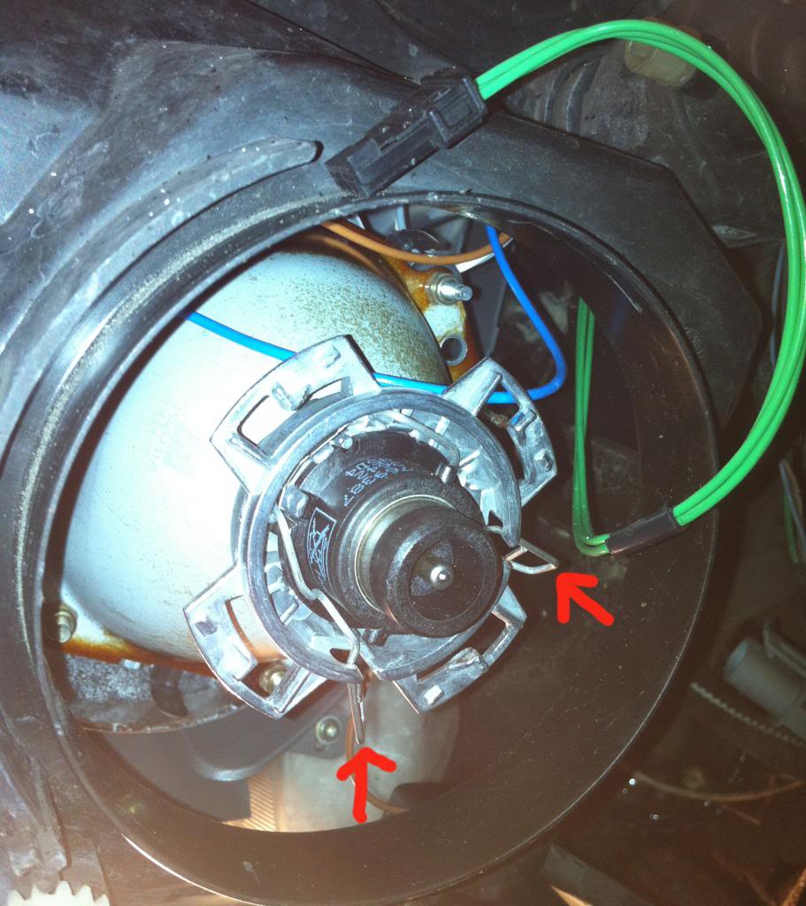

hi please help!!!:mad: im trying to get my passenger side bulb out, i have taken the rubber cover off, unplugged and twisted off the block from the bulb, how the hell does the actual bulb come out?? is there a clip etc that i cant see??????
from what i remember the ballast unit twists and pulls out and comes apart from a locating ring. you need to twist and pull the ring off aswell then the bulb just pulls out
Theres metal clips either side, push inwards slightly then away from the bulb and the clips are free.
thank you sooooo much!! twisted it off like you said!:clap: needed a bit more brute force than i expected! now waiting for the arrival of my new bulbs.
