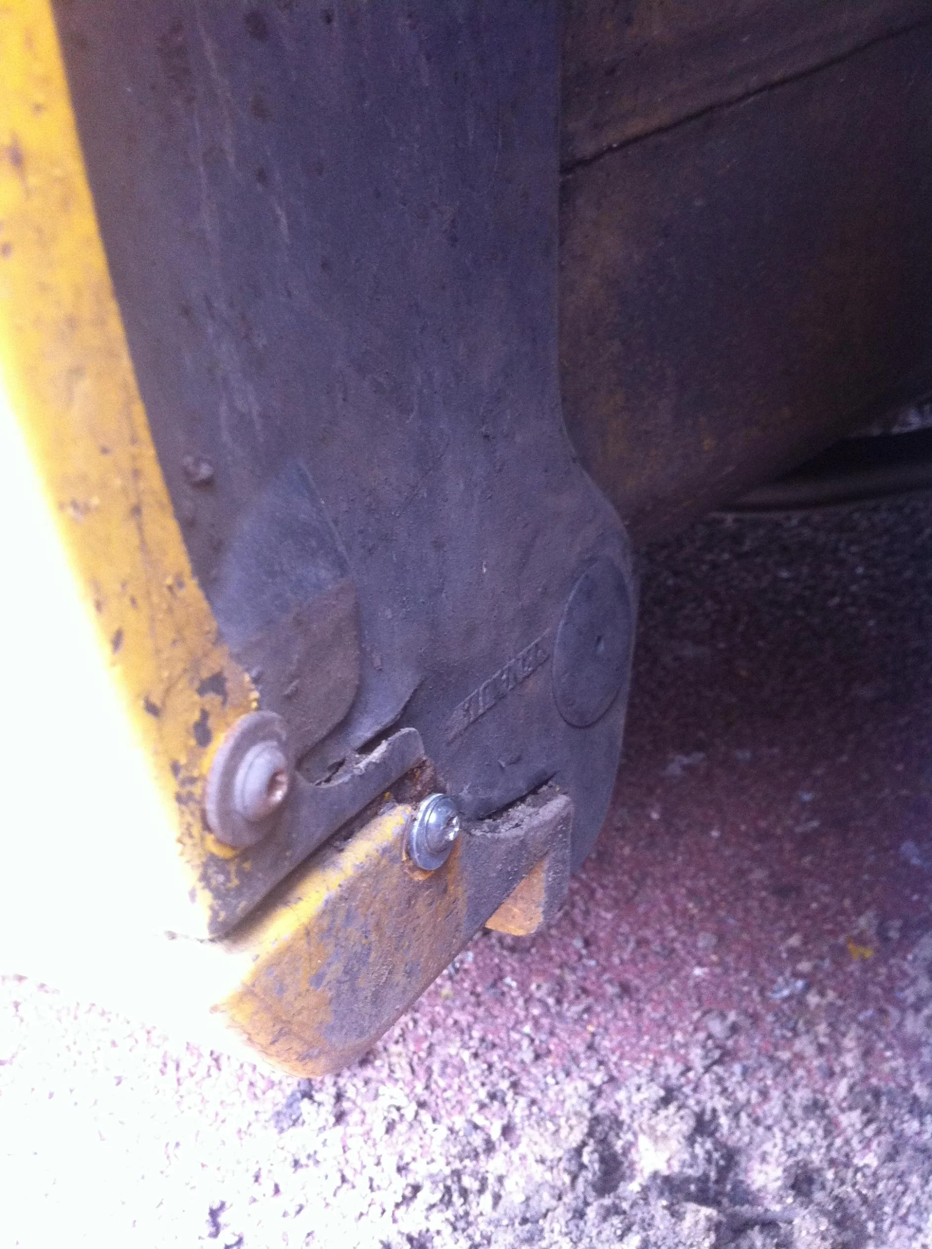

hopefully fixed the problem!! also looked at the bottom of the wheel arch and decided that they need a bit of a touch up. Took me a while to get into the side drain tubes, due to my driveway resembling a ski jump slope, but here's what I did to get it done as easily as I could.

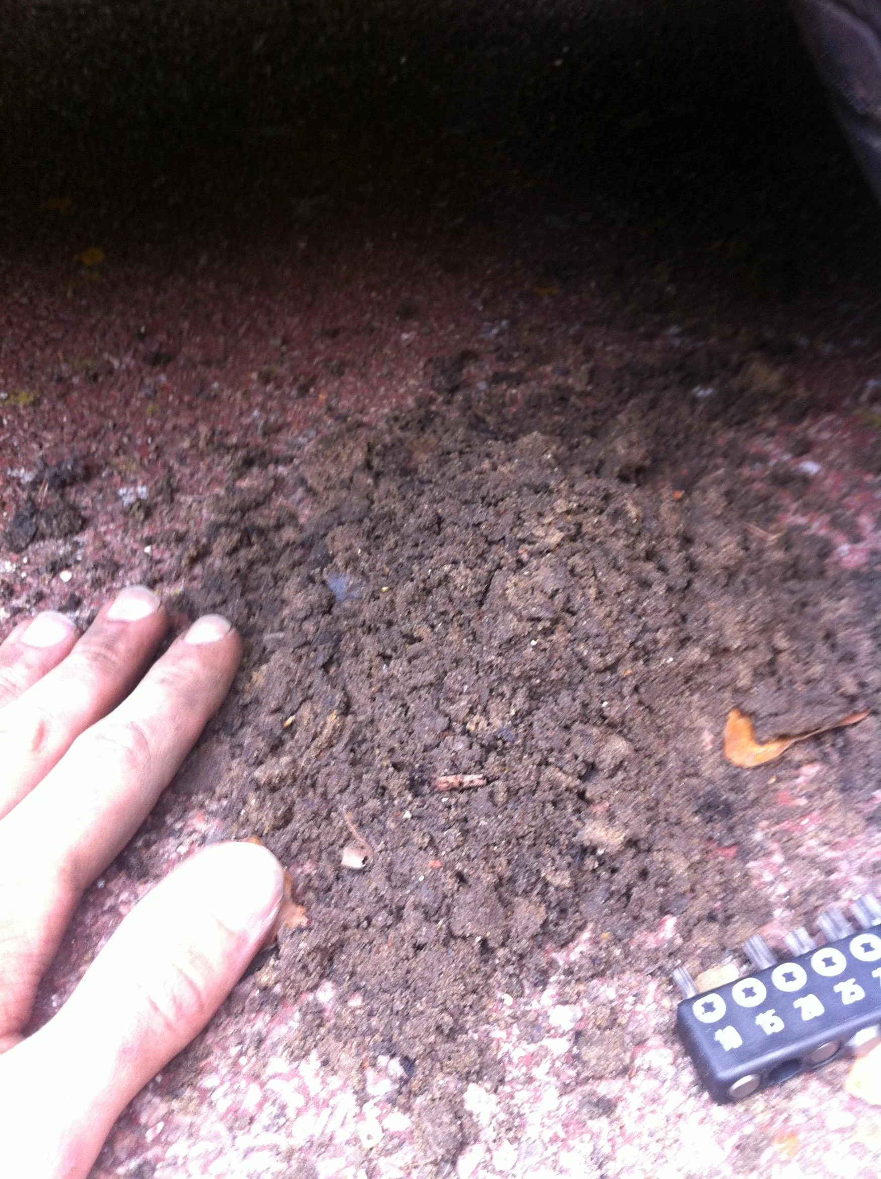

This is what I got out of it!!!! and there was more on the other side, my hands were rank by this point so no pics of the grubbiness of it :p

New screw as well due to the old one being so rusted that it snapped as it came out
