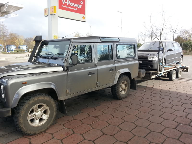

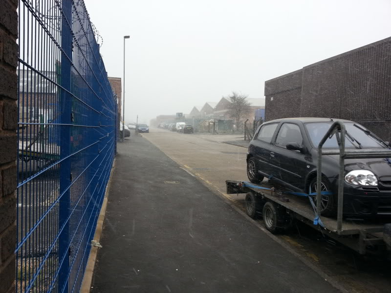

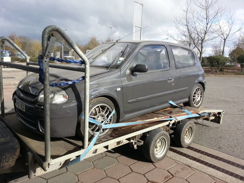

Well after borrowing my mates Defender, then my mate dans trailer he uses to tow his drift car about with, me and danlp6 set off from mine this morning on the treck to see Fred.
After arriving at Freds, having a nosey around in the workshop (Seeing Dynacup relagated outside :( ) and a chat with fred and Zoltan, we rolled the Clio out the workshop and into the sunlight - well, I say sunlight, there was a bit of sun, then this:
Big thanks to fred and Zoltan, who helped me and Dan get the Clio safely on the trailer :)
And a BIG thanks to Danlp6 - as always ;)
Had some Clio up our chuff all the way home (haha etc)

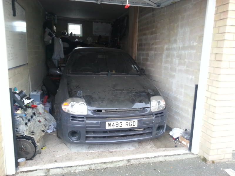

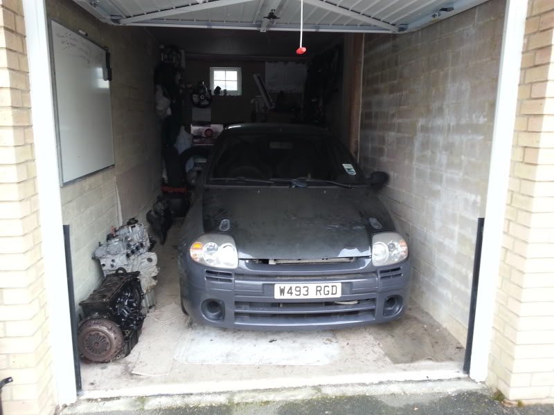

And as you have seen, now tucked up in the garage

It was a bit odd mate, we pushed the Clio out of Fred's place, out on the road (With Fred doing the hard job of sitting in it :rasp: ) and the heavens just opened! T'was a right blizzard in a matter of about 1 minute

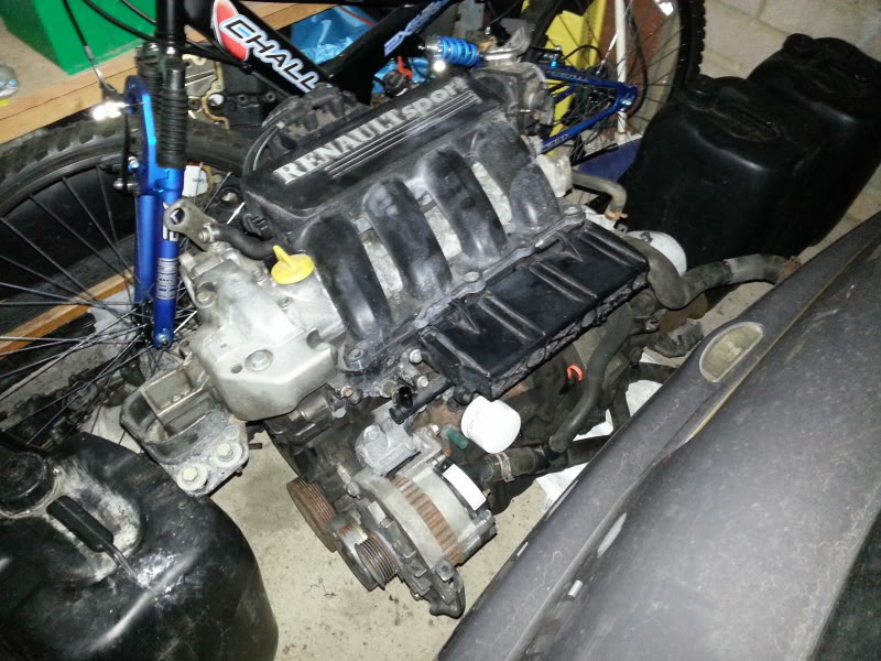

And here is the 'new' engine
Need to tidy the garage up so I can start taking all the bits off it

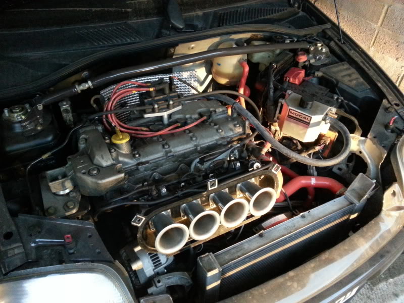

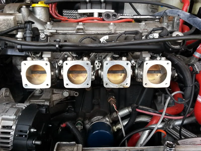

Small update - it's now MOT'd :D
Had a spare couple of hours so got the old alternator off and fitted the new one, gates belt and was all good once I had managed to find some bolts to bolt it on with lol.
Had to whip the air filter back plate off, which needs a clean - something to add to the list lol
Once that was on, I fitted the new battery, and gave it a go starting (Not sure how long it hasn't been run for, but I think it has been about 6 months from memory) and it fired up, ran smoothly then dropped onto 3 cylinders. Great.
I tidied up quickly, then checked all the plug leads were on ok, and hoped it would clear. I got 2 miles up the road and it wasn't getting any better, so had another quick nosey round the engine bay - long story short one injector had come unplugged, but was still resting on the injector so looked like it was still connected.
Popped it over to work, got it up on the MOT ramp for it's test and had a very good going over it while it was being MOT'd.
The only bad point we could find was one ball joint has a tiny bit of play - nothing bad, and barely worth it, but as I have about 3 Clio's worth of spares I will chuck a better one on lol.
As it hasn't been used in a long time, I took it quite gentle, but I did open it up a little:
does pull well, but to my ears it doesn't quite sound 100%.
What I'm sure isn't helping is the state of the oil :( Unfortunatley by the smell of it, fuel is getting into the oil, which I am guessing could be rings - I will give it an oil change and run it for the next week and see how it behaves but I'm 99% sure my spare engine will be going in it.

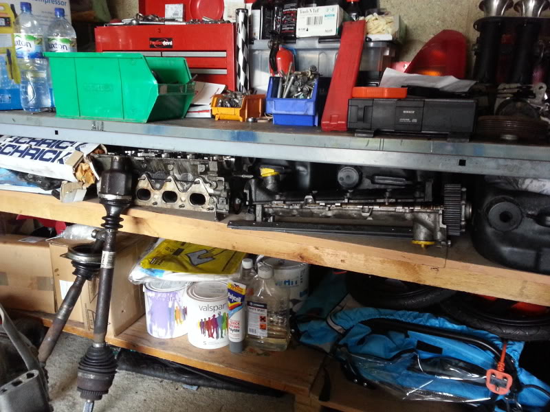

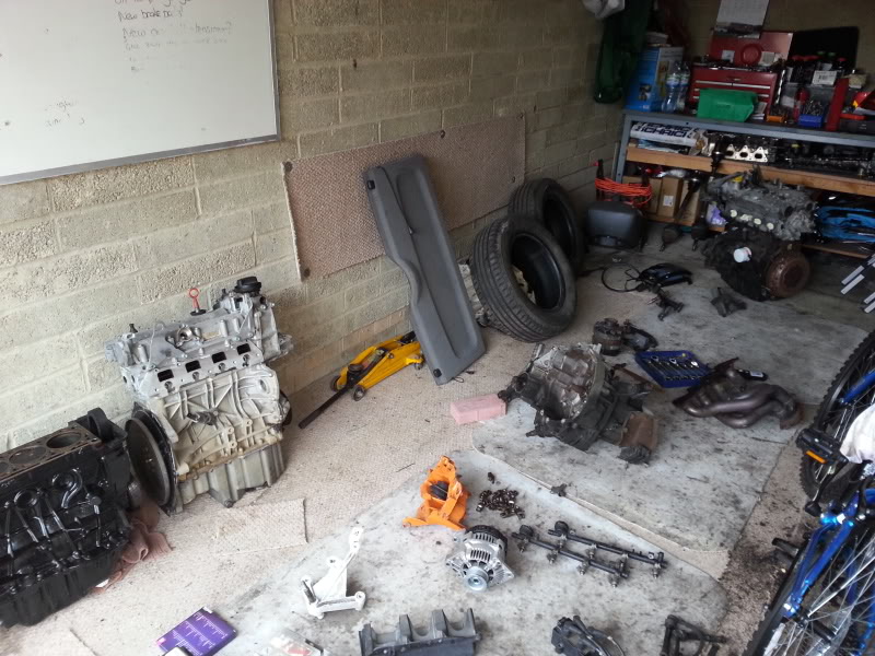

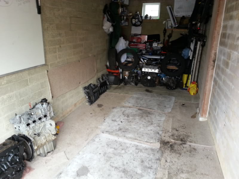

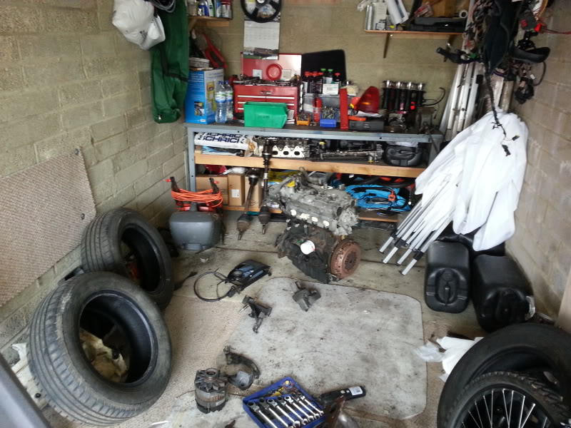

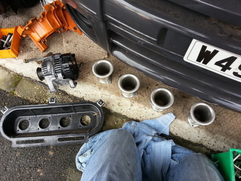

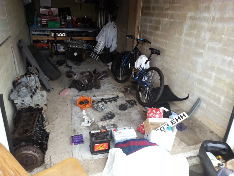

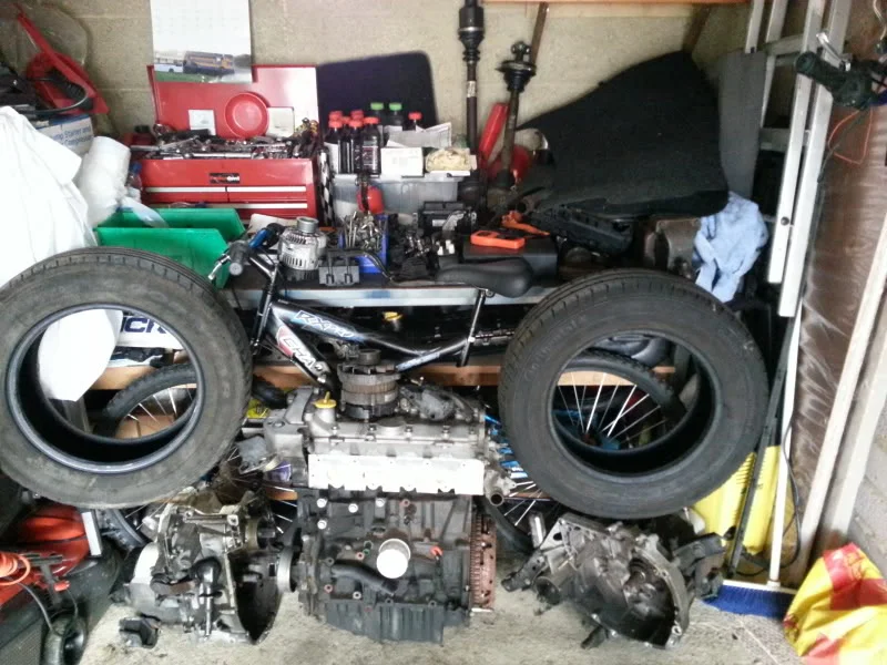

Got it back out the garage for a couple of hours, not to work on it, but to tidy the garage and start taking bits off my other engine.
My garage at the moment is an utter tip, but after an hour it looked like this (And yes, this was an improvement)

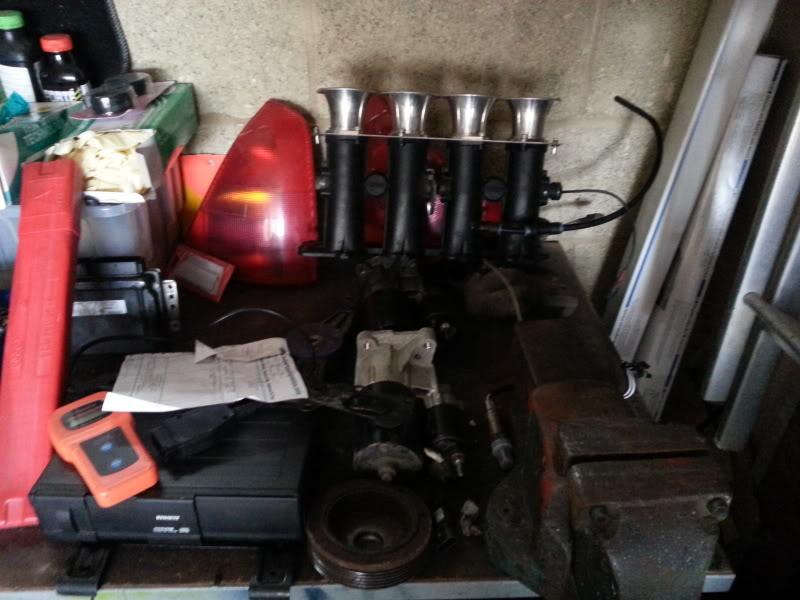

I spent a long time sorting the crap out on my work bench, which now has various Clio bits on it

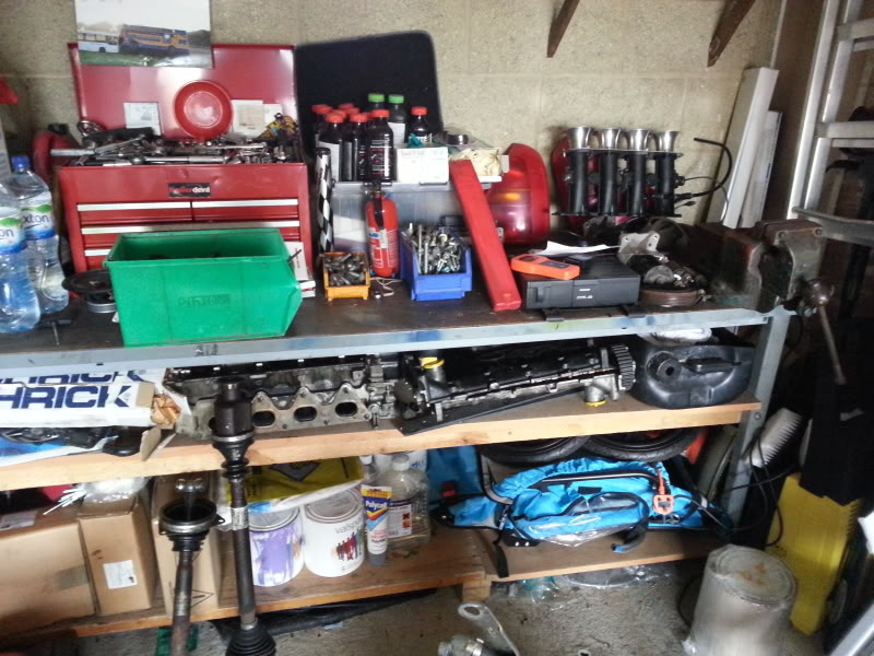

And ended up like this

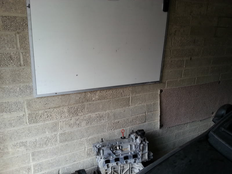

Lastly, the white board needs updating with latest project.....
I got the inlets, exhaust and gearbox off my other engine, which are for sale, so check out my F/S thread ;)
