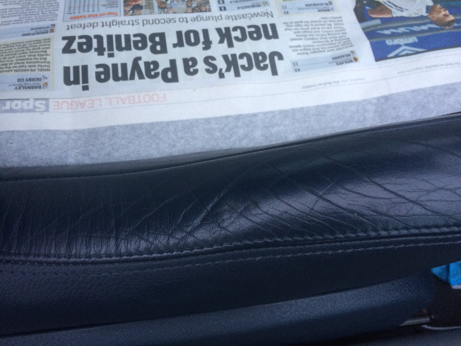

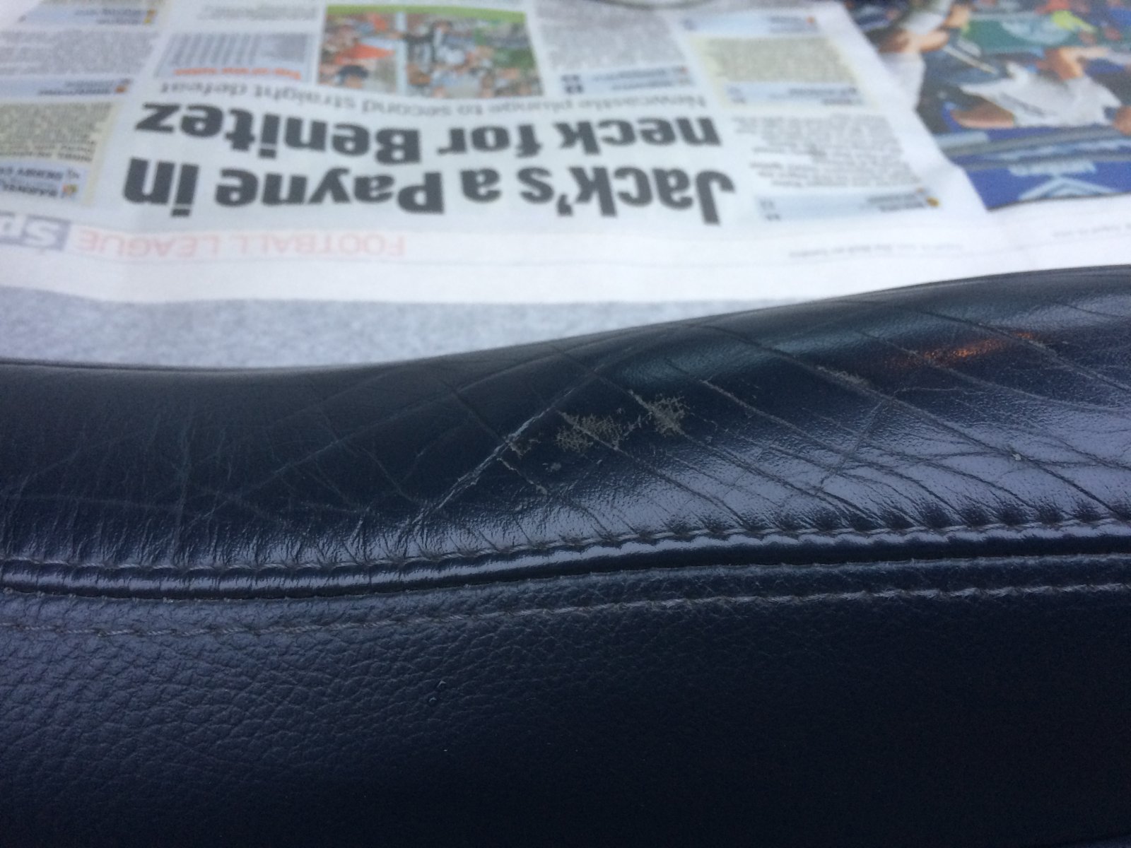

Yesterday (when for just 5mins it wasn't raining) I had a go at making the cracked leather on the driver's seat bolster look a little better... with some navy blue shoe polish that I found in my parent's shoe cleaning kit!
Before;
Sainsbury's shoe polish!

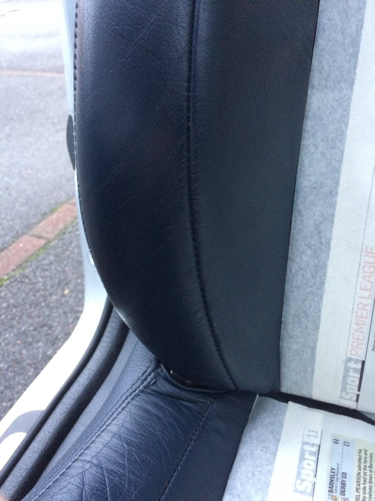

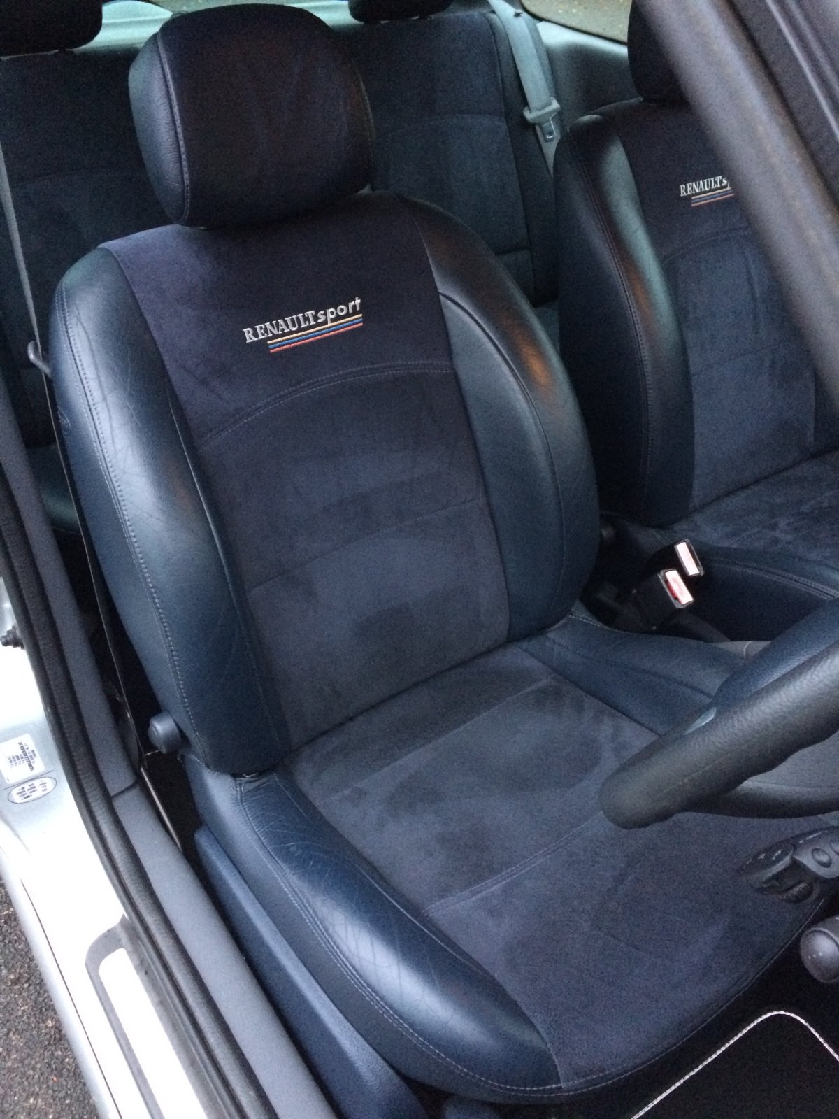

After;
Quite pleased with the results... I did go over the area with some more 'Wonder Wheels' leather cleaner/feed which dulled down the shine that was a result of buffing off the shoe polish!
The seats do look quite plush now :cool:
^ Looks great, the problem will be if any of it rubs off on clothes- especially a white shirt

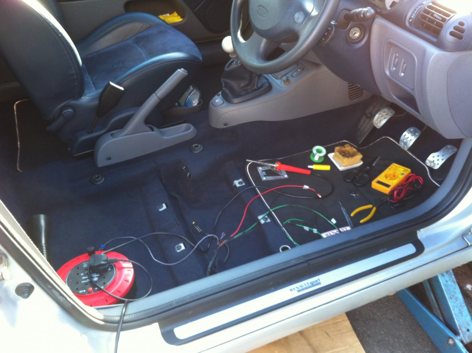

So I managed to book it in at my mate's garage for the 6th Feb (today) - Except that I knew that one thing it will definitely fail on is the illuminated airbag/serv light, so luckily the weather over the weekend was kind to me & I was able to get out & solve the issue once & for all..... I'd already snipped off the old plugs & re-soldered on some new ones - but noticed that it had looked like the cables were snagging on the Autochanger under the driver's seat - so wondered if the wires had broken down there?
Driver's seat out & new cables/plugs soldered in from where the loom exist from under the carpet...

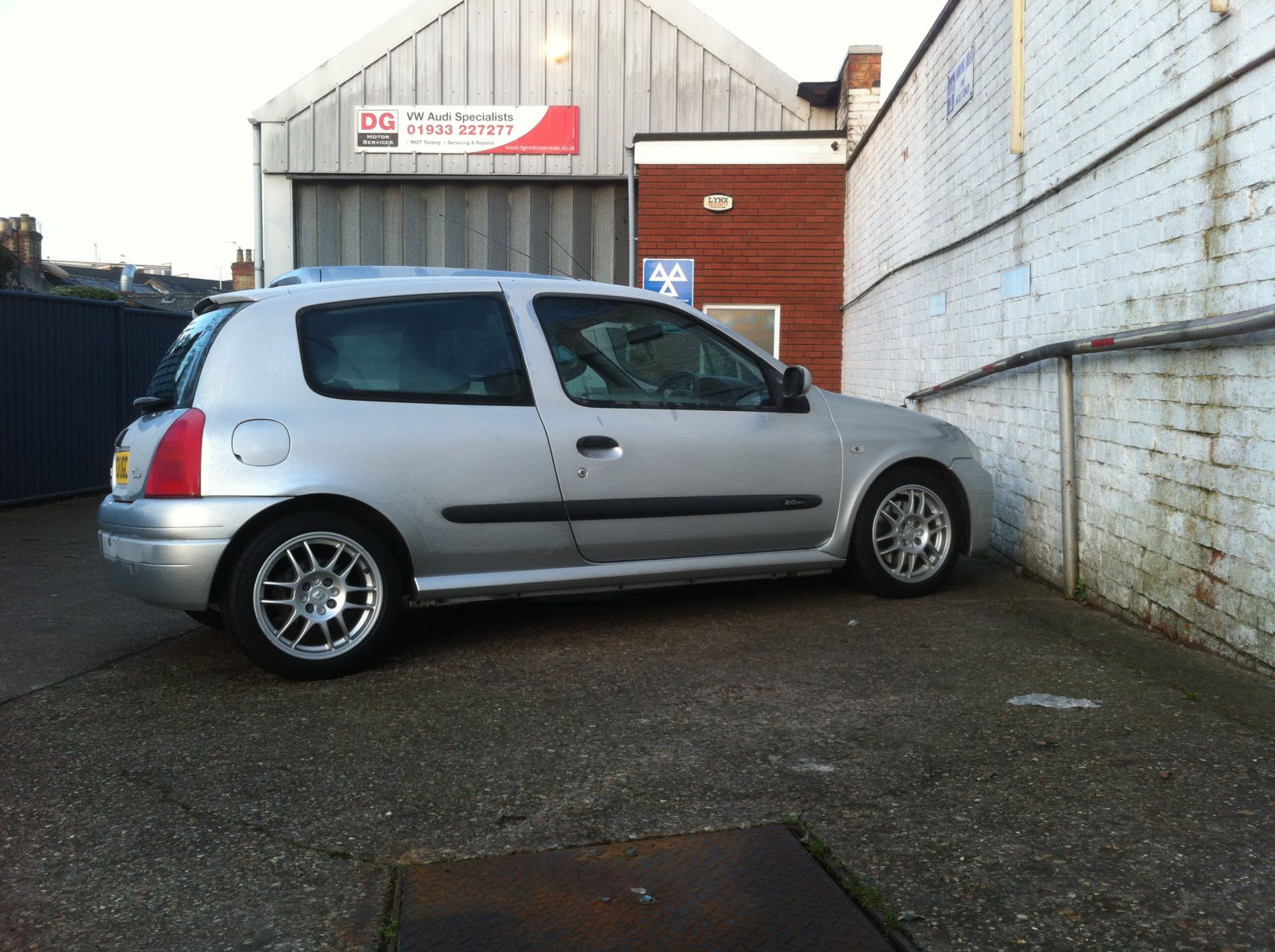

.....& this frosty morning, dropped off at the garage ready for its inspection!
I've just had a phone call from the garage to say that its al ready to pick up..... so I'm presuming that its passed!!:up:

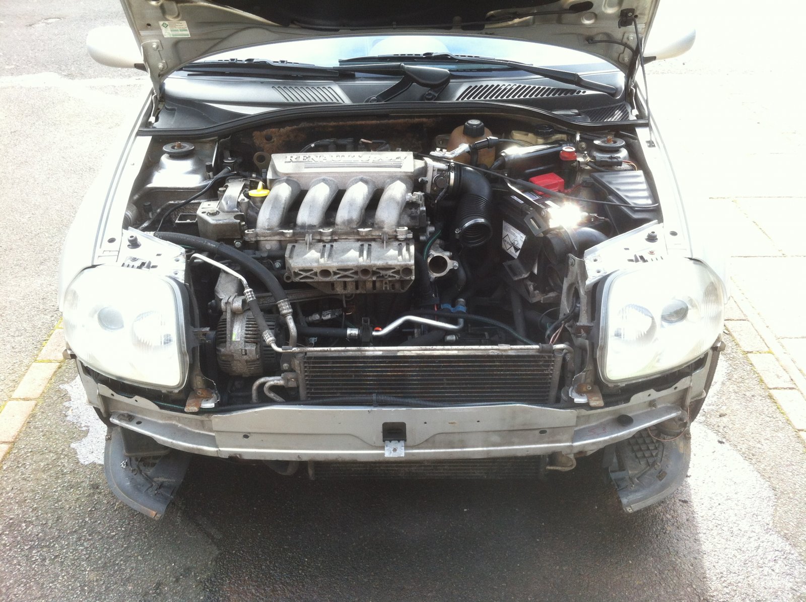

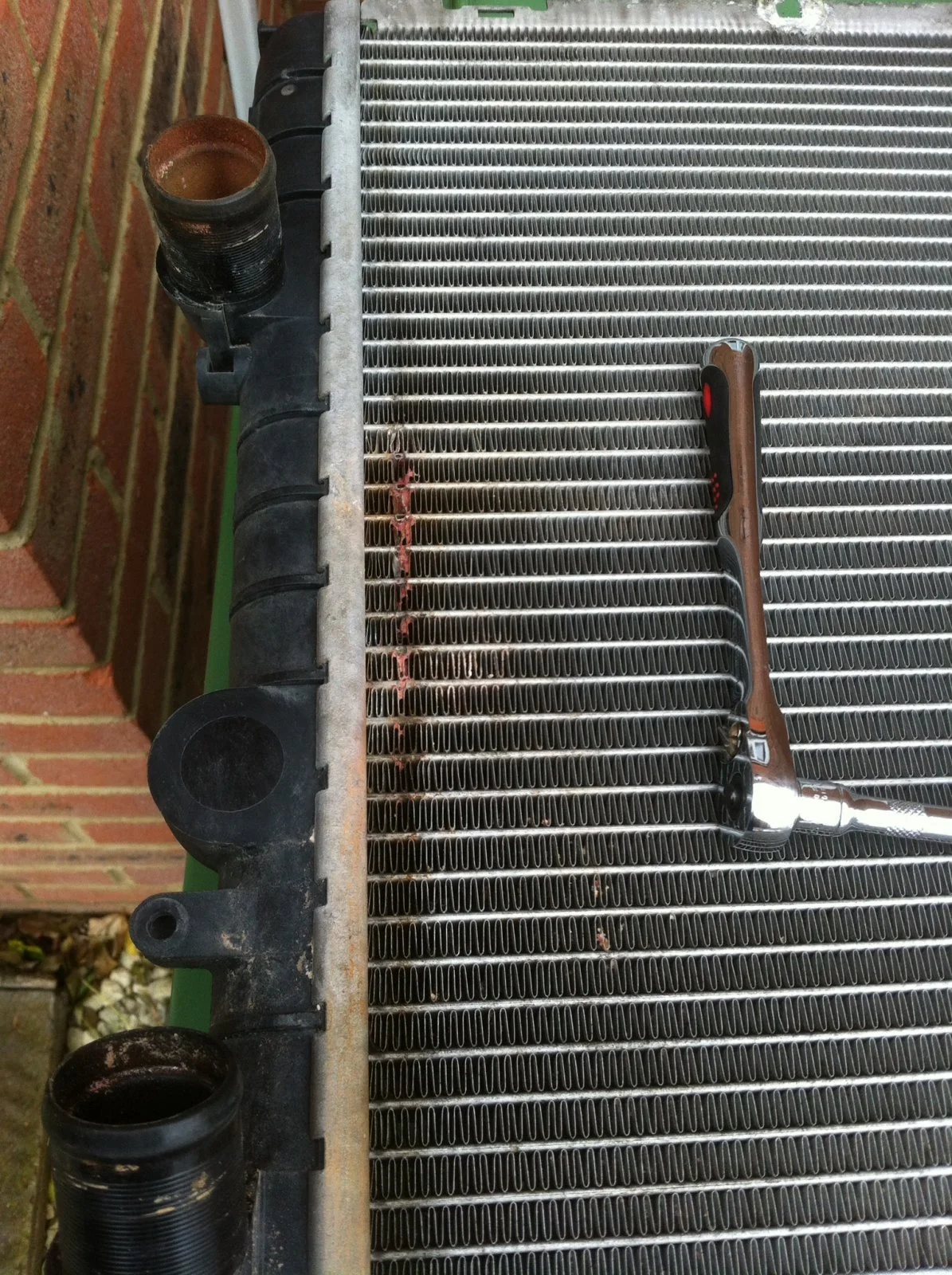

Whilst my car was in for its MOT - the tester (& good mate) said that there seemed to be a bit of a coolant leak - this was something I had spotted myself from a slight & very gradual reduction of the coolant level in the header tank, I had kept an eye on it over the last few weeks knowing that I needed to make a long journey from Northamptonshire down to Poole in Dorset to deliver the seats from the VW Derby to the trimmers for re-upholstery.... but instead of getting the leak fixed before travelling down... I thought I'd risk it & set off last Friday morning on my trip. I went prepared with some water in a bottle & made sure I stopped regularly on the way down... at first the coolant level seemed to remain constant - but by the time I arrived in Bournemouth/Poole at the trimmers the header tank was below the min line. To cut a long story short I ended up travelling home with a very nice AA man with the Clio on the back of his truck. Luckily at no point did I let the coolant level (which by the end was a constant trickle out from the radiator) get too low. So No.1 lesson learn't - don't set off on a long journey with a car with a known fault!
I didn't get back home to nearly midnight on the Friday... but was up early on the Saturday morning to set about stripping it down in readiness for fitting a new Radiator. Looking through various guides & discussons, it seems that the real only way to get the Radiator out is to take off the front bumper/grille & slam panel, so to do this I though it would be best if I jacked the car up & set it up axle stands. Now I would like to think I'm reasonably competent when it comes to working on cars (& mechanical stuff in general) - Indeed the Clio, since I've had it has been up & down on a jack more times than a Whores draws! But this is when the 2nd 'thing' happened - I jacked up & set the passenger side up on the axle stand, then went to jack up the drivers side. I use a wooden block that sits in the 'vee' on top of each of my stands to protect the underbody/cill lip of the car - but I'd set the Pass-side stand up in the wrong orientation (so the cill lip was across the 'vee' not in it) So as I jacked up the other side it allowed the car to slide on the wood block until the axle stand fell out - with the car dropping down back down onto the stand but now resting on the side skirt - crushing it in the process :fearscream:.... as you can imagine much swearing ensued!! But I must say - it could have been worse... the car could have dropped onto the floor... or worse still, onto me, with me under the car!!
So after that I decided to stop & have a break - I waited until the afternoon & proceeded to carry on with the task in hand, now with a calmer frame of mind! That's not to say that the bumper (etc) removal was completely trouble free with a couple of seized bolts & a broken headlamp bracket. But now I've done it once - it will be a lot easier if I ever have to take it off again!
This is as far as I got - everything removed ready to receive the new radiator - which I purchased during this week, along with a new Thermostat & some Type D Coolant from Renault.

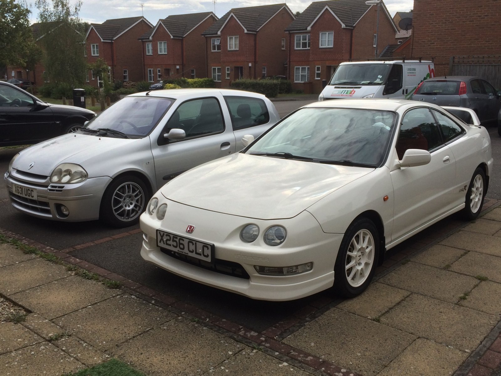

On other car related news, The Honda Integra that I sold back to Honda for their heritage fleet has started to make a few appearances on various twitter feeds & featured within an article over on Pistonheads. The photos below are from the Honda Europe website;

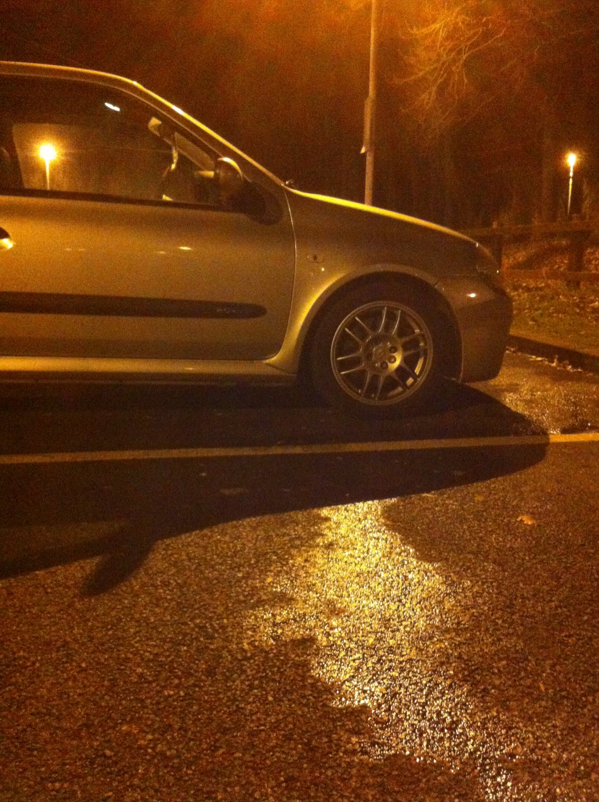

Lucky escape with dropping the car, I'm always paranoid about lifting a car into axle stands.
I don't tend to jack onto the sills if I have to. I use a trolley jack under the front wishbone joint and then place an axle stand on a bolt on a chassis plate strengthening thing just behind the ARB or the subframe bolt. Then just for piece of mind keep the jack in place too so there is a few things holding the car up.

Good tips for jacking up these cars, I must admit that lip on the Cill section looks very vulnerable & mines already a bit misshapen so doesn't give me a lot of confidence. I'm actually very annoyed with myself, as I know I'm normally far more careful when jacking up & working underneath a car!

Managed to fit my new Radiatior in-between the rain showers yesterday, all seems OK so far, touching wood & fingers crossed lol!

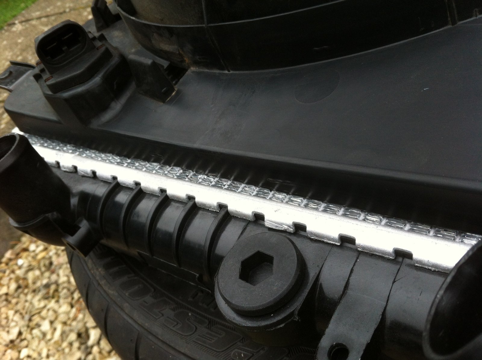

Was looking at my old rad - it's obvious where it has been leaking from..... & it took me a short while to realise that the regular wear mark that pierces the radiator actually co-insides with where the rad fan housing sits, the fan housing/shroud on that side was warped causing it to rub & thus eventually piercing through the radiator itself.
.....so before I bolted the fan to the new radiator, I shaved a bit off of the offending plastic - so now there's a gap, so hopefull there'll be no rubbing (well until the fan shroud warps further still!)

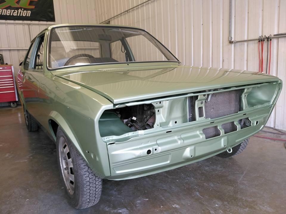

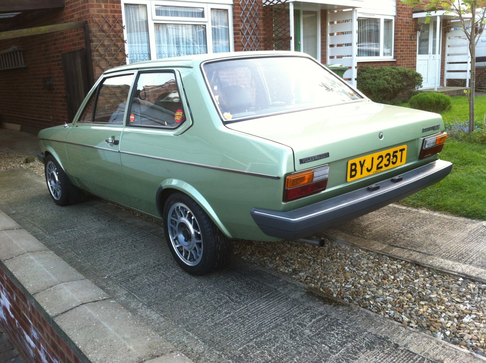

So I made the return journey back down to Poole to pick up my re-upholstered seats for the VW Derby..... this time the car drove both there.... & back - here's a picture to prove it!

Very little rust if it has any, although also doesn't have a lot of anything else either 😂 donor car arrives later so hopefully that looks good once it arrives, saw what I thought was a Ph1 on the A14 going on a recovery truck last night and thought hope that's not you, obviously not which is good :up:

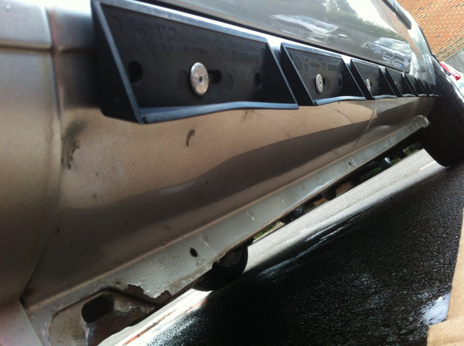

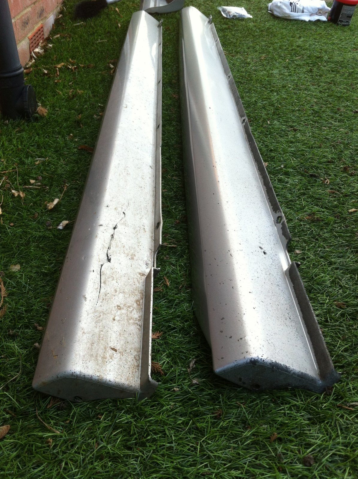

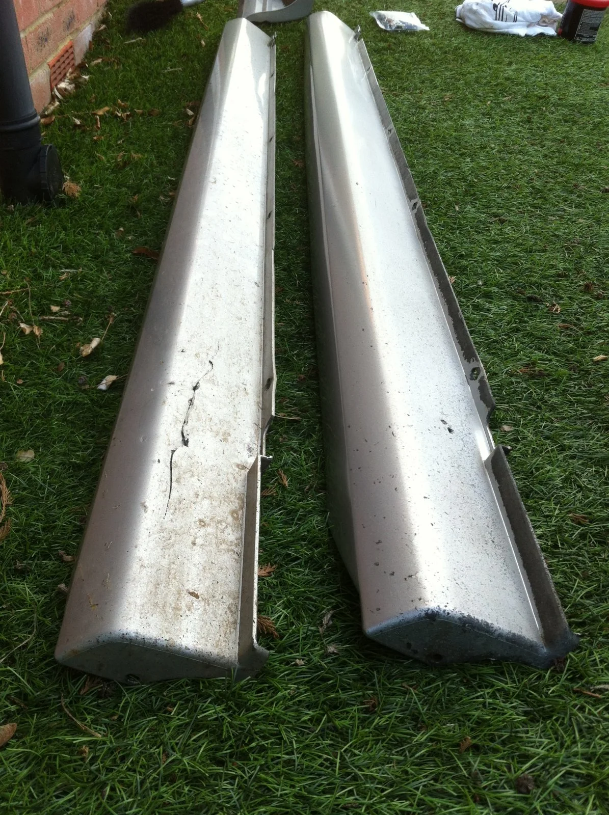

I love the longer days & nicer weather we've been having - it meant that I could replace the cracked passenger side, side skirt with the one I purchased off mintno1.
On removal of the old skirt - I was rather disappointed to discover that the car dropping off the axle stand down onto the side skirt had indeed damaged the cill beneath :confused:
On the plus side.... whilst there is some minor rust bubbling towards the rear of the cill - it doesn't look bad at all - although I'm guessing the bubbling is a sign that its coming through from the inside - so i'll have to remove the side panels at some point soon to get in there & treat the inevitable rust...
