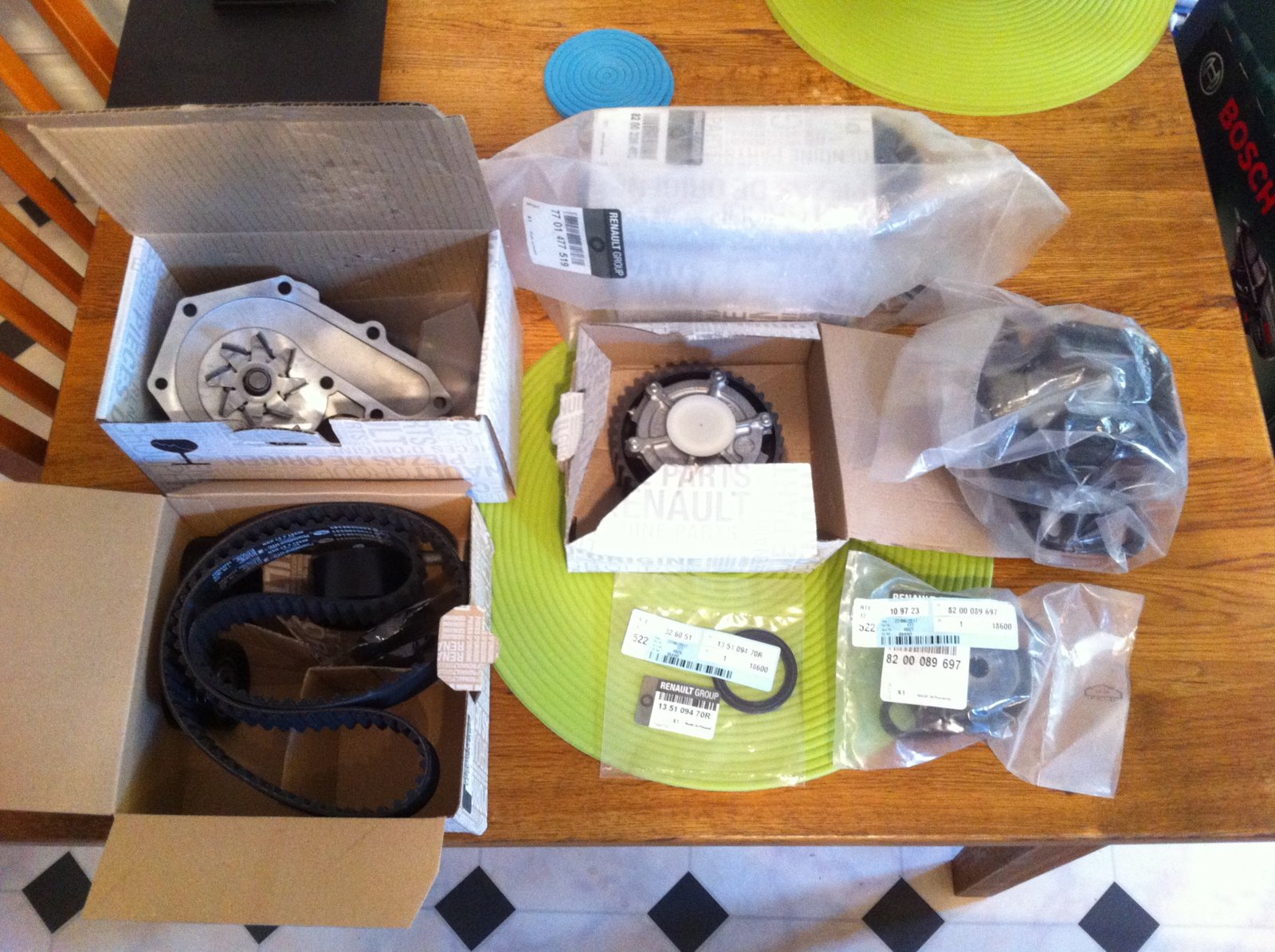

So this is happening...... The dreaded Cam/Aux belts & dephaser pulley! The dephaser pulley noise suddenly got worse so have been avoiding driving the Ph1 for the last couple of weeks - luckily the weather has been nice enough that driving around in the Derby hasn't been too much of a hardship :smile: I had started looking into doing the job myself - but on reading up on it I just don't think that a) I'm confident enough not for something to go wrong, or that I'd get stuck on (with the car sitting stranded on the drive) & B) I just don't have the time! So with a lot of ringing around different garages, the only place that filled me with any sort of confidence was Northampton Motorsport in ahem.... Northampton. The car was dropped over there this morning along with the parts that I had purchased.... so fingers crossed all will go well!
At the same time they are going to look into the oil leak situation & change the crank bearing seal on the timing belt end of the engine & also replace the Ktec engine mounts for OEM Renault mounts.... I'm hoping that the car will be a more pleasant drive all round when it gets back?

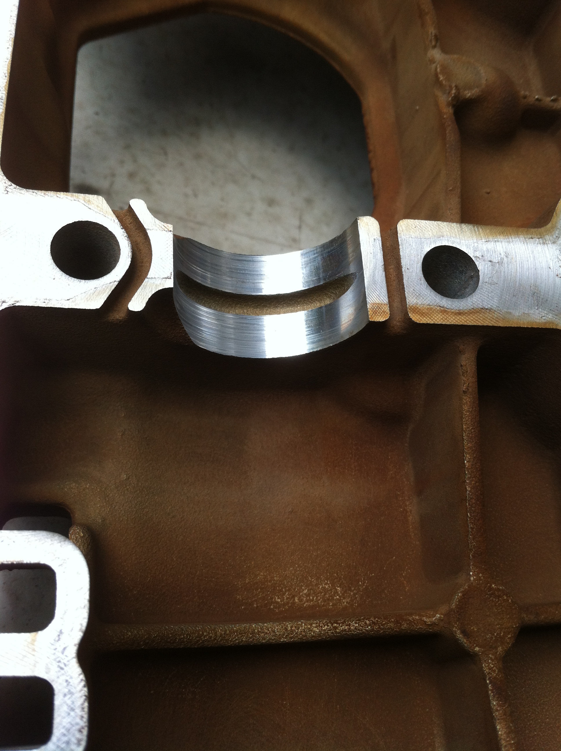

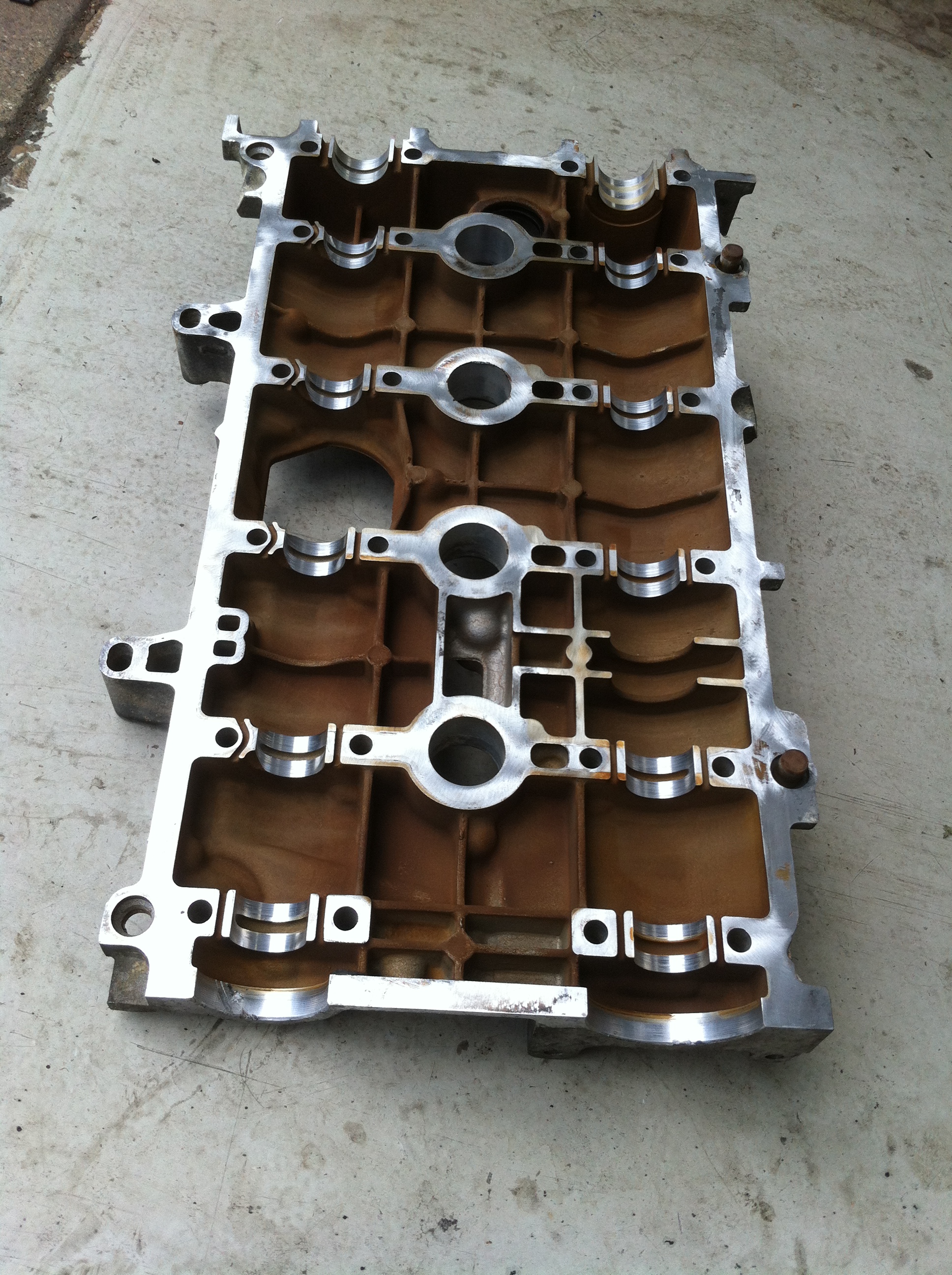

These last few months the little Clio has been a bit of a source of expense & worry... at a time when I really need my daily driver to be reliable. Getting the Dephaser & belts done was always going to be an expense where you actually question if its worth it - given how little these cars seem to be worth - but with Phase1 RS Clios becoming rarer - getting this job done seemed worth it.... even if I was only going to keep the car for a further 6 months or so. The car was duly delivered to Northampton Motorsport who spared no time in stripping it down & in doing so discovered a very leaky rocker cover - which they asked if I wanted them to remove & re-seal. On removing the rocker it exposed what Northampton Motorsport considered to be worn/scoured surfaces on which the camshafts run - they think it maybe as result of oil starvation, potentially caused by the surging of oil whilst the car was being driven on a trackday or similar?
This is representative of the surfaces on both the rocker & on the head casting itself..... definitely not the fine machined surface that I know should be the norm..... I'm not sure what other Cliosport.net members think - or if they've experienced anything similar?
Northampton Motorsport invited me over to have a look before they proceeded further with the dephaser/belt job - & indeed if I thought it was worth it. Too be honest from the conversation on the phone I was expecting to see worse.... given that I'd now done 10K on this engine since buying the car (& knowing that I'd not driven it in any conditions to have caused the suspected oil starvation) & it had been OK, I decided that we would continue with the job. At the same time Northampton Motorsport fitted the new supplied OEM engine mounts. One thing I wish I had done was take a picture of the car on the 'four-poster' in their workshop - it actually looked the part sitting up their surrounded by historic rally cars (Escorts & a Manta) & other exotica! with Snap-on protectors over the wings!

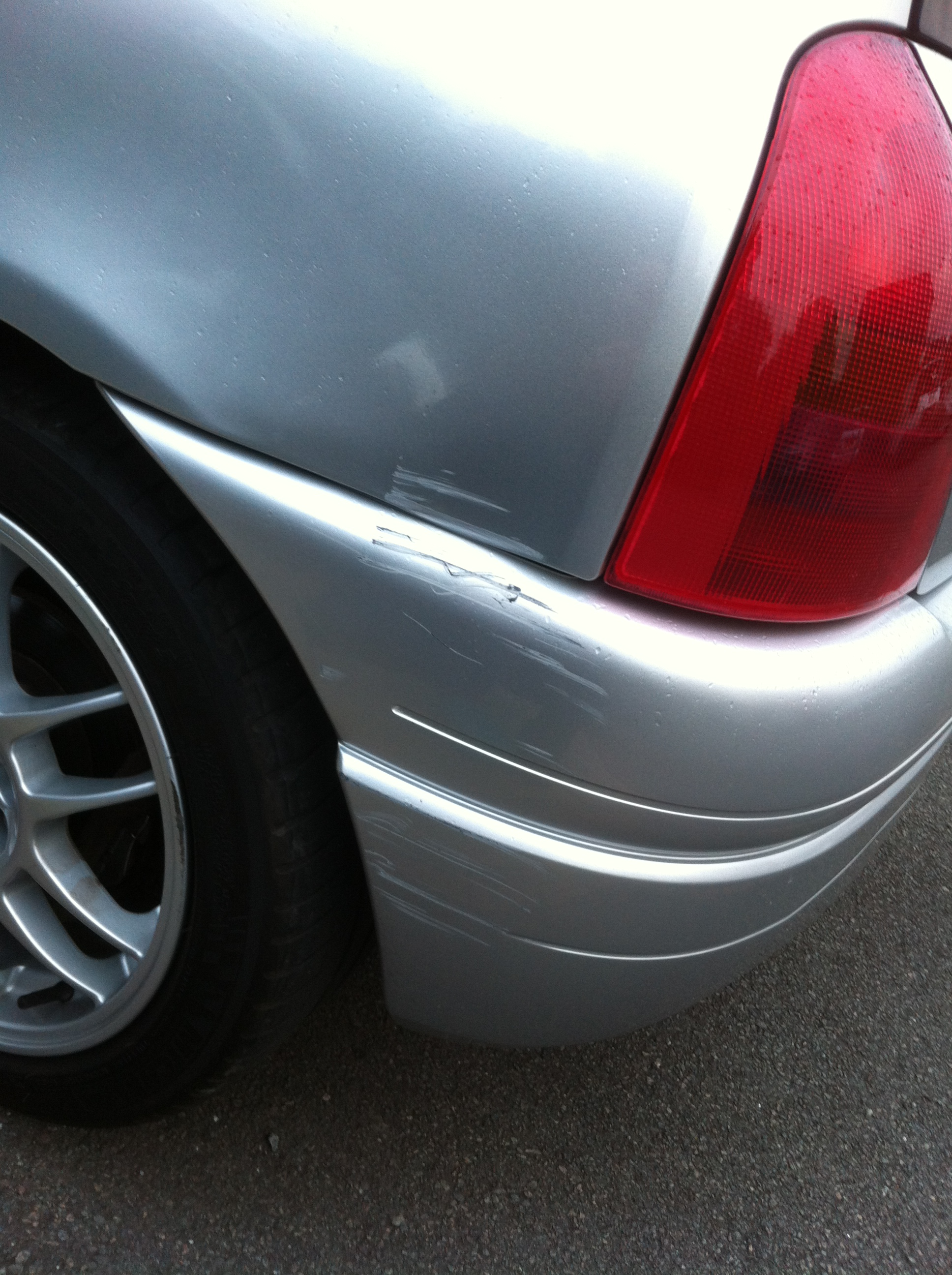

Next up, I ended up bumping the car into a concrete pillar in my local multi-storey car park - it was a case of me rushing around too much whilst on my lunchbreak & lack of judgement - I must admit I was so angry at myself!
