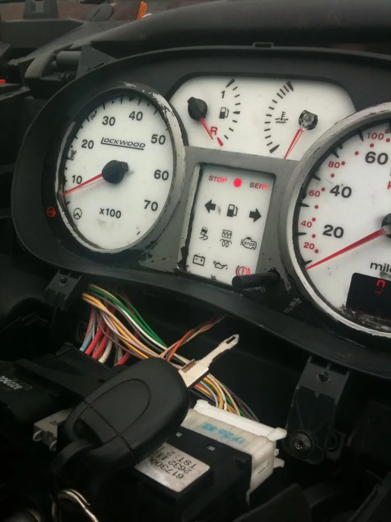

Right a quick one here for you,
Had to take gearbox back out last week due to a problem, so disconnected and fitted back, now not sure wether this is because of the cold weather or not but it was fine before gearbox came out..
As you can see, the clocks are all light up, say STOP SERV etc etc, but the key isnt in :S
Disconnect battery and do it again and its still like that.. i have no idea whats up wit it tbh
Any suggestions?
iv checked the usual Earth points etc so not suree
tbh i'd recheck all your earth points again
double check the connection on the battery to make sure it's good
Deffo bad engine earth @ the gearbox ......
Stick one lead from jumpleads on batt negative and the other end onto a clean metal bit of the engine...... lights will go off to confirm.
