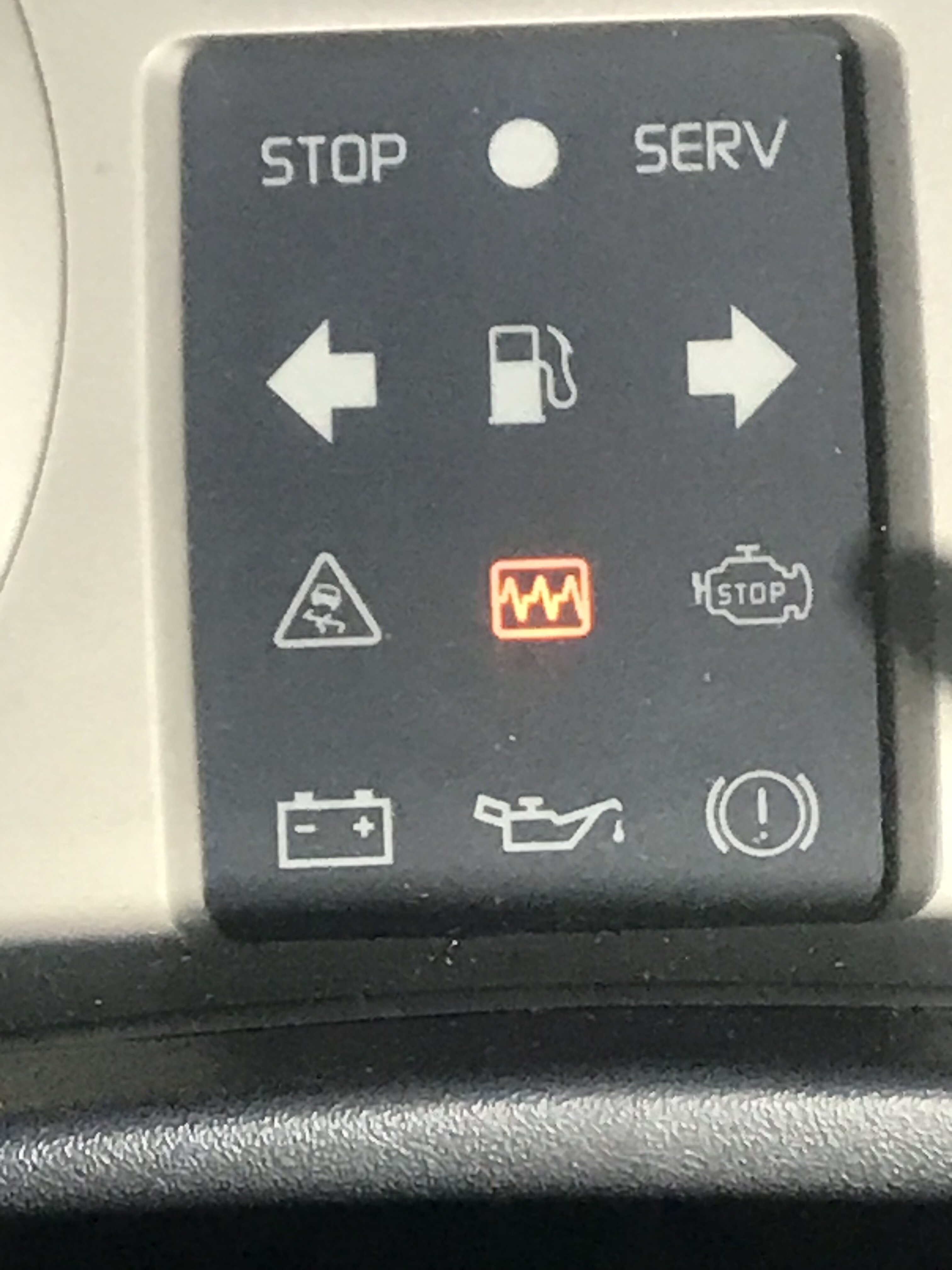

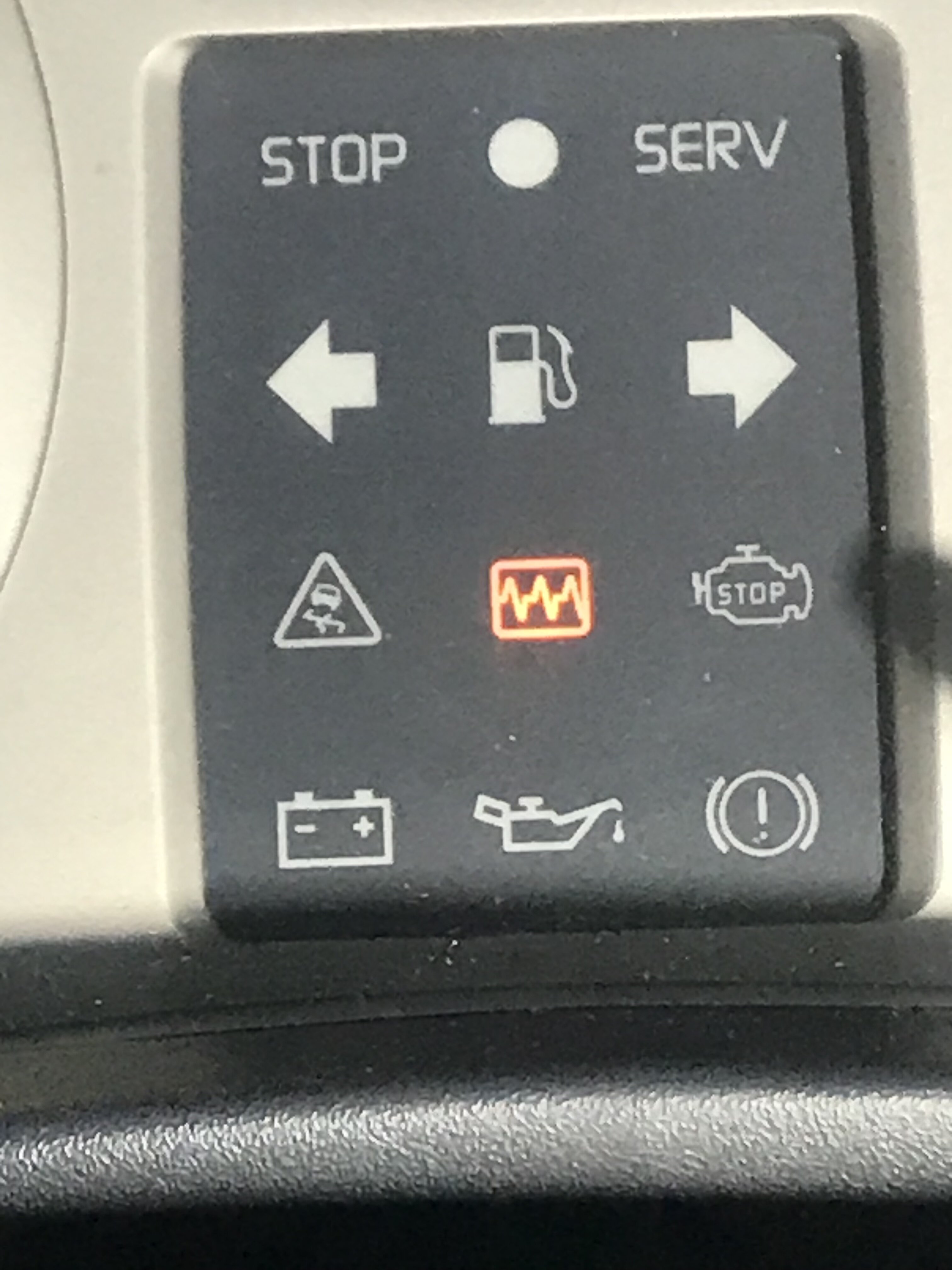

BUT I have this warning light on.
What’s this one??

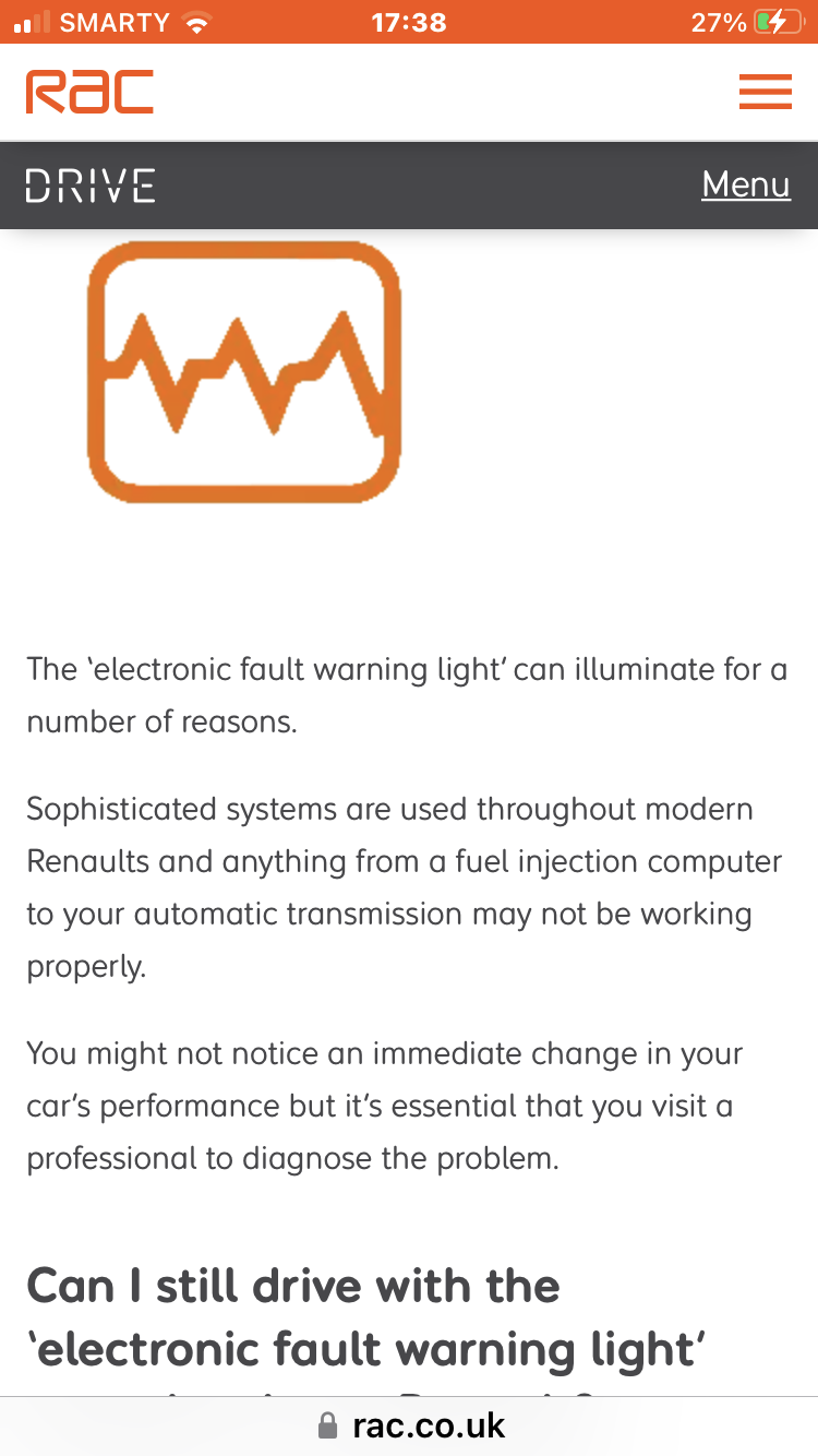

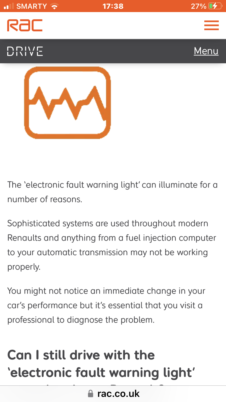

Seems it’s a very vague one. Will spin it up the road shortly and see if drives on.

Ok a bit of an update. Done visuals of all and can’t find anything out of the norm. All dry in the fusebox area. So rechecked obd stuff and nothing.
Restarted and idle had come down but the light above was still on. So took it up my road and it was running in limp, so back home and scratch my head. Anyway ign on again and light has gone out and idle is a smidge high and fluctuating slightly. But as the light was out I went for a short spirited run and power is back but as idle is still slightly not right I’ve loaded the car up ready to go to the track tomorrow.
Somehow somewhere I’m sure some moisture has entered somewhere but I’m of the thinking that by the morning residual heat may well dry whatever it is leaving it all fine for tomorrow.
Should any recurrence happen I’ll have to tap up a good friend on here who has the full Renault kit to dig deep.
But for now I’m not going to worry anymore and go send it tomorrow!!
Thanks all.
Need clip to see what fauls are stored with electrical fault light on. Usually relates to fusebox area/corrosion on relays, white plug corrosion etc. Remove and refit relays if any further issues.
