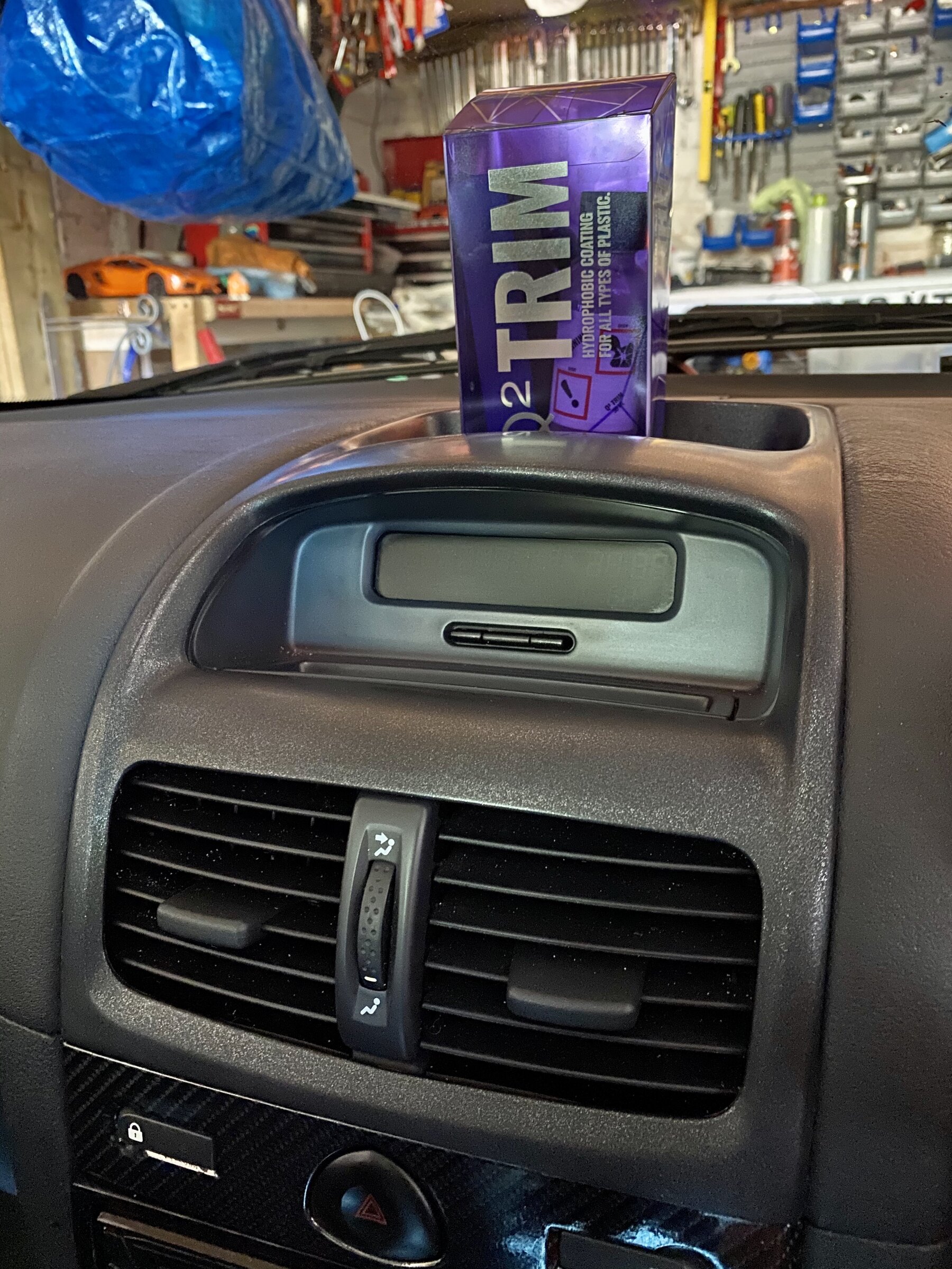

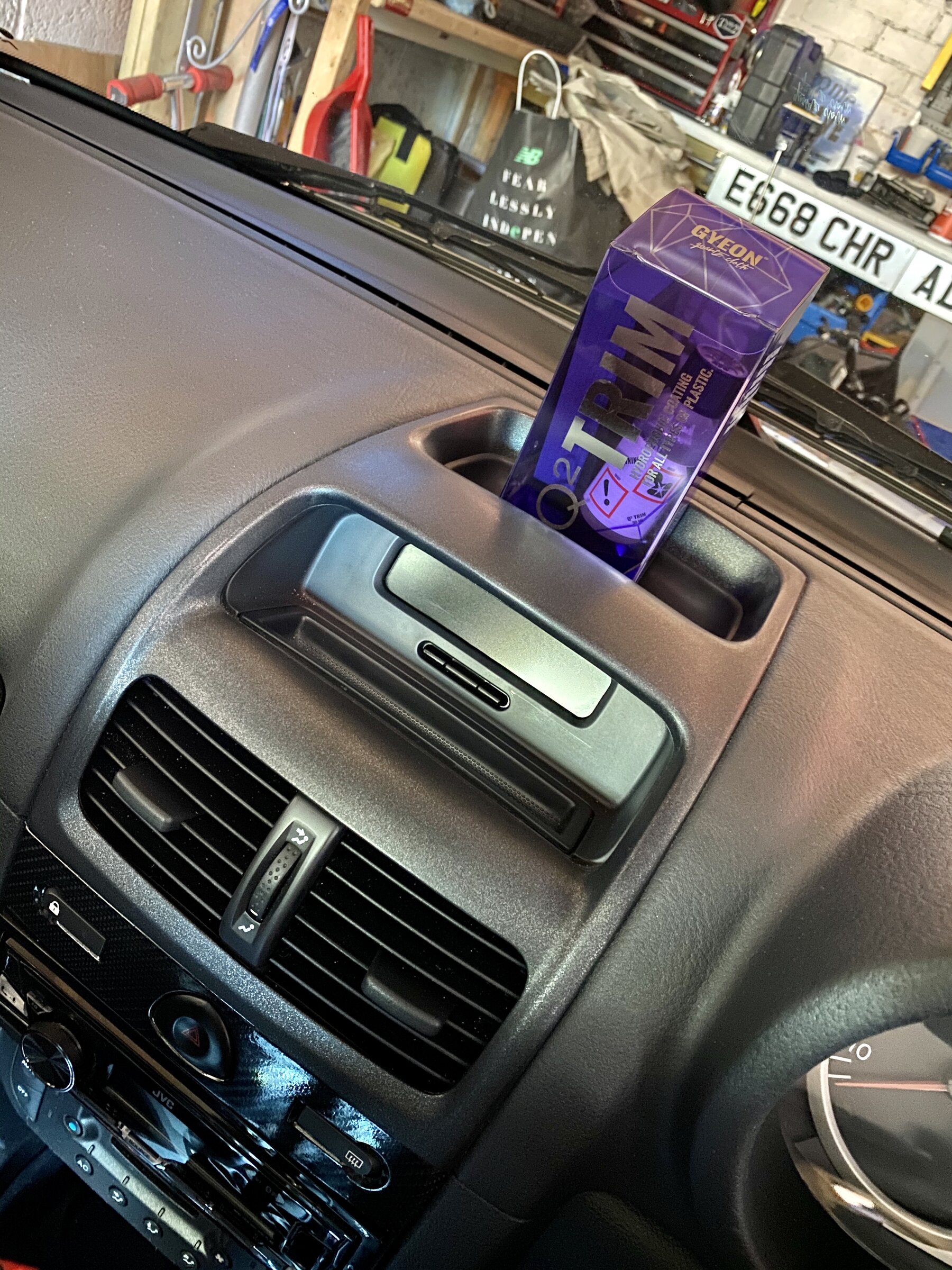

I stripped mine and picked up an IG post from another Clio owner where he’d used some Gtechniq C4 on the centre binnacle. I didn’t have any so tried Gyeon Trim instead and really pleased; slightly darkens the trim and leaves a satin sheen. Helluva lot easier than either masking everywhere or taking the dash out!
