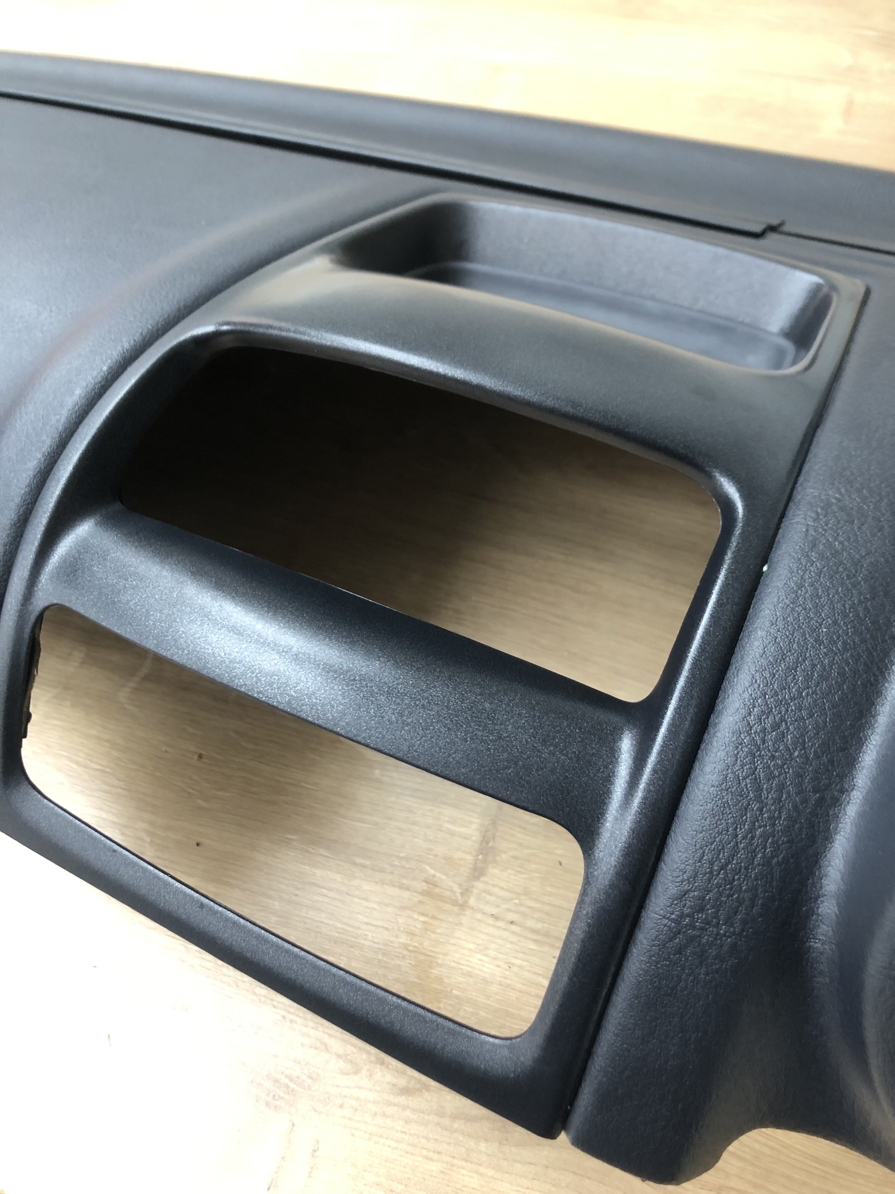

Hi all, just thought I’d share my success using the ‘Elbow Grease’ and wipe method on my sticky dash parts.
I rubbed it down with some elbow grease spray and lots of clean rags to remove all of the soft touch coating then sealed it with some gtechniq C4 trim restorer.
Took about 20 minutes to get it all off but well happy with how it looks. Also worked on my AC controls.

The standard ones aren’t speckle are they? This retains all the silver bits on the trim
True, but unless you do great job cleaning off the tack, and during that process dont damage the surface , it will still need a coat of lacquer to look good again long term, just a coating of wax will fade and need more attention than the outside when baked daily in the summer.
Will keep an eye on mine but the gtechniq stuff works wonders making bare plastic look shiny and new. May end up lacquering it like you say

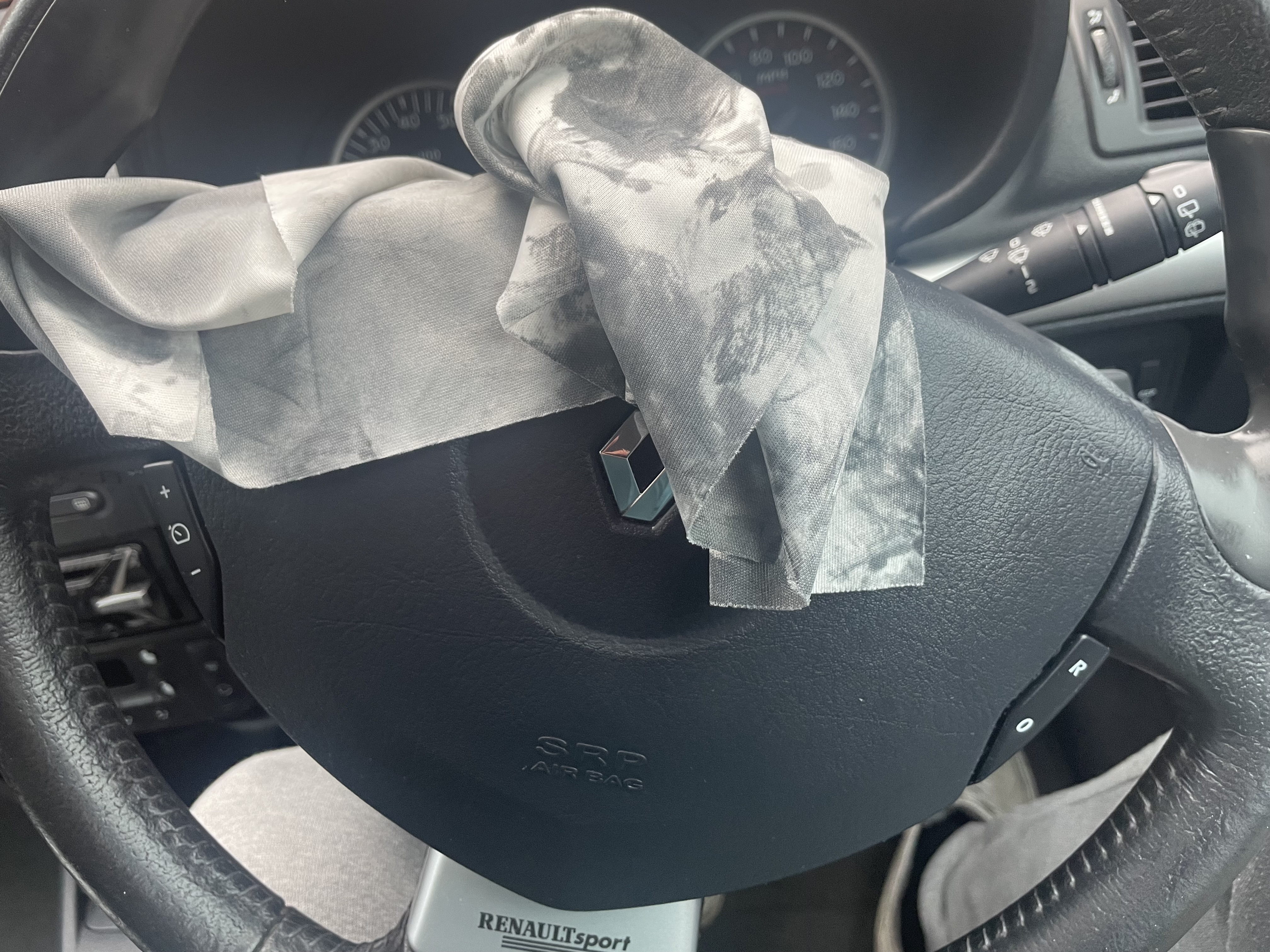

Attempting mine at the minute with some Elbow Grease pulling off this horrible blackness from the steering wheel, I’ll definitely need some trim restorer after this!
