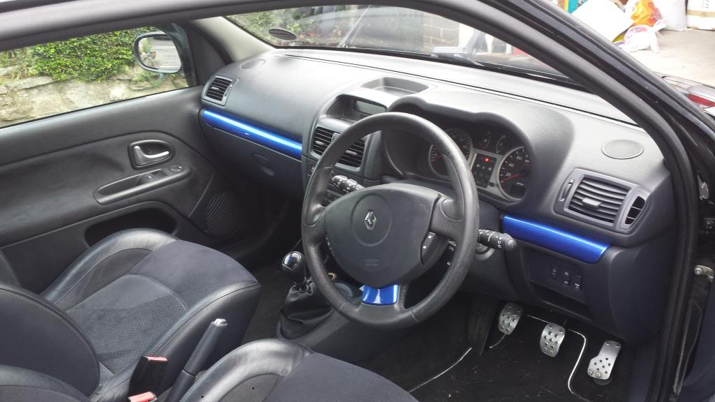

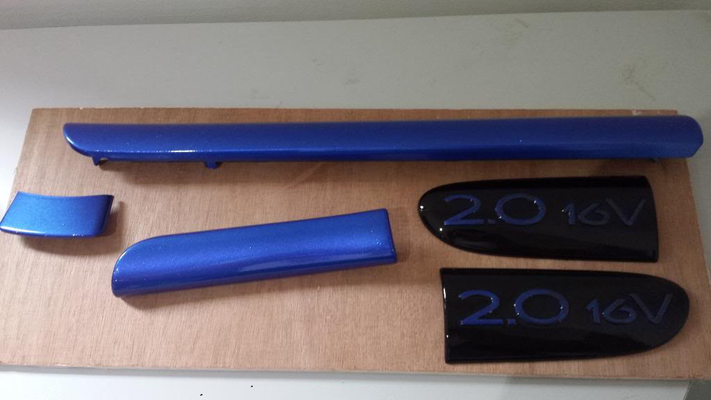

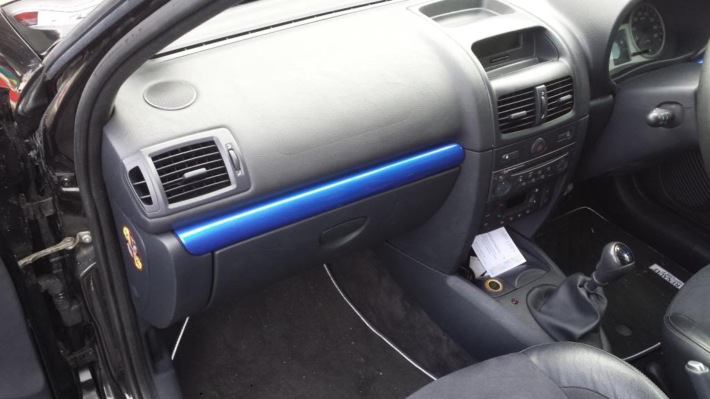

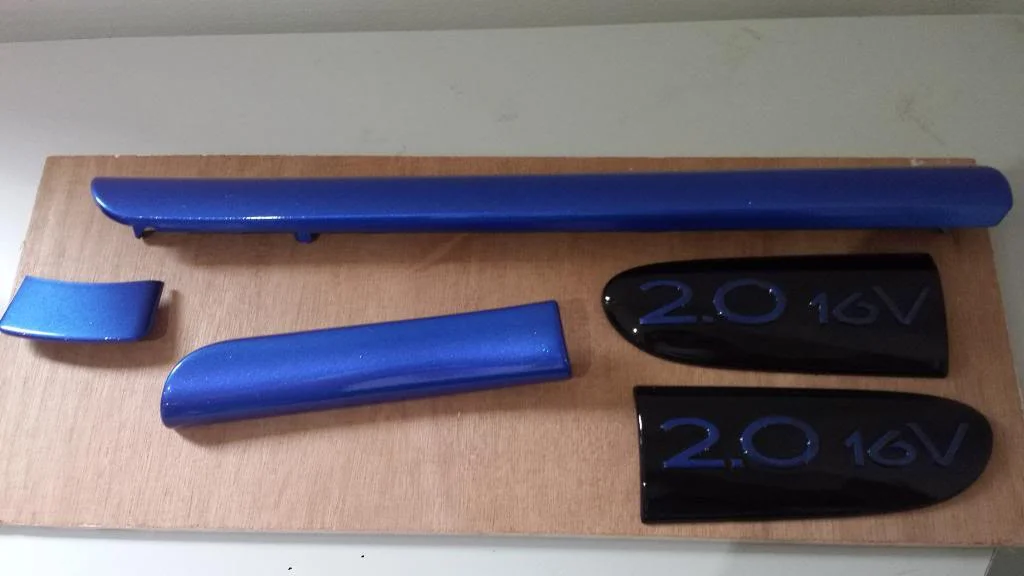

I have just had the above items done.
Steering wheel insert and dash strips done with a silver base coat with blue main coat with blue flake in.

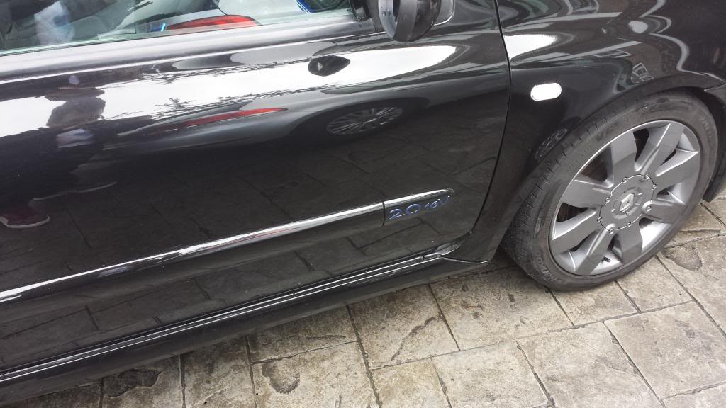

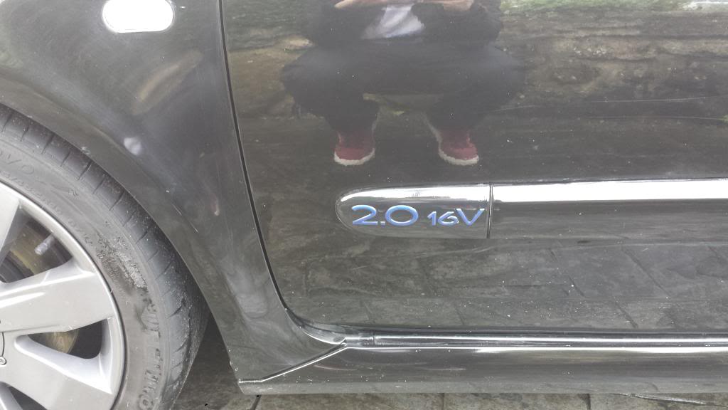

Door bullets done in normal black with hand painted decals.
What are your opinions? Also i can get them done in any colour you like if other people would like some.

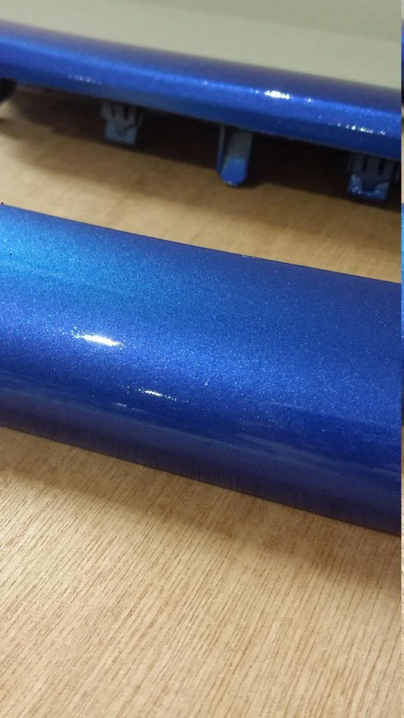

Seems like you didn't sand them very well mate. I like the color, similar to electric blue metallic. Prime 2x sand with 2000 dry, prime 1x sand with 2000 wet, color 2x, sand 2000 wet, color again then clear. At least that's what i would do. Also it looks like you went to heavy with clear.
I didnt do them mate . My girlfriends brother did them. I dont know what he exactly did but i am happy with them. Also When you say it looks like he went to heavy with the clear what do you mean exactly? Lol. Also the side of the dash strips are hidden so i cant really see that. I will try and upload a better picture.
