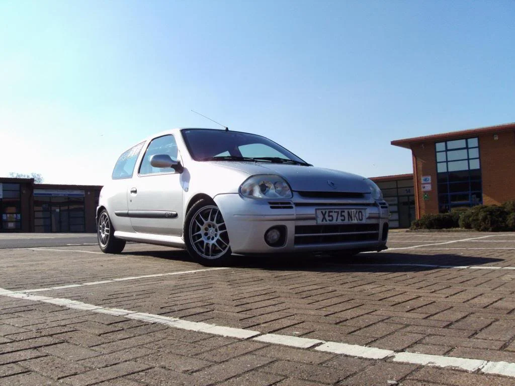

Well, picked this up last weekend for £2000. Completly std Ph1 172.
75k, just had a 'service' generally OK condition yet needs some tlc.

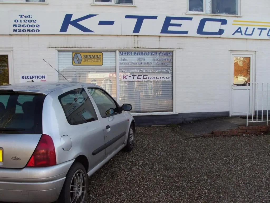

Next day I venture down to Ktec for some coilovers :approve:

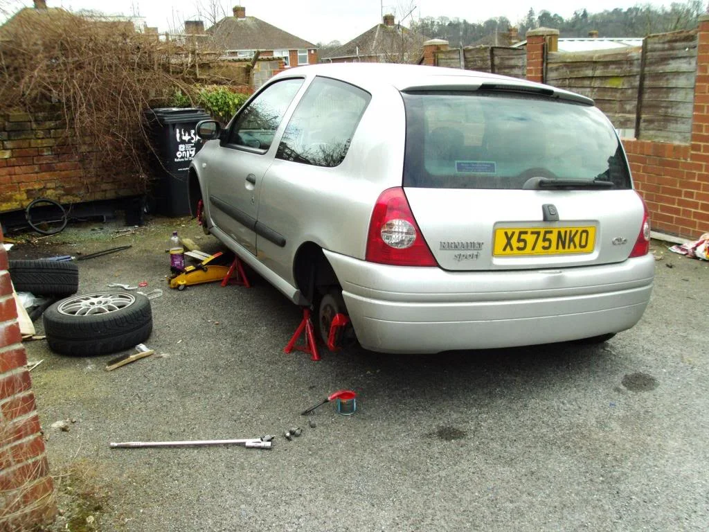

Fitted them last Sunday, taking 3 hours in the process (never done coilovers before and im average with a spanner :sleepy:)

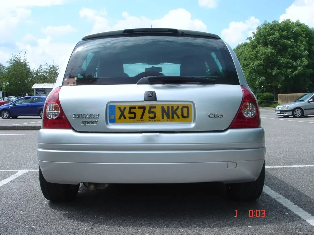

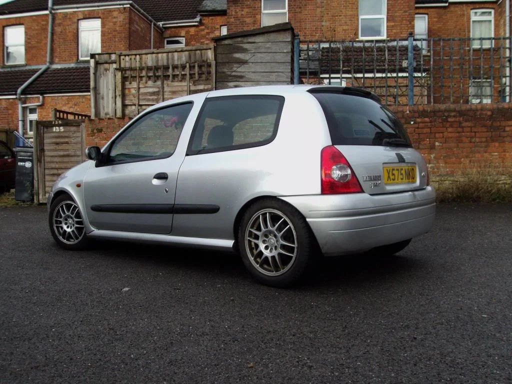

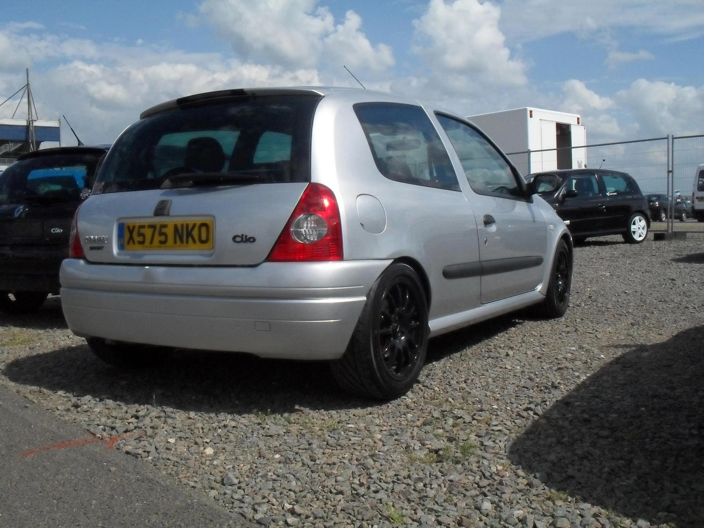

Also, decided to get some ph2 Tail-lights and a Leon Cupra splitter.
Gave the car a quick rinse over aswell.
Heres some pics.
Excuse the minging wheels, they have seen better days! There next in the list for a refurb ;)
Thats all for now folks.
Swheeet :)

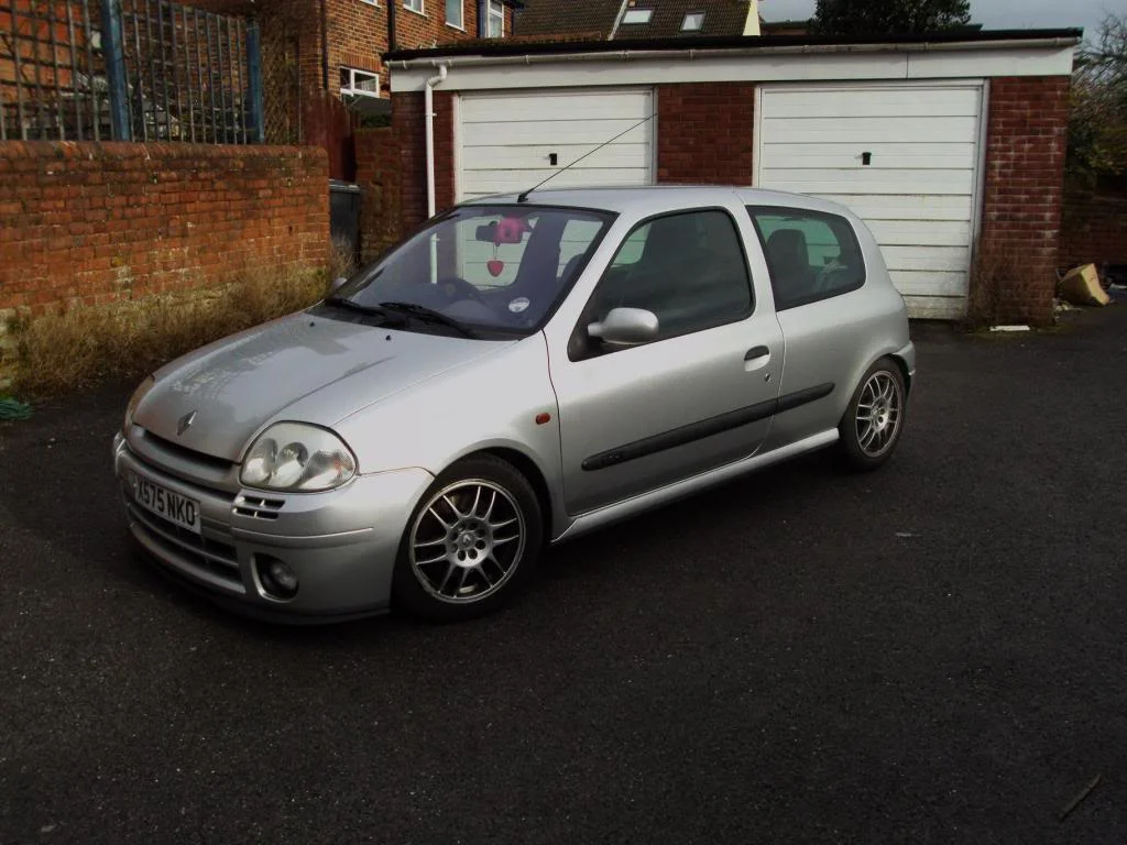

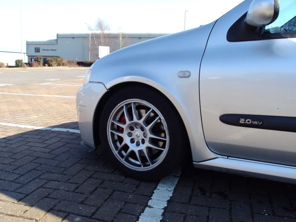

If the wheels have been badly kerbed they might be buckled. Takes nothing to buckle them.
Decided to have a busy weekend on the 172...

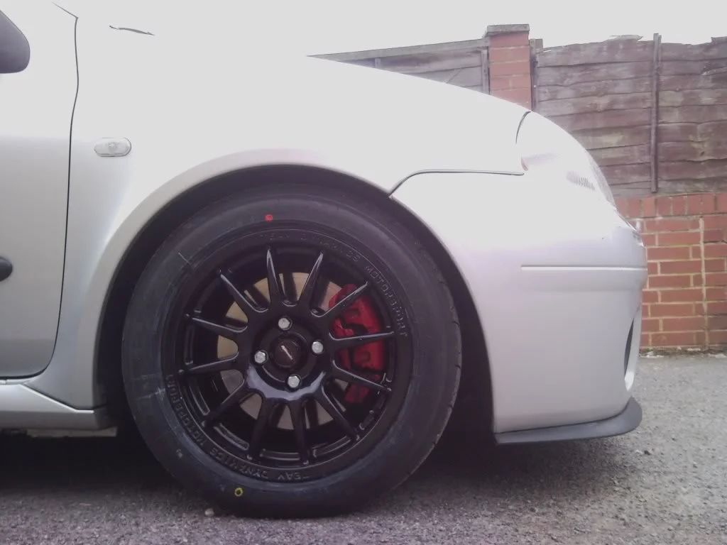

Got bored so decided to paint the brake calipers :S little freshen up was the general idea...
Also bought some clear side repeaters from Renault :approve:
Results of the caliper and repeater combo...

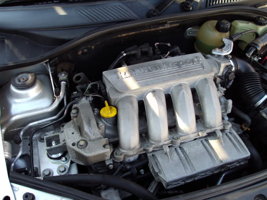

Went to Ktec on Thursday and picked up a new std gearbox mount and uprated engine mount.
Also carried out a Full service using Renault parts inc oil (I can get 20% off at Renault) and carried out CAF modifications.
The lack of engine cover is down to the fact I couldnt be arsed to re-fit it at the time :rasp:

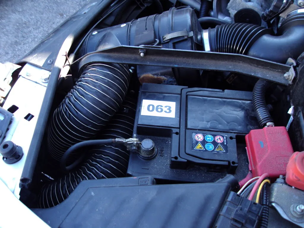

Routed one of the hoses to the original place and removed the passenger foglight and mounted the other hose to the original surround (had to modify the surround) Fits well and have a nice induction roar.

looks sweet!!! how doid you mod the fog light been thinking of doing this for a while now!! how much was the ducting and what size did you get?
This is the exact ducting I got.
http://cgi.ebay.co.uk/ws/eBayISAPI.dll?ViewItem&item=270495872395
Good tough stuff.
In terms of the foglight, Removed the actually light and glass from the inner surround. I then smoothed the surround on a sanding disc machine to allow the ducting to fit over. chucked a jubilee clip around it, then screwed it back into place. :approve: Really easy to do.
looks nice.. can i ask how easy is it to change the engine mount, whats needed ? thanks
The engine mount takes a matter of 5 minutes mate.
Sorry I cant remember the exact socket size's I used, But its just a case of getting a jack under the engine (use some wood to prevent damaging the sump) Jack it up to allow clearance to get the old mount off. Secure the new mount in place and drop down again. make sure everything is tightened up...job done!

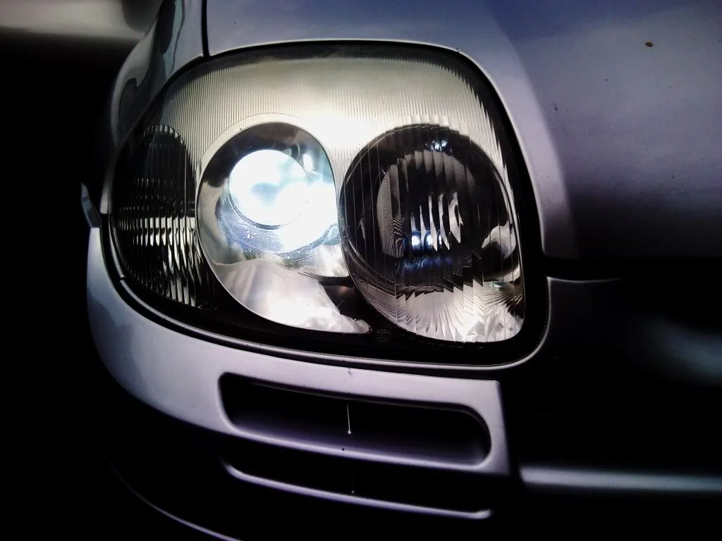

More subtle mods include silvervisions and HID's meanwhile...

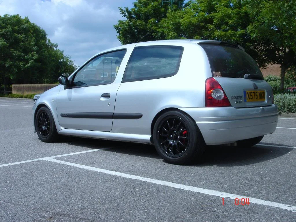

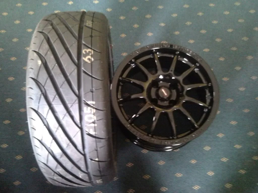

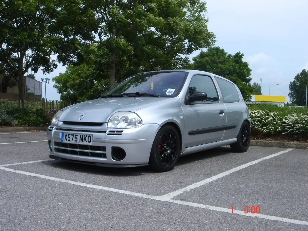

Next up was wheels, I really couldnt stand the standard bent OZ's anymore so jumped on the TD 1.2 wagon, fitting my Parada Spec 2's also.
Pedo-Bear
Sorry for the phone pics gents, a camera is on the shopping list :boring:

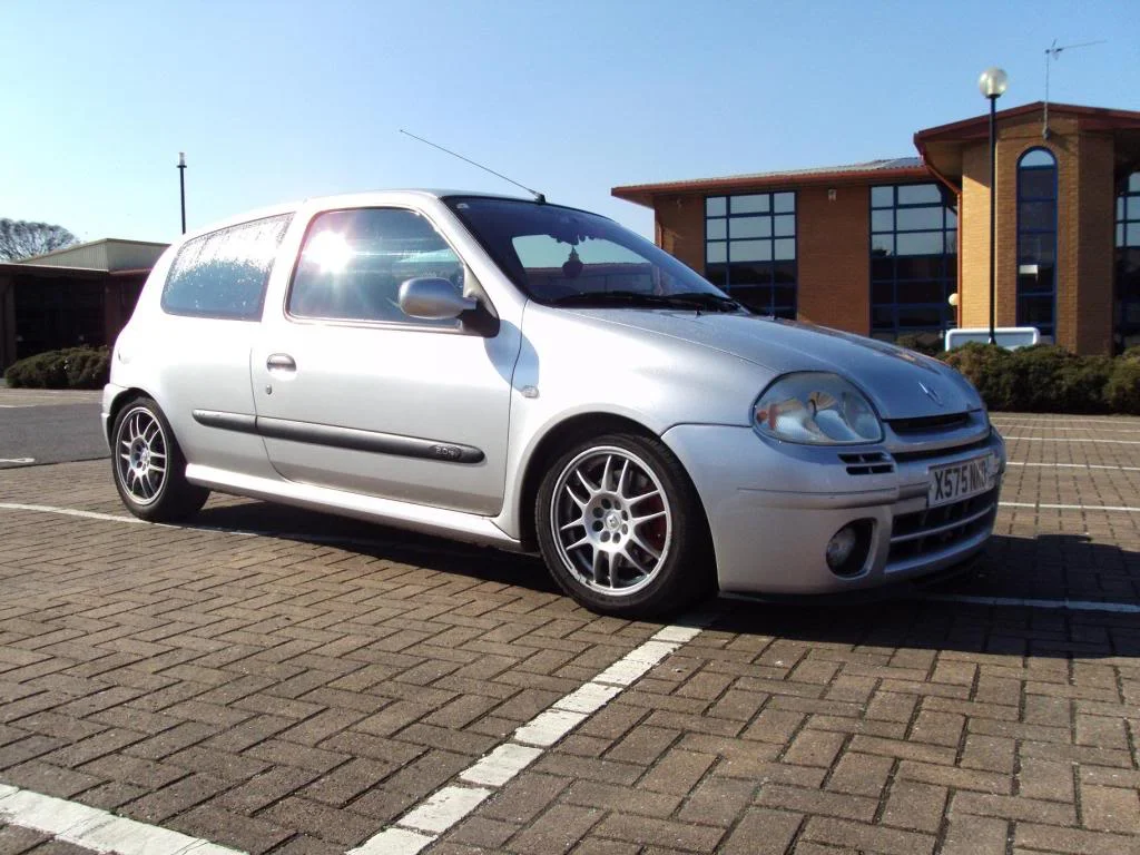

Shortened Aerial
Bosch Aerotwin Blades
Gloss Black mirror caps.
Better pictures.... :rasp:

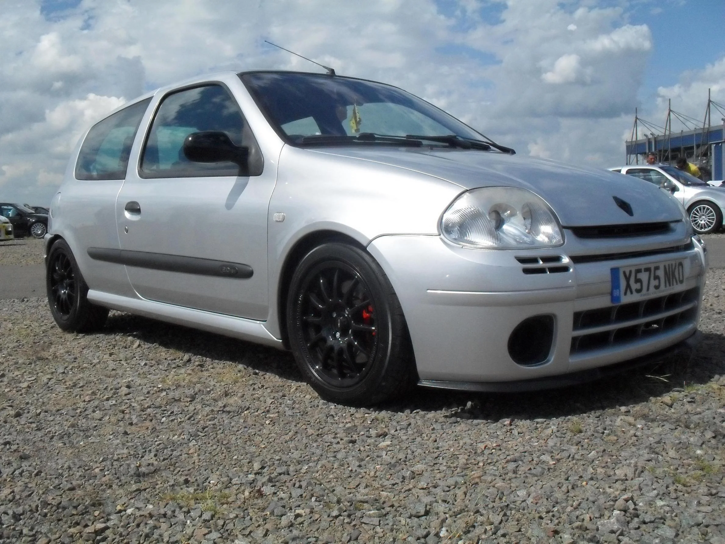

Ok, Havent done much since FCS really, heres a couple more pics of the new additions.
Front and Rear badges have been done black - the original RENAULT badge is being kept in silver.

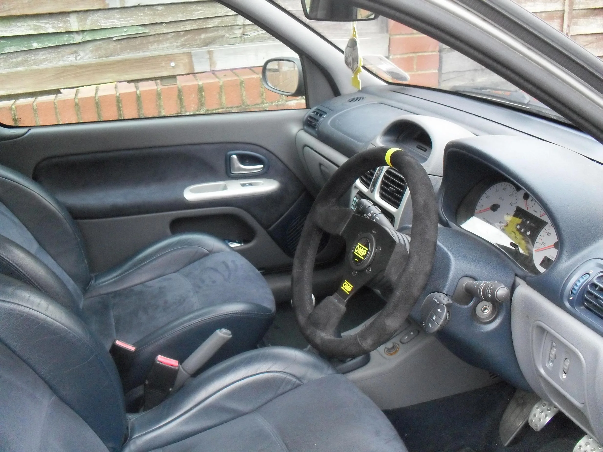

Also bought a New OMP Targa steering wheel :) and gave the car a Full service (I do services every 4k because im anal)

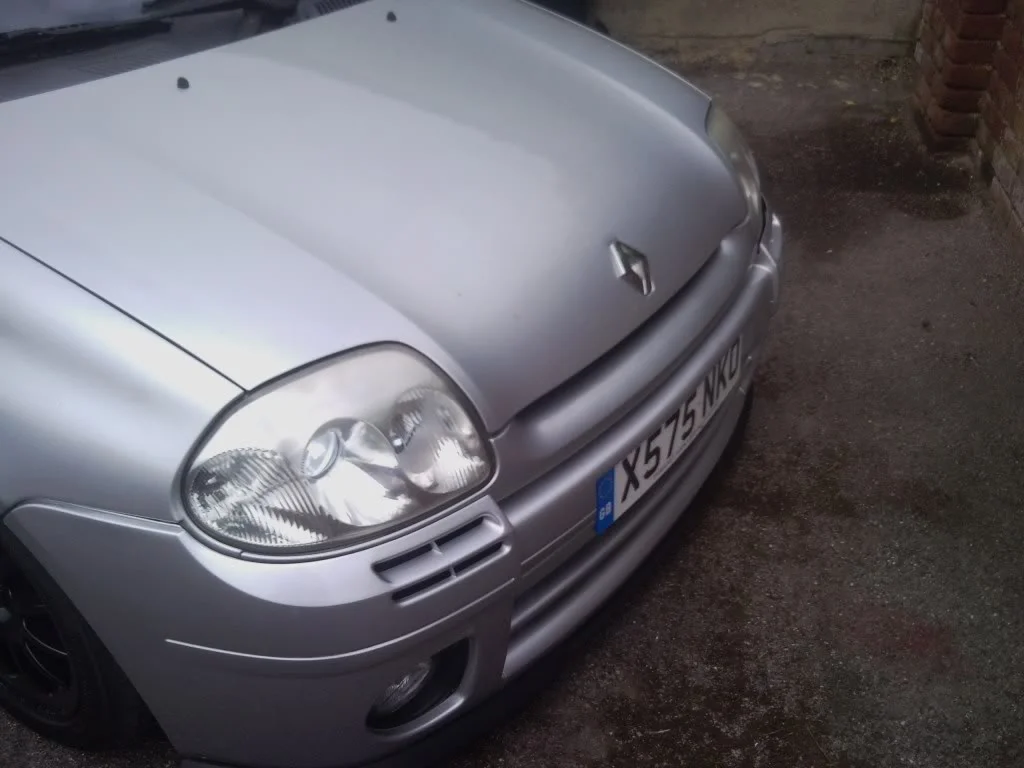

Decided to sand back the front headlights as they were getting abit manky.
