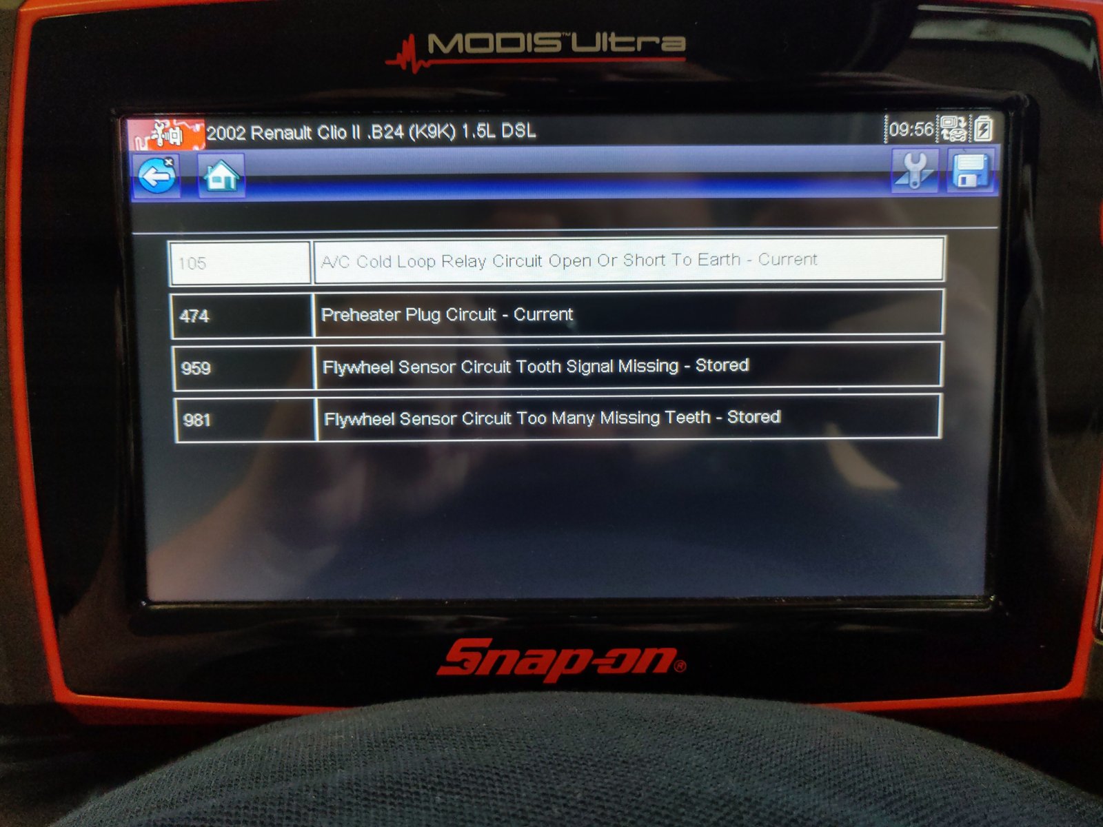

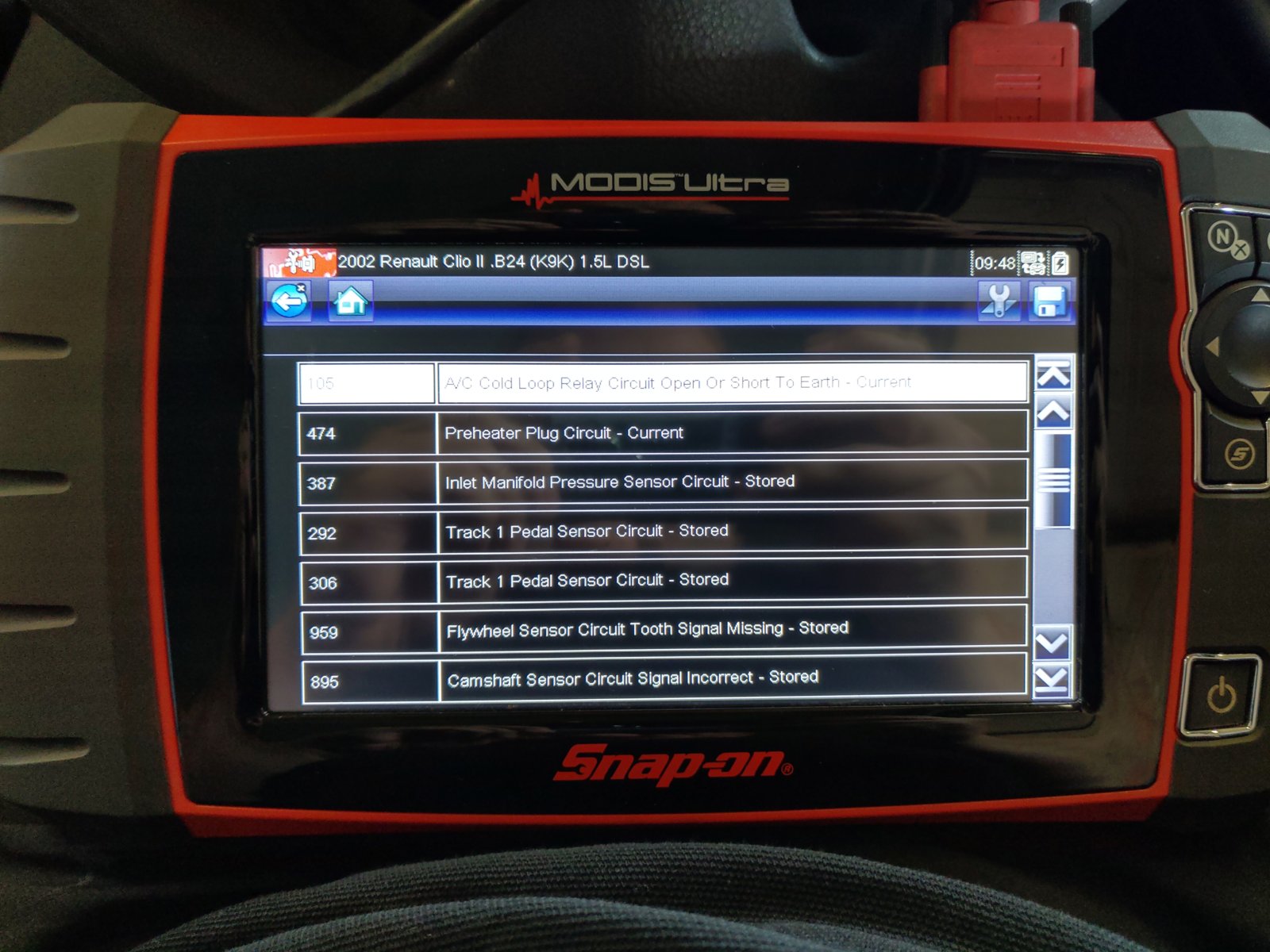

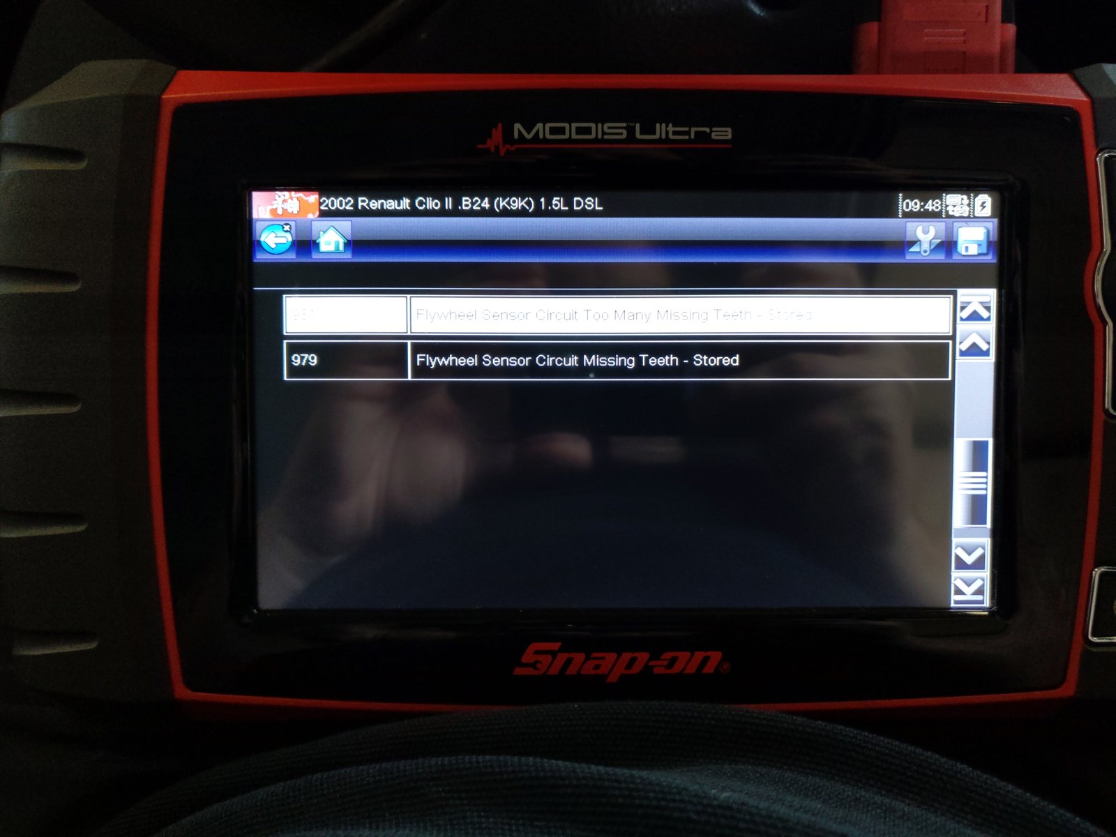

Plugged it in and was met with these...
Cleared the codes, re started and cycled the fault a few times
Will change the tdc sensor this afternoon and see if we have a cure! Odd as usually they don't like to start when it fails.
