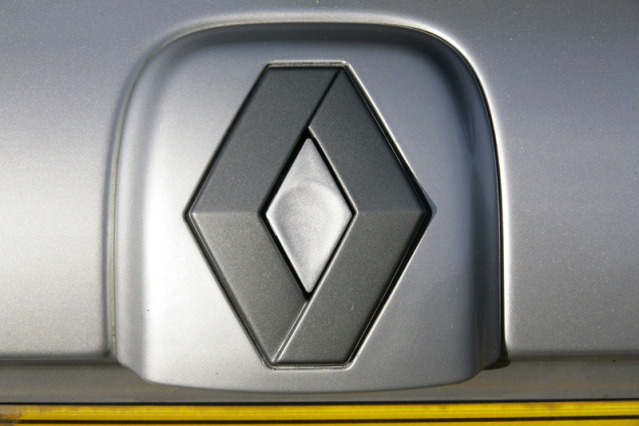

In that case i'd suggest buying another 'Renault' badge and spraying that.
For the rear diamond you have to removed the whole thing as the diamond's bonded on.
Open the boot unscrew the plastic cover, then undo the 3 bolts holding it on and it just pulls off.
  Inferno 225 cup
Open boot, take plastic off romove three nuts, A little bit of tugging and wiggling then wallah :)

No you have to remove that separately but it's a piece of piss,
unplug a connector or two, couple of bolts to undo and that's it.
The hardest bit is holding the button down to slide the mechanism out.

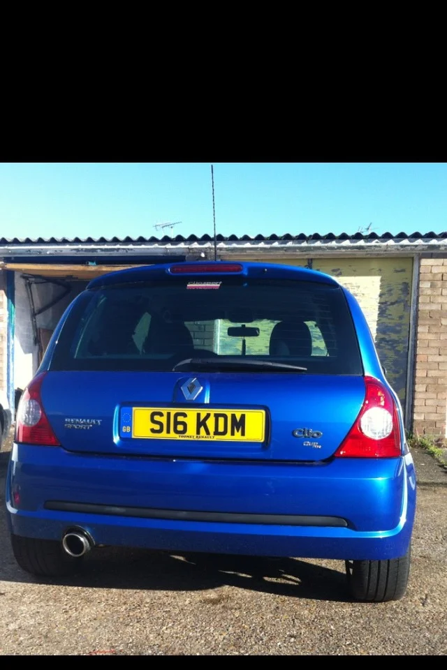

I am tempted. I will leave it blank for now. Your cup looks great in that picture
