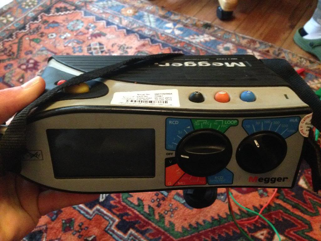

That's exactly what I did. It didn't register anything on the Amps setting using this meter - http://www.ebay.co.uk/itm/Rapitest-D...-/160769621479
So I also borrowed this piece of kit and couldn't get it to register anything that indicated what the amp draw was, I was told by the previous owner the RAC tested it at 0.4AMPs. If I got a reading anywhere near that I would be happy so I could start pulling fuses to chase the problem.
  Clio 182 FF
I have tried.... It read the voltage that's ok. It reads 3.62 on the ohms setting. On the Amp setting it reads nothing. Must of tried it half a dozen times now.
  Clio 182 FF
Yes somethings definitely not right, but if i cant get a proper reading from a testing meter i can't go any further with it.
JamesBryan
Ahh right, well i don't know too much about house electrics but it has an RCD setting.
RCD being Residual-Current Device and Amps is a current, so i'd go with that.
Not sure what the symbols are on the RCD mode, but the bottom one... RCD auto test might work.
