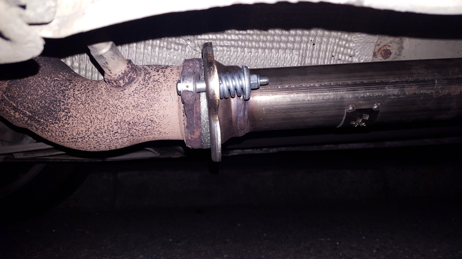

Today I had my Ktec decat + new gasket thingy from Ktec fitted. Aswell as getting my new brembo discs and pads from George fitted :up:
after driving 40 odd miles lightly bedding the brakes in I notic3d the exhaust was rattling/blowing on deceleration and downshifting. so after i pulled up to have a look but does this look correctly fitted to you guys ?
MRBILLYUK
  FF Jeden Osiem Dwa
Looks fine to me . It does look ever so slightly out of line , but that'll be determined by how your exhaust sits on the hangers in the middle and rear of your exhaust . How is the exhaust clamp between the centre section and the other end of the De cat ? Personally I think the whole design is a bit crap. The cups that sit inisde the manifold will eventually rust through anyway and it'll rattle 12/18 months down the line ,lots of people have problems with both ends blowing and rattling.
On the standard cat the gap on the manifold gasket is equal in that picture the decat looks high, is it a straight pipe?
