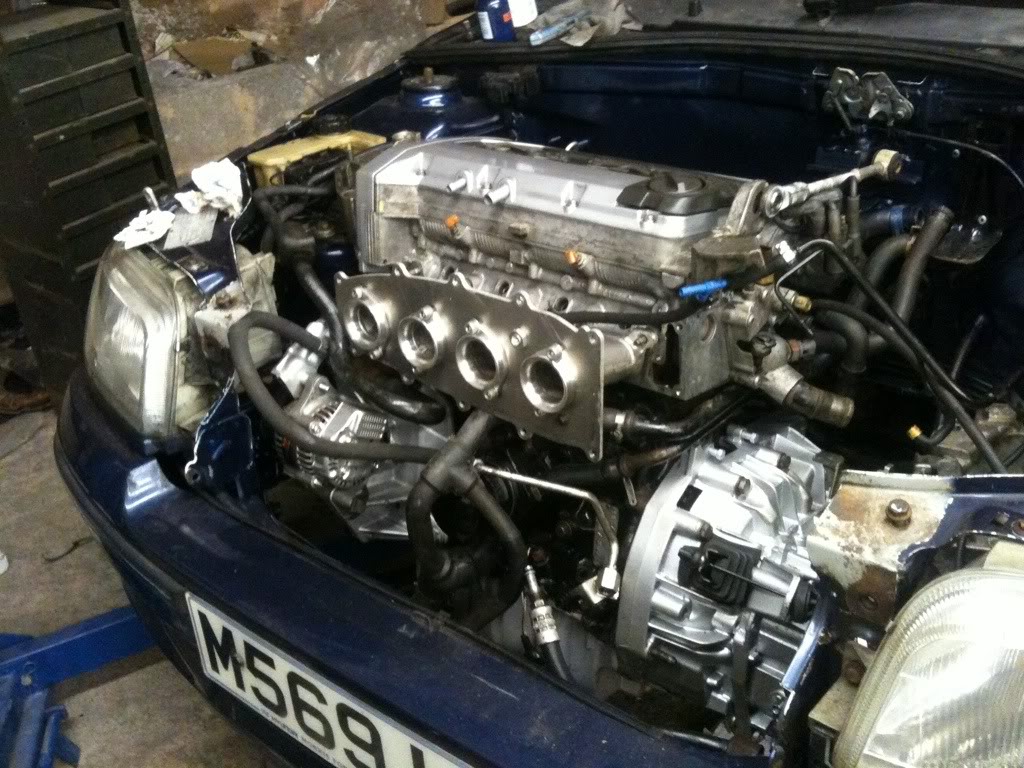

You could try an inlet like the one I have made for the temporary engine Ive just put in my Mk1 project (will be a honda lump but for now is just a cammed williams one)

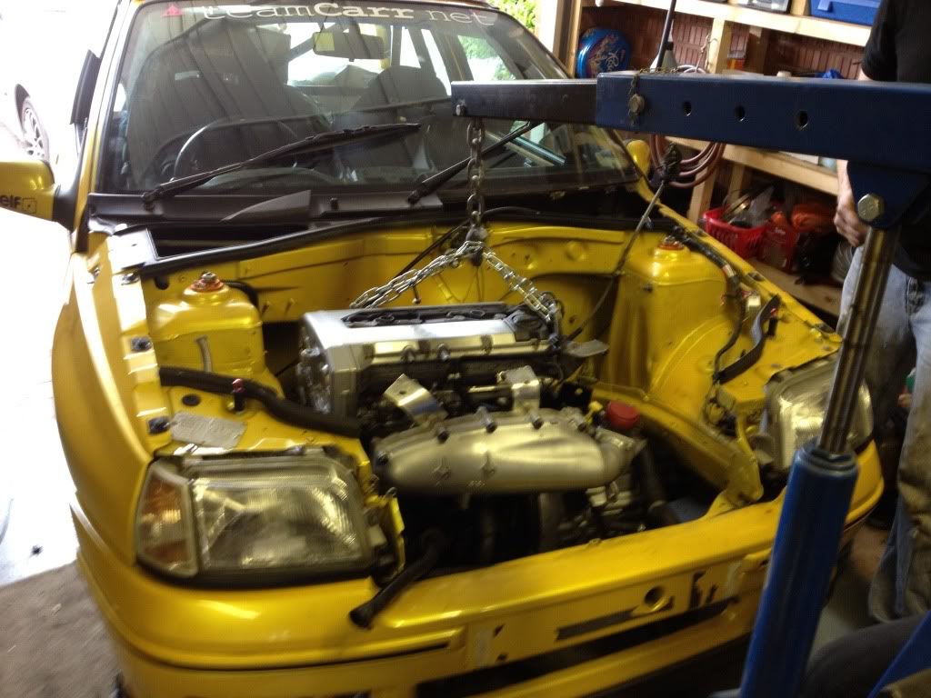

Looks good is that off a gtir ? I have one in the pipeline for my car just now will add a picture if my works computer allows me as I a stuck here for another 6 days.
That looks excellent did you make both parts? I take it you will be running a smaller radiator with that.
I cant still run the fullsize rad and it will clear, but im using a polo one that I had from when it was on bodies previously anyway.
Its a pulsar plenum, an ITB manifold, and then an adaptor plate I made and a spacer that a friend got made, and then I added 4 trumpets to smooth the flow.
