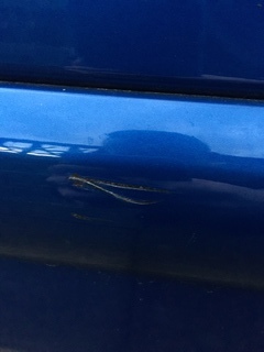

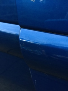

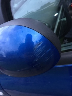

It appears that one of the previous owners may have had some difficulty with scraping the left hand side of the car as there are some quite deep scratches on the left hand side door trim and the wing mirror cover.
So to get to the point - I'm seeking out some advice on the best, and preferably cheapest, method to take to removing these scratches (pictures below) whether it be buying undamaged trims and spraying them to colour match OR the filling and sanding method. Hopefully one of you guys can provide a guide too as you've probably guessed I'm pretty novice.

I was going to do my scratched mirror caps this weekend. I'm going to use filler, sand them, prime, spray with paint code colour match cans and then lacquer them. I got everything from st helens autopaint who will do the paint matched cans.

Just buy replacement primed mirror caps and get them painted :up:
