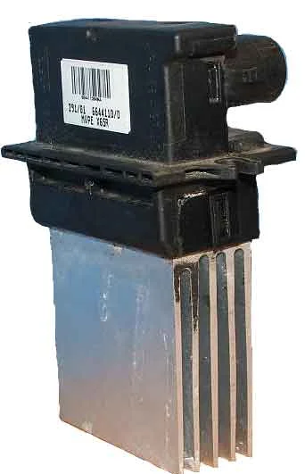

Nah Adam it isnt that i need, its the actual resistor it looks like this, and Ian i cant actually take it off its on so tight loool i dunno if im trying to pull it off wrong though! This is what it looks like though!

The resistor when you take it out looks like the picture.
To get the plug off the resisitor, you have to push the locking pins either side inwards. On my car, the right hand one that was difficult to get to was already broken. They are quite stiff. Then to remove the resistor pack itself, you need an m7 (may have been m6 or m8!) socket as the self tap screw has a hex head. The right hand on can be a mare to get to. Then it just lifts out.
