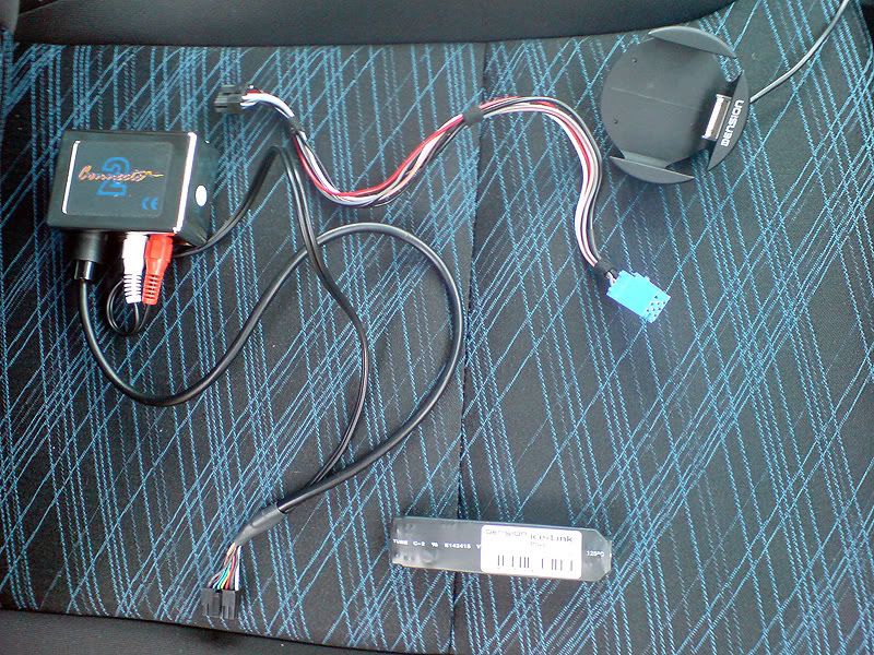

I got hold of what I thought was a Dension iPod link for my Clio 3. The Cradle and the black plastic covered circuit board have Dension written on them. The silver box is obviously Connects 2 though?? I've plugged it all together and into the cd changer slot in the back of the stereo. Put the ipod in and it began charging and saying "OK to disconnect".
Pressed Source on the radio and the display said "CD 6" - nothing happened and then after about 5 seconds the display on the car dash said "Link Error" or "Link Innactive"
Any ideas whats wrong? For you that have these have i been sent the wrong stuff?

The bits for my 182 where all Dension, not sure why you have a mix of that and the Connects 2 stuff ?
The 182 set up has 3 parts - the cradle/dock wire which plugs into the black heat shrinked part at one end, the other cable with the changer port connection them plugs into the other end of the heat shrinked circuit board and into the h/unit.

Thanks Rich, it looks like i've been sent a miss-match of parts! Ill contact the seller again.
  Renaultsport 220T
The connects 2 box is what I have Jon. It was supplied from Dension like that. Odd I know. It should just plug and play though.

Turns out its the older setup Steve and Dension changed it for the 2005 onwards I think. Ill either sell this one or get it changed hopefully.
