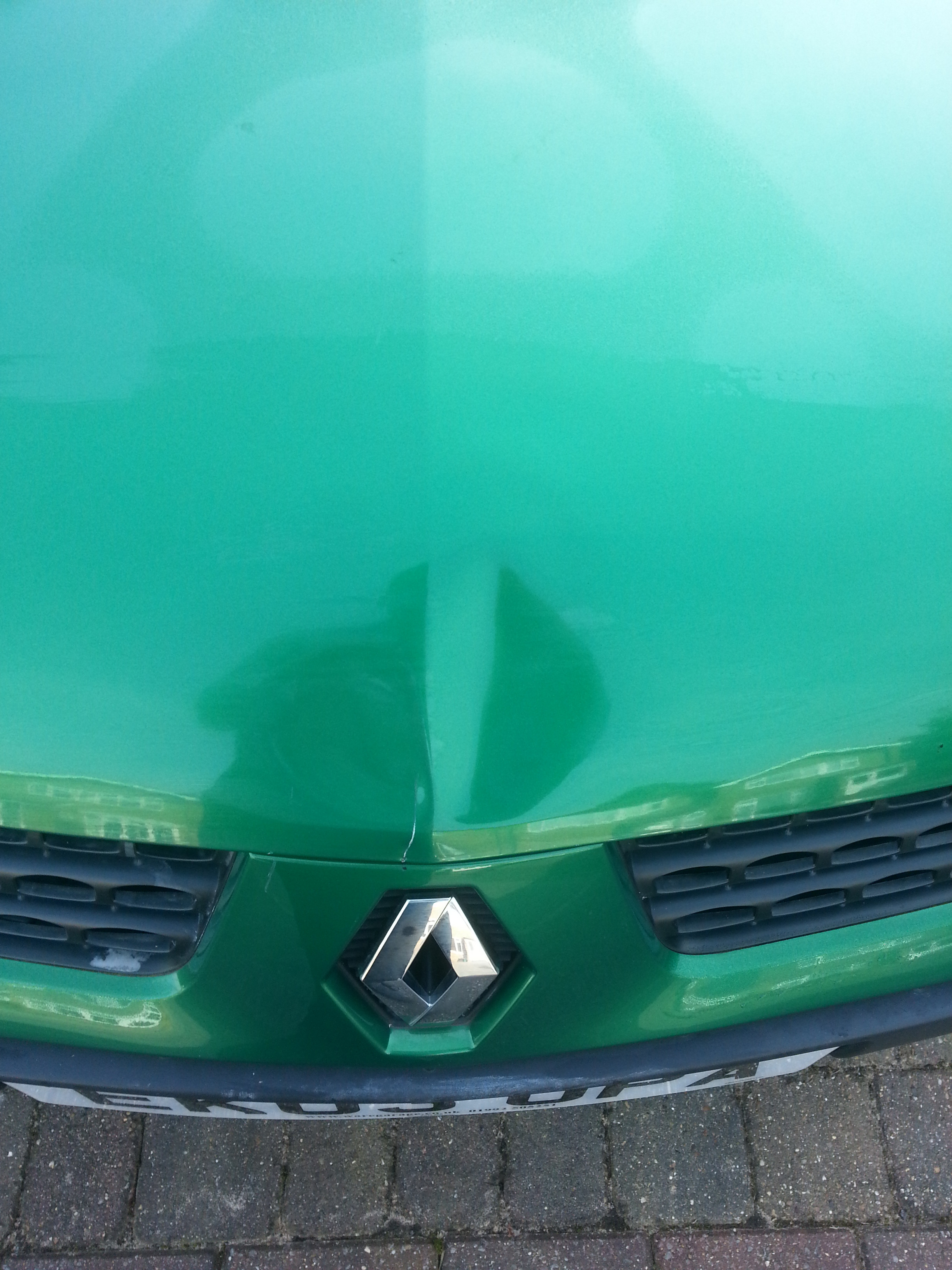

So I got a nice big juicy dent on my bonnet, courtesy of mr cyclist deciding he wants to cross the road right infront of me in the rain.
Any ideas on how to remove it? With the bonnet being double skinned, can't really get any tools of any significance in from the bottom to push it out that way....unless there's another way to get in?
Contrary, are there any tiny little sucker things that could be used to pull it out? Couldn't use the large ones that I have as they couldn't get a good enough seal around the edges to stick to the bonnet.
Picture attached

there are small suction cup dent pullers available although they seem pretty elusive in my country, ive seen hectic dents removed by them bt i dont seem to be able to get it right, the usual way is to weld a rod or a few rods in ur case on top of the dent and use a slide hammer to pull the dent out... obviously that would mean a respray of that area if not the whole bonet...

That's not a smart repair that... it's a fill and respray job.

Could get lucky and find a replacement bonnet in that colour.
For gods sake don't fill that dent.

Without wanting to state the obvious . Have you rung any PDR guys in your area ? It'll only cost a few mins of your time and they'll tell you roughly over the phone if it's possible to remove or not .

any half decent pdr guy will get that out no problem.
hmmm interesting....all of the guys I saw said that it would have to be a respray jobbie. I'll have a look a bit further afield I think, get some more quotes from others

did you go to bodyshops though? chances are most of them will say that to get the work from you.
