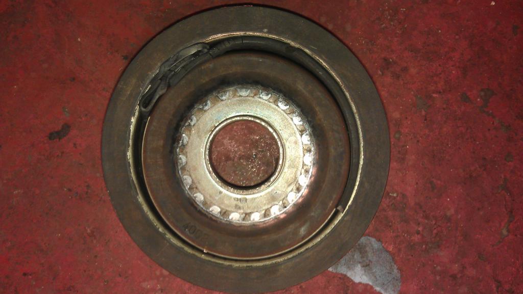

  dan's cast offs.
this made some odd noises to say the least...
