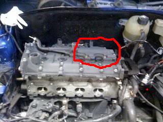

I had the Inlet Phelum off the car a few weeks ago and I noticed that instead of oil being forced up through the cam cover bolts that oil seemed to be leaking from this box unit that was bolted to the top.
I went to Renault today to see if I could source a new gasket and after a few funny moments and random hand gestures he showed me his screen and I pointed at the unit.
Depollution Unit? - god knows what it is/does, but he wanted £78 for a new gasket!!!
Well after I momentary relapse I walked off in amazement.
So can I source one elsewhere as that is a biblical amount of money to pay for a gasket.
Cheers
Al
Well I couldn't find a really clear picture on google images, but its the thing circled in red.
yeah the gasket is over £70
most of the cars left the factory without them, just use silicone, everyone else does!
thats the oil strainer/breather plate for future referecne
Well I called it a breather unit when I went in there but he called it a depollution unit.
So I can unbolt it and use some sillicone to reseal it?
Mine looked like it was leaking from there turned out to be rocker cover gasket loosen up the rocker bolts one by one and put some under the head of the bolt as well
