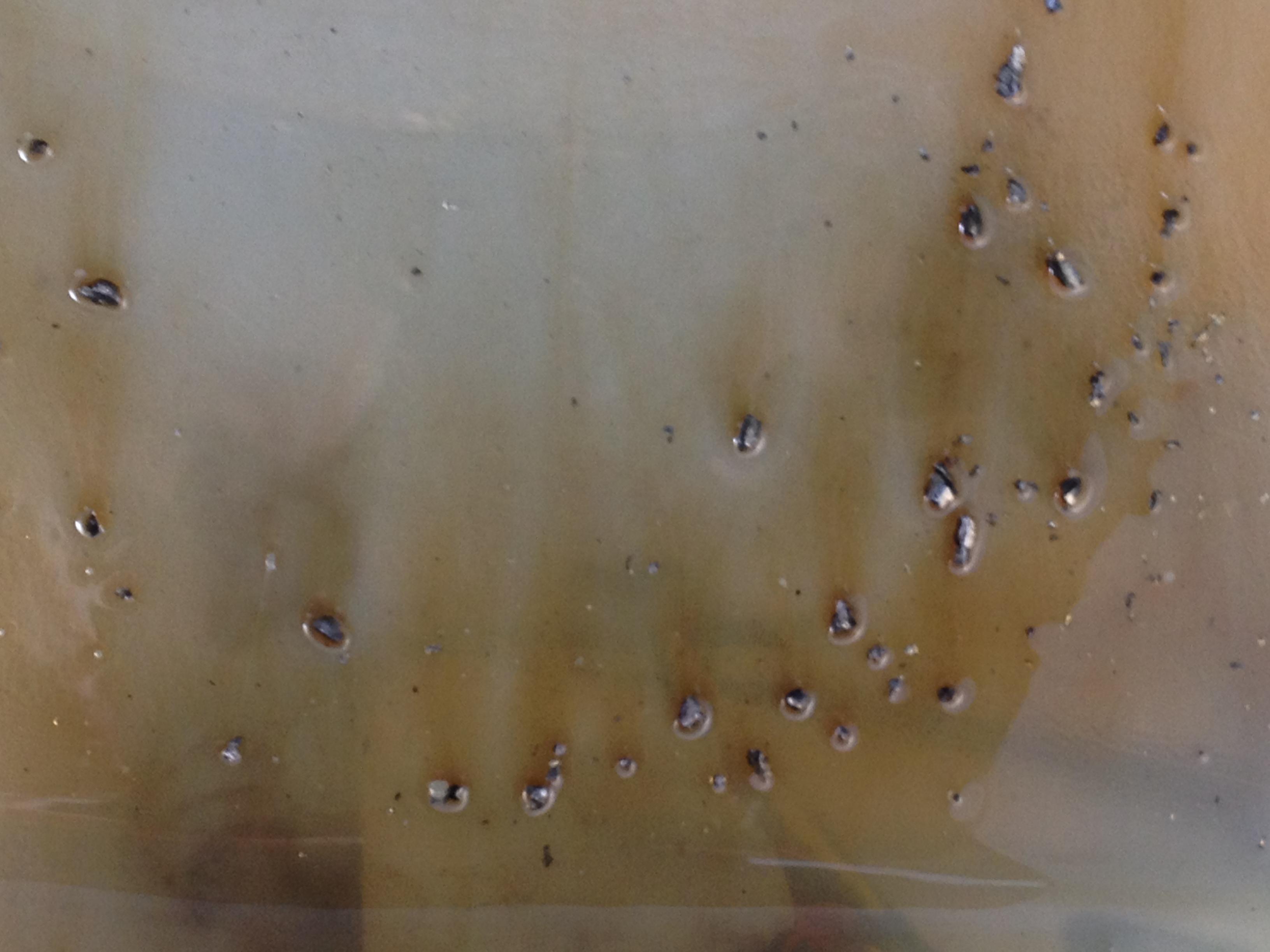

Lots of metal in the drained gerabox oil, see pic below .... second hand box fitted this weekend and seems good :)
