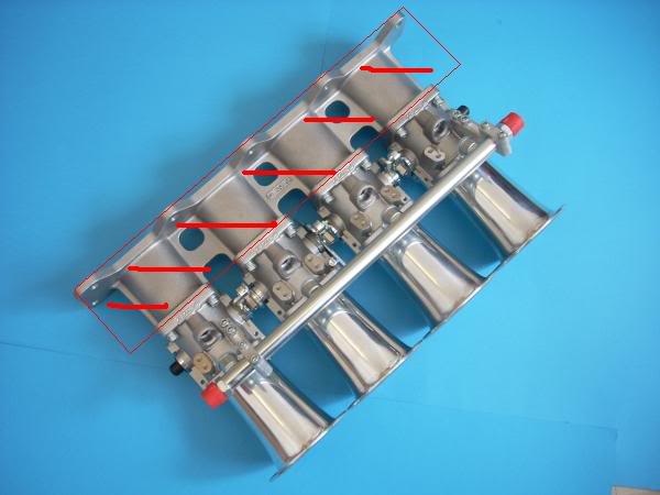

the AT units are 'direct to head' and so bolt straight onto the clio engine without the need for an additional manifold
the Jenveys need a manifold on the back of them which is specific to the vehicle

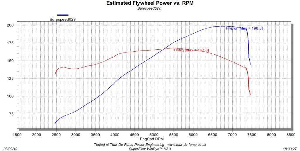

on both standard engines, my jenveys made 194 bhp and Burp/Tony's AT's made 198 and both made just shy of 170 lb/ft
however it is more about the delivery of power and im afraid thats where my knowledge of RR graphs runs out

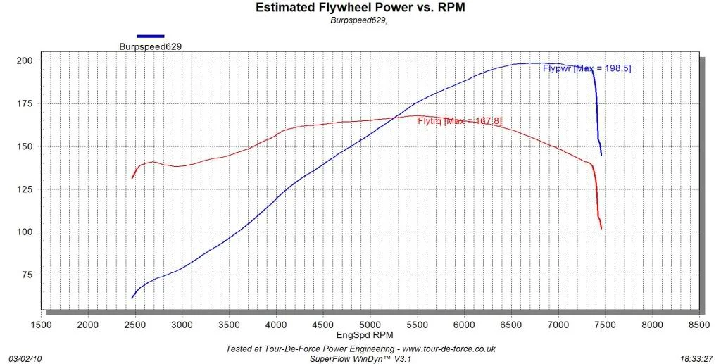

Heres the graph for our AT Power car.....
It has 100mm extensions and a carbon airbox. And only on 95RON fuel

Would be nice to see a graph with a Jenvey car and AT car overlayed to copmaire.
Fred has apoint as the AT's sit so close to the engine space is tight. Needs a bit of fidling with and we binned the stock cable. The Jevenys have acres of space to fit linkages
We are very pleased with our tourqe curve tho. On a set of bodys that people were sceptical about

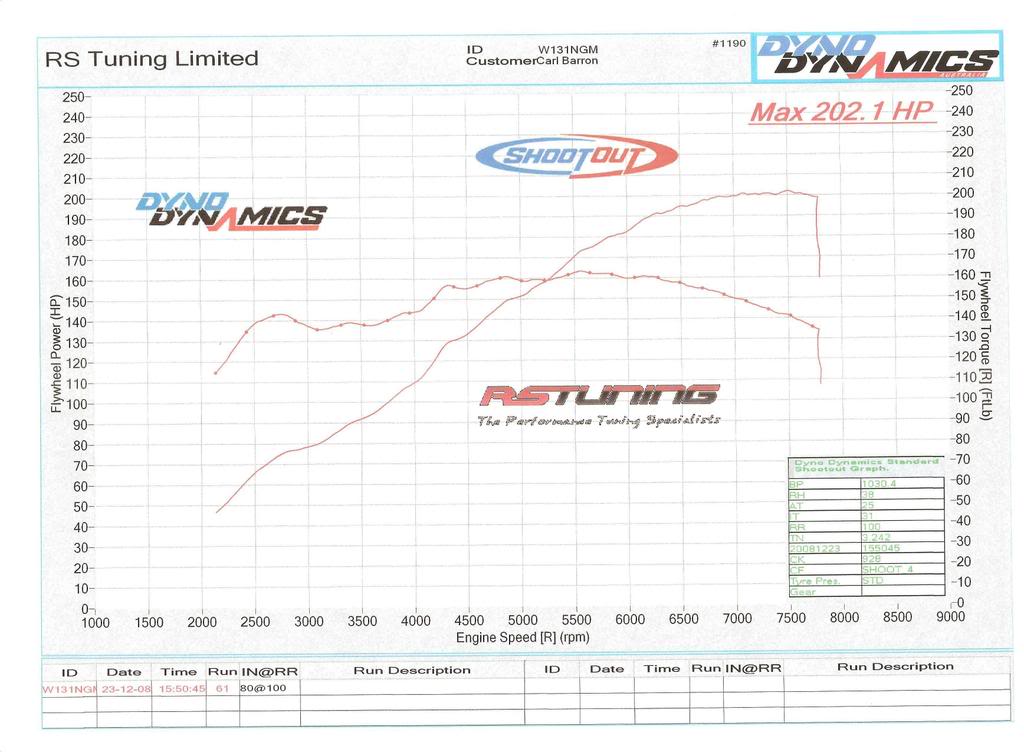

Since I was really curious about difference on dyno graphs I did this:
I hope everyone realise that these were different cars and different RR. But it's obvious that Jenvey should give you power higher (above stock redline) and AT looks much better for street (torque at low and medium revs). Difference could also came from better maping on AT setup. So I'd say that these two kits are almost identical.
