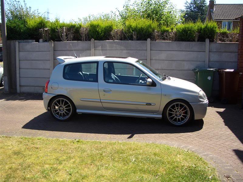

vinny how come your phase 1 172 has the aerial at the back? stoddies is at the front on his ph1
