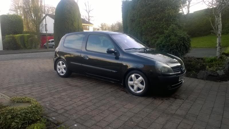

Dropping my clio 60mm on springs do I need to change my dampers if so what's the cheapest and best options (mk2 ph2 dci)
Fletch
  Derv 65, MPG > BHP
I dropped my ph2 dci down 40mm but it ended up looking more like 50-55 ish, and the ride is diabolical. I haven't changed the shocks and the springs are Apex, so I've kinda pissed on my own pudding there. My point being if you've got the cash for aftermarket shocks then personally I'd recommend going for my option of saving for a good set of coilovers. That was what pretty much everybody recommended to me, but I got impatient and skint so went for springs off a 172... :/
Anyway that's just me, if there's a full set of shortened shocks that's significantly cheaper than coils, I'm interested to find it myself.

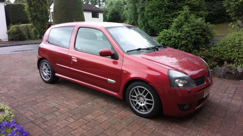

172cup shocks and eibach springs with 15" OZ F1s

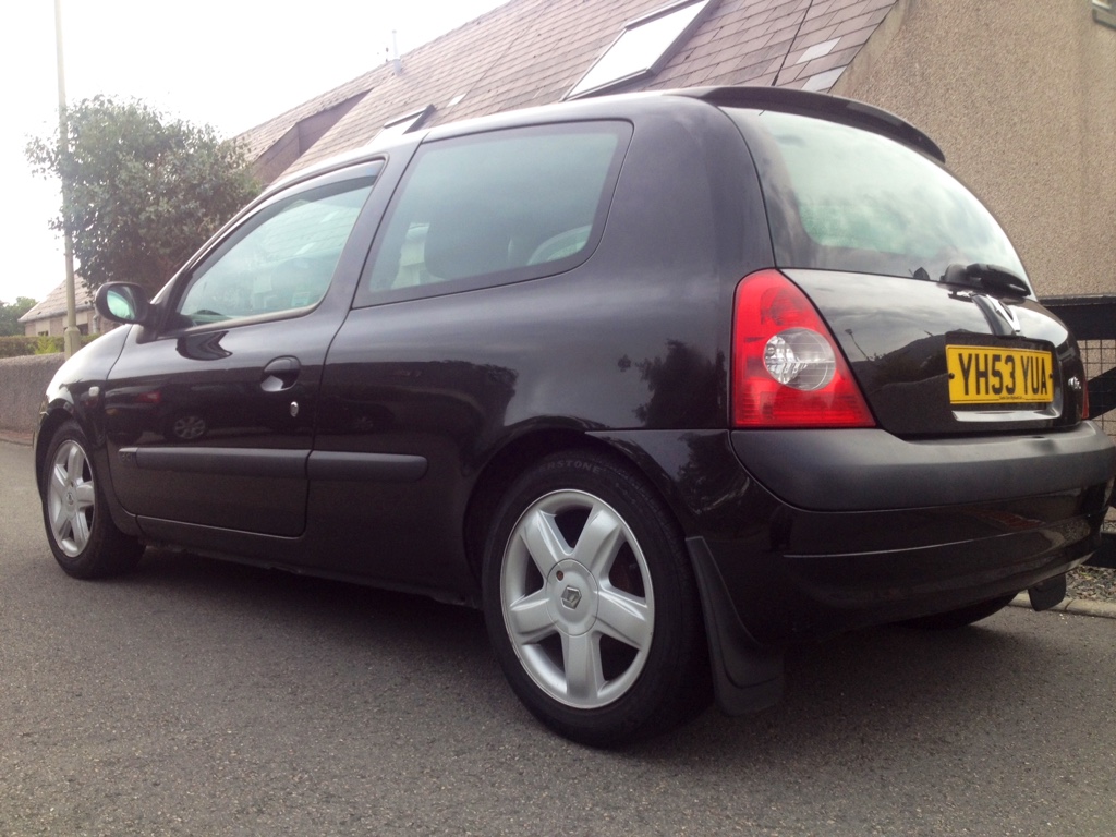

I need to know what the best spring/shock combo would be, looking for a drop of about 40mm so most springs do this, don't want coilovers as they make a very uncomfortable ride, I live out in the middle of no were so always going down bumpy country roads, I have been thinking about the sportlines. I have a DCi mk2 ph2 with mk3 black alloys on it.
