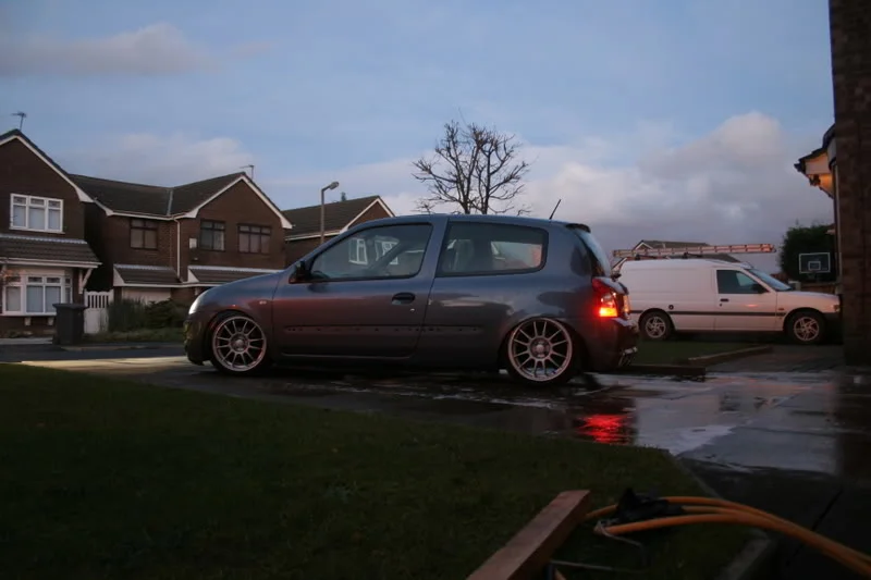

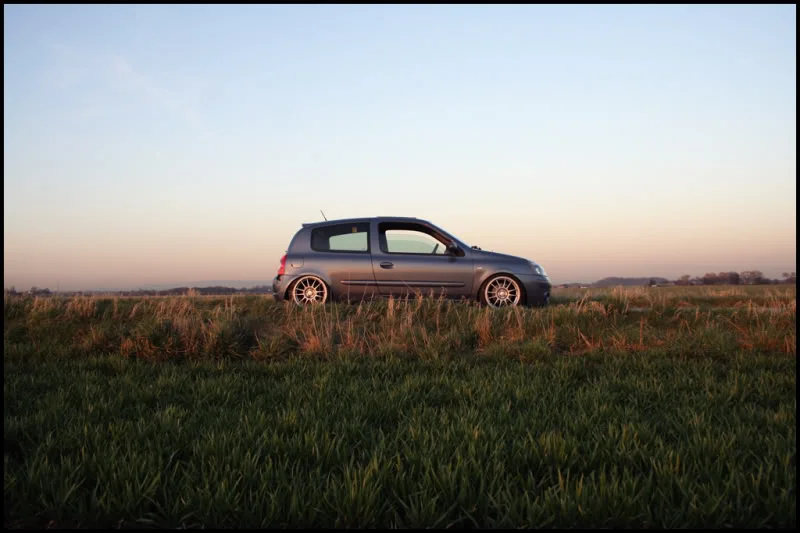

coilovers with custom rear springs, 16' wheels, 45 profile tyres, around 100mm...
some other custom rear springs, rest same as above, more than 100mm...

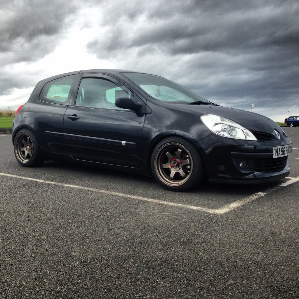

Clio mk3 07 plate 1.2 got apex lowering springs 30mm but compressed another 30mm, ordered Koni sport dampers, anyone know some decent after
Market brakes?
