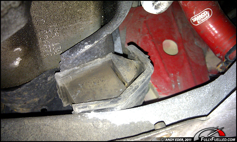

Pic of lower mount I found helpful finding mine.
For the sake of 12 quid for a new febi lower mount it would be daft not to change it while you've got the tools out.

Gearbox has three -
1) Dogbone
2) Upper gearbox (as posted above, http://www.ebay.co.uk/itm/271994627772?_trksid=p2060353.m2749.l2649&ssPageName=STRK:MEBIDX:IT&clk_rvr_id=1020885114894&afsrc=1&rmvSB=true )
3) Front gearbox (looks like this, http://www.ebay.co.uk/itm/Clio-spor...132388?hash=item5b12f5f324:g:ws8AAOSwEK9TvQM1)

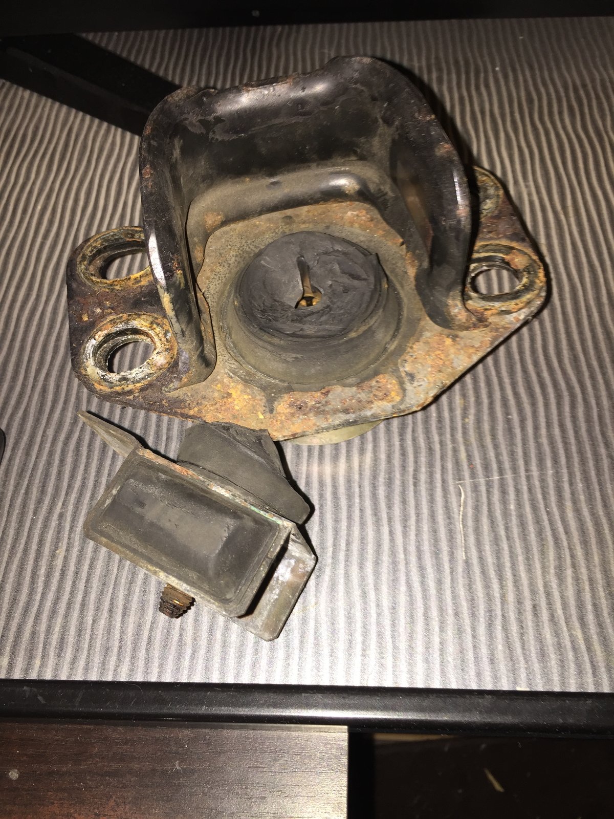

Good call Amos. The drivers side and gearbox one were both broken. all fixed now. just about to go for test drive.
