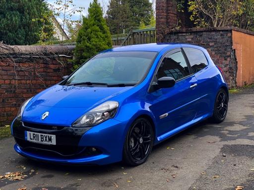

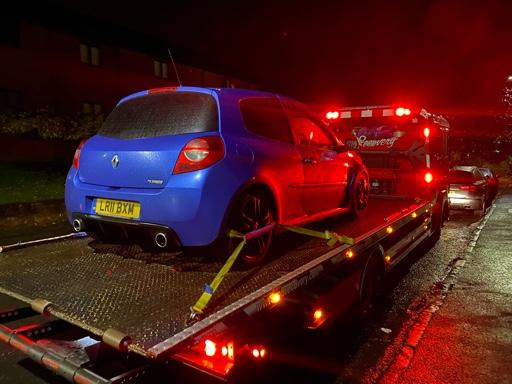

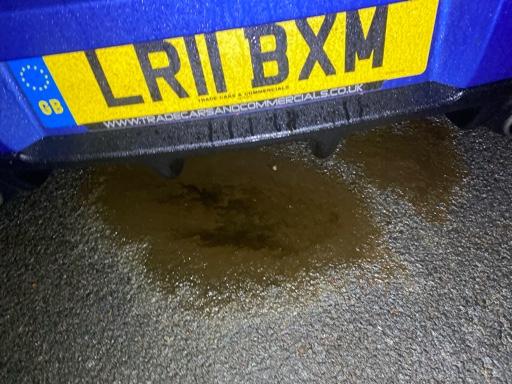

Well tonight my Clio 200 completely gave up. Was on the motorway decided to over take and the engine made a unusual sound next min all sorts of horrible noises smoking everywhere pulled into the hard shoulder. Still smoke belting out the car and low and behold looks like maybe the rod has went through the block no oil and no coolent left in the engine.
Not sure what the hell to do if I should sell as is or meglio or what [emoji30]. Car has got or had 73k on the clock few mods body work is great

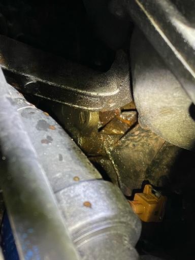

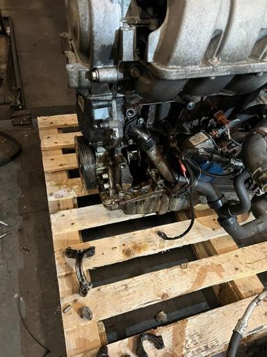

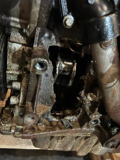

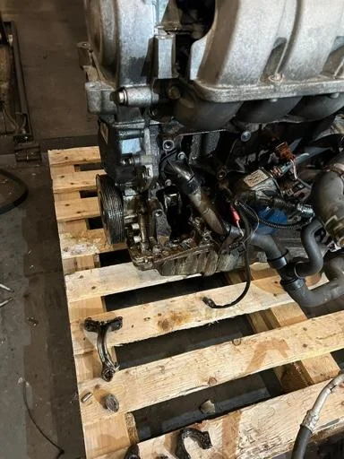

Beaniesport said it’s the worst they have seen!

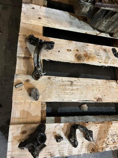

The con rod came right out the engine and was sitting behind the alternator
It dropped a valve which locked the piston solid. At which point, unstoppable force meets immovable object.. and the best is in the under tray

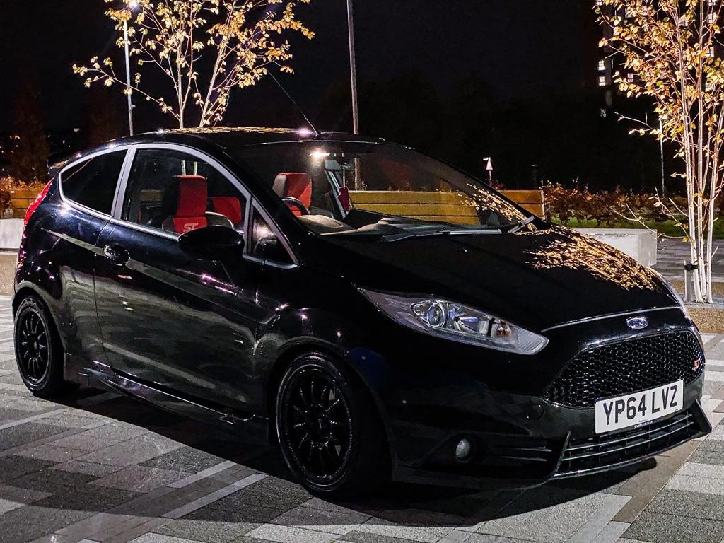

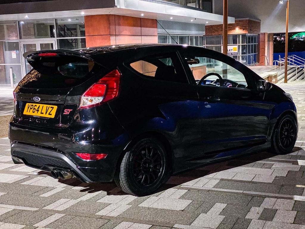

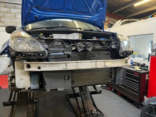

Decided to put another 197/200 lump in it as just bought a stage 2r fiesta st [emoji23][emoji23] so will be for sale guys [emoji102]

Fiesta looks nice, but needs bigger wheels lol
They're a great buy though. Really capable and the engines seem pretty ripe for tuning.
