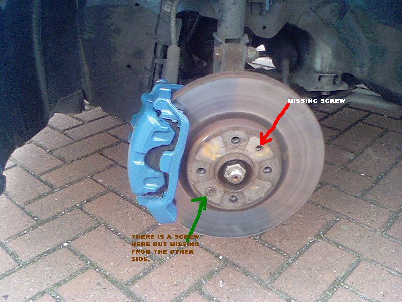

Painted my calipers today and noticed the disc was wobbly then noticed i am missing a screw from the fixings see pic, does anyone know where i can get one from pretty quick as i have been driving the car for three months like this, so i know its safe to drive just want to get it sorted asap..
cheers for any help guys :D

It's fine, take them both out, the cup racers don't even have them, yozzasport took mine out as they where the wrong ones and told me this, when you put the wheel on it secures the disk and won't be wobbly.

cheers mate, put my mind at rest im due to head for scarbrough tomorrow from hartlepool and wanted peace of mine it wasen't gonna bugger up or anything lol
again cheers mate :D

Yeah, he speaks the truth mate, nowt to worry aboot, just stops the bastids falling off when you put the wheel back on!:D

Like the green and red arrows, suppose one is better then 2. If you have some, fit some, otherwise as above really.
Bolts go through discs to the hub with the bearings in.
