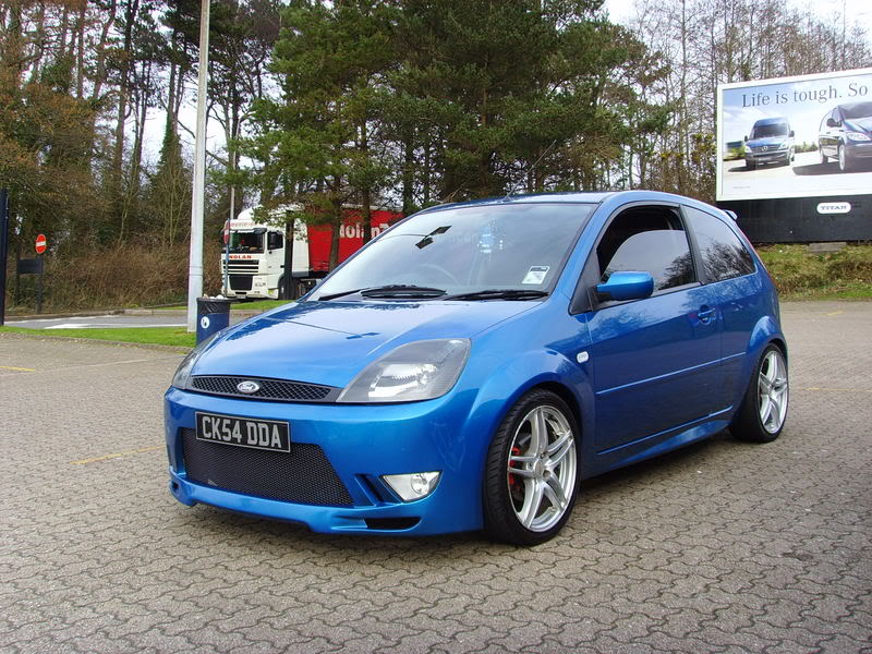

on a fiesta zetec s de-tangoing does involve taking the headlight apart and removing the orange lens!

heat gun/ hair dryer ftw!!! i done my mk6 fiesta lights and never had a problem... i will do mine when i get my car back.

Festa Zetec S lights were easy as the sealant was like rubber so you could cut it with a stanley blade flick off the four clips and then it would seal nicely together again. I was the first of that I saw on ZSOC to paint the surrounds black. Big improvement.
