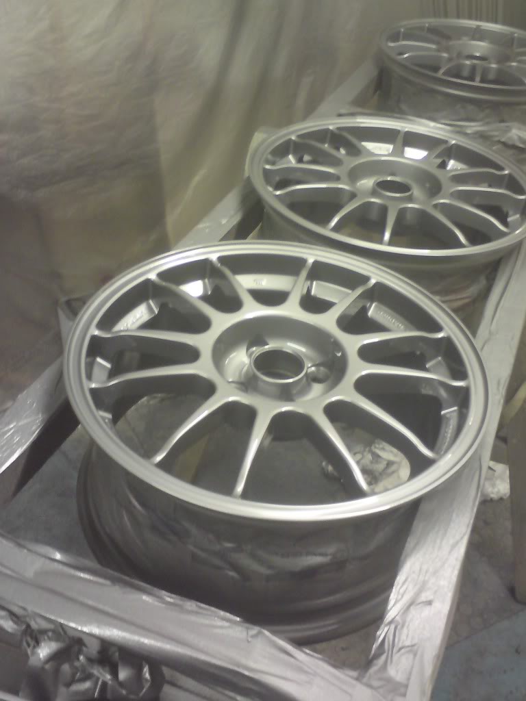

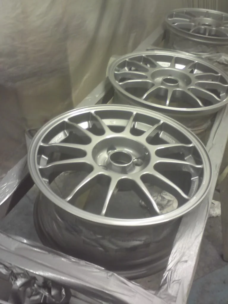

Garage Refurb FTMFW :) Teaser, s**t pic but you get the idea, Base'd up in 205110 Factory cup pack colour ;) ) and 2k gloss laquer, Going to look mint fitted
