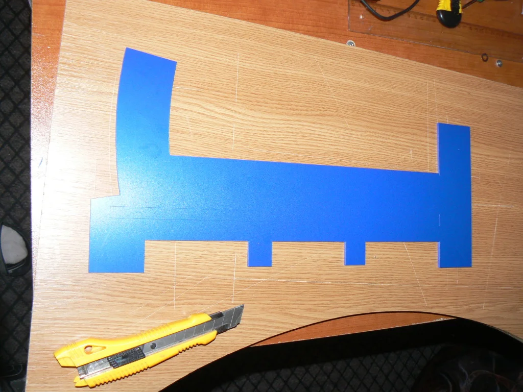

Since I'm having some camber bolts coming soon I tried to come up with somethin' to measure the camber, after realizing that a digital camber gauge was out of my reach - cheaper ones that I've found couldn't get them ordered to my country so my attempt went like this:

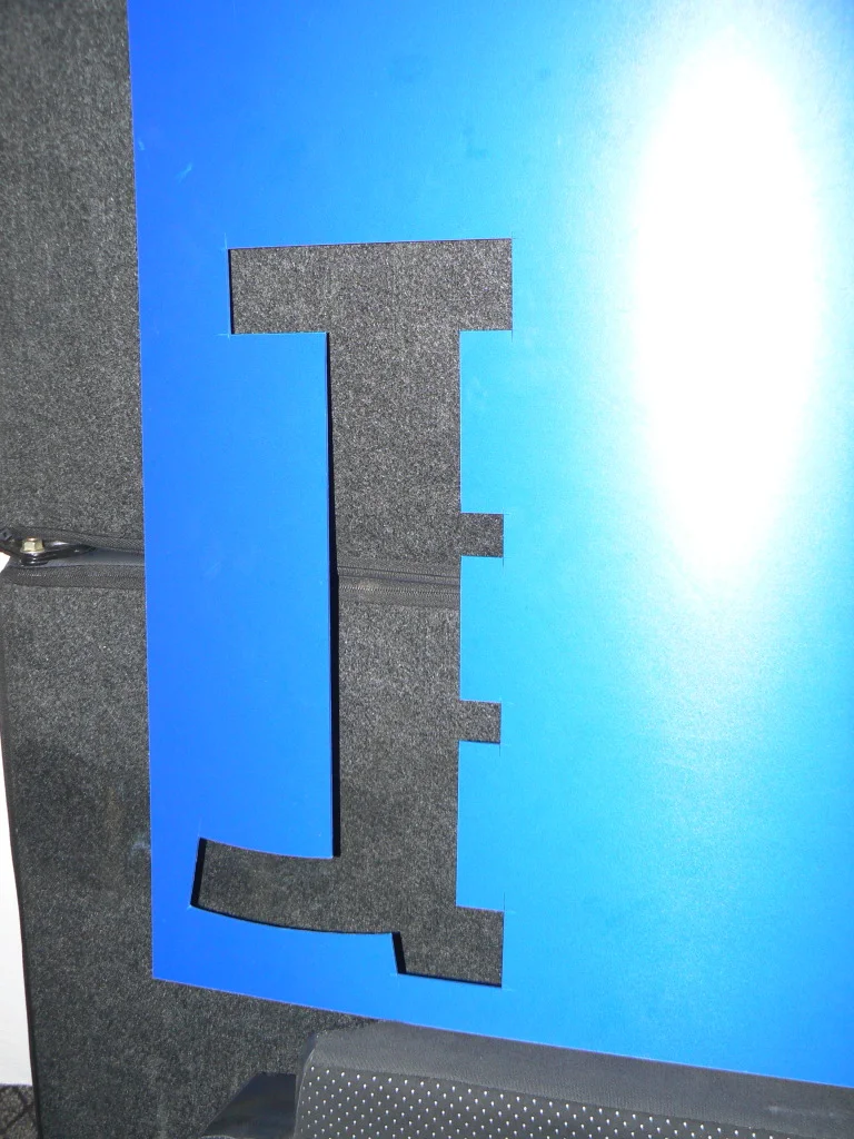

drawn the item in acad, printed on, and made a plastic template after it
used a 3 mm thick plastic material which I already had, the kind they use for publicity panels, interior decorations, etc. used a cutter to get the job done. easy stuff
piece that came out:

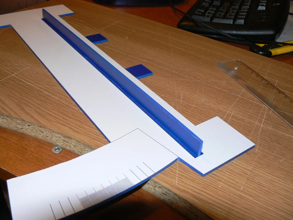

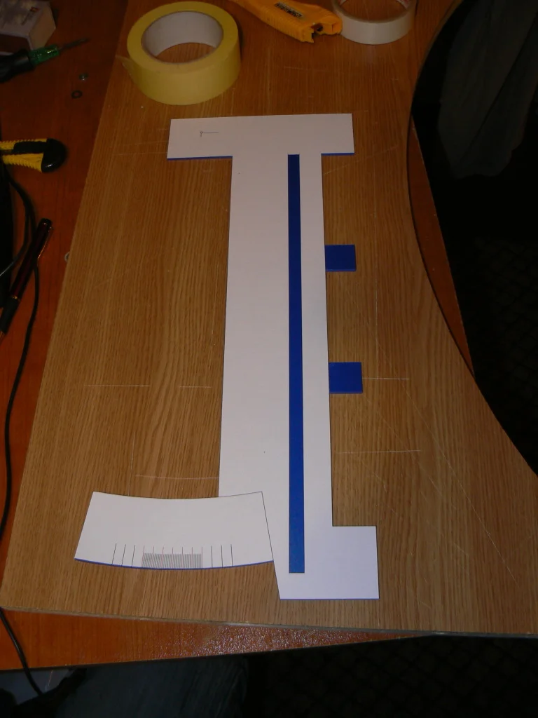

then used double adhesive tape to stick the printed stuff on
after that I strengthened the vertical line with another 1,5 cm wide piece of the same material to stop it from bending
you can see here ^ the markings which show degrees and 0.1 degrees, easy to read- 0.1 deg. ~ 1mm, 1 degree~1 cm

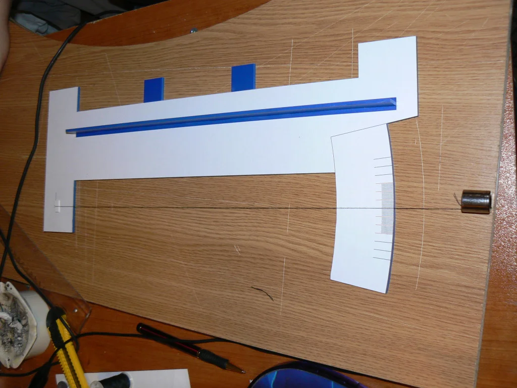

then hanged a 12 mm spanner from the tiny hole on top using a thin string and job done
The two blue smaller things will sit on the disc when the wheel is off, while the white larger extremities sit on the rim edges (16" rim)
It took some patience but I'm pleased with the result. then went out and took some measurements. as I suspected the front camber is +0,2/0,0 while the rear is ~1,5/~1,9 neg.
