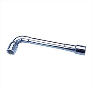

Is there any news morgam23? Using an angle socket wrench makes it easier.

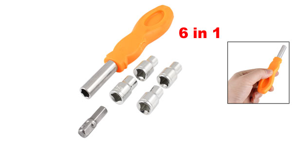

I done mine today and my hands where ripped to bits.
The part itself costs £125.27+ VAT and the part number is 77 01 050 887.
I just ripped the wires out and rerouted the new cable as it was a pain to get the unit out.
what i used was a 6mm socket on the end of a screw driver like in the picture below.

£125.27+ VAT? They are ripping off consumers :S On ebay an used actuator costs £30 or less! :clap:
If someone else tries to replace the actuator, I strongly recommend to use a 6mm angle socket wrench. It makes it easy to turn the screw. So that, your hands will thank you. :cool:
