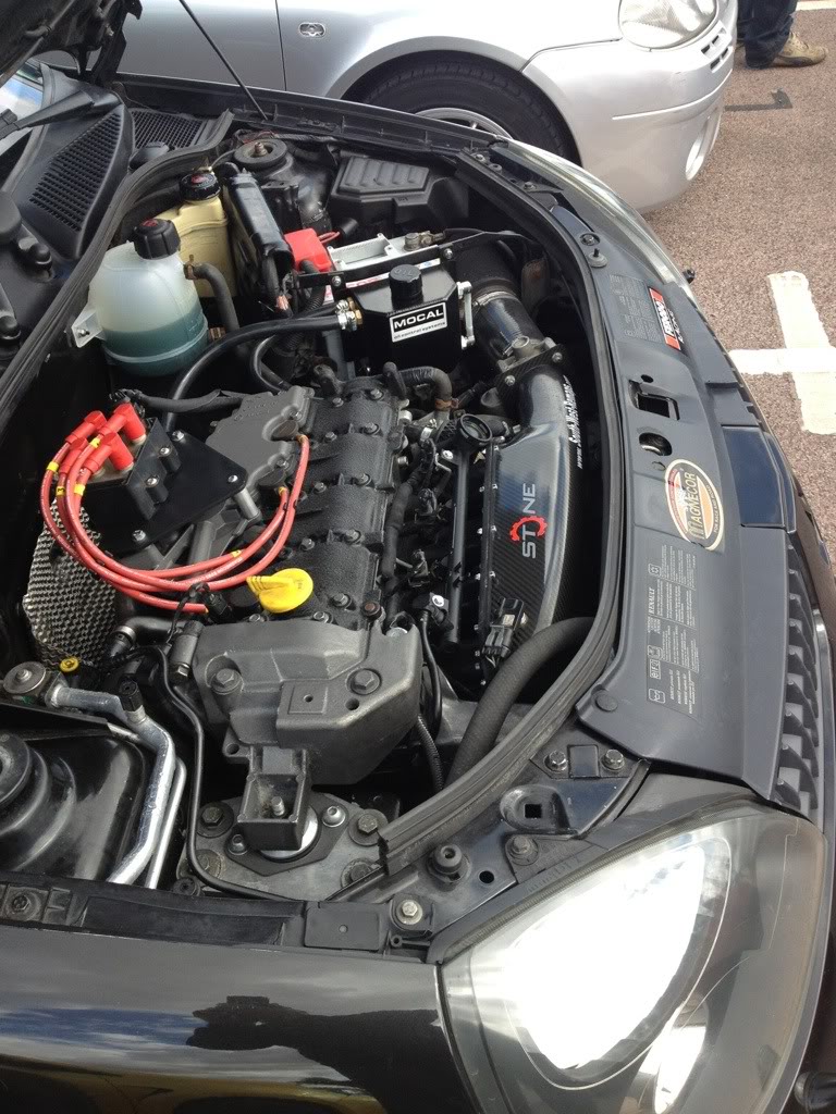

I just put mine next to the header tank. It consists of the tank, a filter and a 90 degree hose joiner.
So the hose from the standard airbox goes on one outlet and then you for a breather to the other one? That's it?! No second pipe?
You hve 2 pipes in that?
With the Mocal tanks you can have both the 'in' and 'out' pipes on the same side.
The breather pipe from back of engine and a 'out' pipe that vents to atmosphere with a small breather filter on.

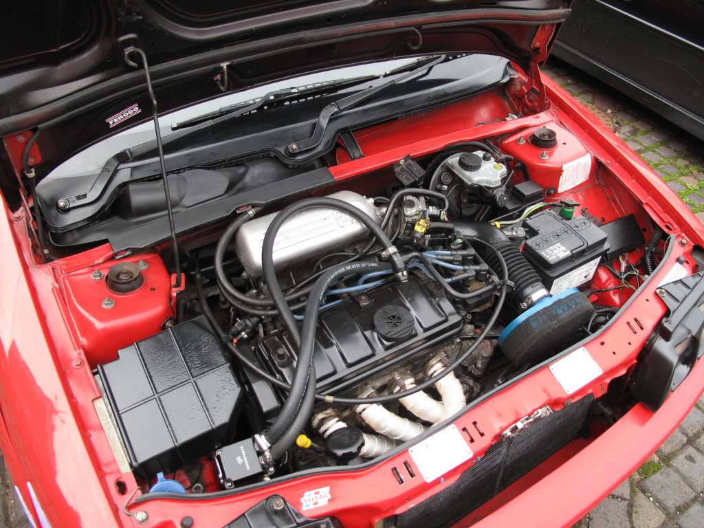

This was how i use to run a catch can on the 106.
One hose would run from the rocker cover into the catch can, the second hose ran from the catch can to the elbow on my induction kit. My Induction kit elbow had a hole to join the hose to like the Clios standard elbow does.
Because you are looking at replacing the Clios standard elbow for a DIY induction kit you wont need the second hose. You can just put a breather filter on the catch can like Ph1 Tom has in the picture above!

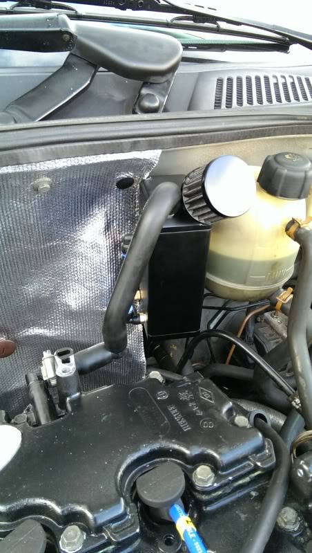

As J says, its to use a remote breather filter rather than it breathing through the lid, the reason being the mrs likes it kept clean and if it breathes out the lid you can get tiny oil vapour marks just under the lid, lol.
