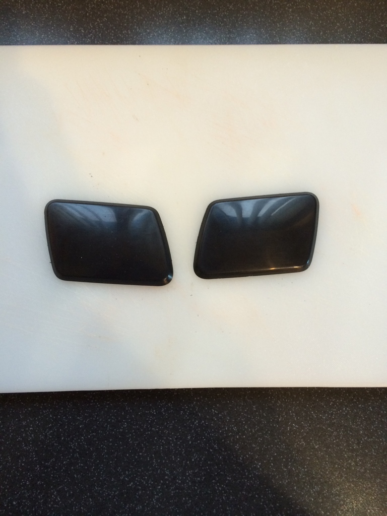

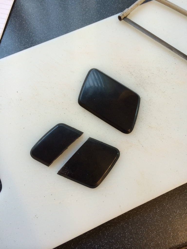

bought some skoda washer covers, not knowing what would come! they were huge so I went about cutting them down

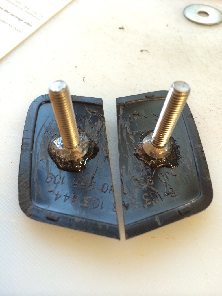

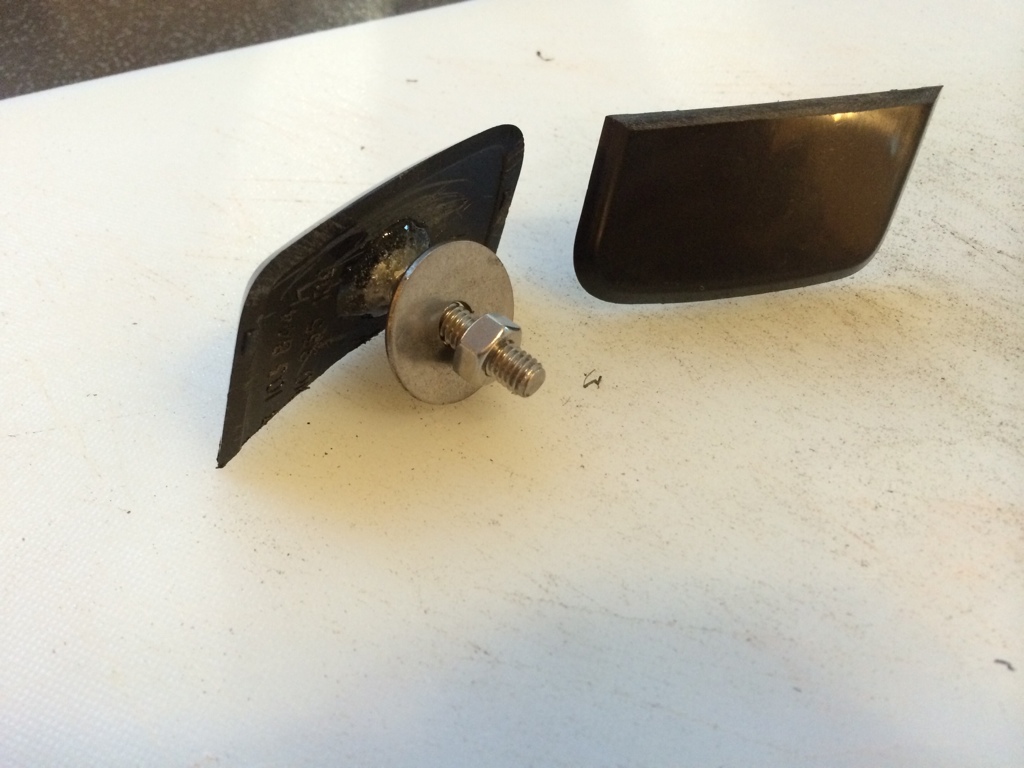

I glued on my bolts with a radiate
then I filed down my cut edge with a slight chamfer on it! here's my finished product ready to be sanded and then painted
