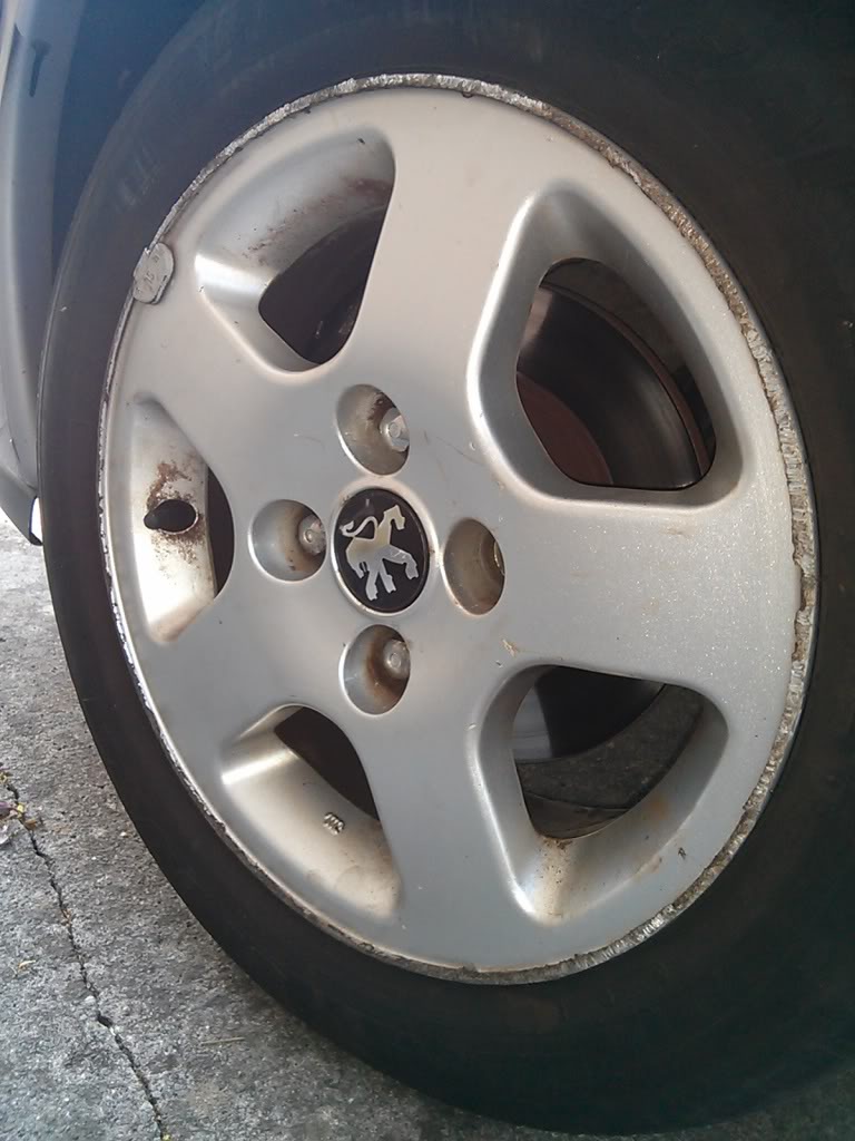

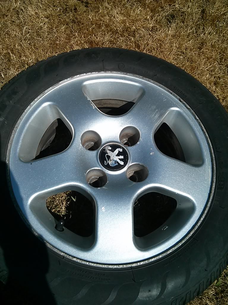

A fair bit of scratches and curbing on them so I did my best ,

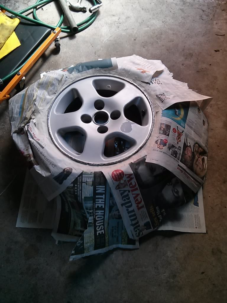

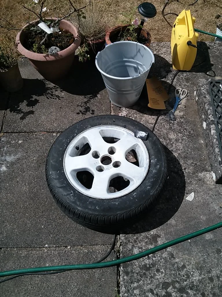

I used wet and dry sandpaper, 2 different grades to get the surface ready and remove any chips. I did buy some p38 filler but in the end I just couldn't be bothered to use it :) it was so hot I was dripping with sweat !

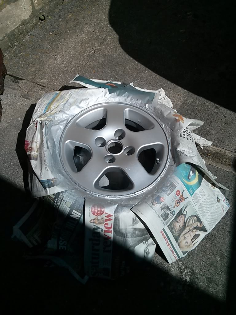

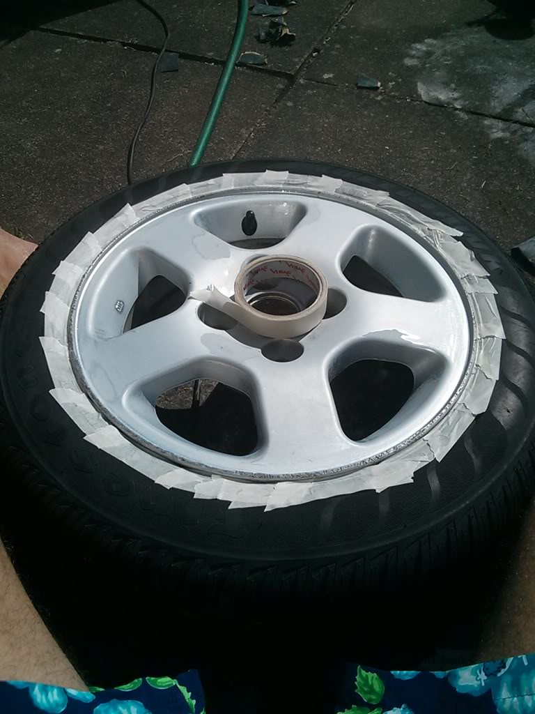

After that just masked up the tyre then primed / painted / laqured.
Also all I had was wet and dry sheets so tackling the badly curbed lips was impossible , if I tried it just ripped the paper so I did what I could and just left it.

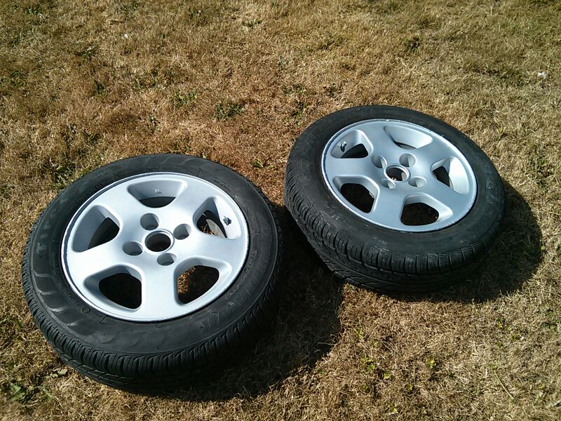

I knew they werent going to be perfect or close to a £300 wheel refurb but from only costing about £40 in materials you cant complain :)
P.s I have only completed 2 wheels as I ran out of time

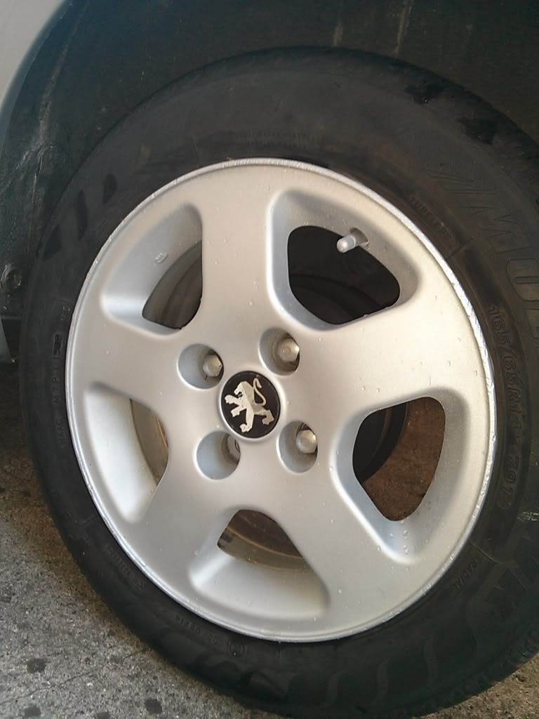

FYI in this picture I the wheel had water on its not dodgy paint run :)
Very good job mate! Looks loads better.
Shame you never taped up the valves though.
