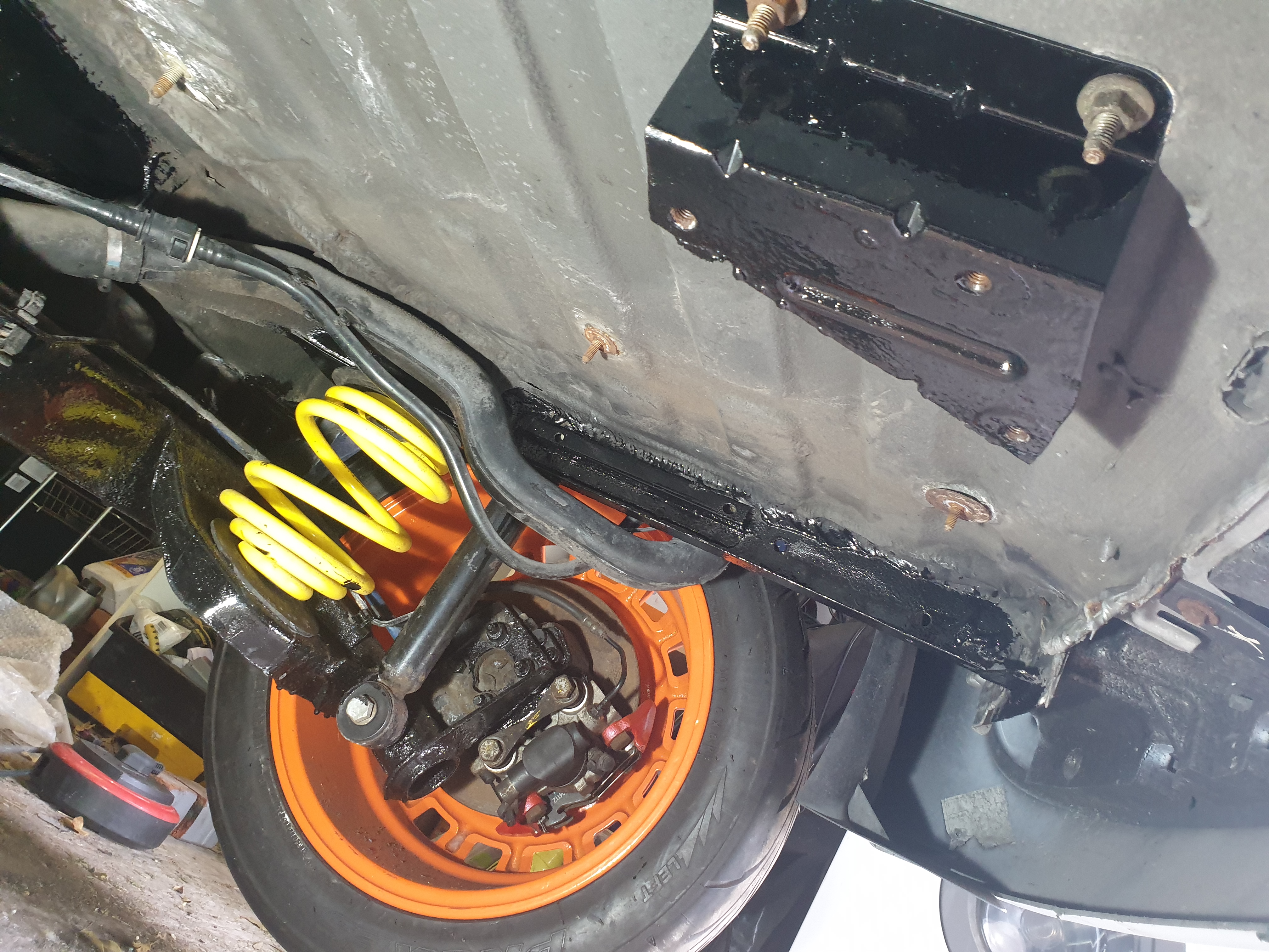

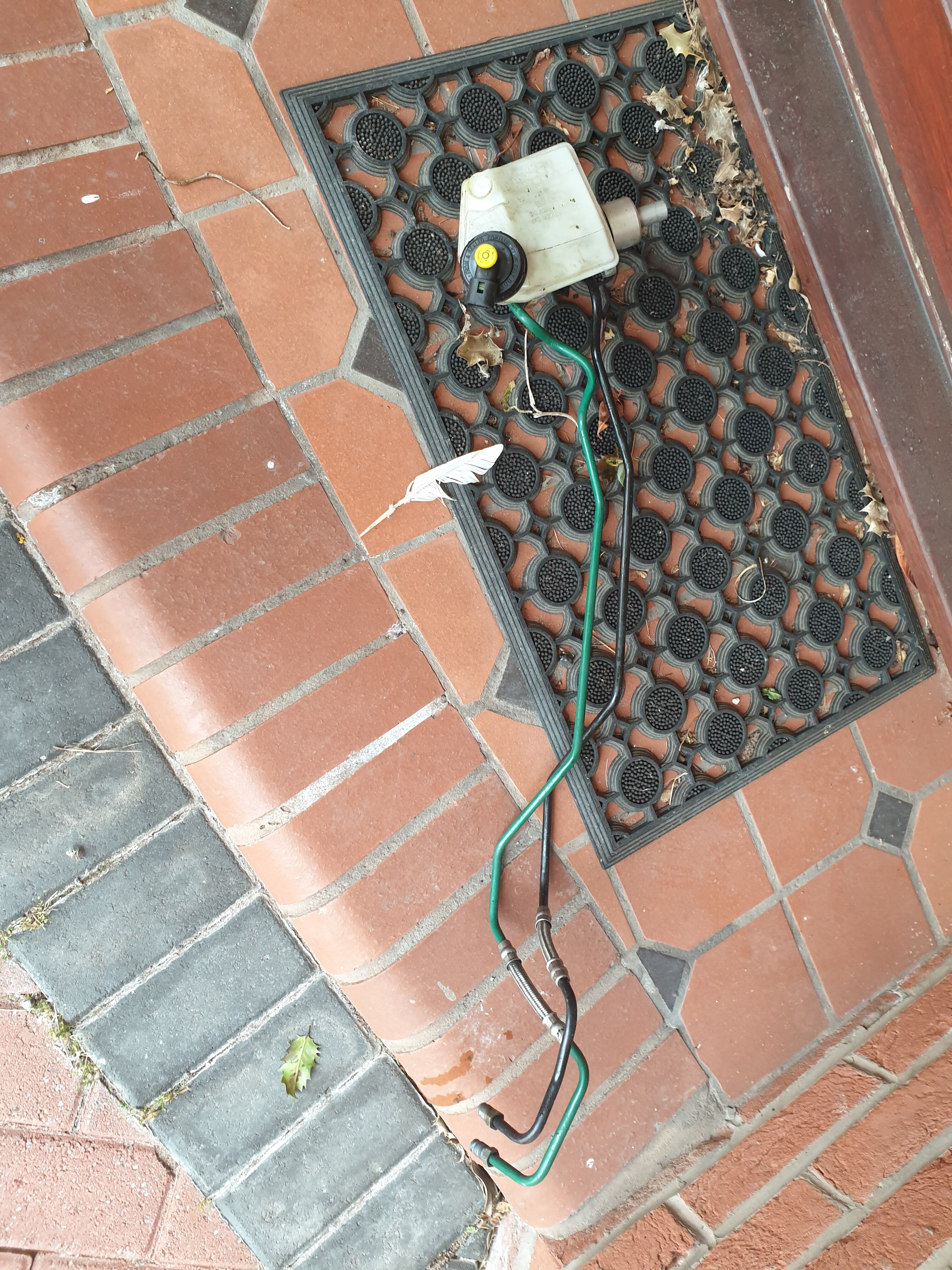

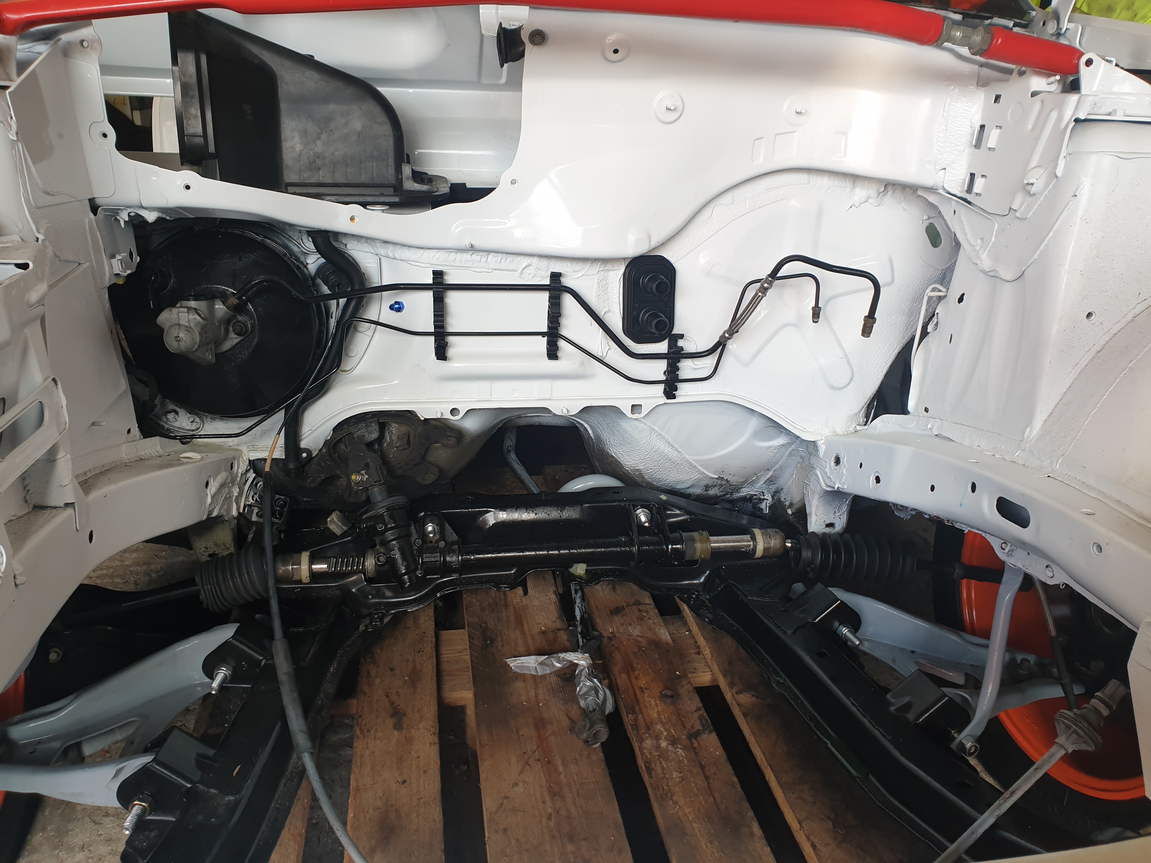

Master cylinder fitted and lines installed

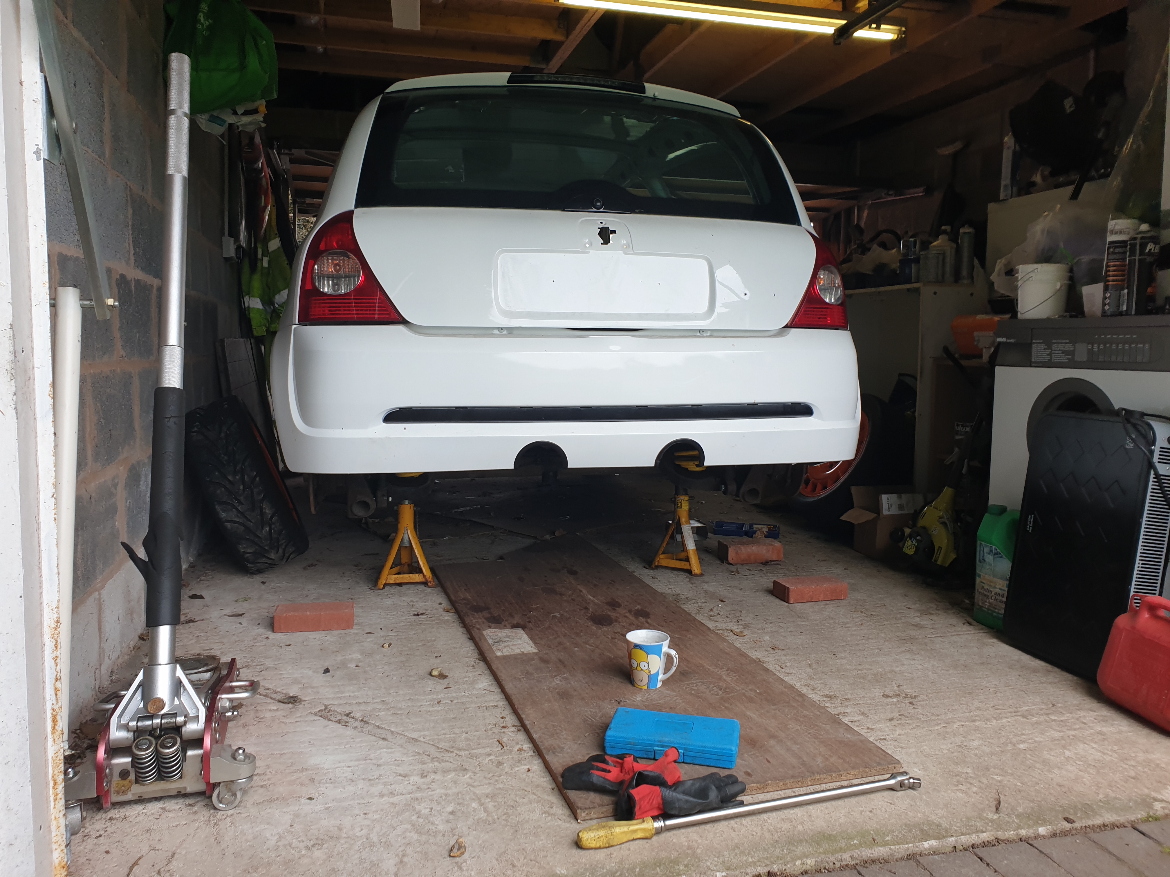

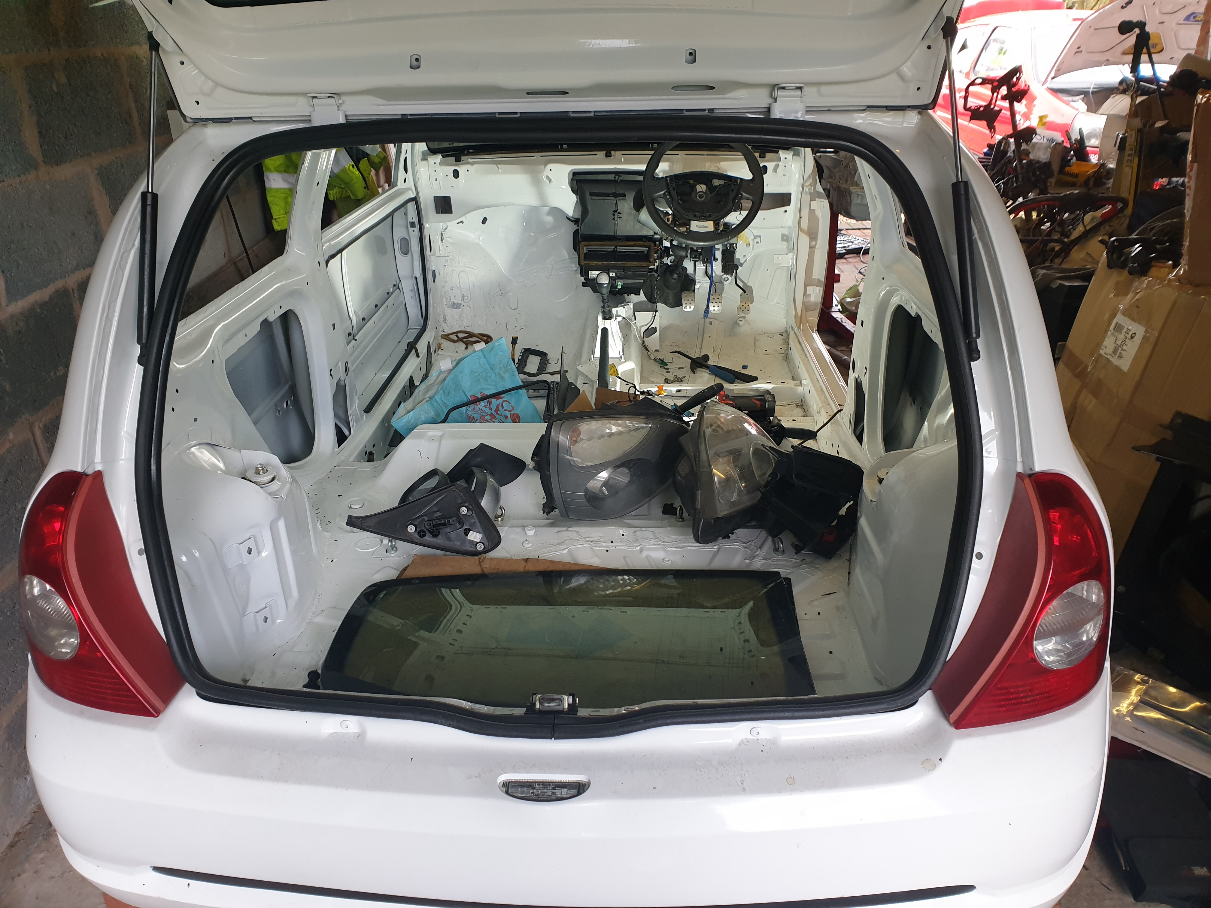

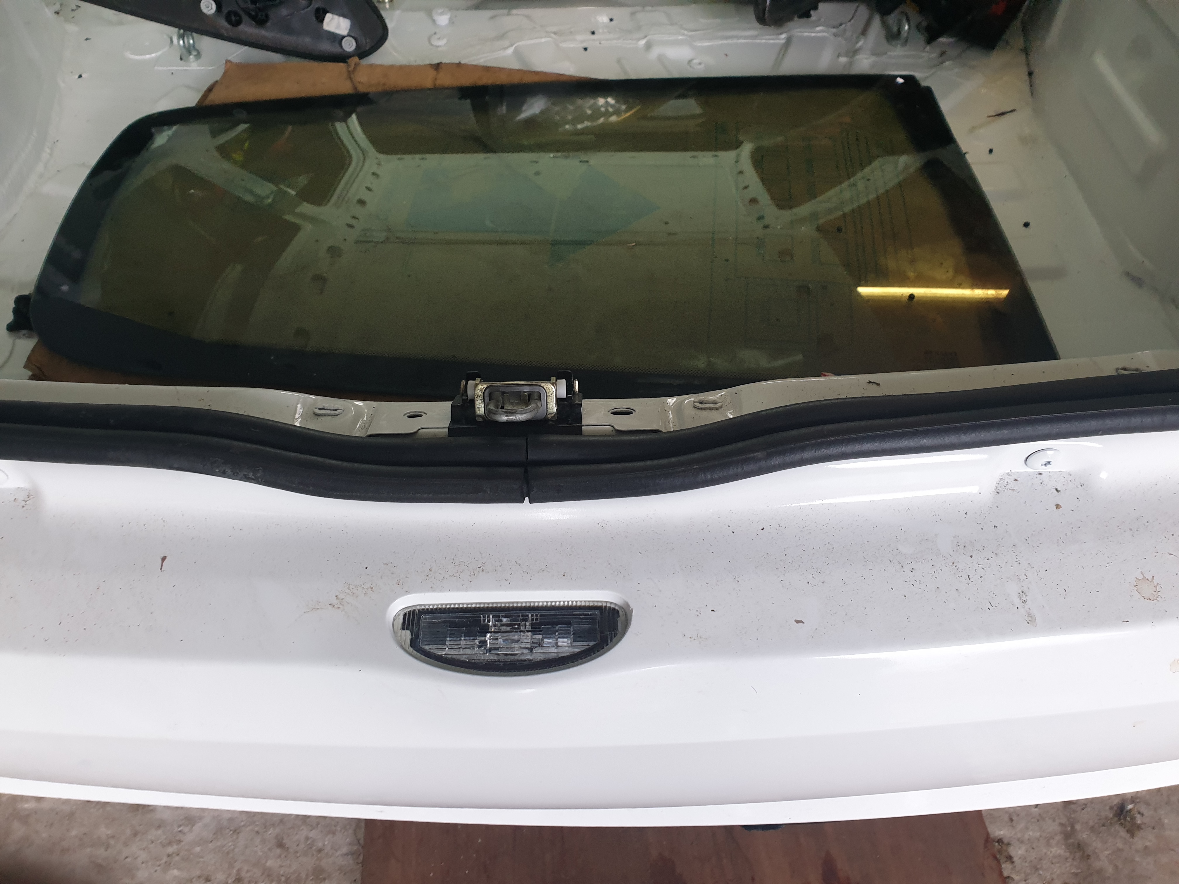

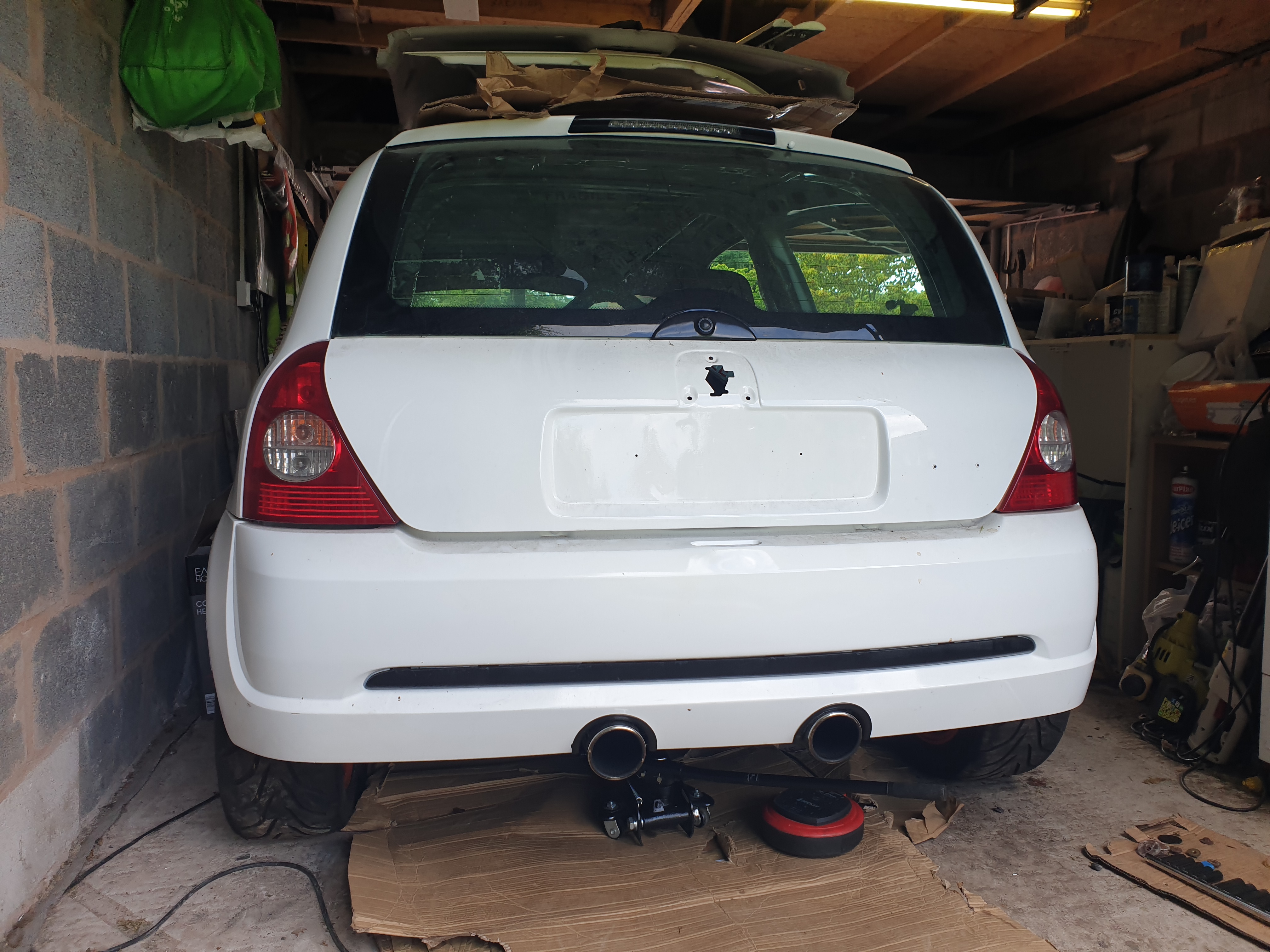

Rear number plate light , boot latch and boot seal fitted.
Need some time work really to get this built , i am waiting on some parts from powder coaters ! Unfortunately they take forever to do anything.

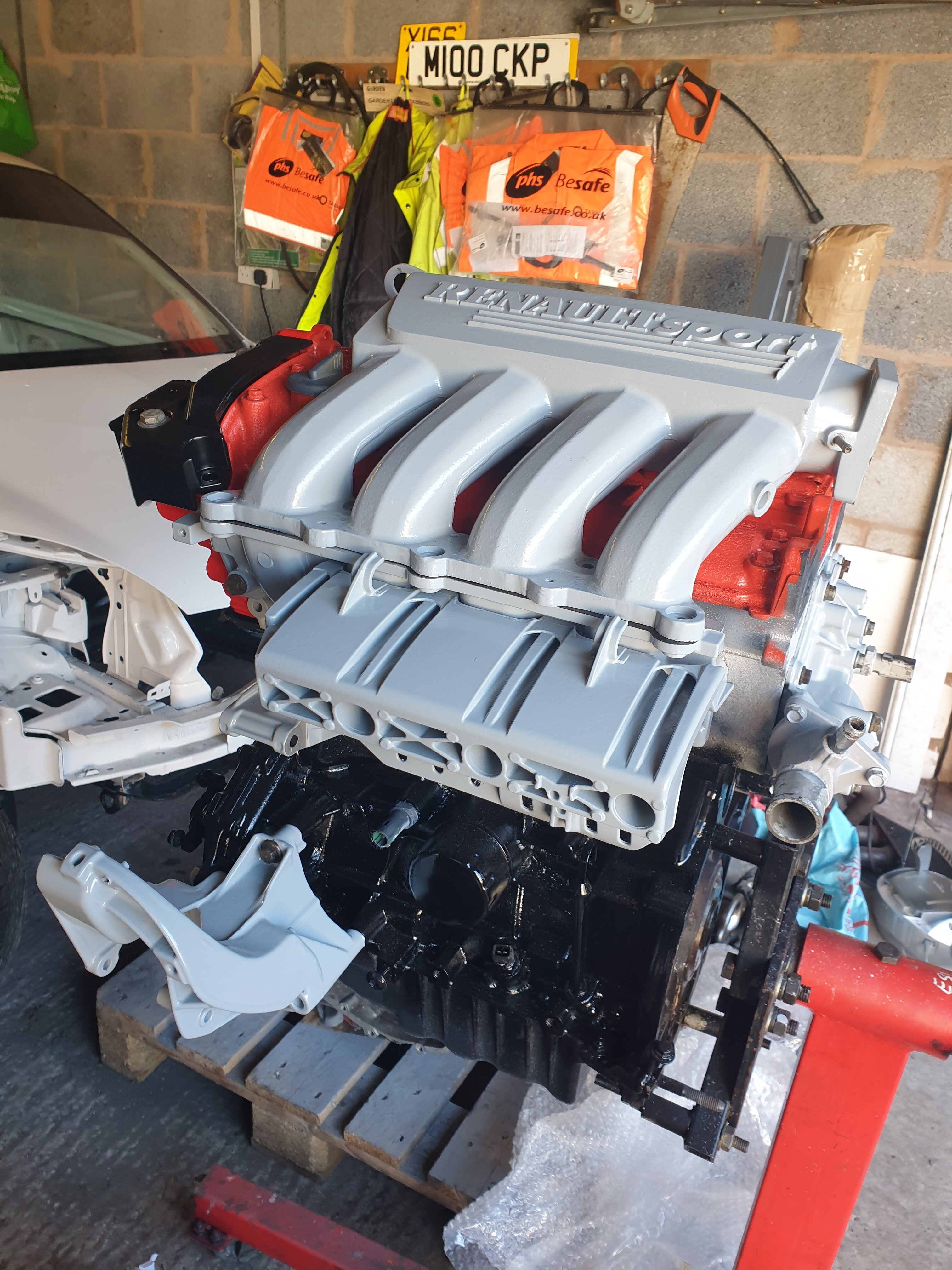

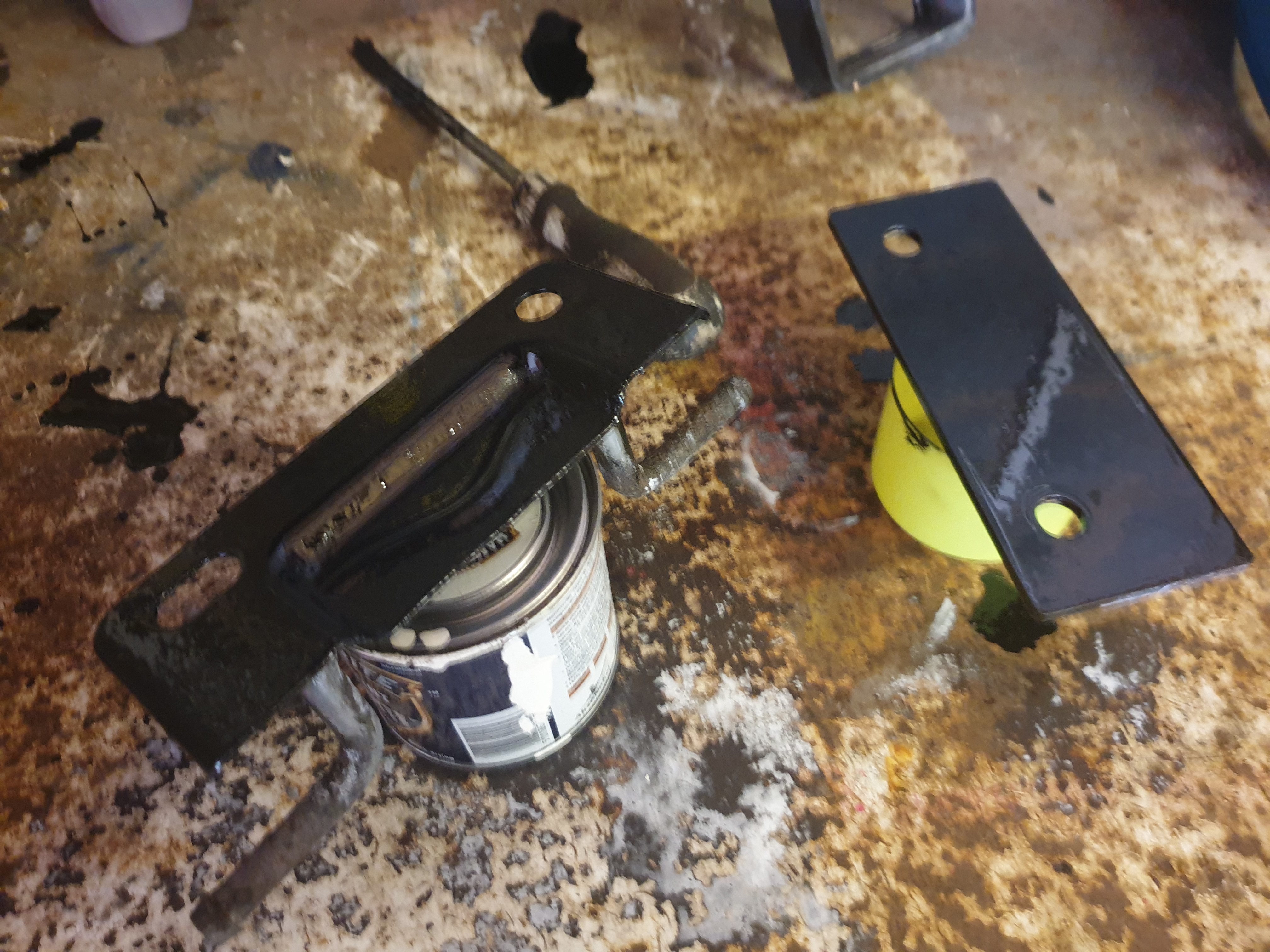

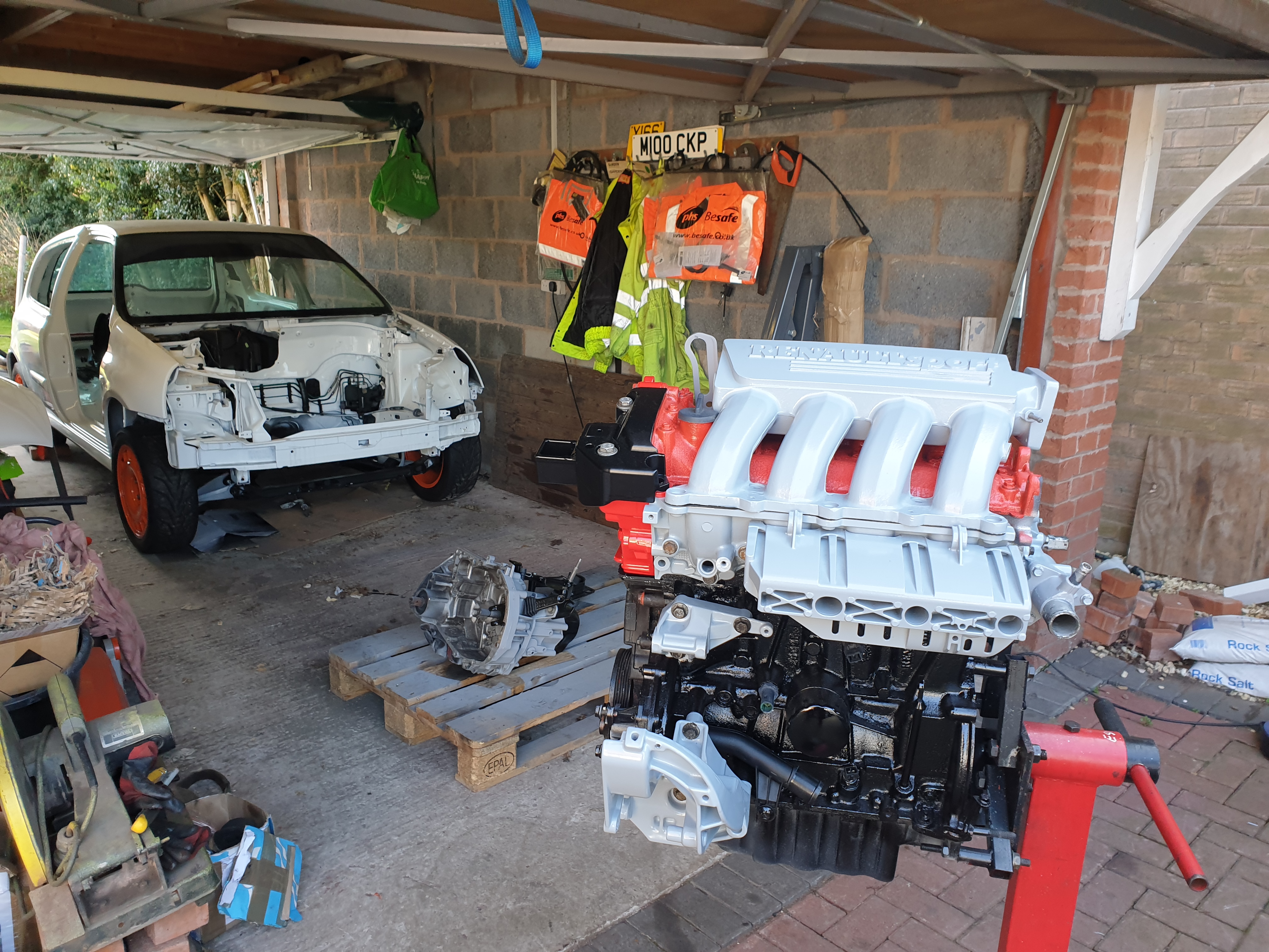

Engine and gaearbox will fitted as soon my gearbox mounts are ready.

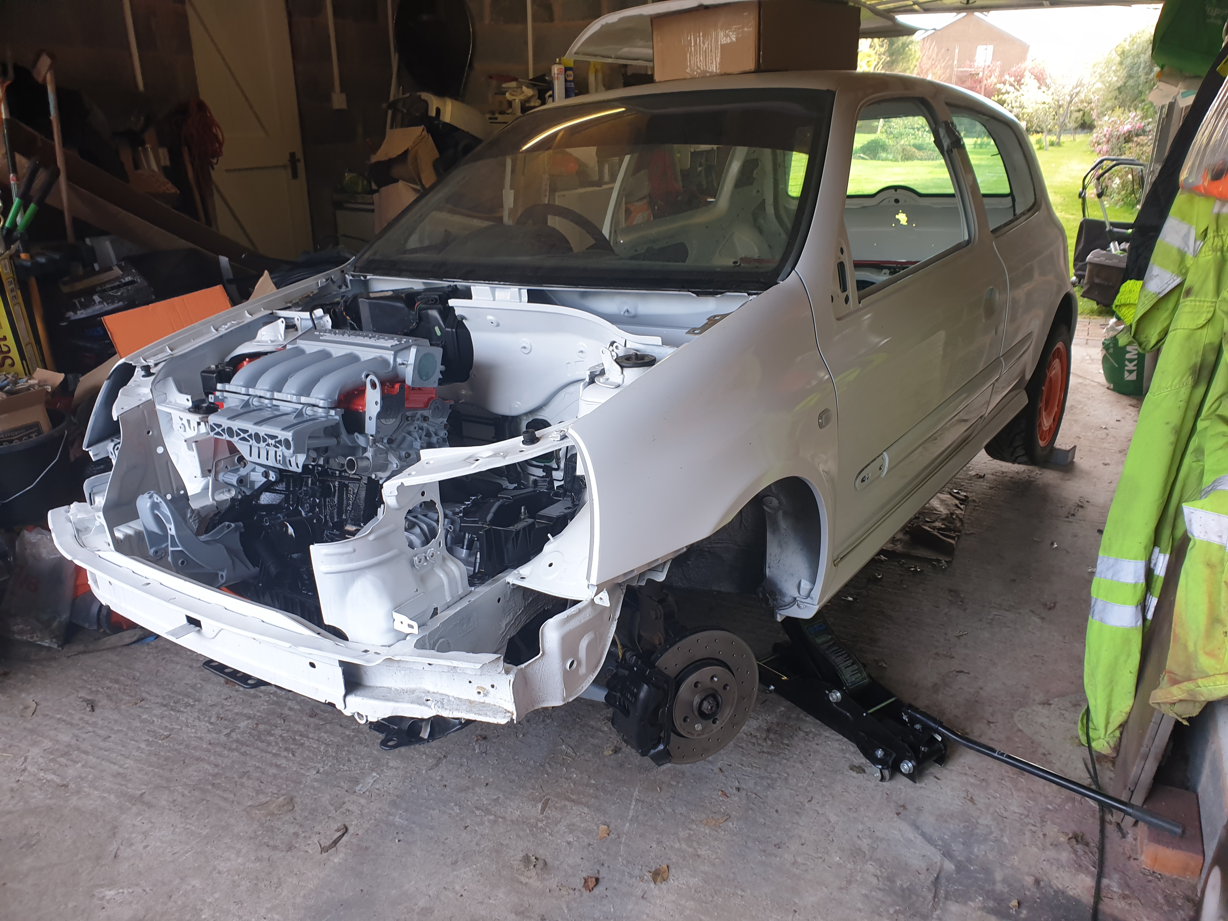

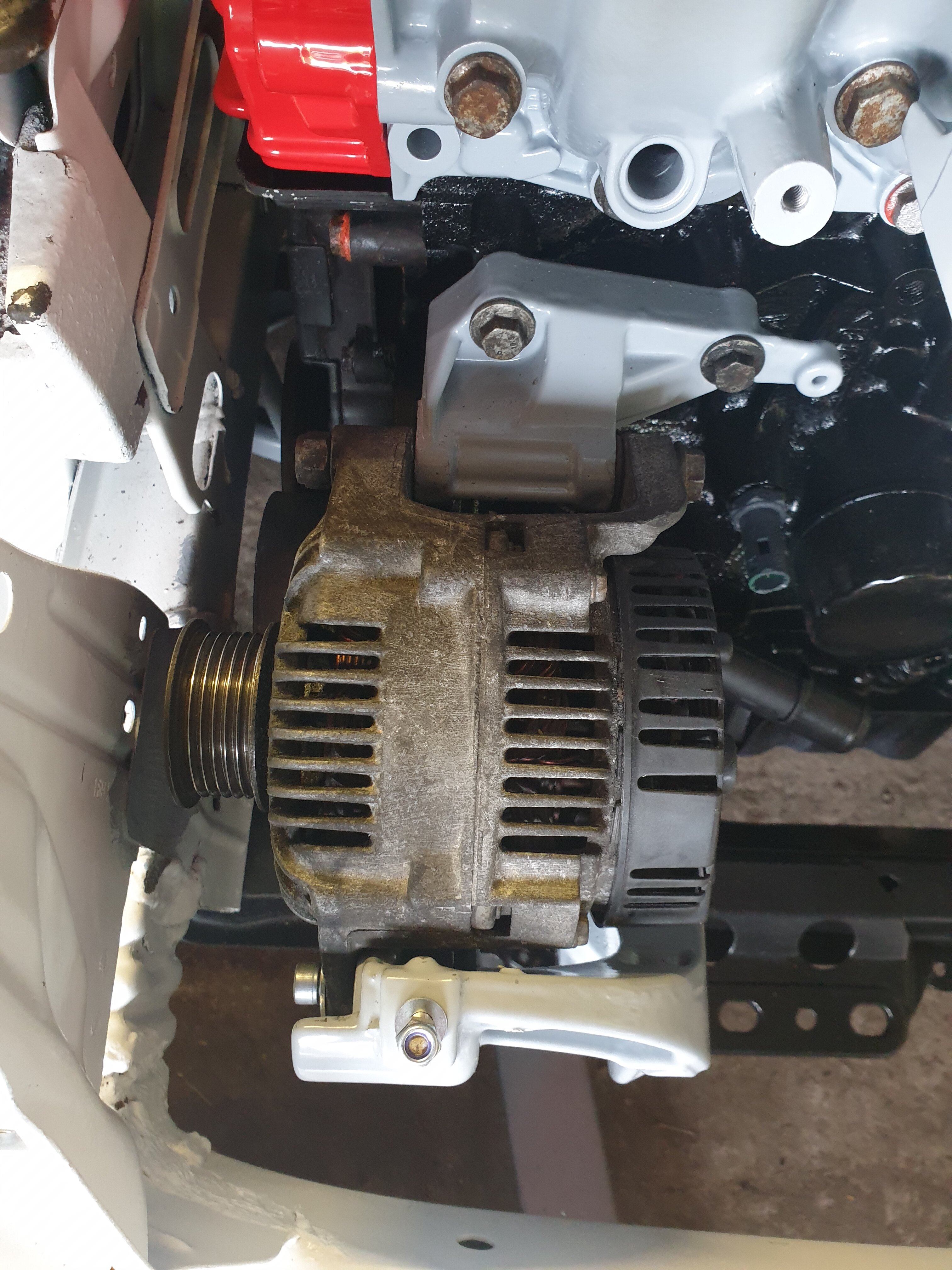

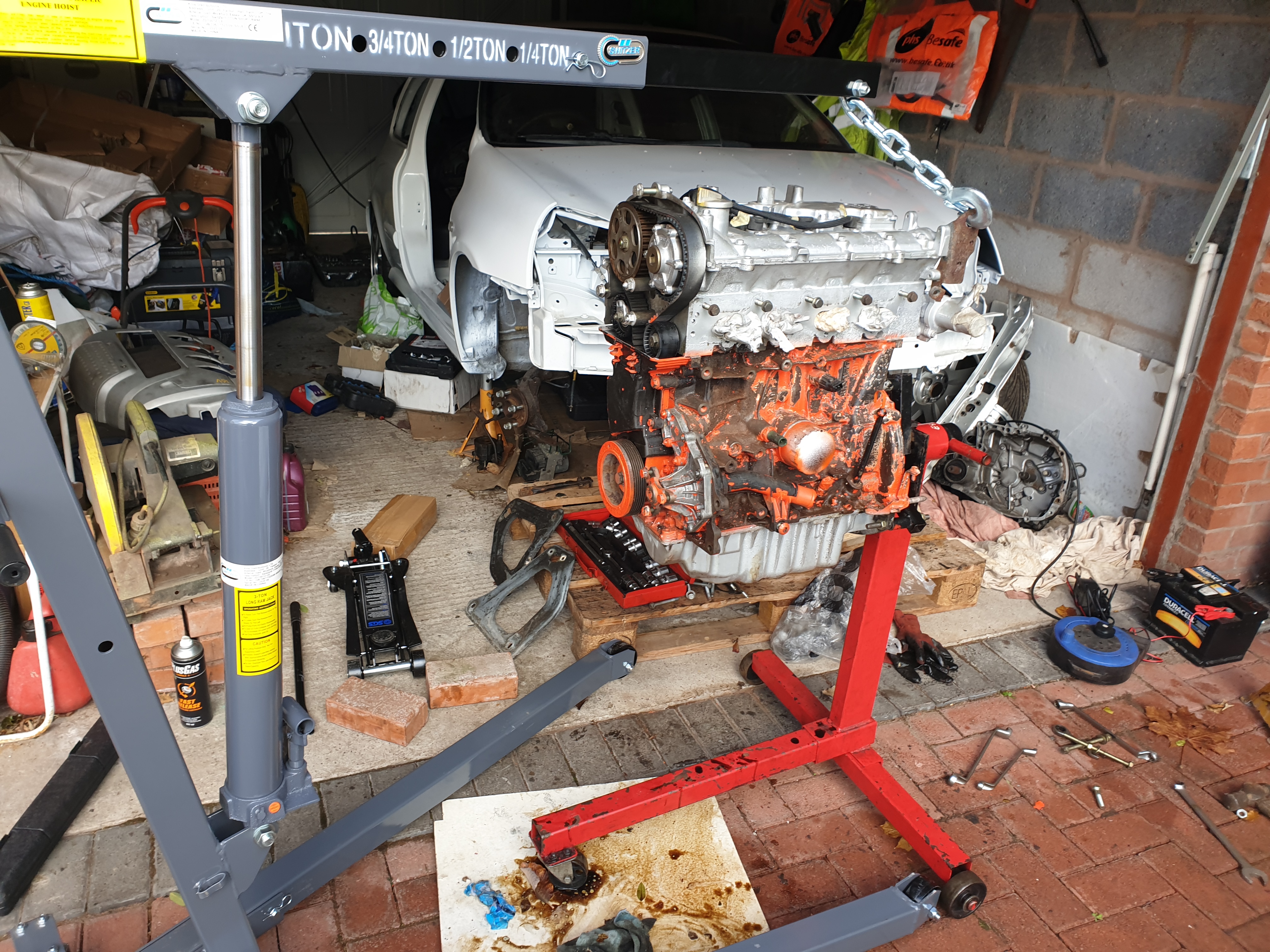

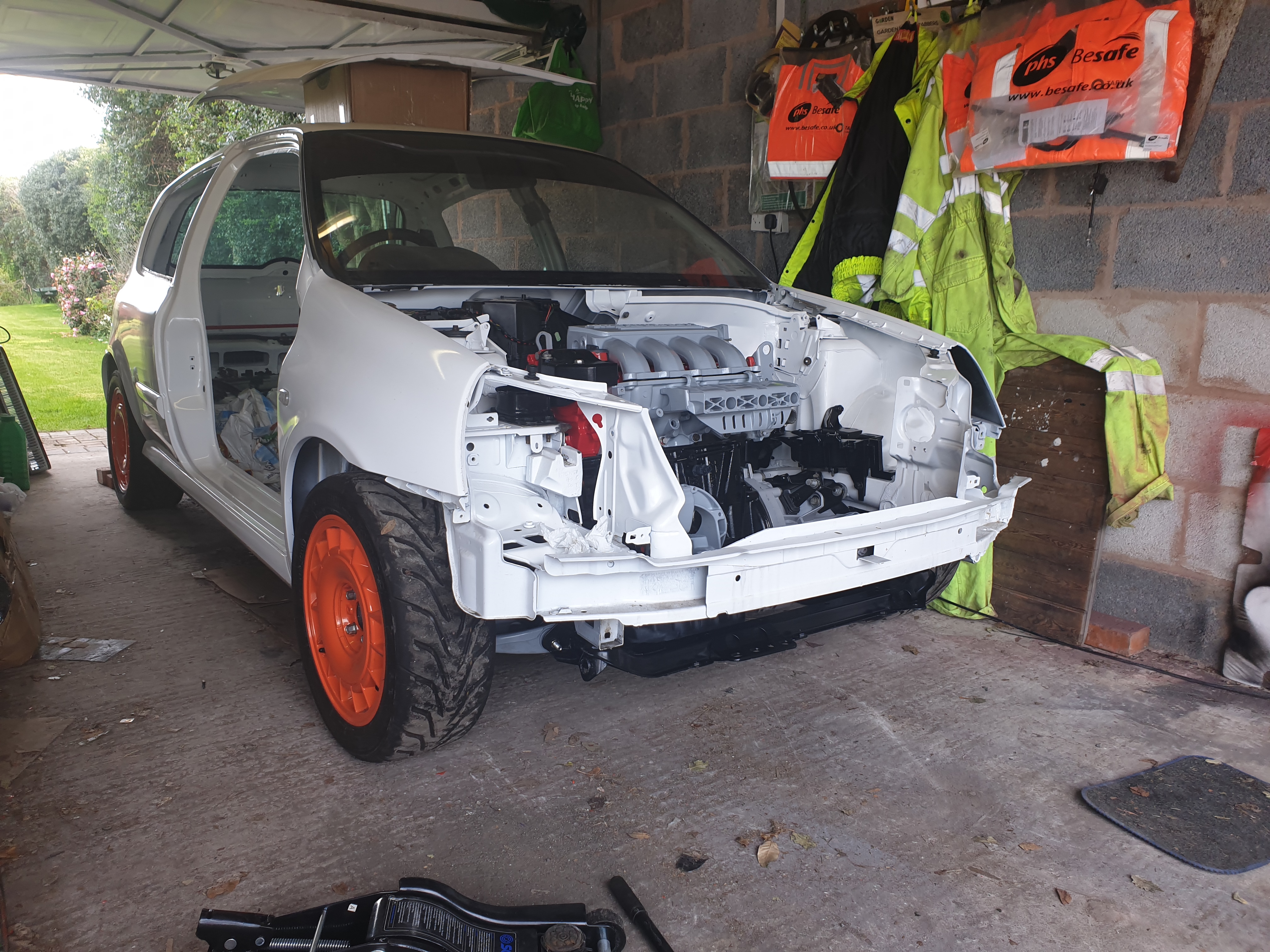

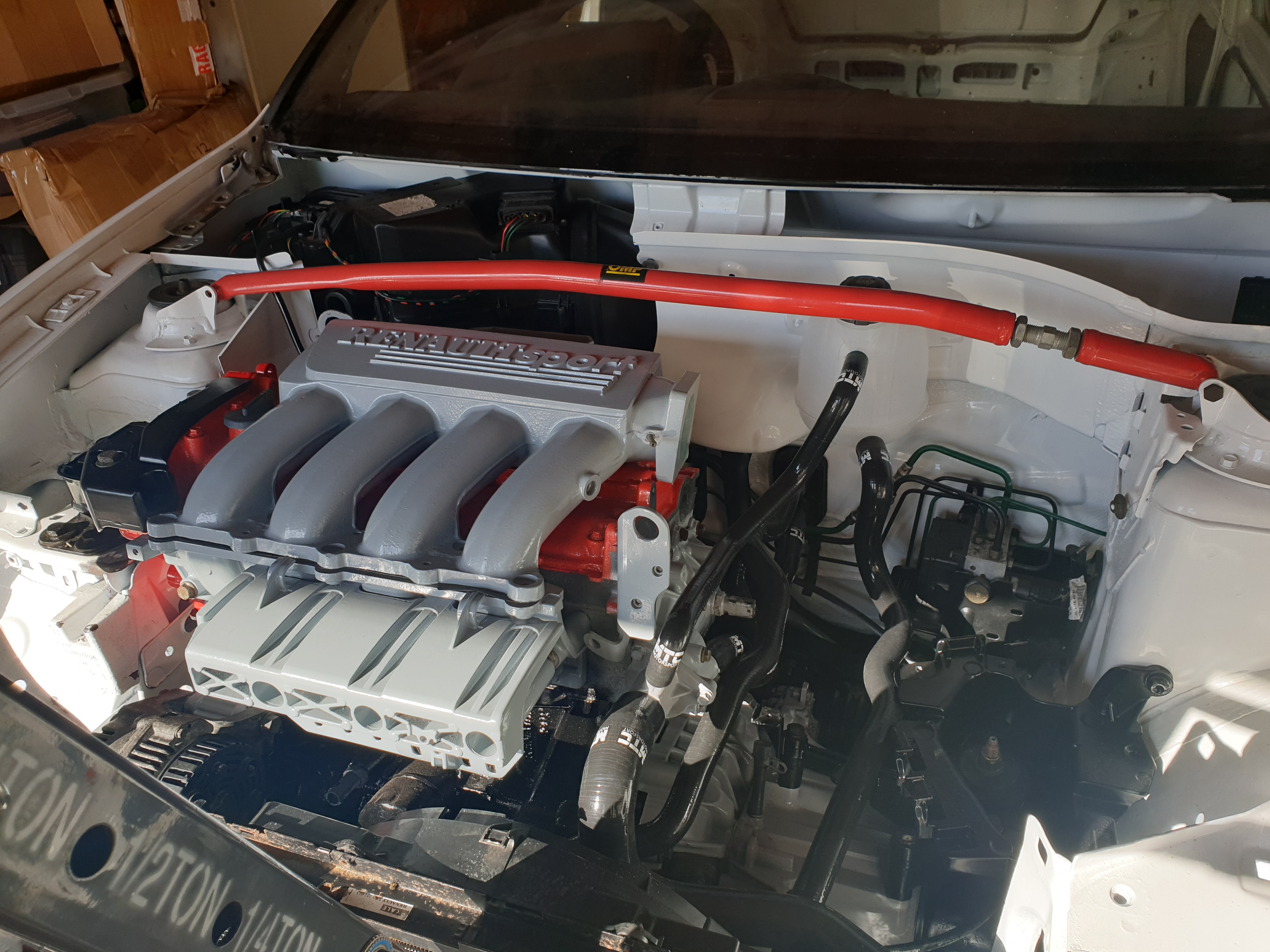

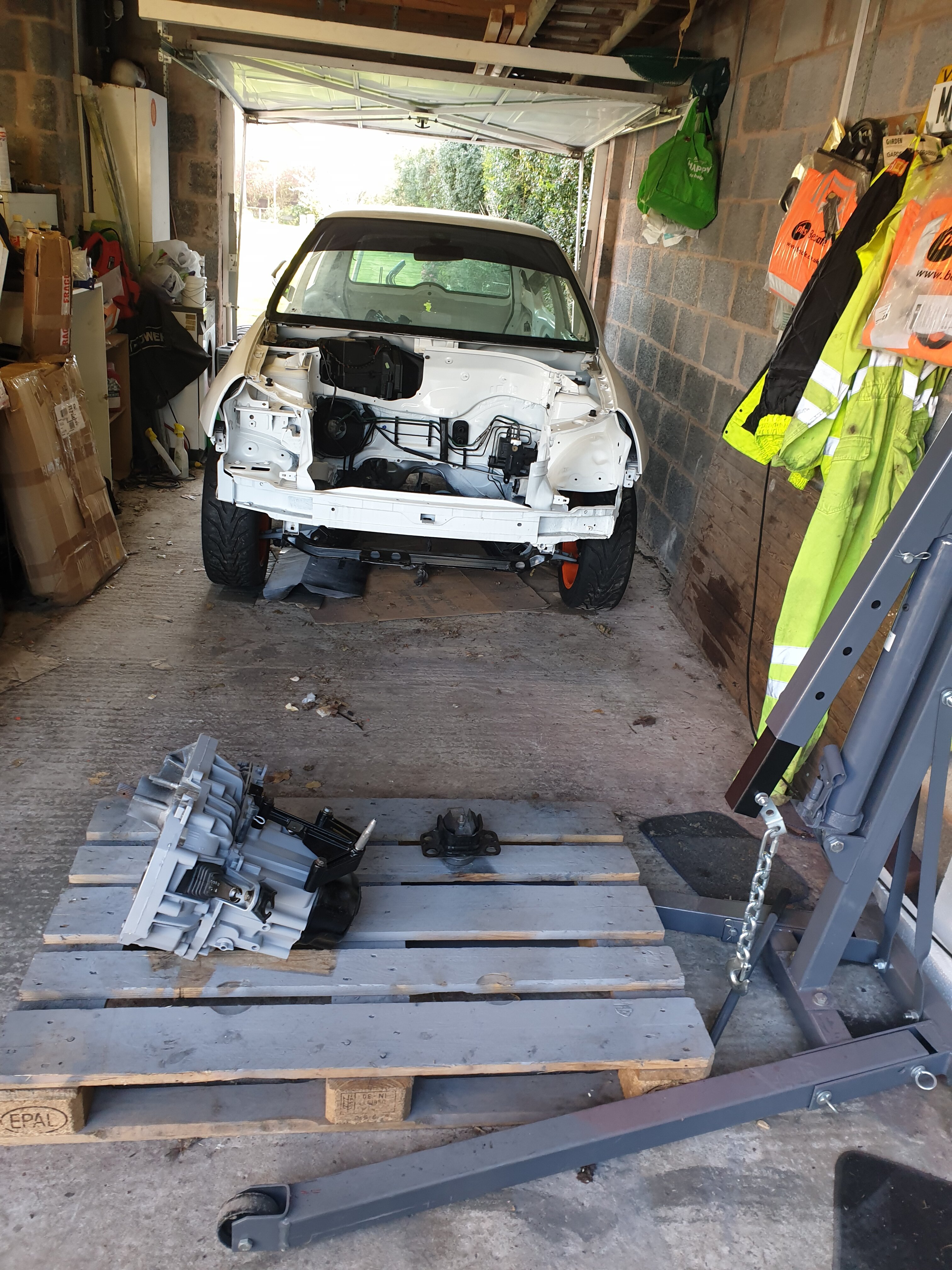

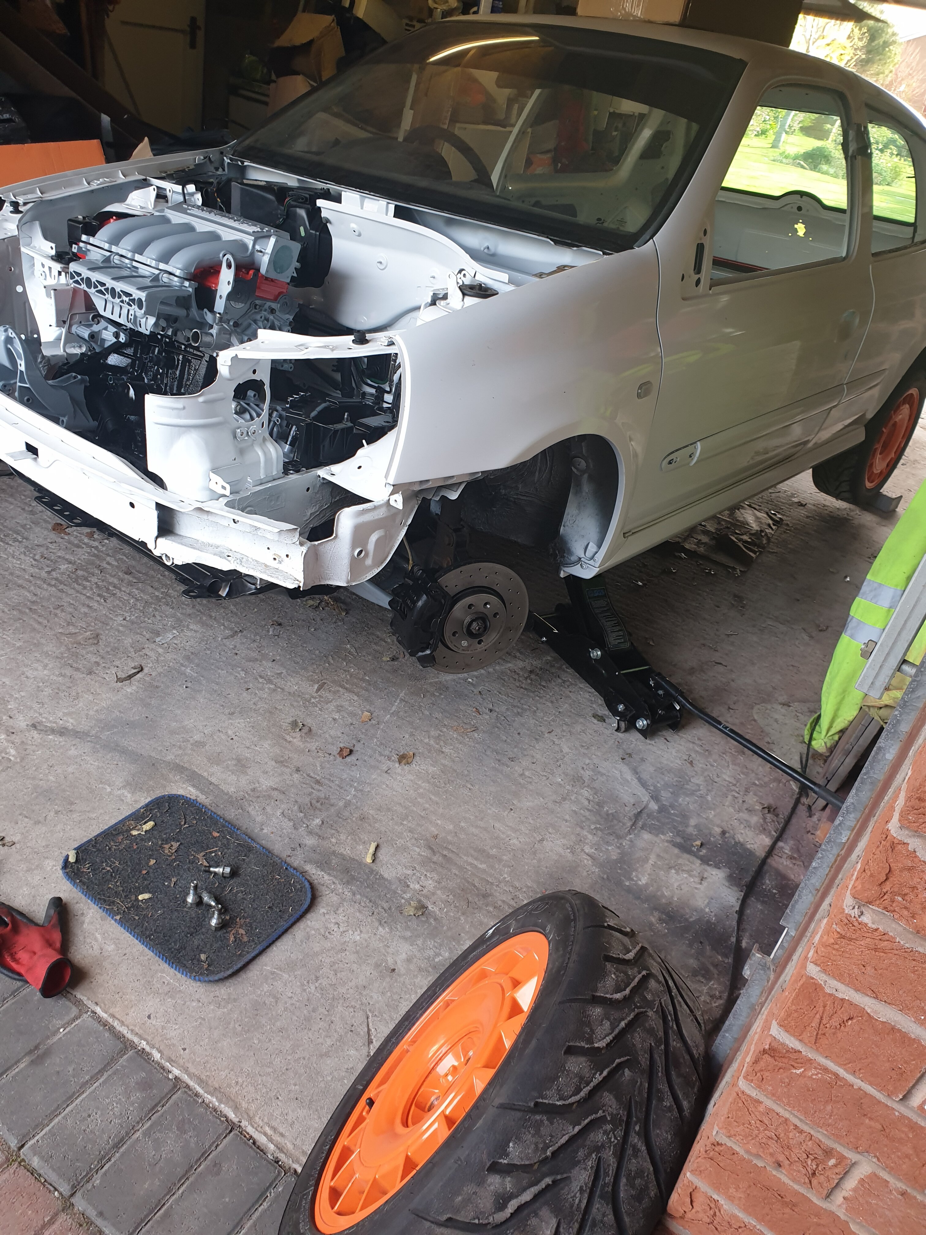

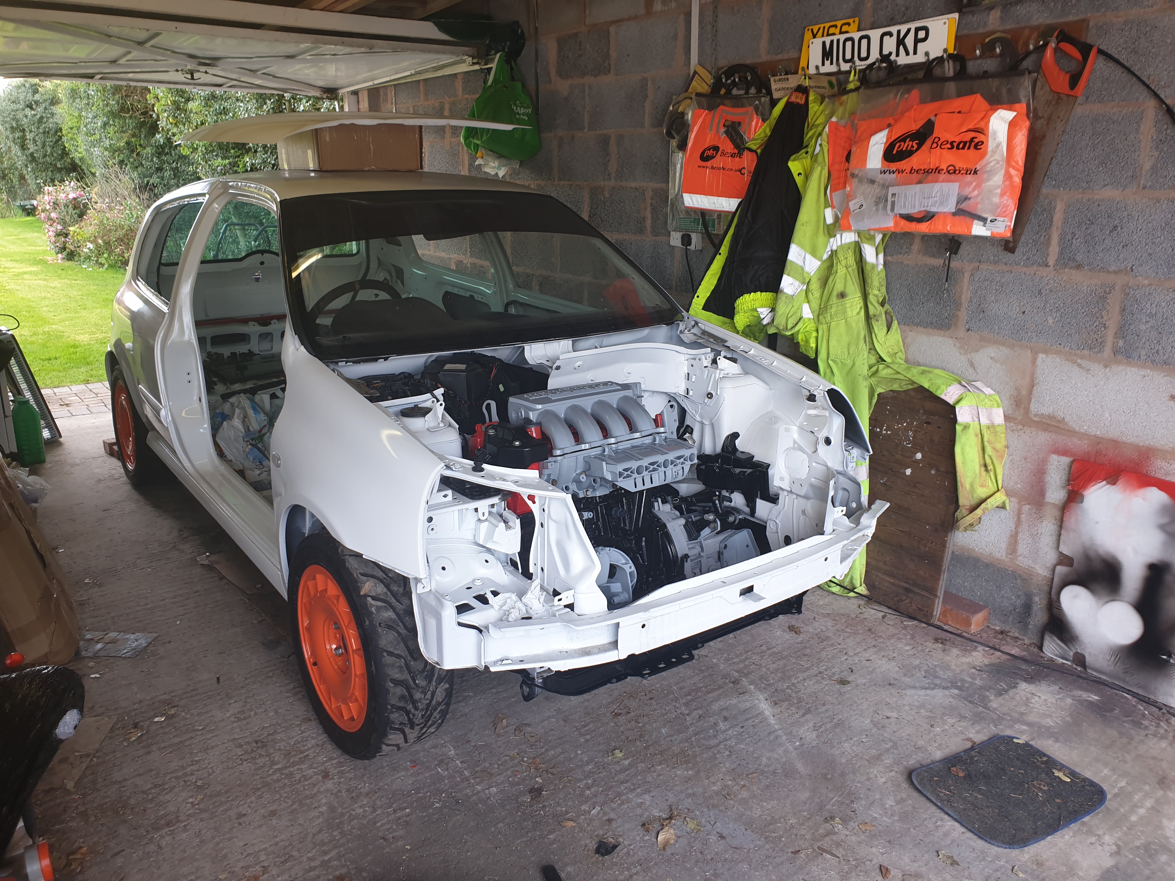

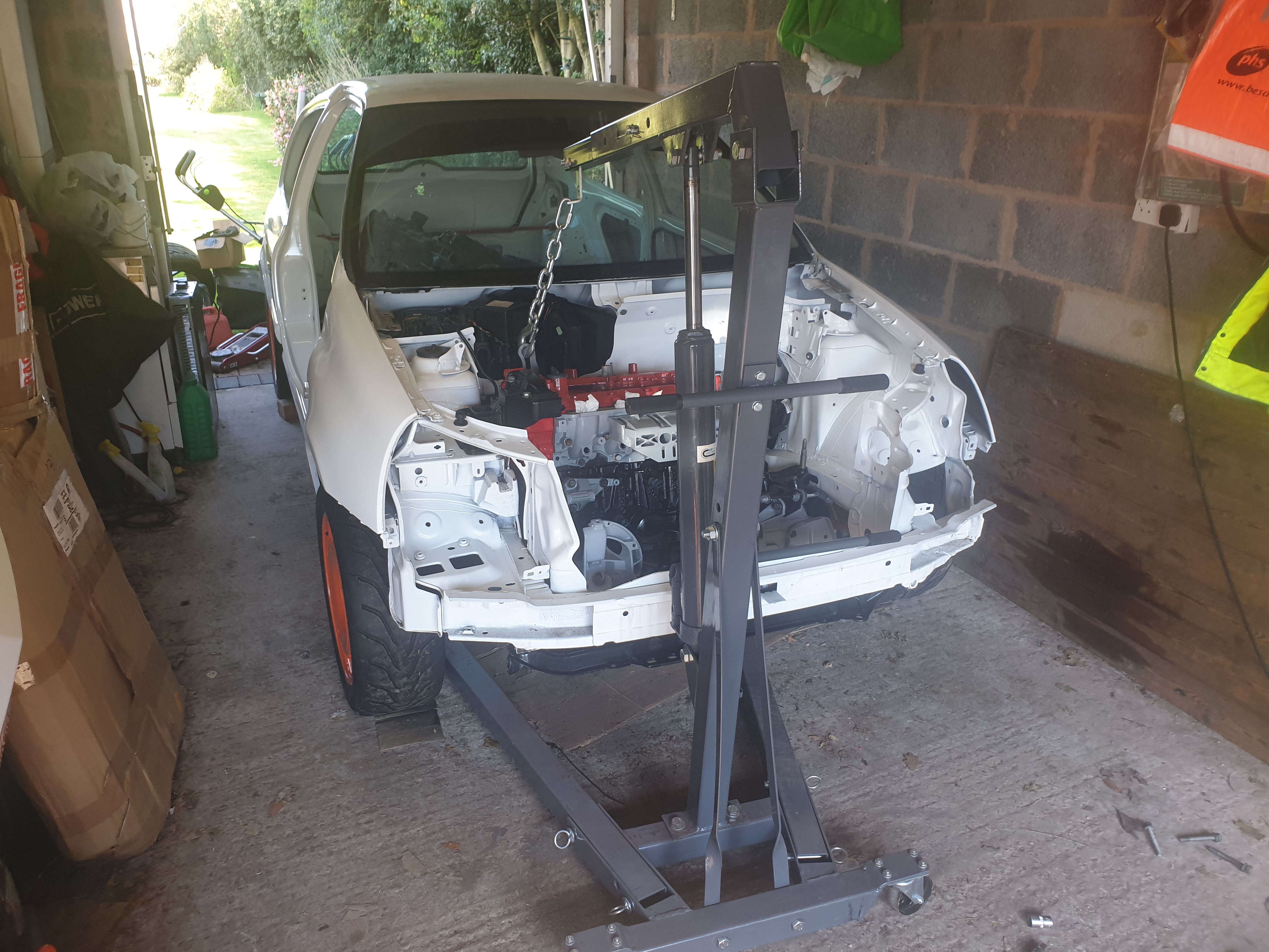

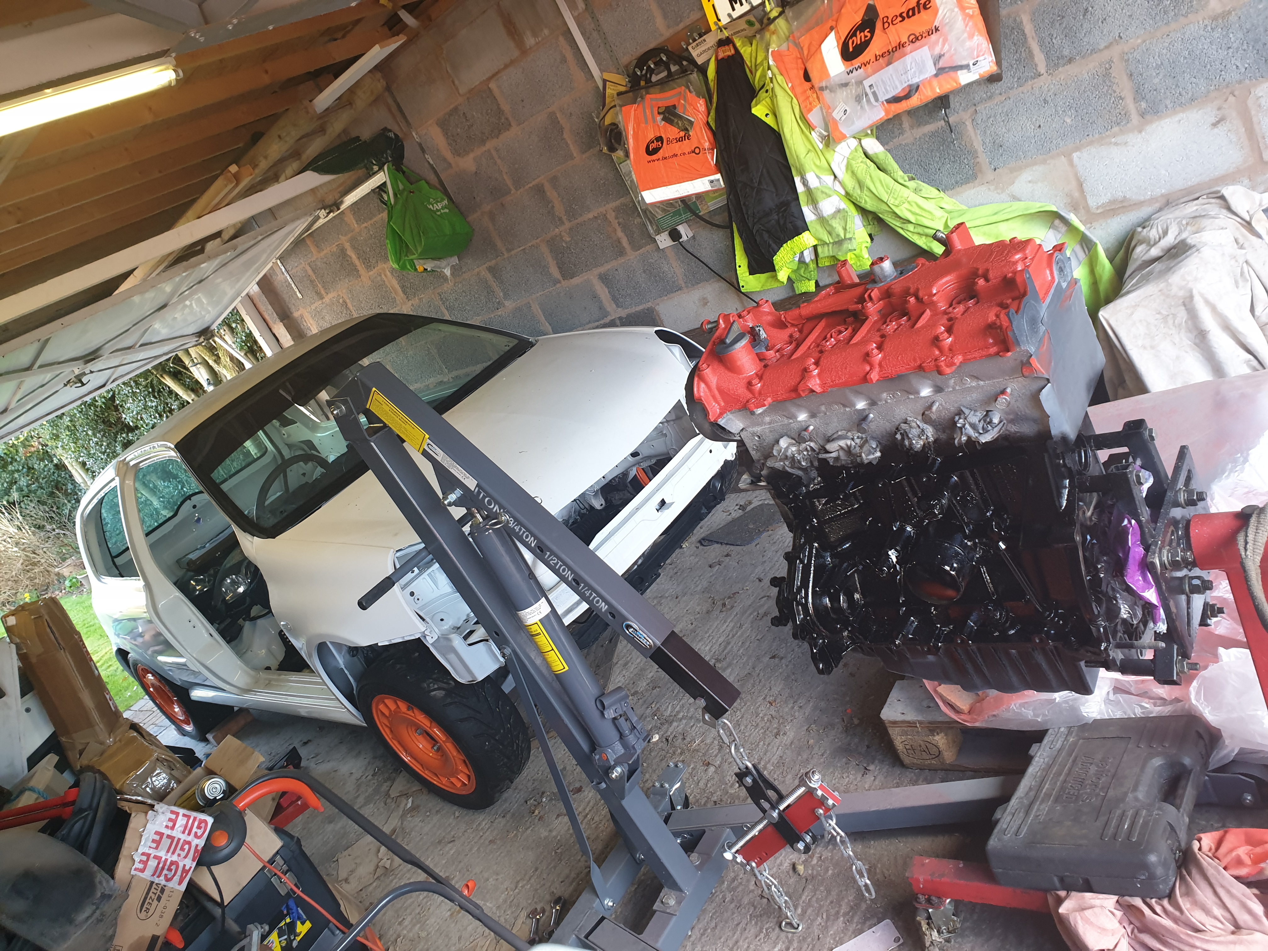

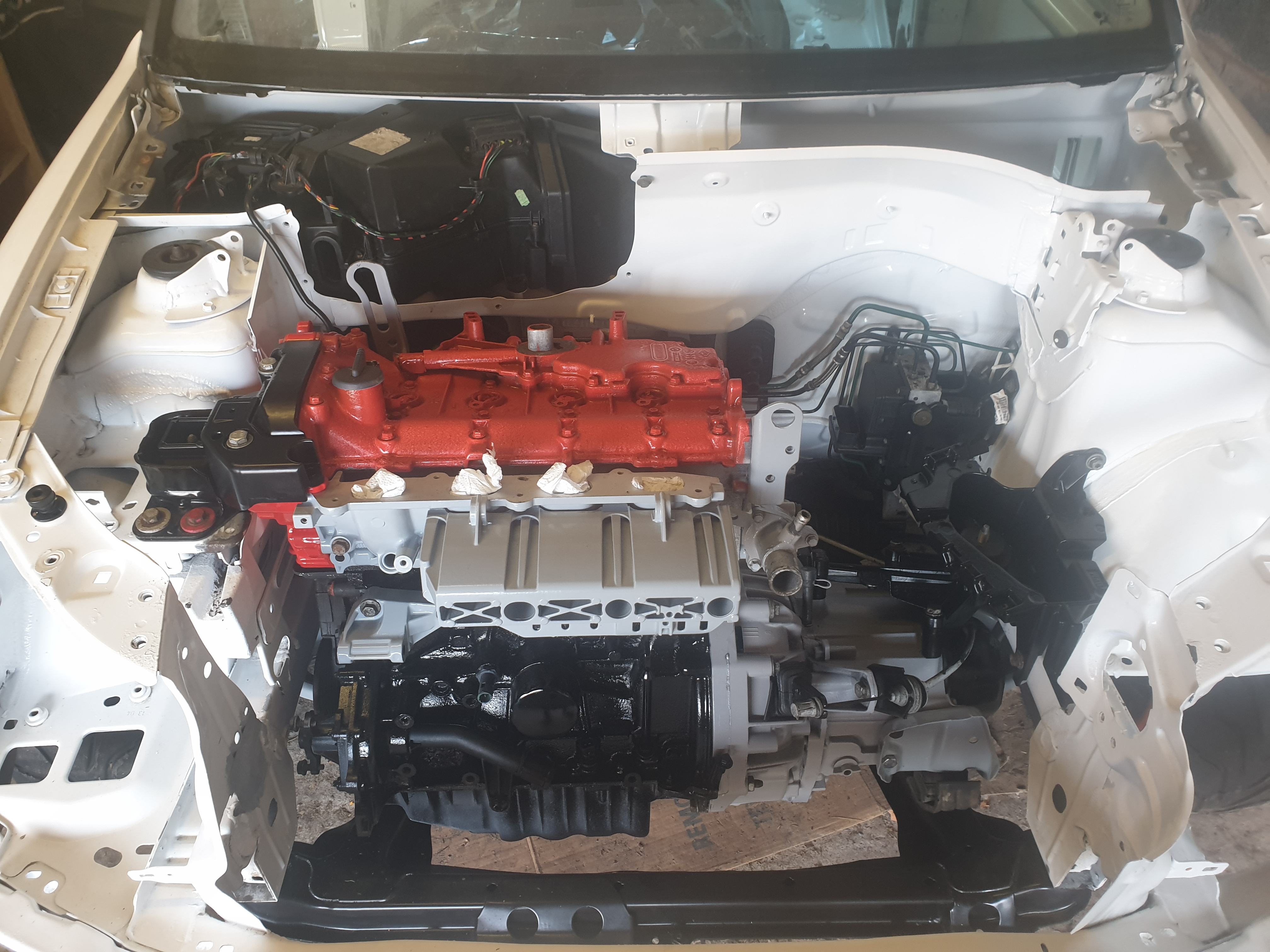

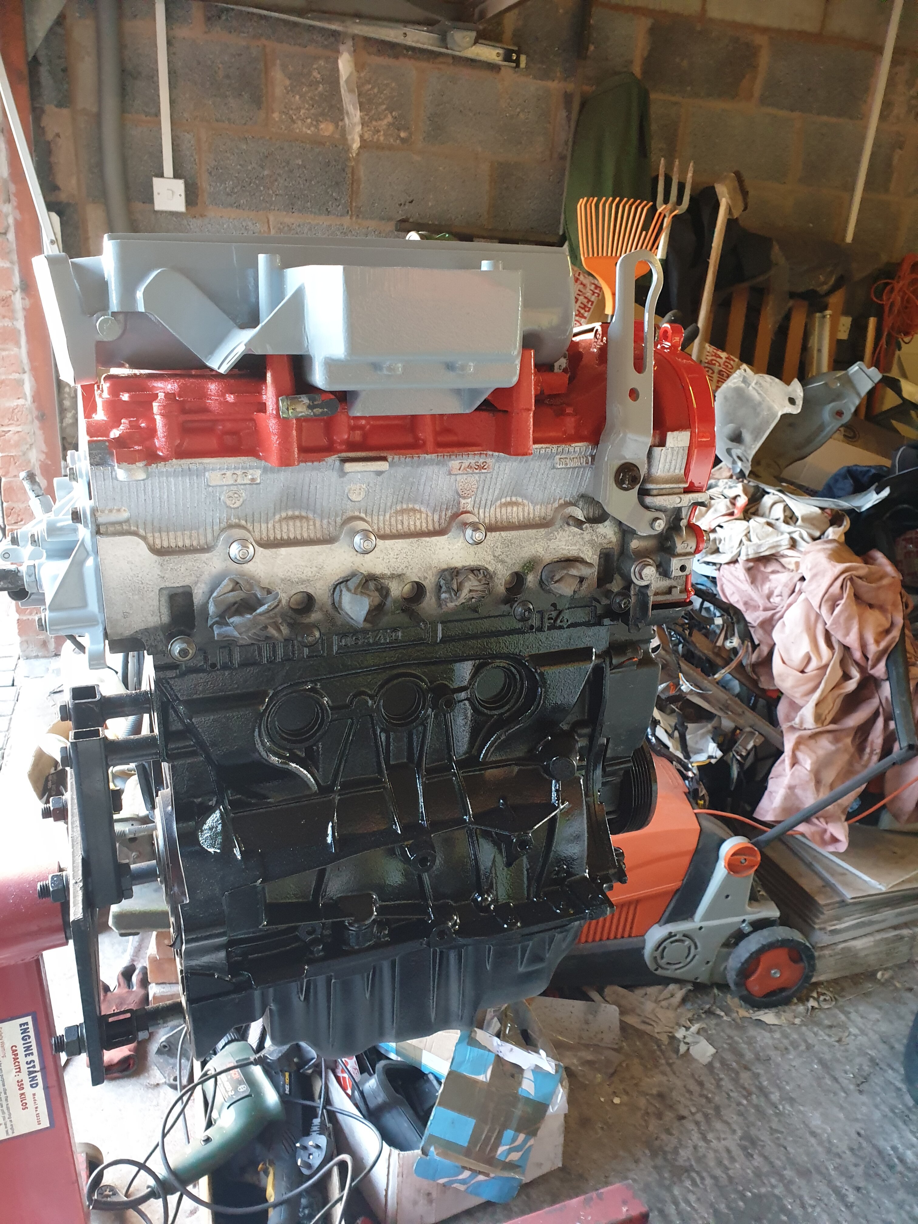

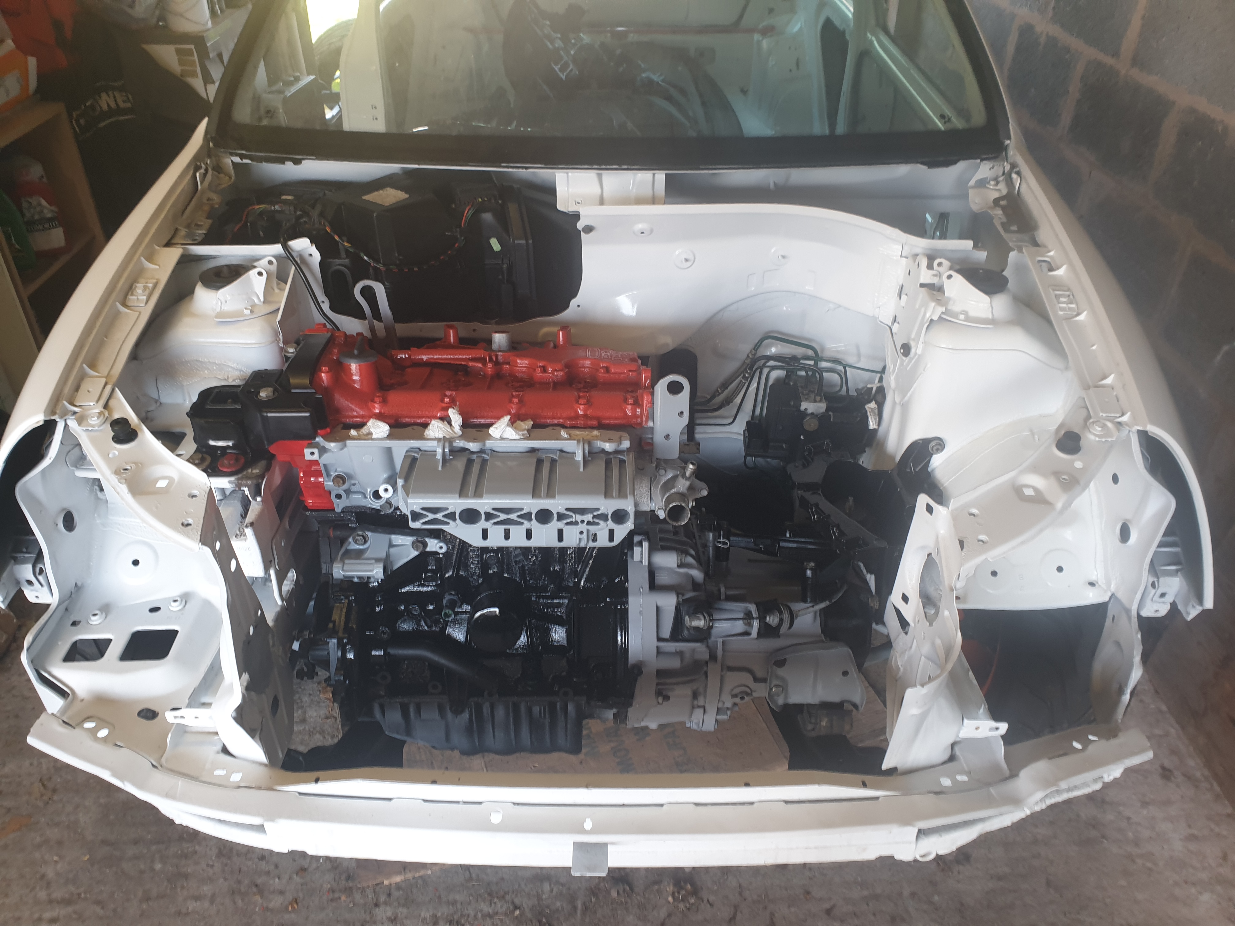

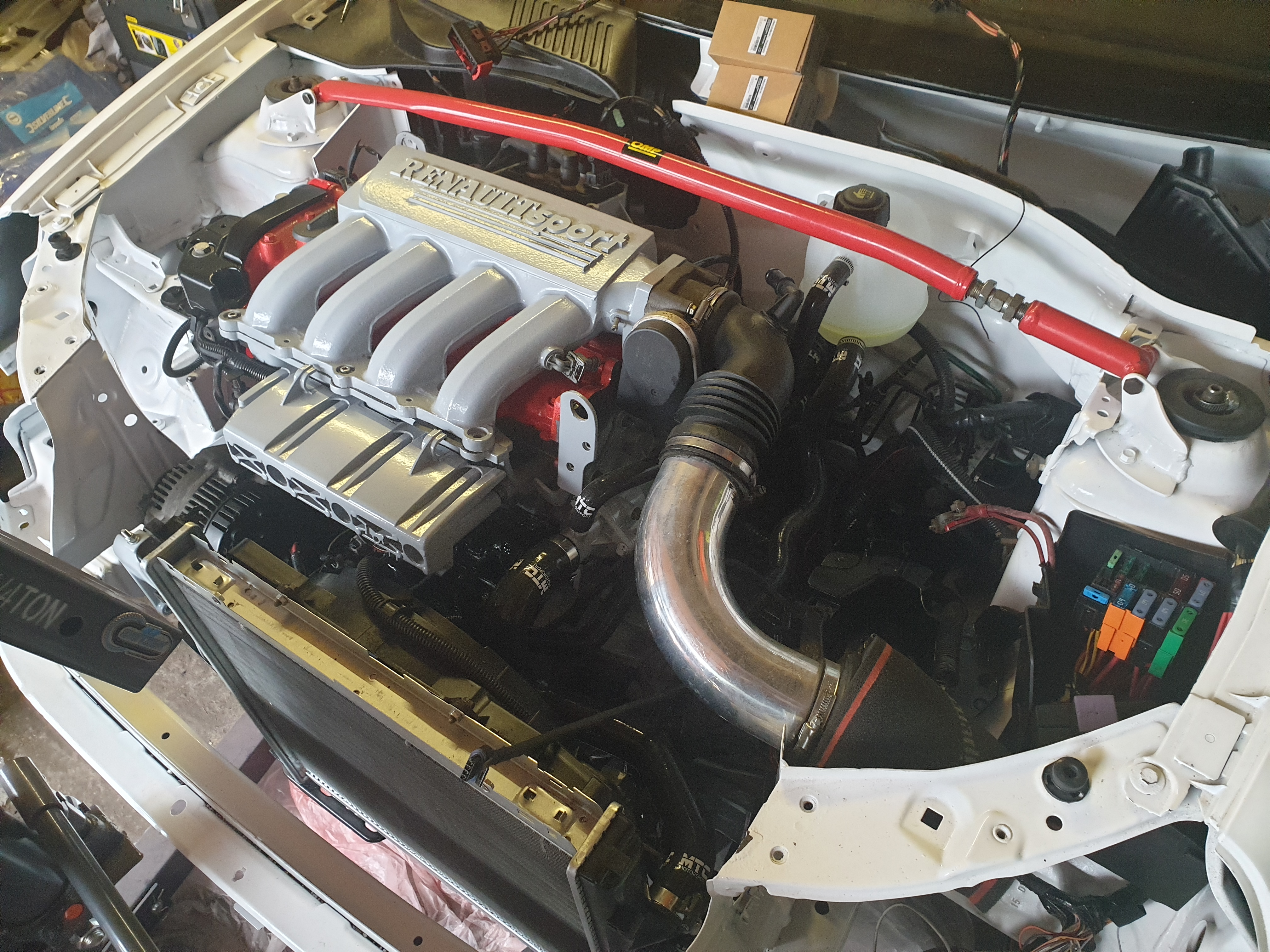

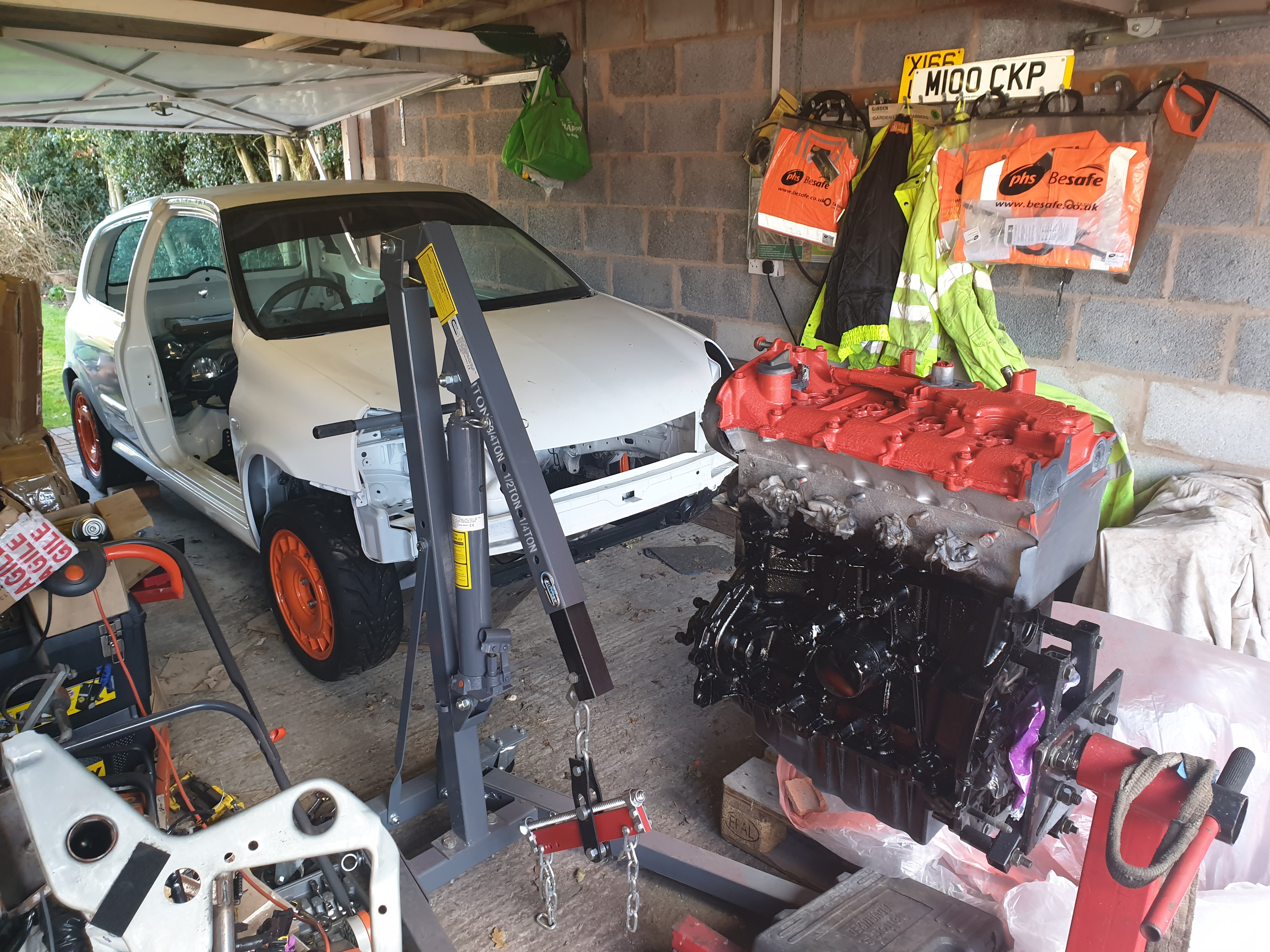

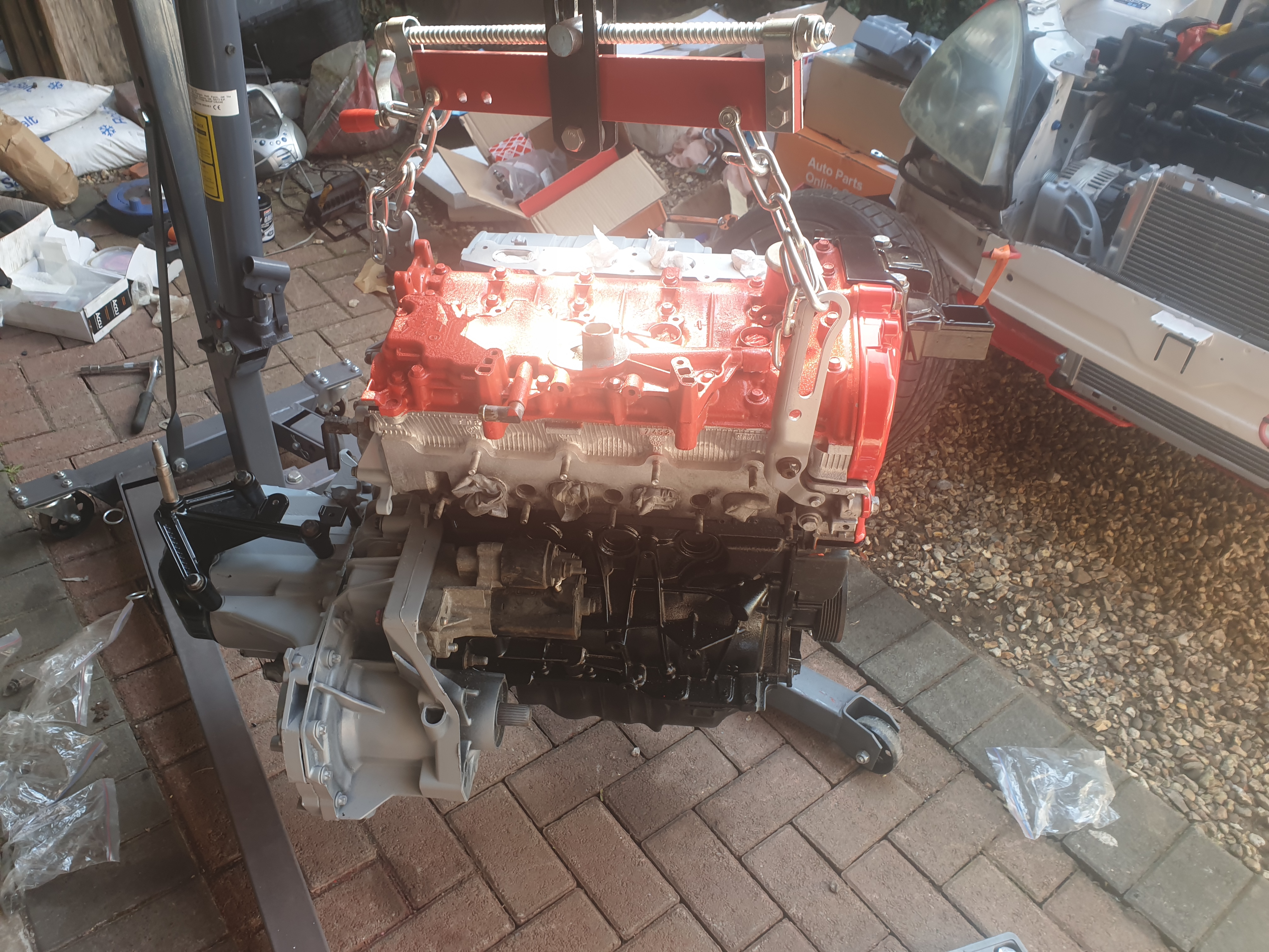

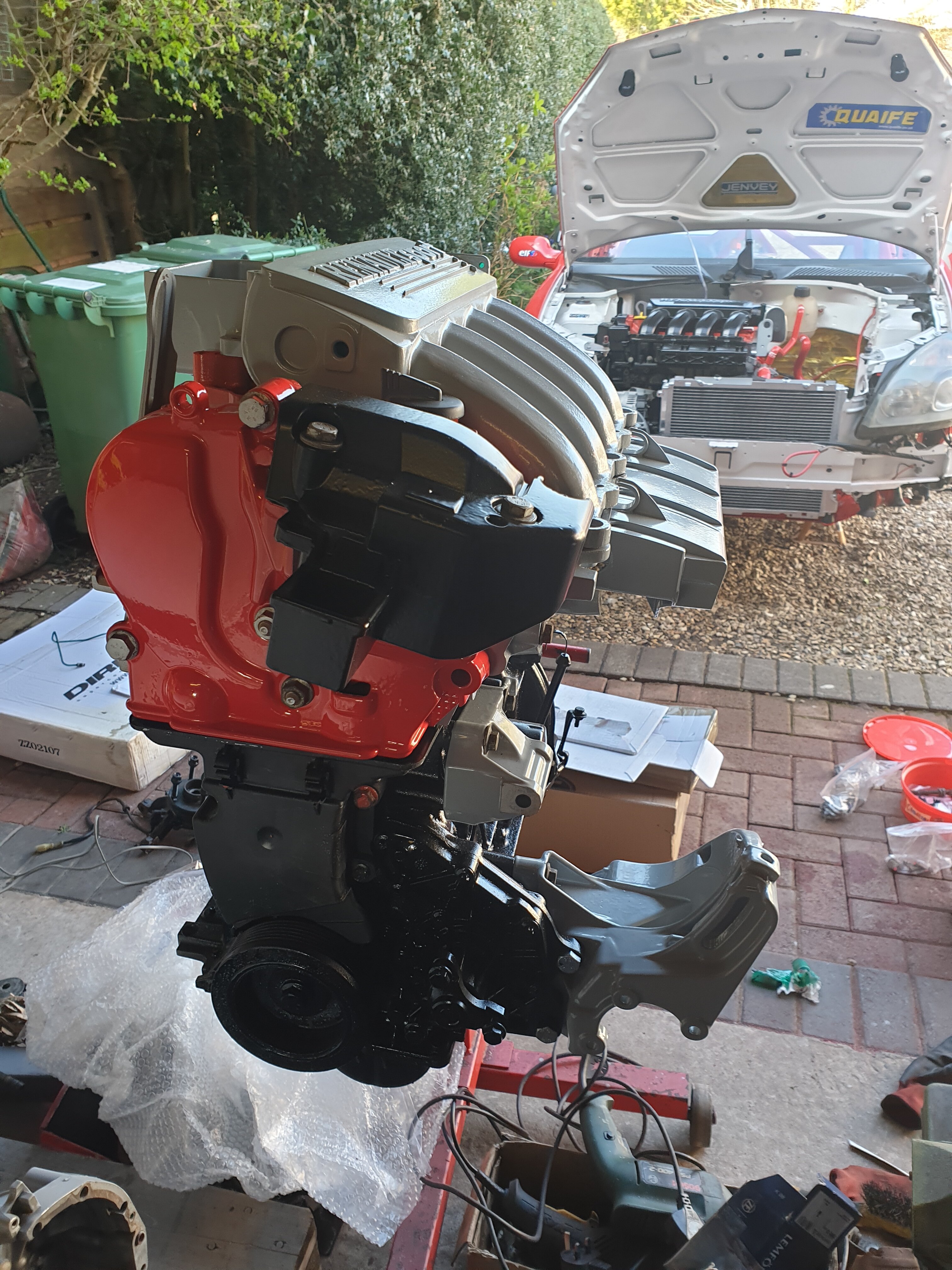

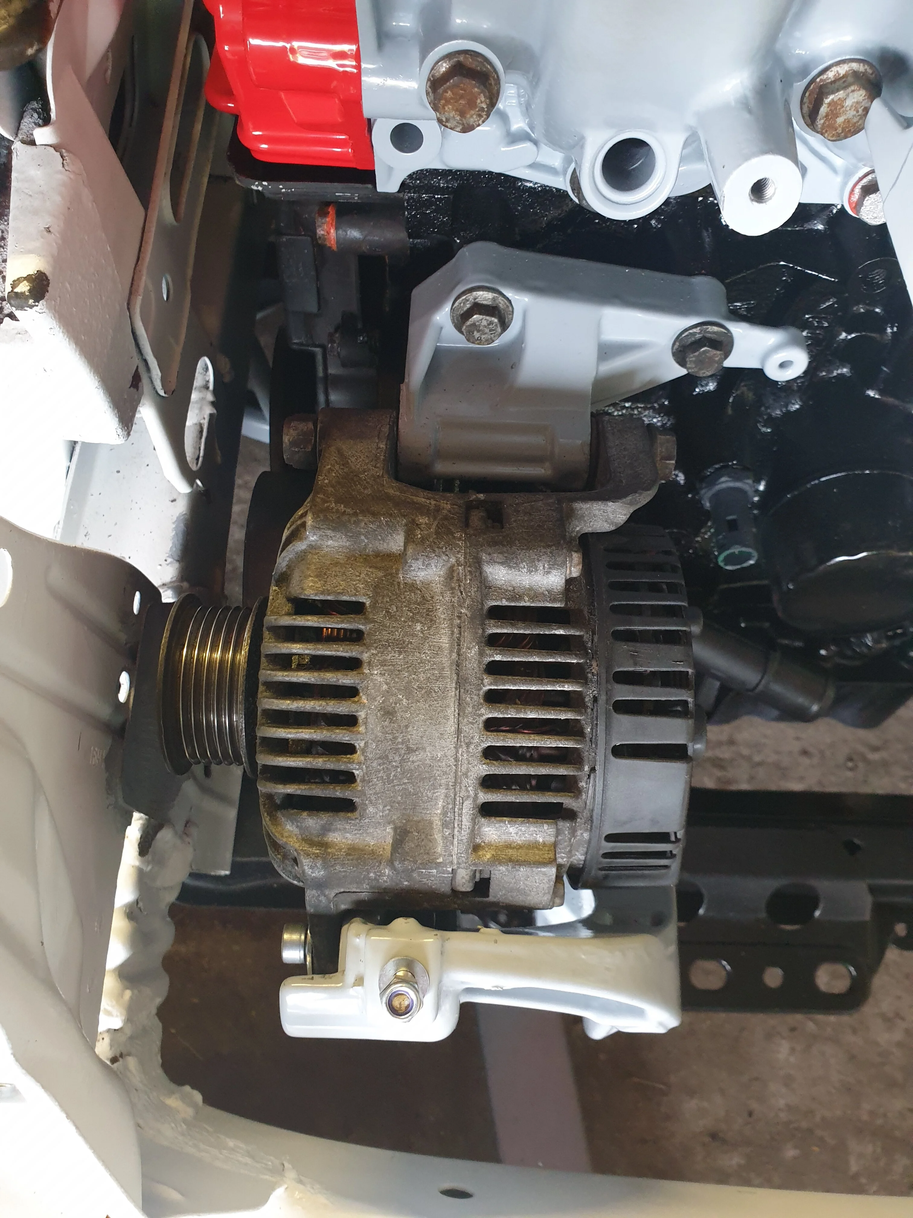

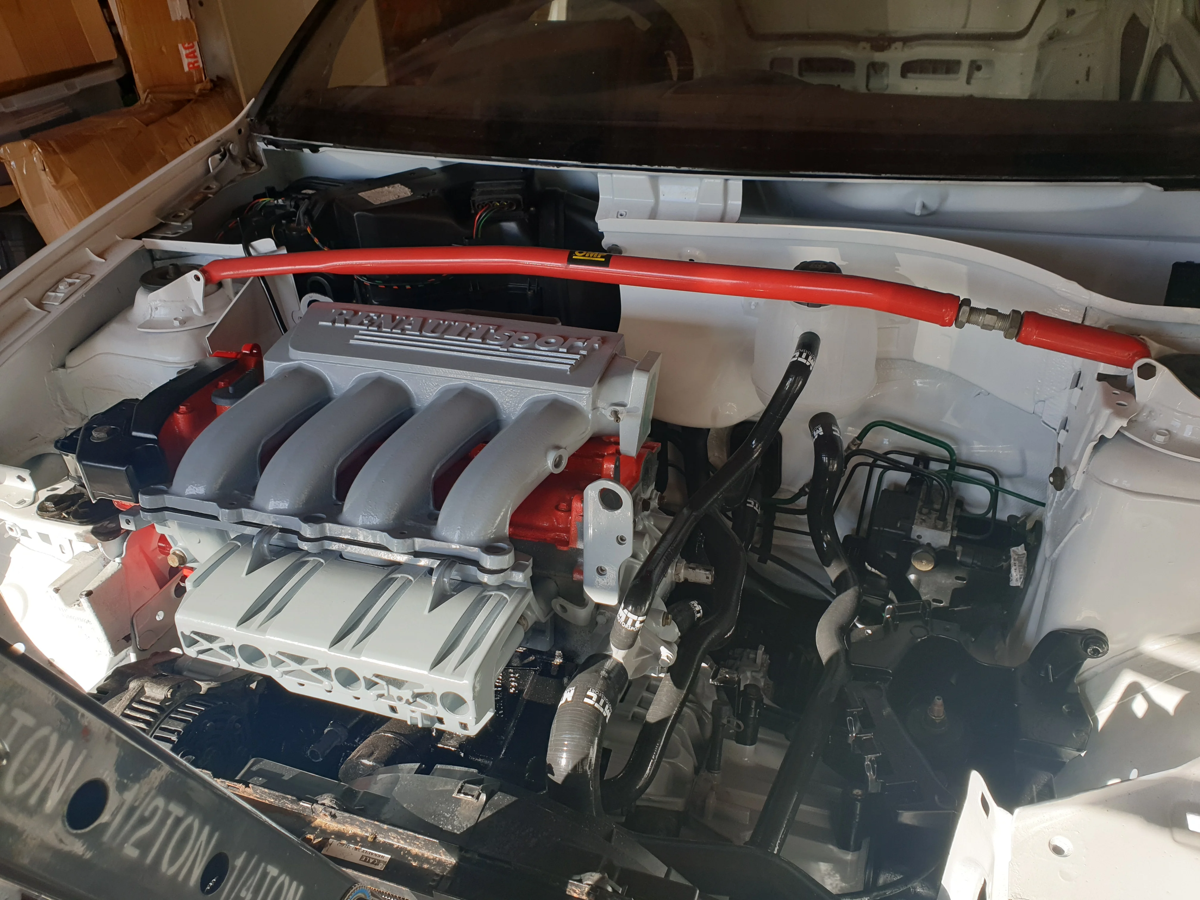

Today was the day to get the flywheel , clutch and engine and geaebox fitted as the mrs started back at work so i get a full saturday in the garage 😂.

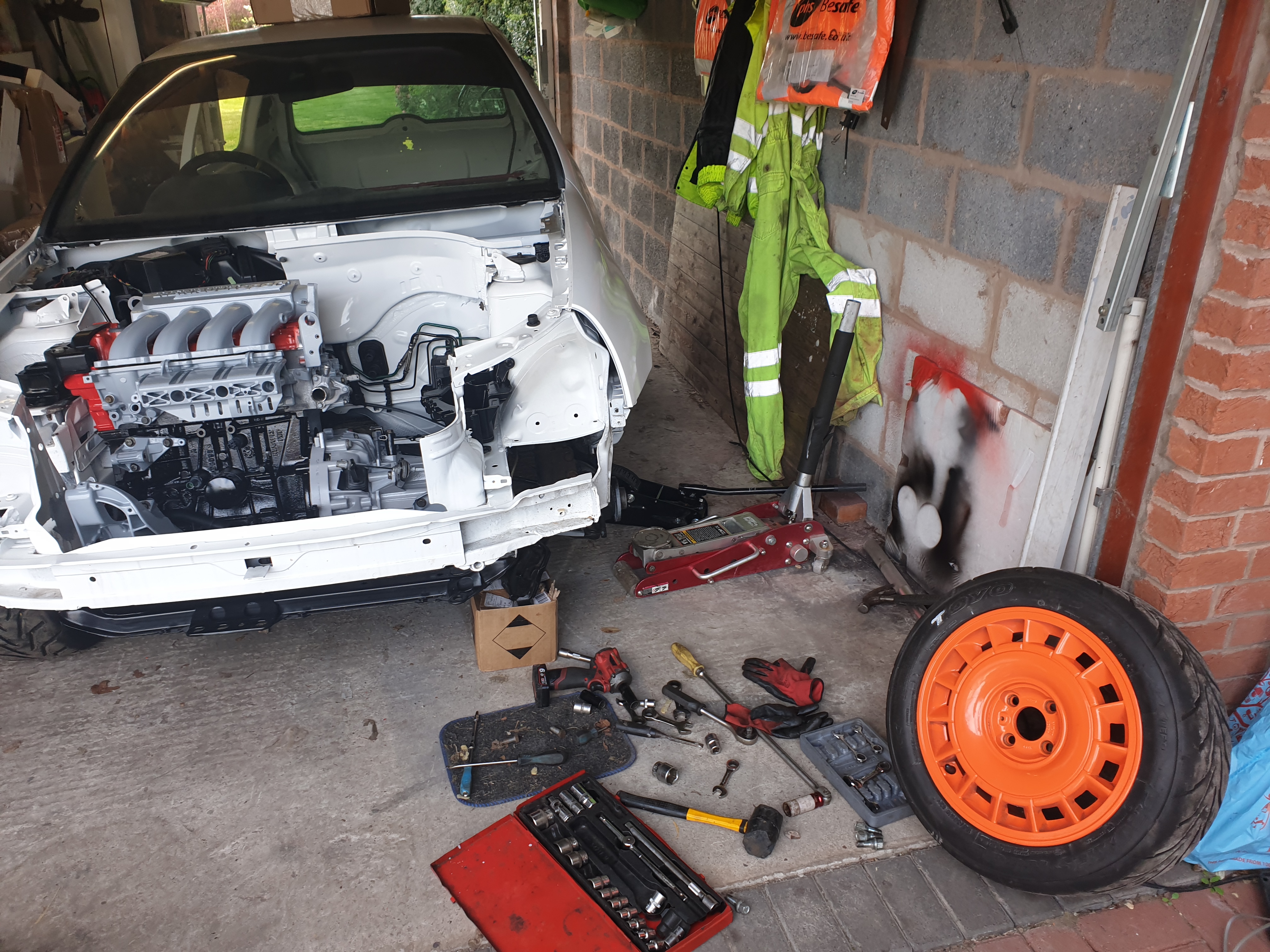

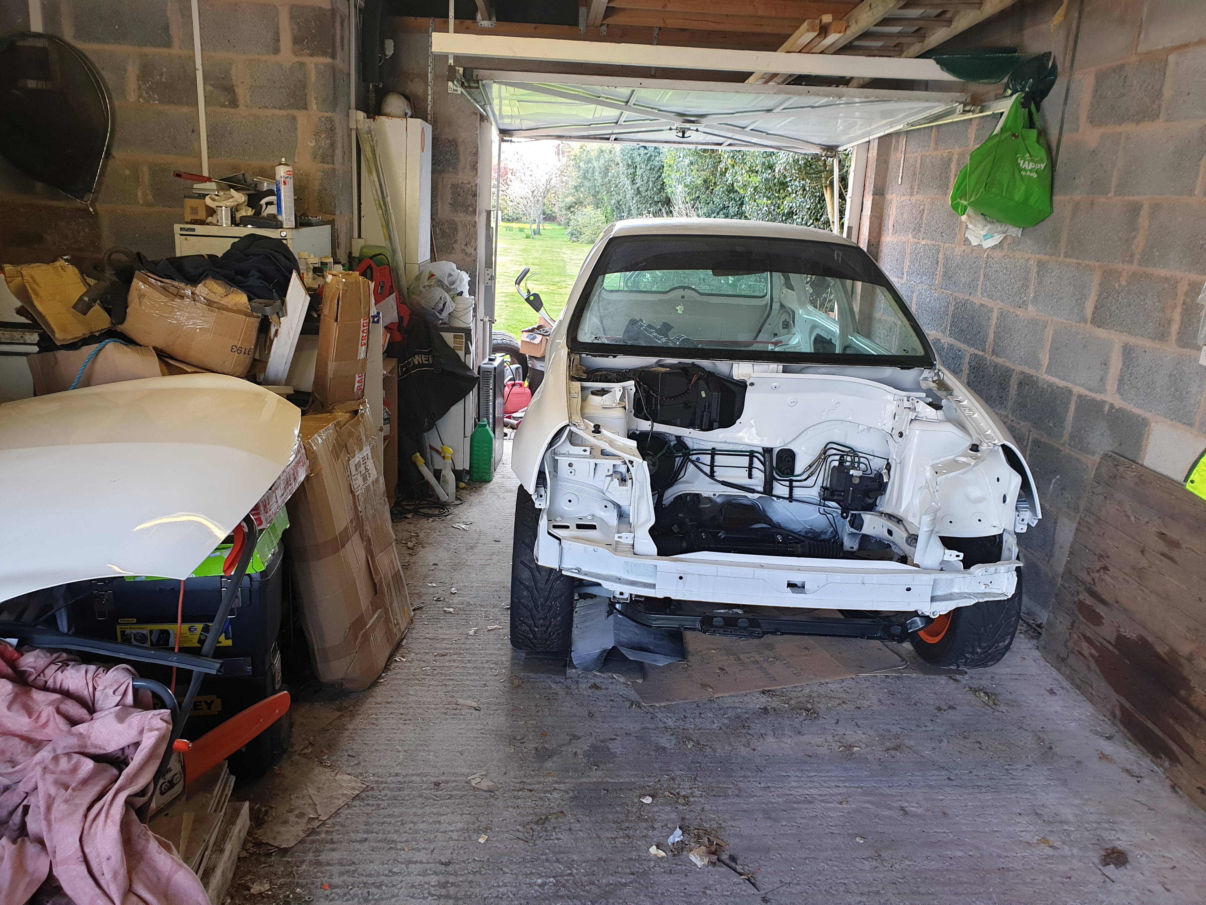

First thing was to make some space and get the garage cleared and the clio pushed back as far as possible to give some clearance height from the front garage door being open.

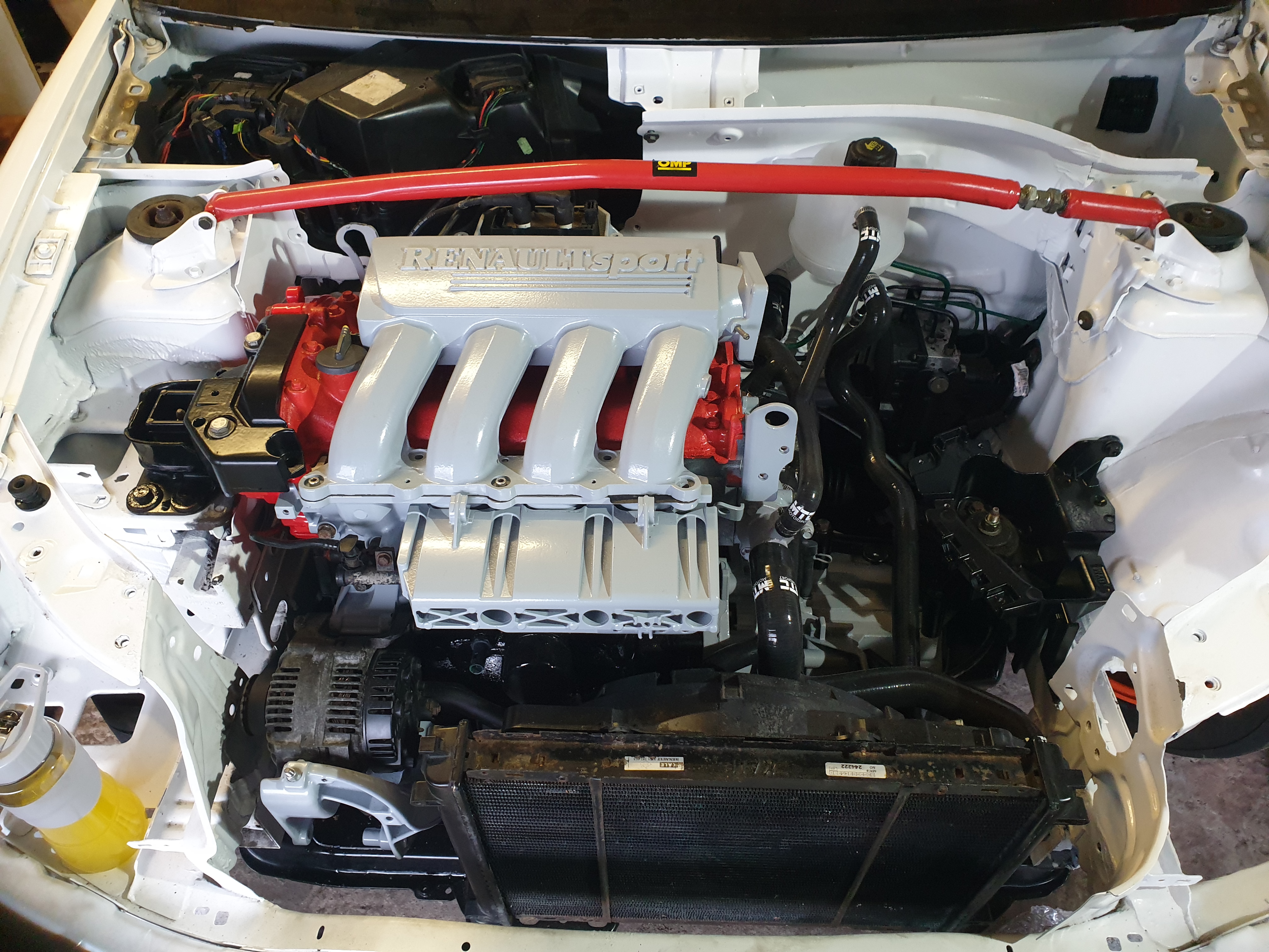

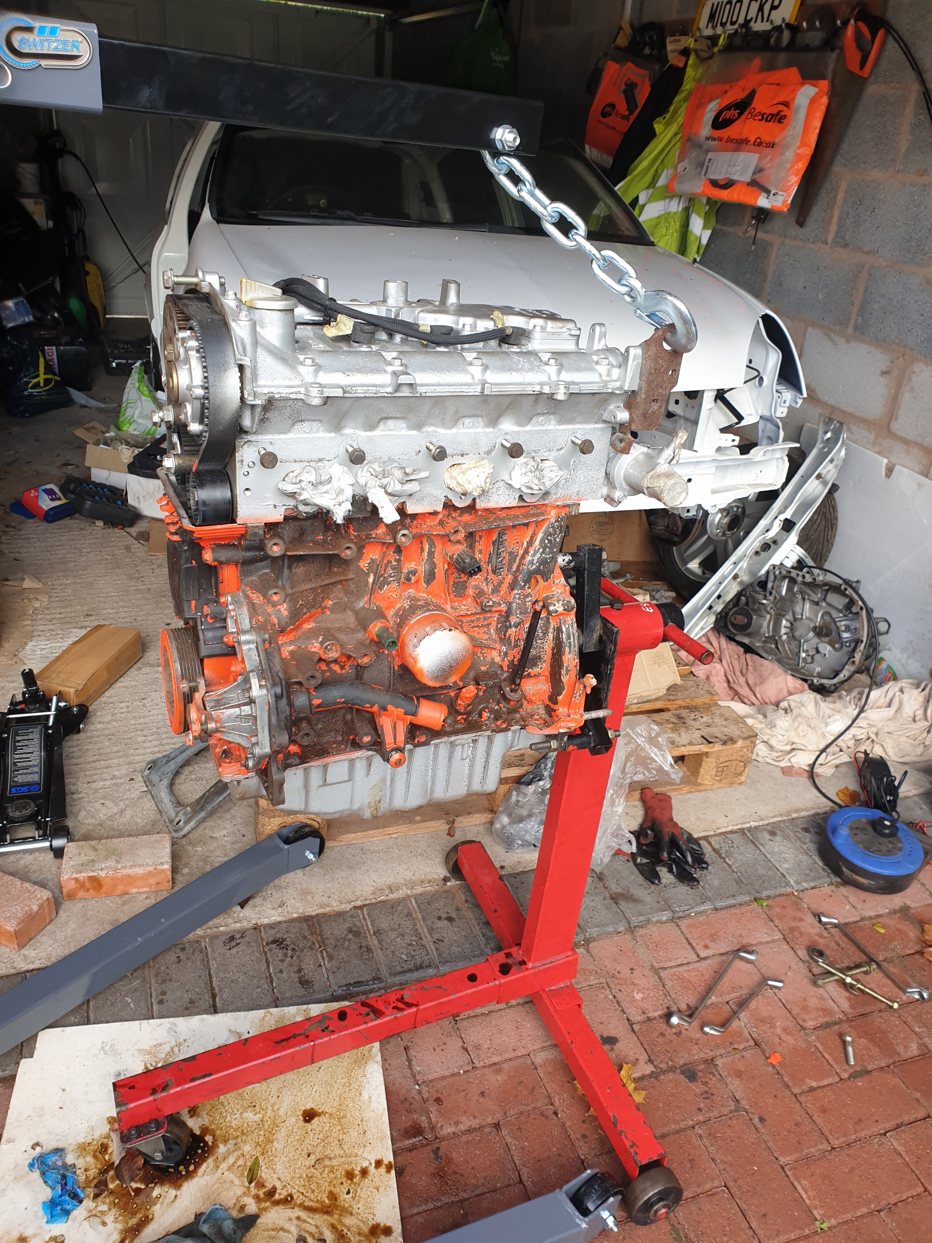

Engine and gearbox ready to go in.

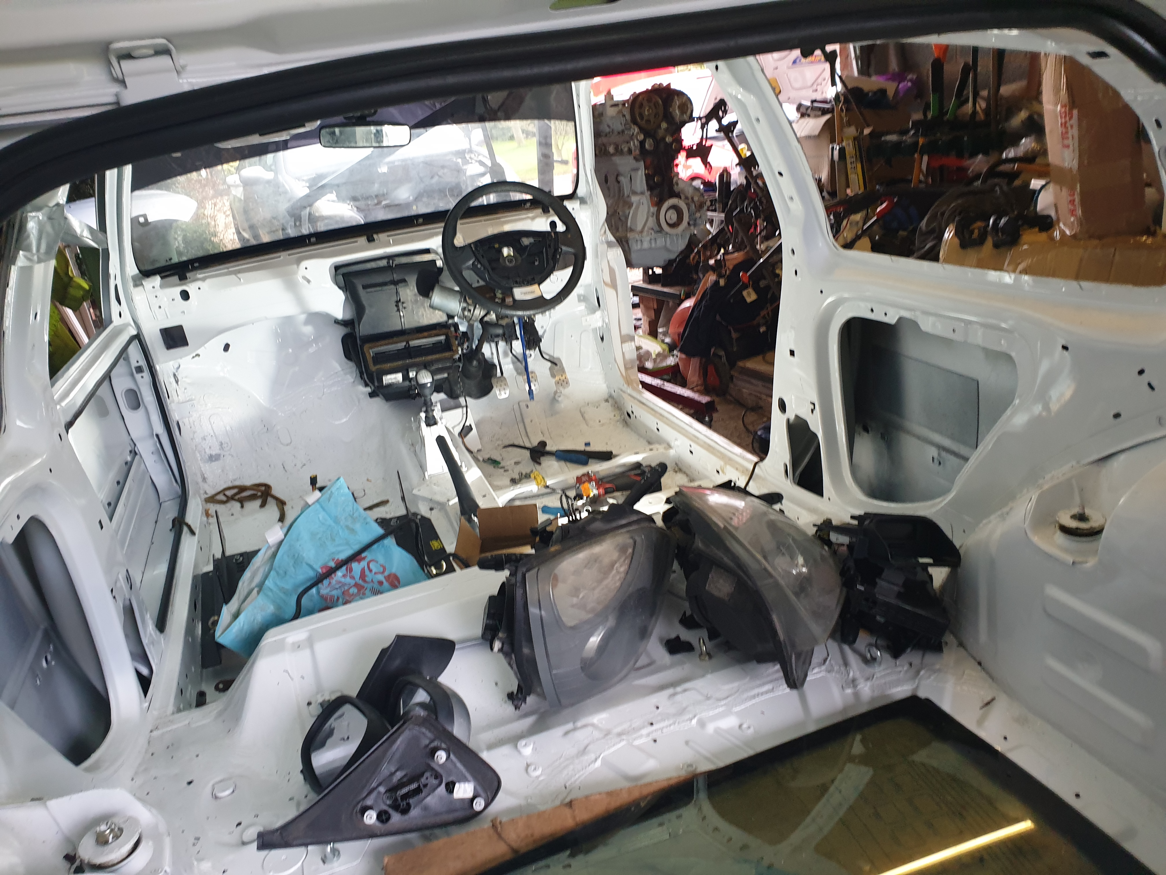

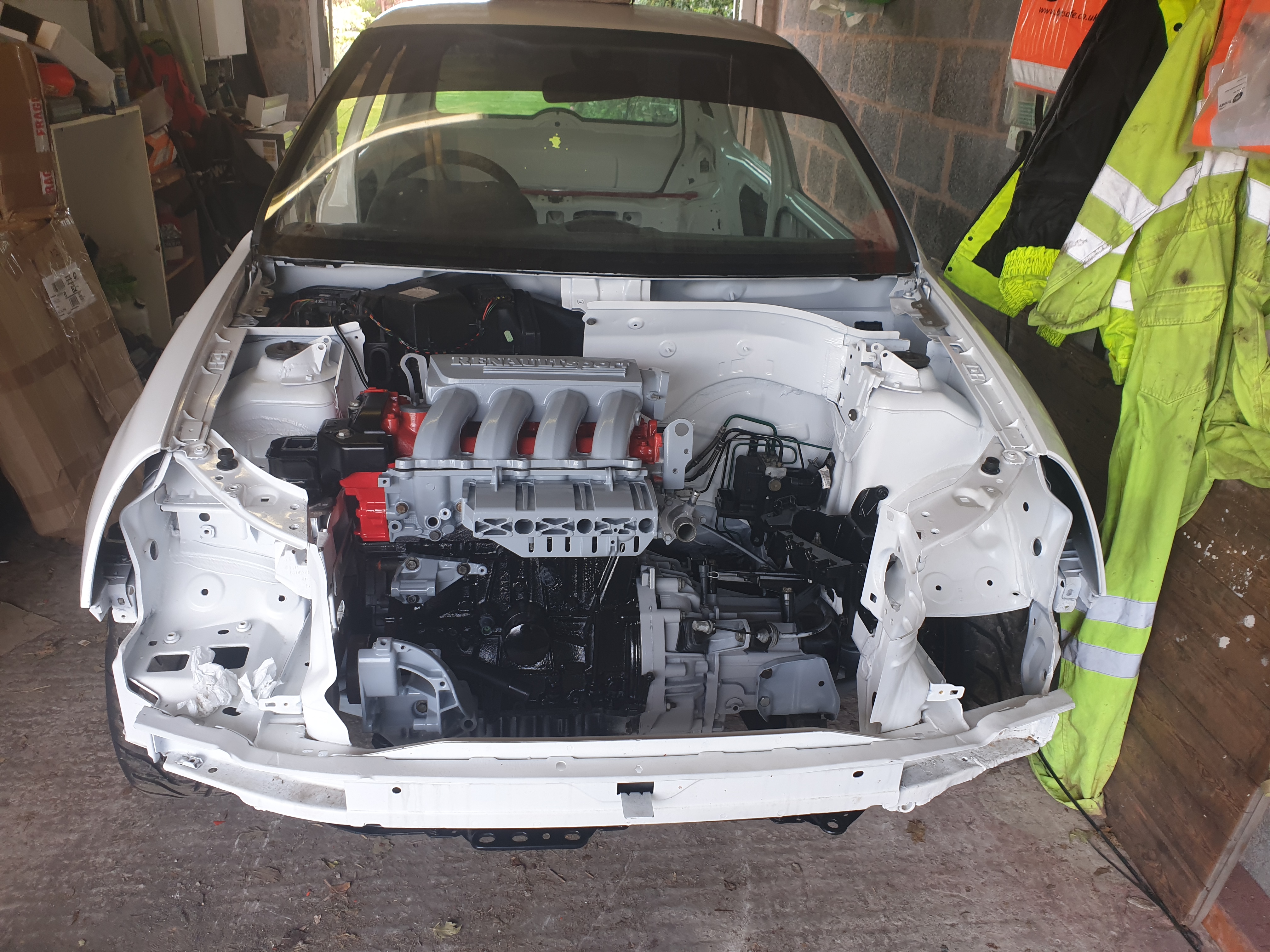

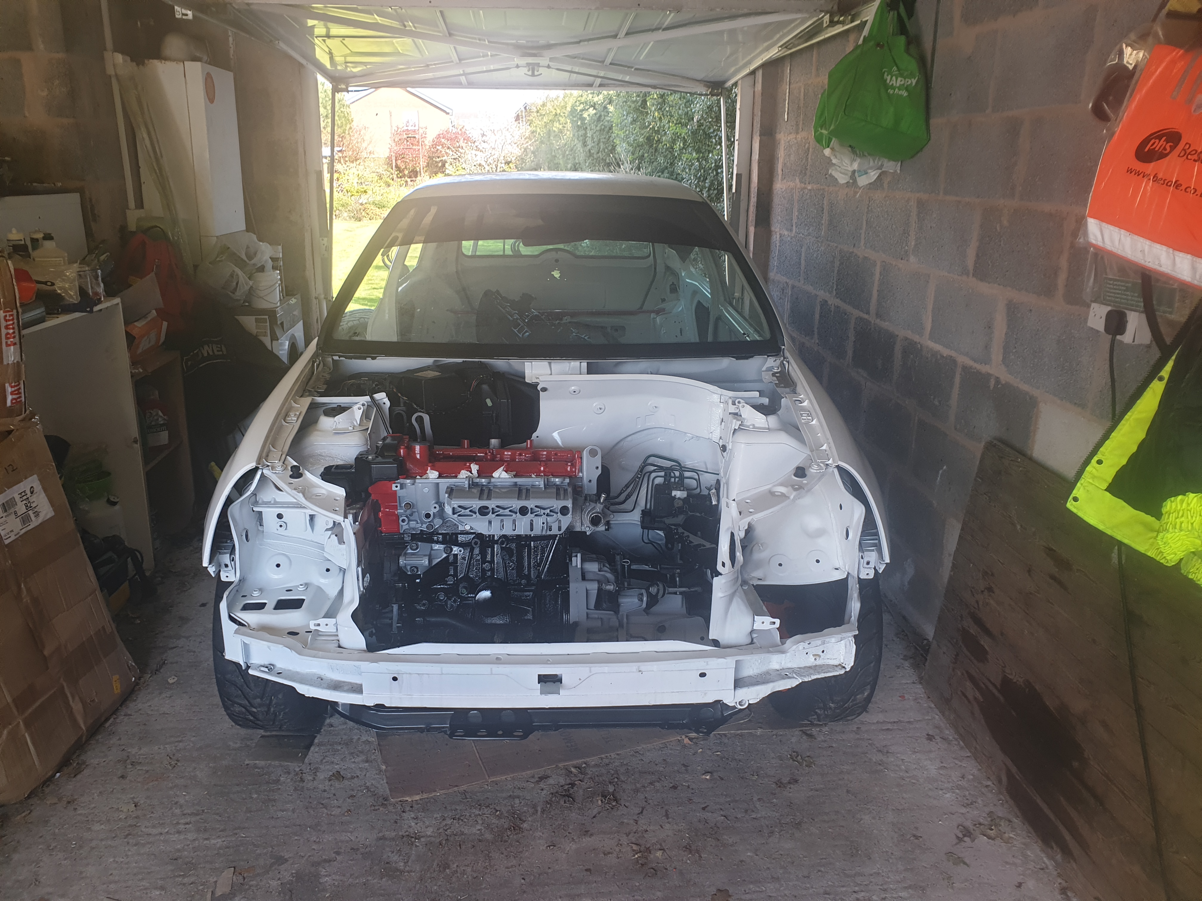

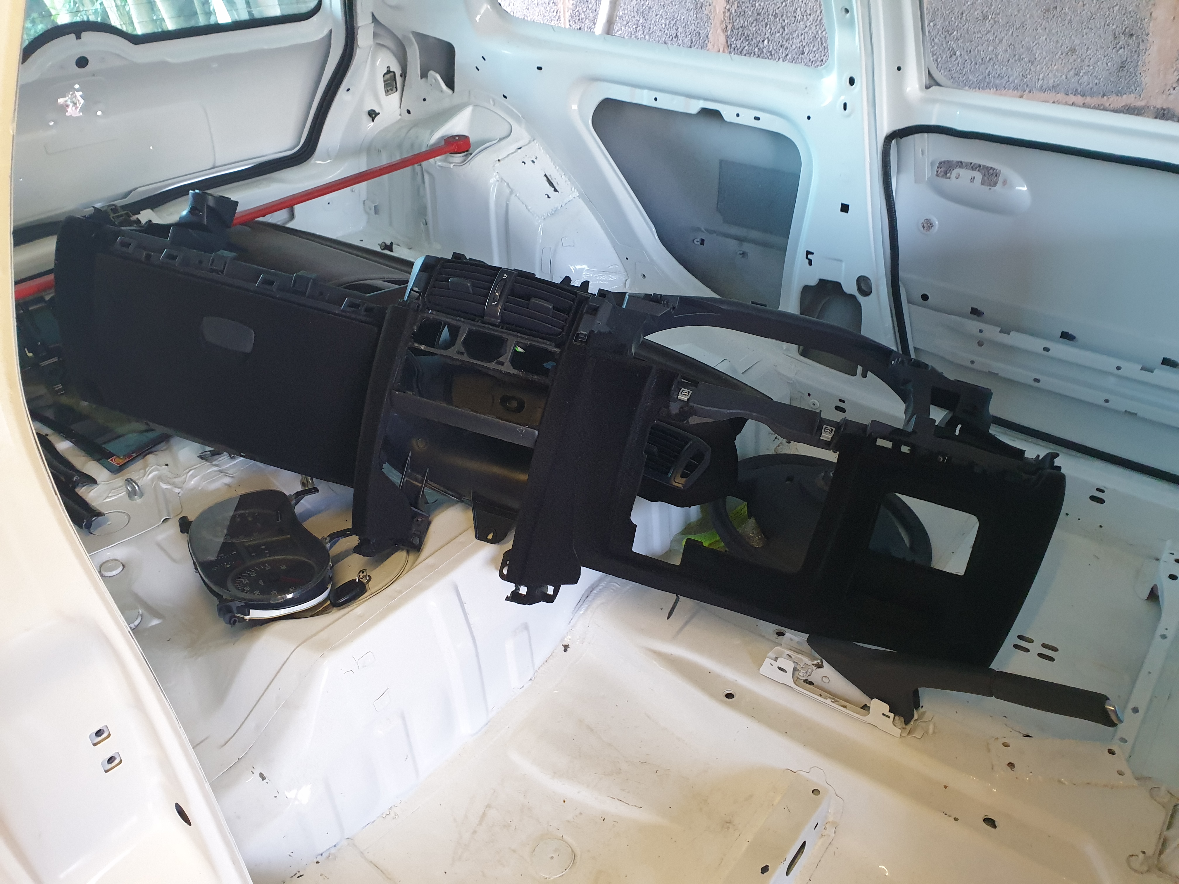

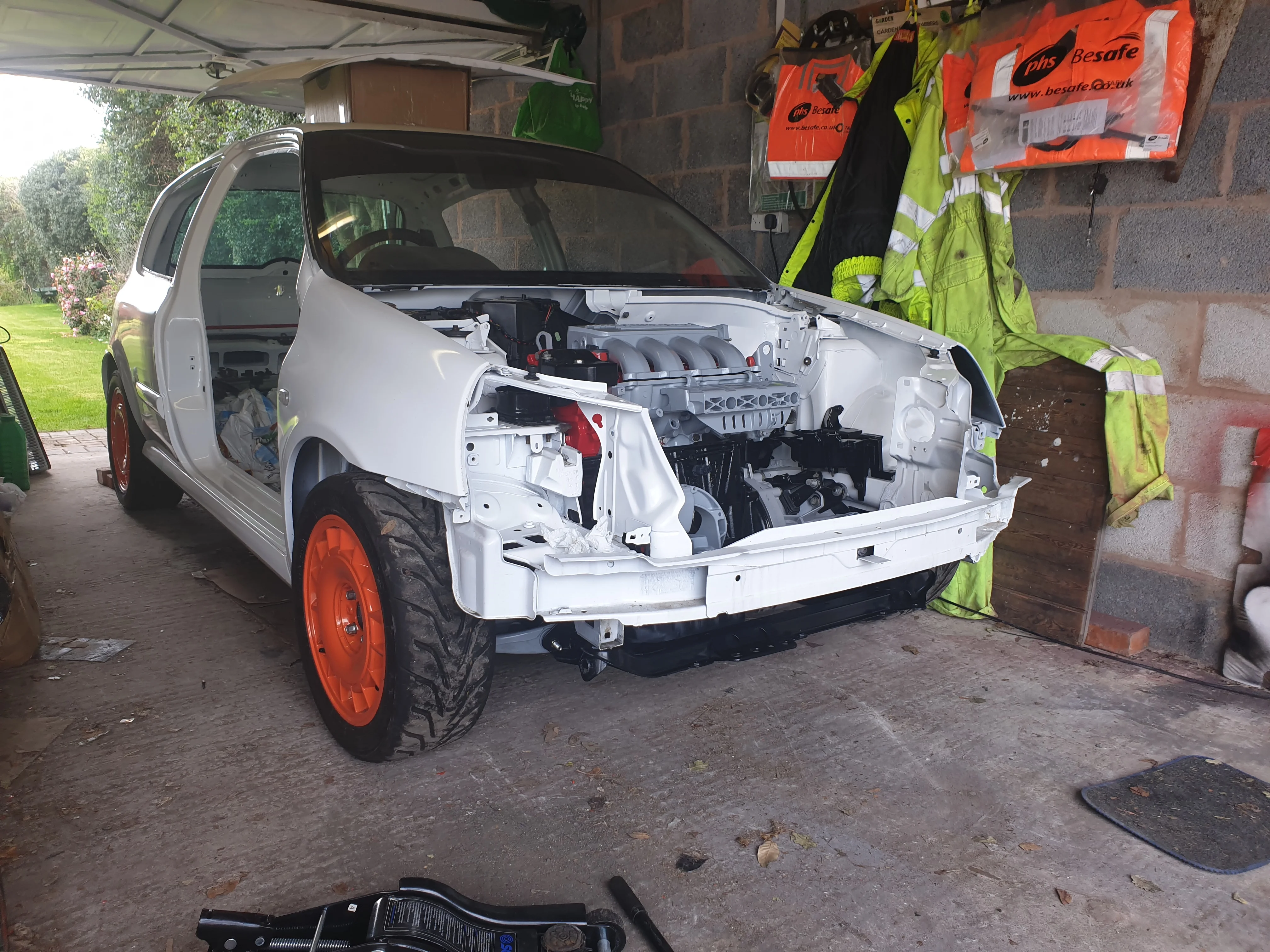

Finally in position , will have abit more room now ! Can finish stripping whats left on the iceberg , need the drivers door and glass from the doors unless i go poly windows.

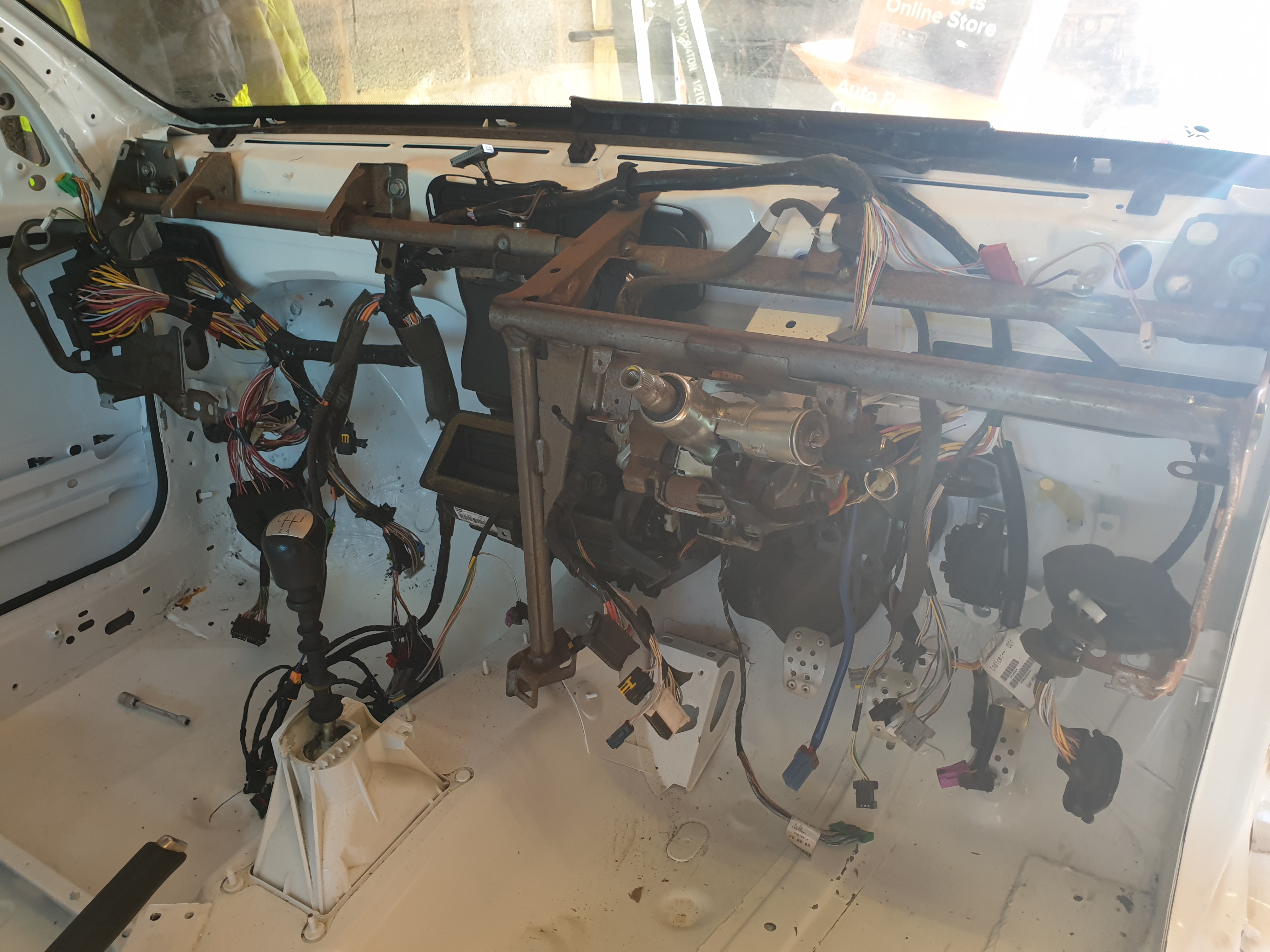

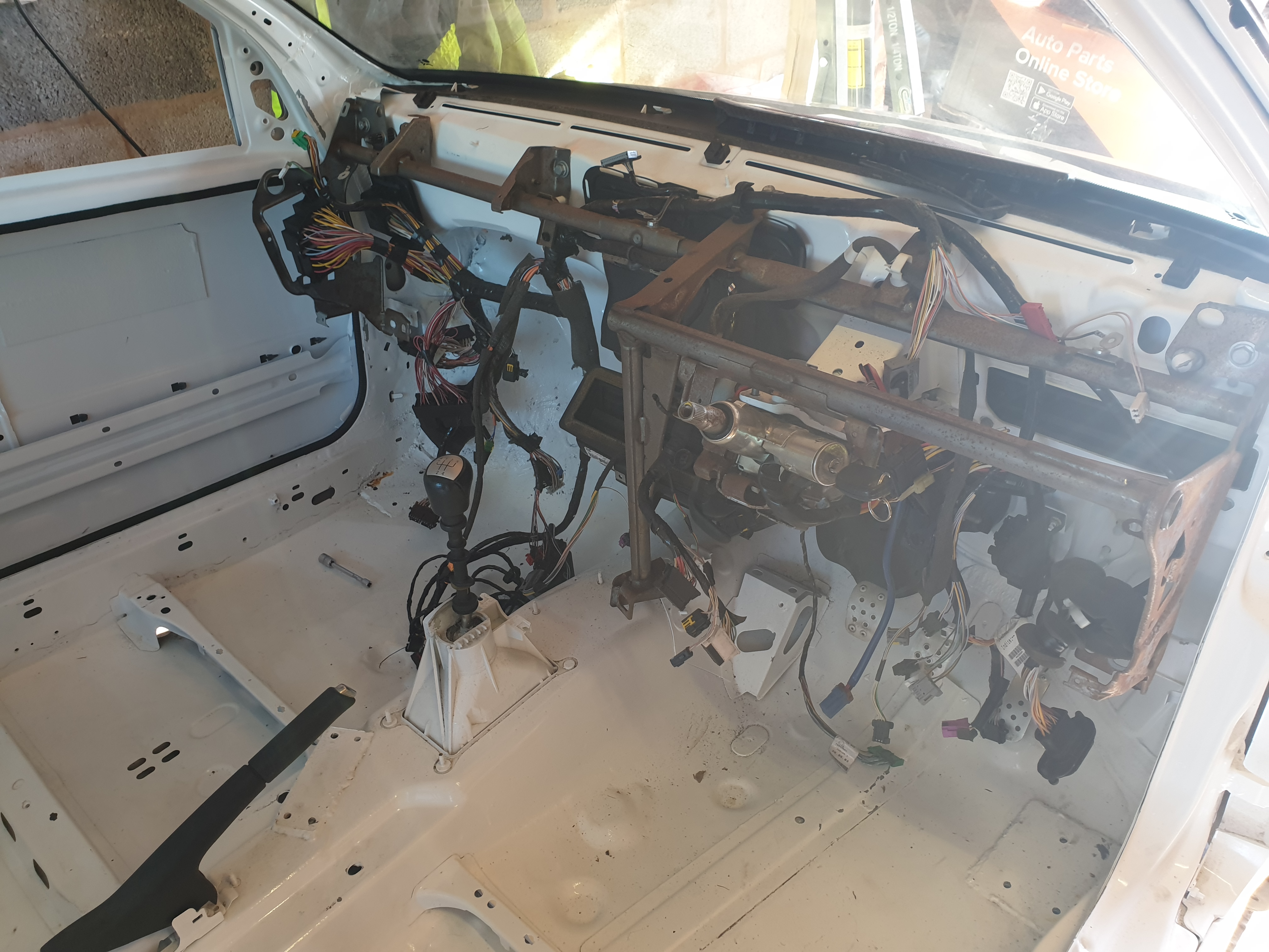

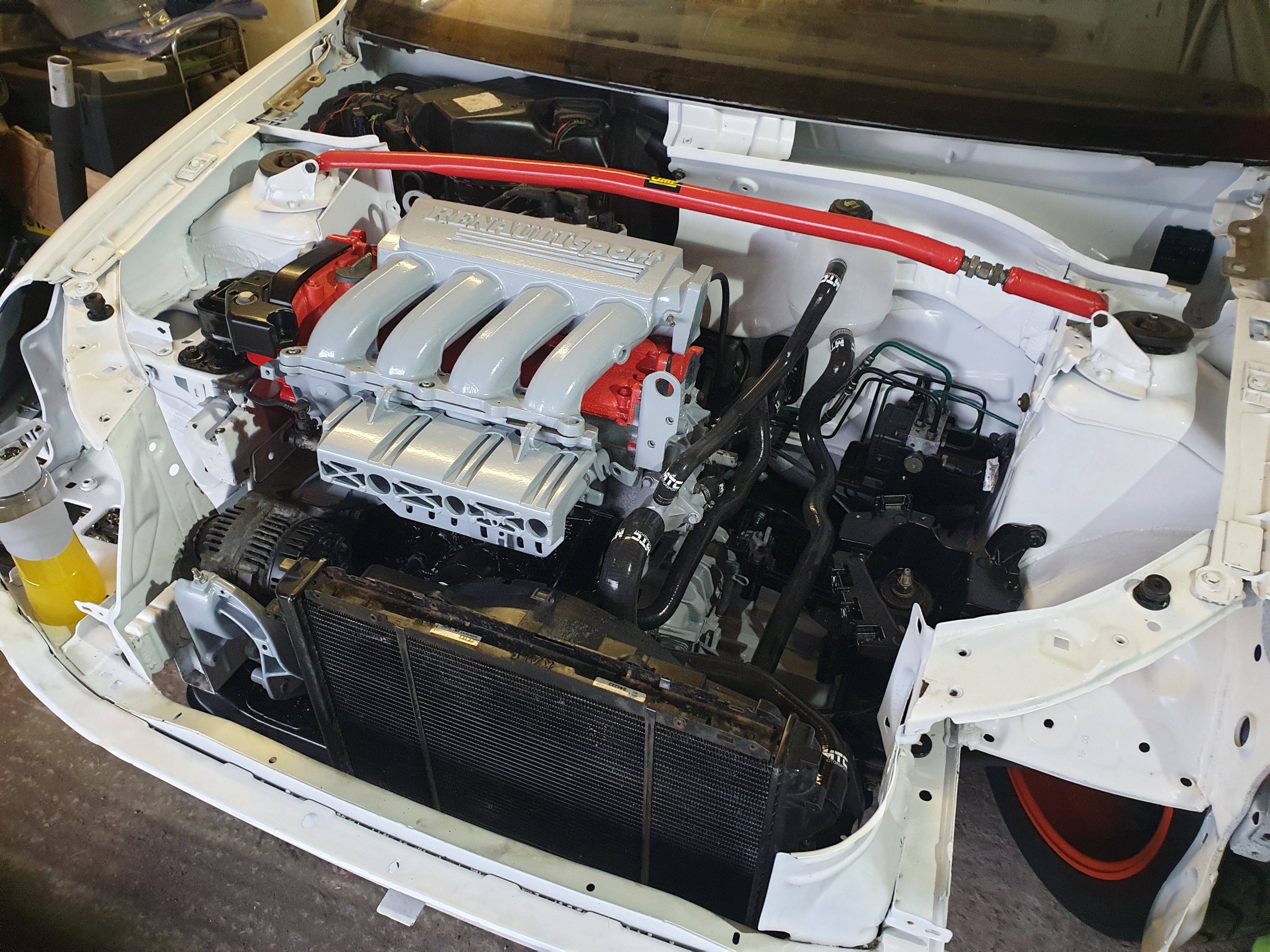

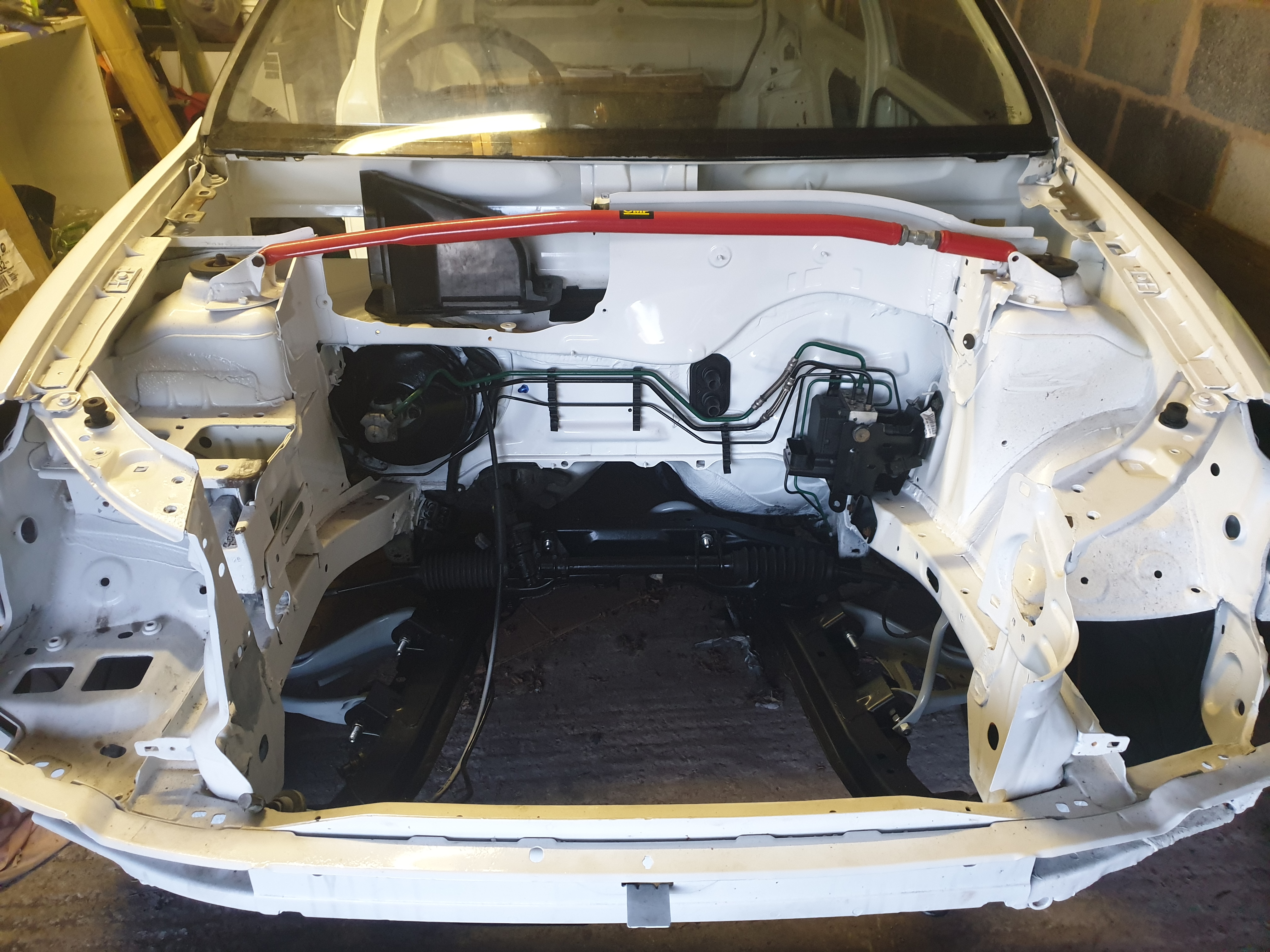

Looks like ive done something but this car was a bare shell , no fuel lines , no brake lines , no wiring looms etc plus the other build and lack of time but happy its in !

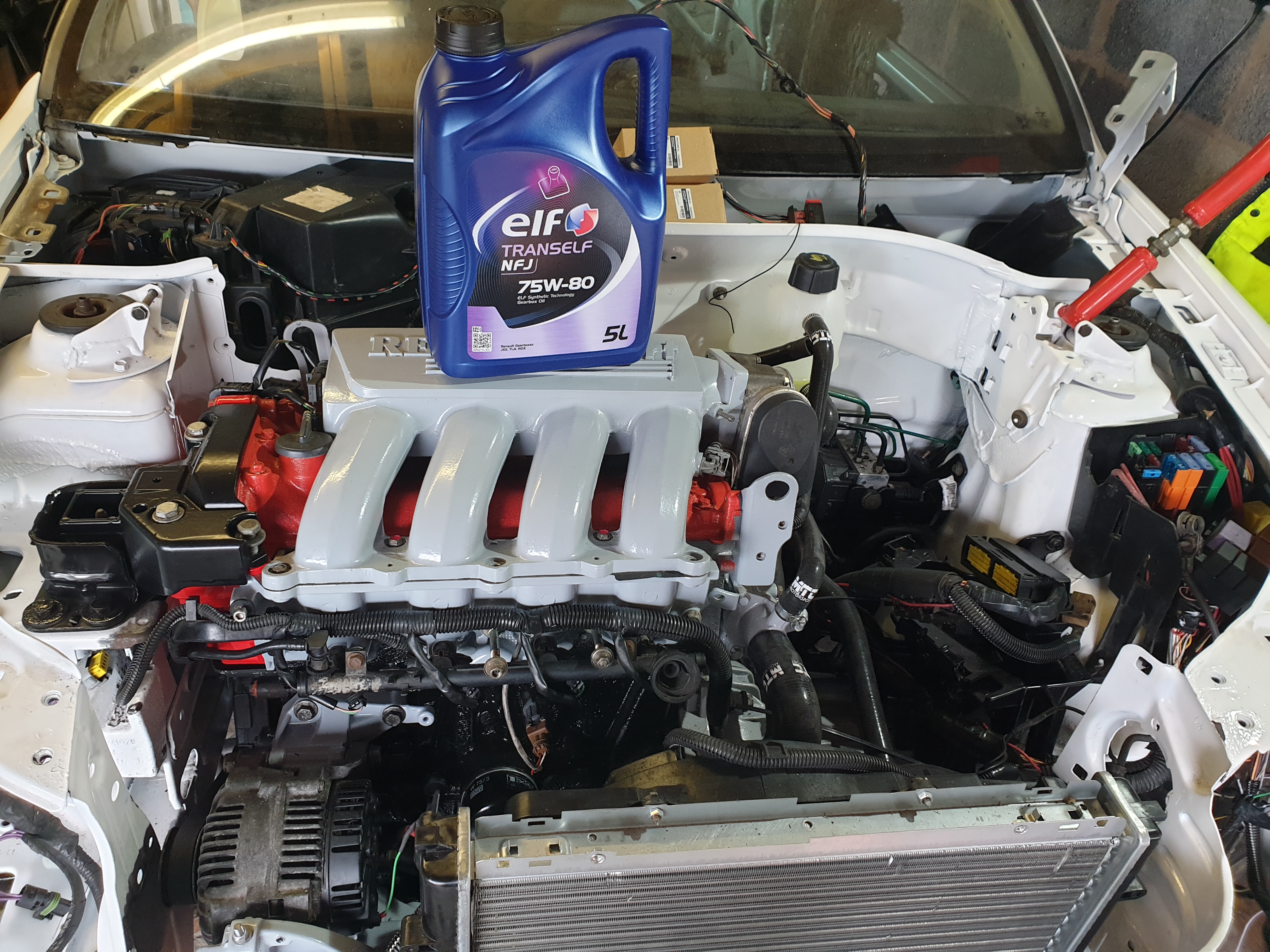

Painted the bolts after it was fitted as the pink bolt was annoying me 😂
Forgot to install the water pump pulley as it had been put away then i noticed it was bright 🍊😳😳🙈🙈

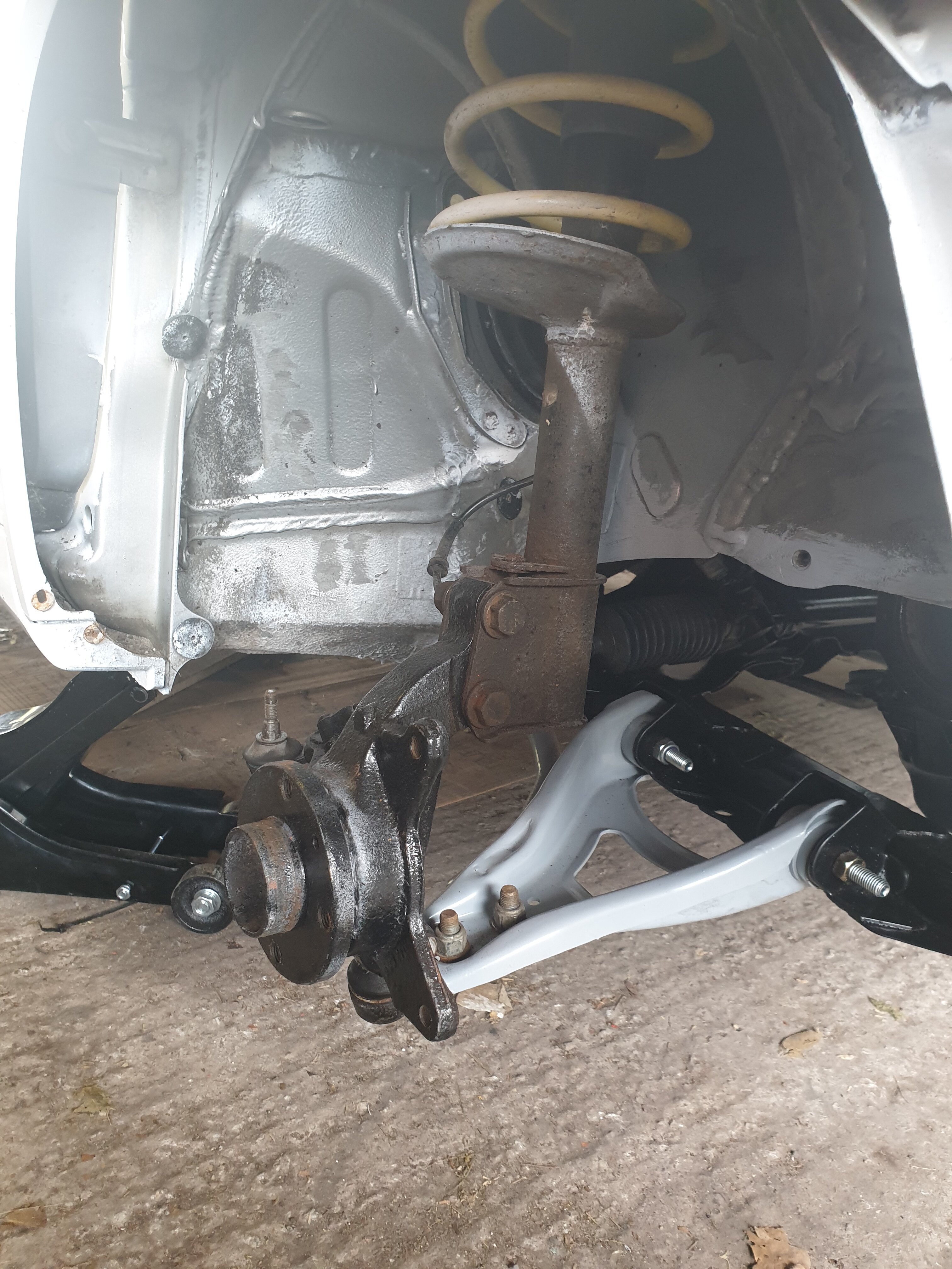

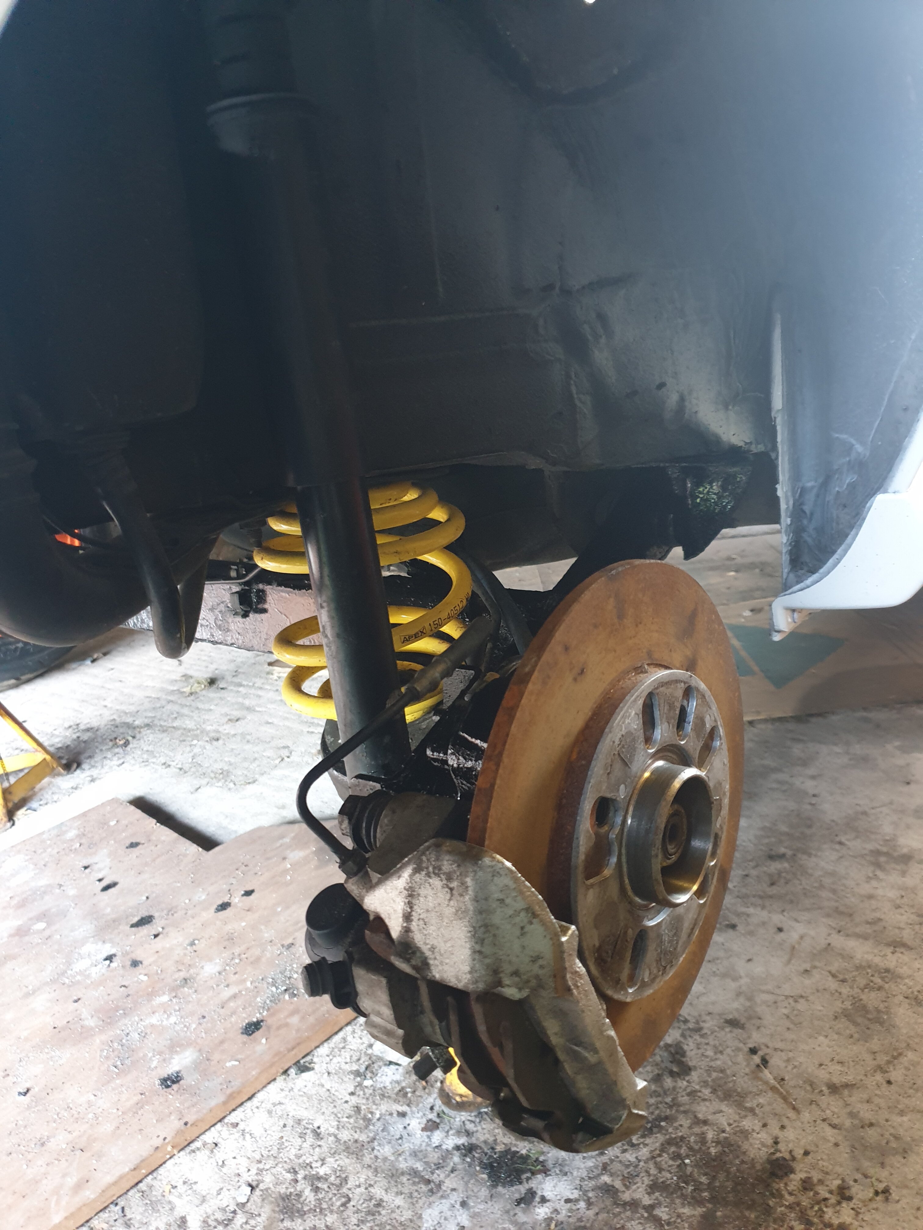

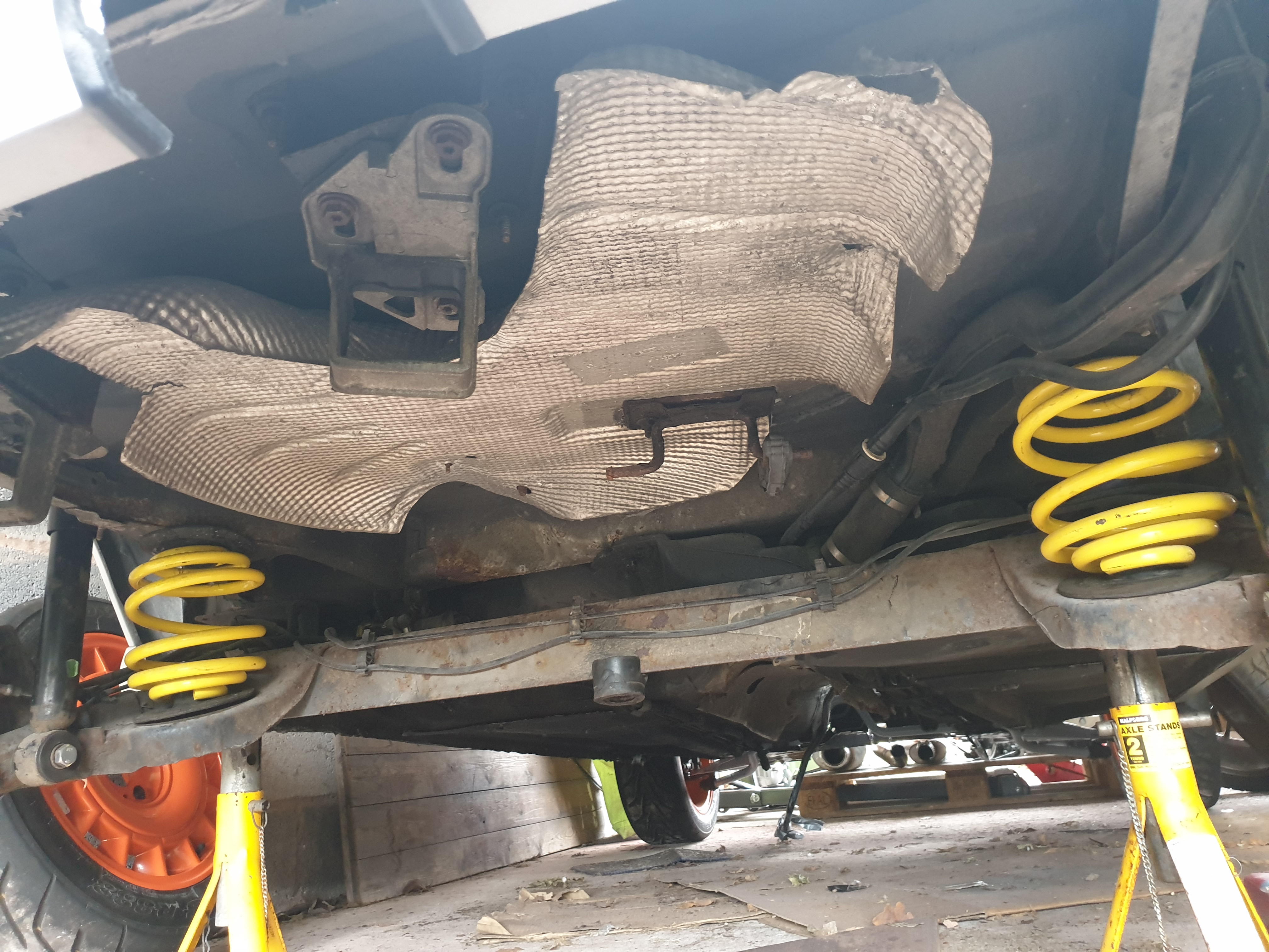

Still undecided whether to fit a brand new set of cup shocks and a new set of springs , maybe the grams or something else or do i just get some BC Coilovers for the car ? 🤔

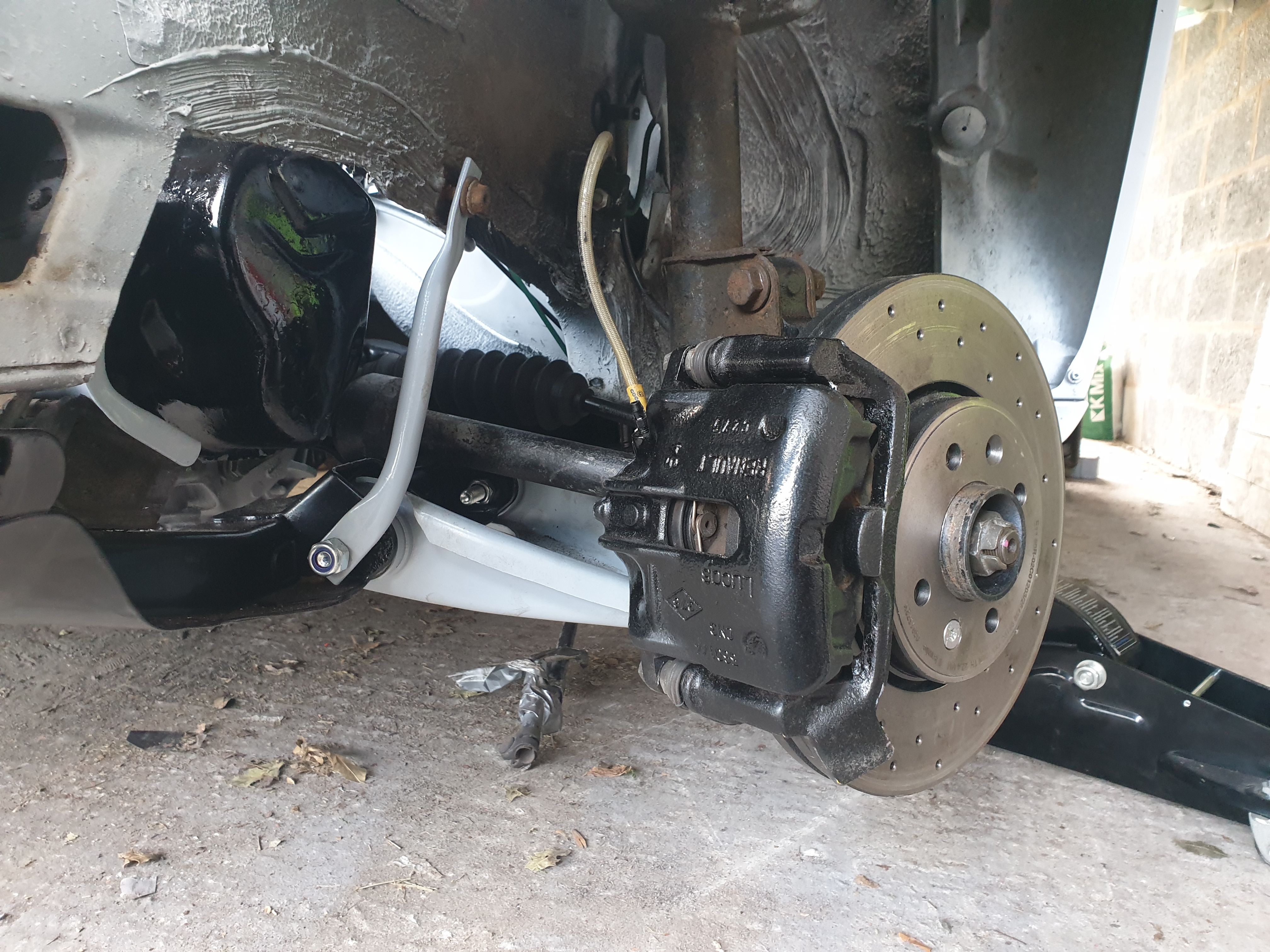

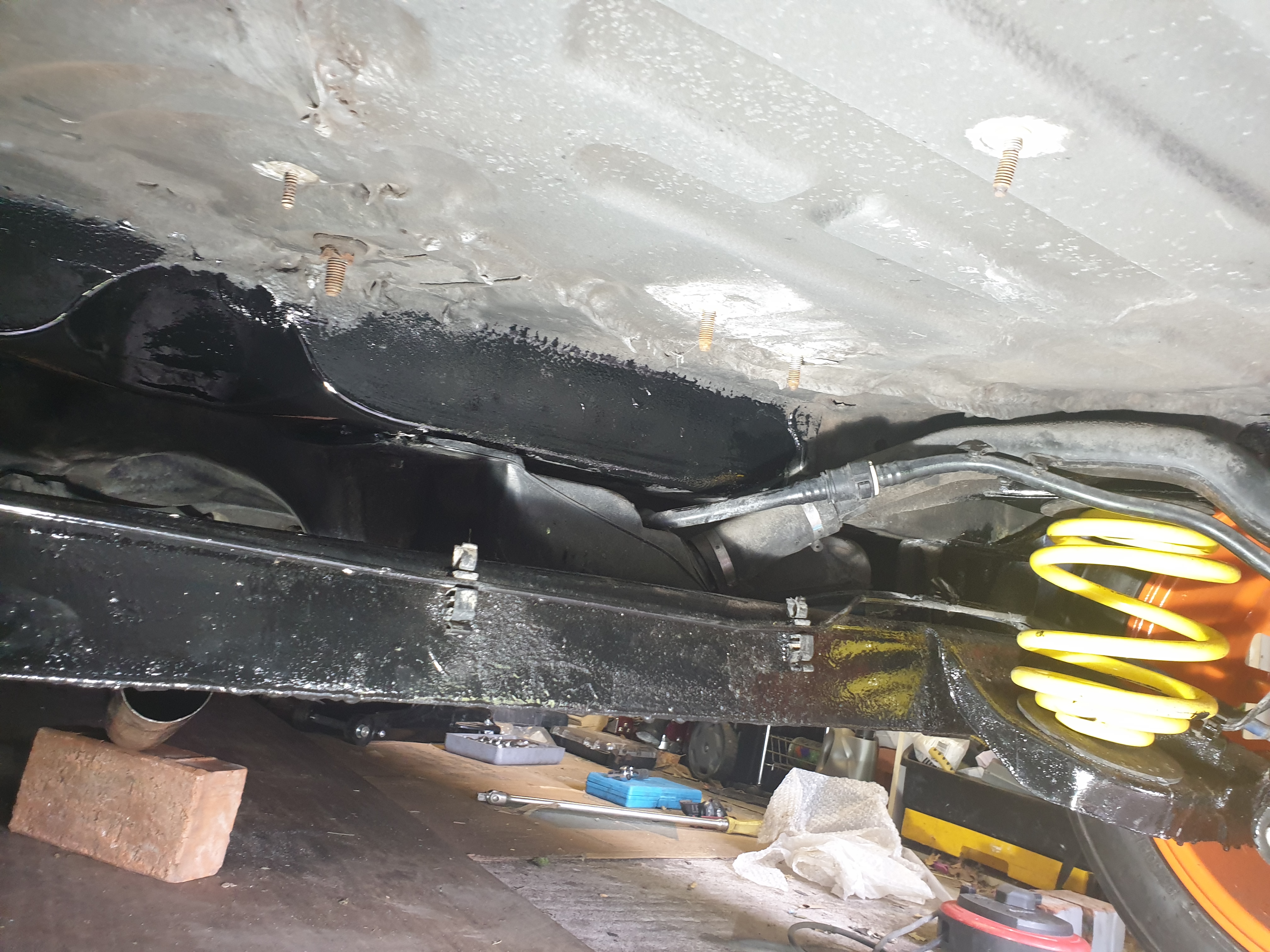

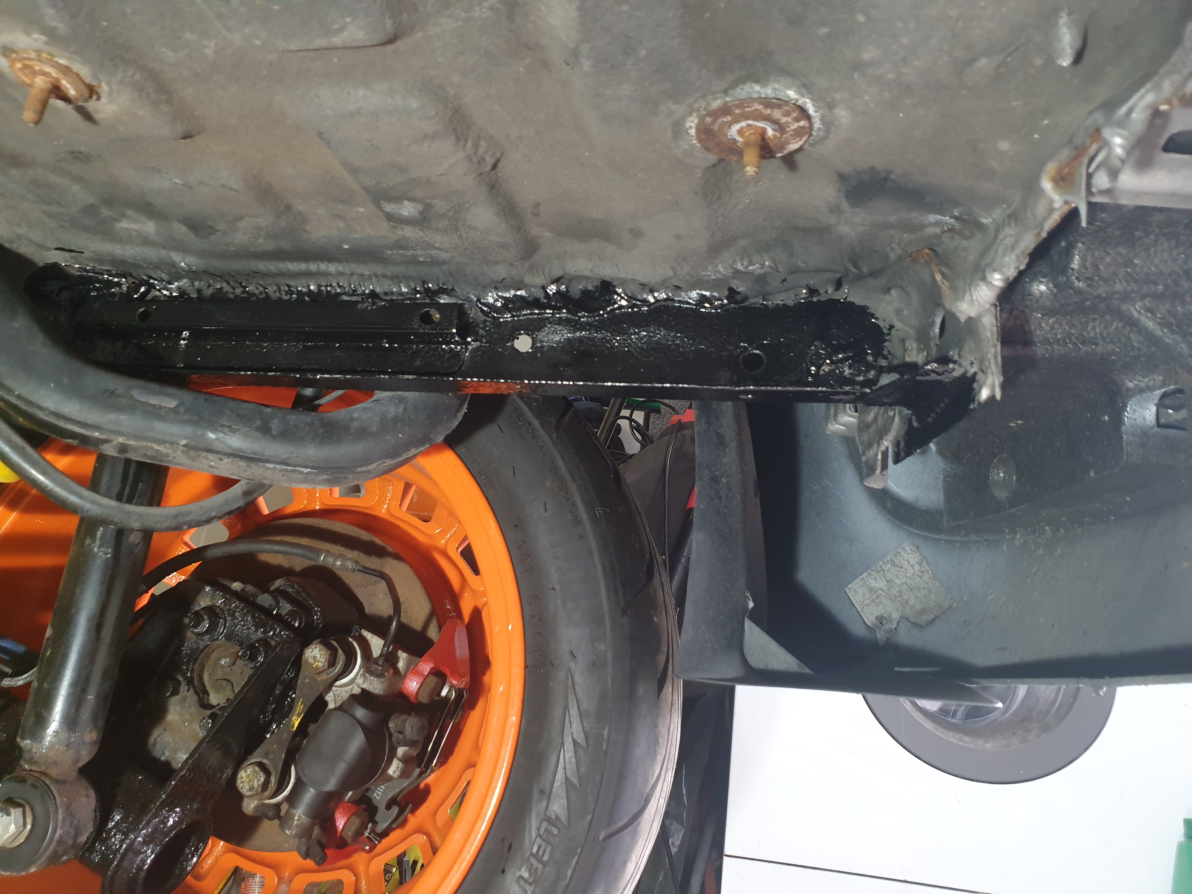

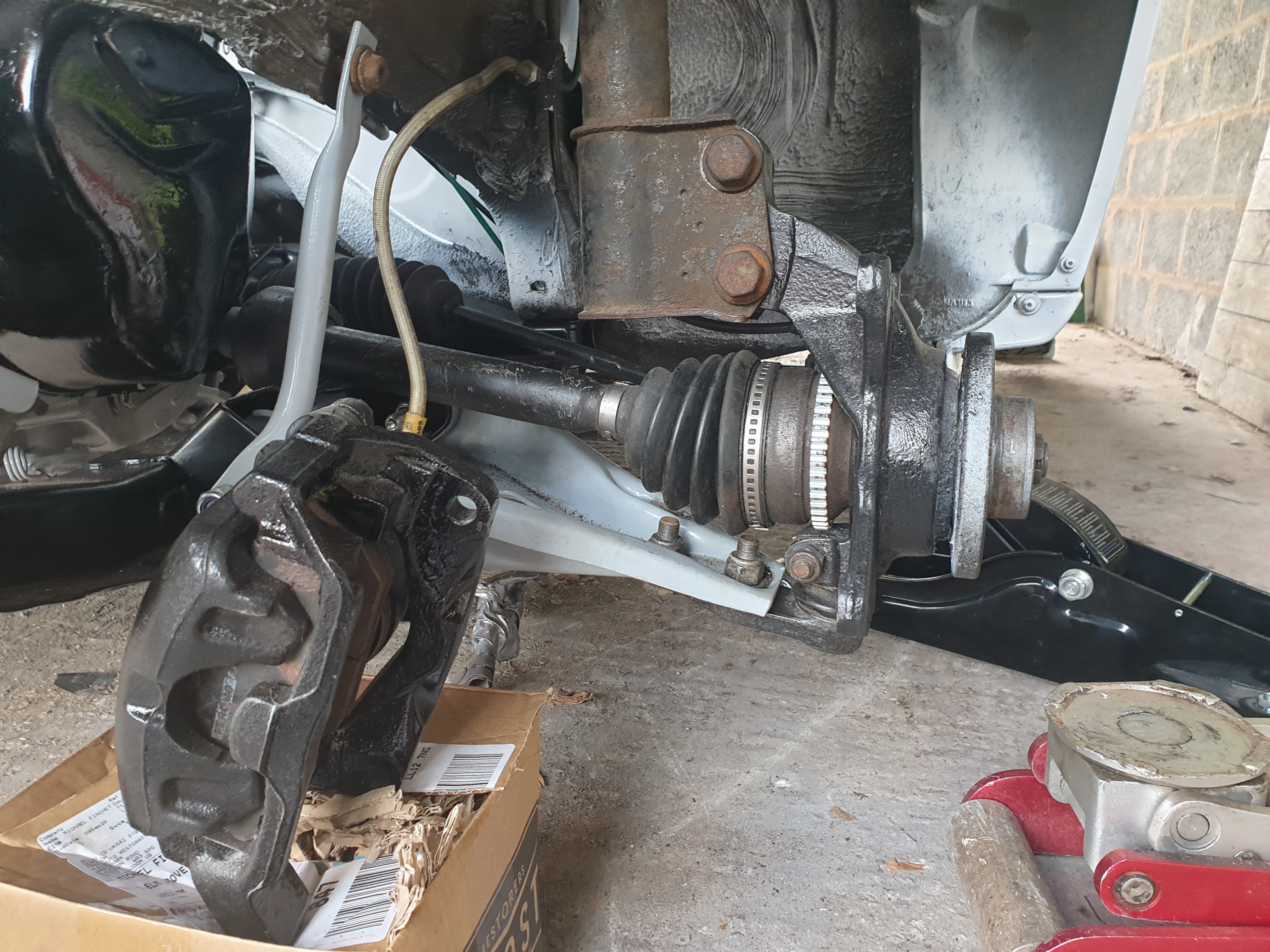

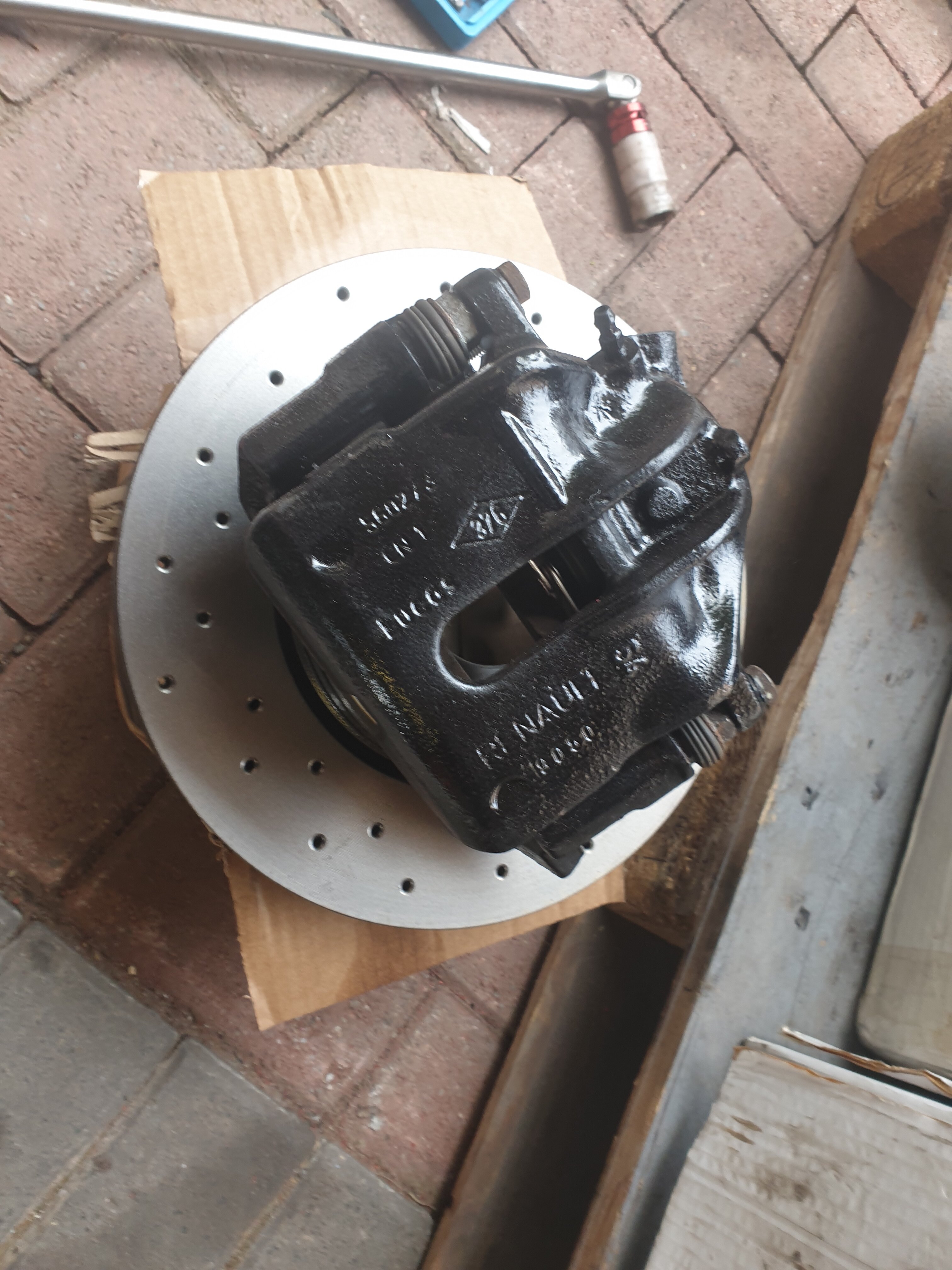

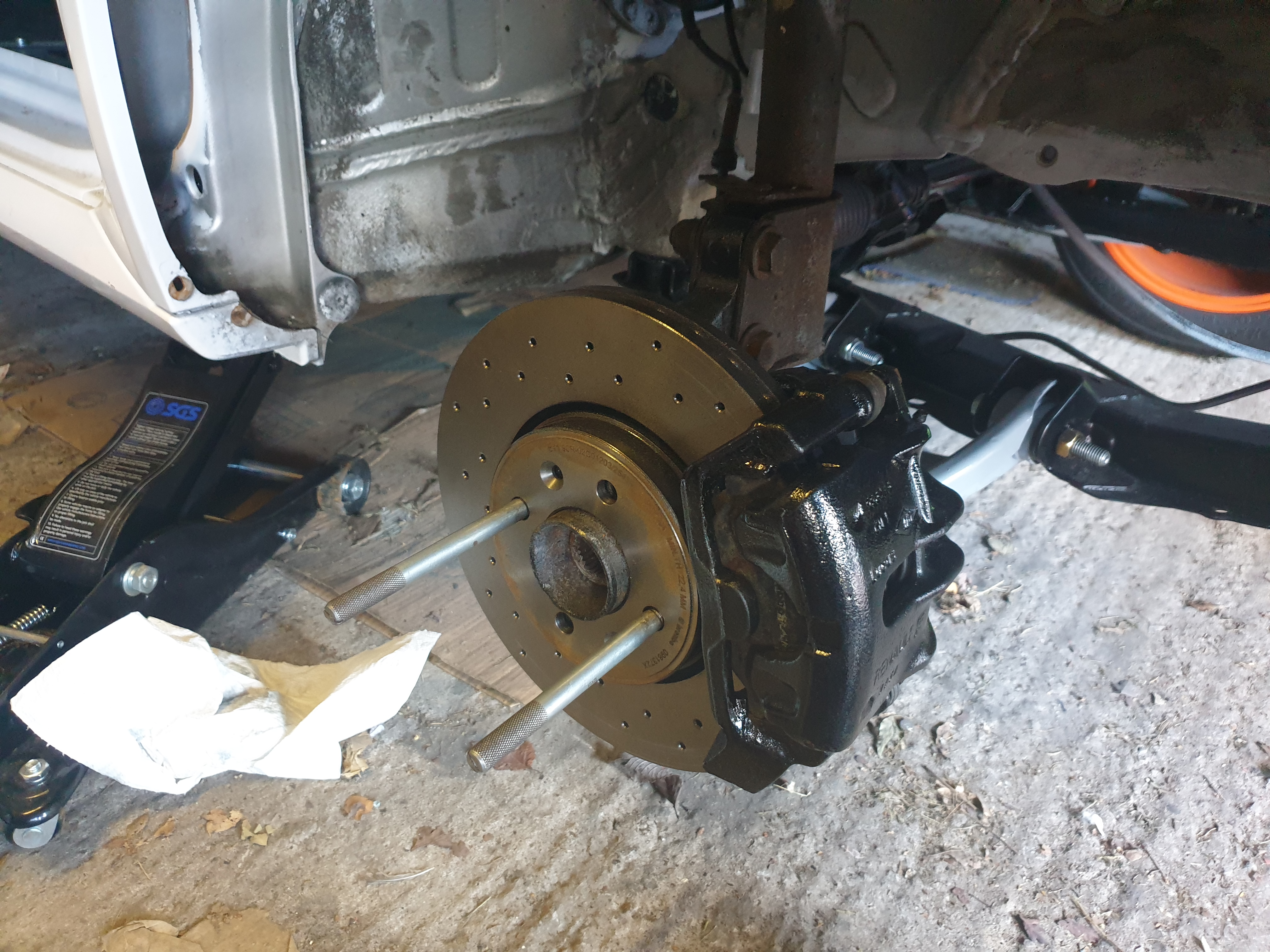

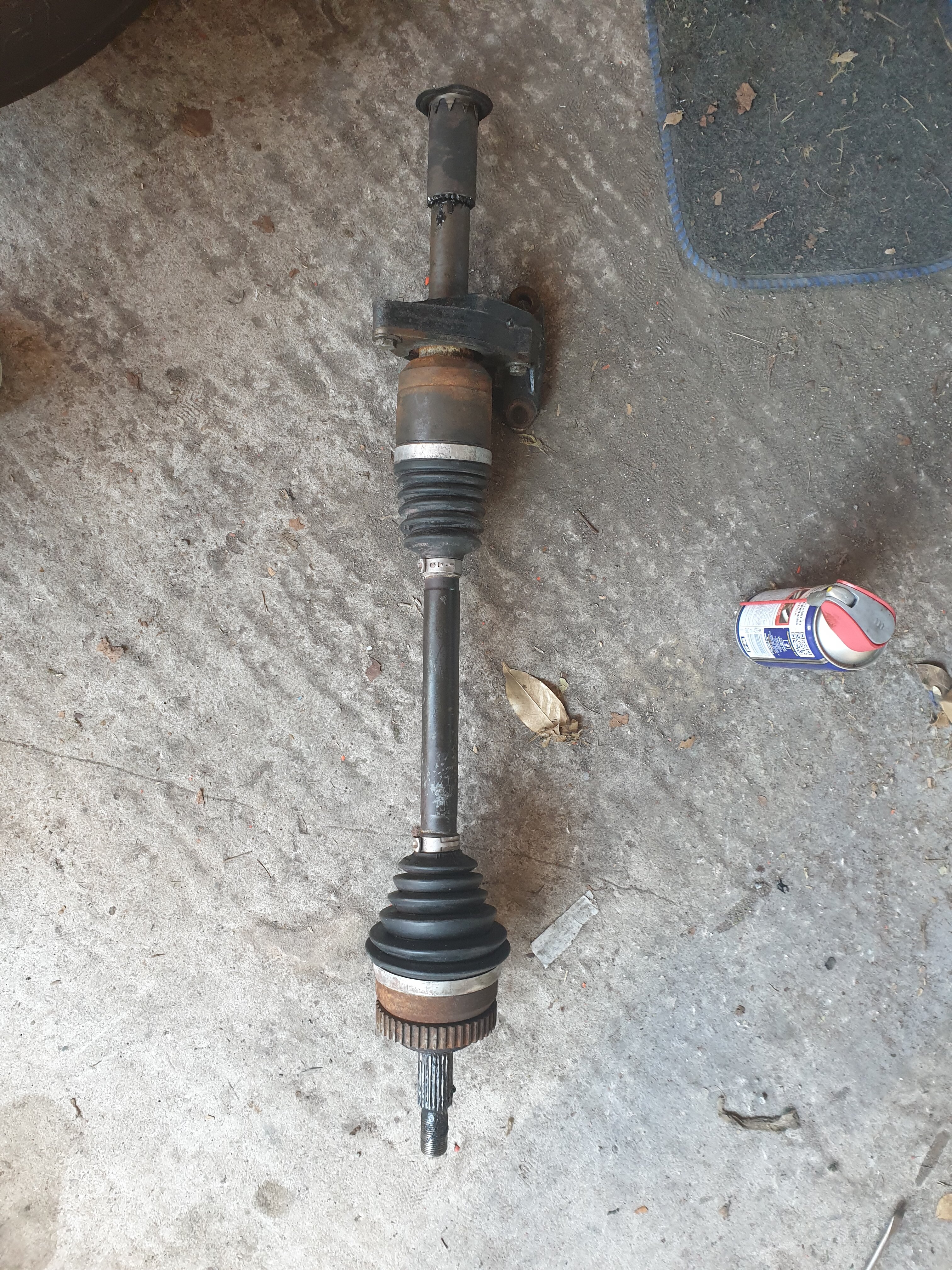

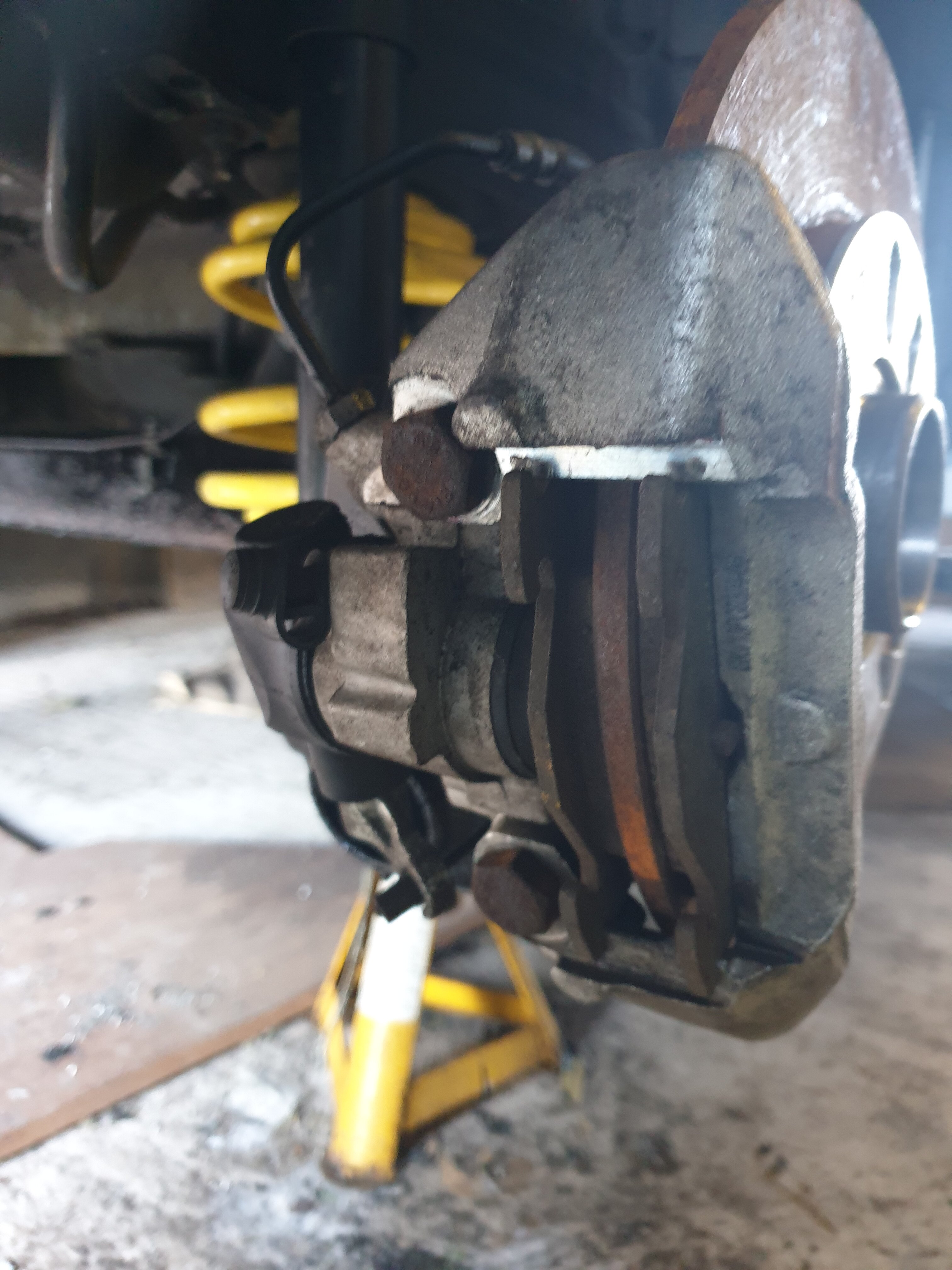

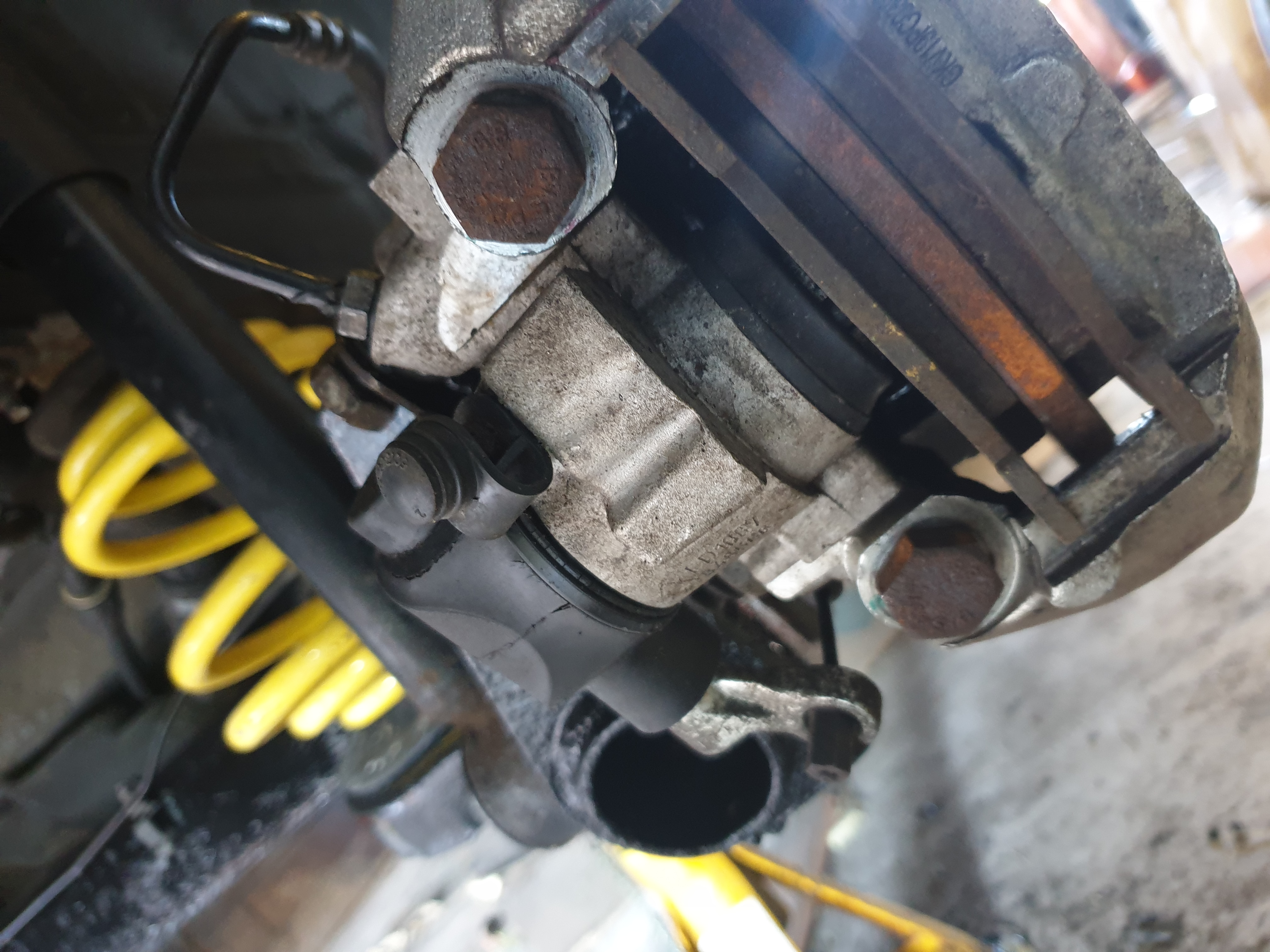

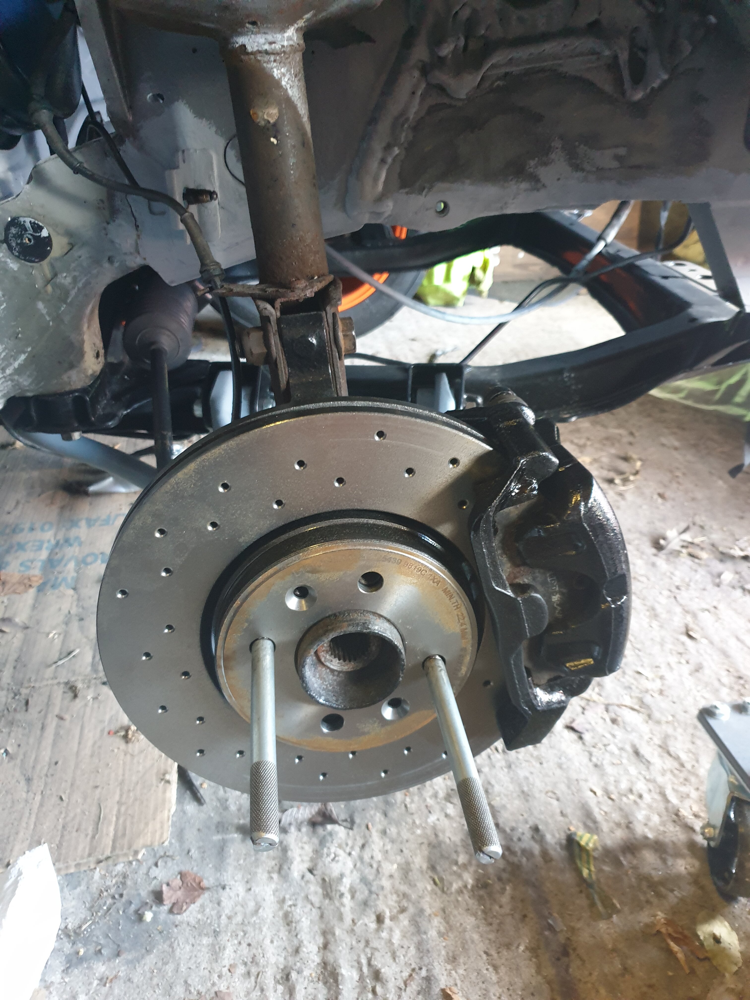

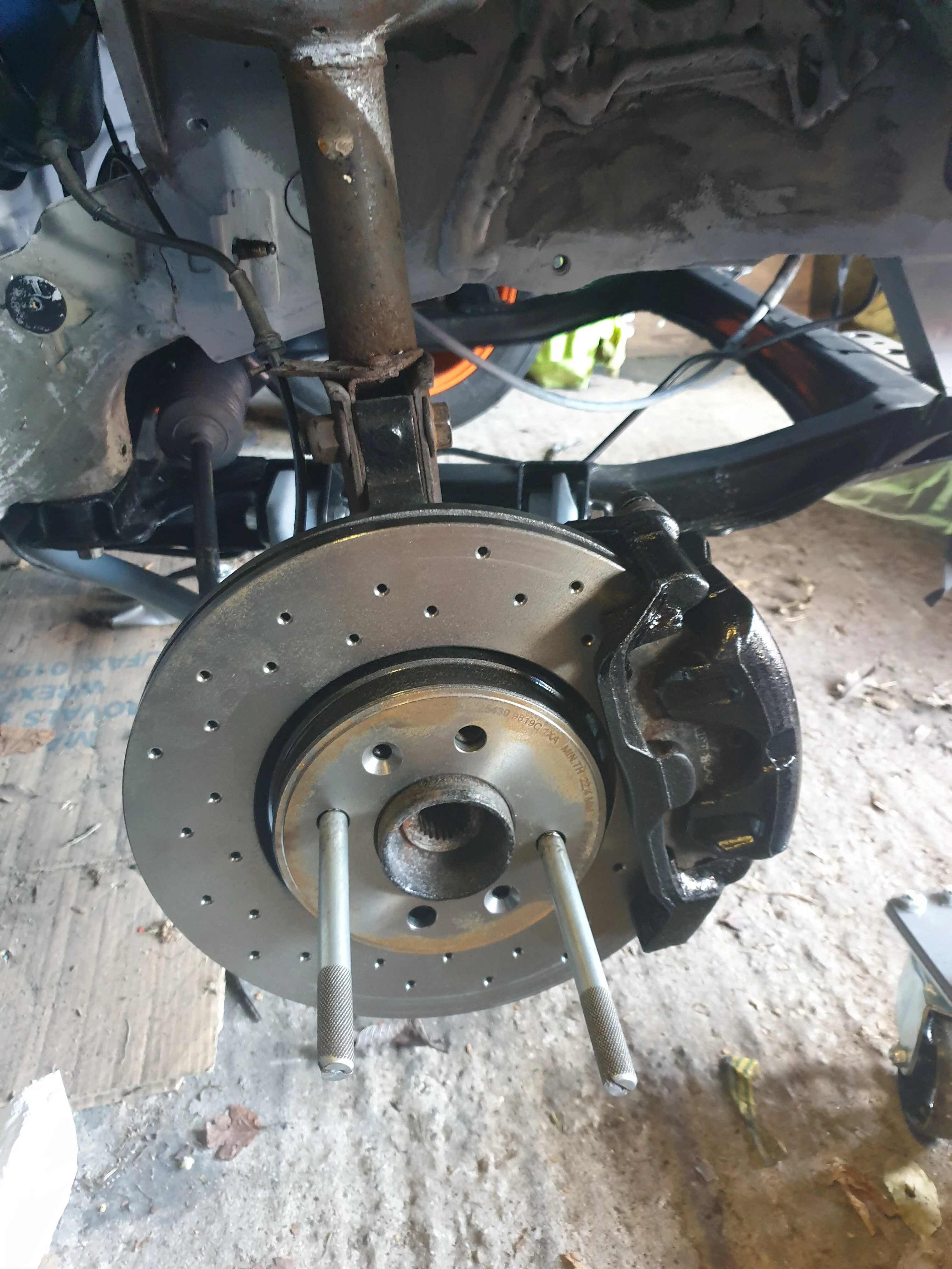

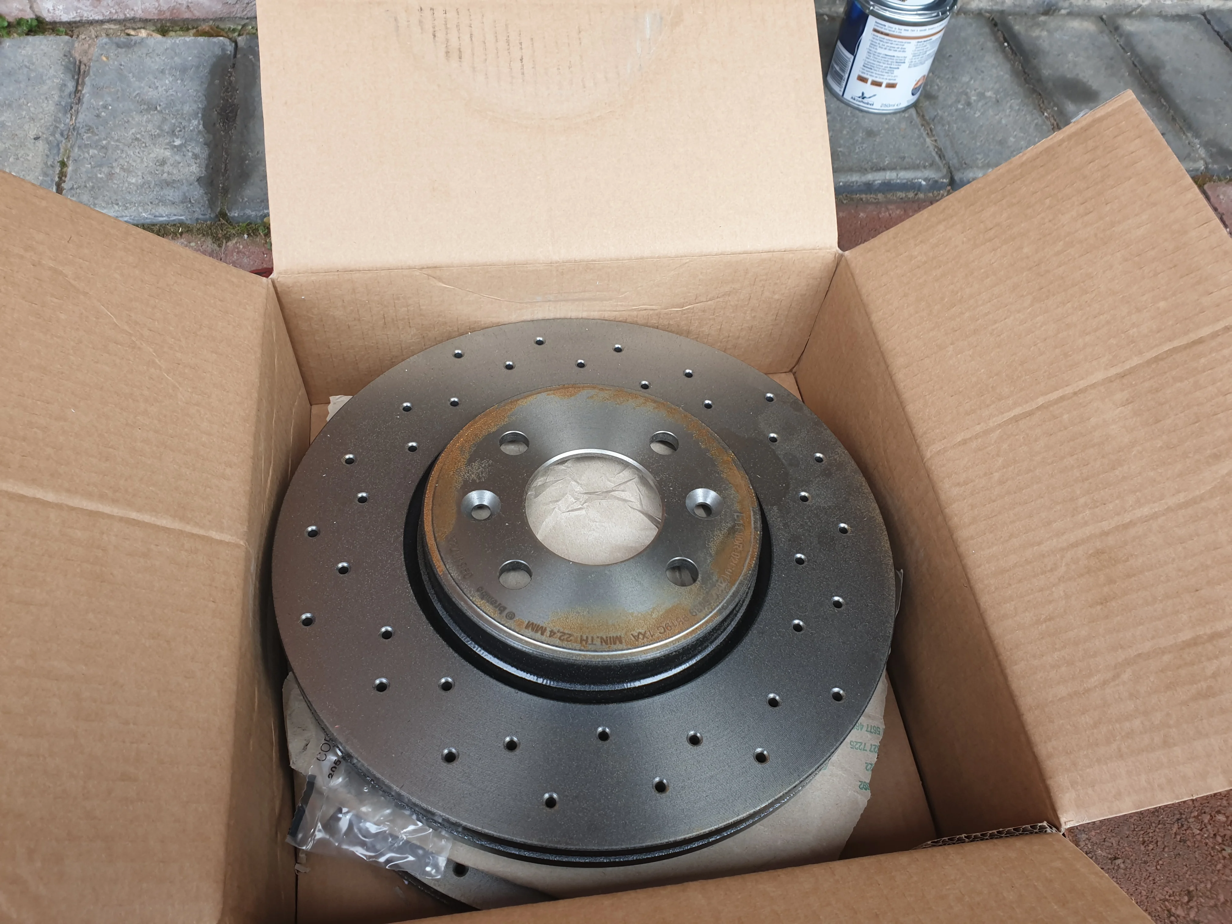

This saturdays activities passeger side driveshaft and abs ring and braided line to caliper and hardline to abs unit.

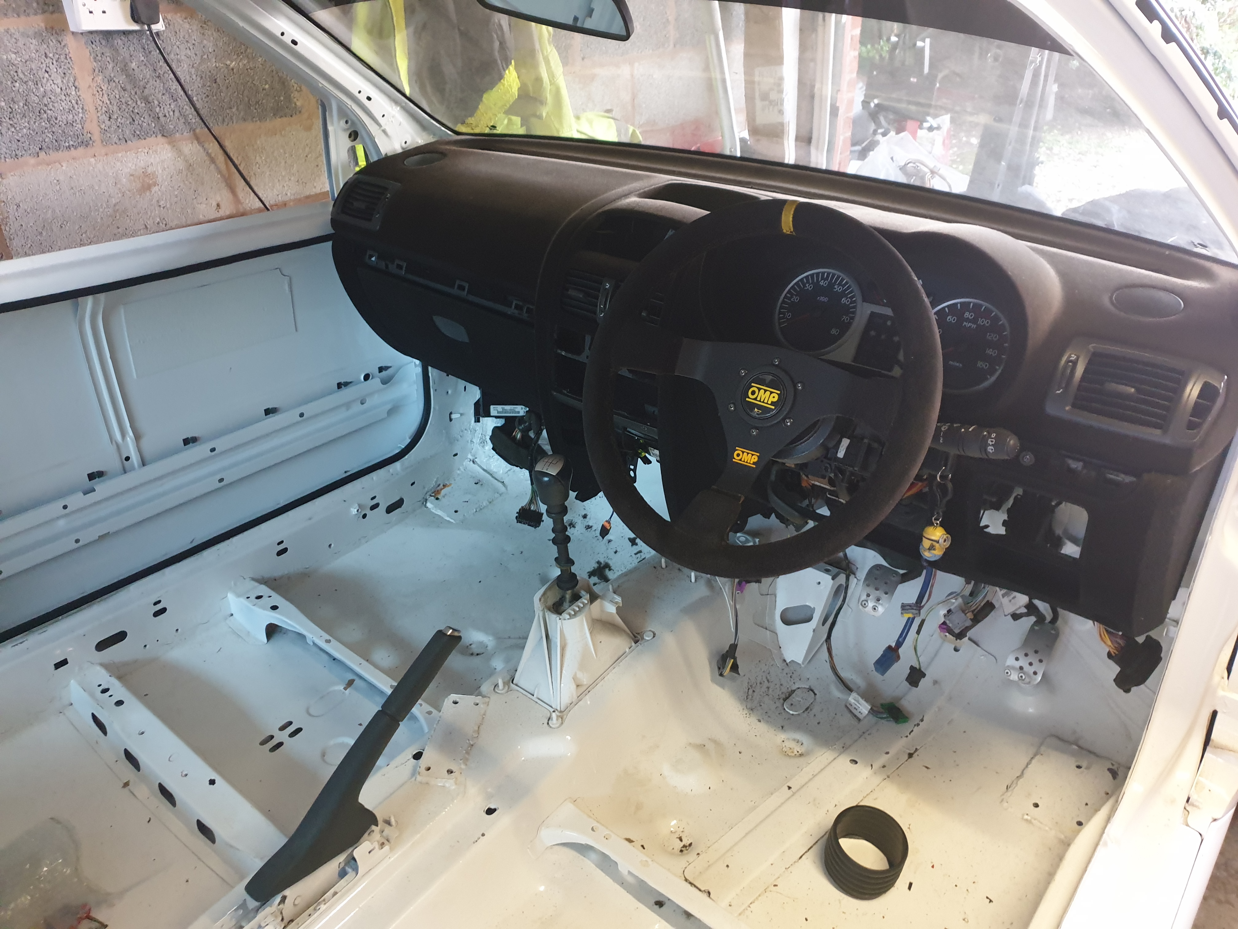

Re-fitted abs to this car For a direct comparison to the red but this will be mainly be a road car / wet trackday car.
Half the battle is having to make space to work in the garage at the moment.
Thats passenger side done onto the next.

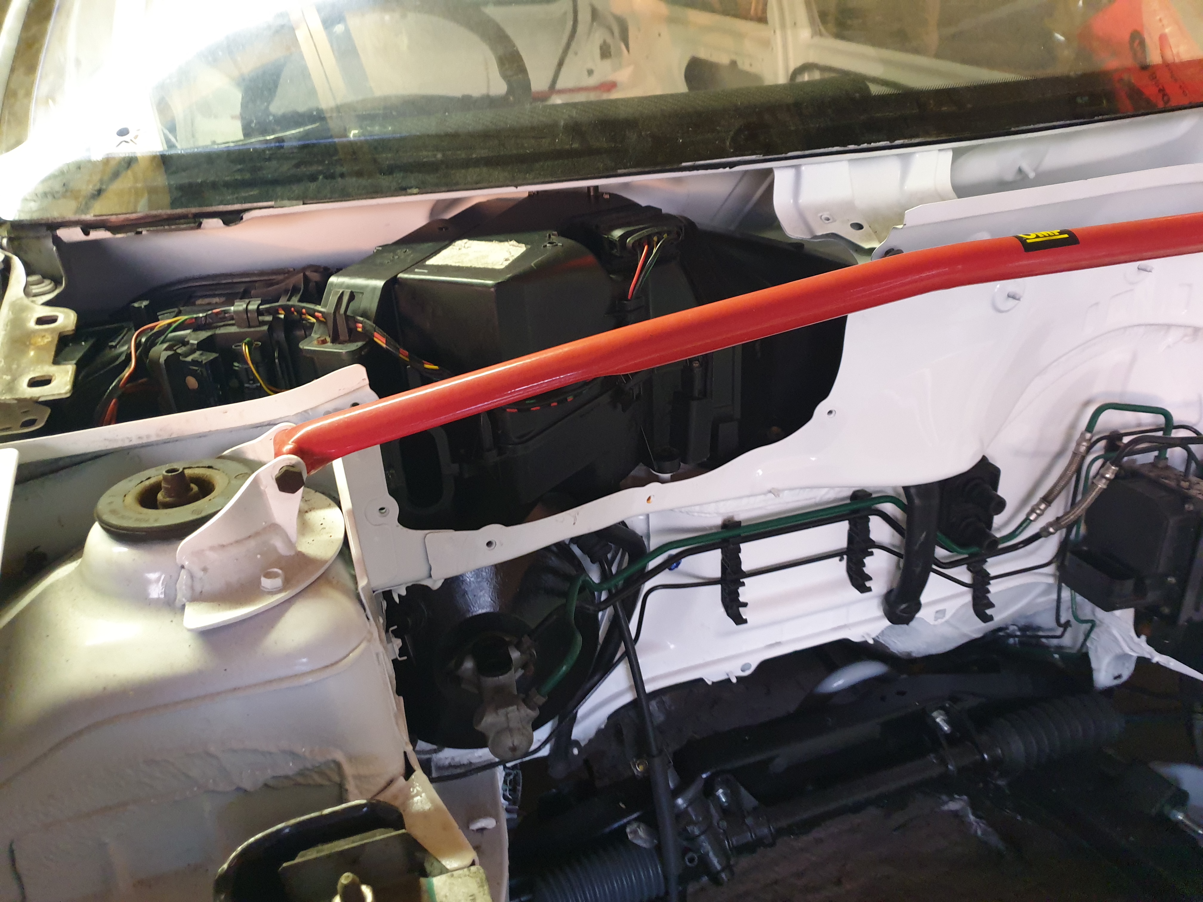

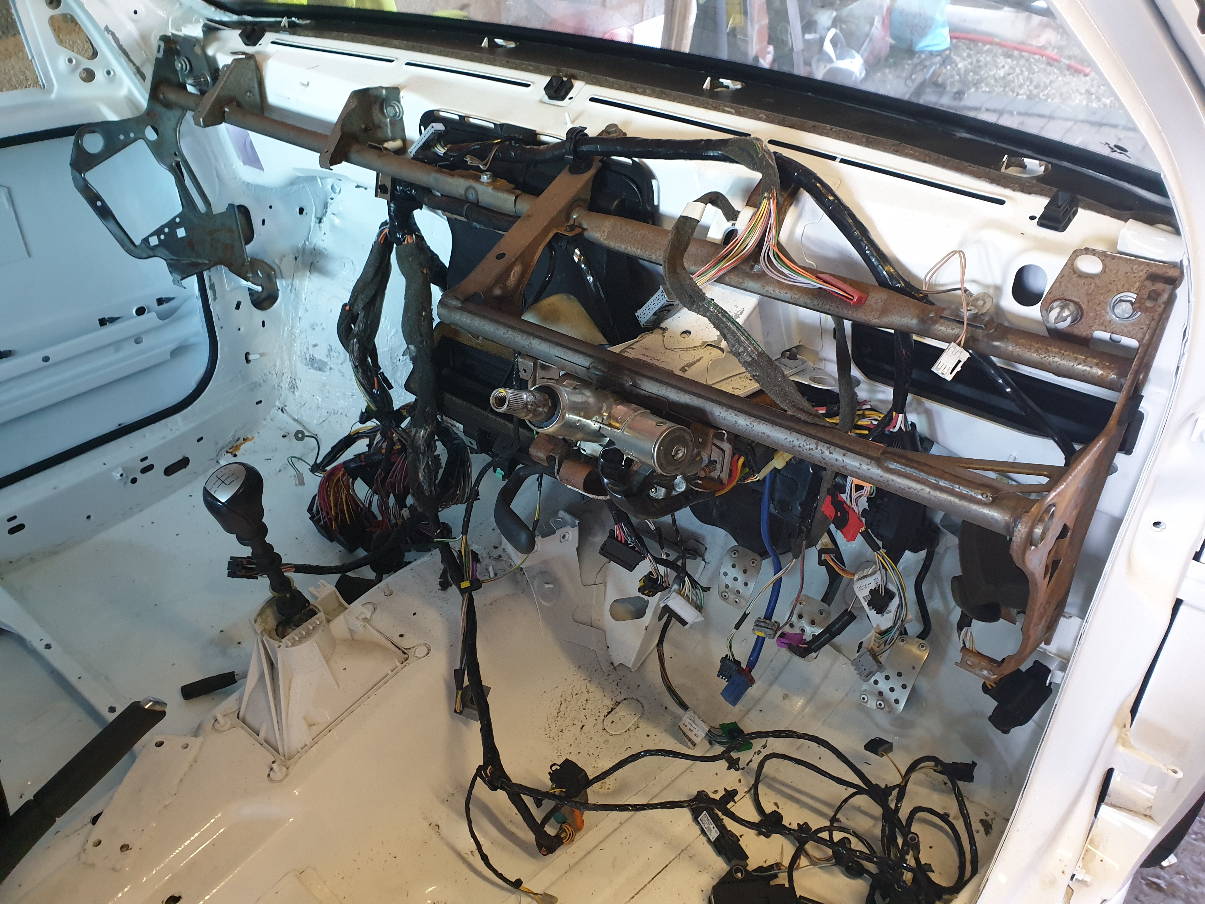

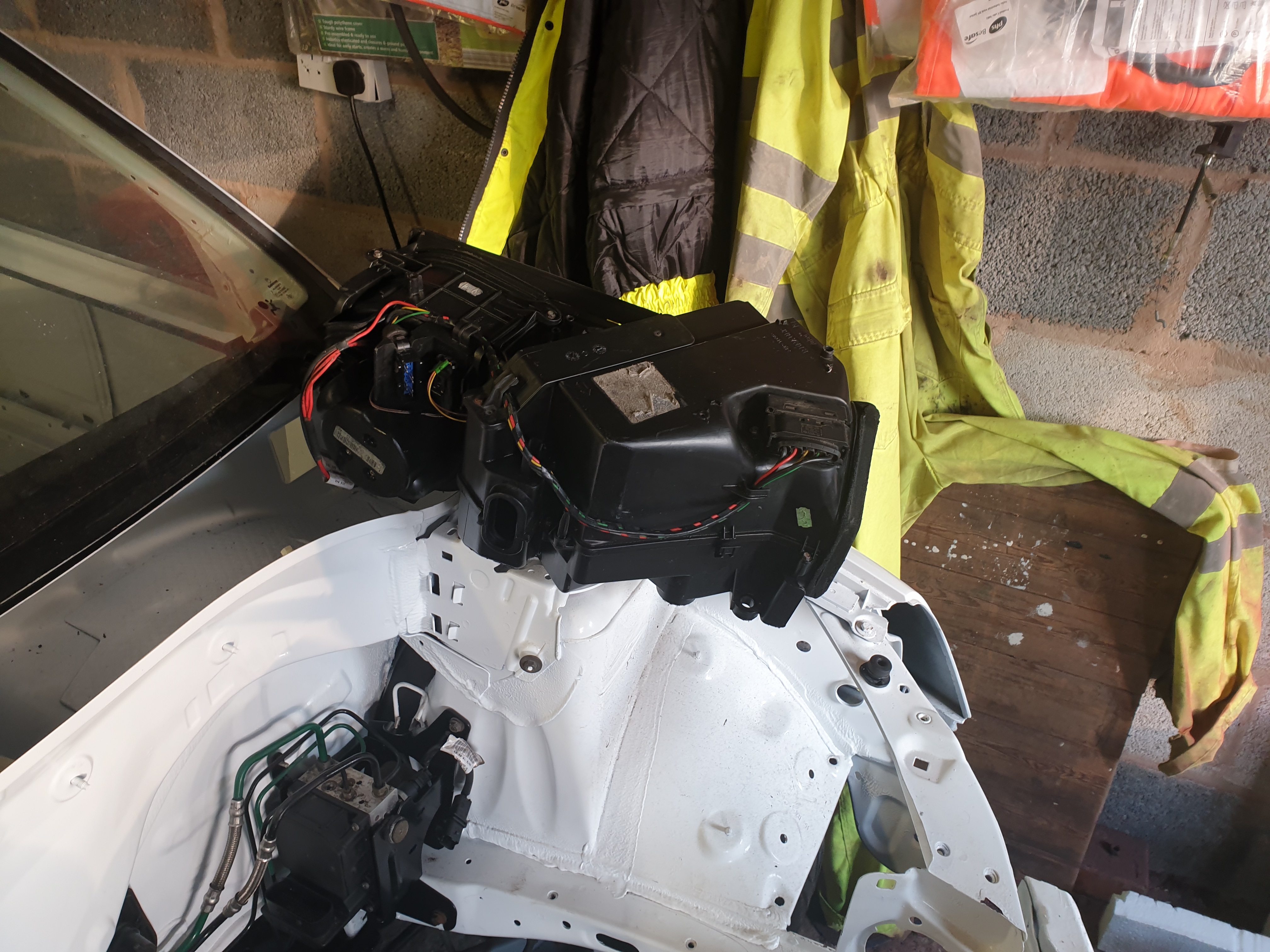

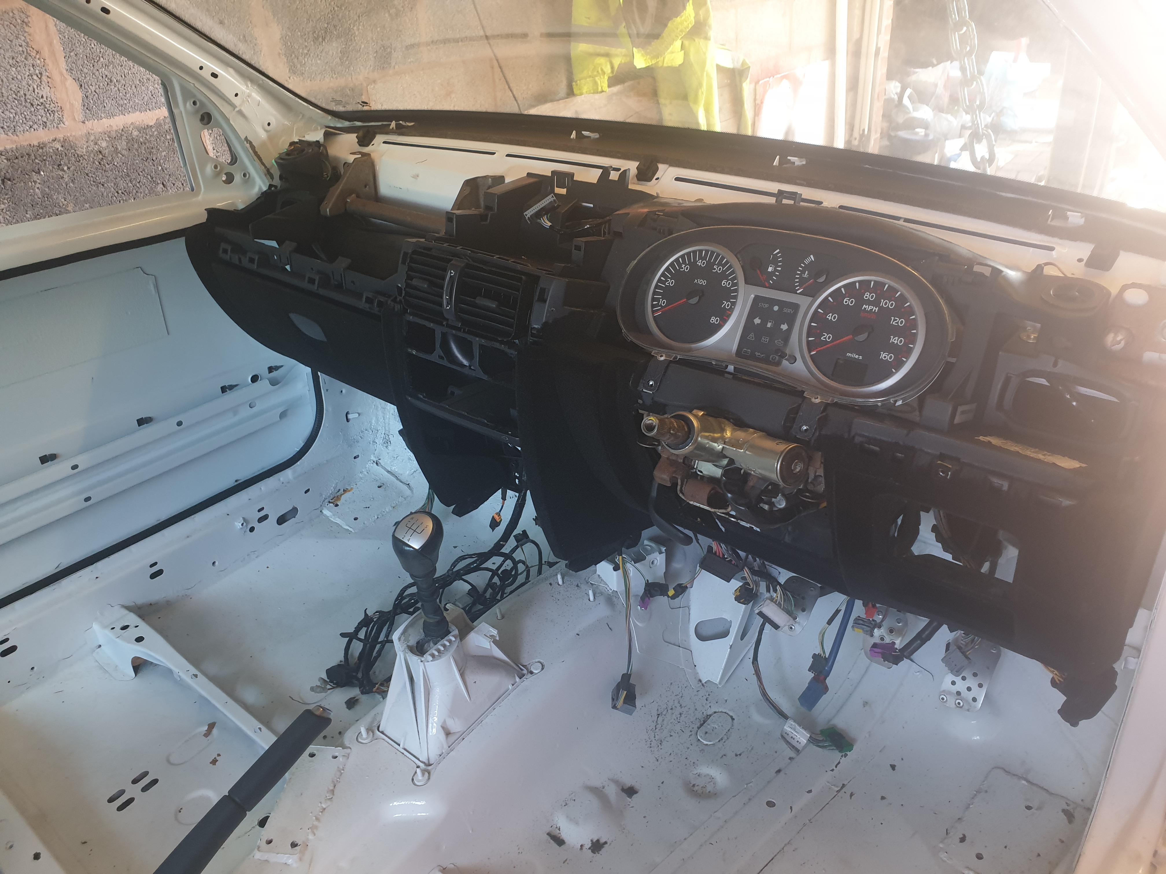

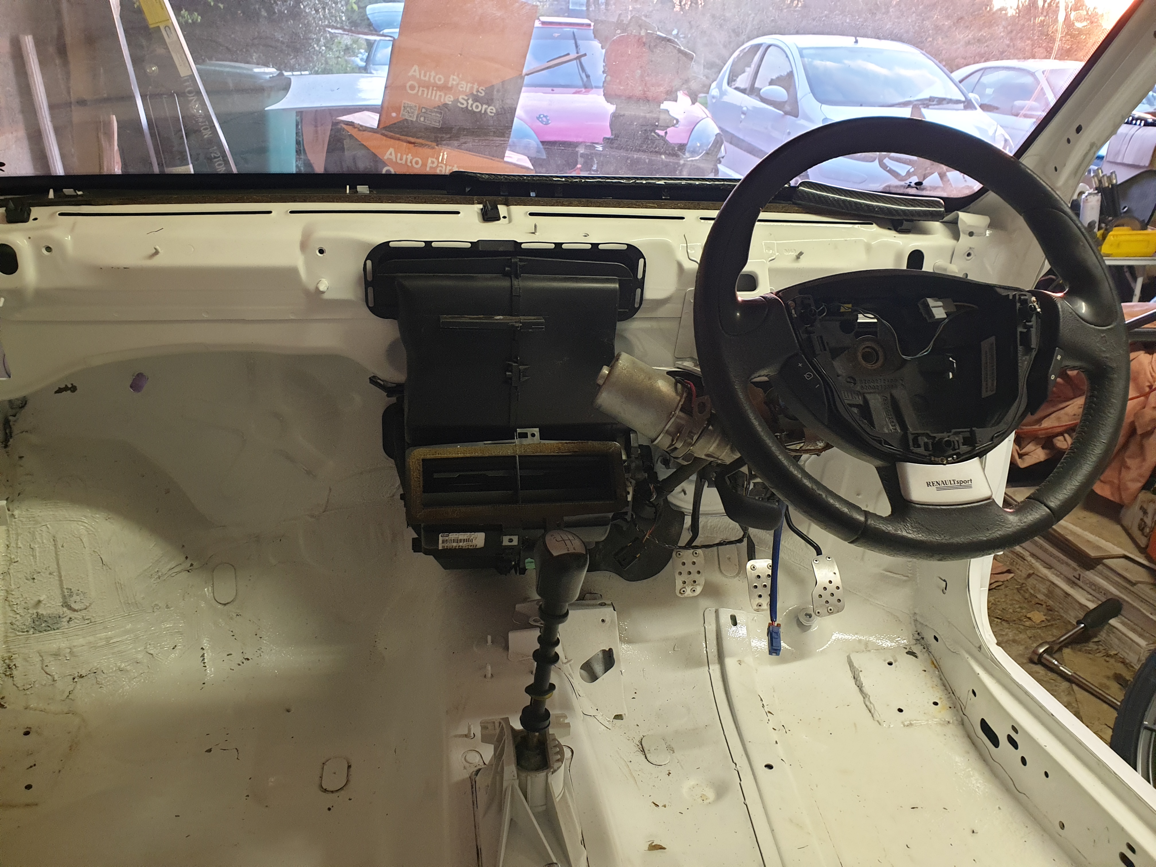

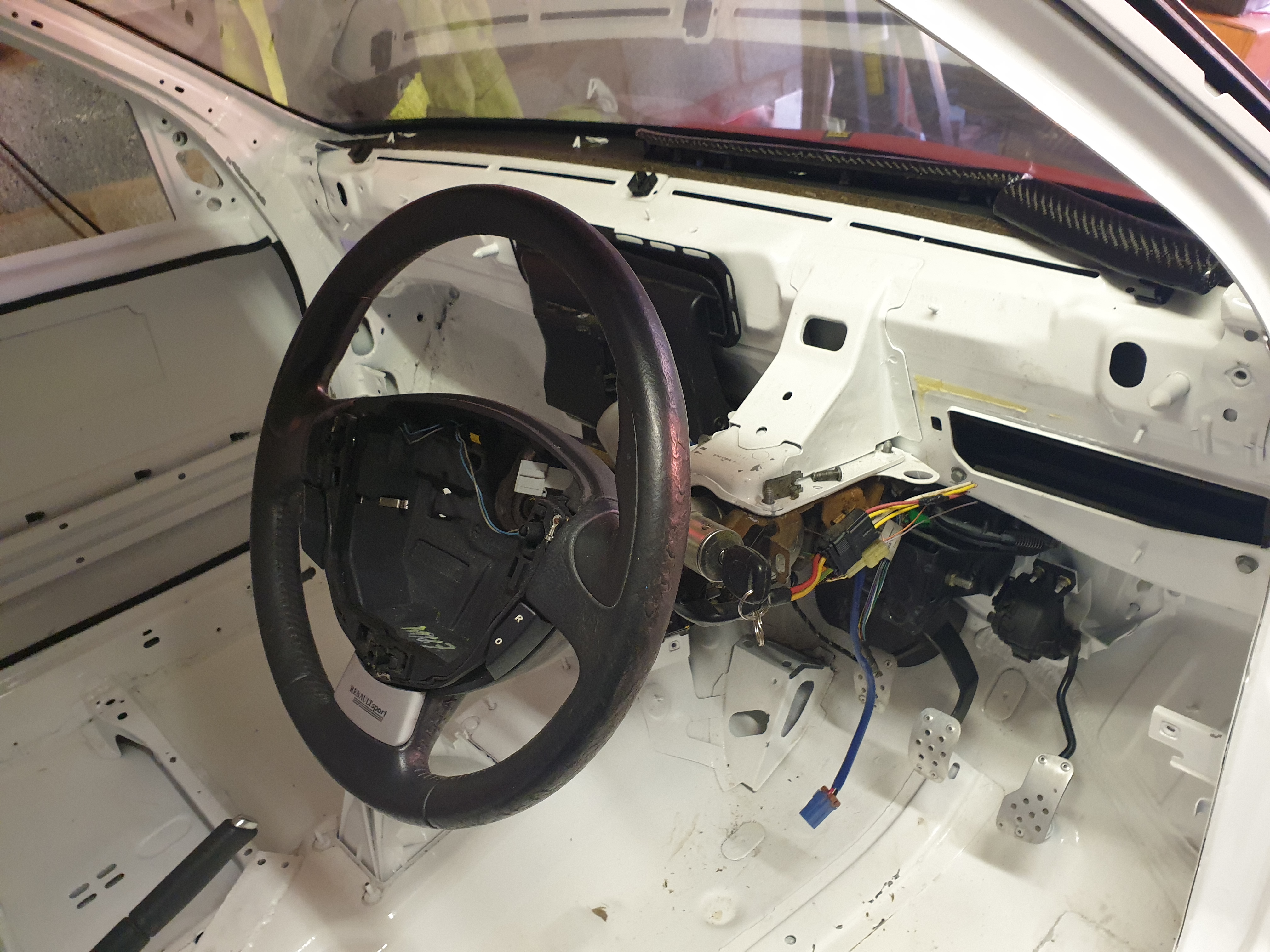

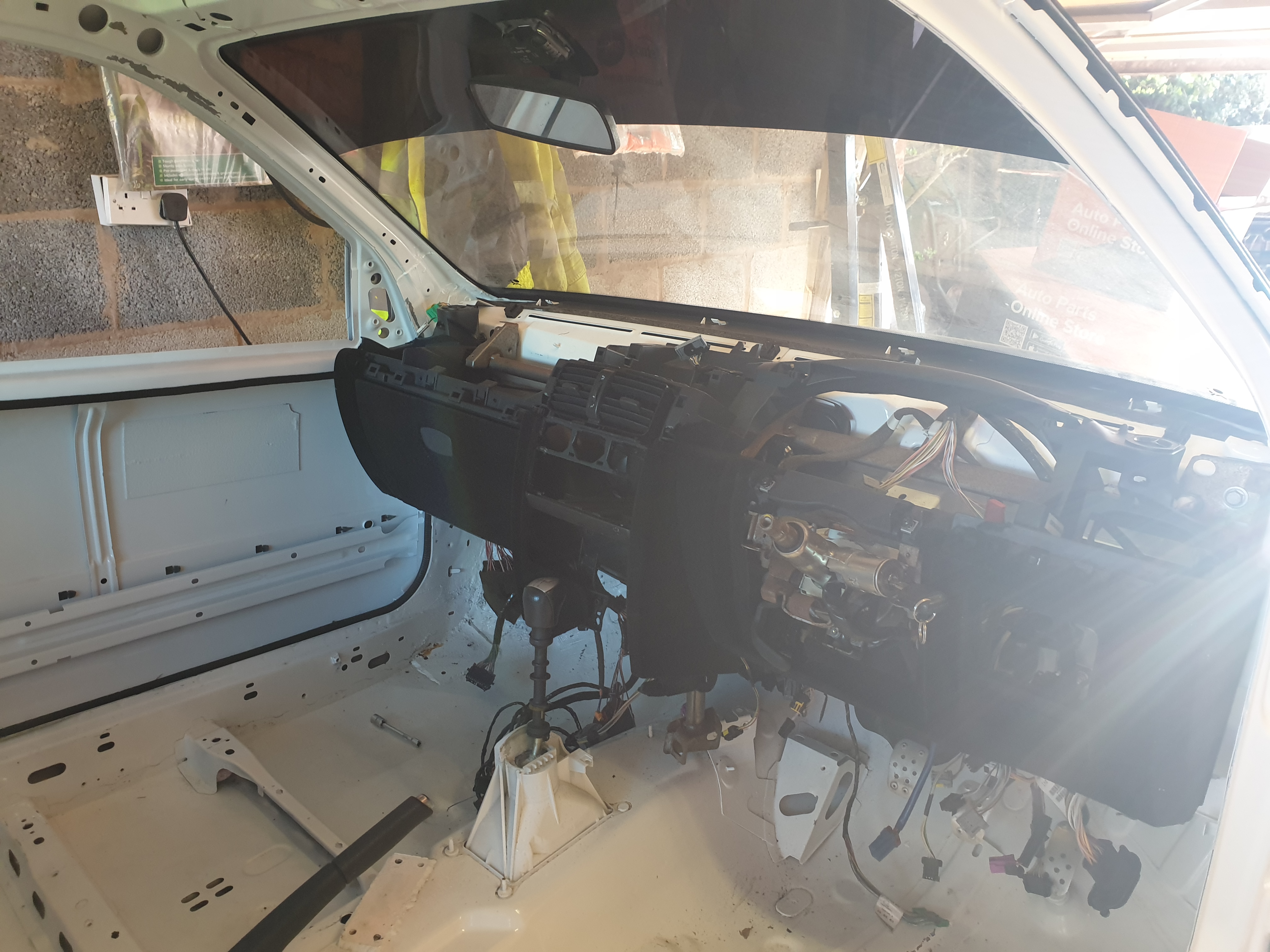

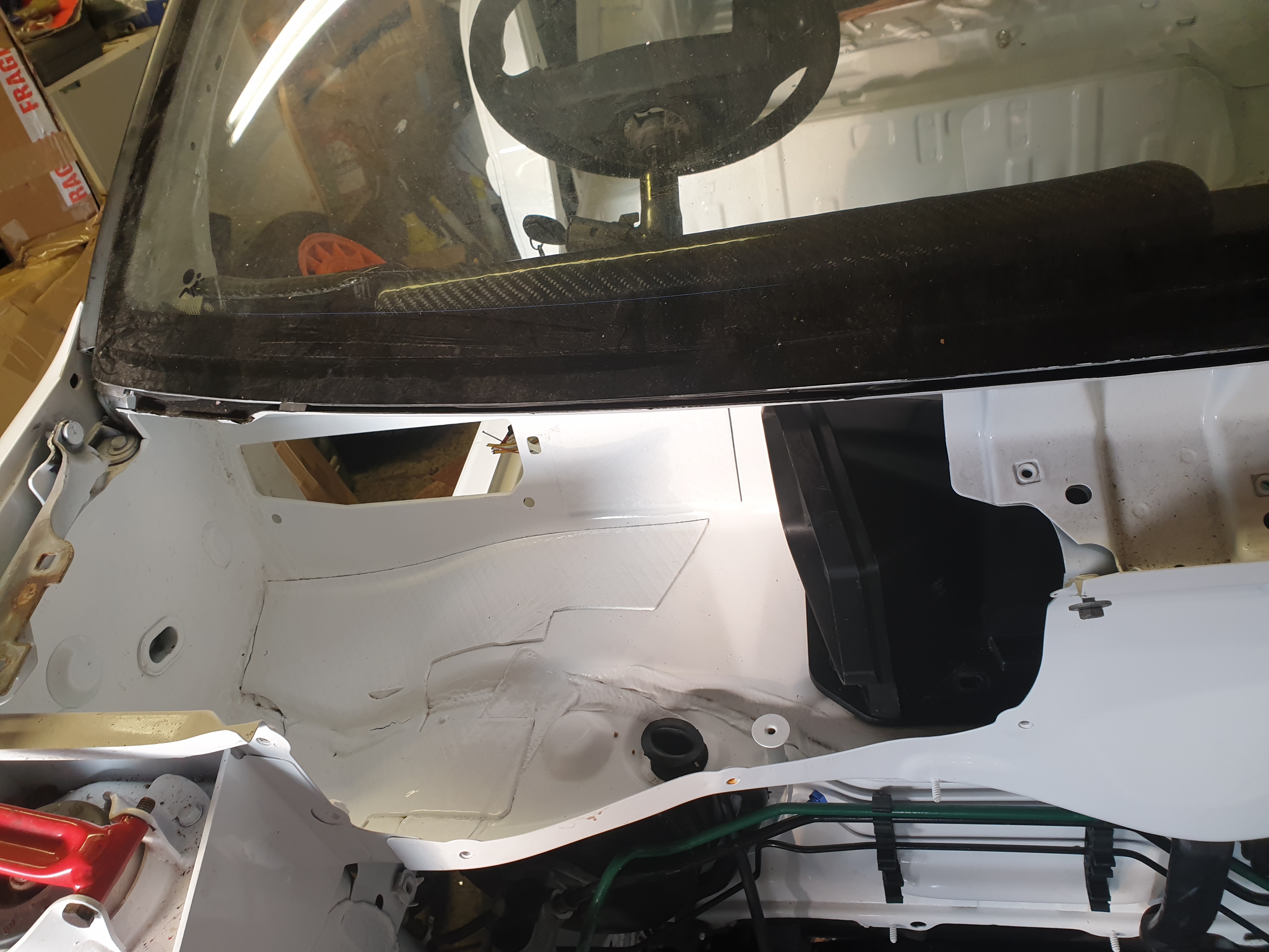

Need to install engine bay wiring loom , needs the looms from the iceberg shell for the doors and rear lights.

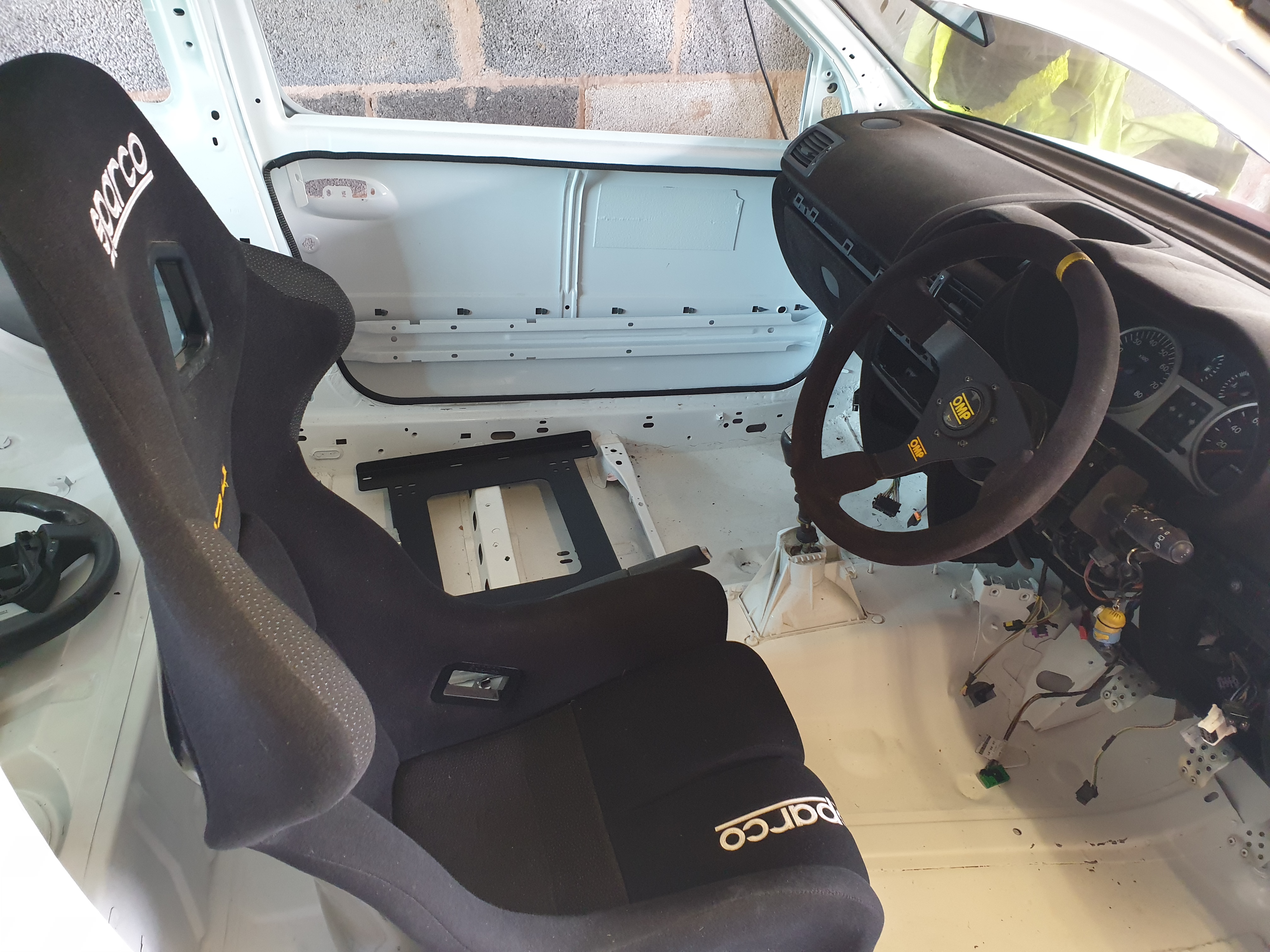

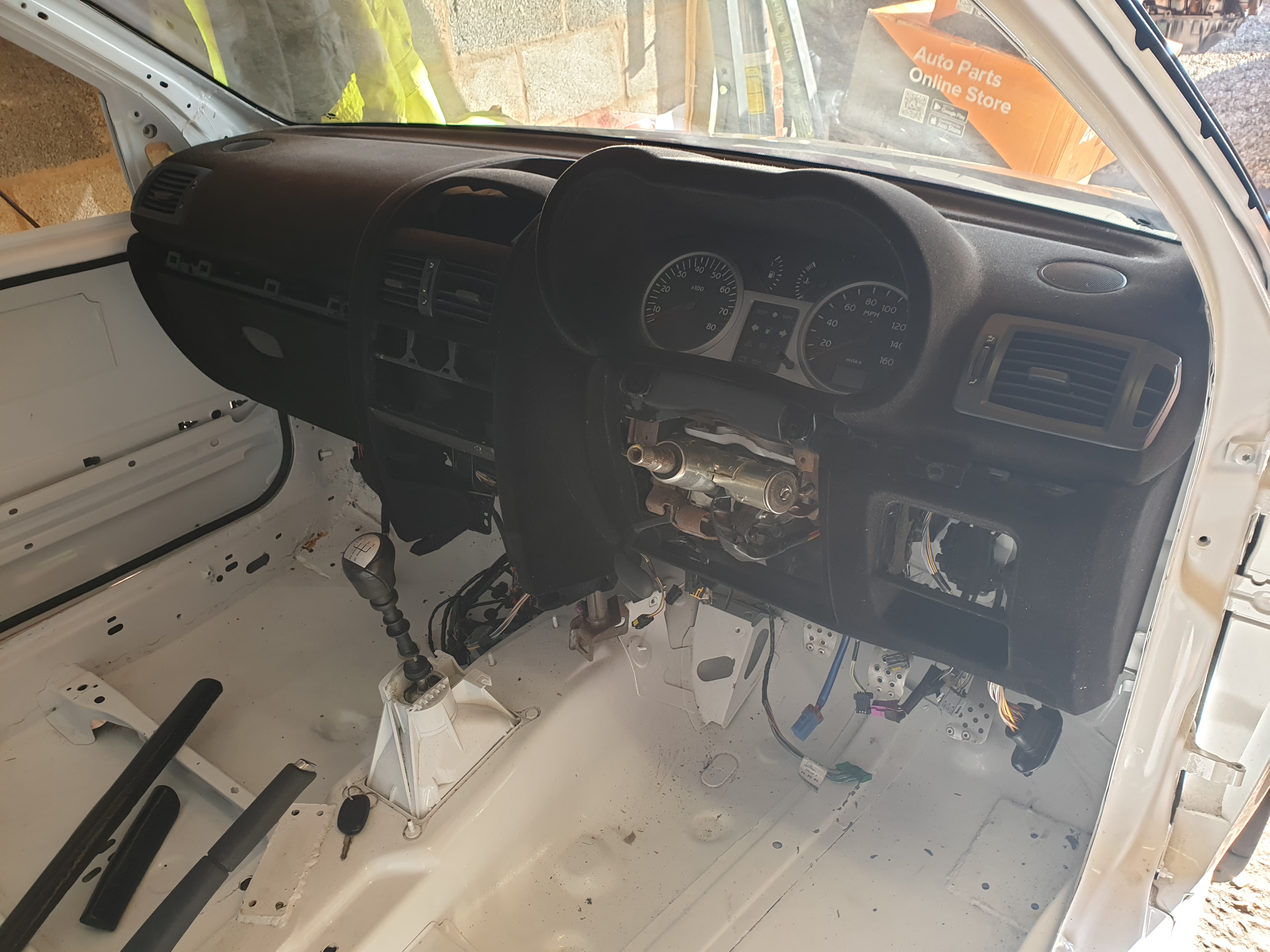

Need drivers door from iceberg and both glass unless i go for perspex windows 🤔.
What do people think ? Perspex or glass windows ?

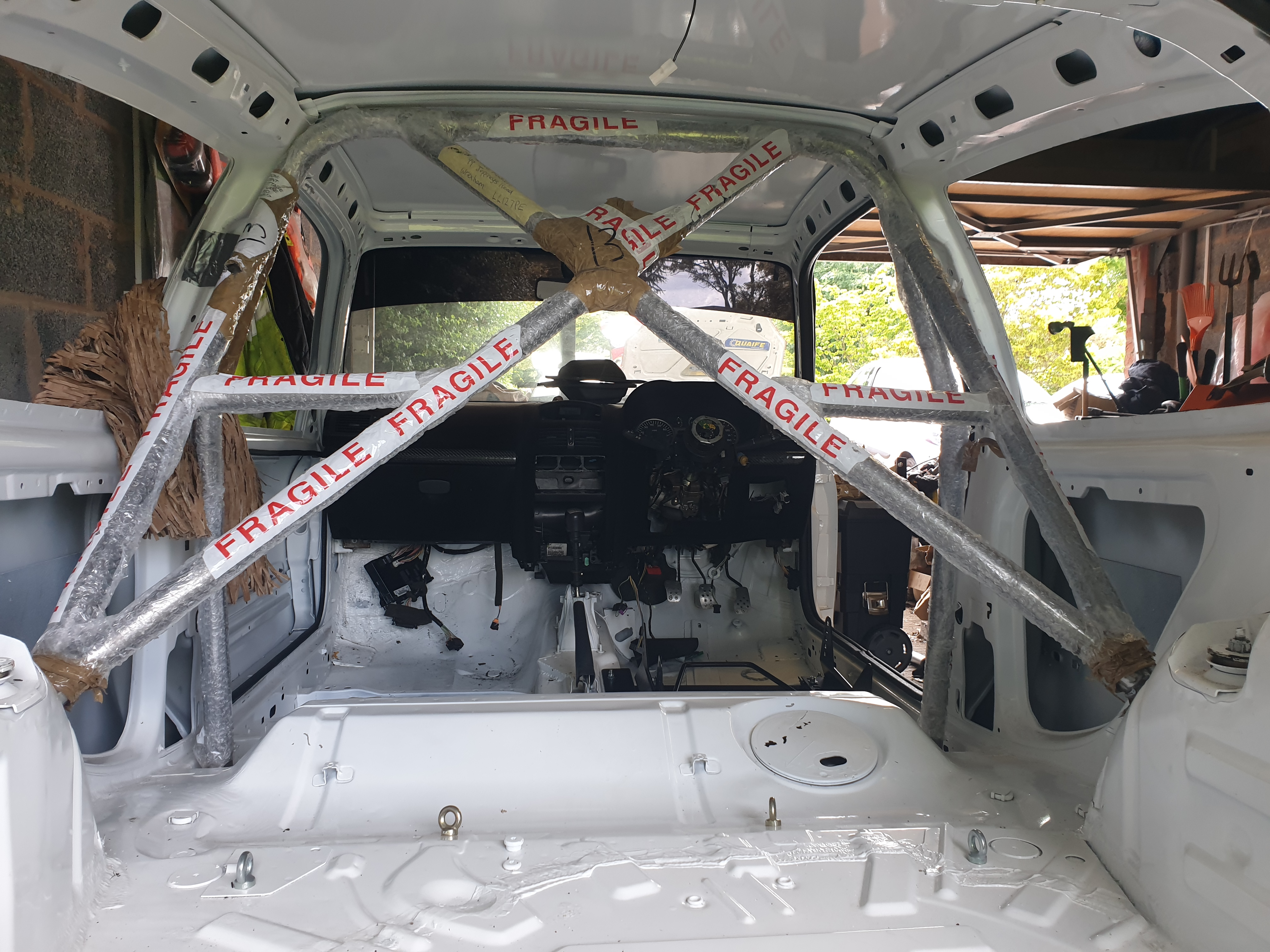

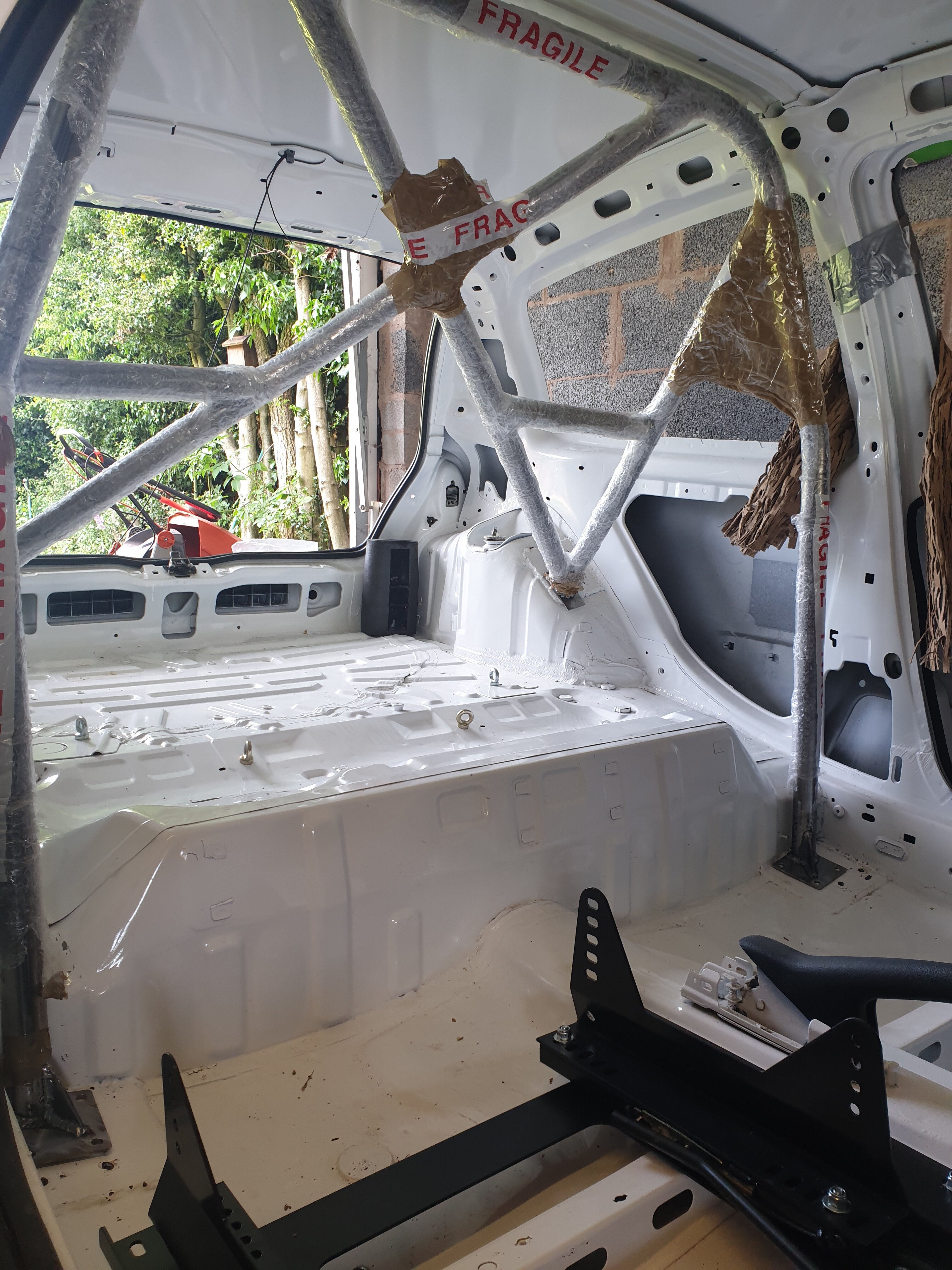

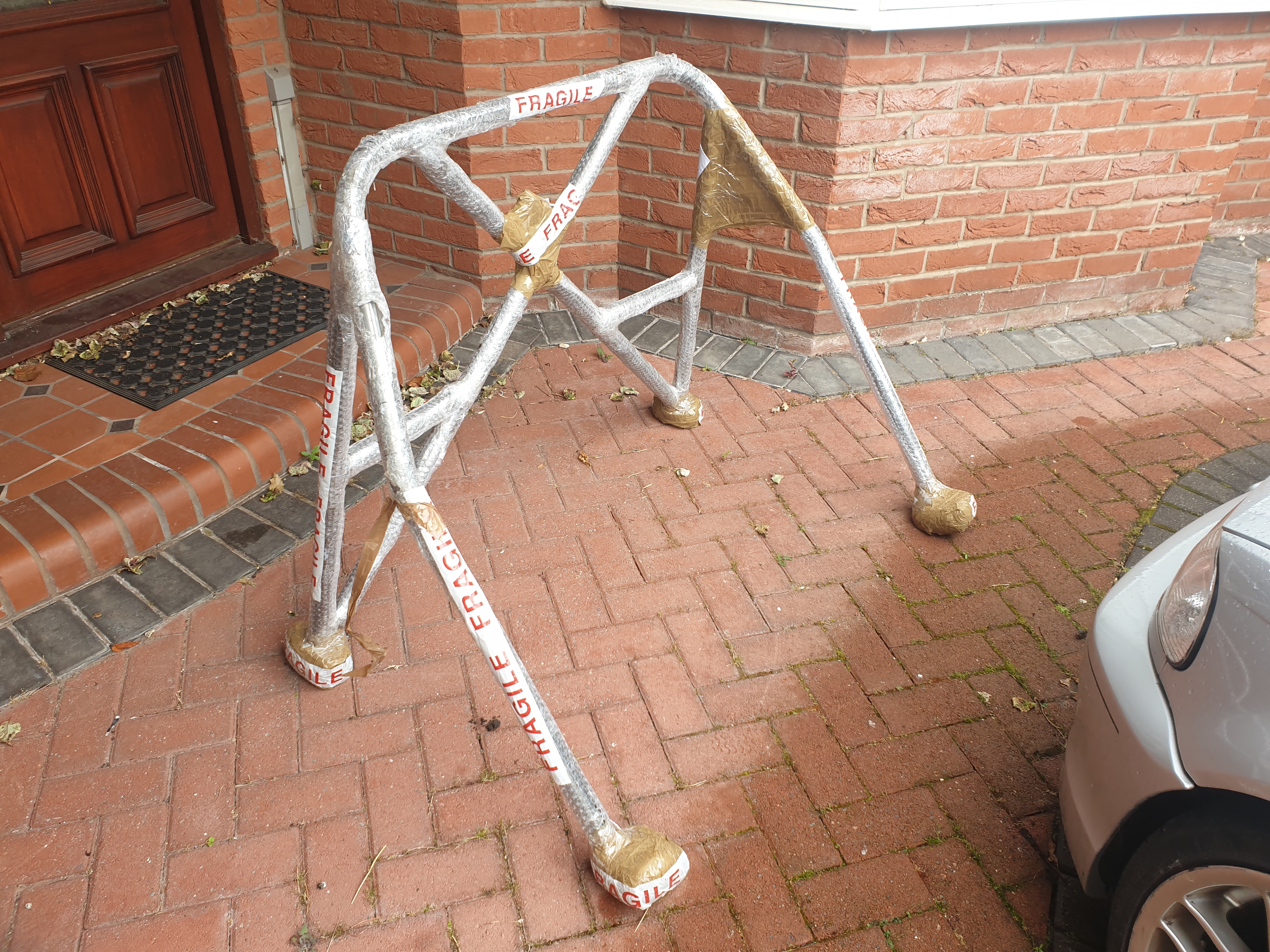

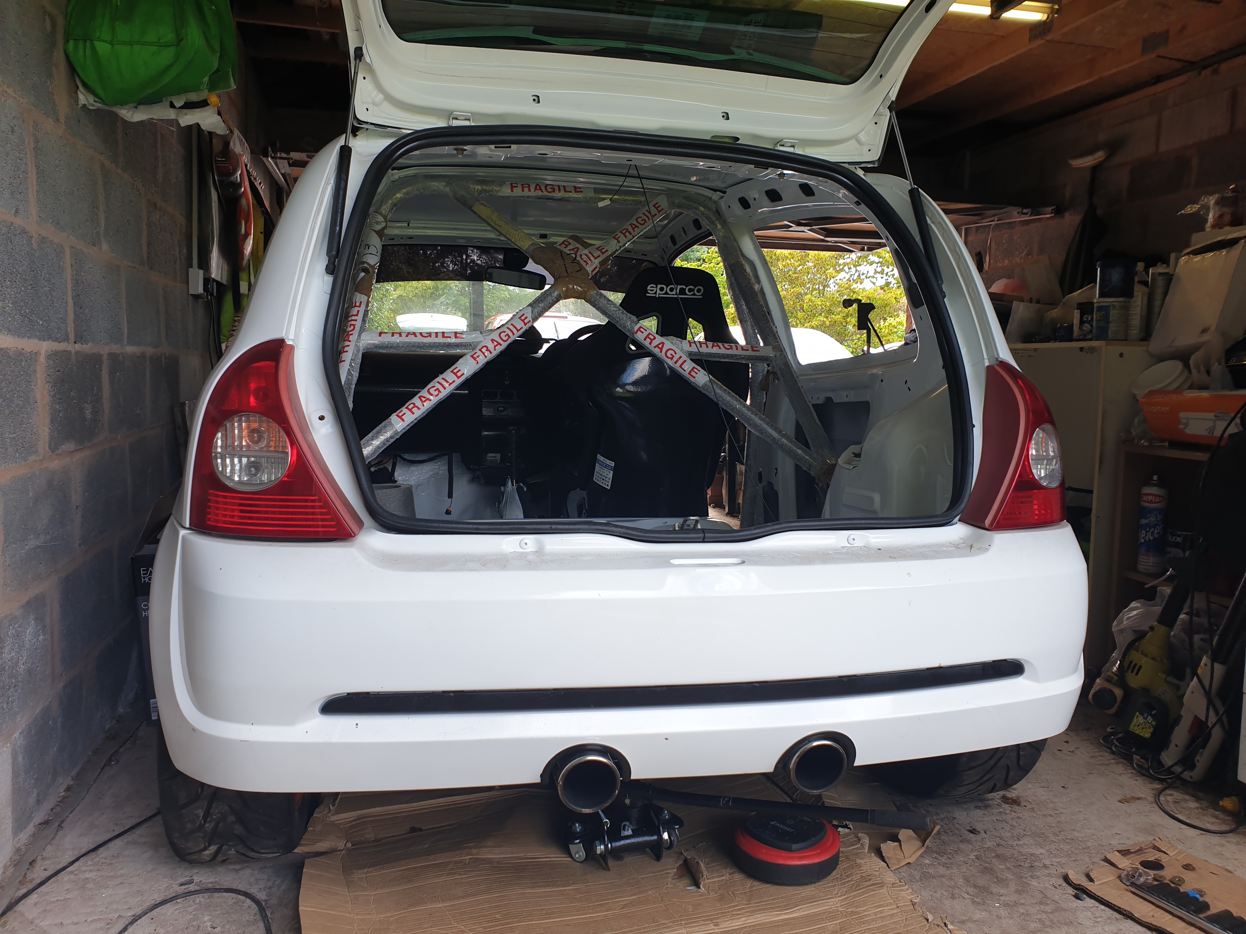

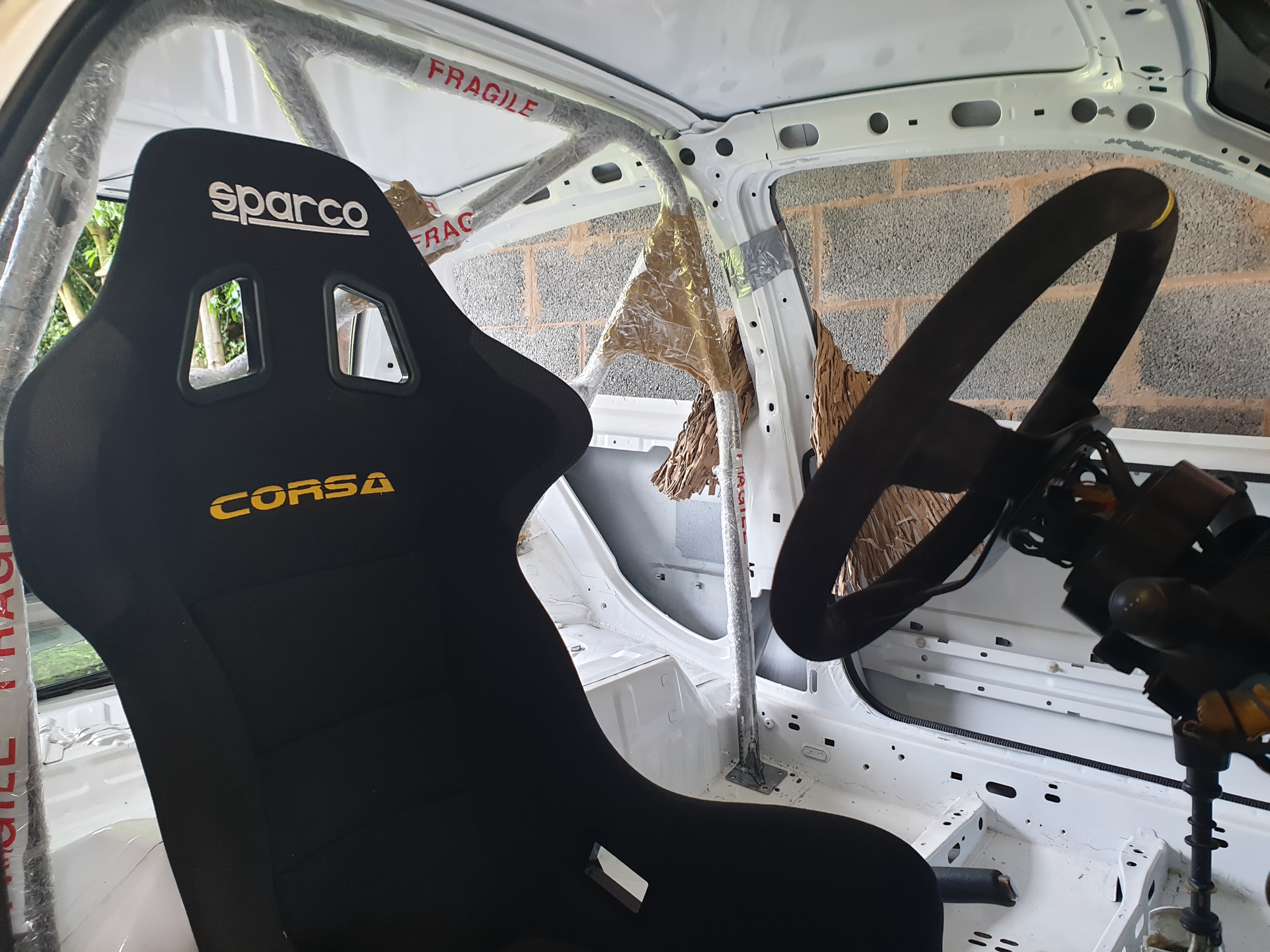

Also have cage colour ? Whats peoples thoughts ?

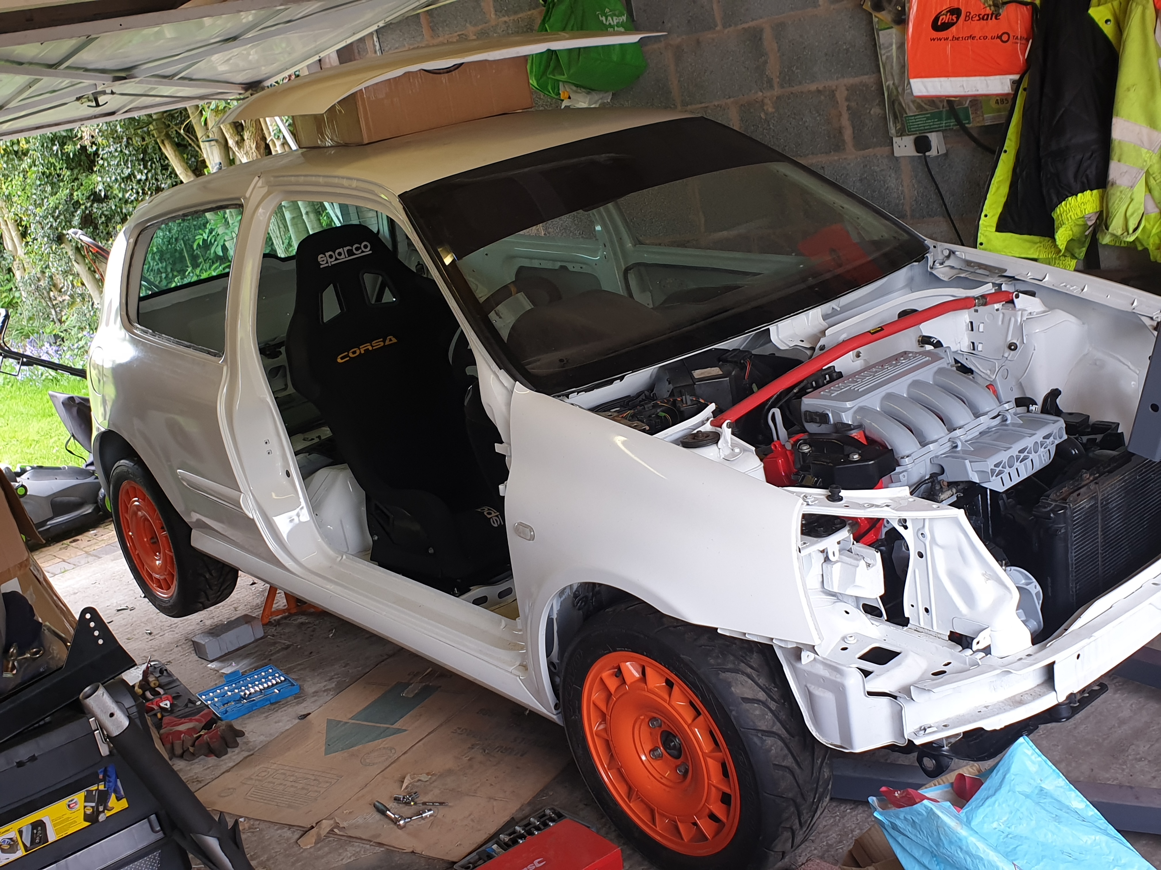

Managed to get abit of time on the white clio today before the wales match. No comments on the result !

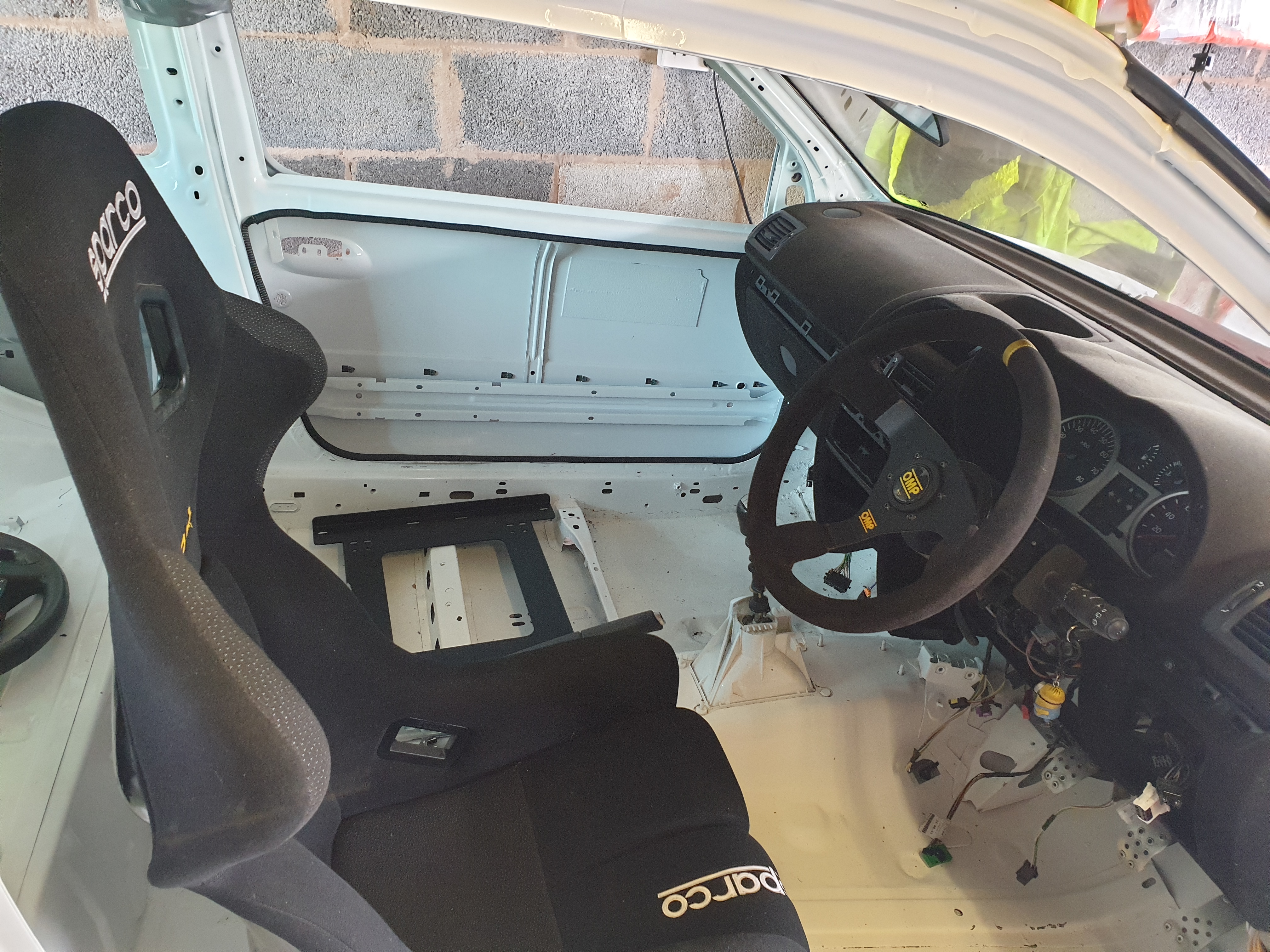

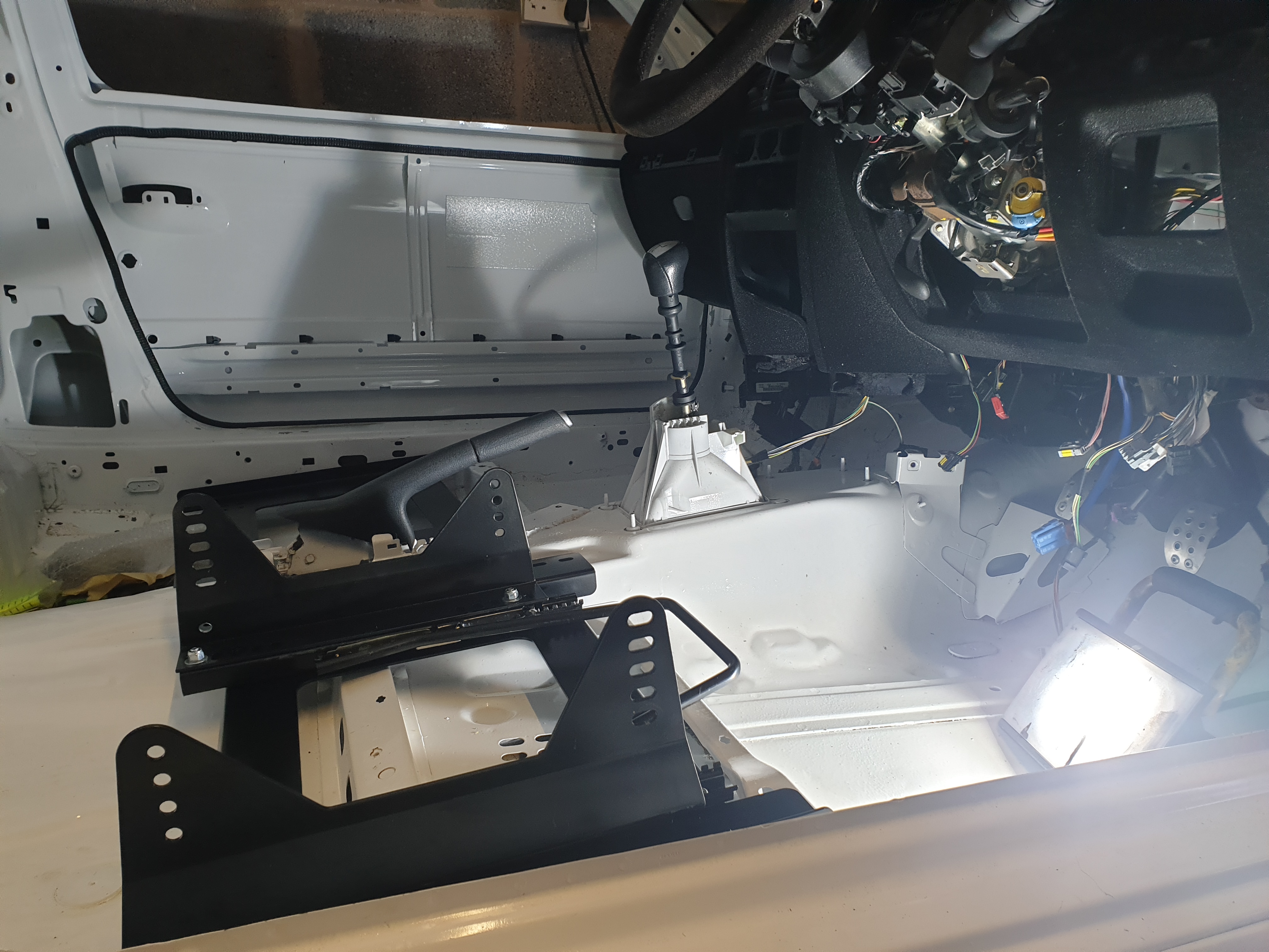

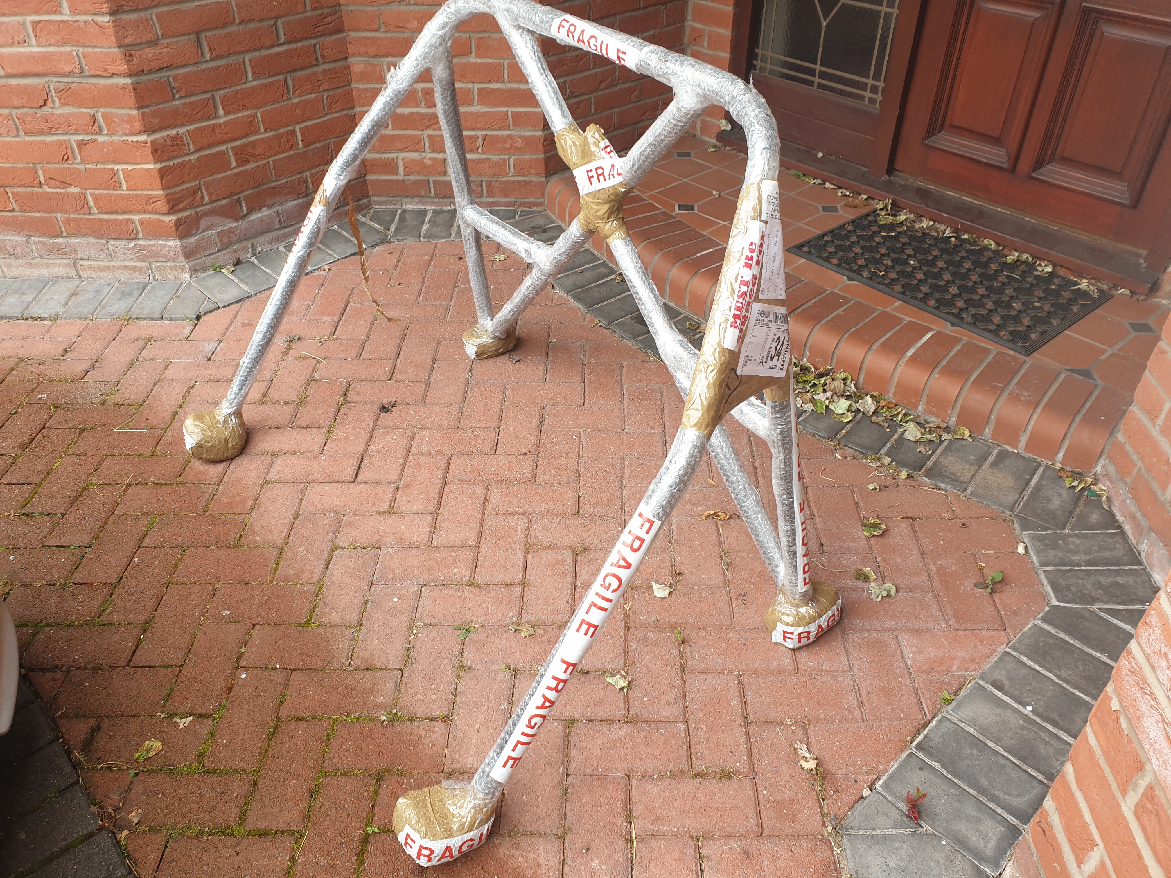

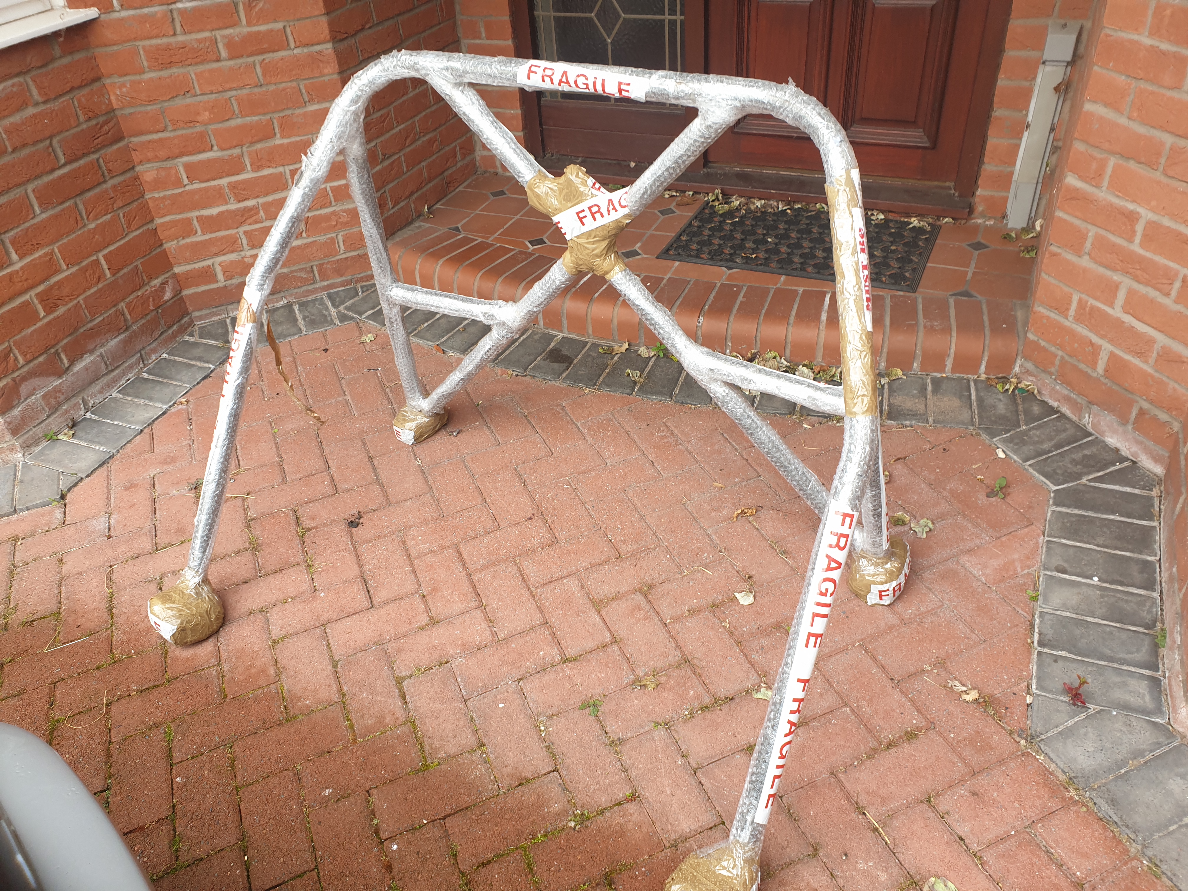

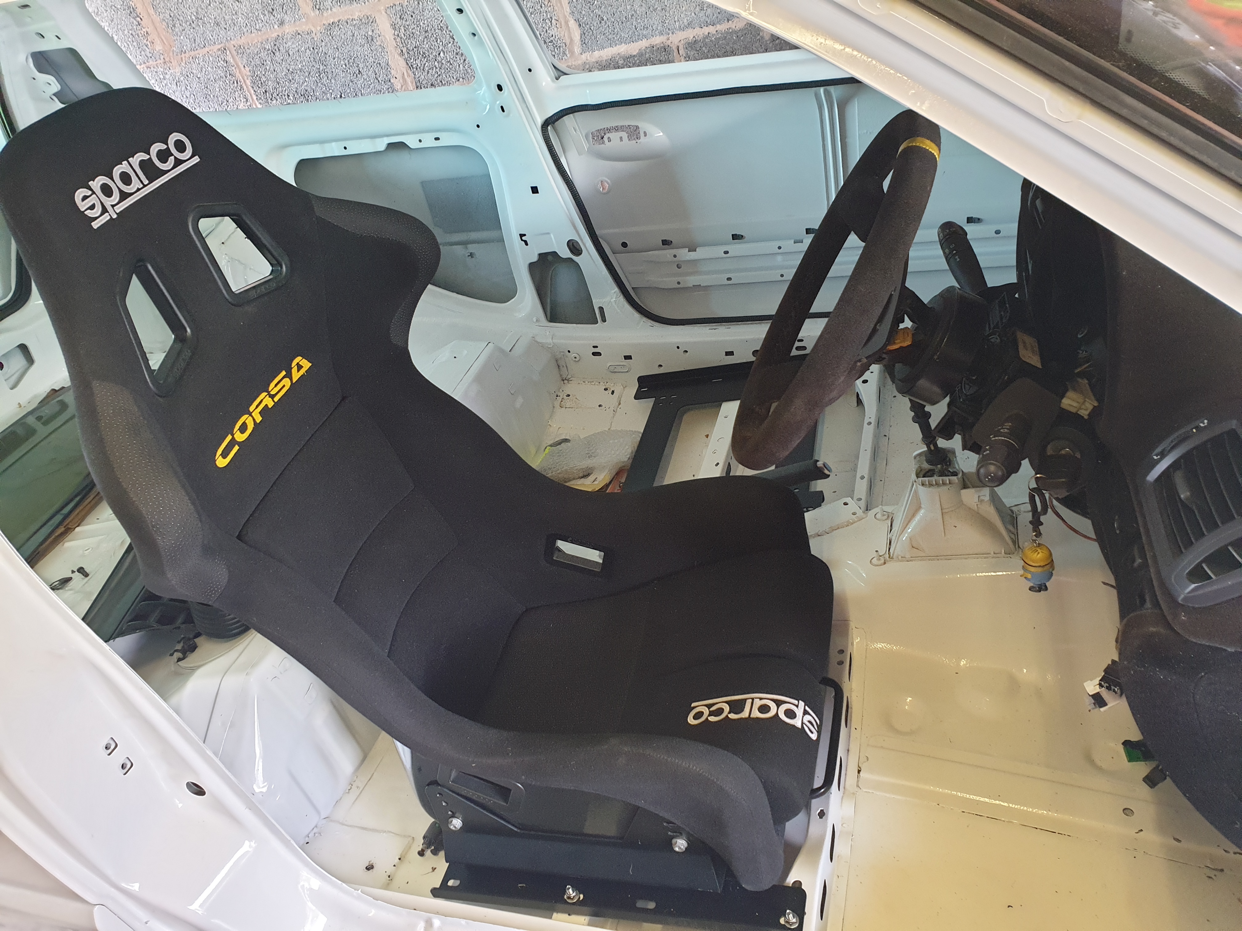

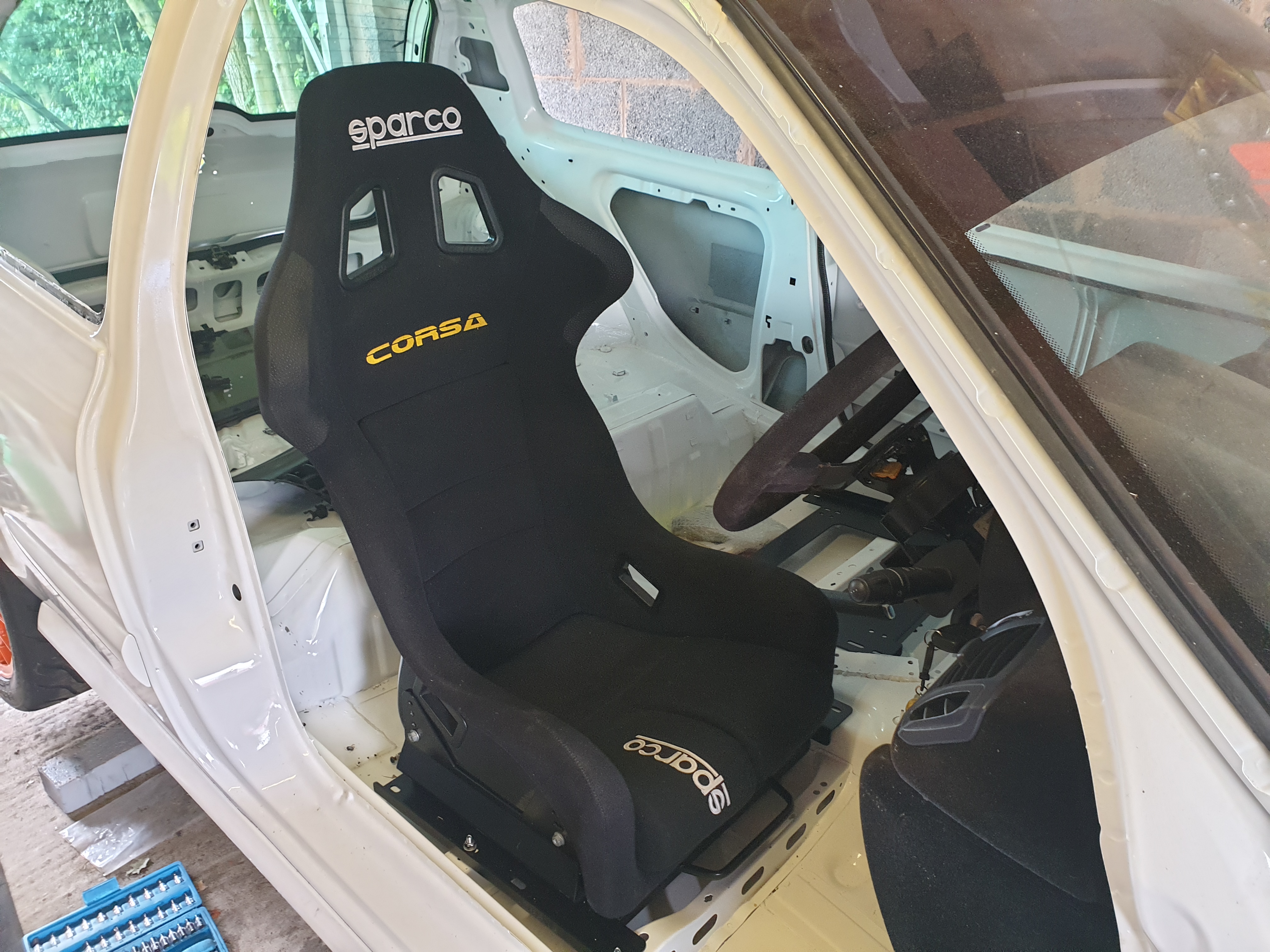

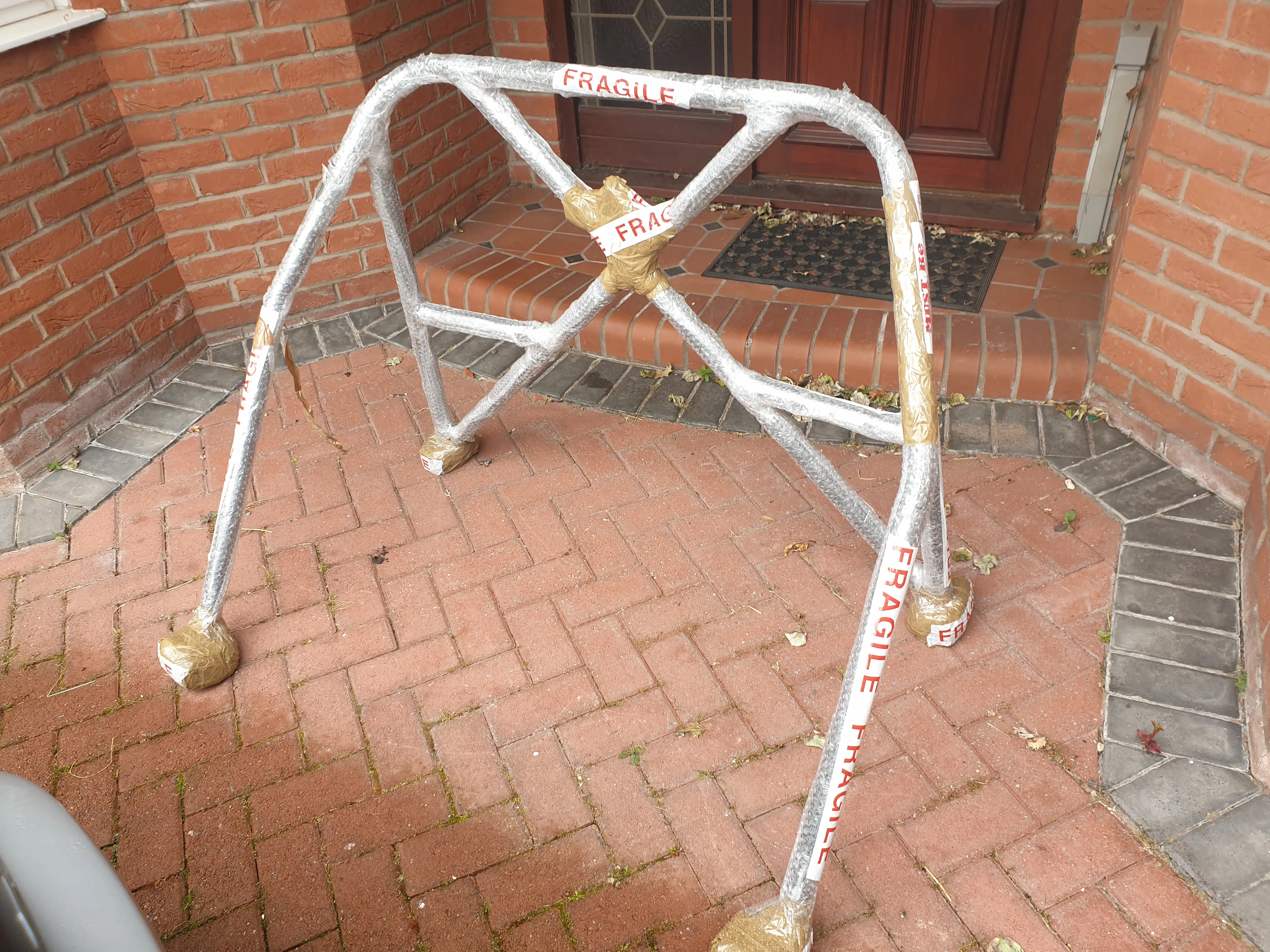

Test fitted the cage , need to get bolted in , bottom feet should be ok but might need to modify the rear strengthening plates.

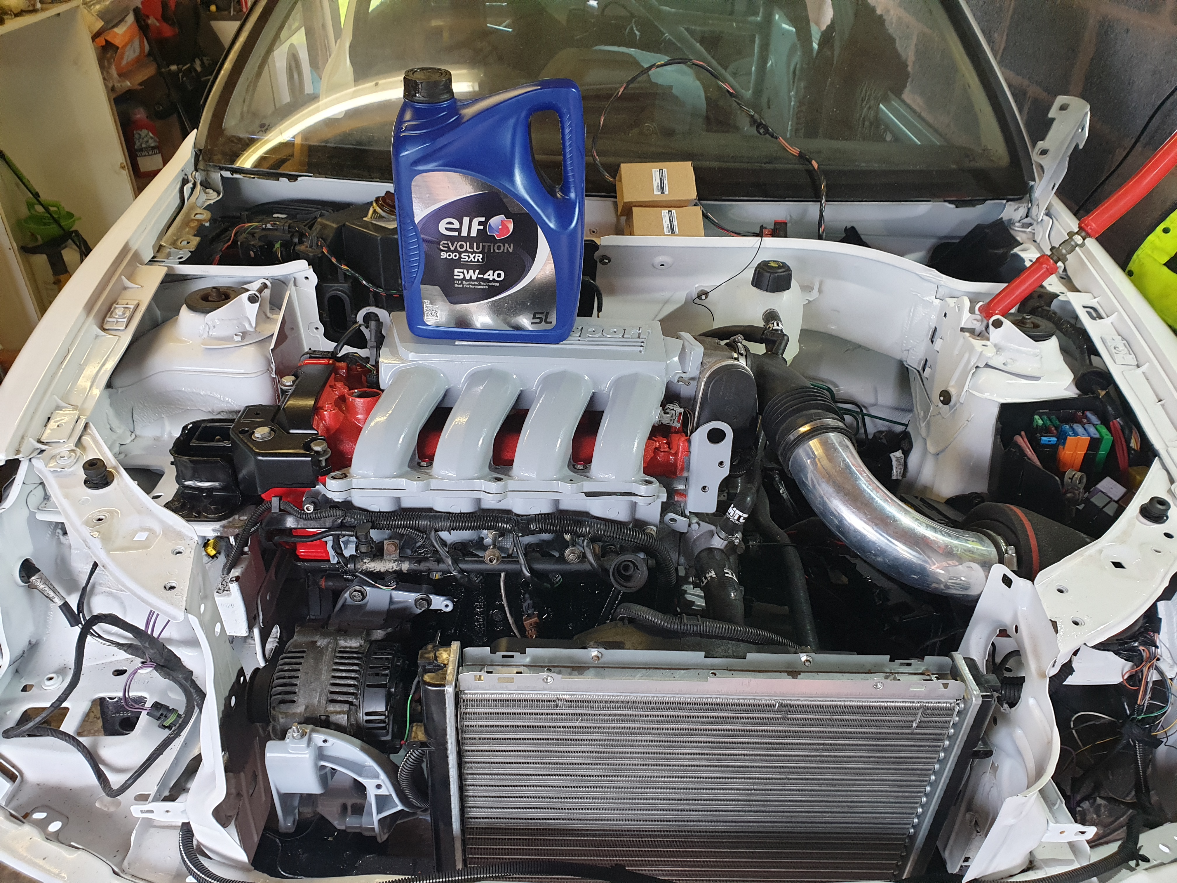

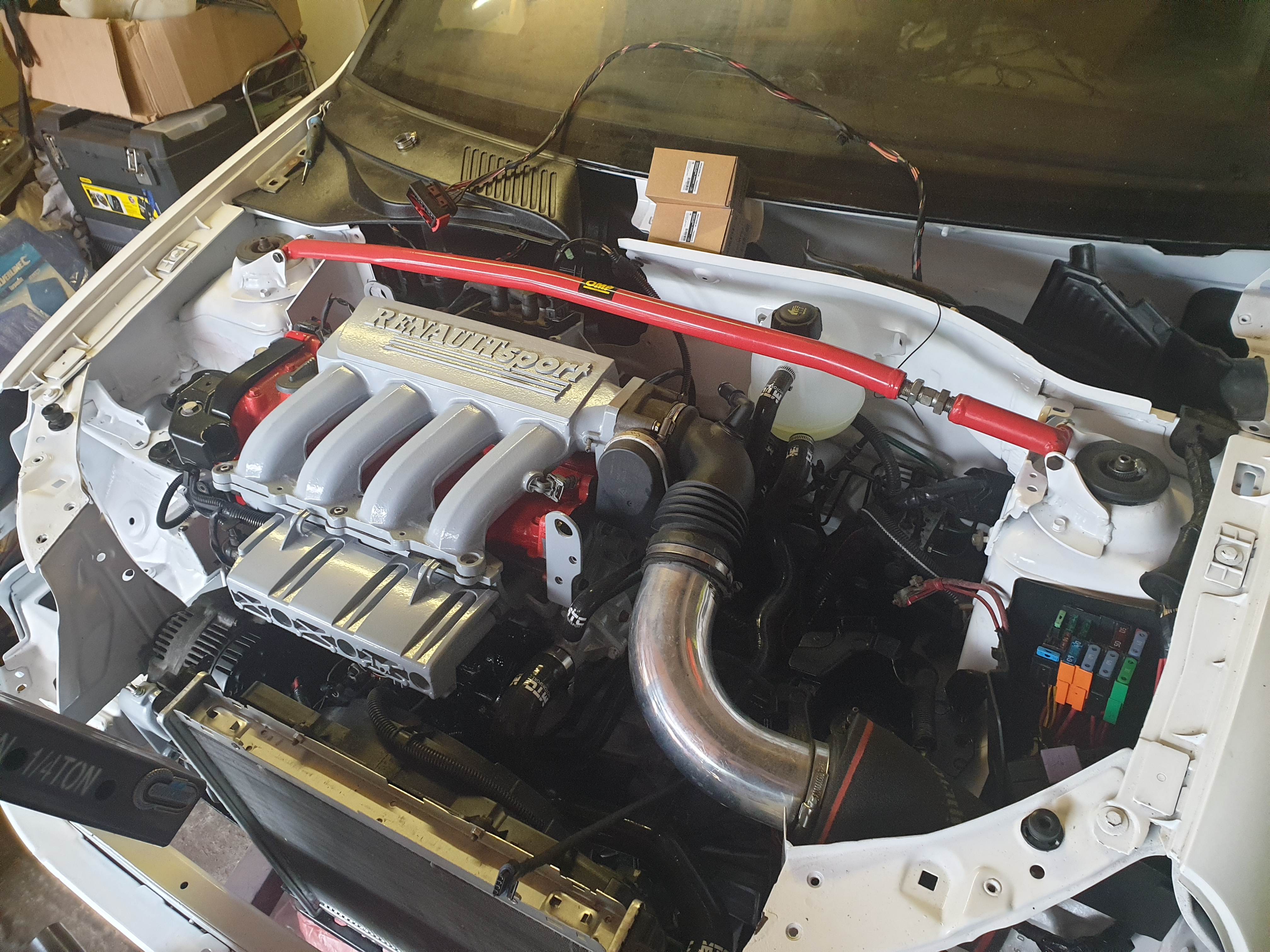

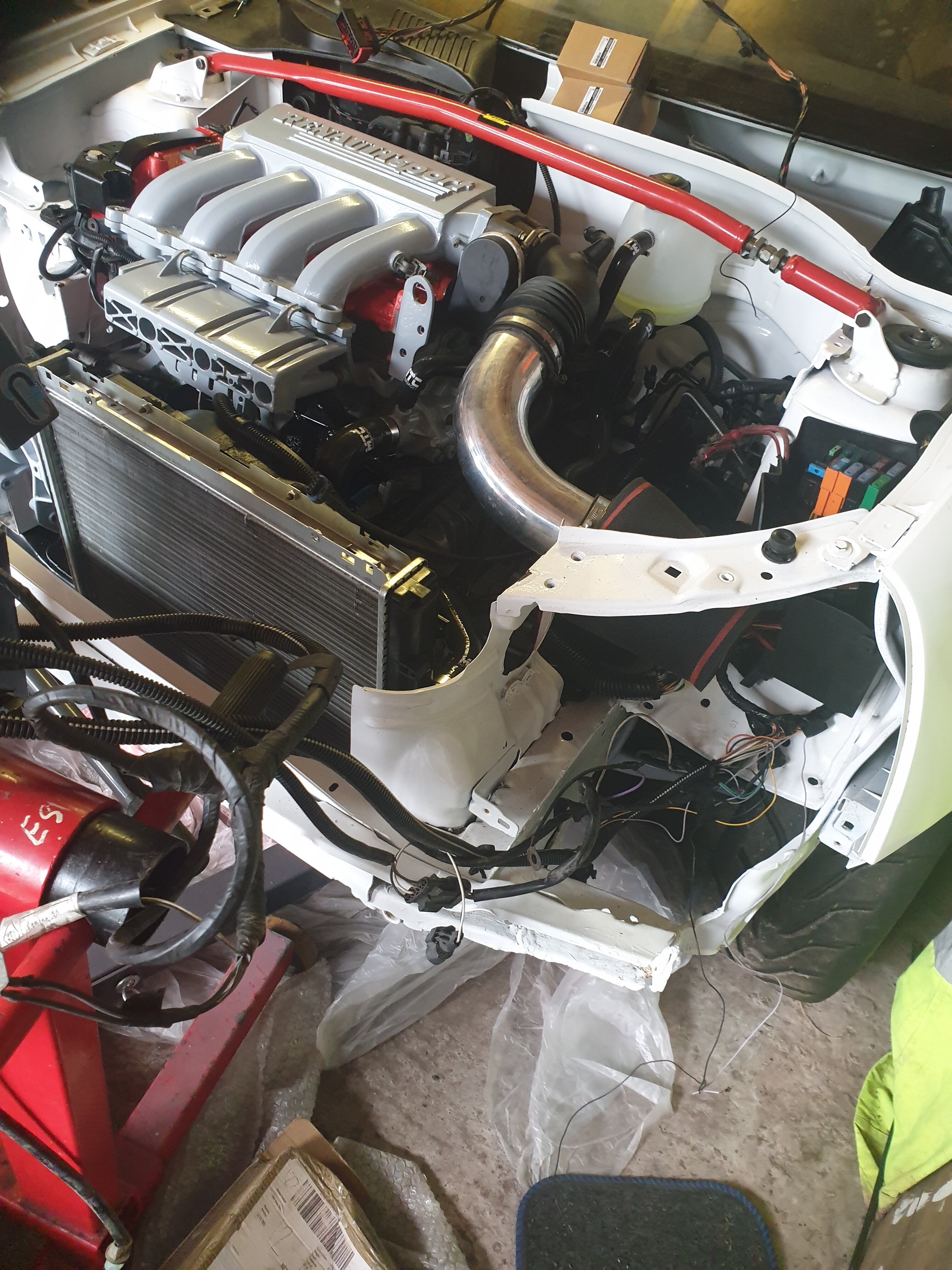

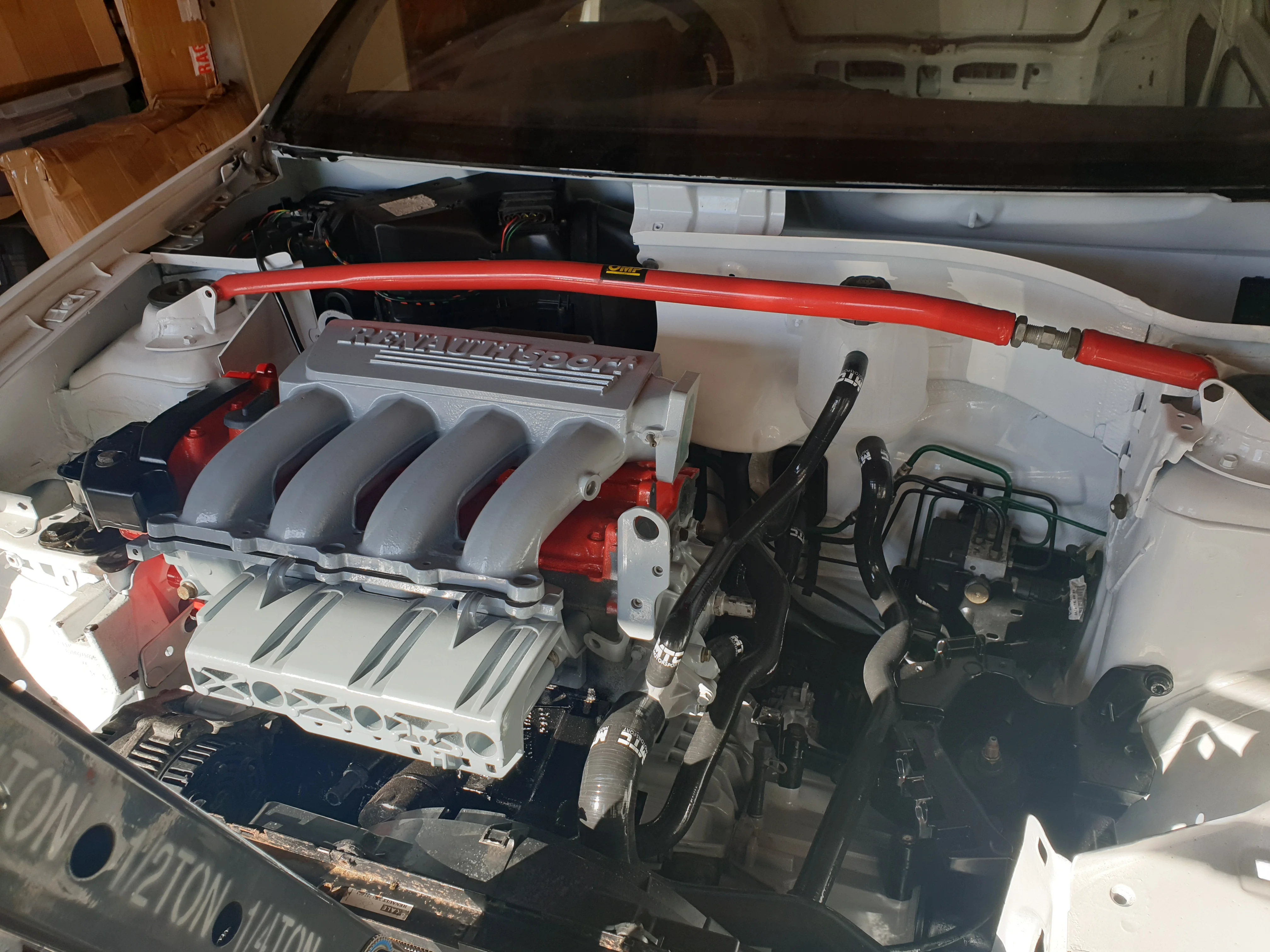

Managed to get the car to start firstime !

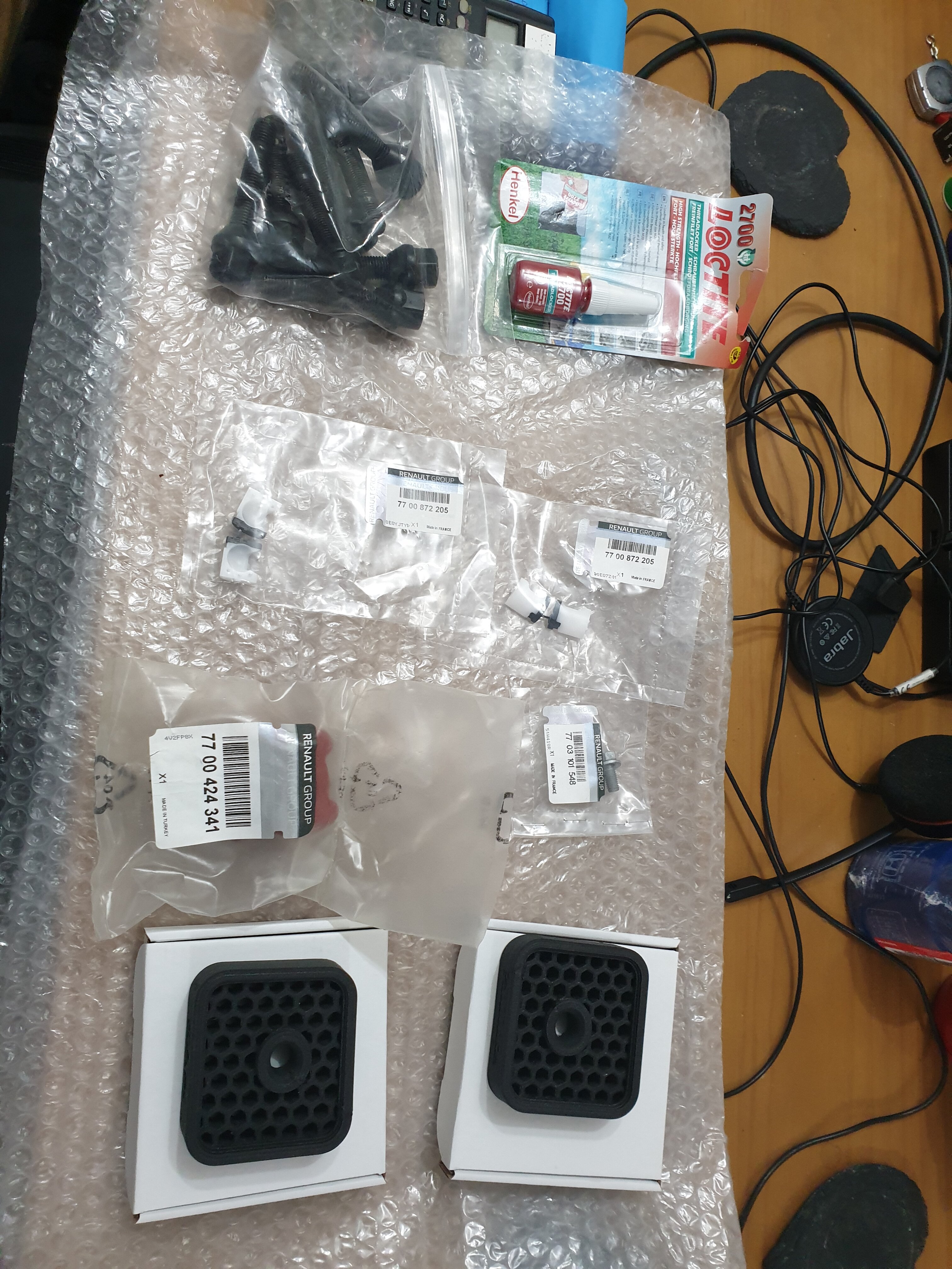

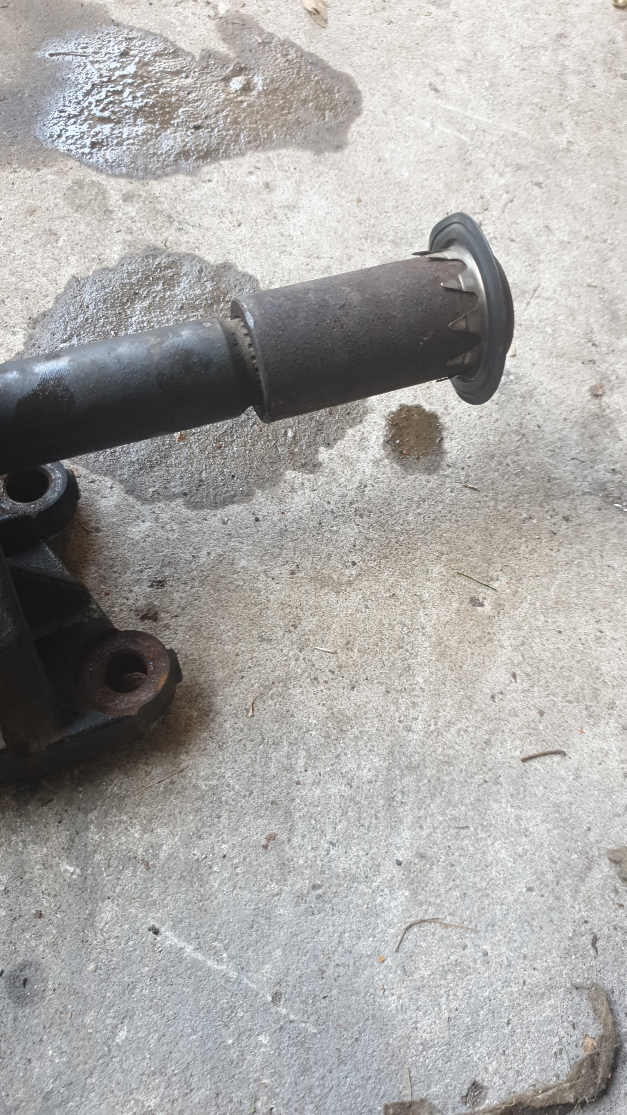

Had a fuel leak ! Rubber o ring had seen better days ,luckily i had 2 connectors from ktec so just replaced o ring and all good.

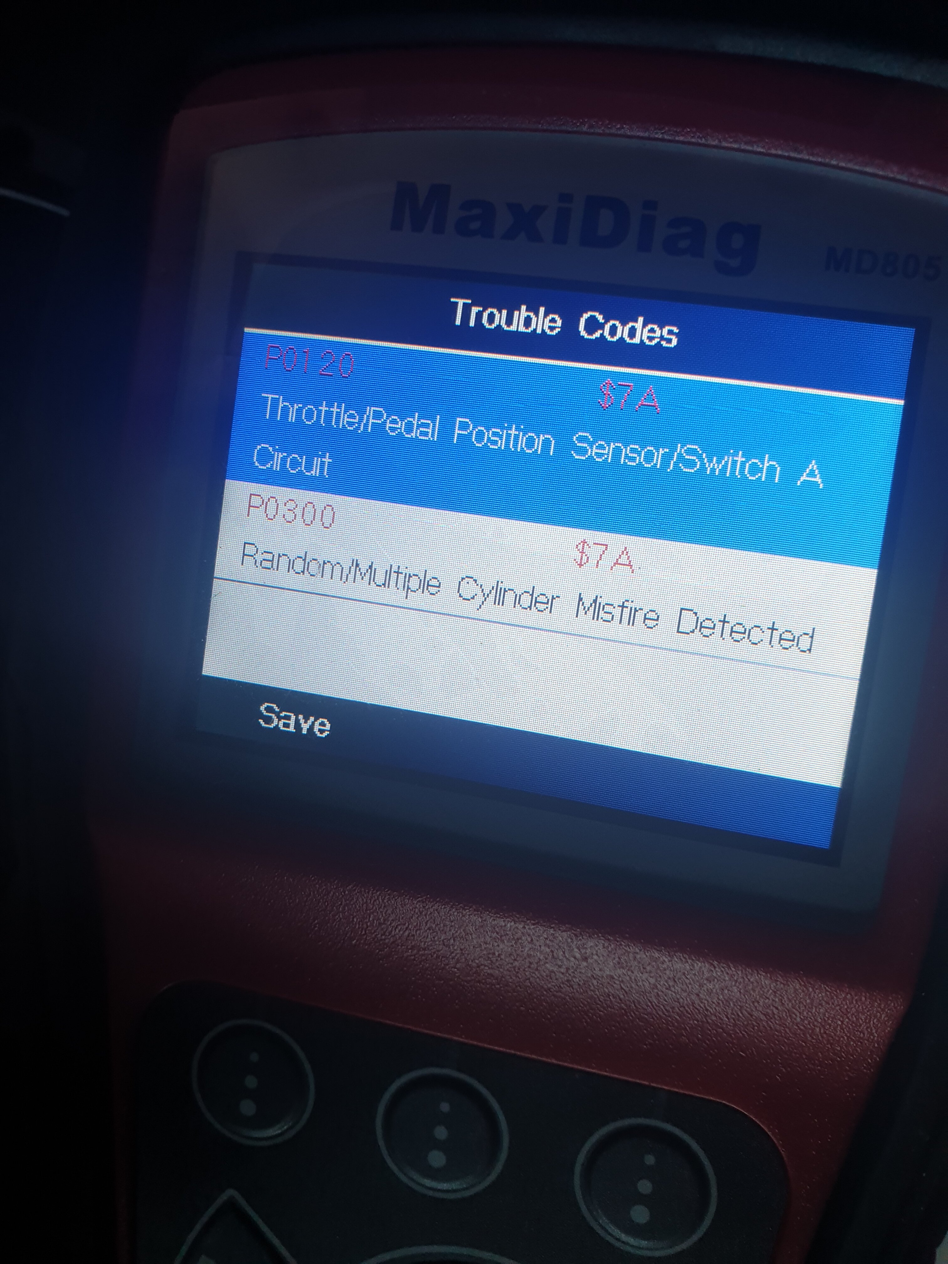

Car was idling at 3000 rpm so likely a vacuum leak , put fresh gaskets and double checked inlets on refit. Idling was now around 1000 but seemed to be struggling and flashing on dash to indicate fault.
Swapped
Swapped pedal which removed one code.

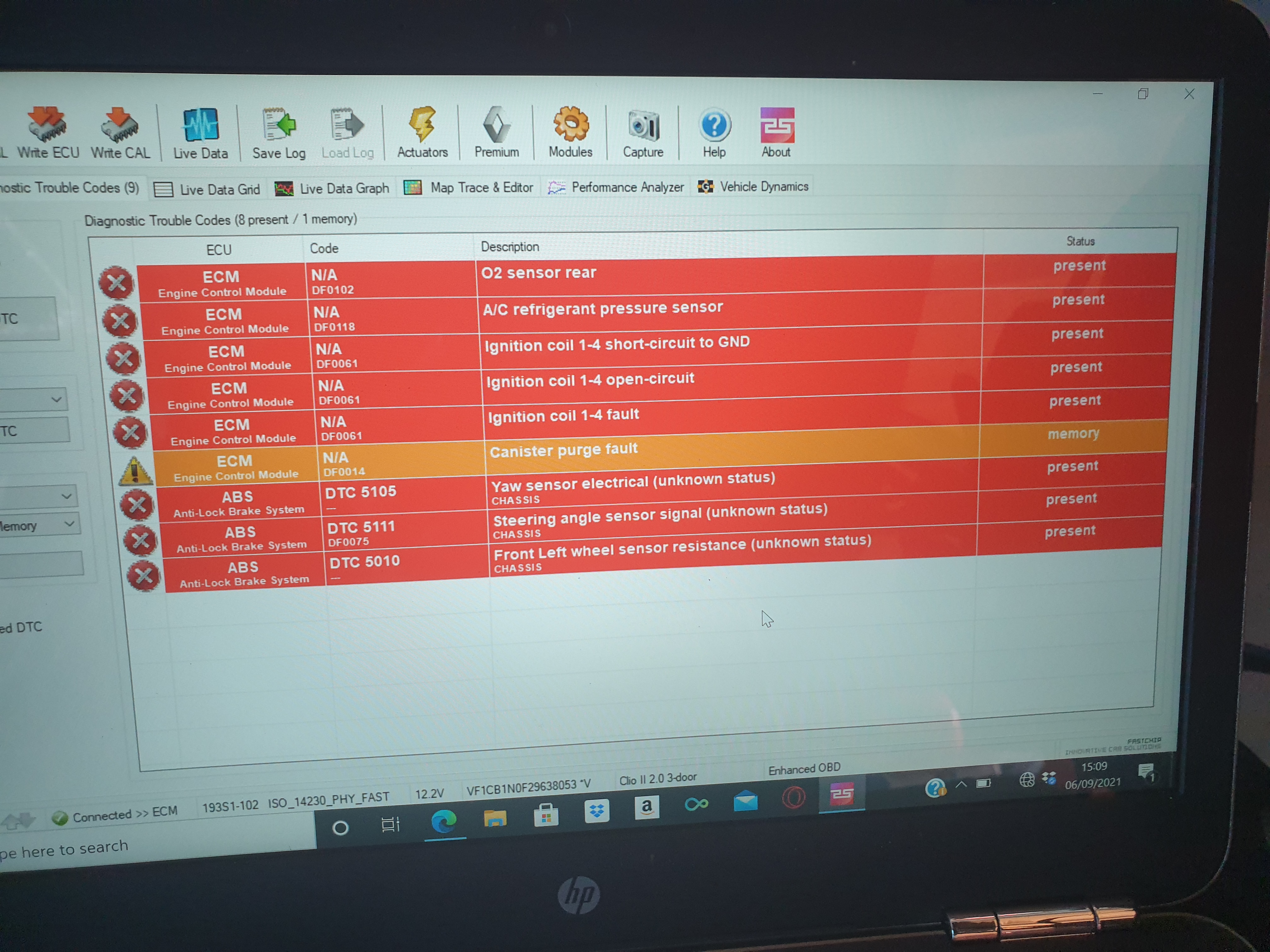

Took my laptop and Rs tuner down tonight to see if i got any clearer codes and this is what i got , i'm hoping its coil pack rather than a wiring fault.
This is one hell of a build and a good read.
Can I ask where you got the cage from?
Thanks buddy its the guy on ebay , i just emailed him directly and paid him via paypal. I can send you his email address if you want to get in touch.
Need to get mine powder caoted once i sort the strengthening plates
