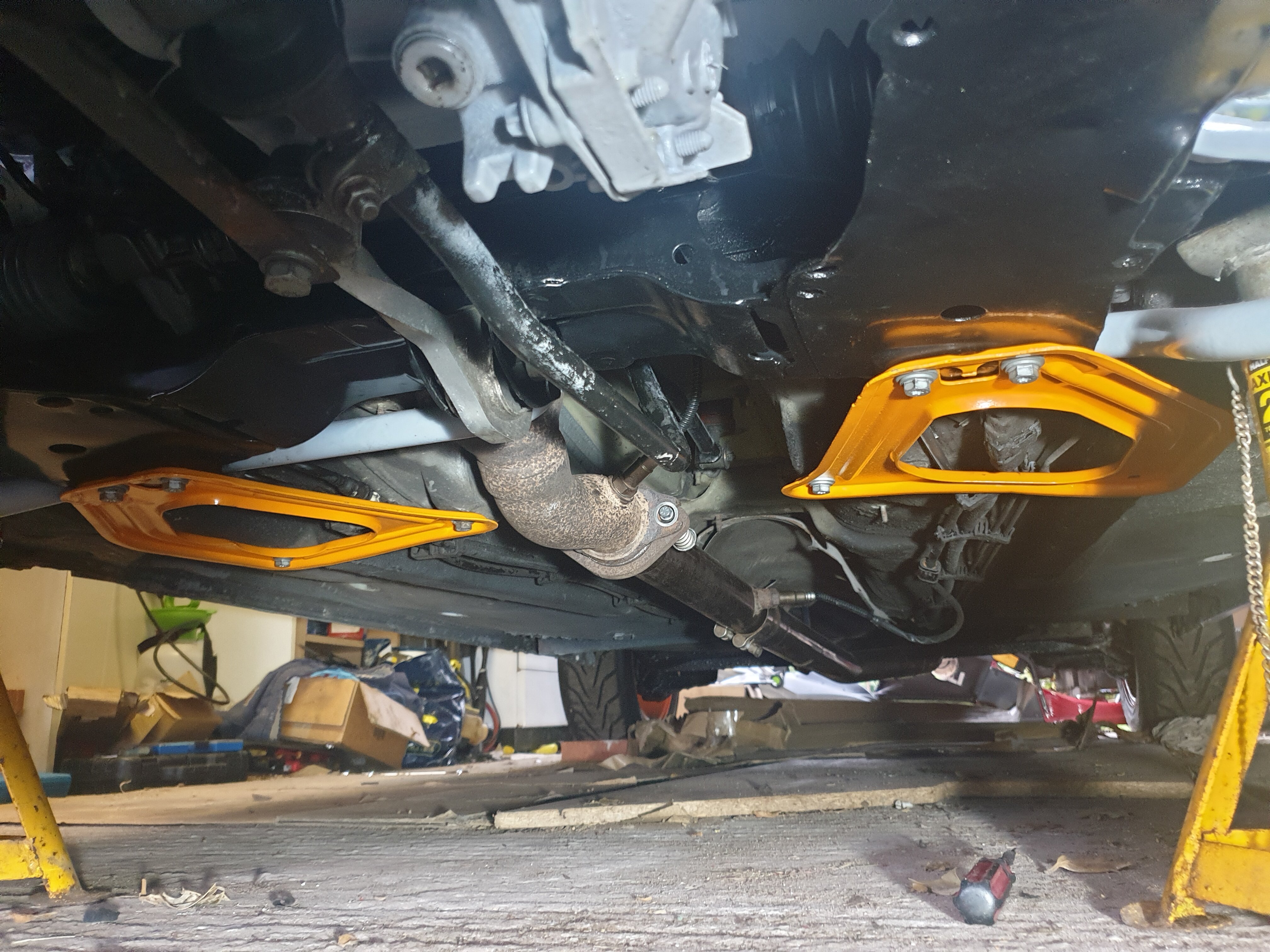

Thanks buddy its the guy on ebay , i just emailed him directly and paid him via paypal. I can send you his email address if you want to get in touch.
Need to get mine powder caoted once i sort the strengthening plates

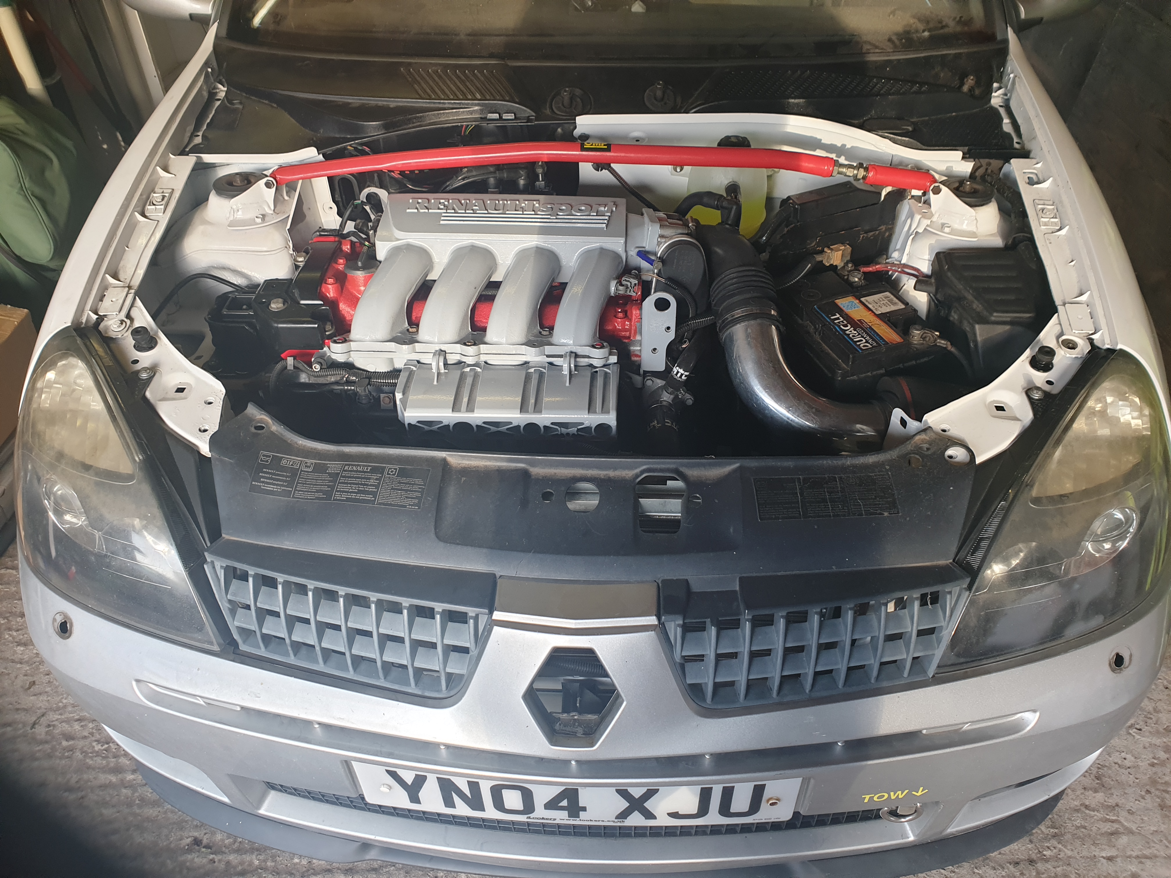

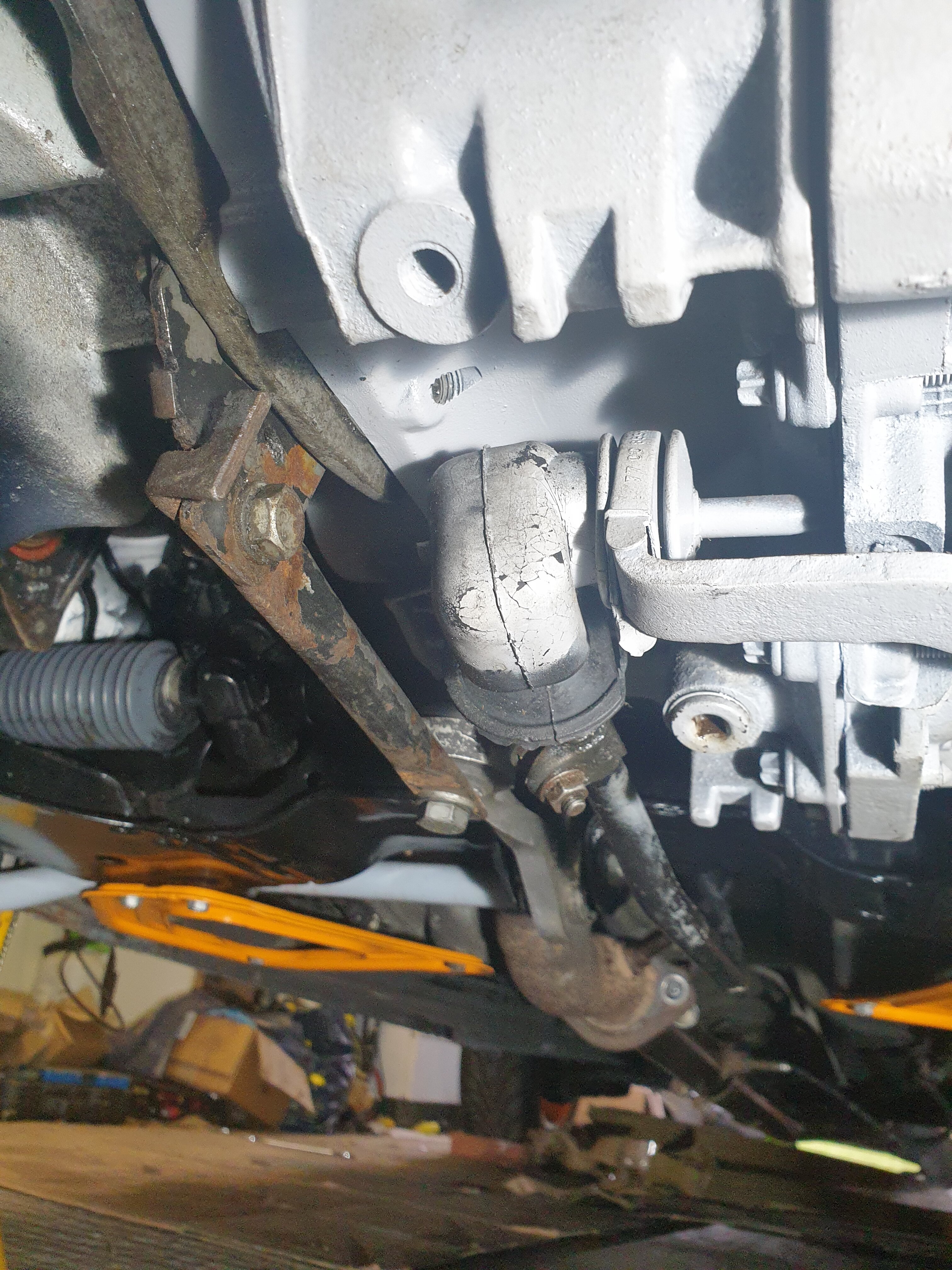

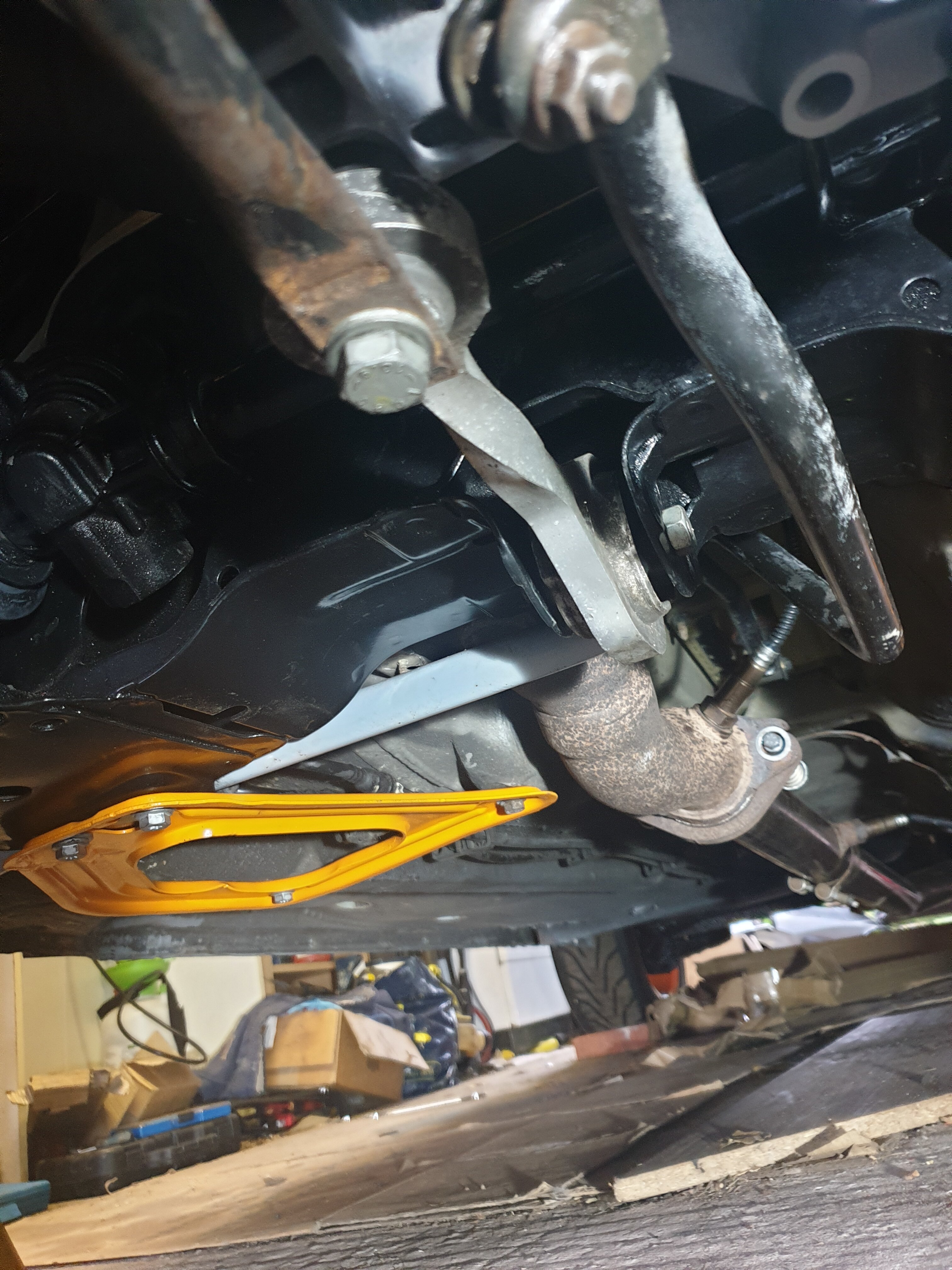

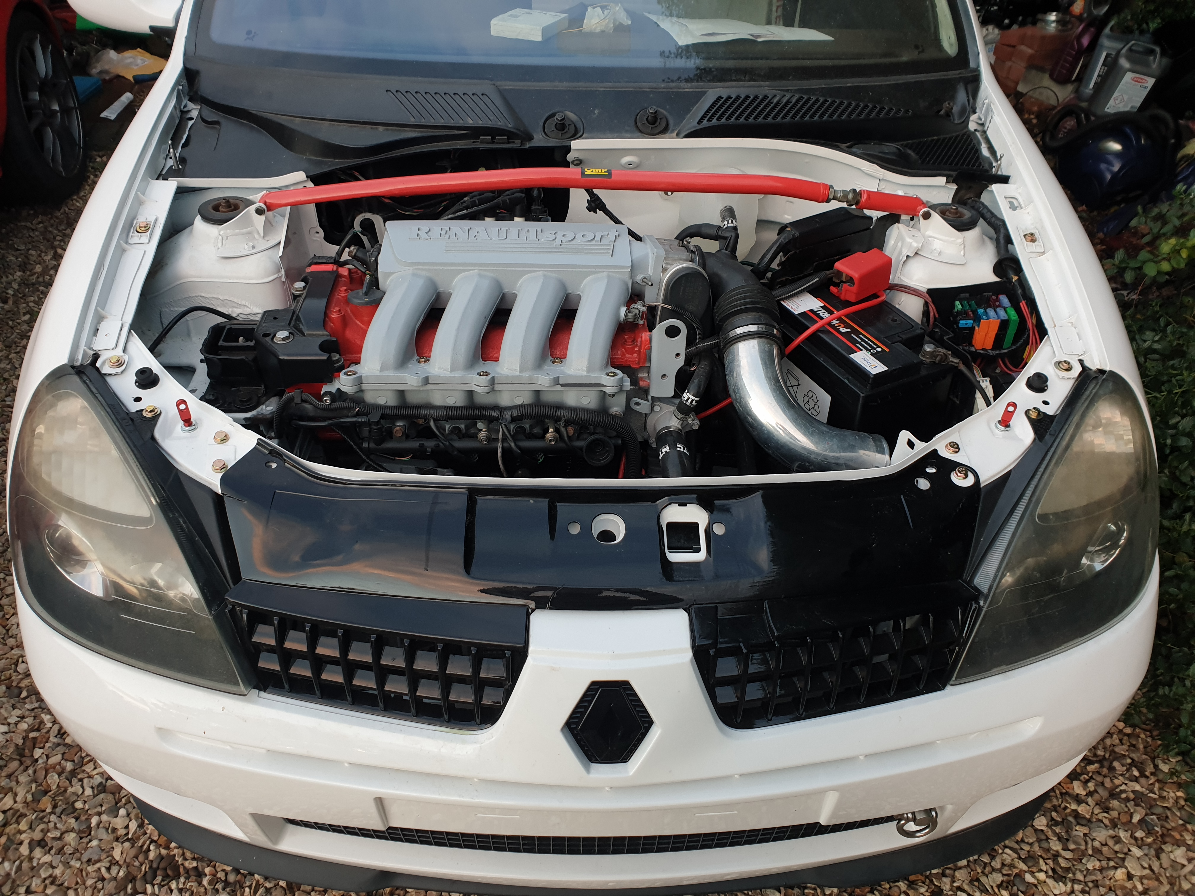

Managed to get the oem dogbone mount in and aligned eventually after undoing the manifold and exhaust !

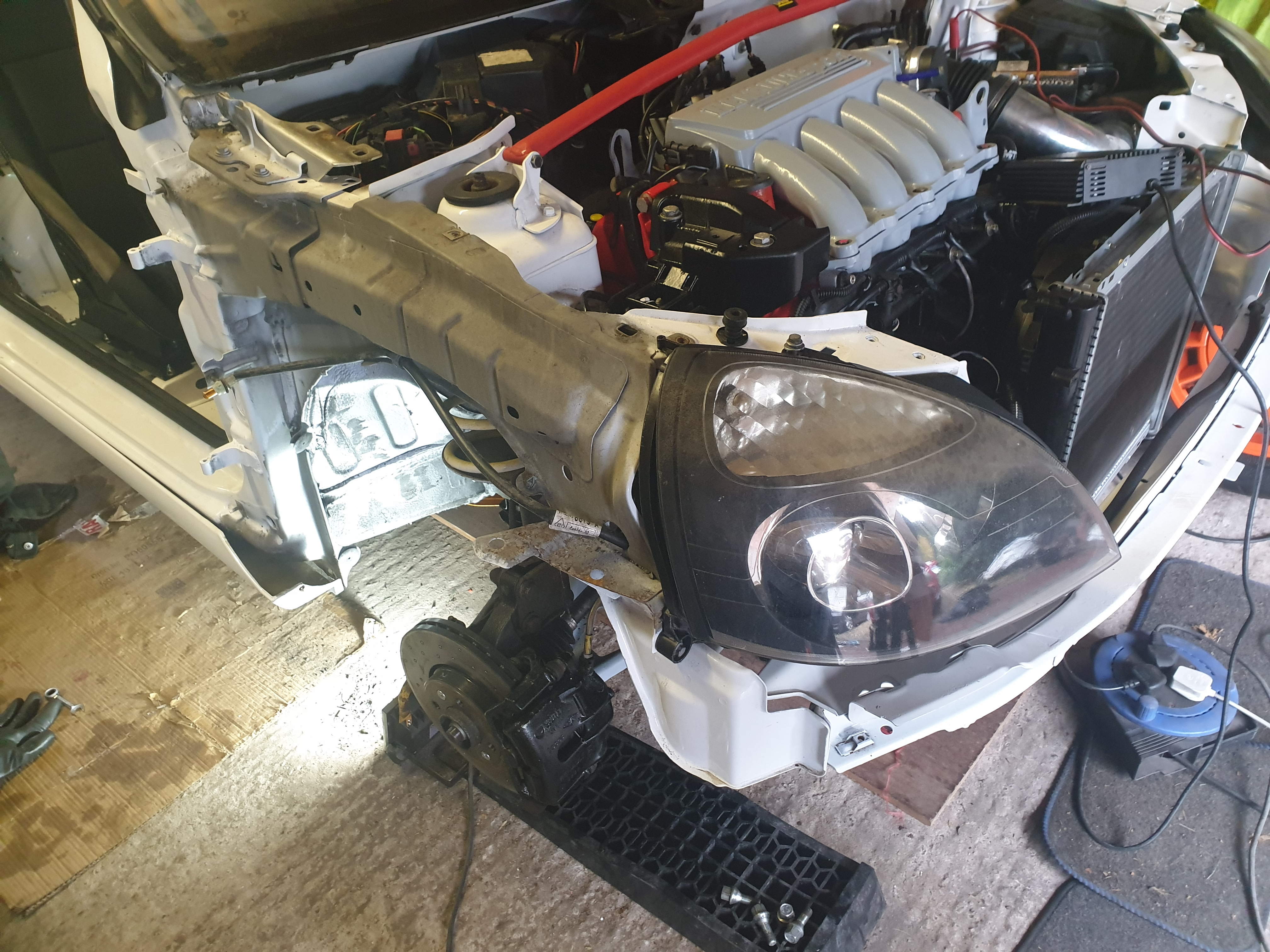

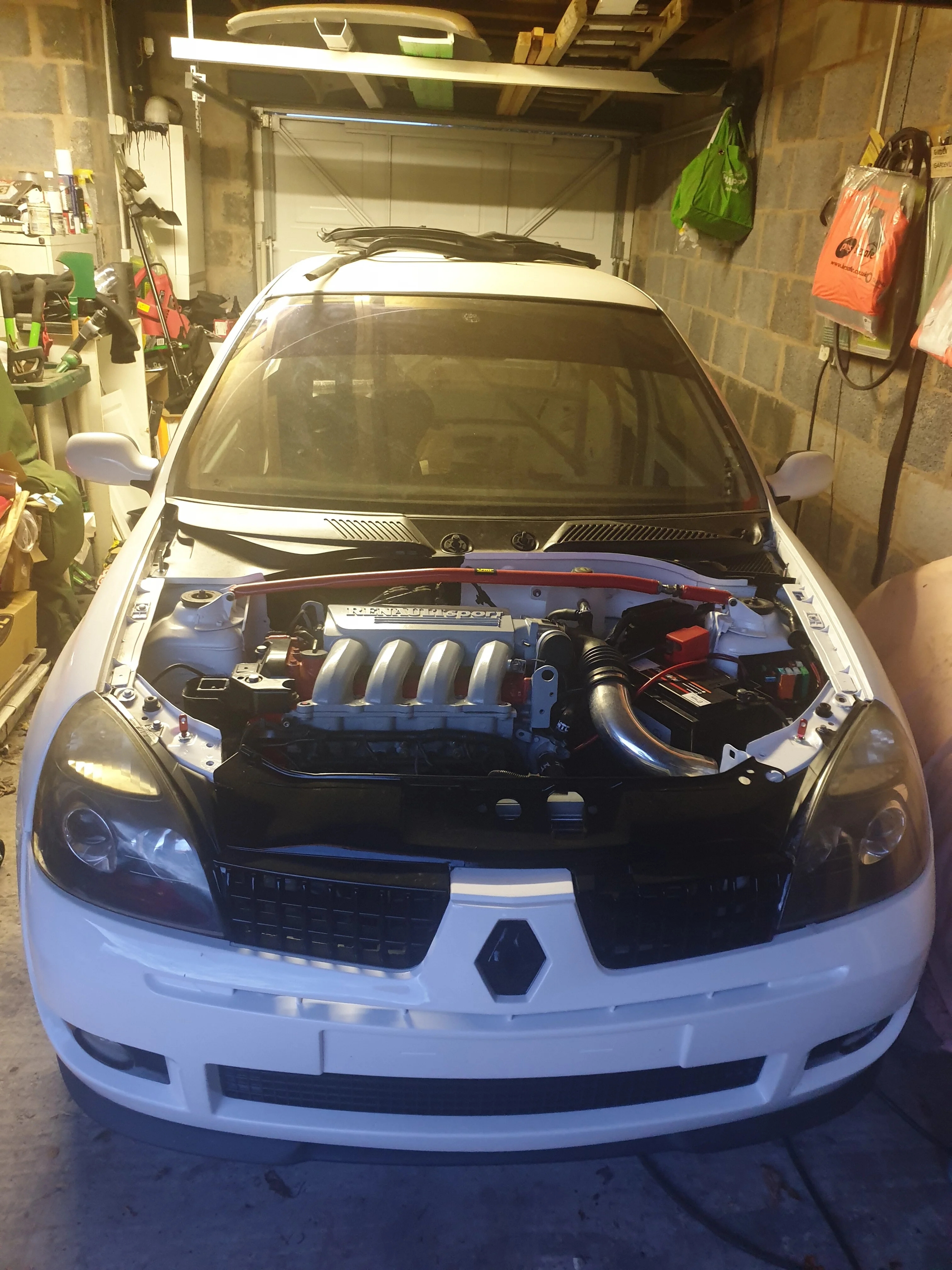

Not much done today on this , fitted washer bottle , wiper motor and scuttles and front headlamps.
They lights need a good polish !

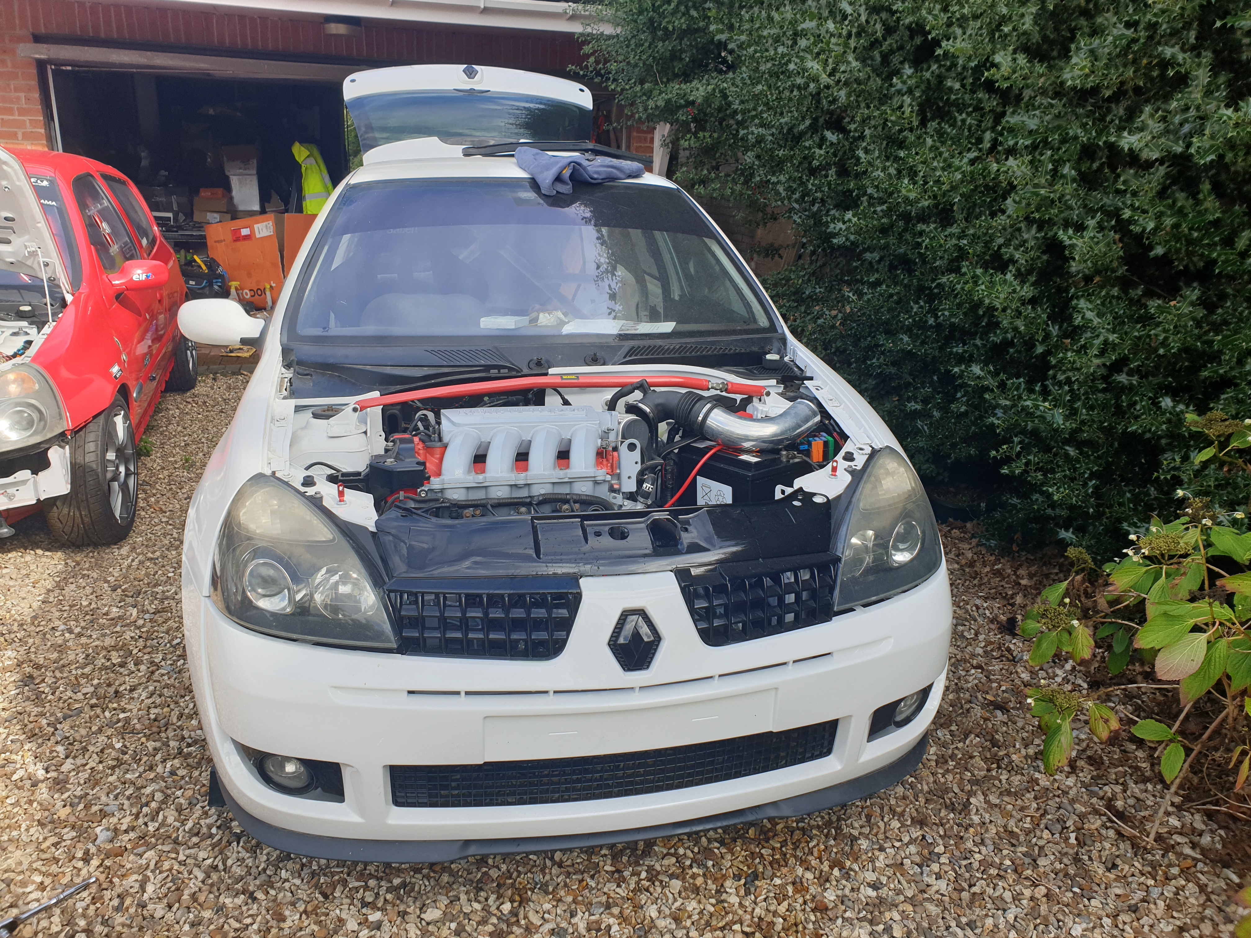

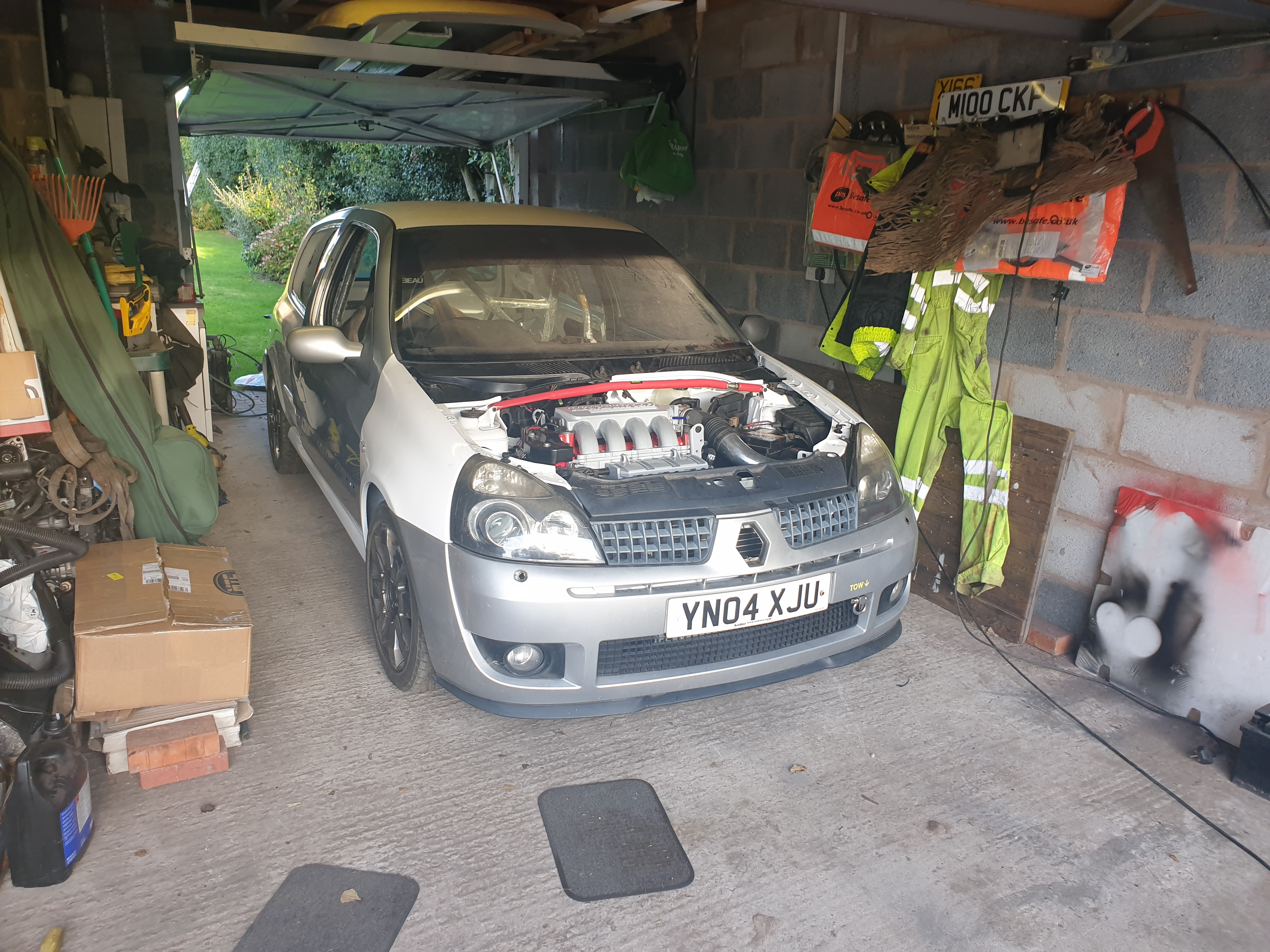

Furthest its moved since i bought it ! I dont appear to have reverse at the moment 😂😂

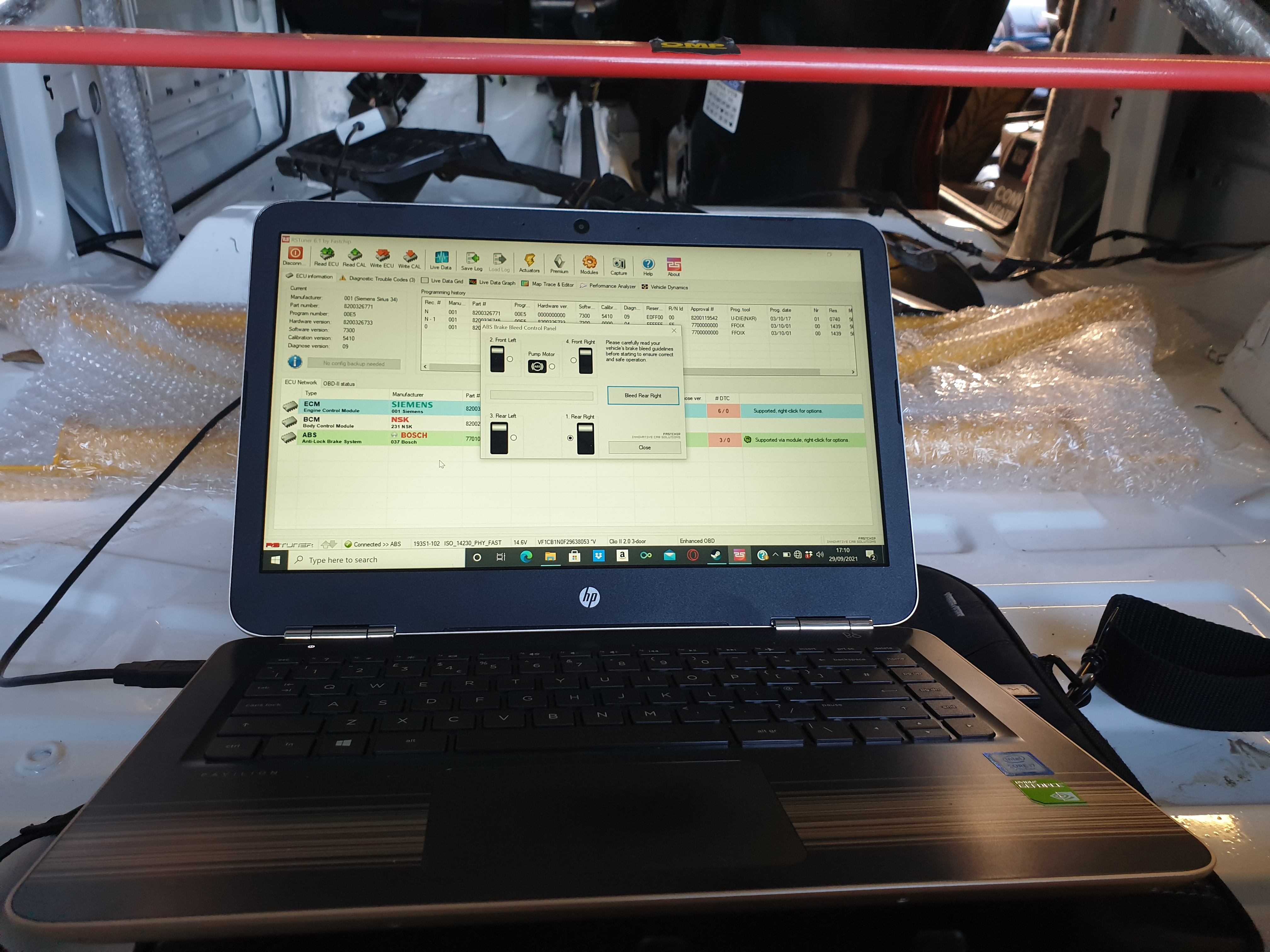

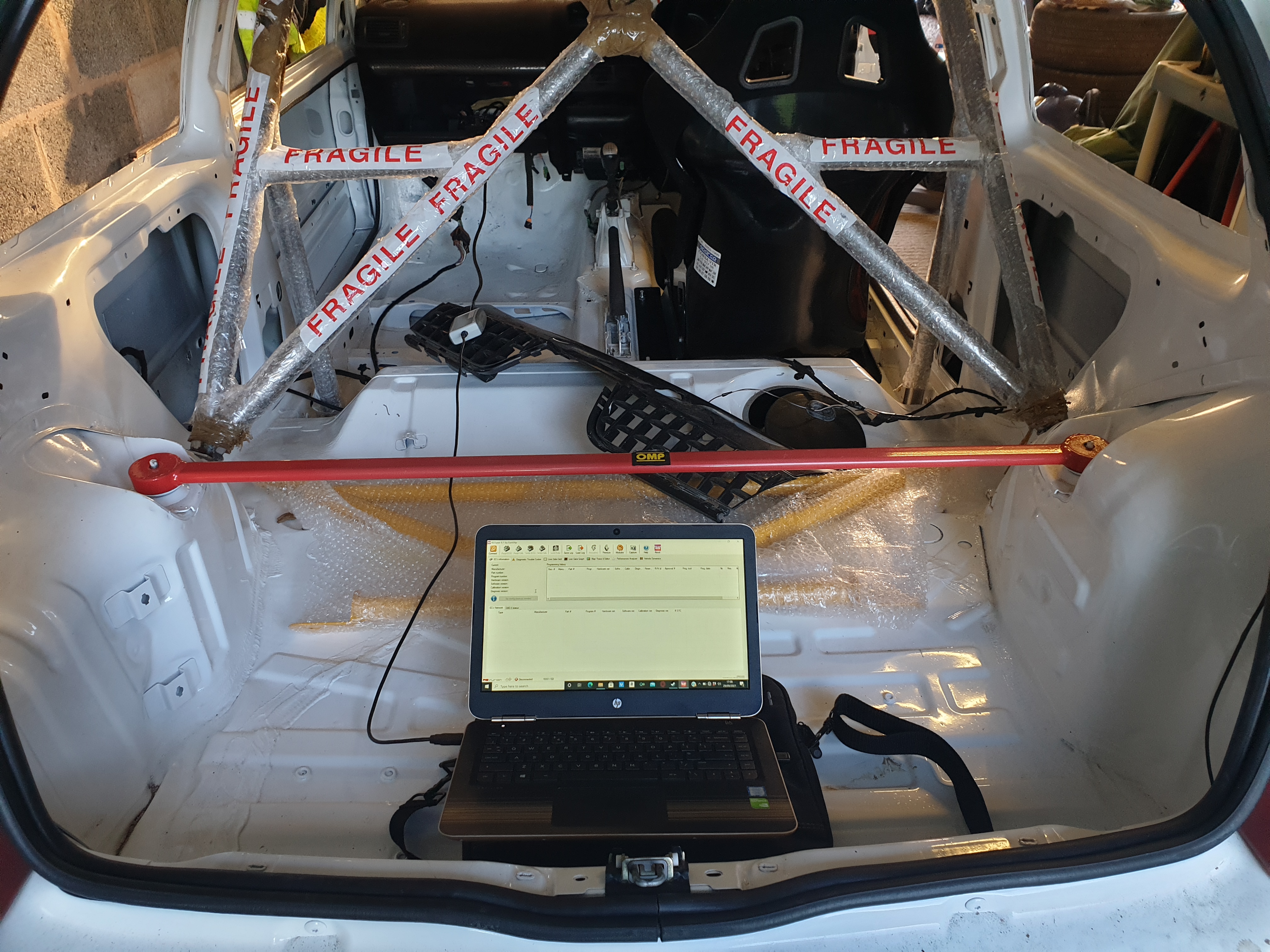

After brake bleeding the car with my new toy , the pedal felt pretty good.
Had nightmare trying to bleed the abs using the Rs tuner , rear right bleeds but then any other caliper it comes up with an error.
After afew days of searching i found something on here that somebody got around the error by pressing pump motor then selecting which side to bleed and it would allow me to do it without the error message. Clearly a bug in the software !

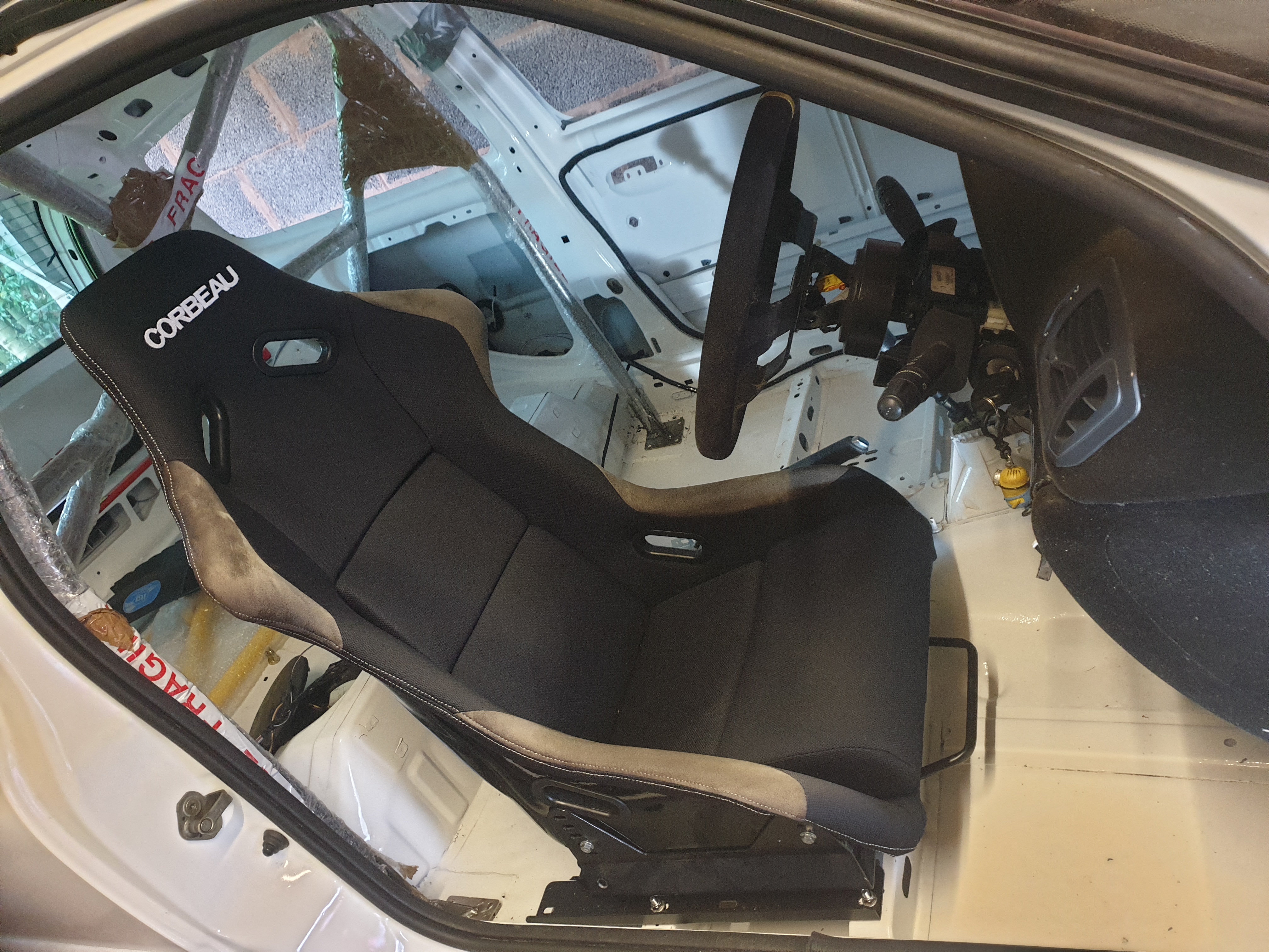

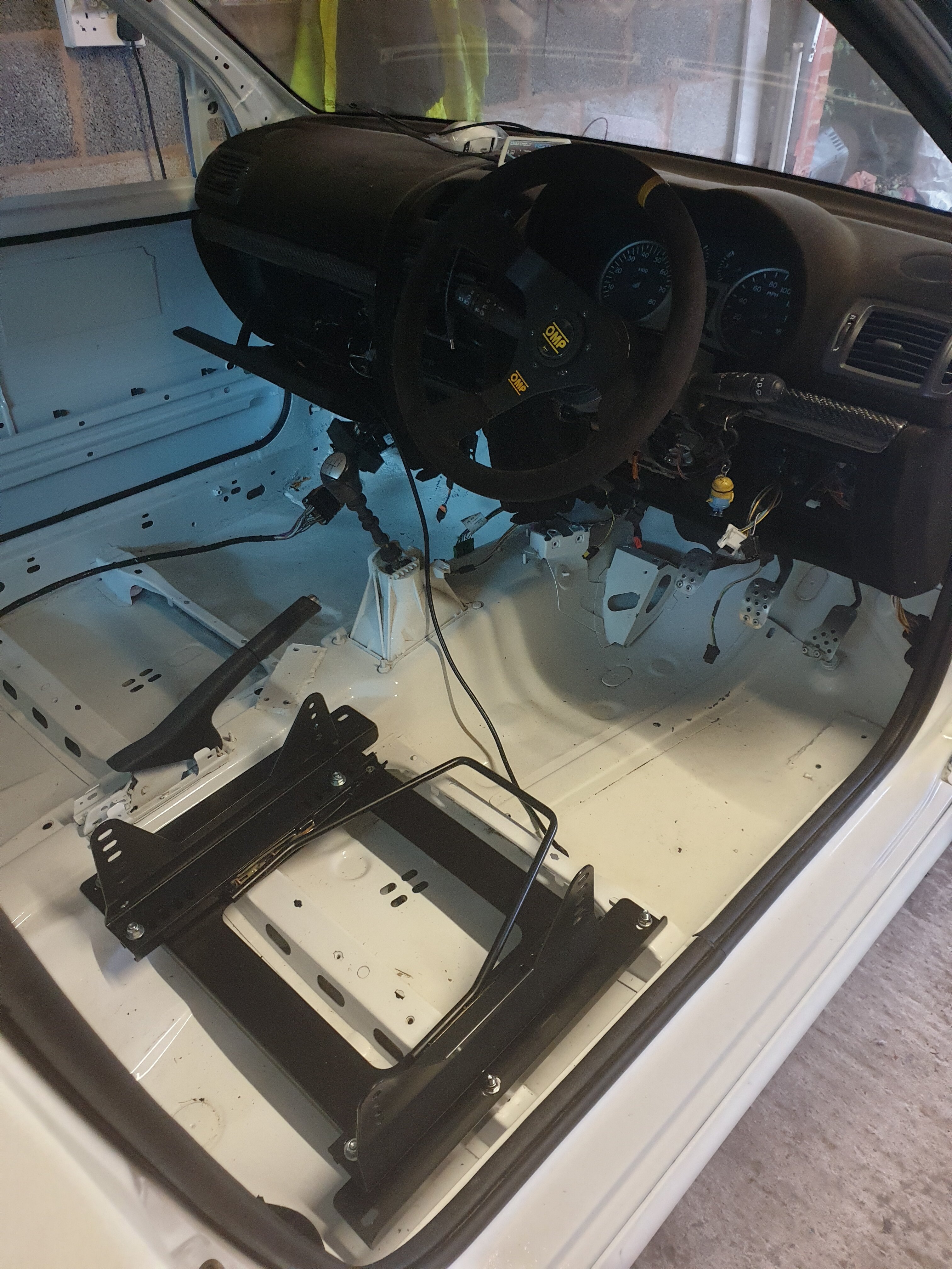

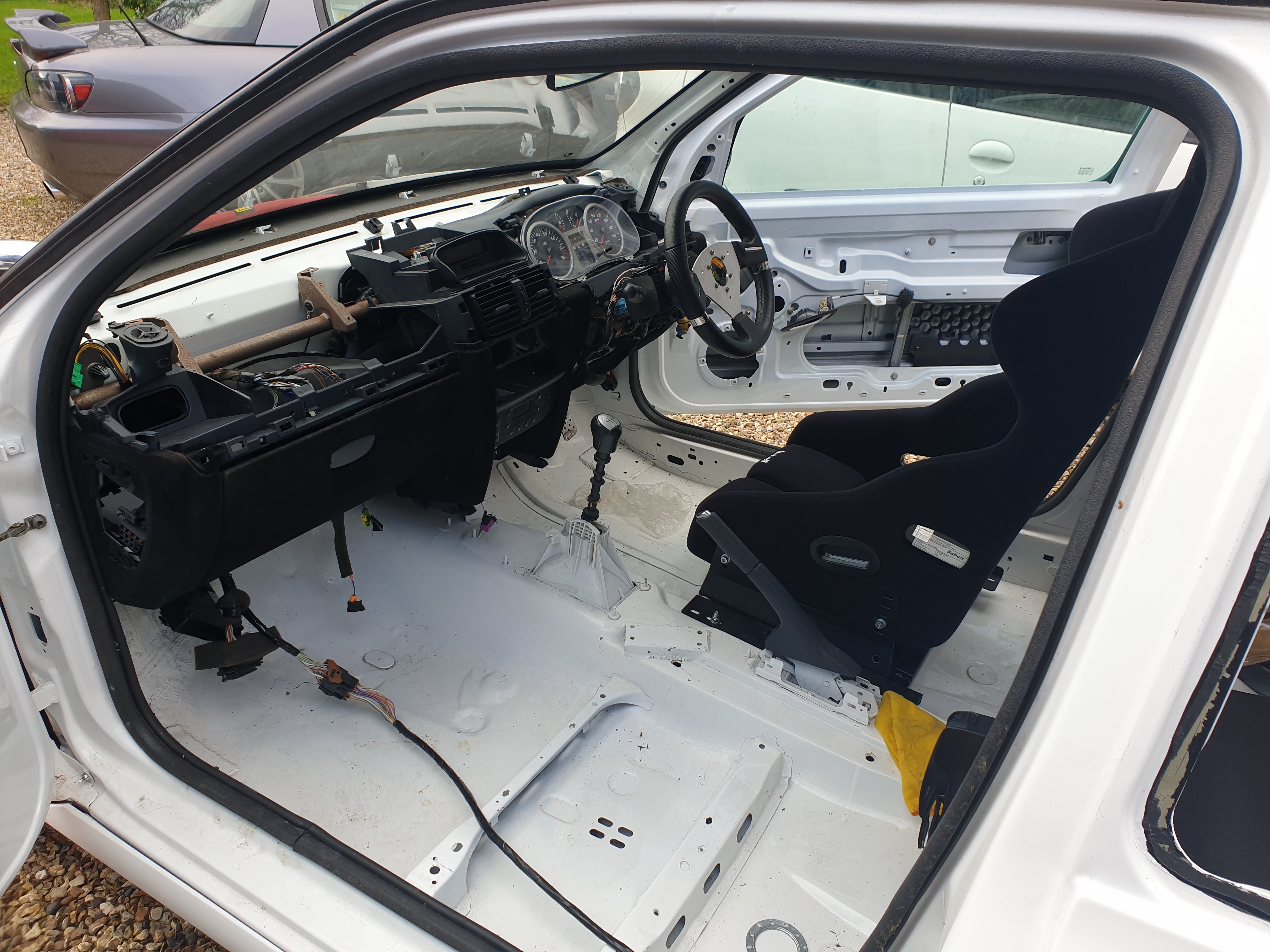

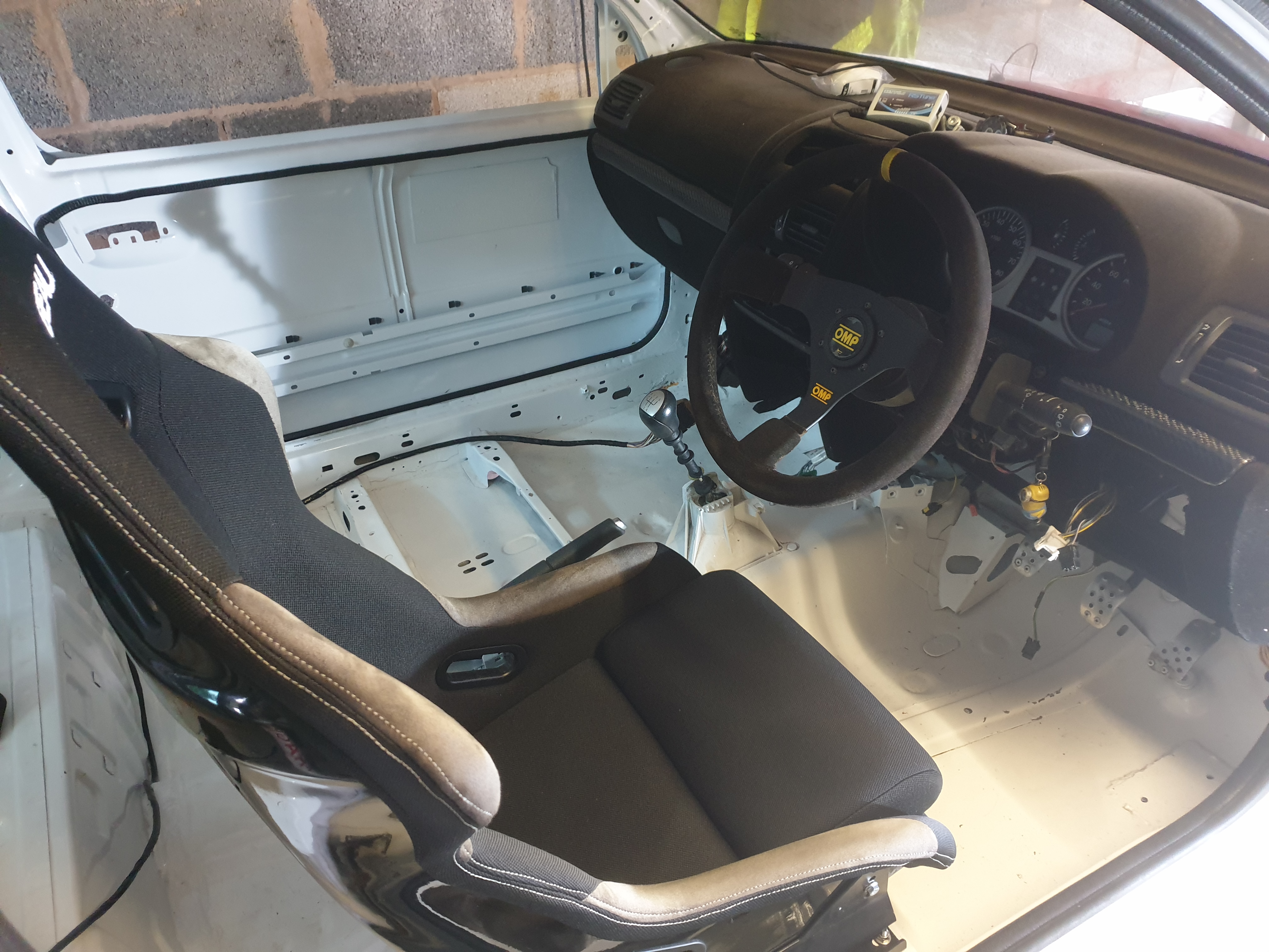

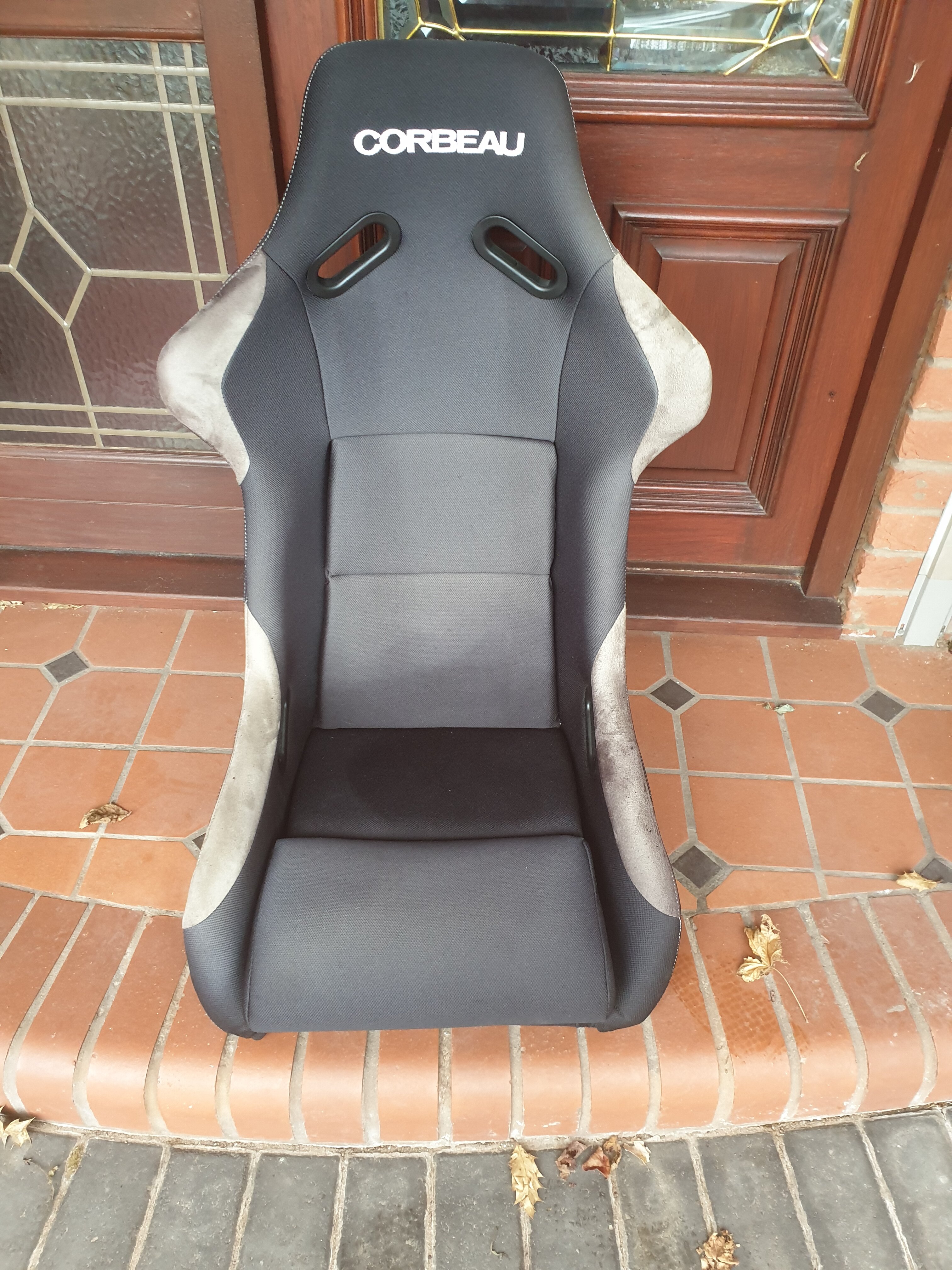

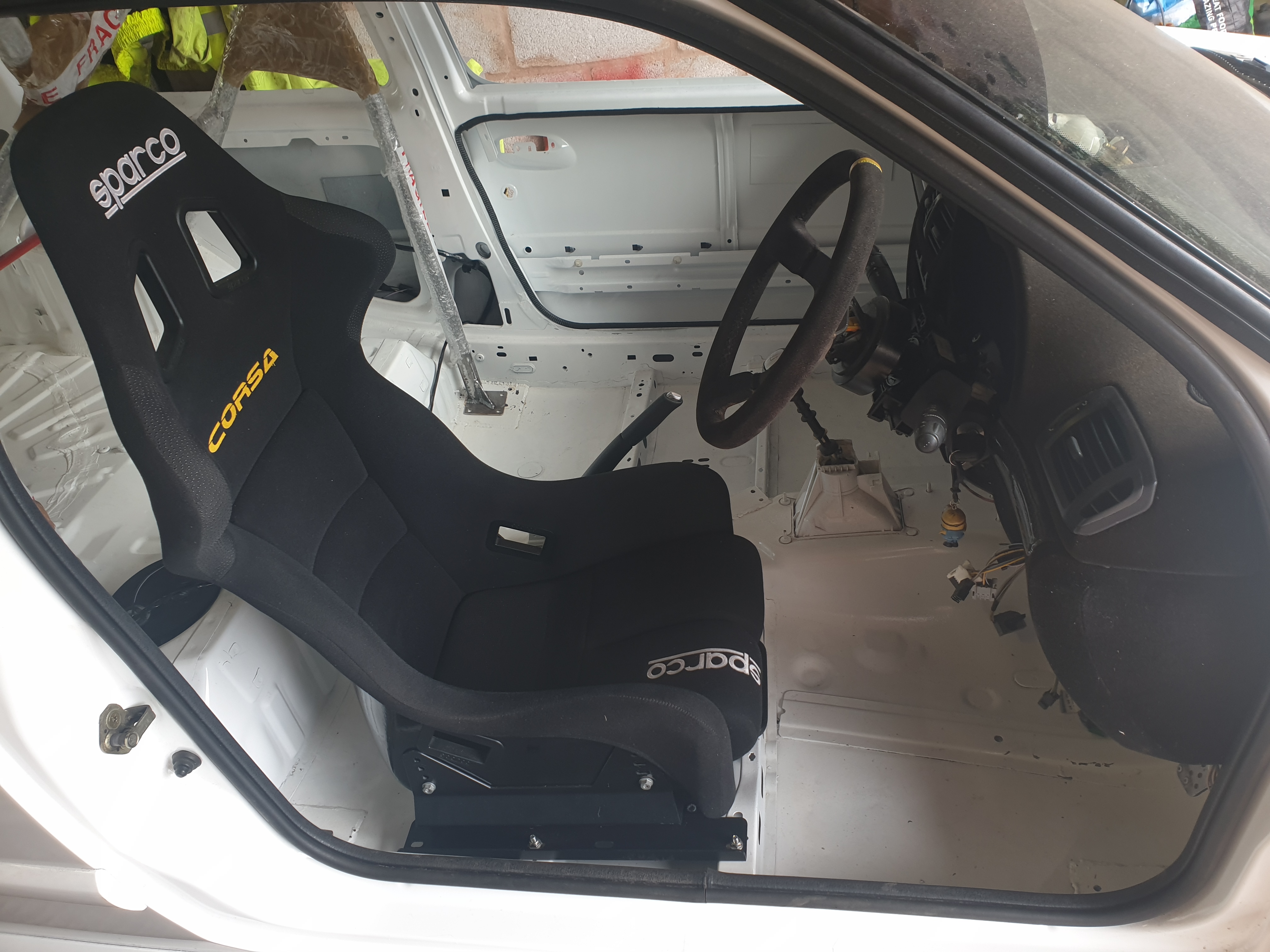

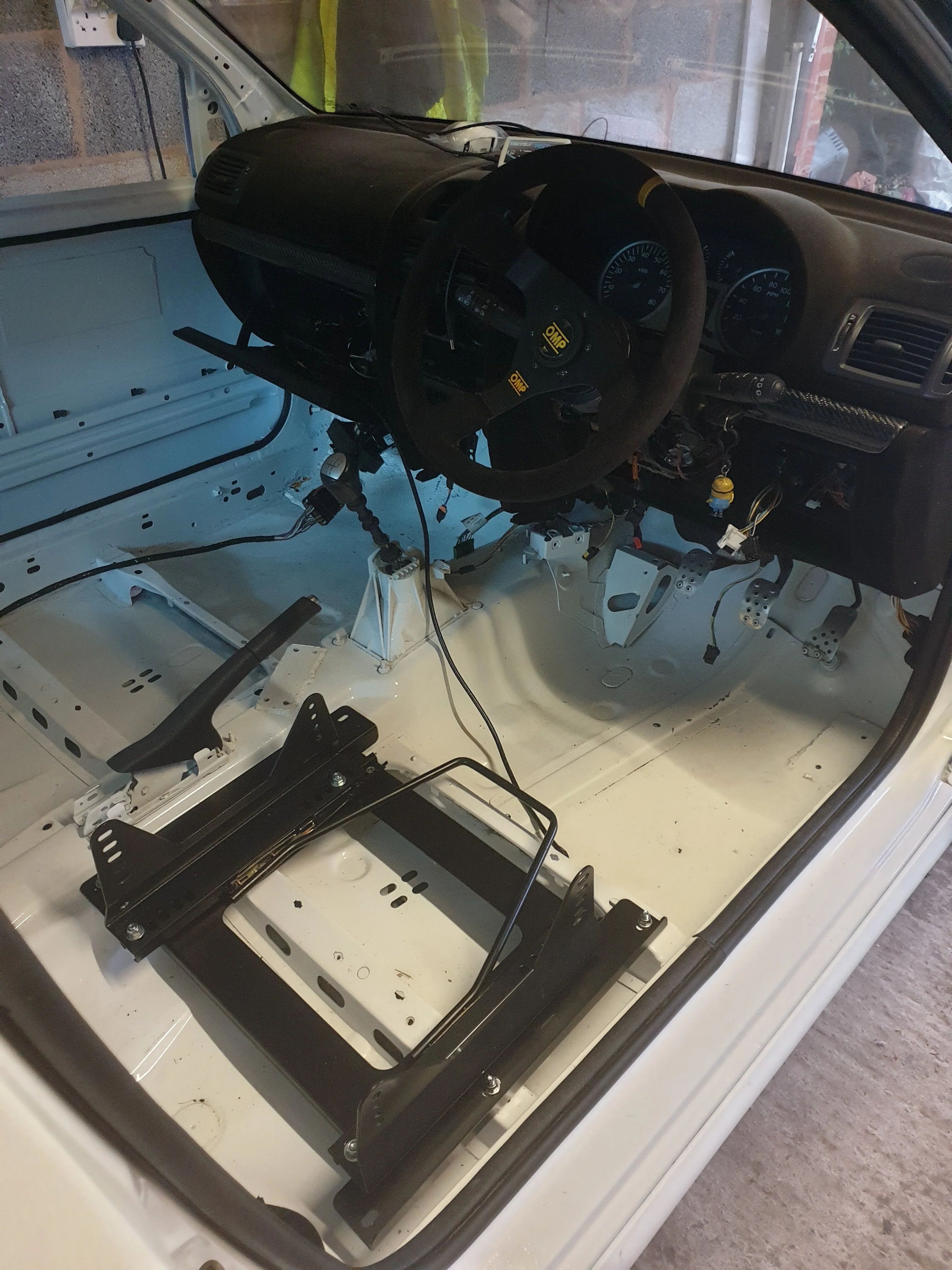

So i sold the seat on thursday , it was alittle snug for me ! So ive had to steal the passenger seat out the red clio ! I did visit demon tweeks to seat in some seats as i was thinking of buying a replacement but seats seem to have got way more expensive !
Bye 👋 seat bye

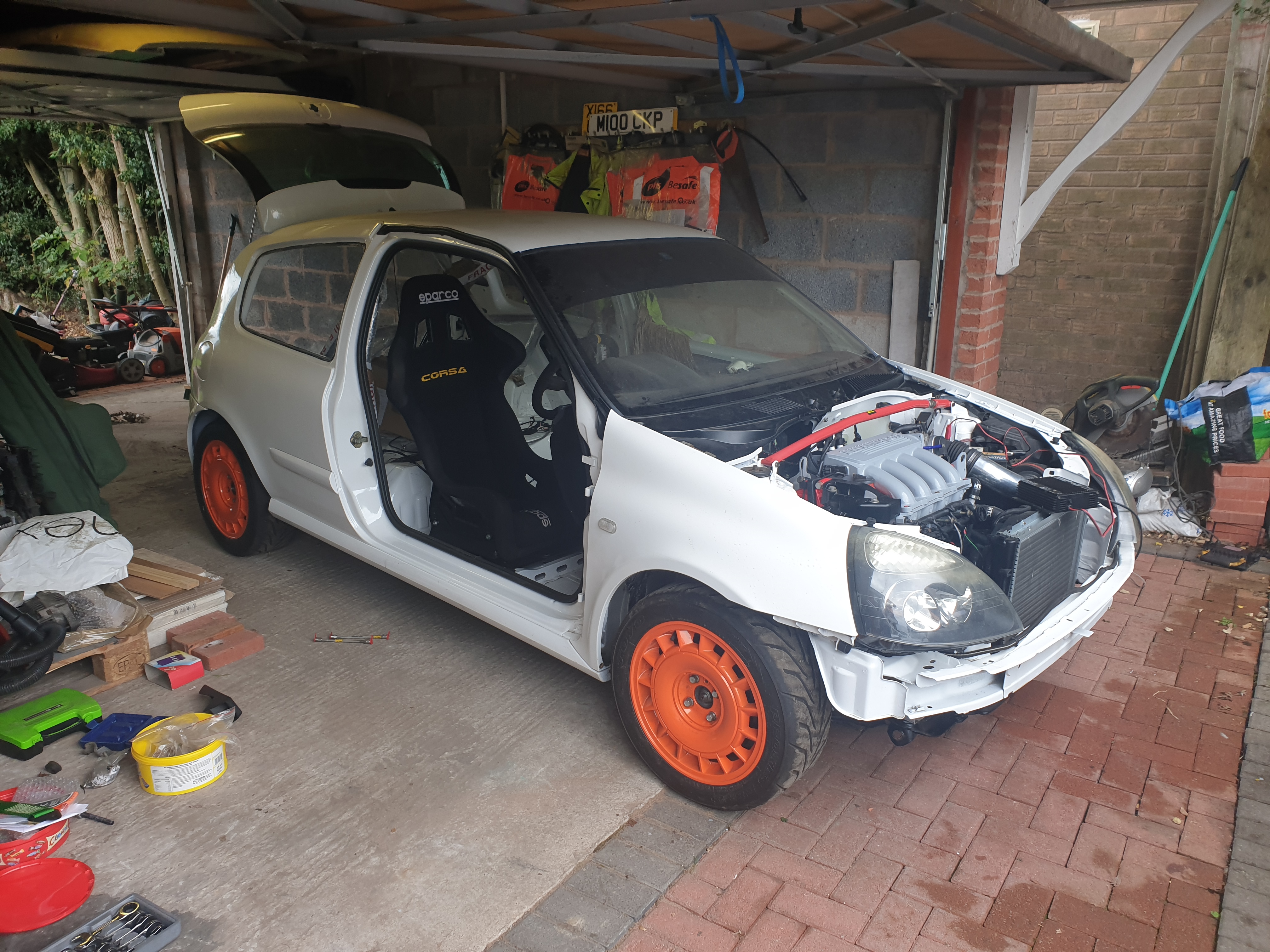

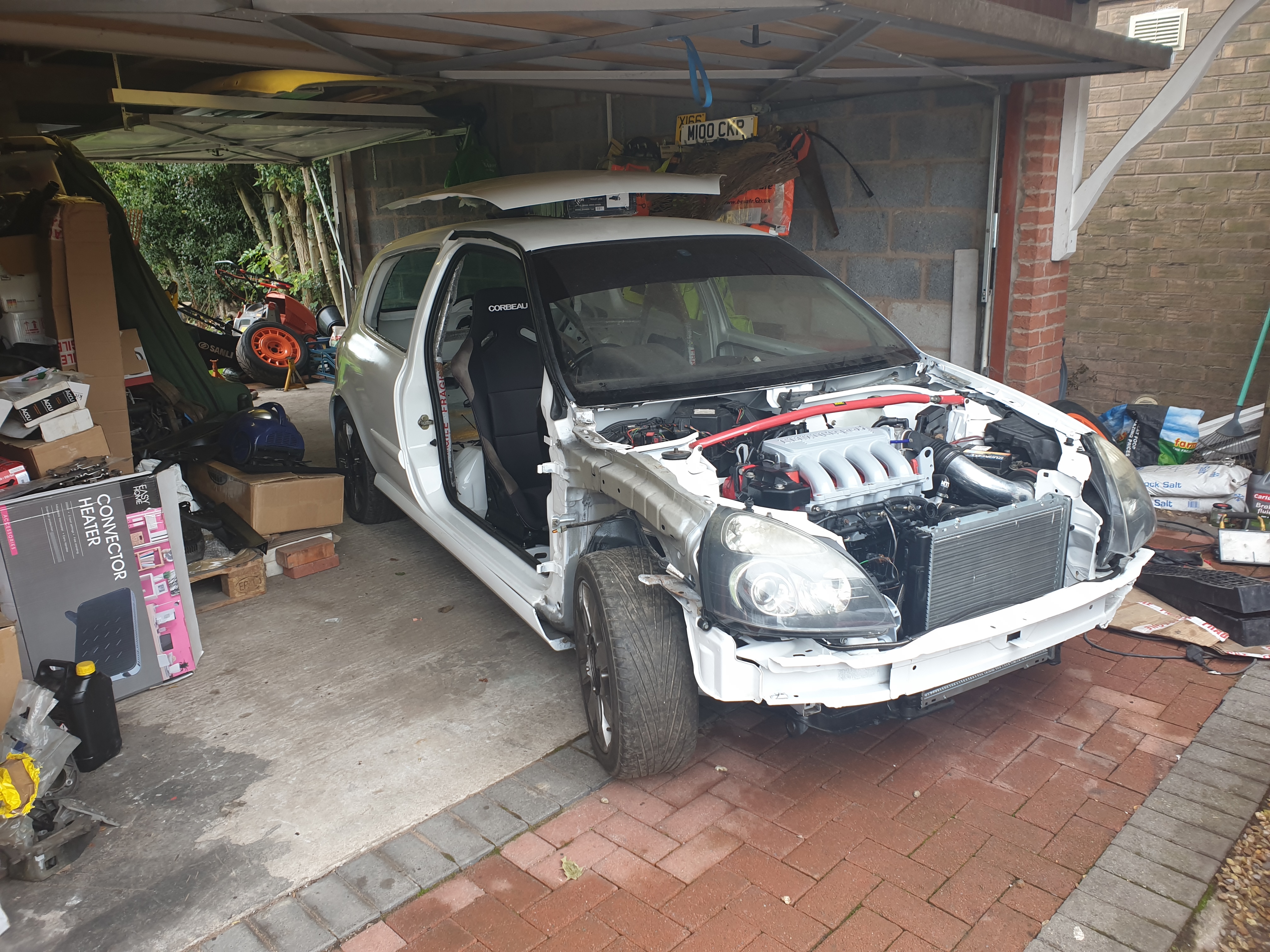

Donated to me by me , corbeau clubsport XL 💪
And shes in , preferred the sparco but to snug !

Seems to be a trend for selling things at the moment , sold my omp wheel this week as i have already got a different wheel to fit.
I found a dodgy fake momo wheel in the shed to put on for now 😂
Also had to remove the upper dash to install the centre clock i had forgot to refit.

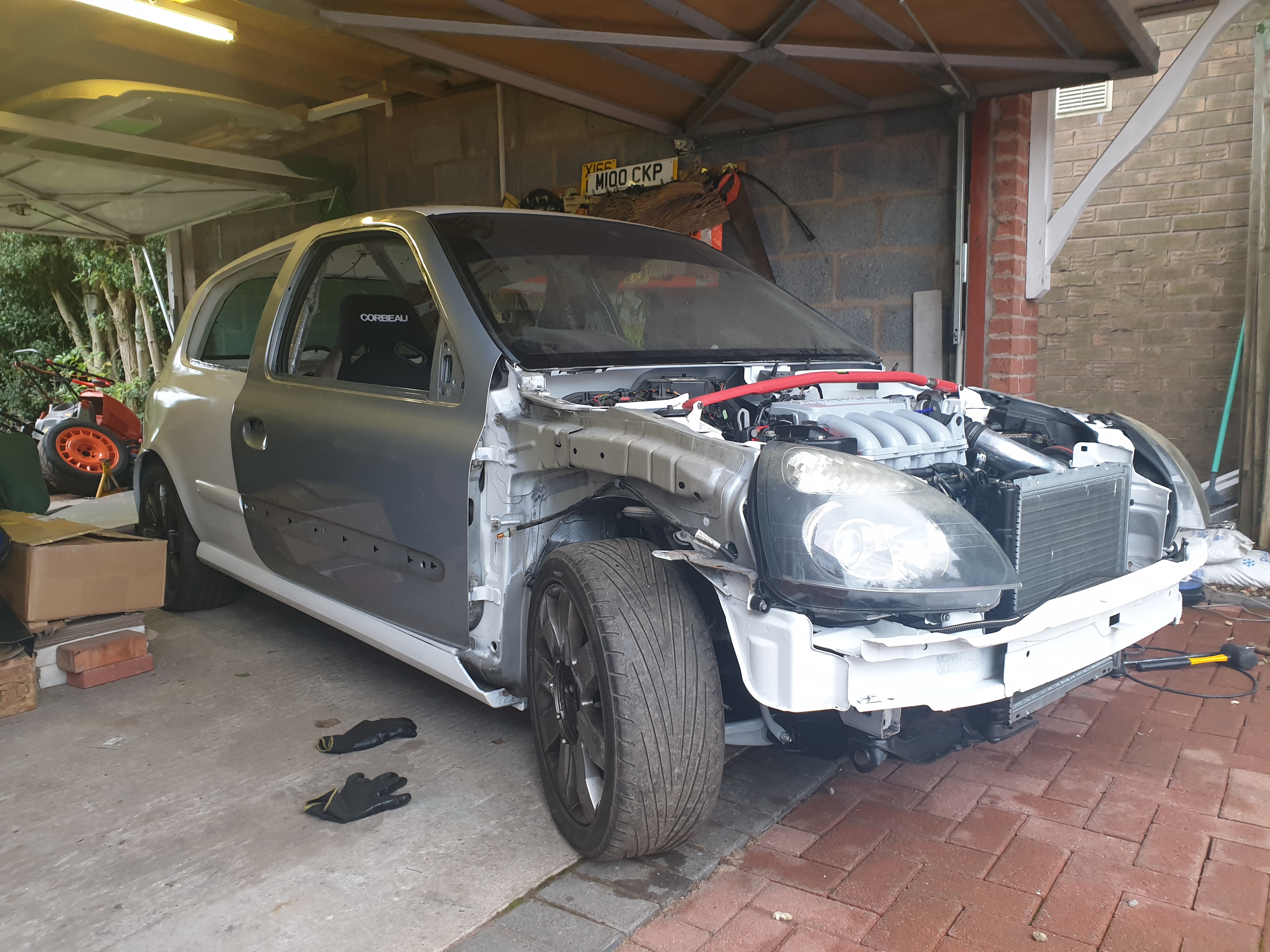

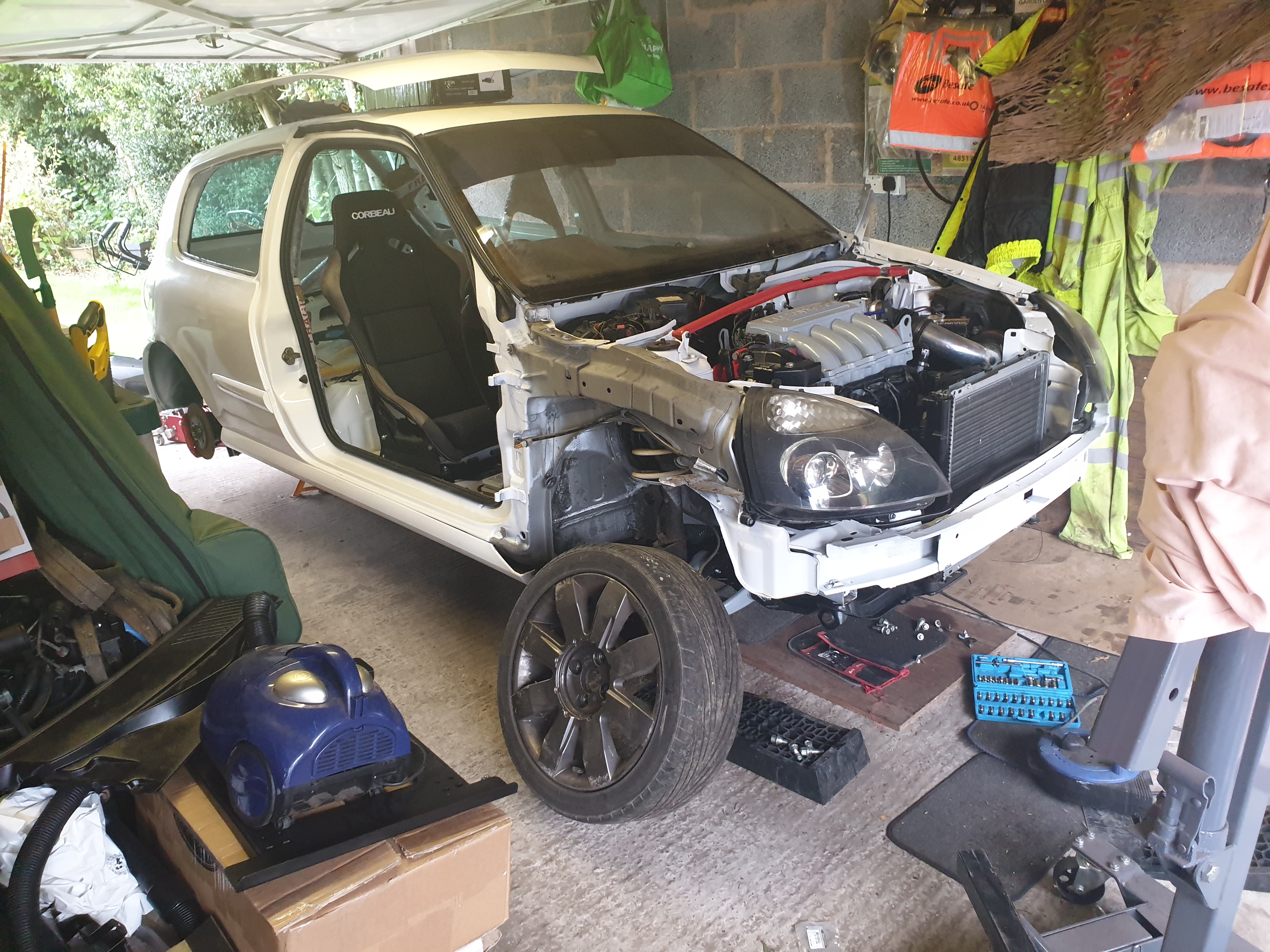

Afew little jobs done today in preparation for going for paint.

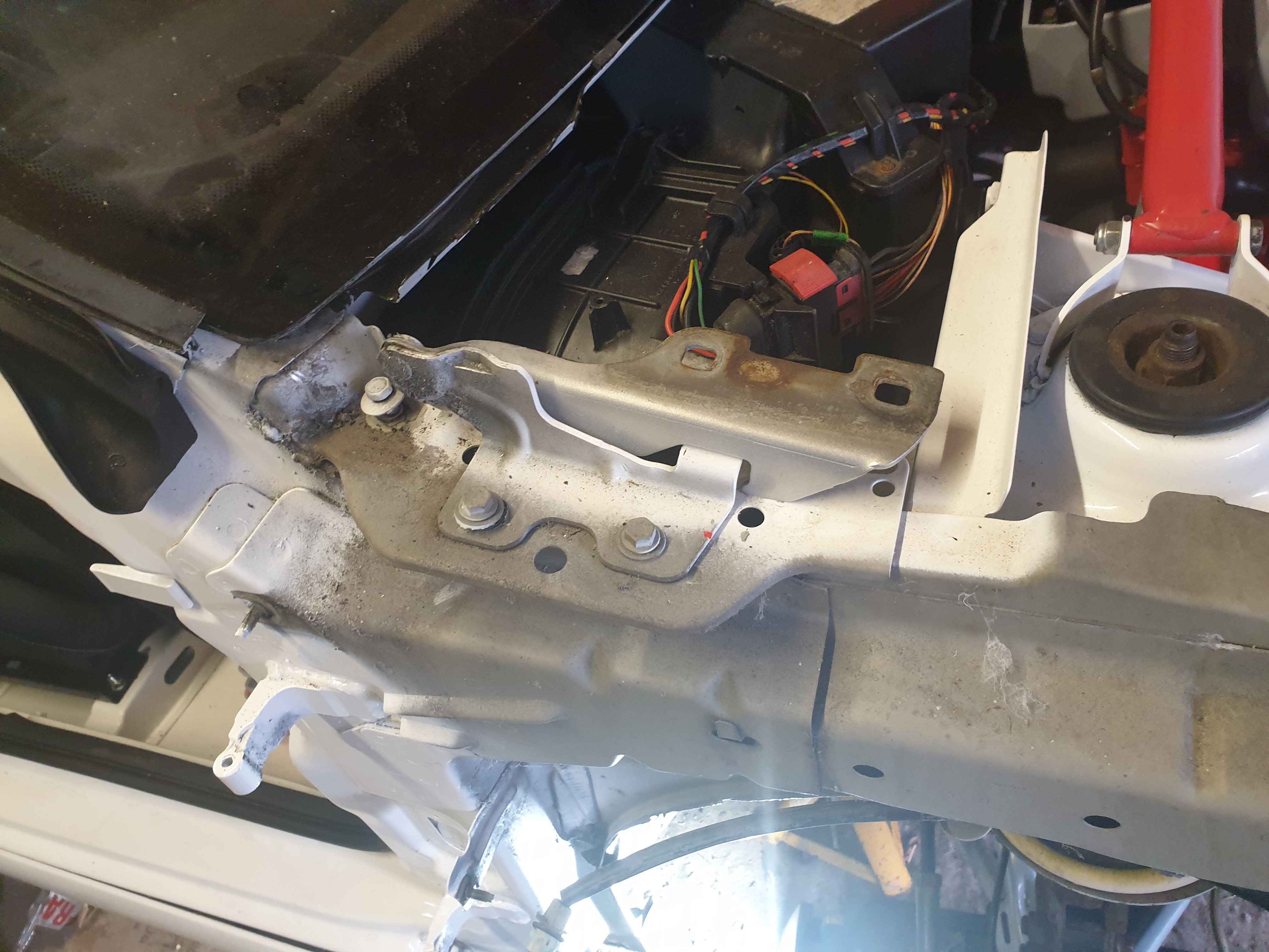

Had to remove front wings in order to remove the bonnet hinges as my bonnet has all the inner skin removed. Annoying i had to unbolt the lights and wings to this but its done.now.

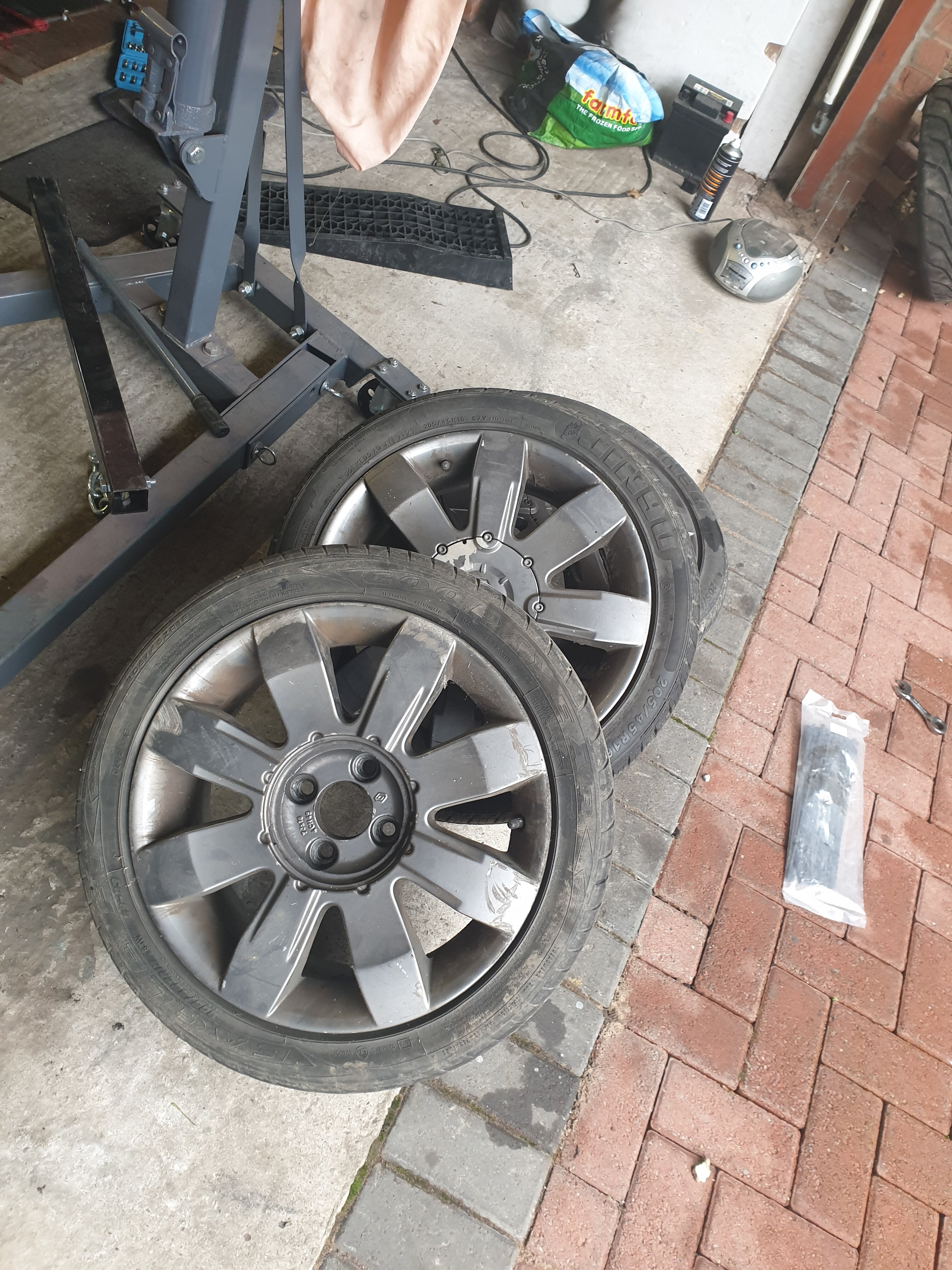

My recently bought 182 alloys fitted for transport , need to put some air in the rears !
May get these refurbed when it returns for winter wheels.
Next job fit doors , i already have a passenger door fitted but the inner rails has been removed so no good as i want electric windows.

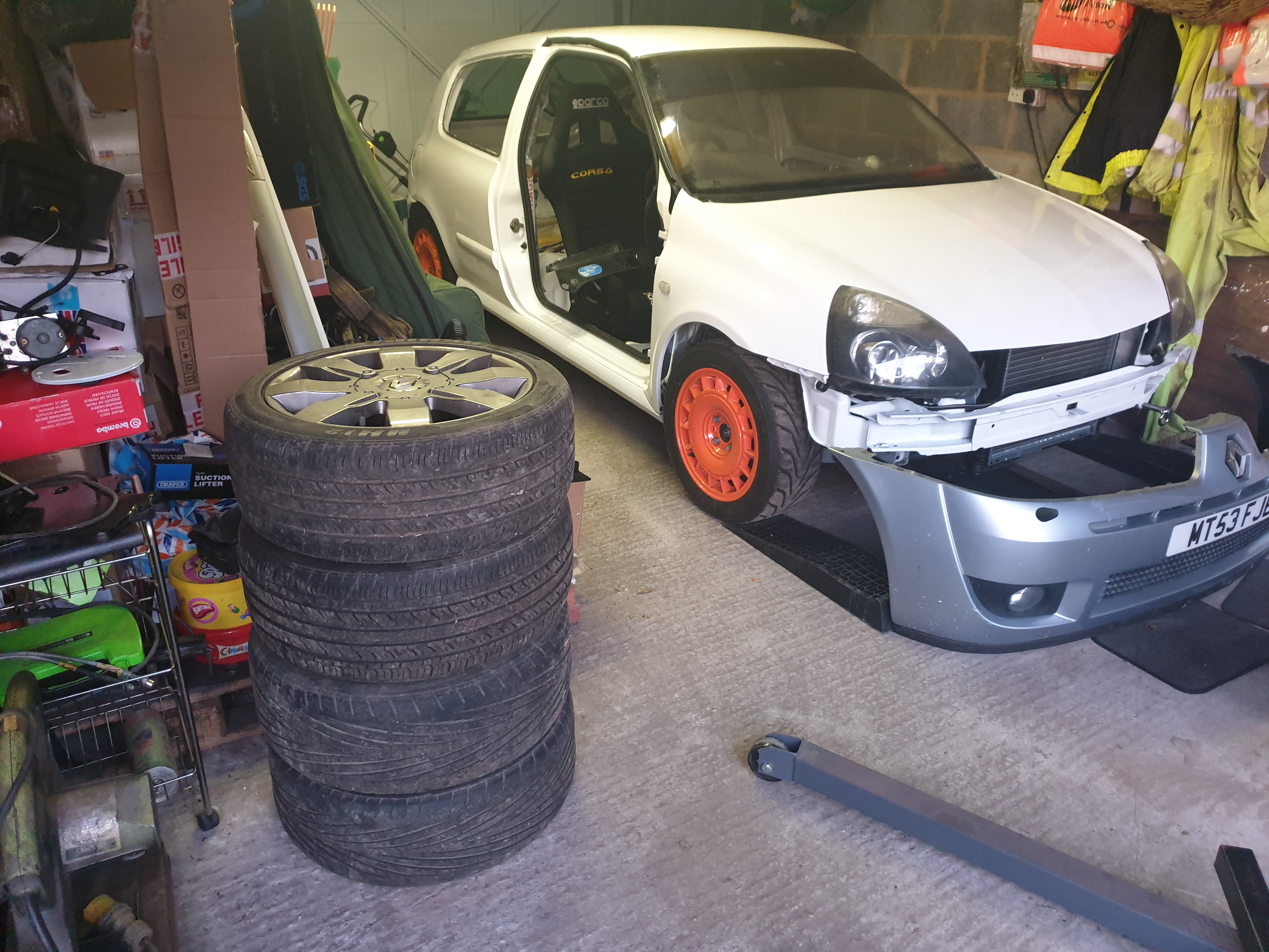

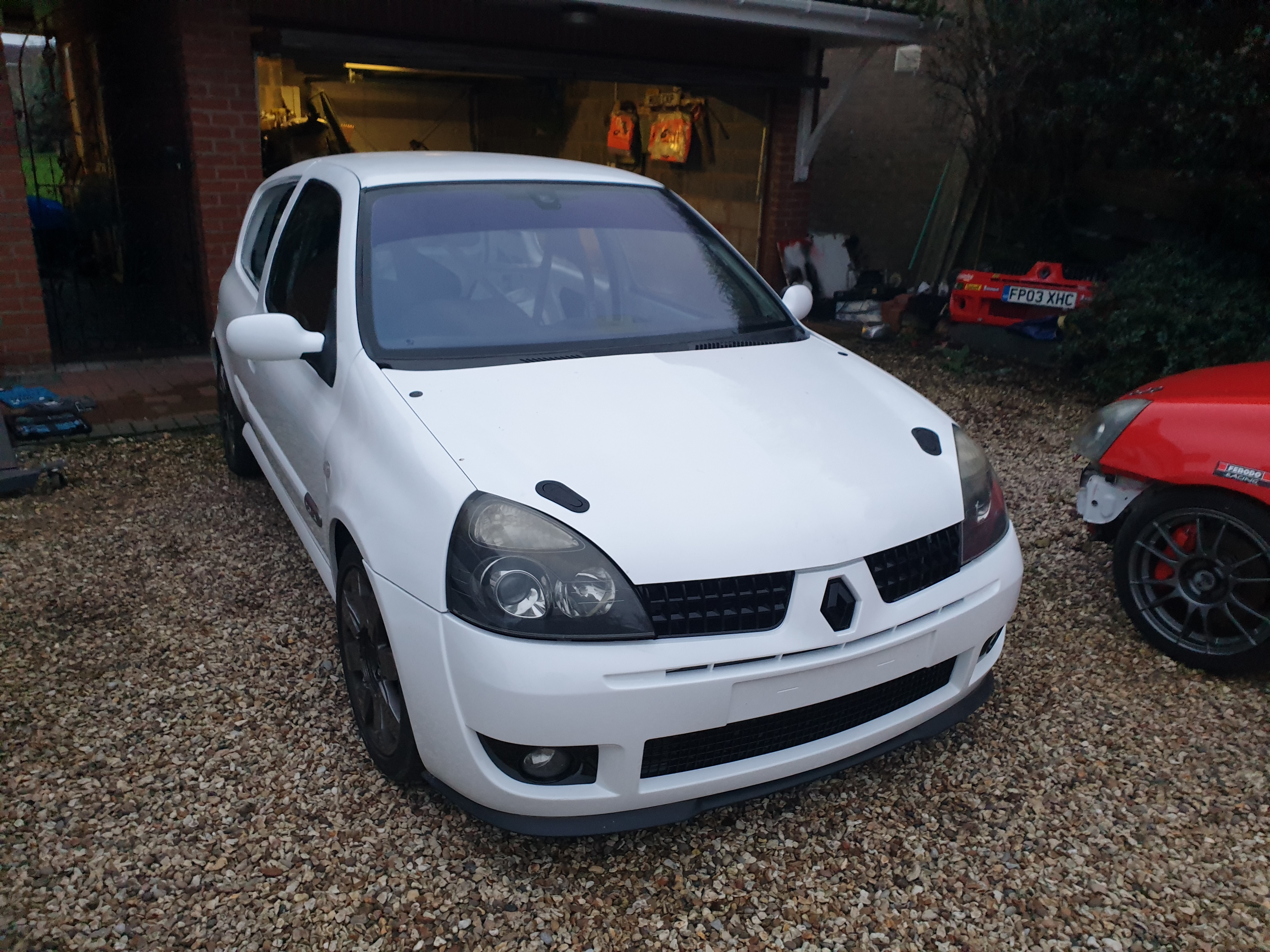

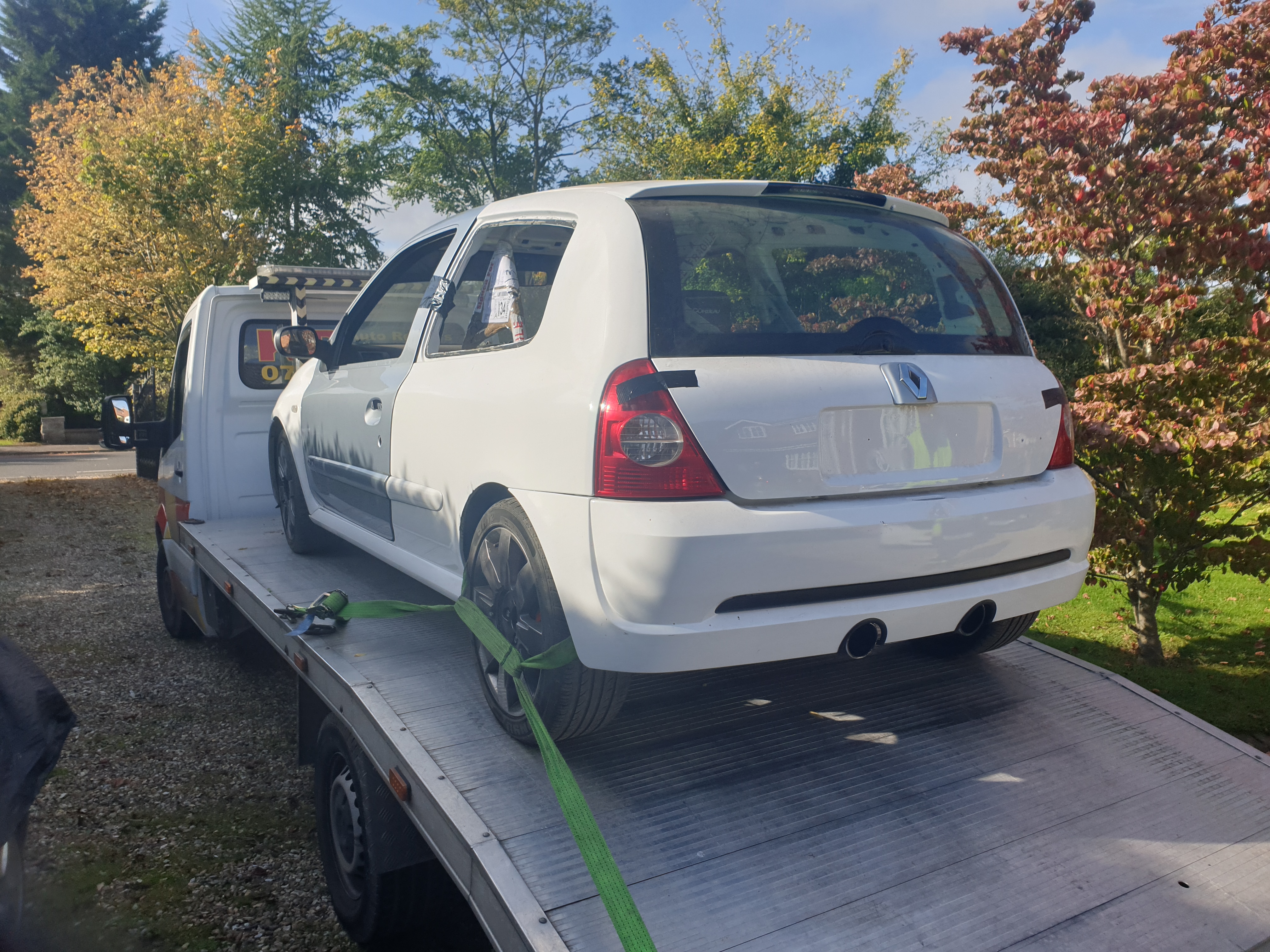

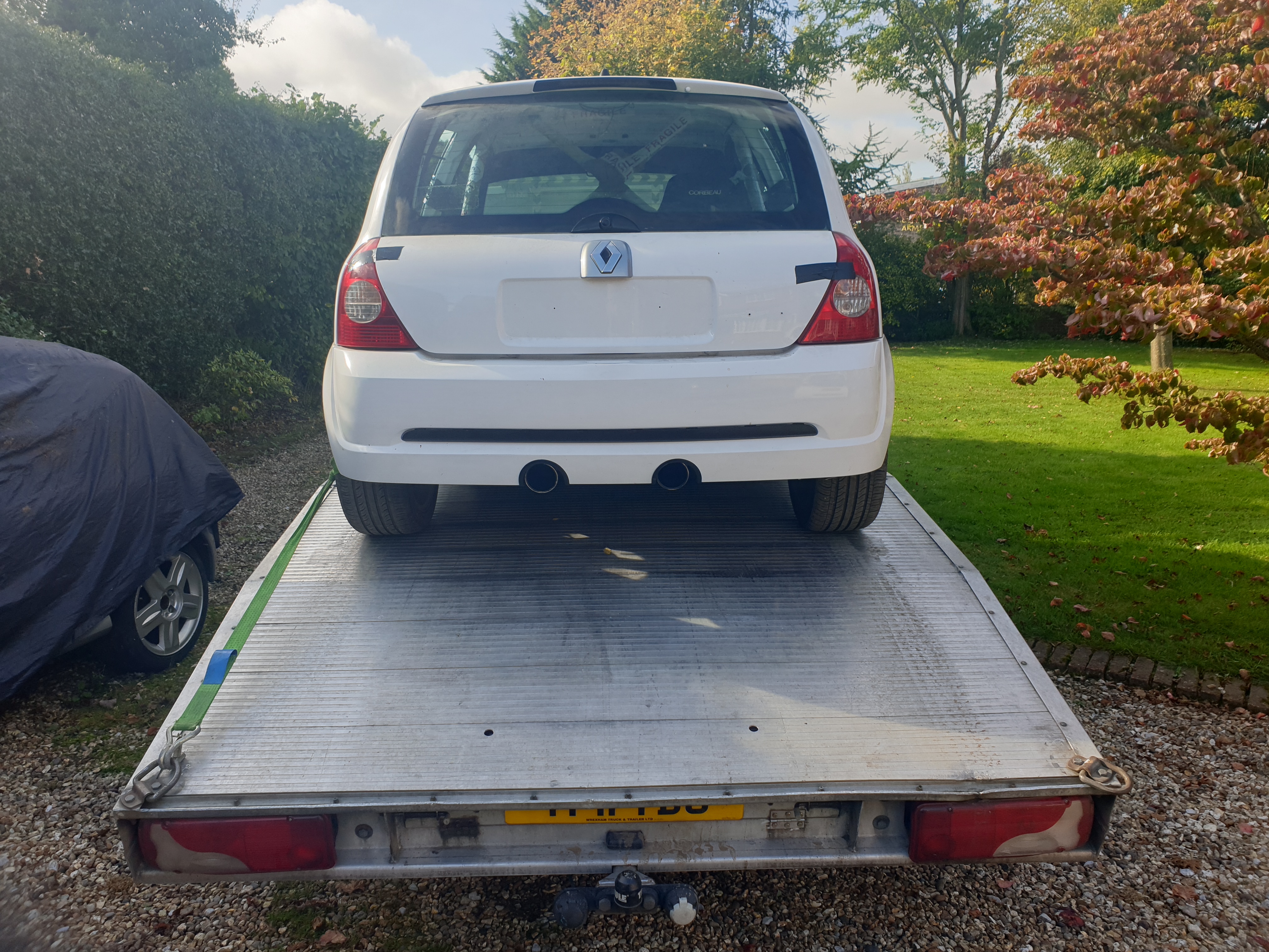

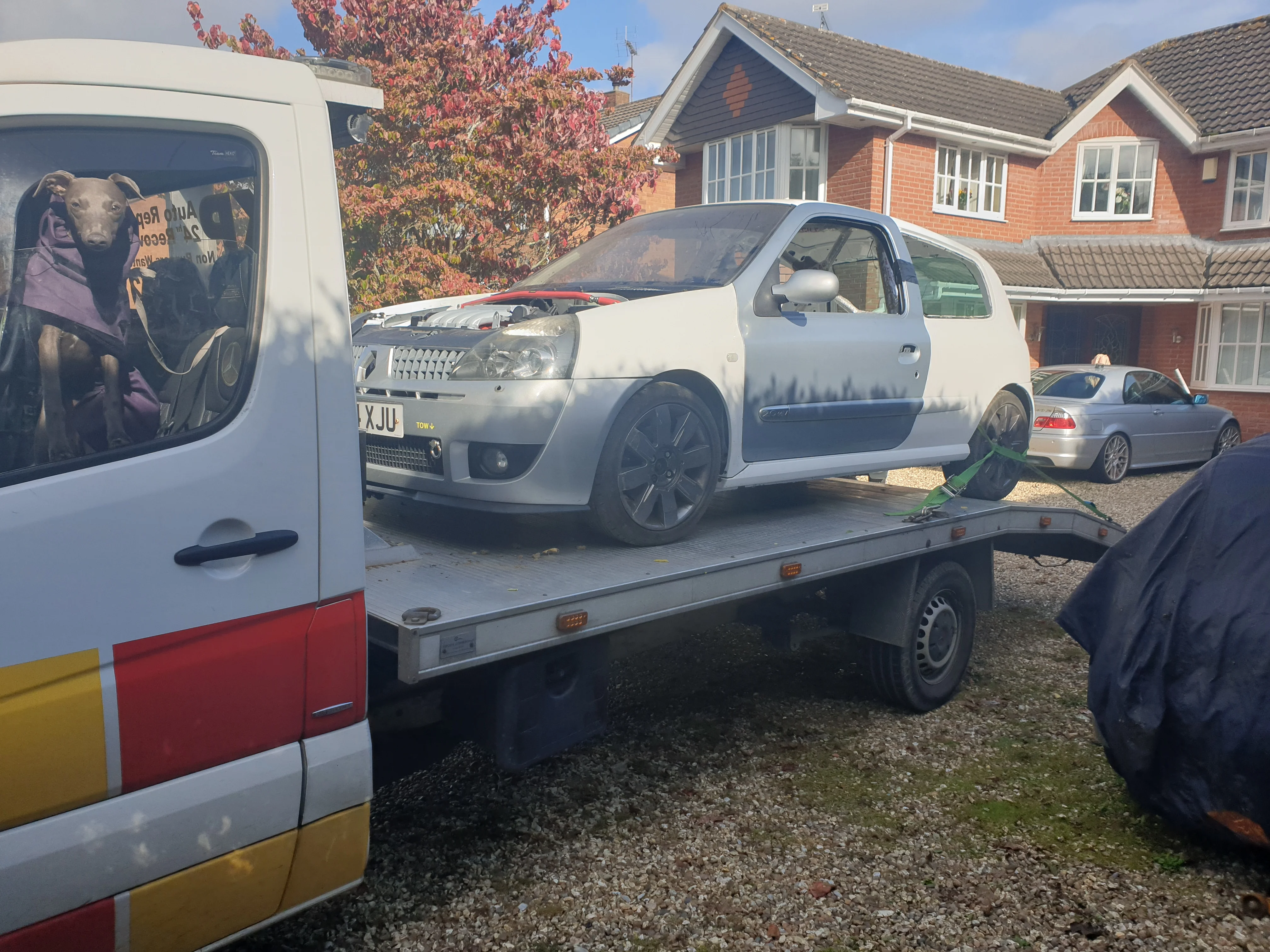

Monday morning arrived and my mate arrived with his tow truck , always use him for transport.
Off to have 2 doors painted and front bumper so its all one colour lol.
Im also going to get my 182 wheels painted but this will be done once the car is back and tyres have been removed.
  clio 172

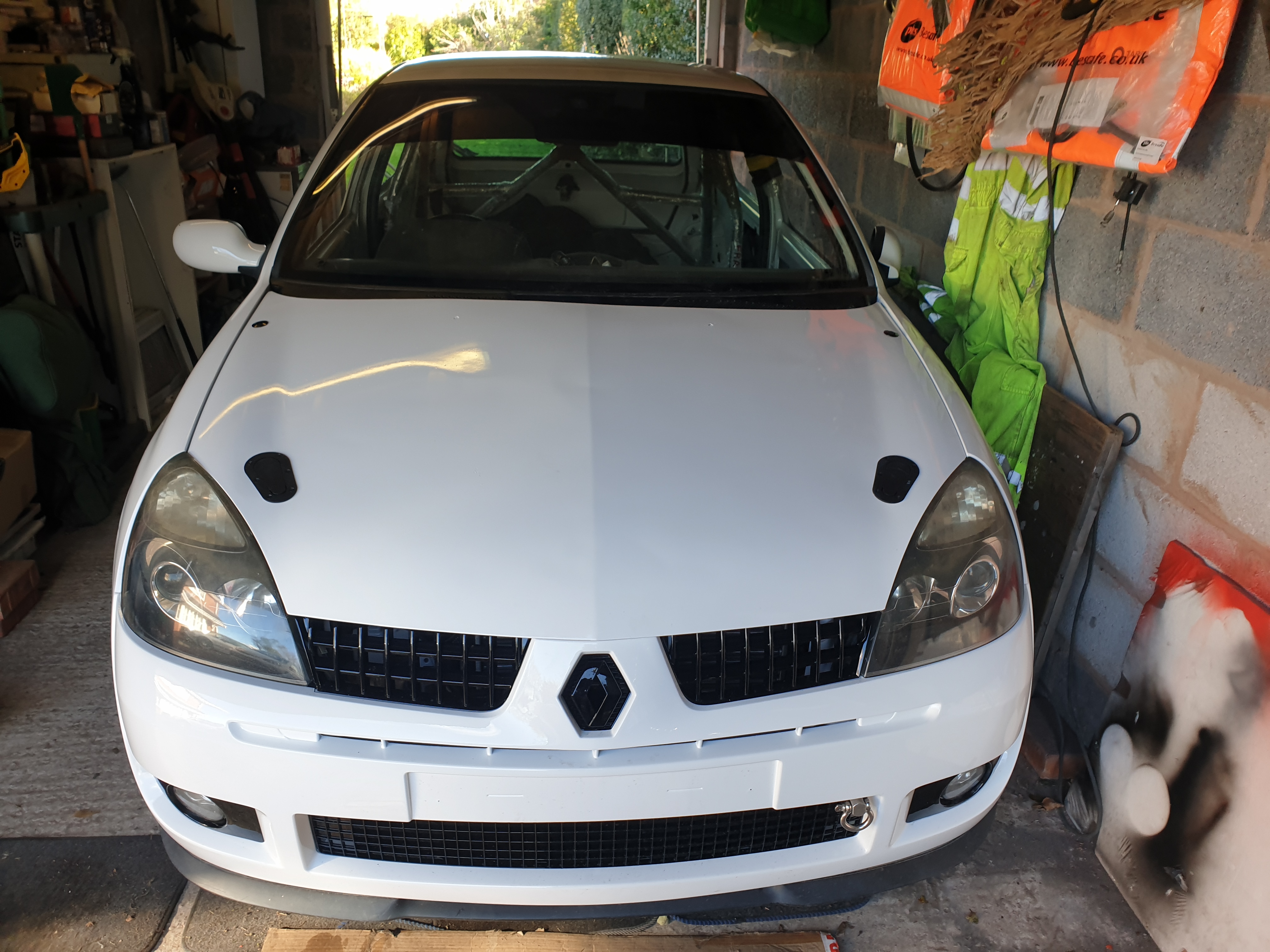

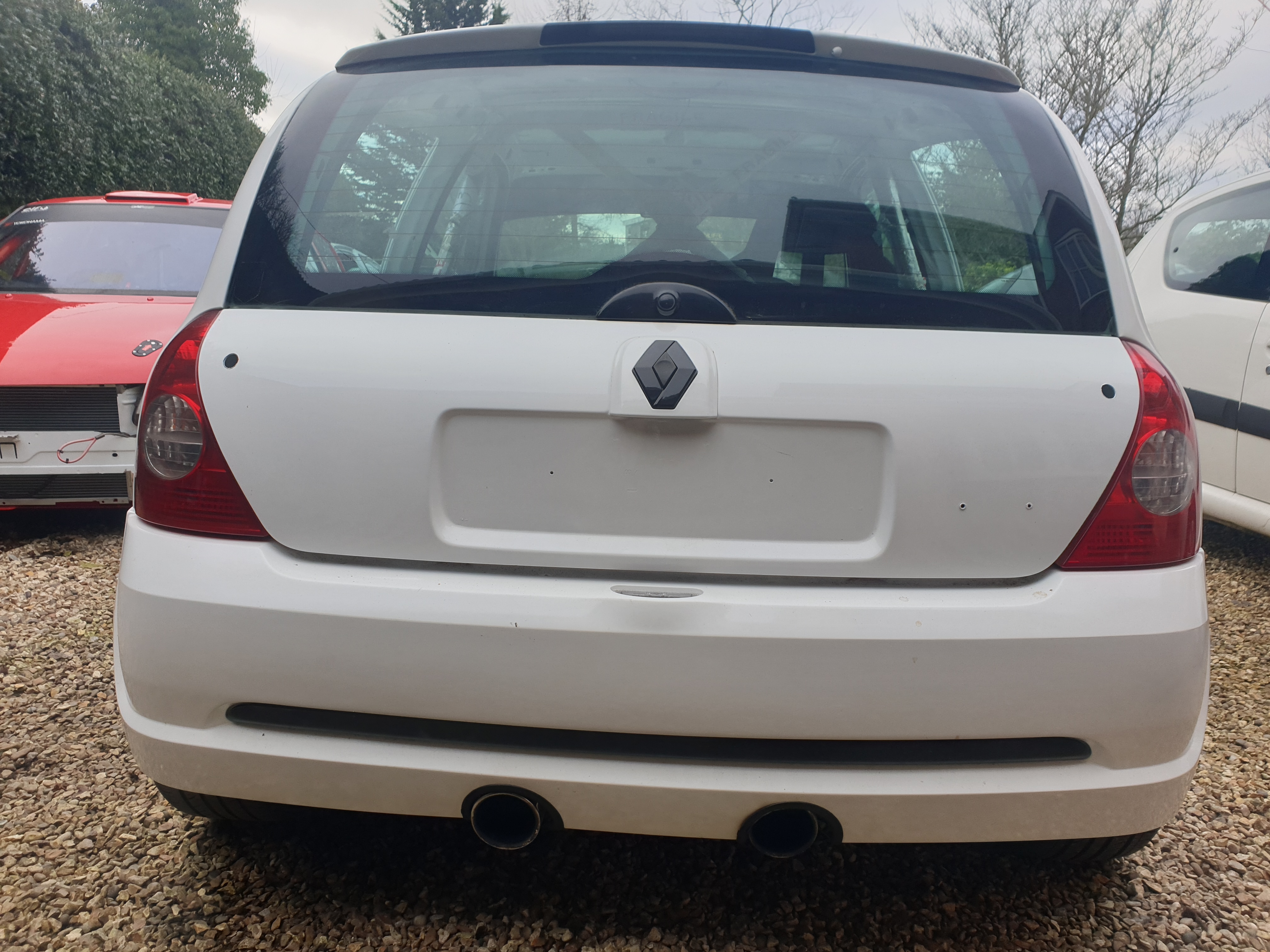

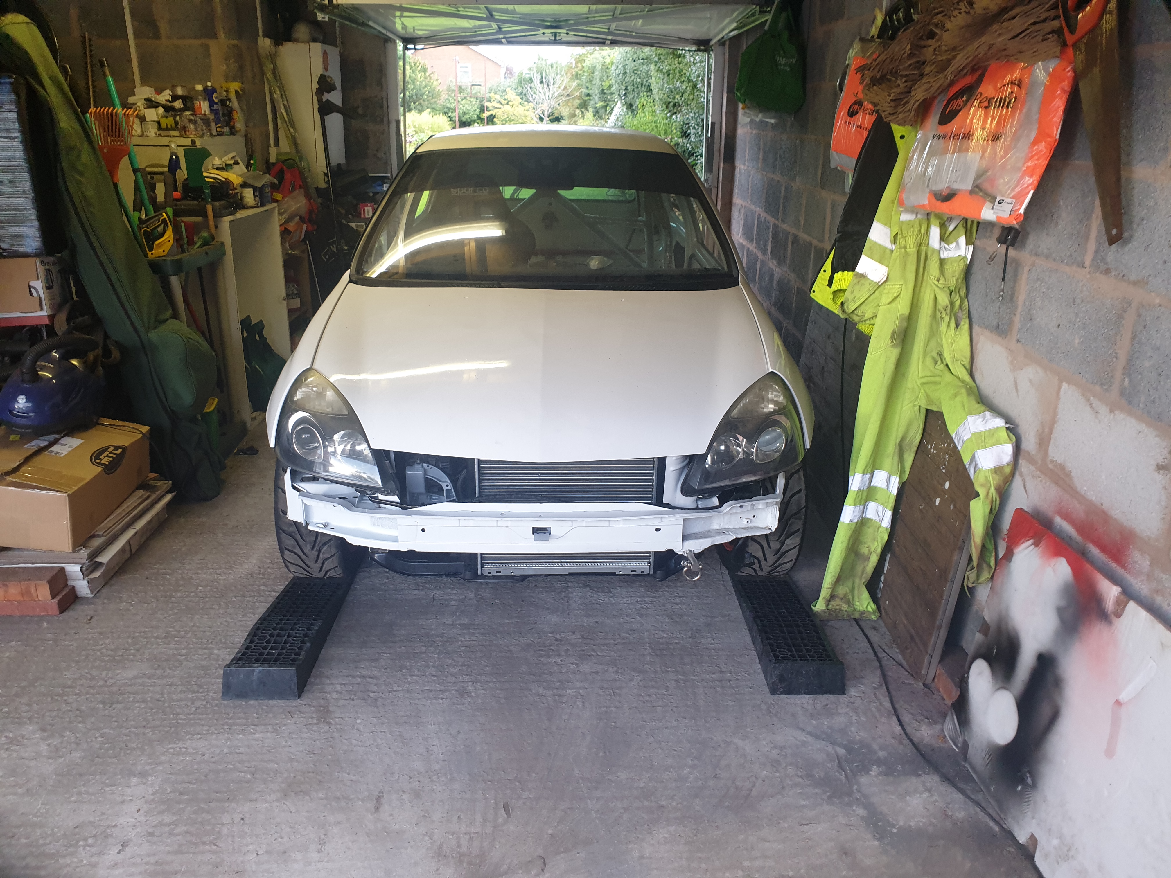

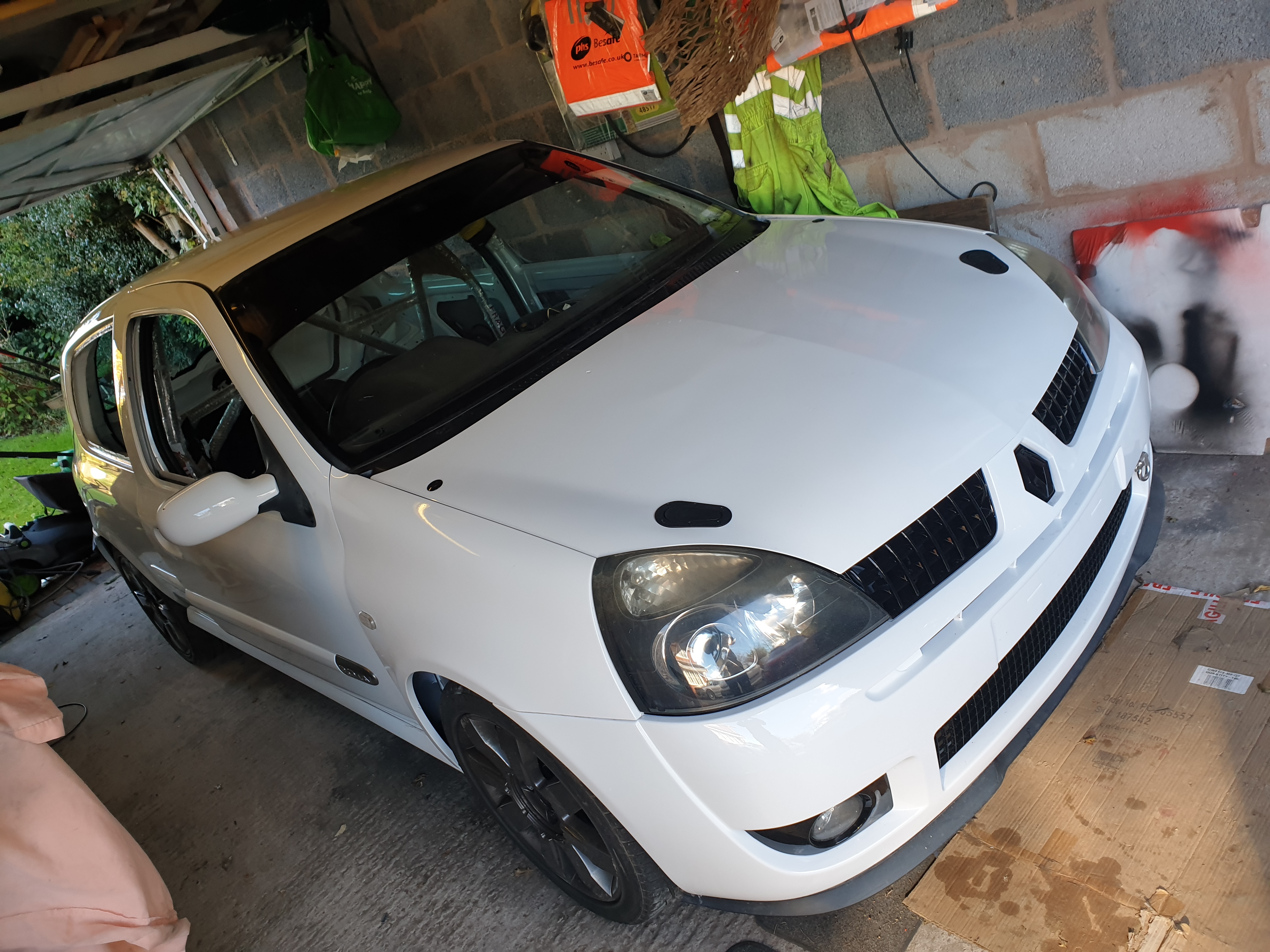

Sneak peak ! Got the car back late last night ! Loads to do still to get it on the road ! Alternator needs to be removed and taken for repair. Reverse gear needs adjusting and currently has no seats fitted !
  clio 172
So i got the car back late friday night ! Had to push it into the garage , battery was flat after its last start as the alternator isnt charging so need to remove this week to take for repair.

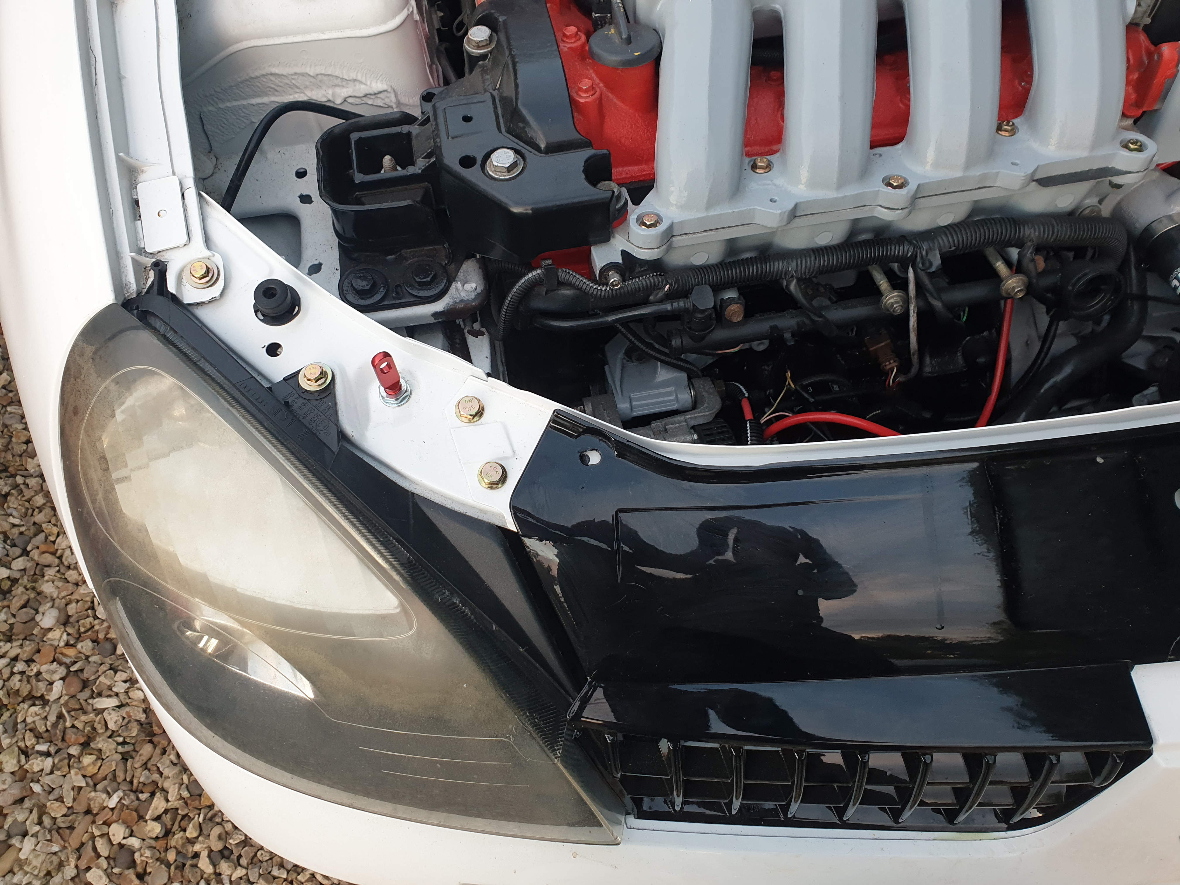

Front grilles have been painted gloss black along with the fog light surrounds and badge.
Aerocatches and pitking latches have been installed as the inner skin has been removed along with the hinge threads !
Splitter needs painting now as it looks out of place.

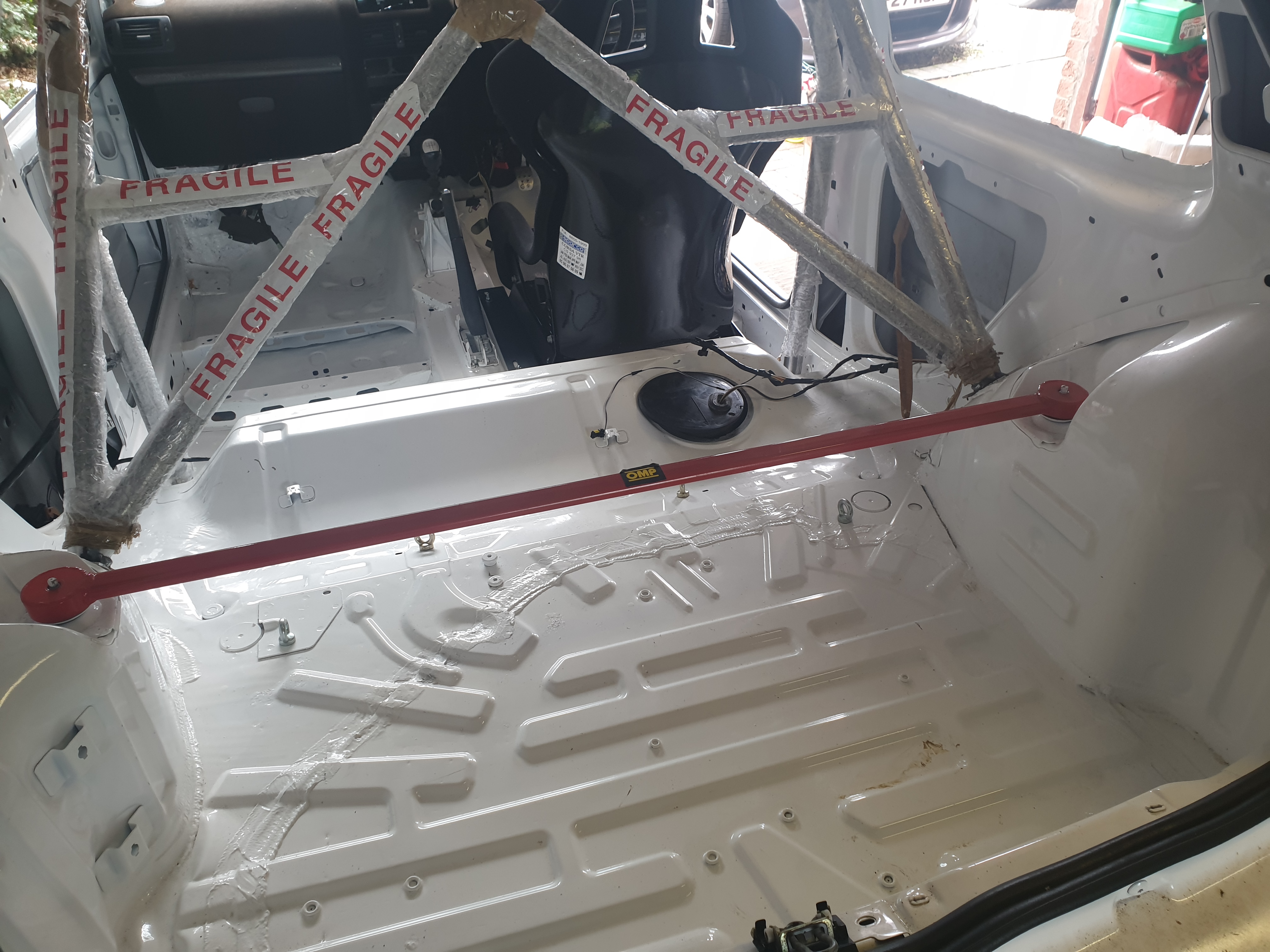

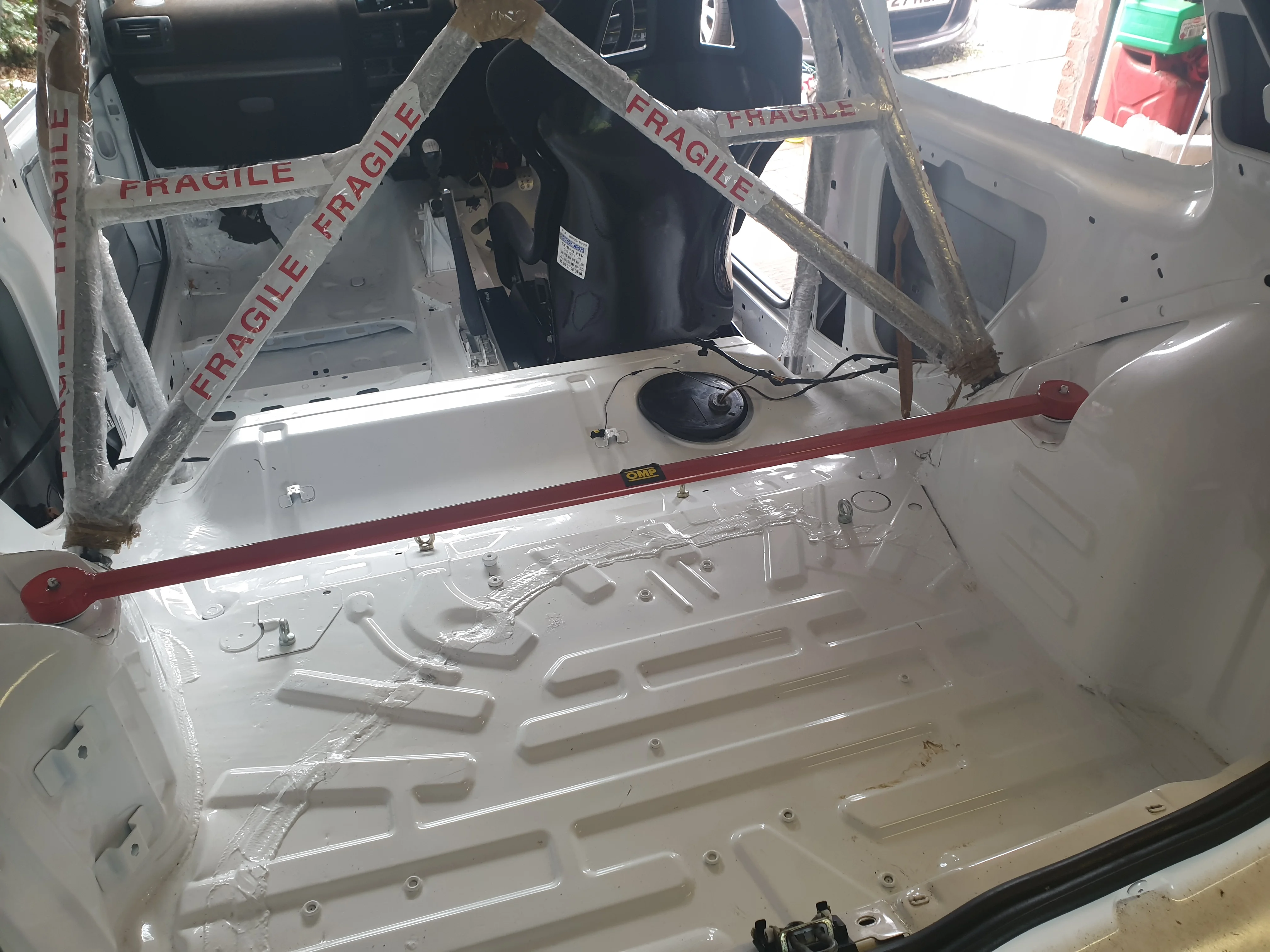

Rear boot catches to be fitted
Exhaust centre bracket mount hole needs repairing.
Rear cage plates need modifying to suit my cage.

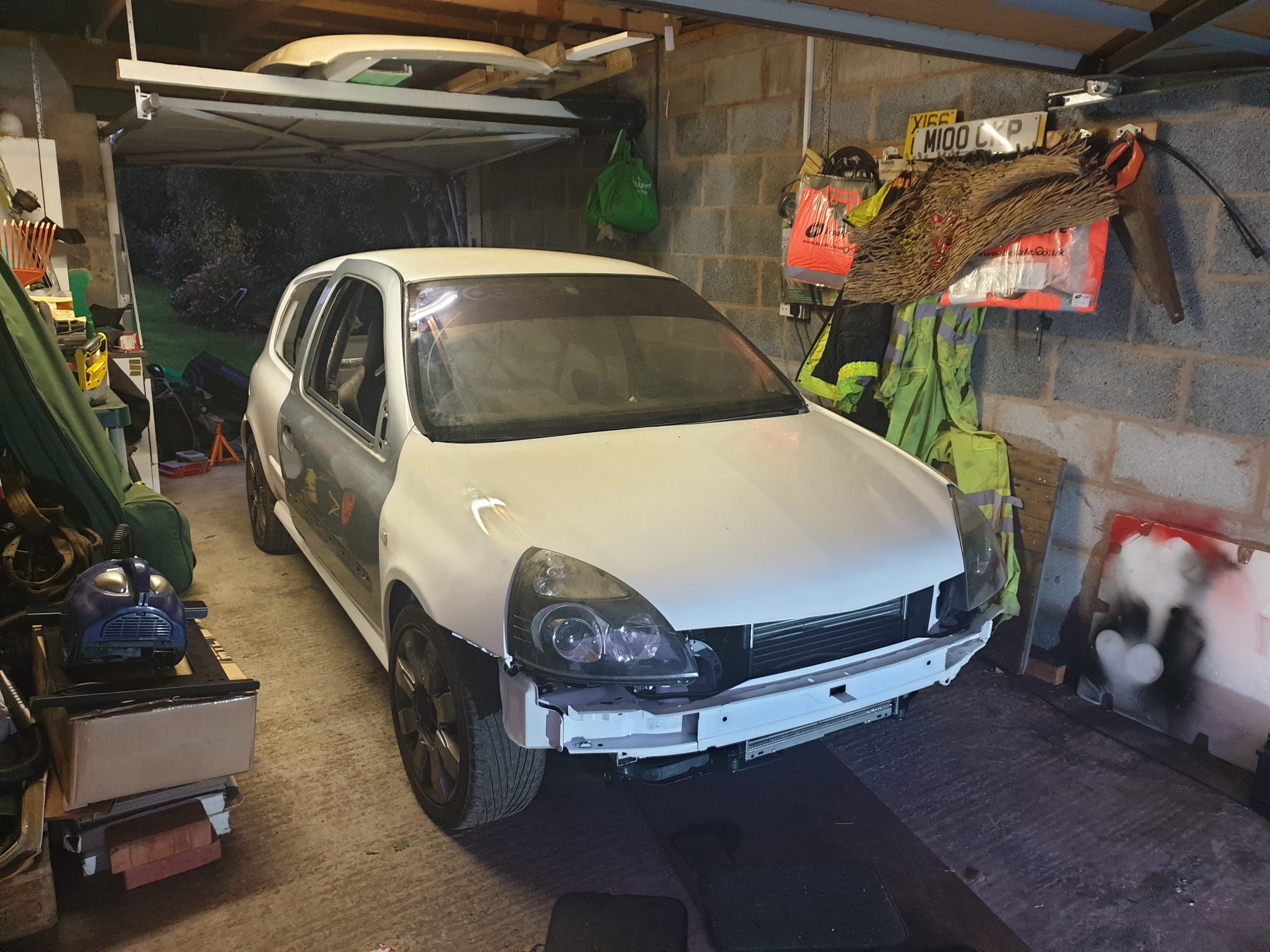

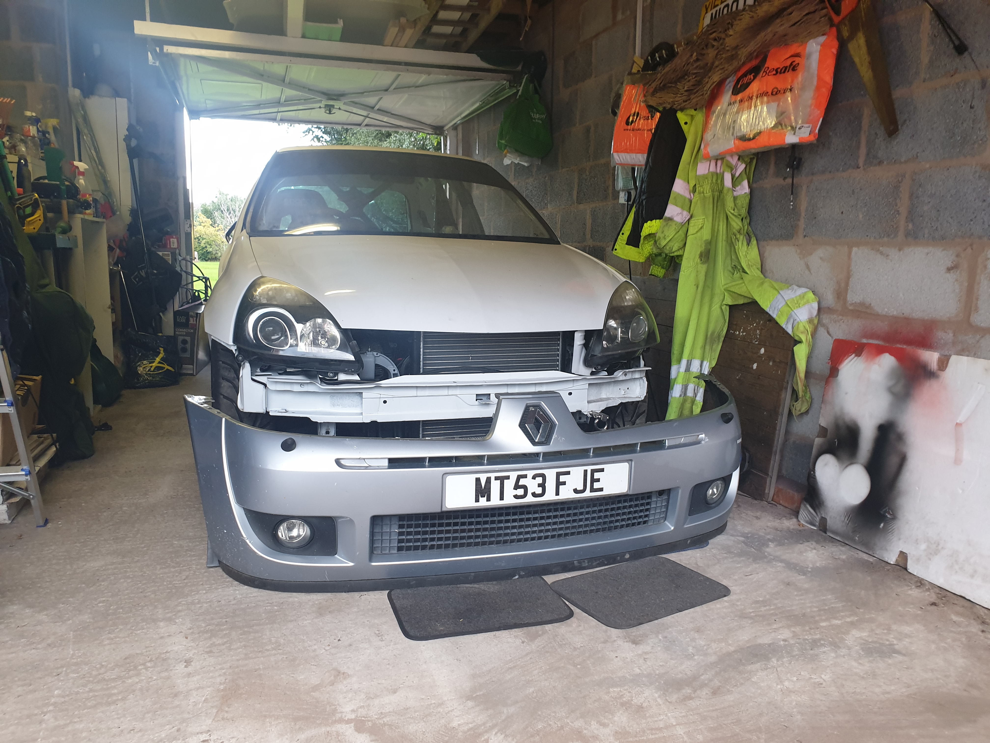

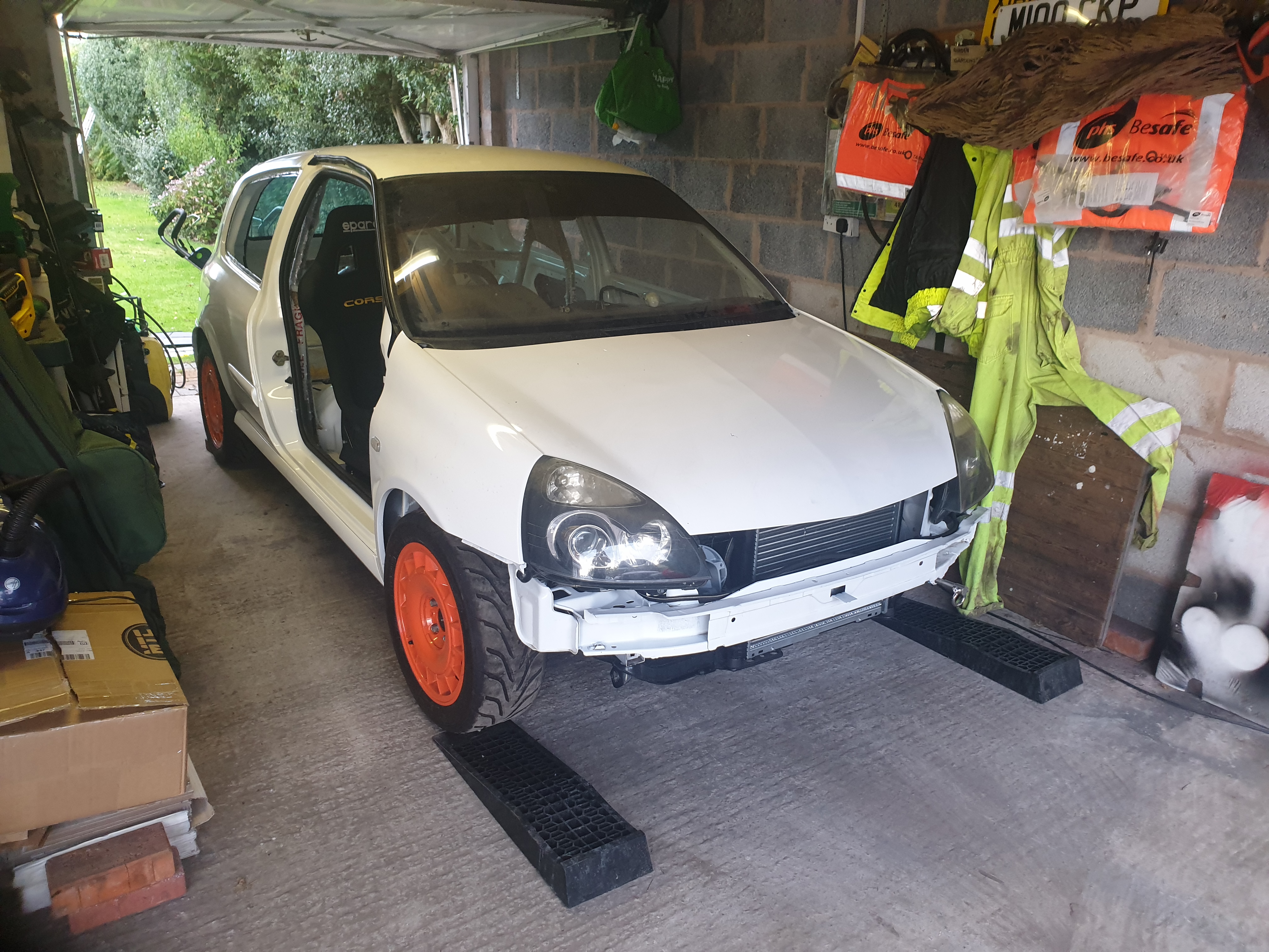

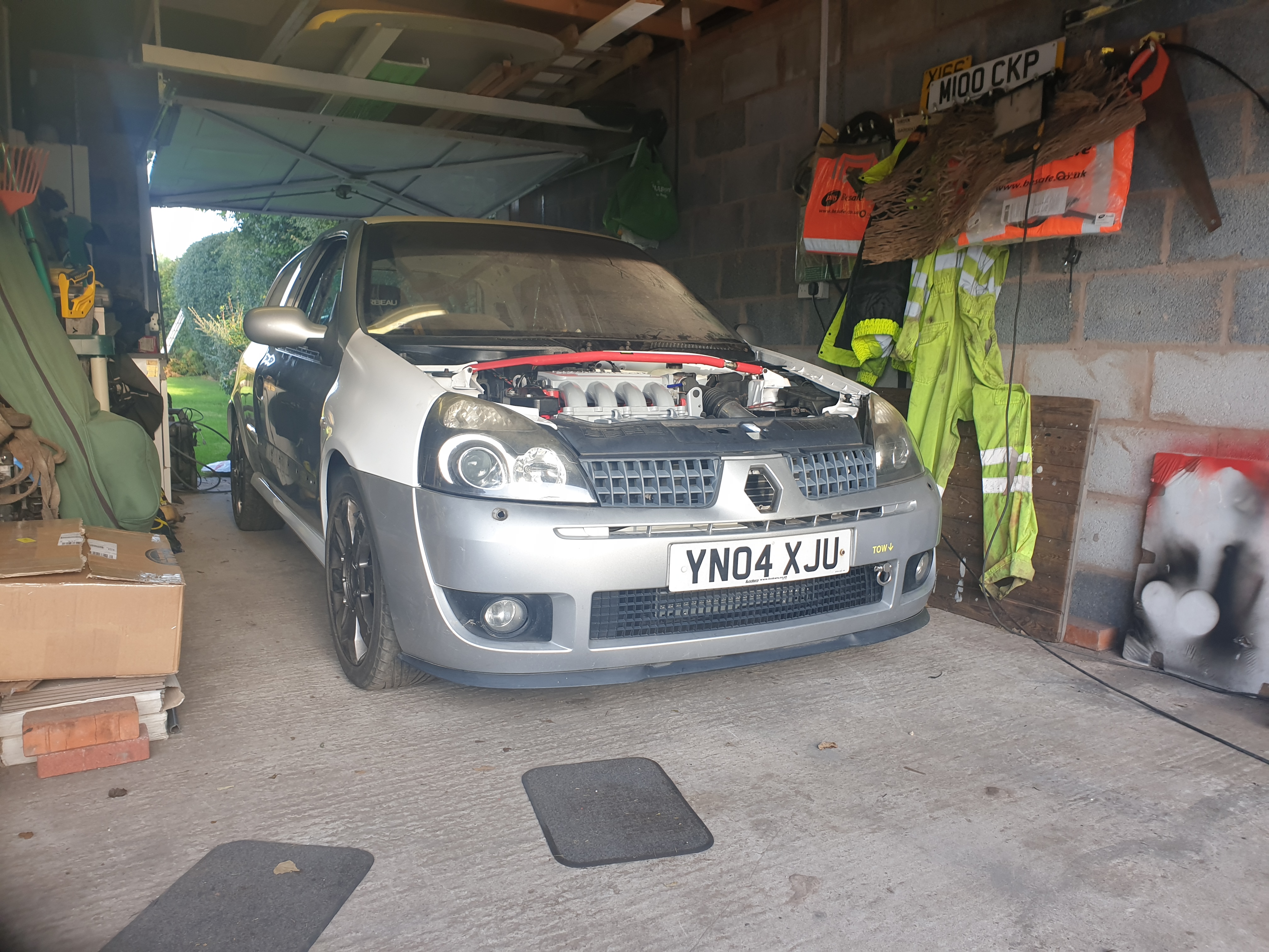

Not alot of time spent on this today as i needed to go the bank and i had to jack the red clio up and adjust the gear linkage to get reverse before i could drive this out the garage.

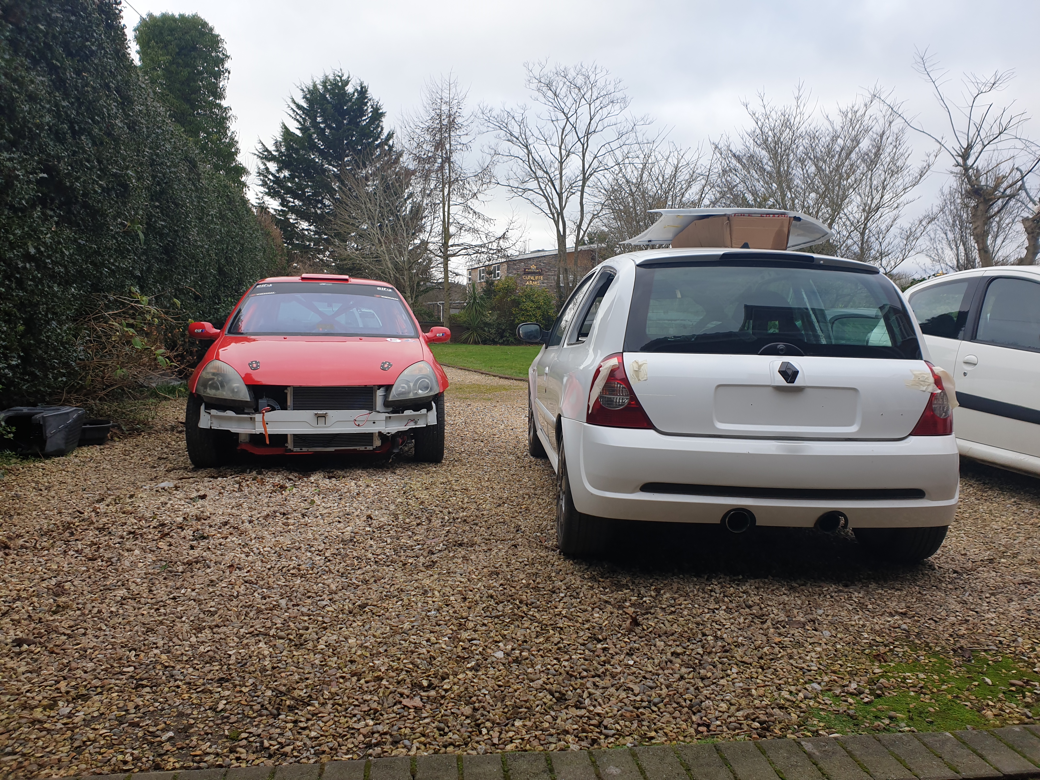

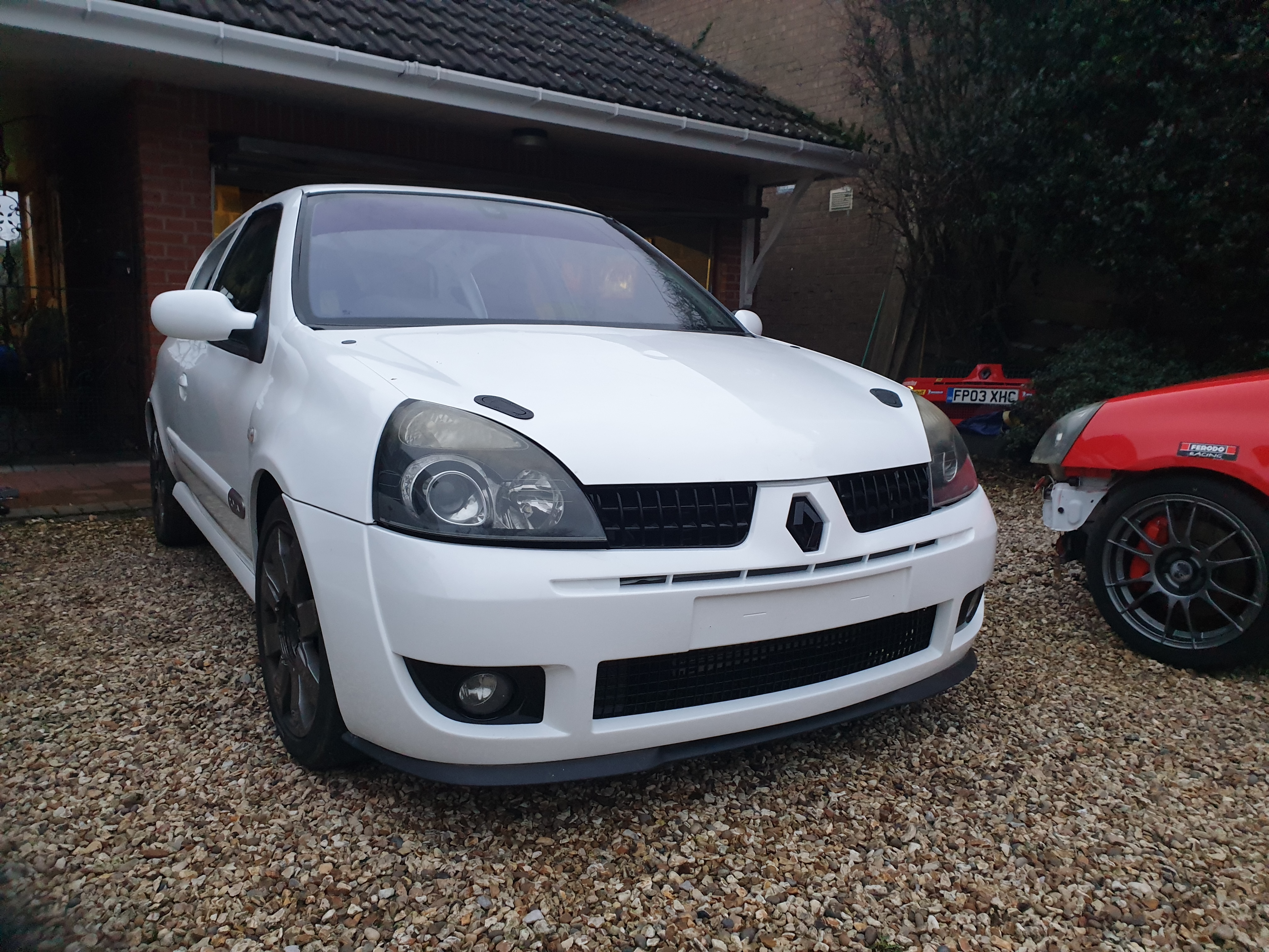

First time they have been both outside. The white clio has been in a garage since 2014 by previous owner as bare shell and been in my garage since december 2021.
Hoping to have this motd and on the road for march.

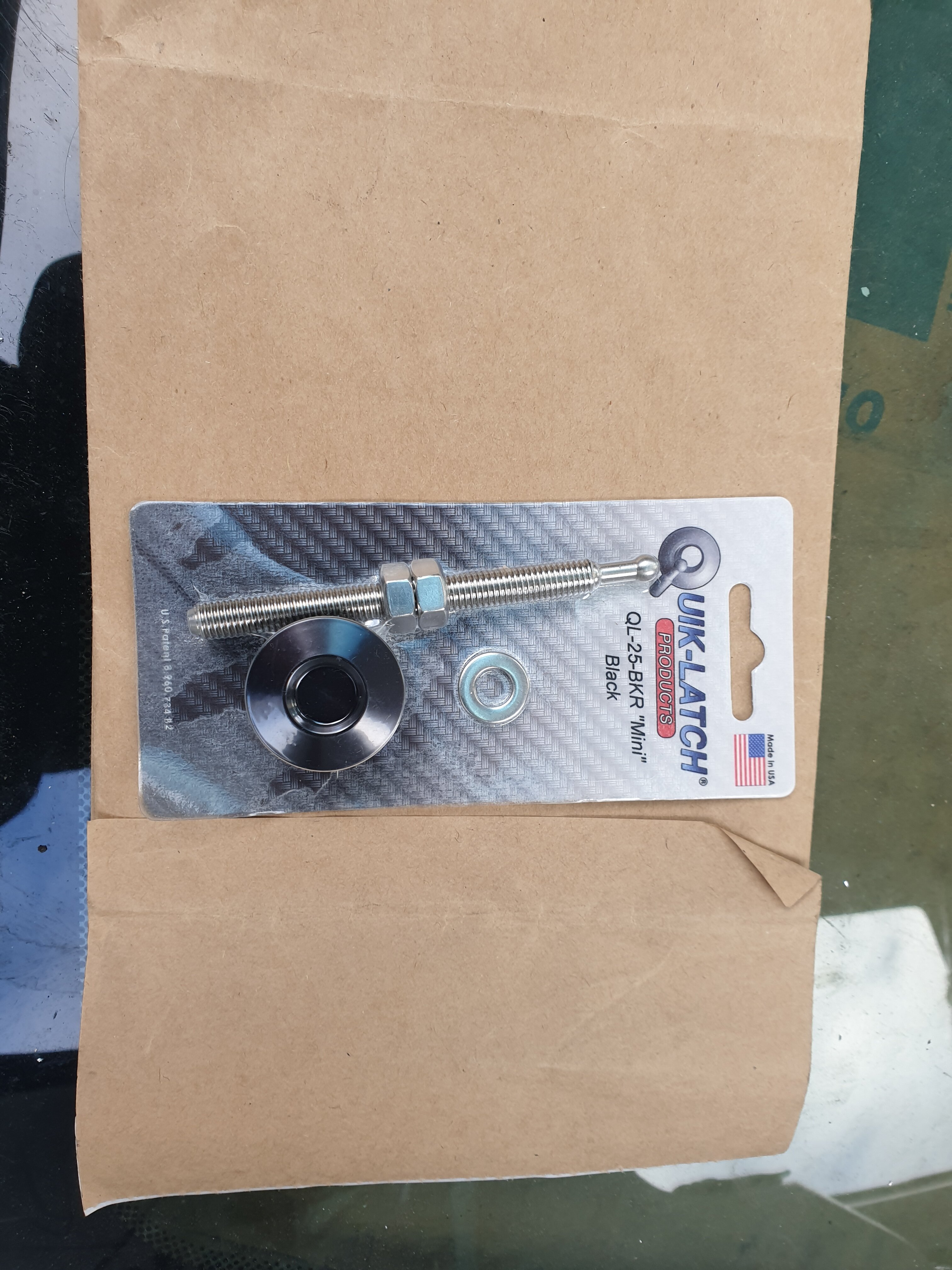

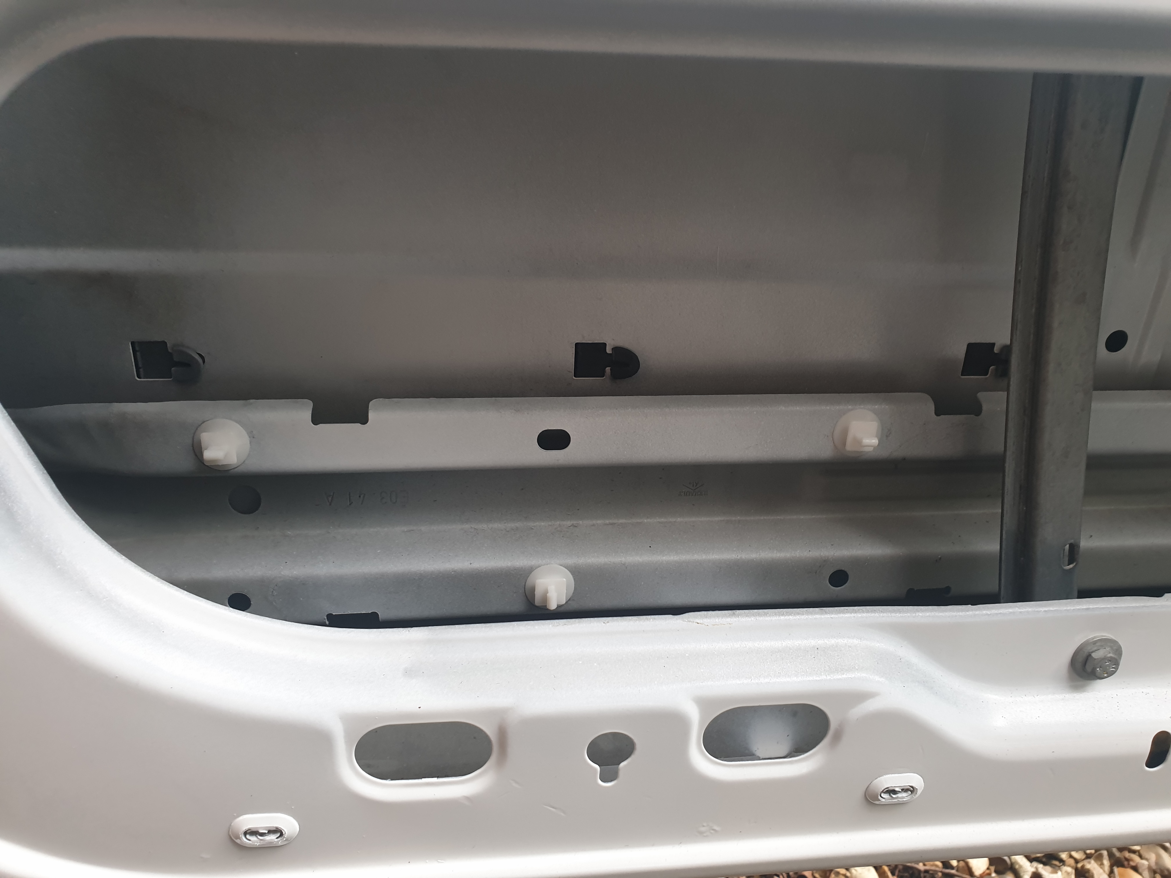

First job was to fit the rear boot latches. I have already fitted these to the front of the car, expensive for what they are but if the Aston martin race team use them on there cars the quality should be there in comparison to the cheap chinese ones on ebay.
  clio 172
Quick latches fitted , these could have done with being ever so slightly longer but maybe i can look into this again.
Didnt take a pic of the rear with them actaually fitted 🙈🙈

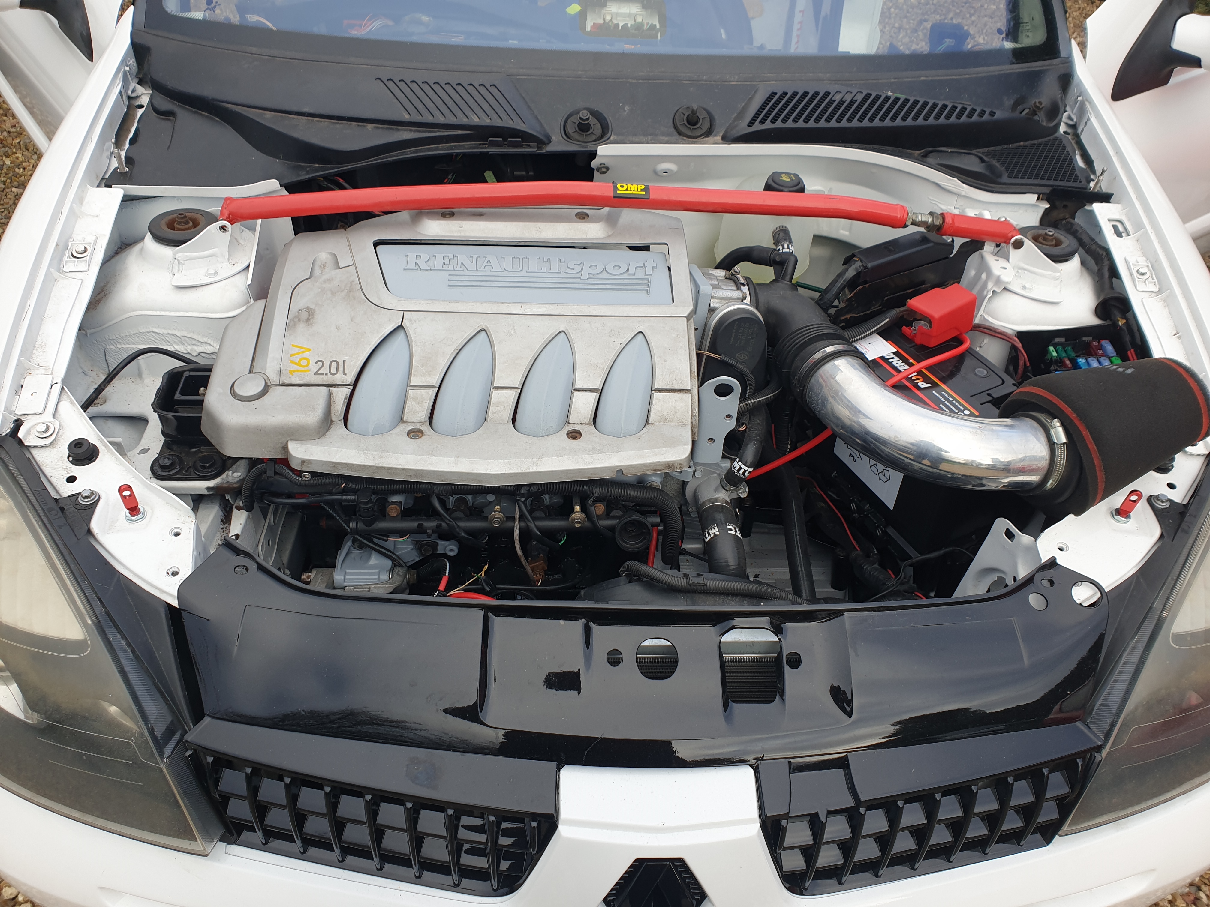

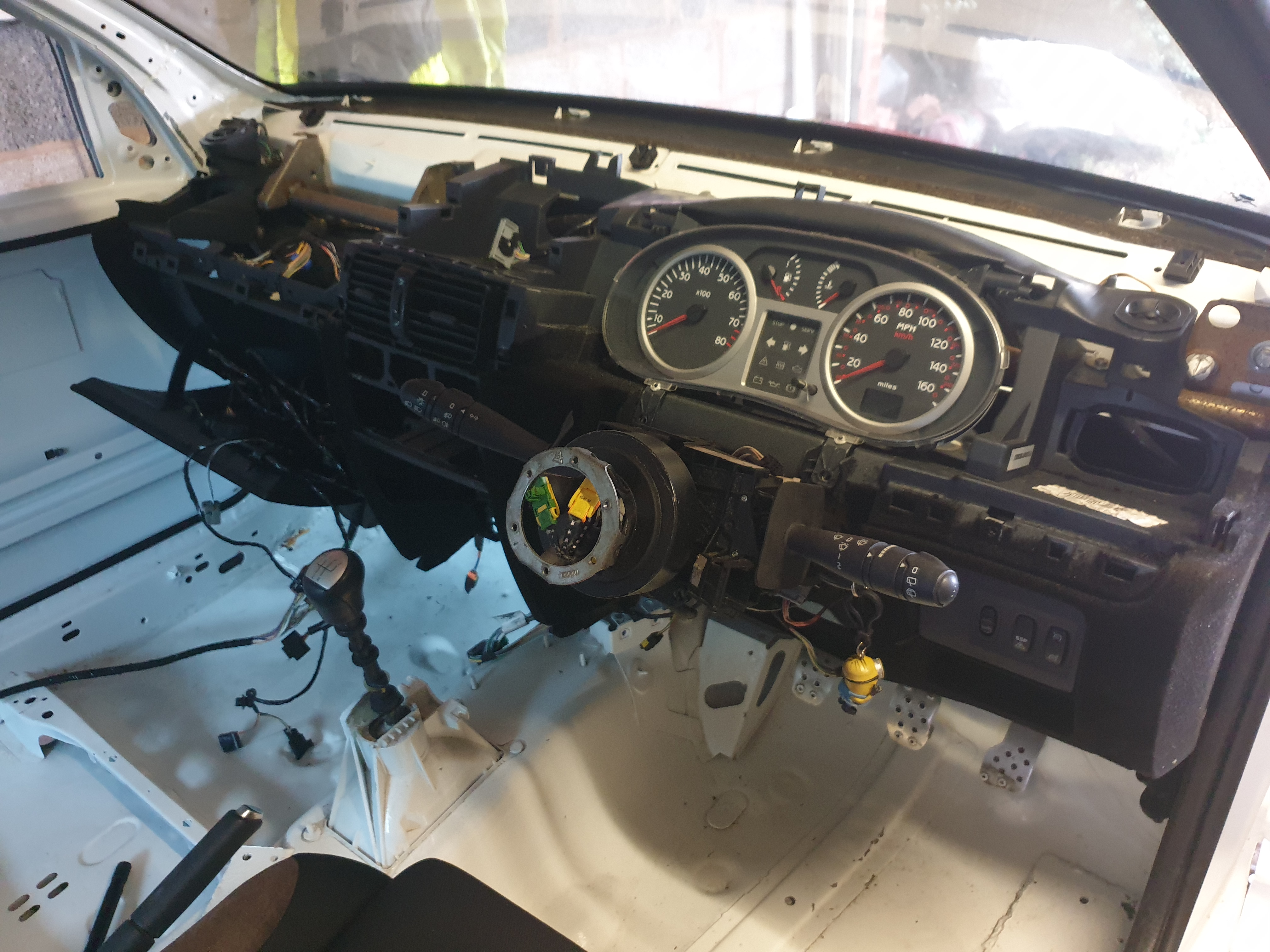

Found the engine cover that came with the car. Dont think that will be going back on !

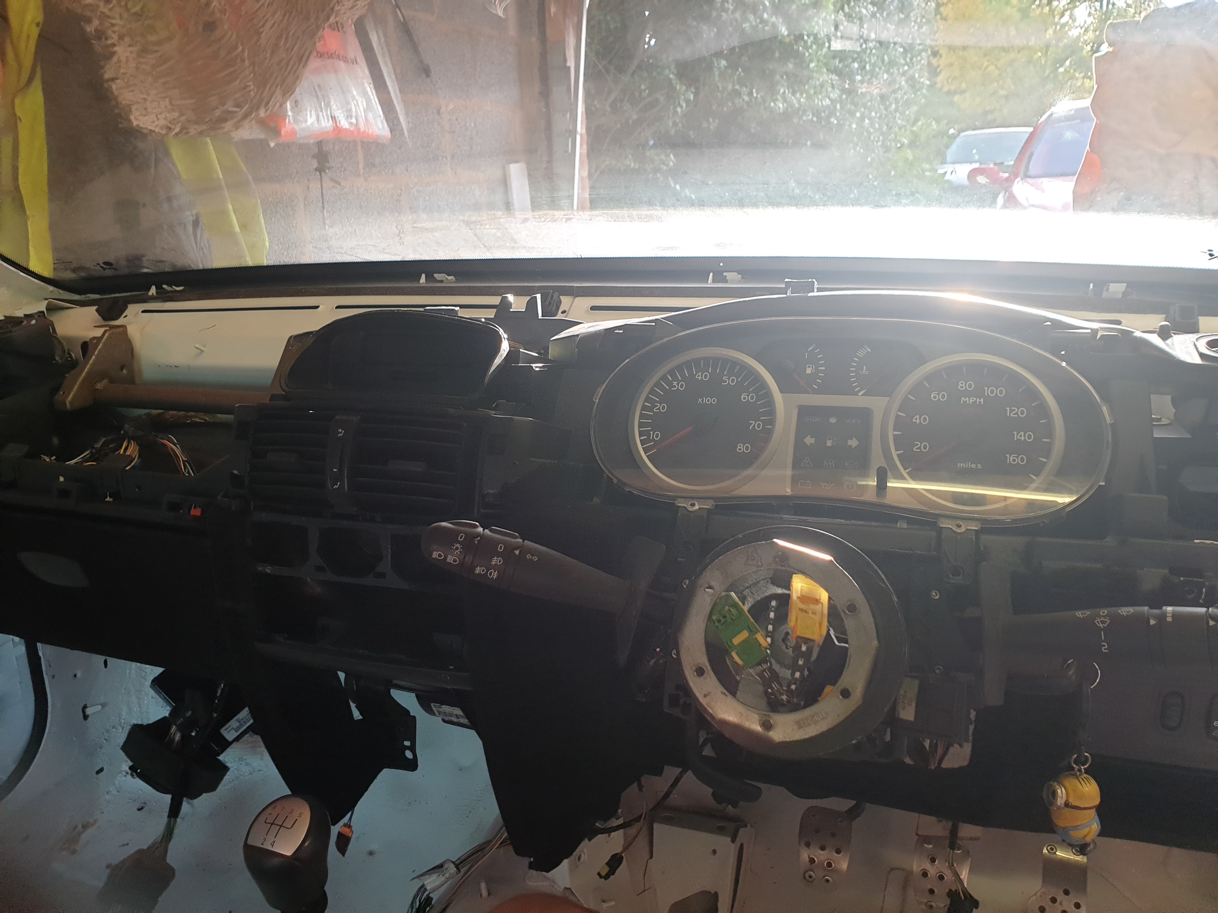

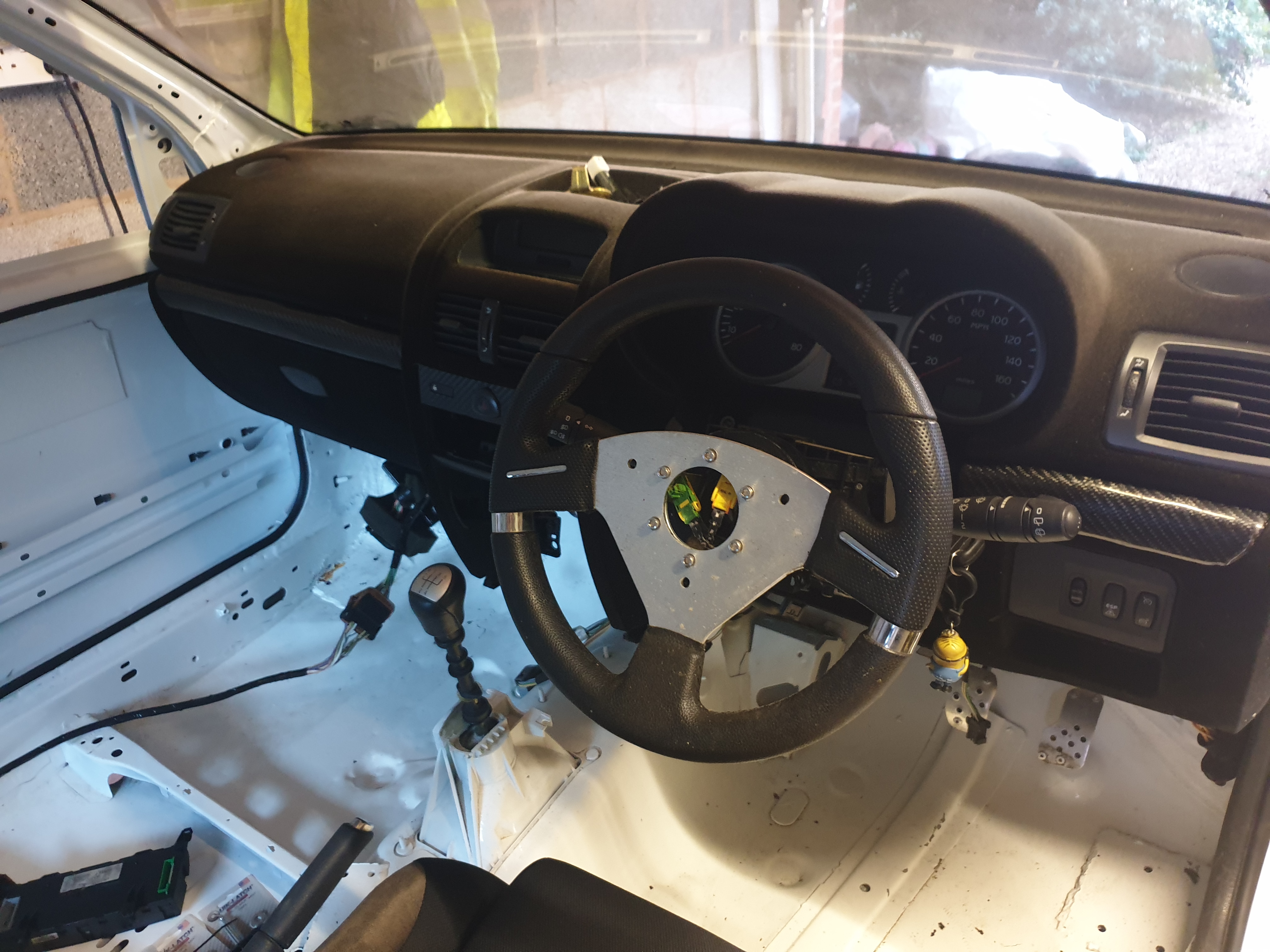

Time to re-install the flocked dash and start putting the dash back together.
Still not 100% sure how much of an interior is going to go back in this !
Note the dodgy steering wheel, only installed for moving the car.

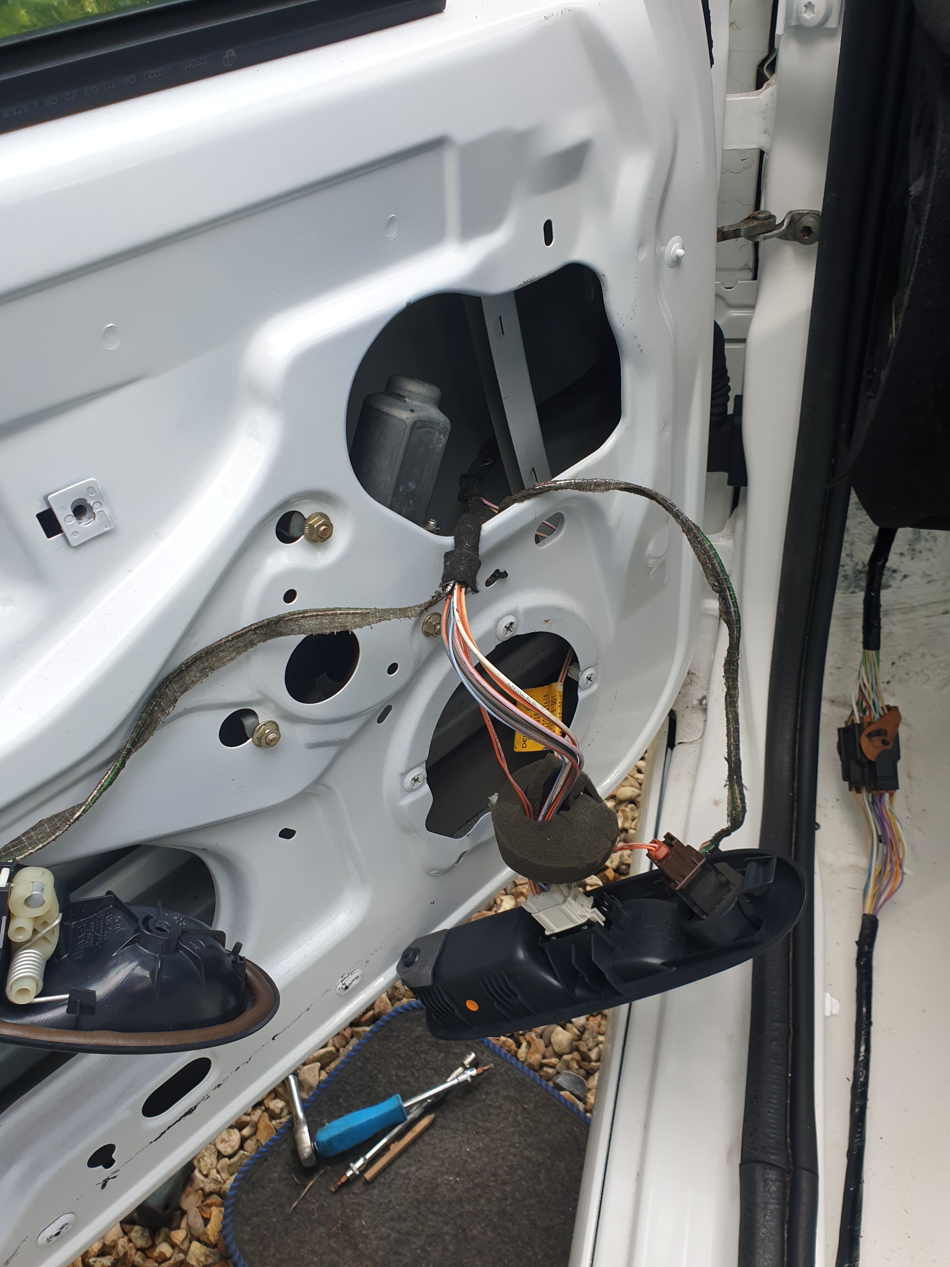

Front door looms fitted and rubber trims on drivers side. Not sure where i have put the passenger one 🤔. Can you still buy these if not ?
Anyone know what the part codes are ?

As it currently looks , thinking of getting the 182 wheels refurbished as i do think they suit the 182 but i do have ideas for some aftermarket wheels.

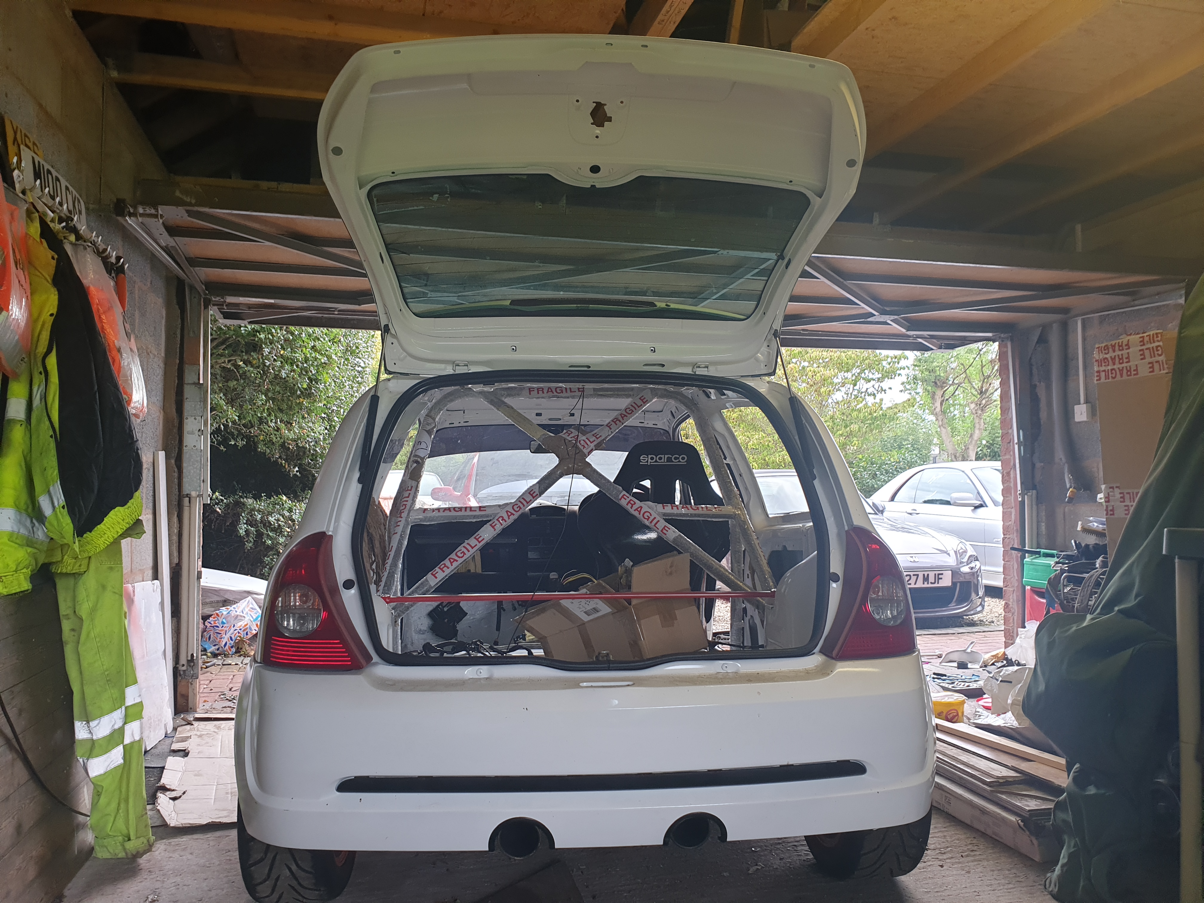

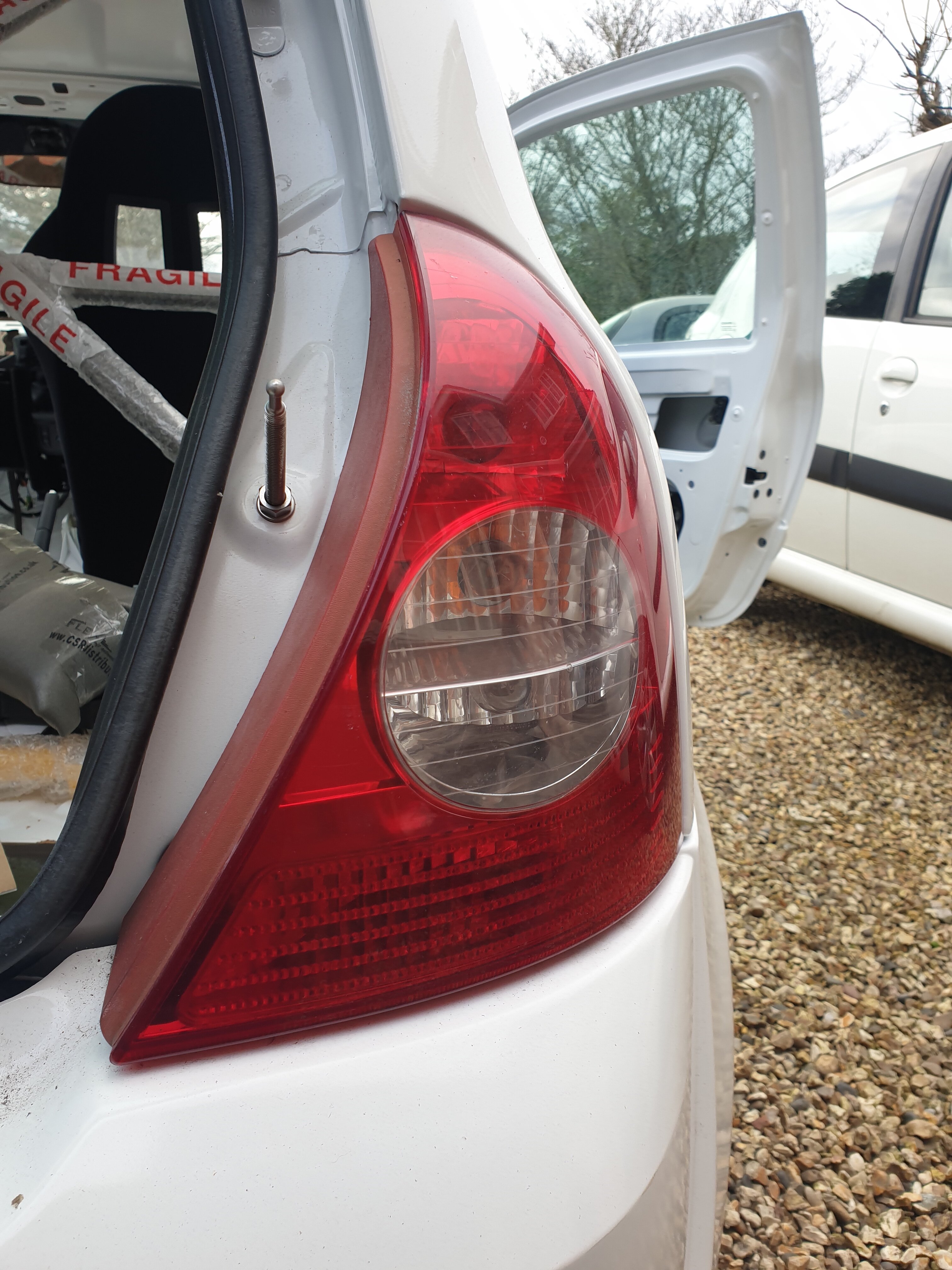

Been a while, life and work got in the way as usual but going to get this finished and on the road over winter as the S2000 will be tucked away so good opportunity to get some miles done in this and some winter trackdays.

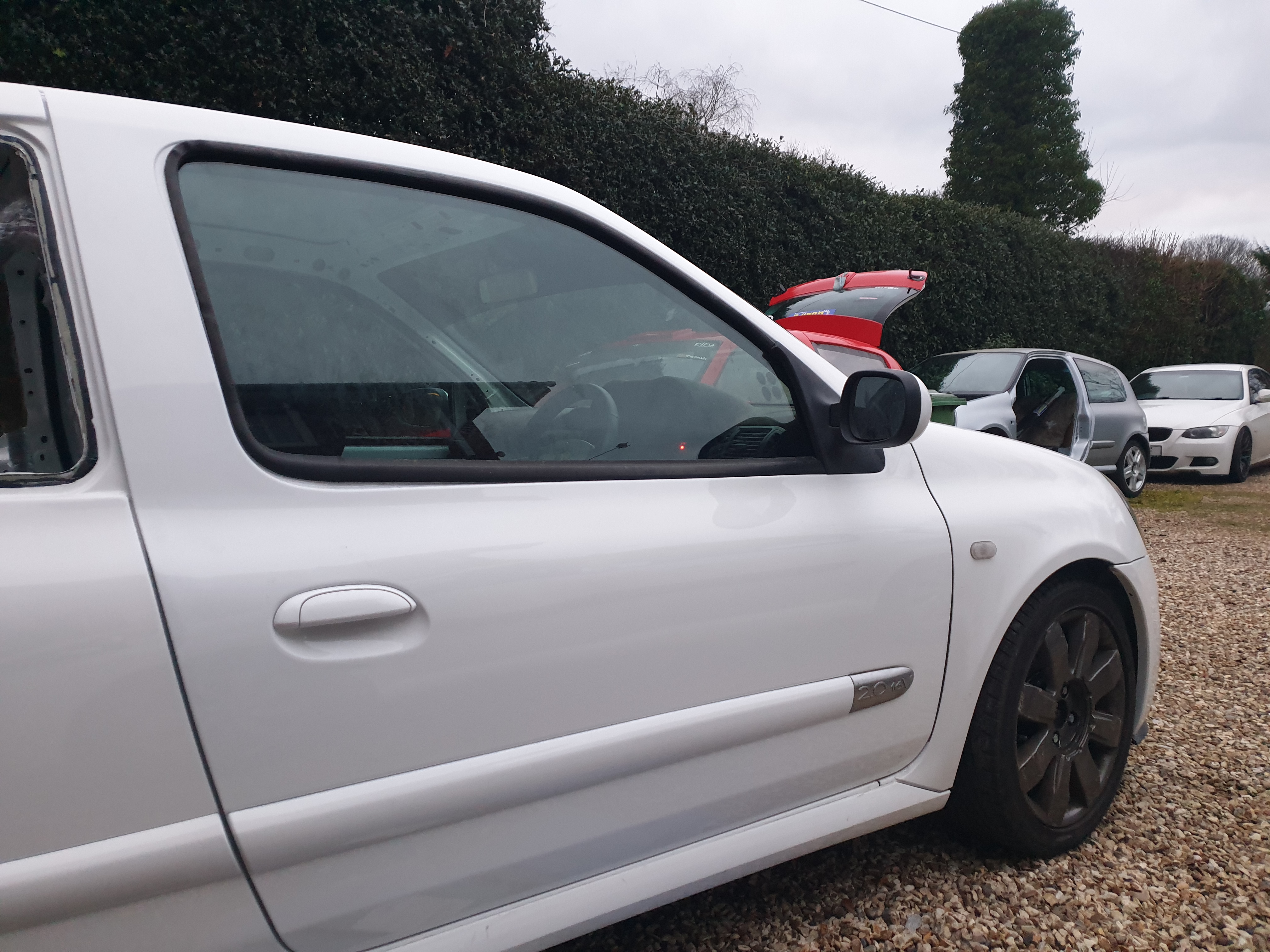

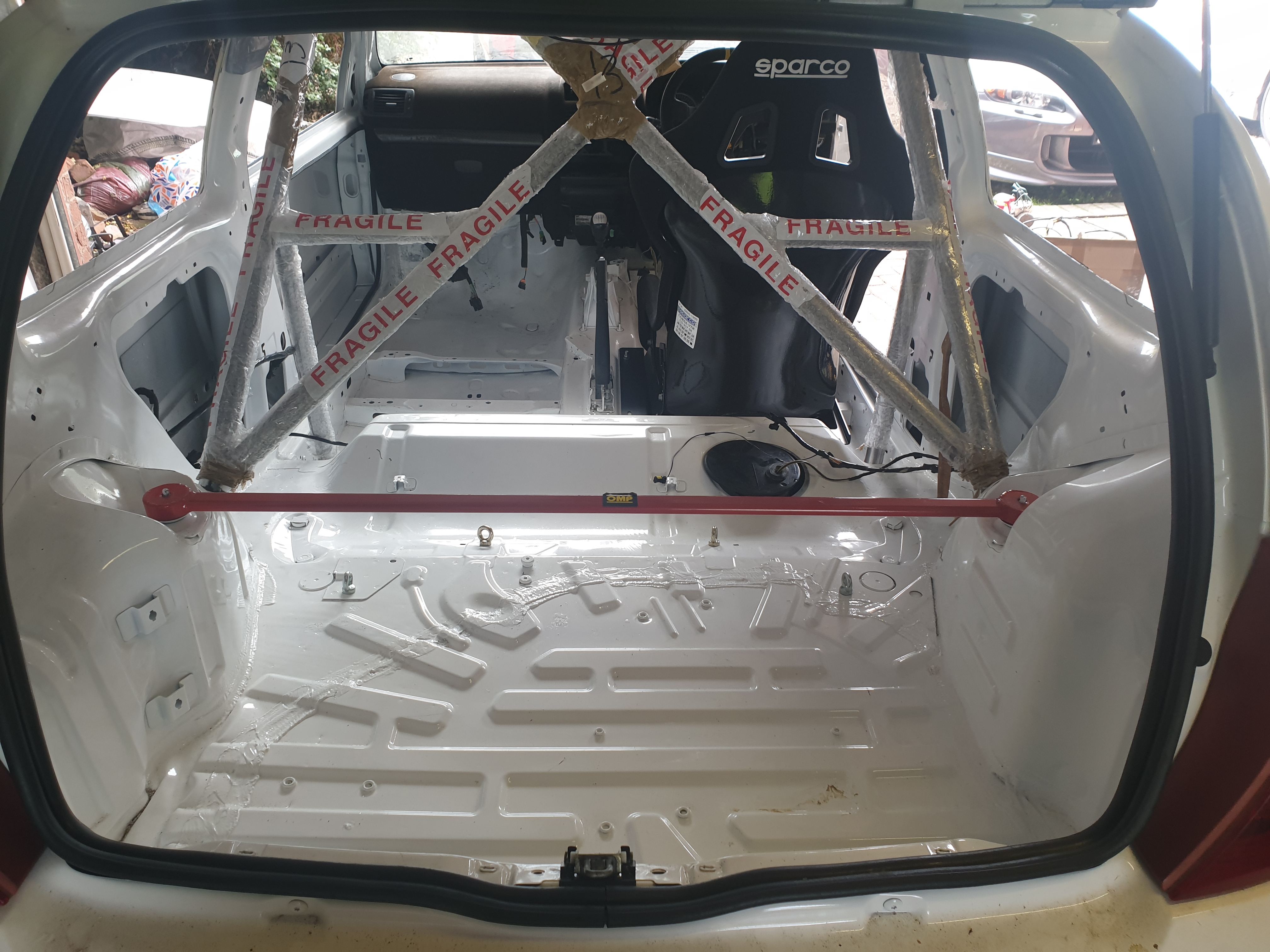

Rear Cup windows installed so hopefully car will be water tight so i can get this out the garage and on the drive.
Need to remove the KW suspension off the red car and fit onto this as its currently on oem shocks and sits very high.

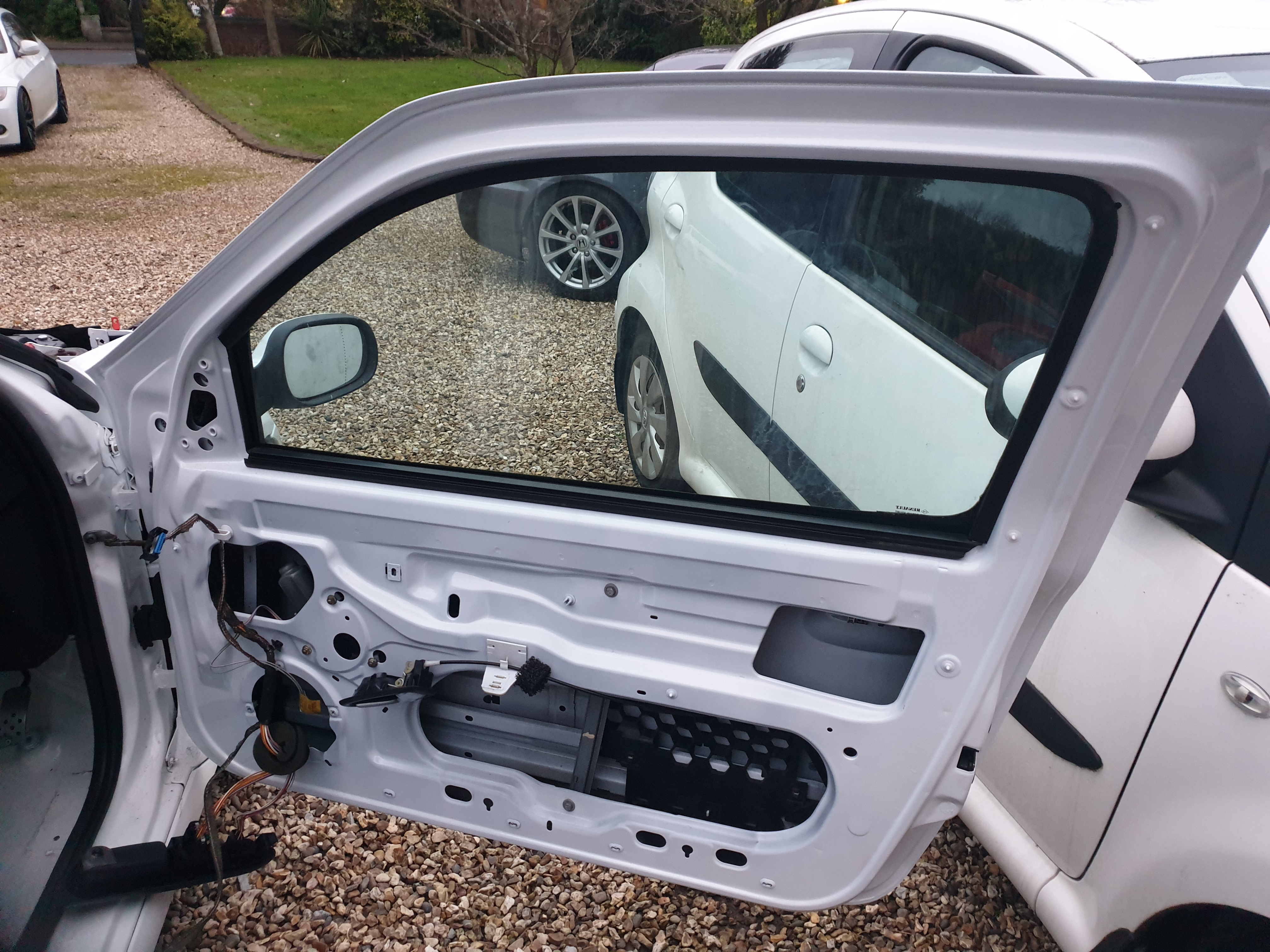

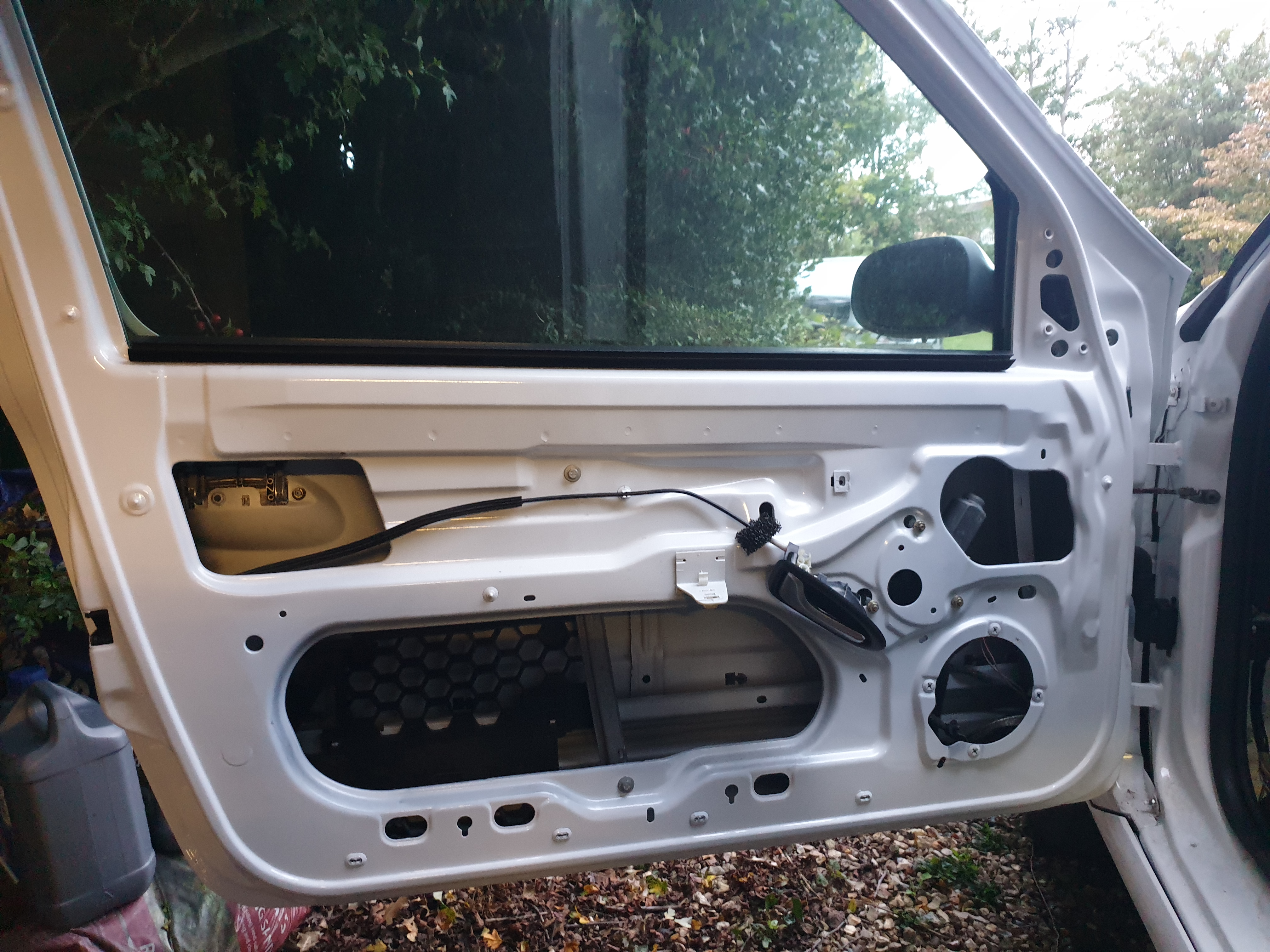

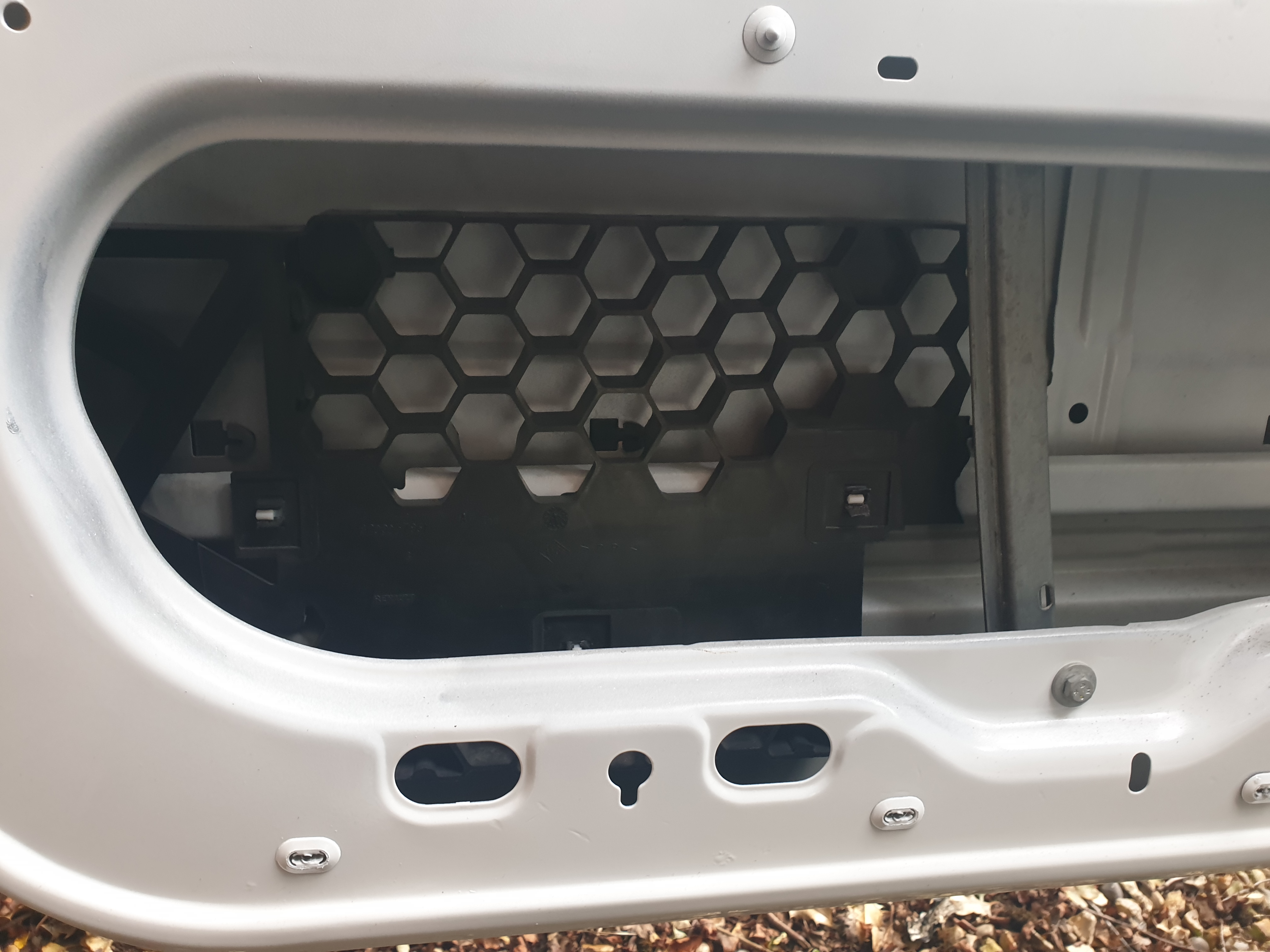

Managed to finish putting the doors back together now i had the white clios for the honeycomb window guide.
Also found the insert for the side of doors as couldnt remember but luckily i bagged all the door fixings.

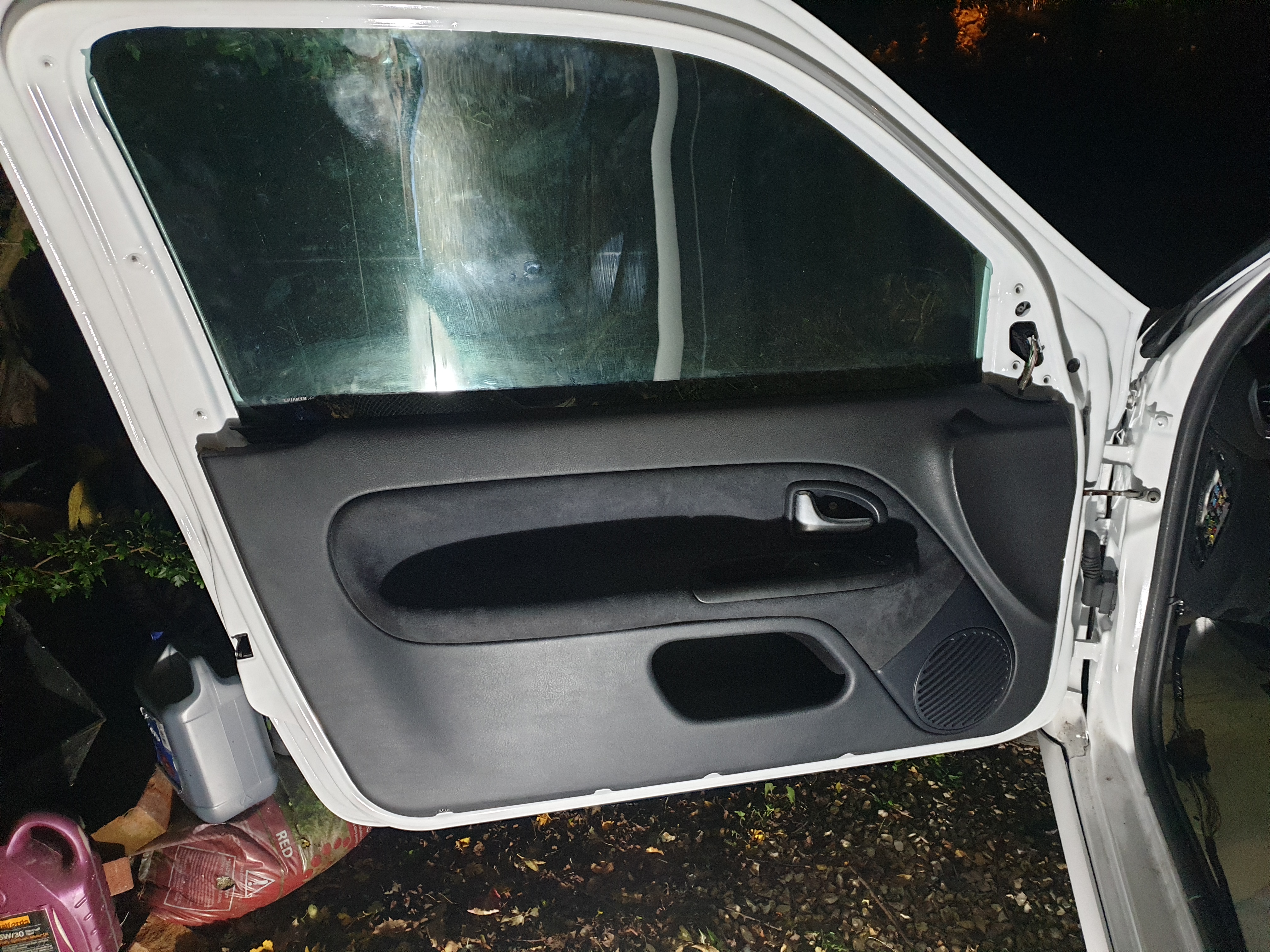

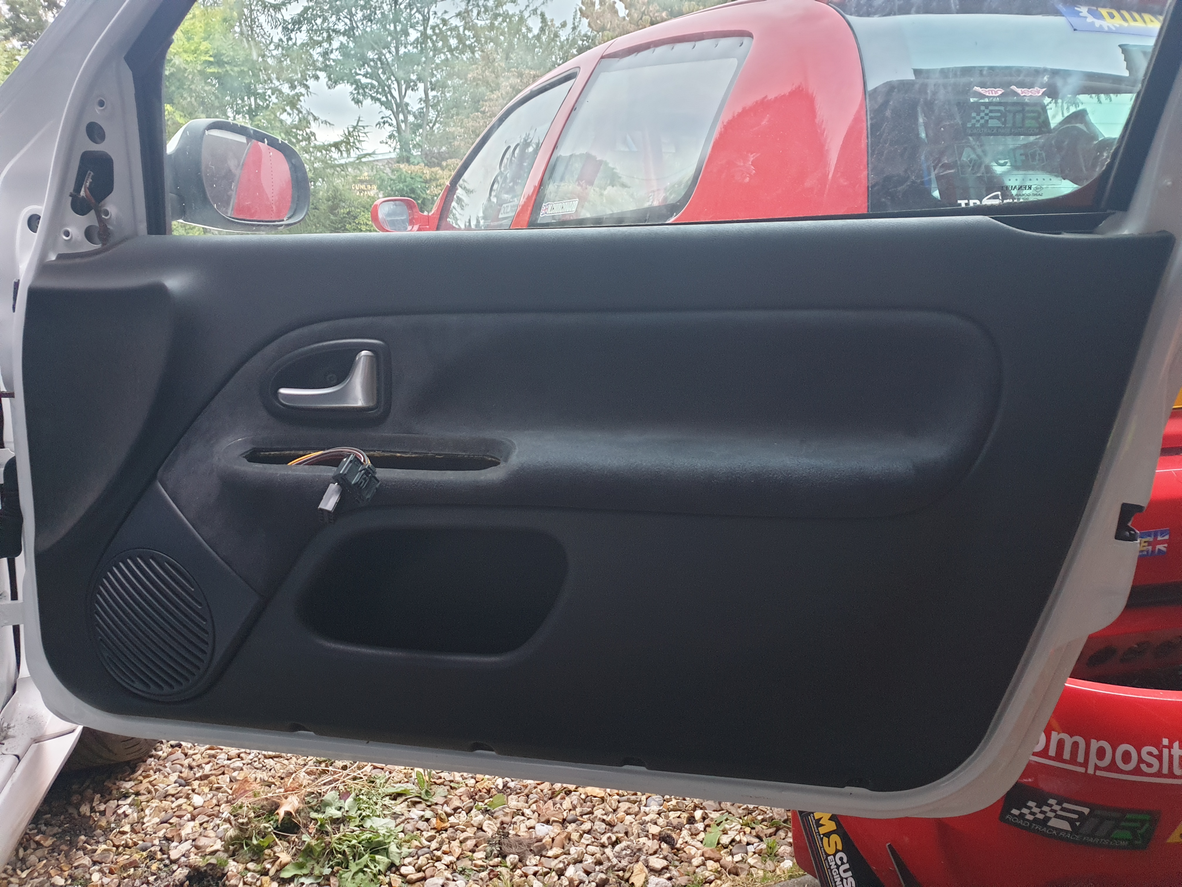

Fitted the oem door cards for now as i plan to use this abit over winter and be semi practical 🙃.
Drivers side done, need to see why its not locking on the key fob, cant hear it engaging lock so will check im getting signal at the door.
Passenger side, it was getting dark so packaway time.

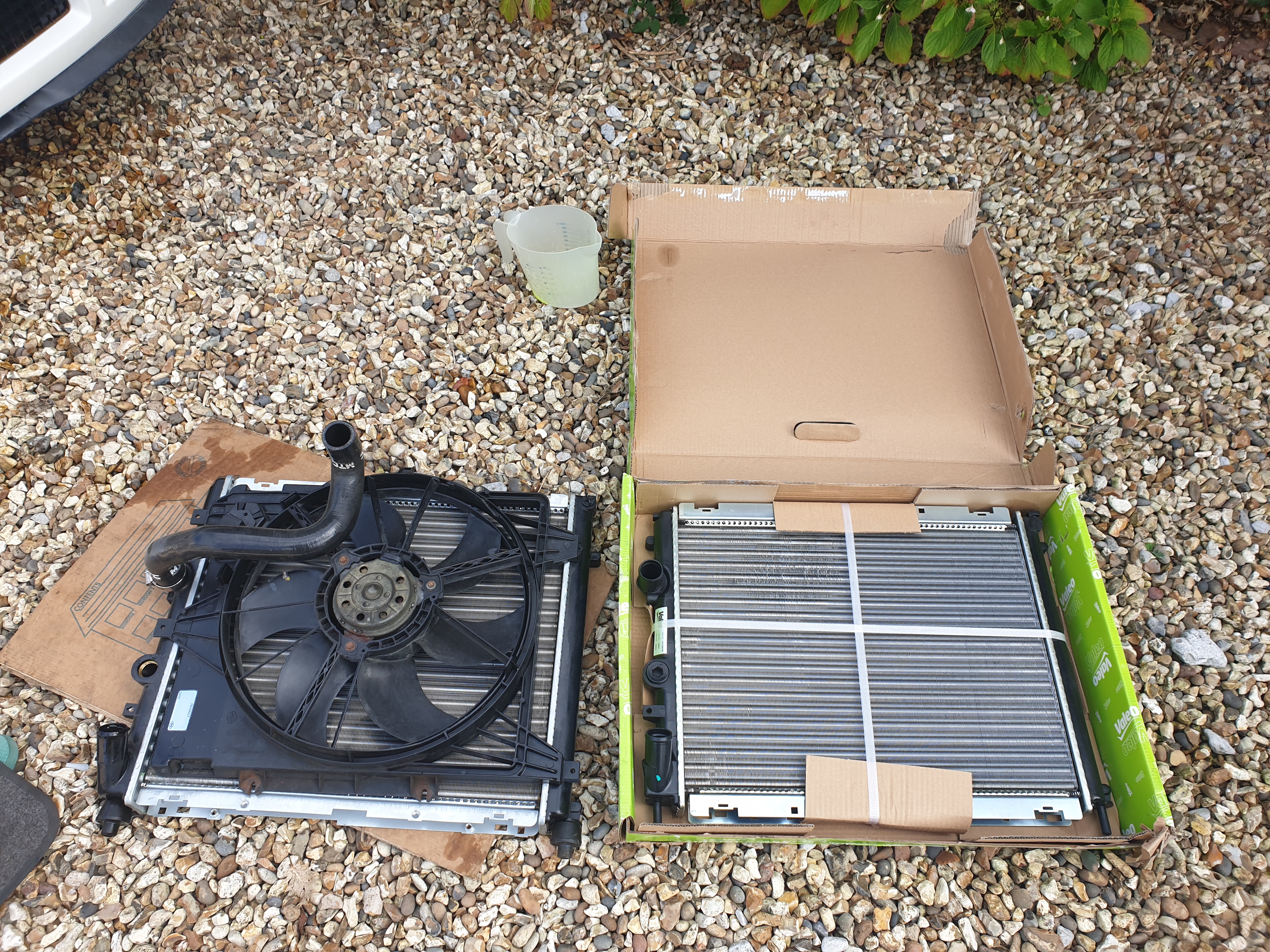

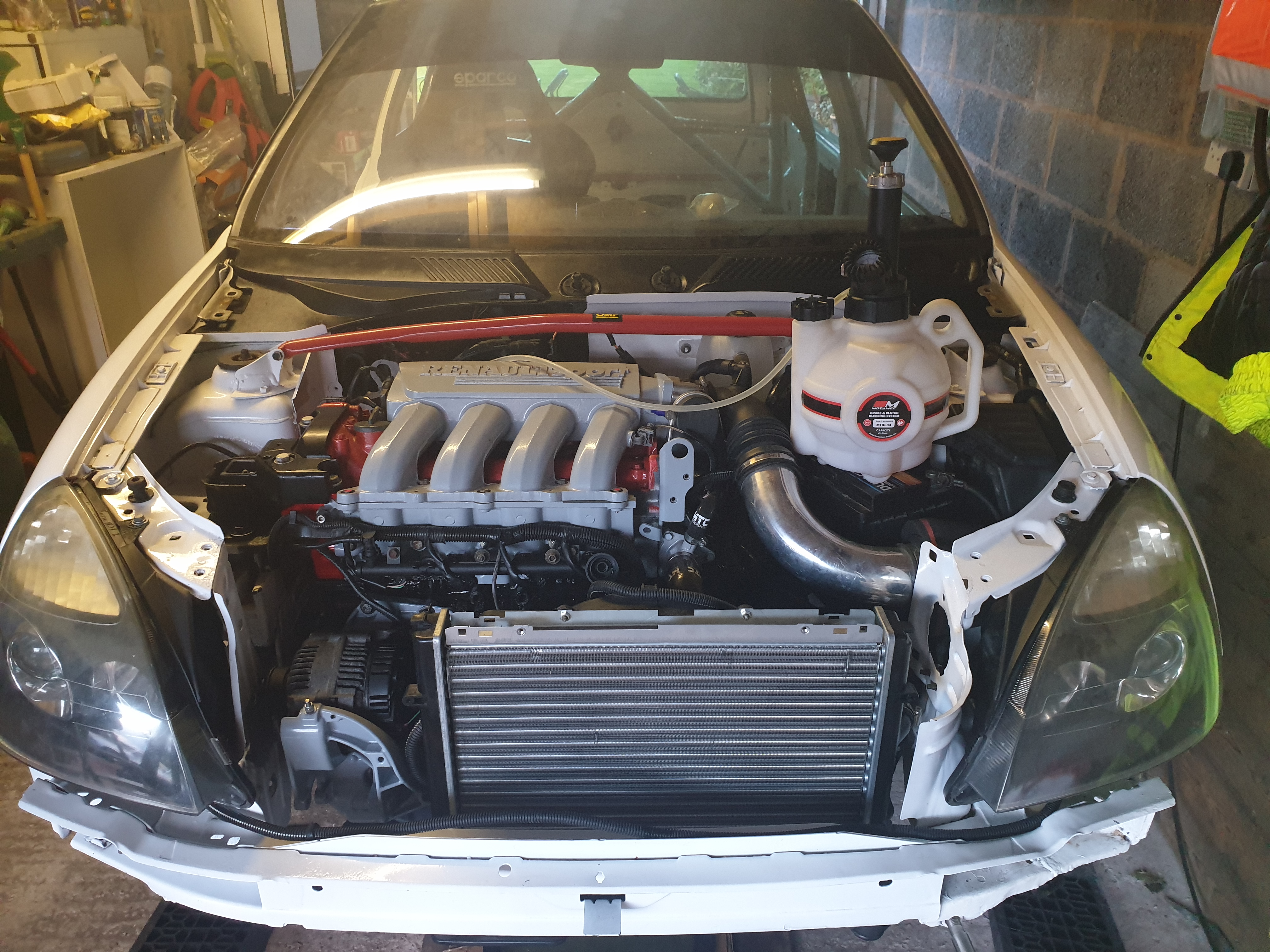

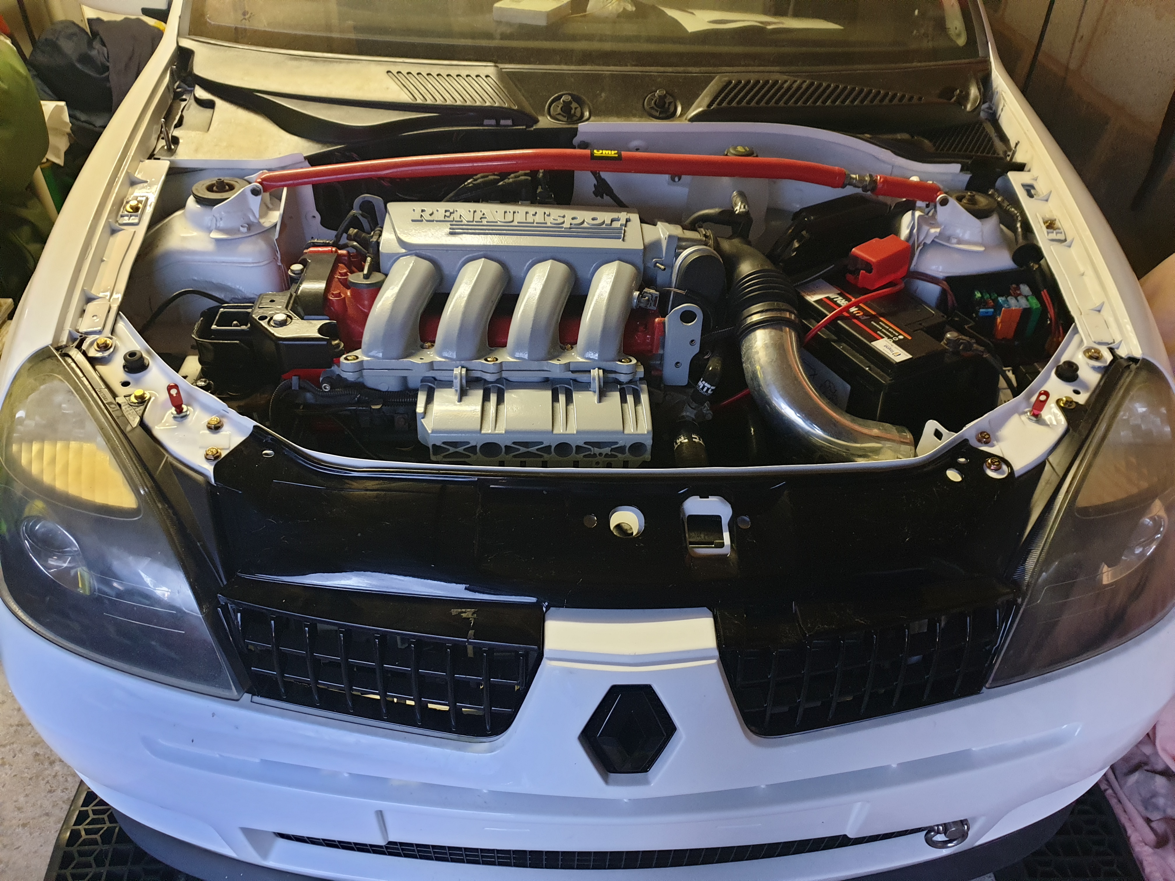

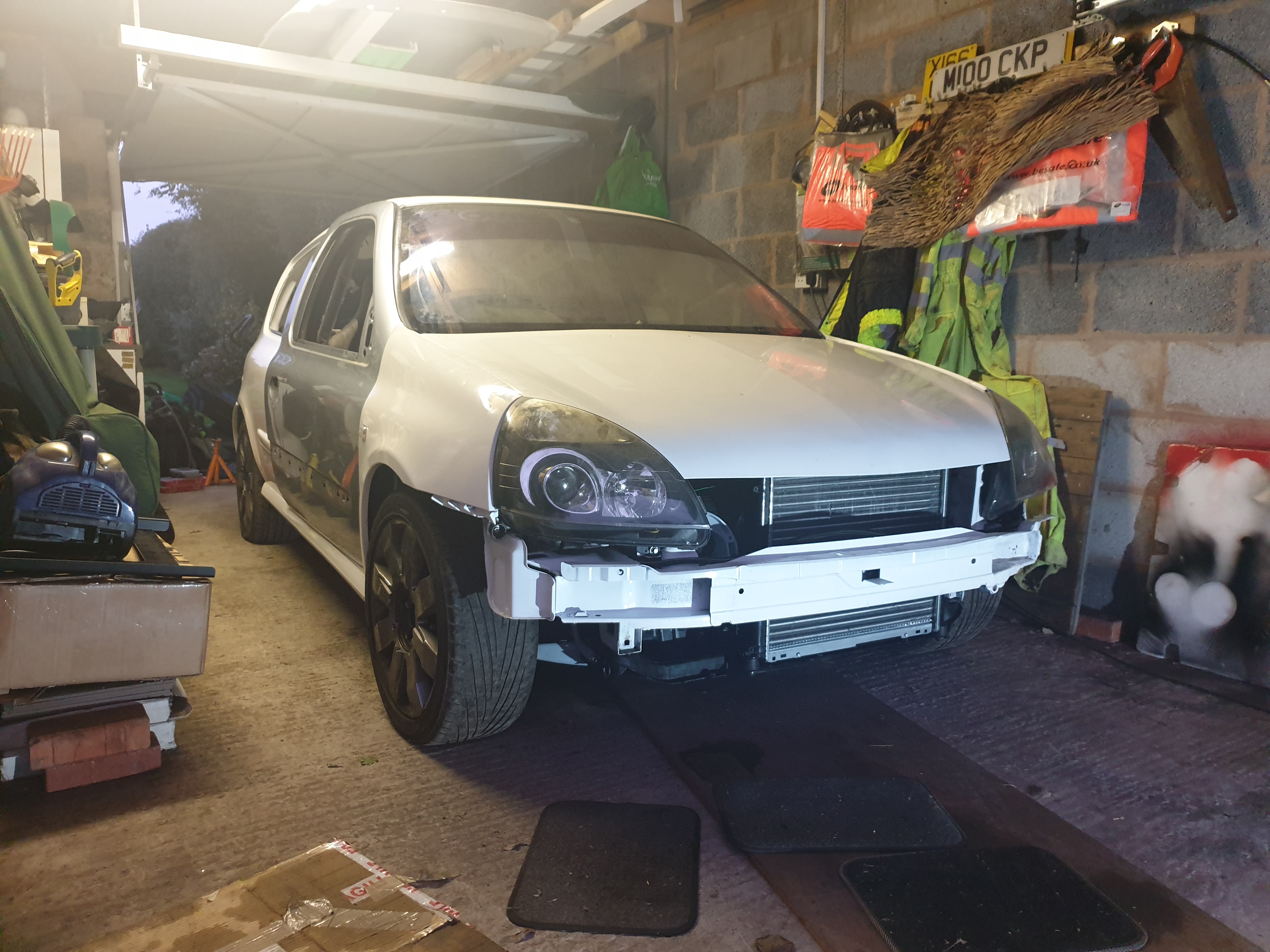

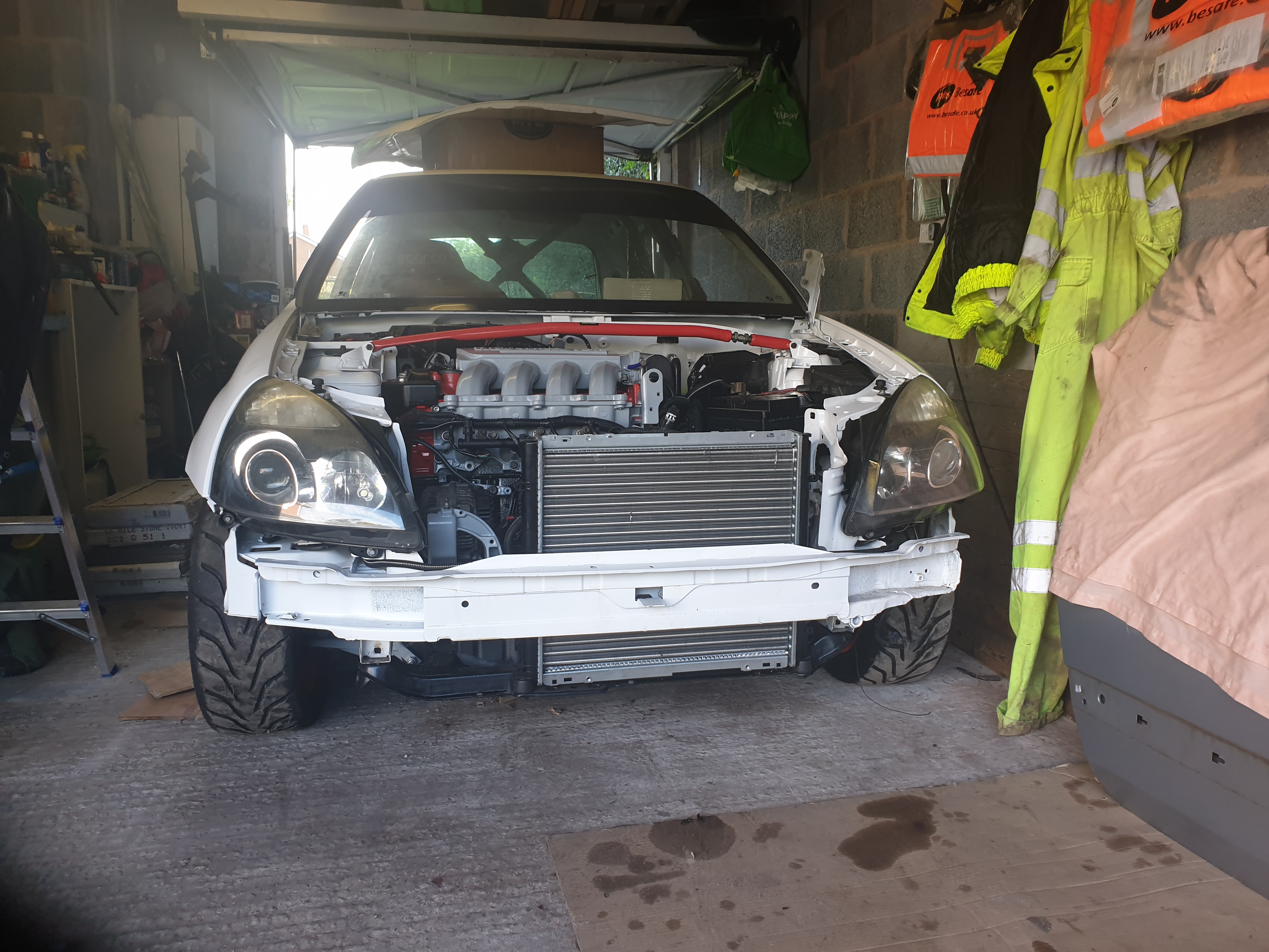

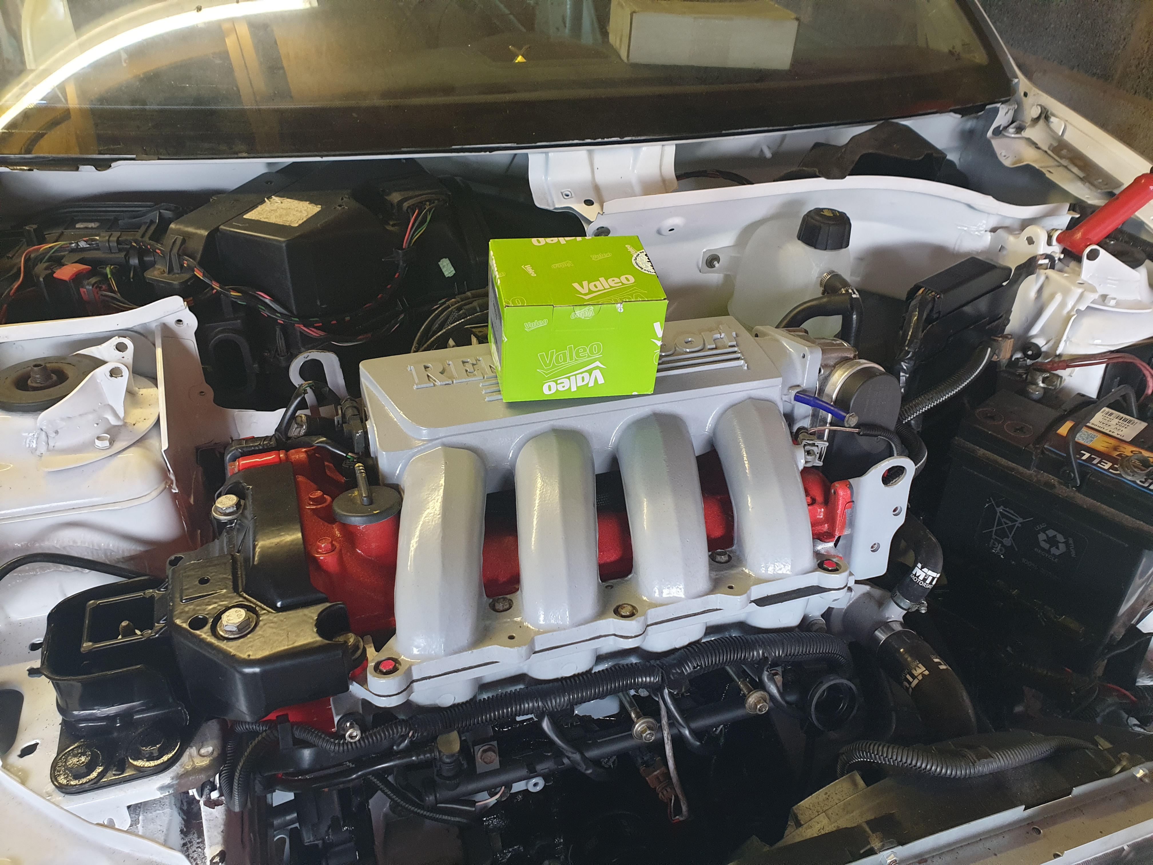

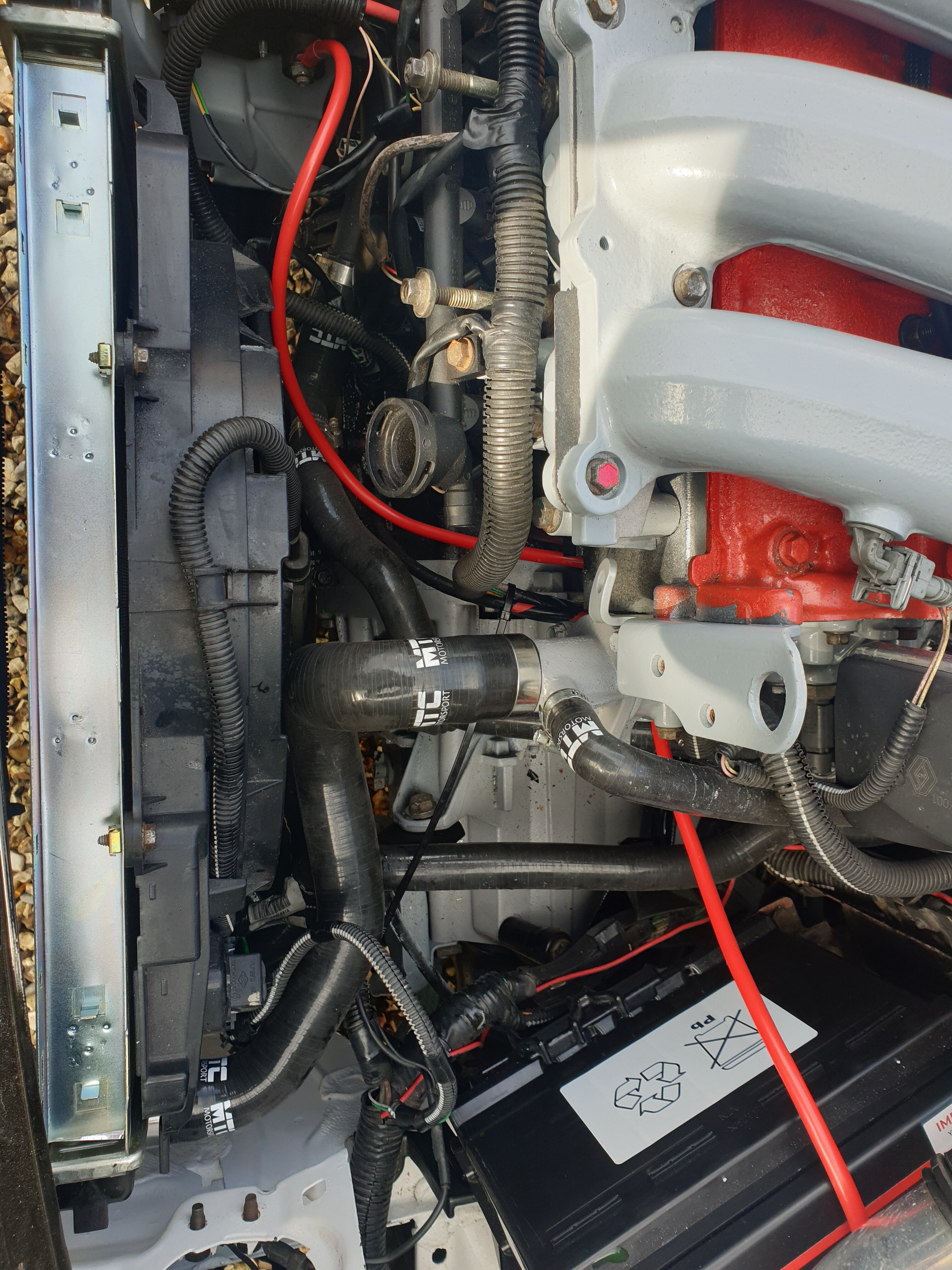

Attempted to do abit today with my right hand out of action due to a broken wrist !
First job was replace the radiator as the one i fitted was slightly to tall so i purchased an oem one.
Slam panel should fit in place now without fouling the radiator 😎
  clio 172

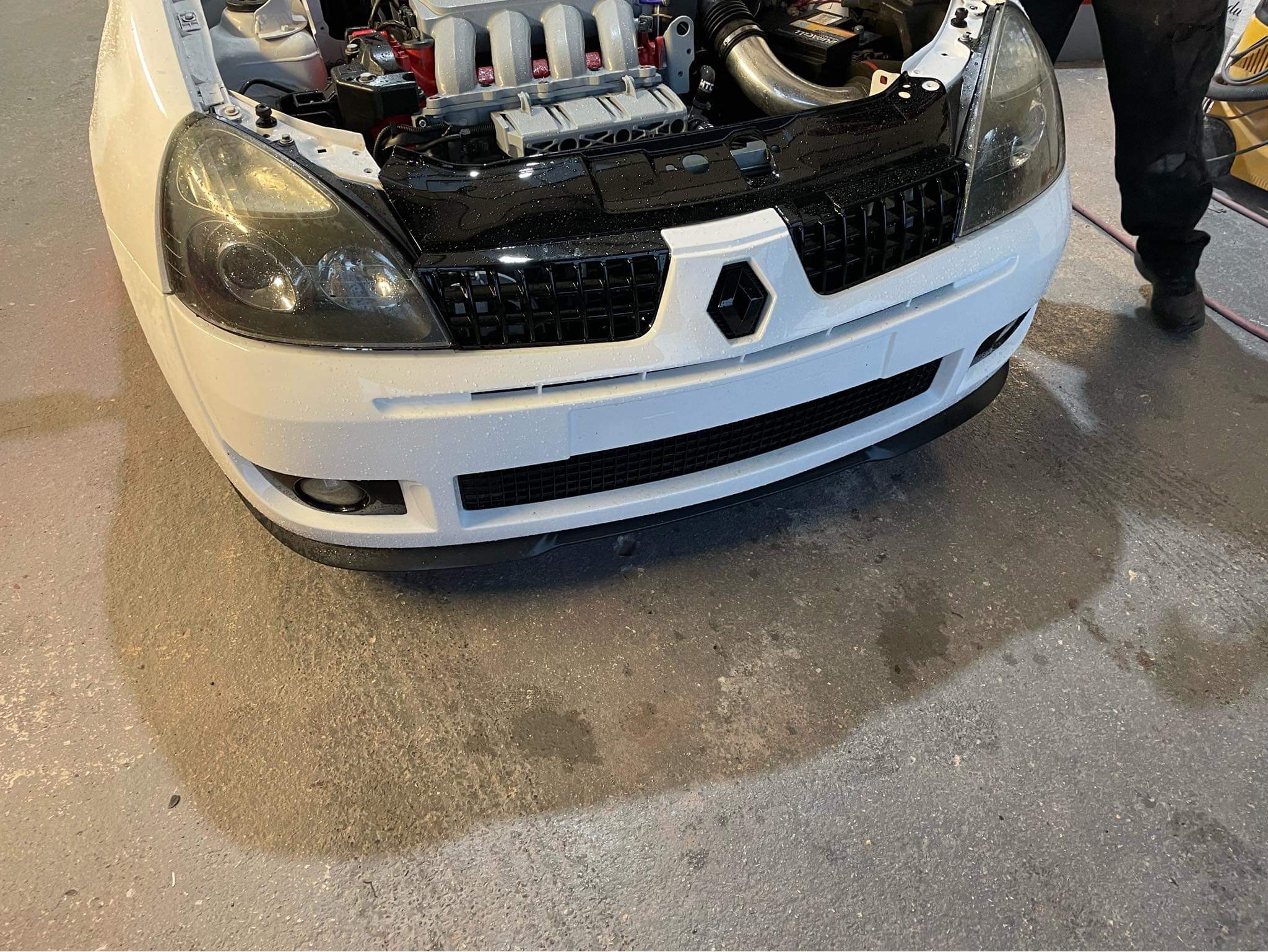

Spent afew hours on the clio today. First job remove the radiator which doesnt quite fit with the slam panel as i found out.
I went for valeo unit, think this is what are fitted from the factory.
Hopefully slam panel fits in place now without fouling the radistor.
