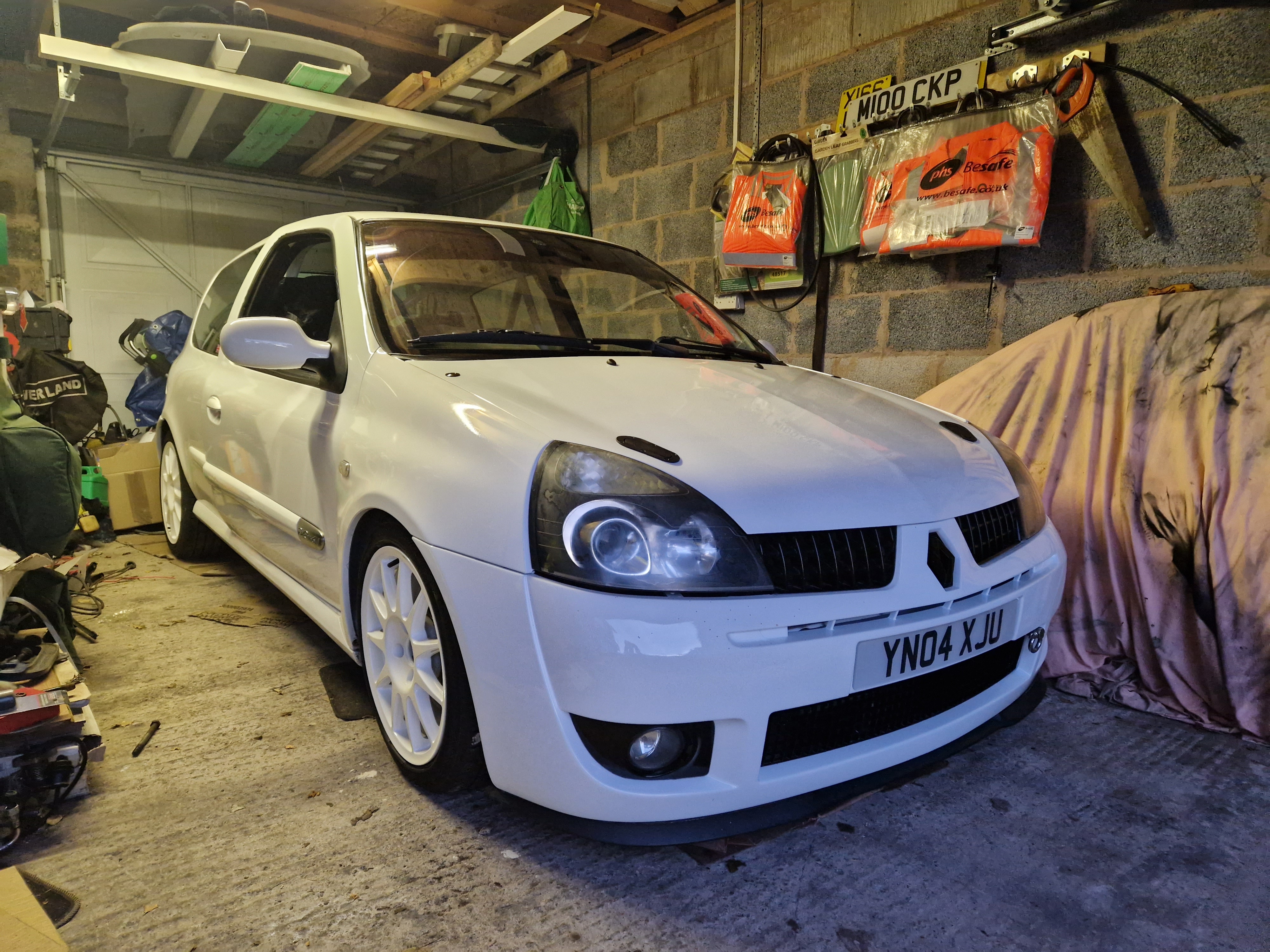

DJ Kaled , Another one 🙈🙈🙈. Track car

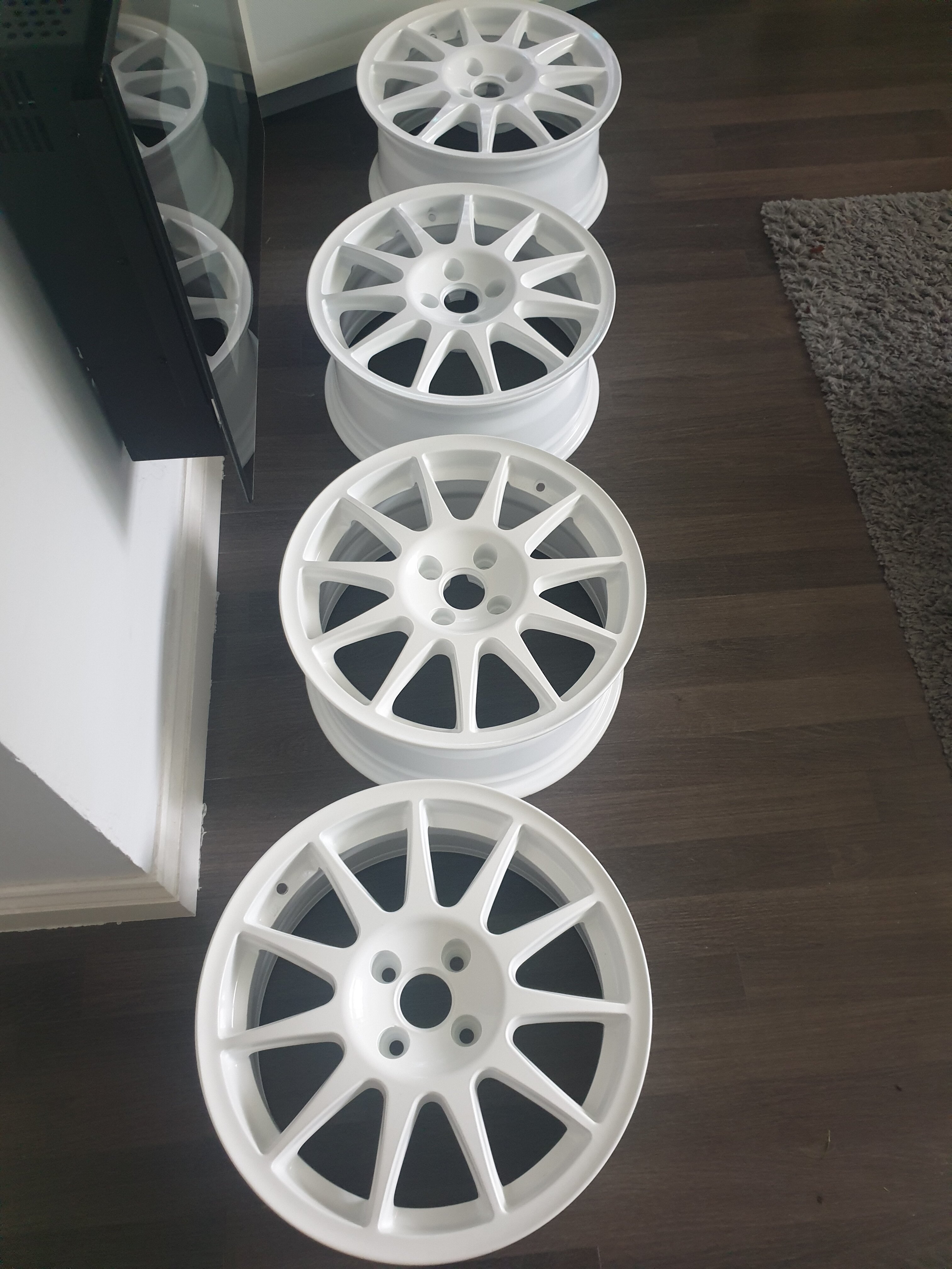

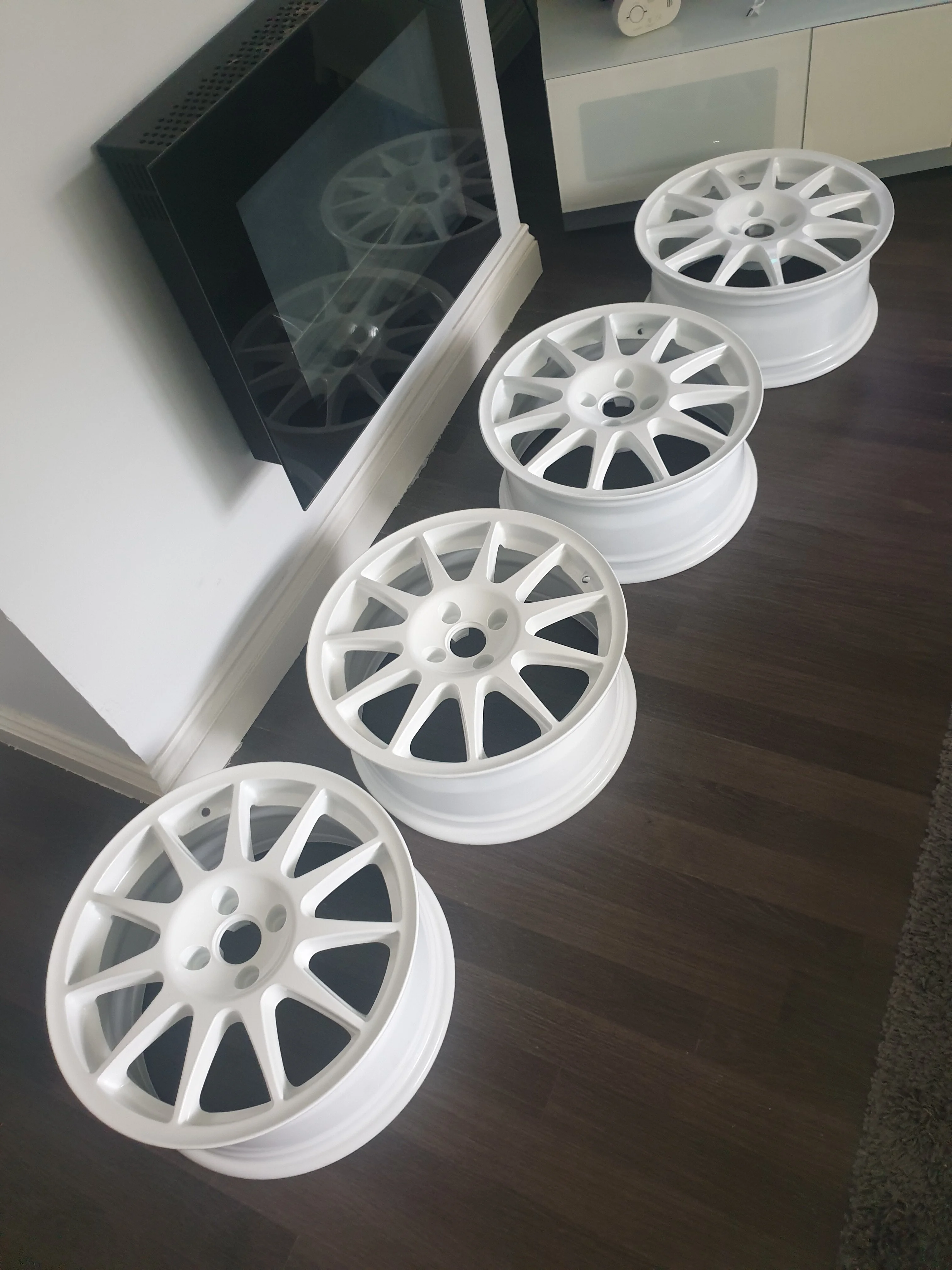

Winter wheels done.

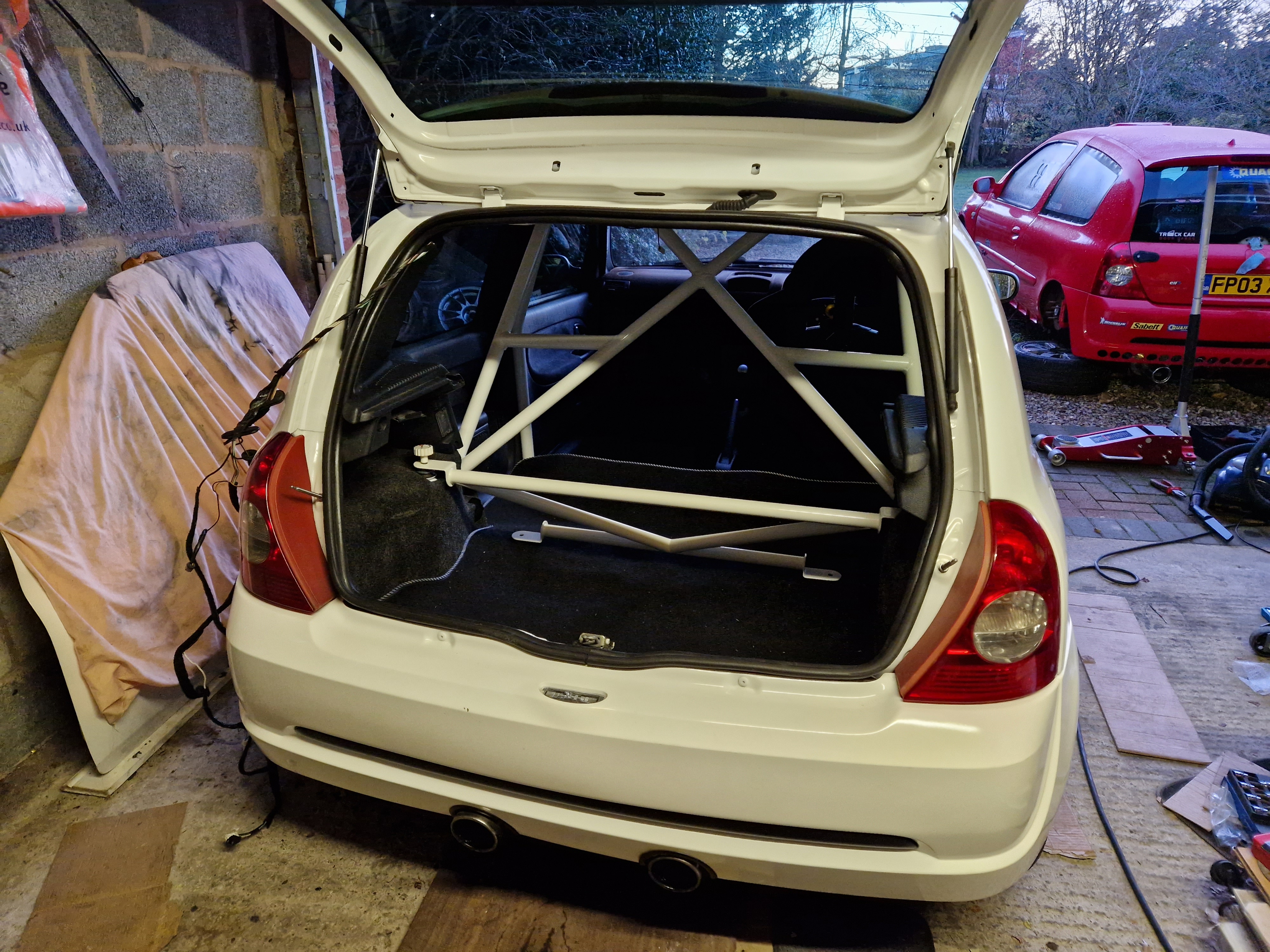

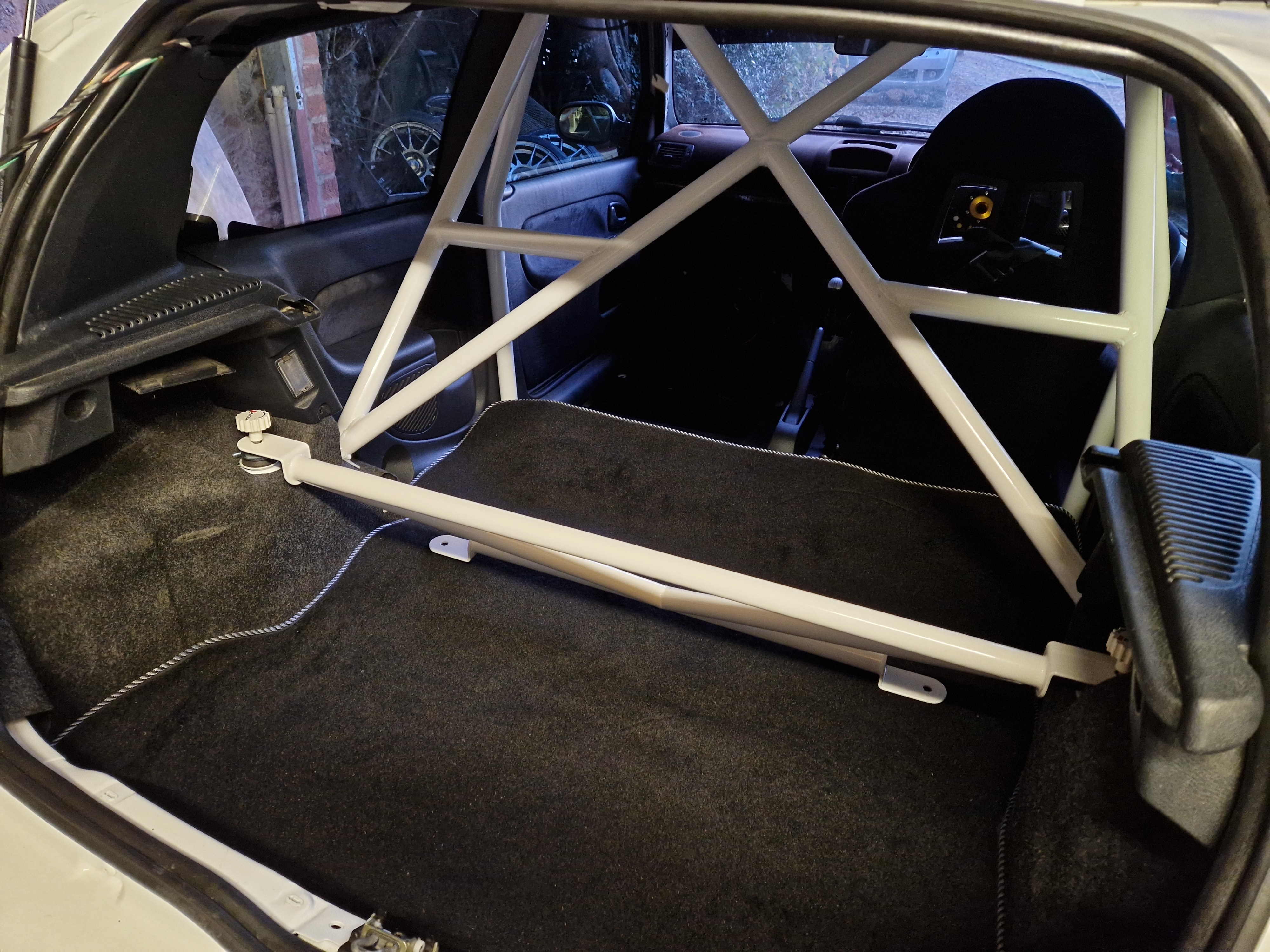

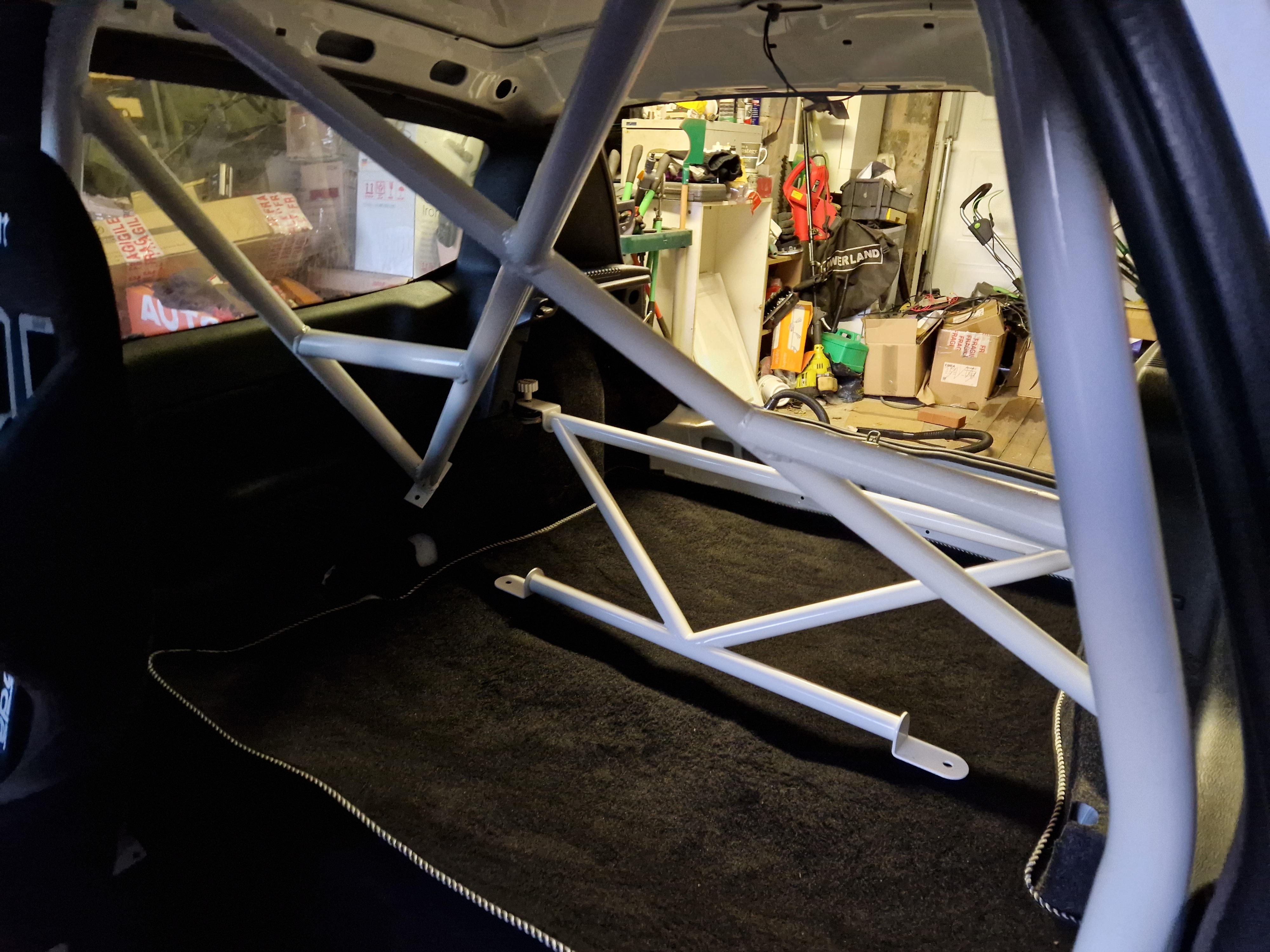

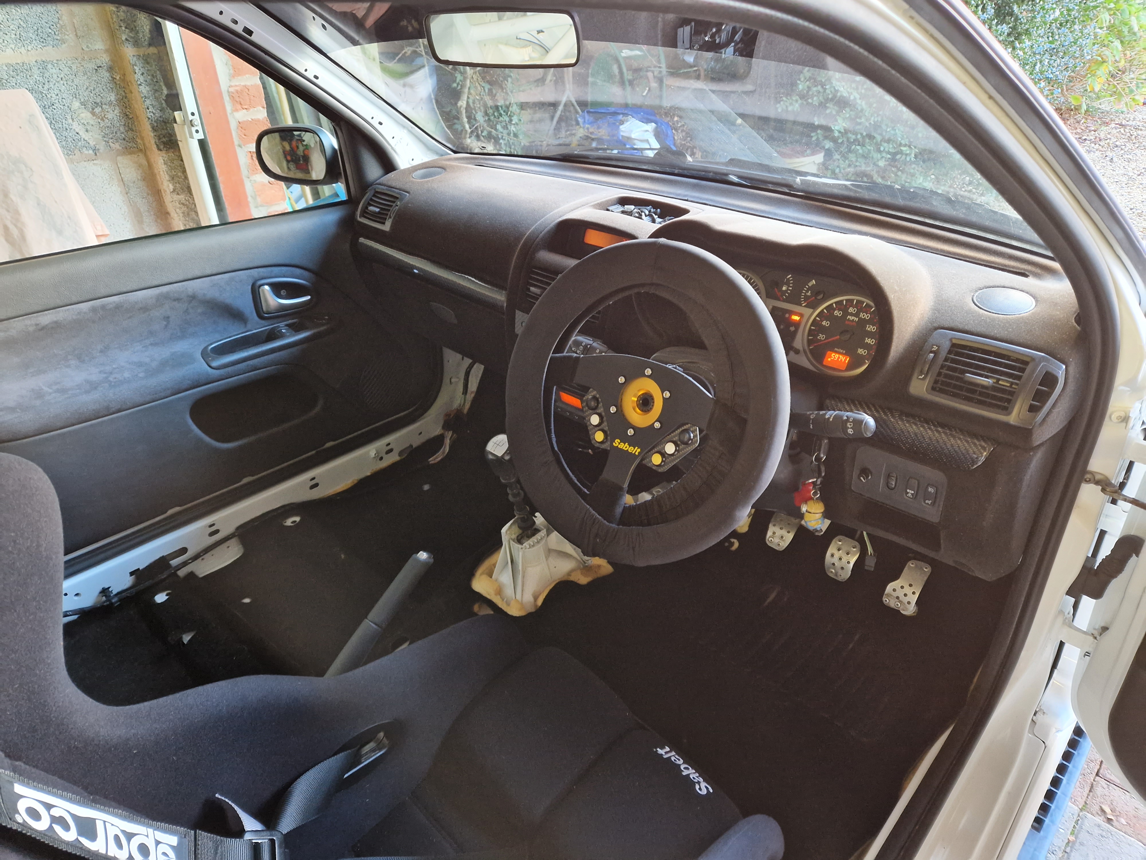

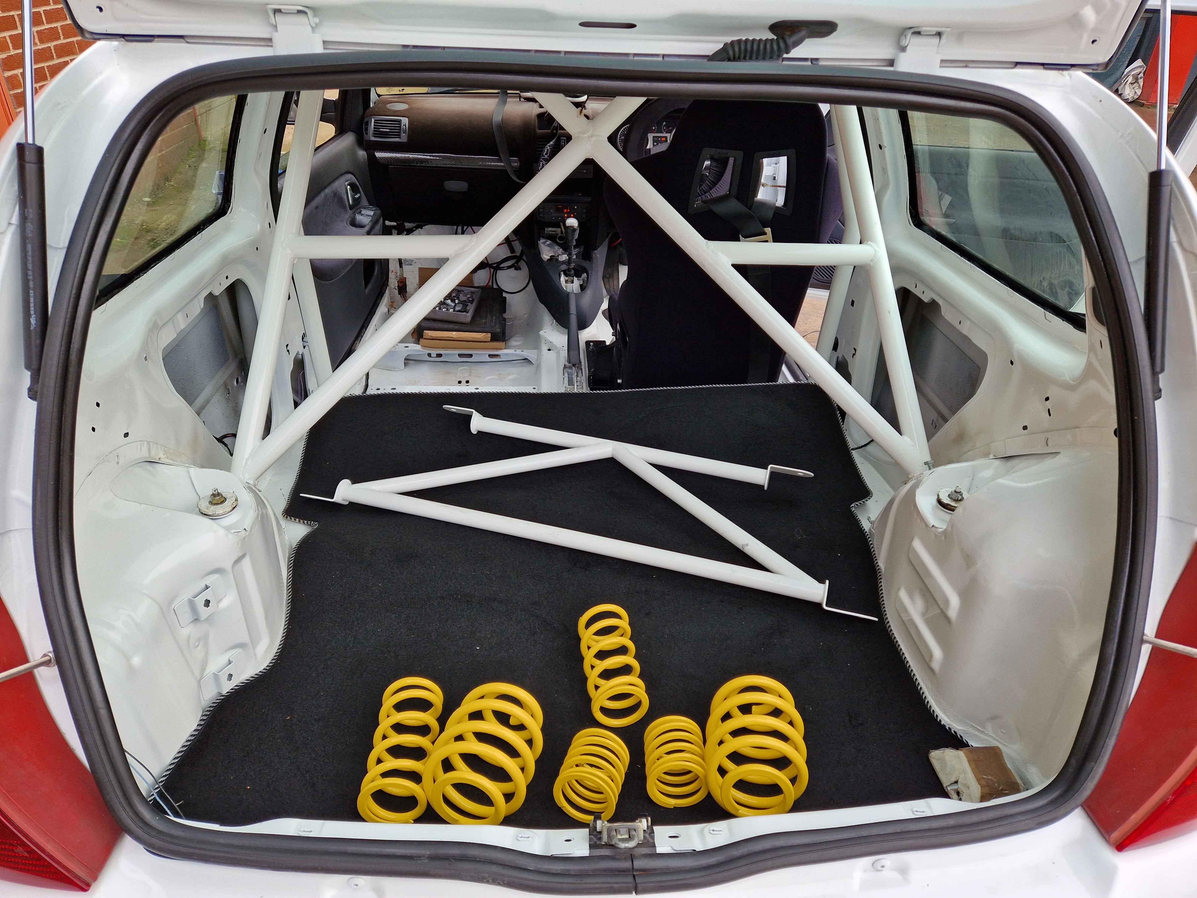

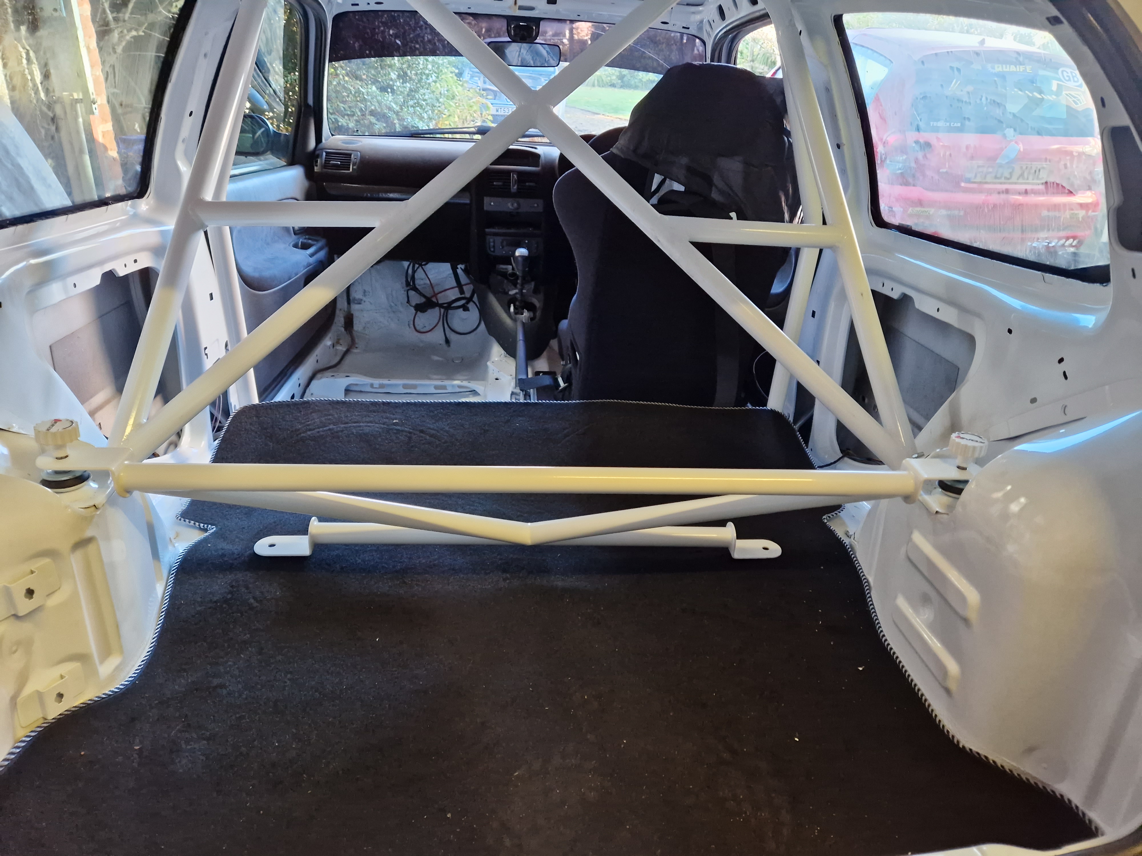

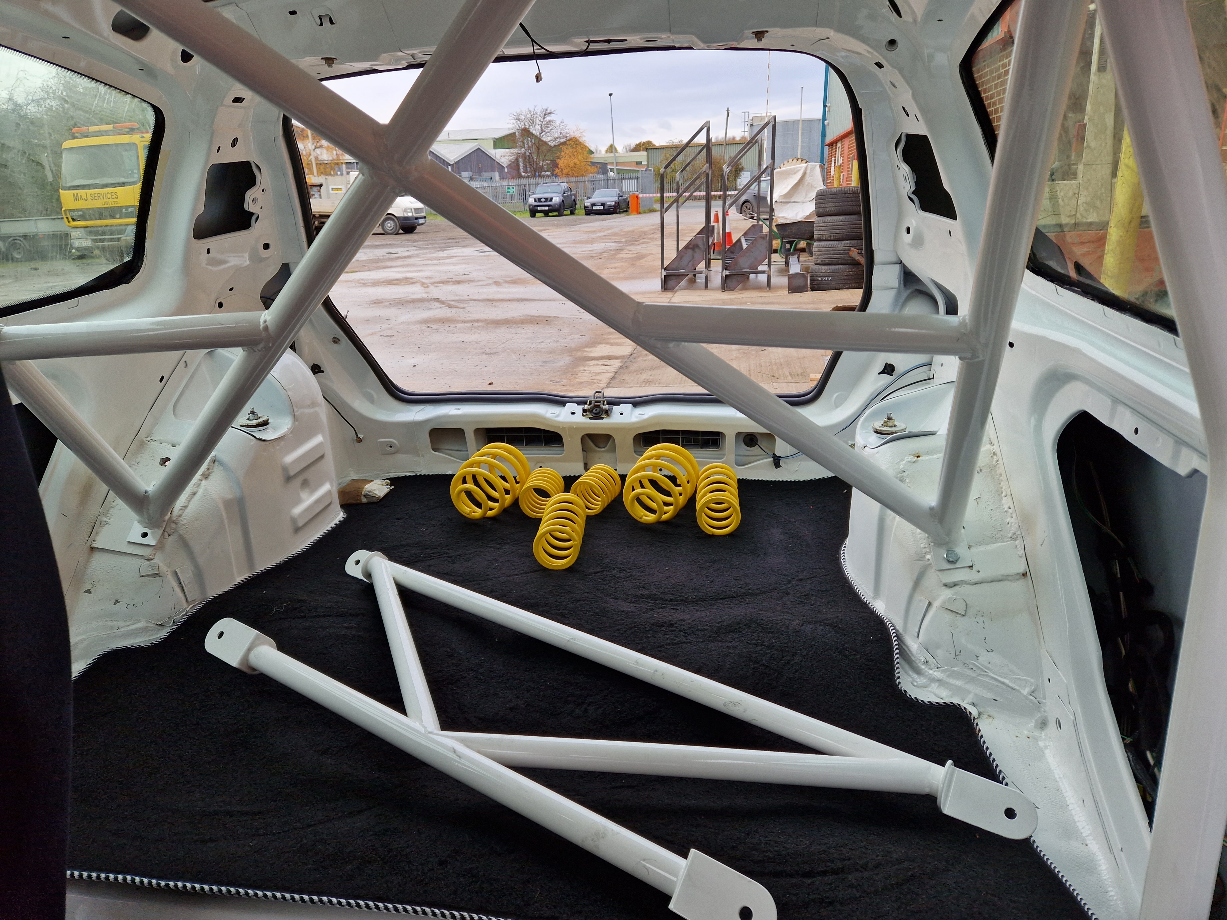

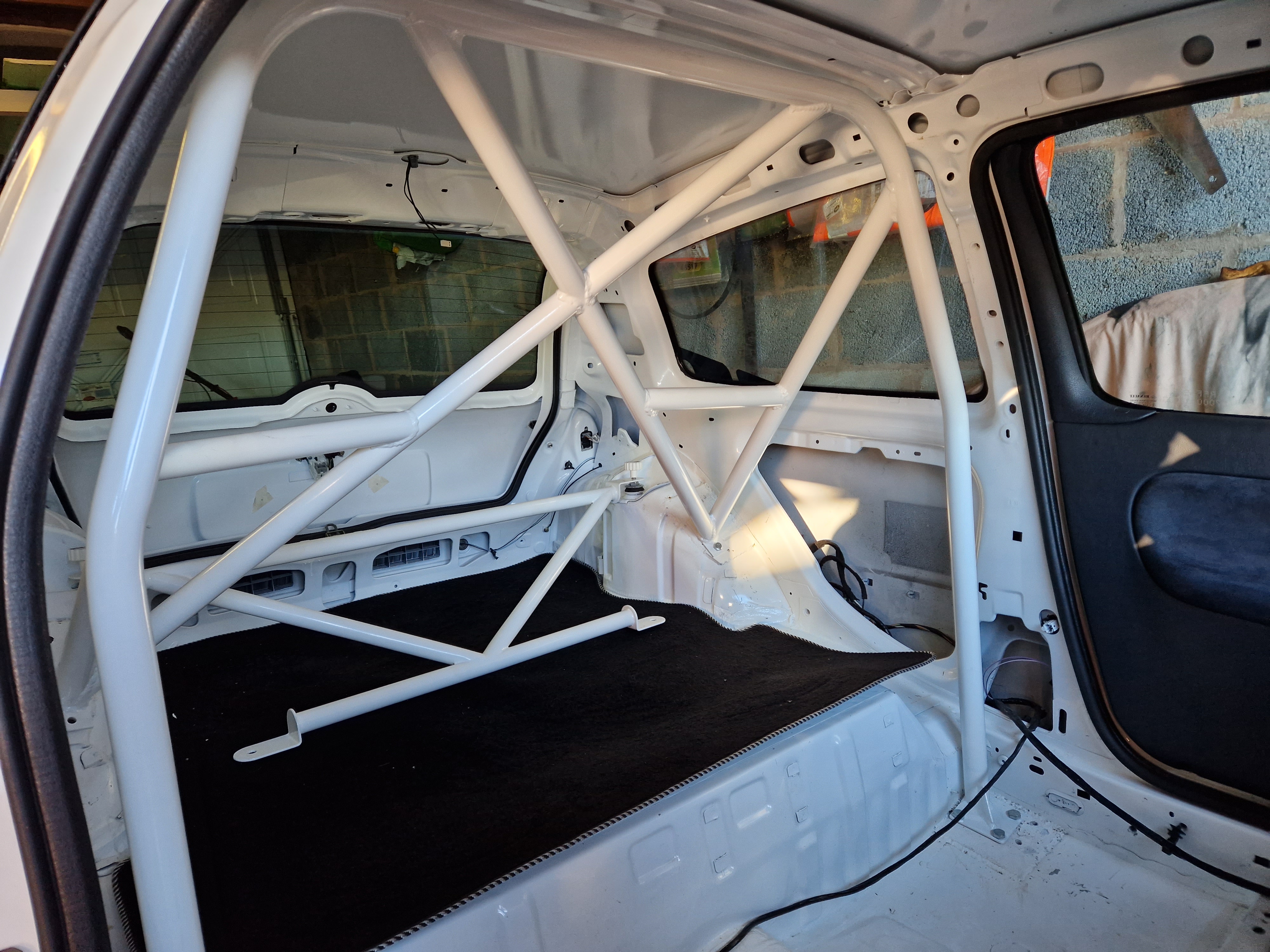

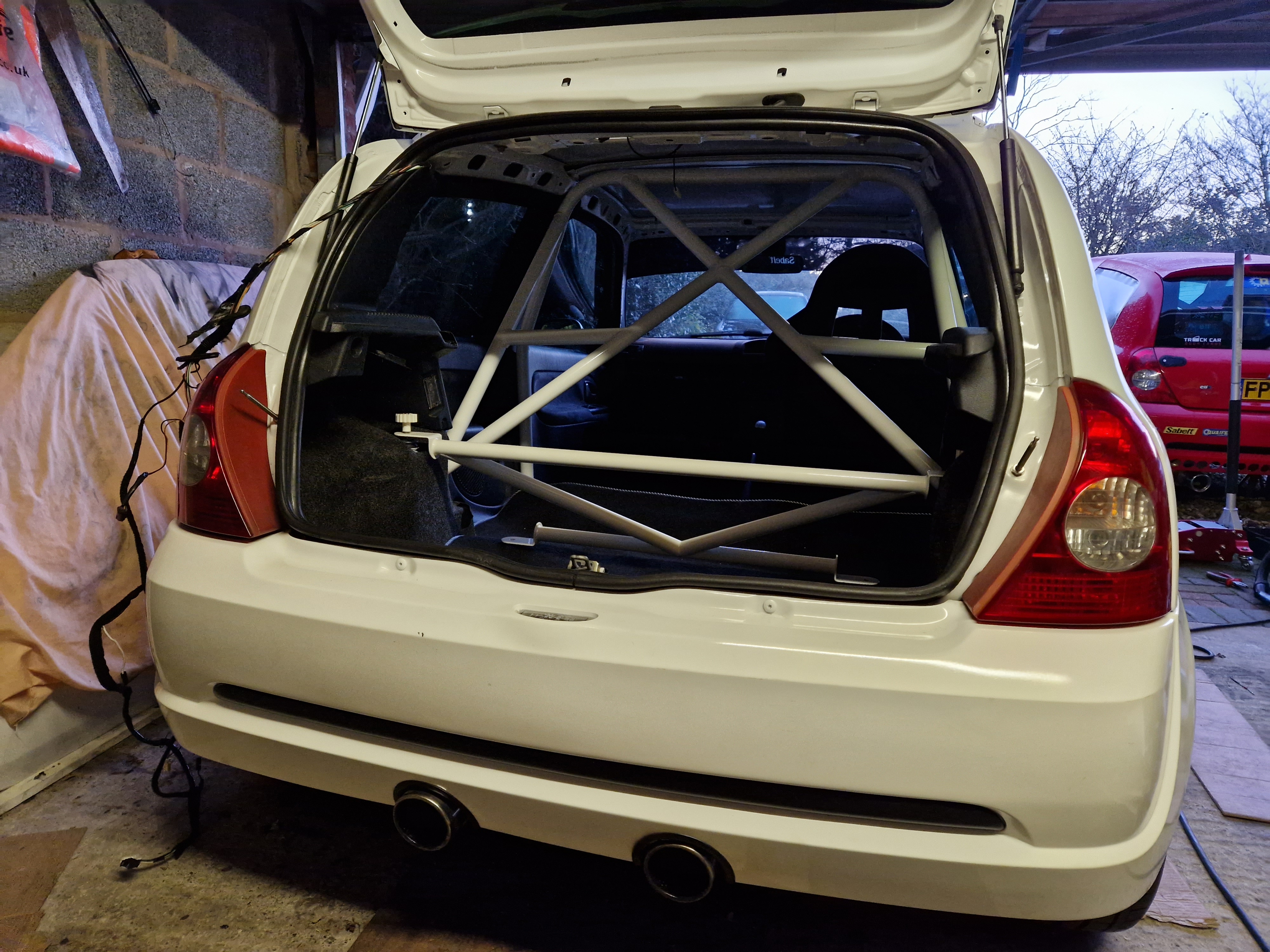

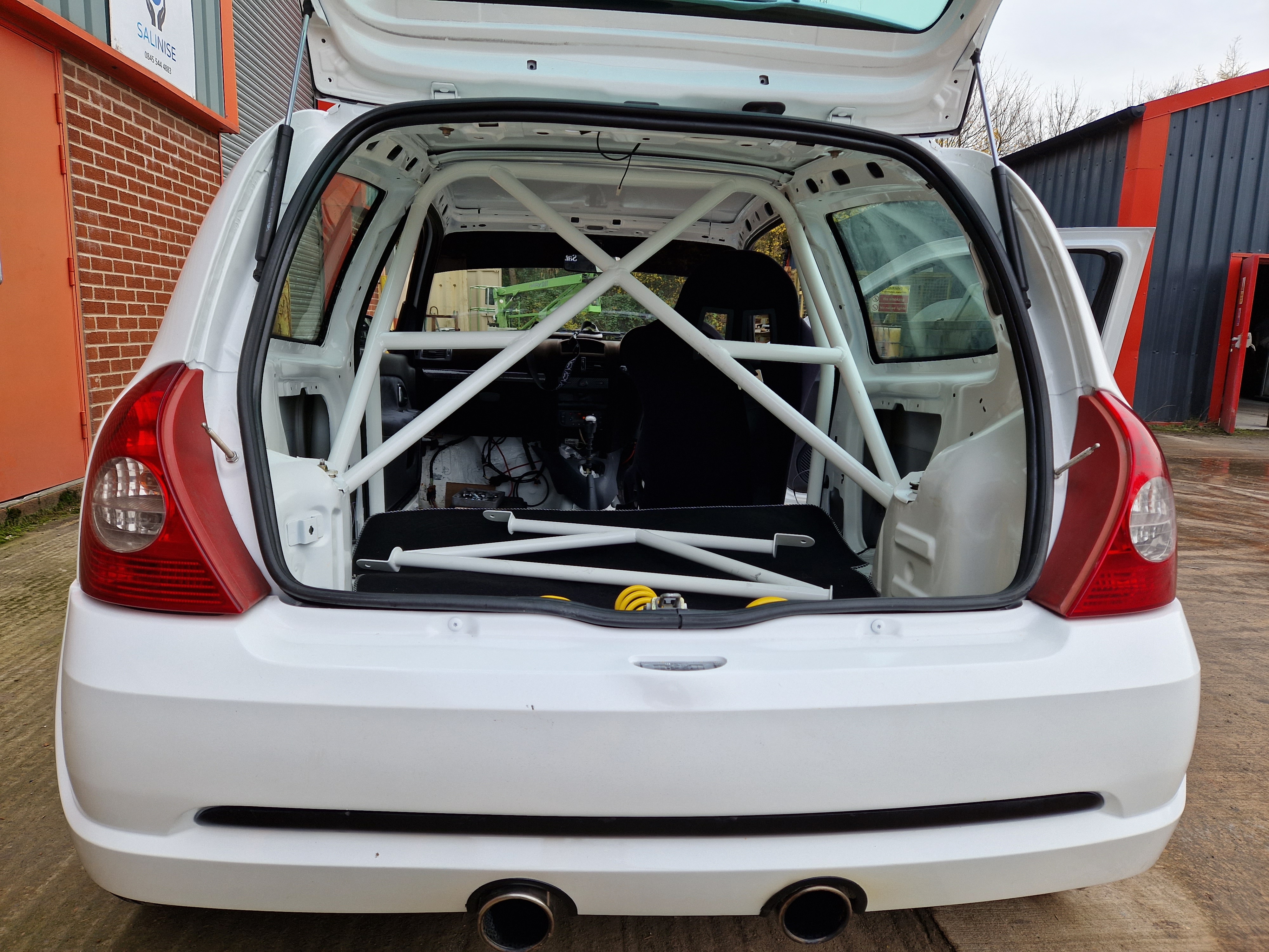

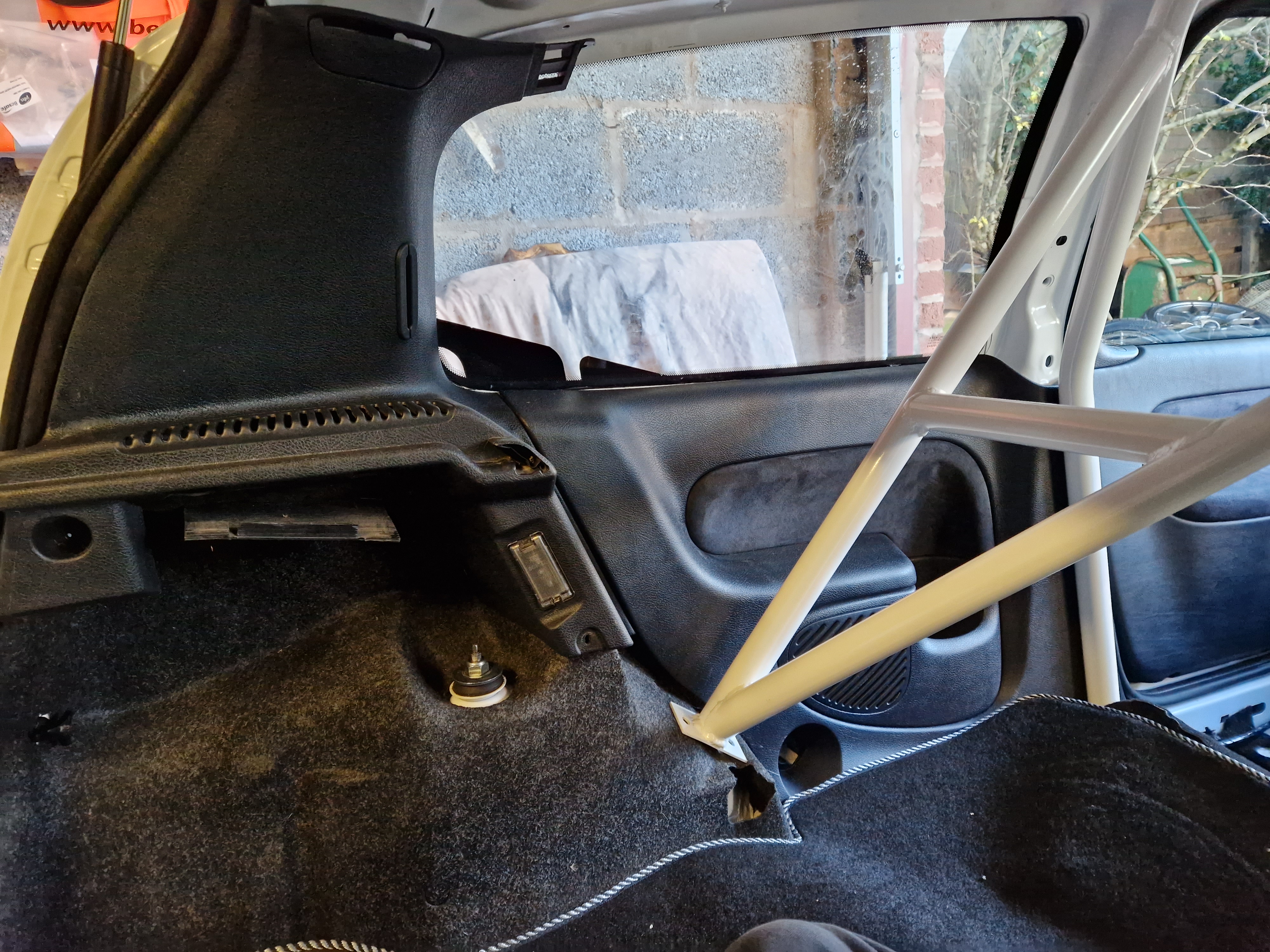

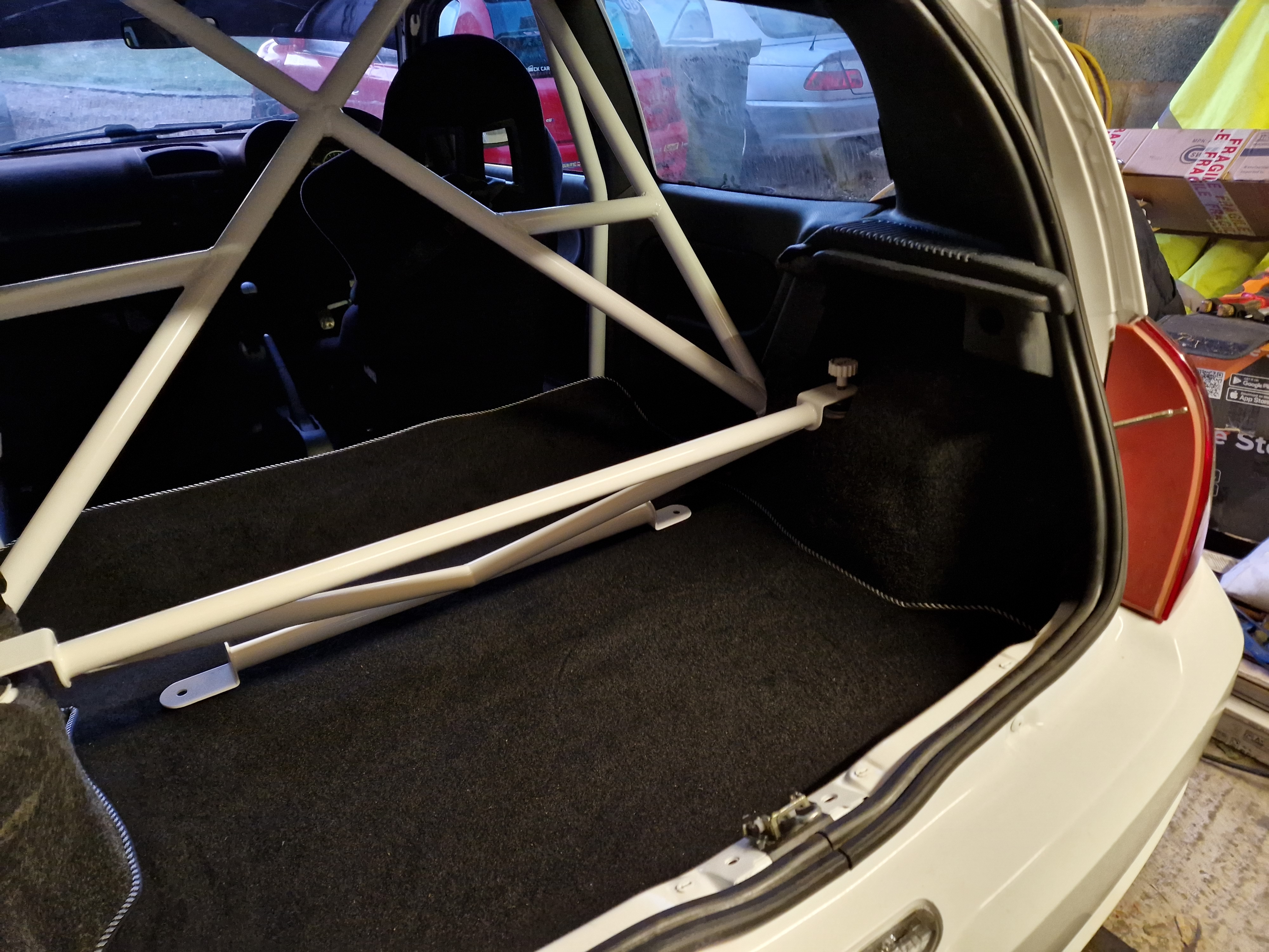

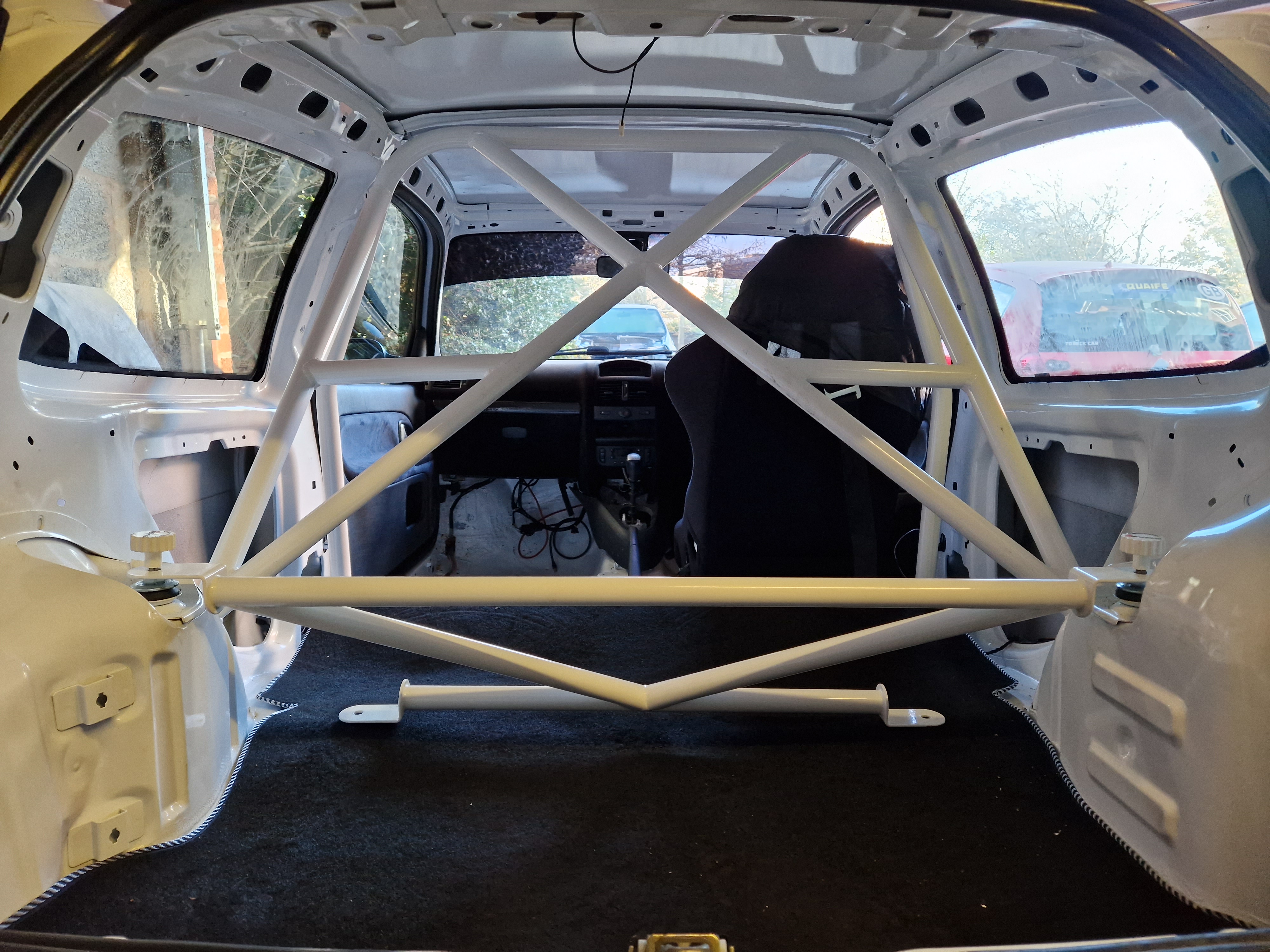

Picked up my roll cage this afternoon from powder coat along with my springs and k brace !
Only temp fitted in to get back home, had to remove seat and will to get back in but not too bad !
Decided on white for the cage in the end.

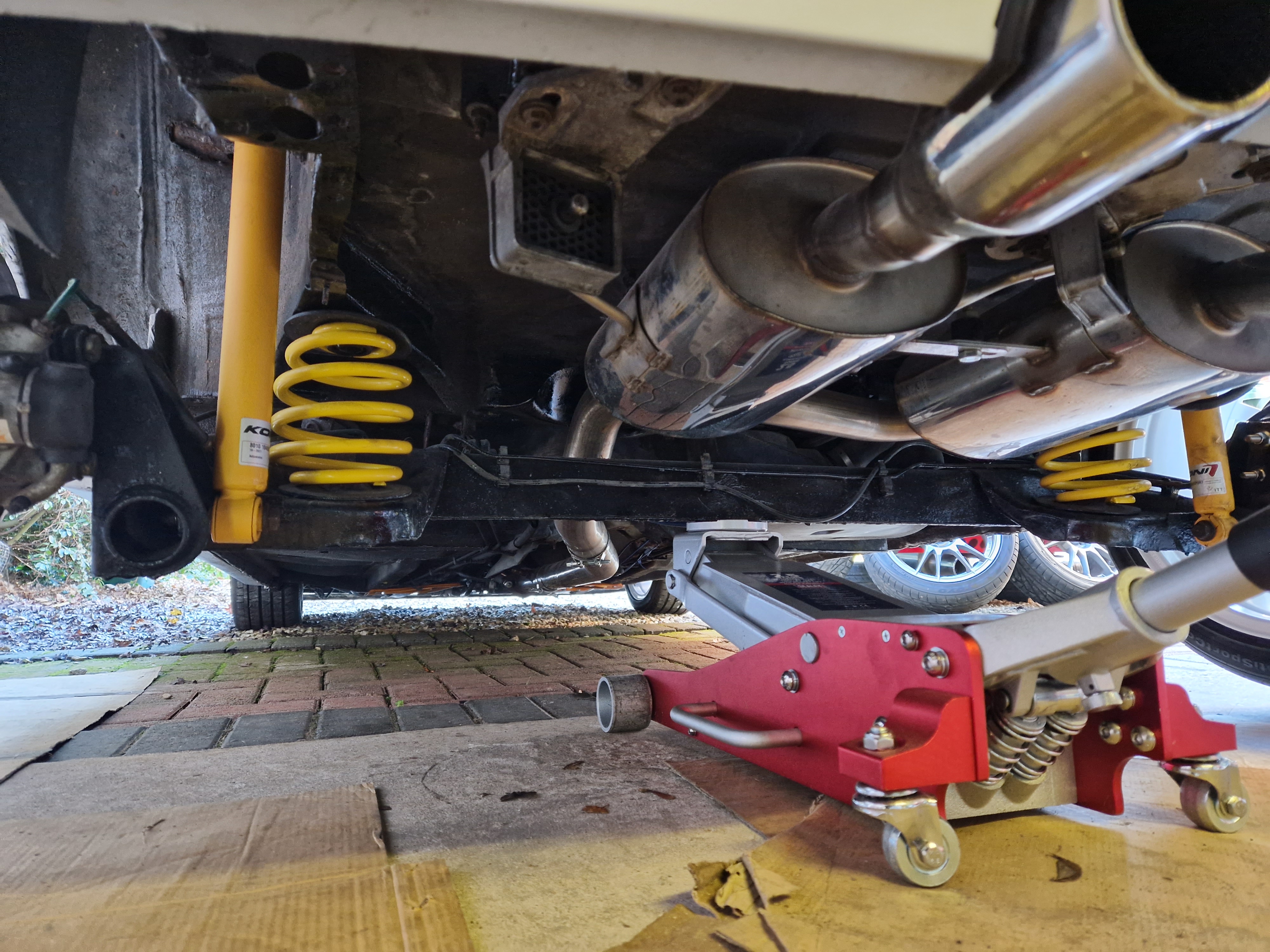

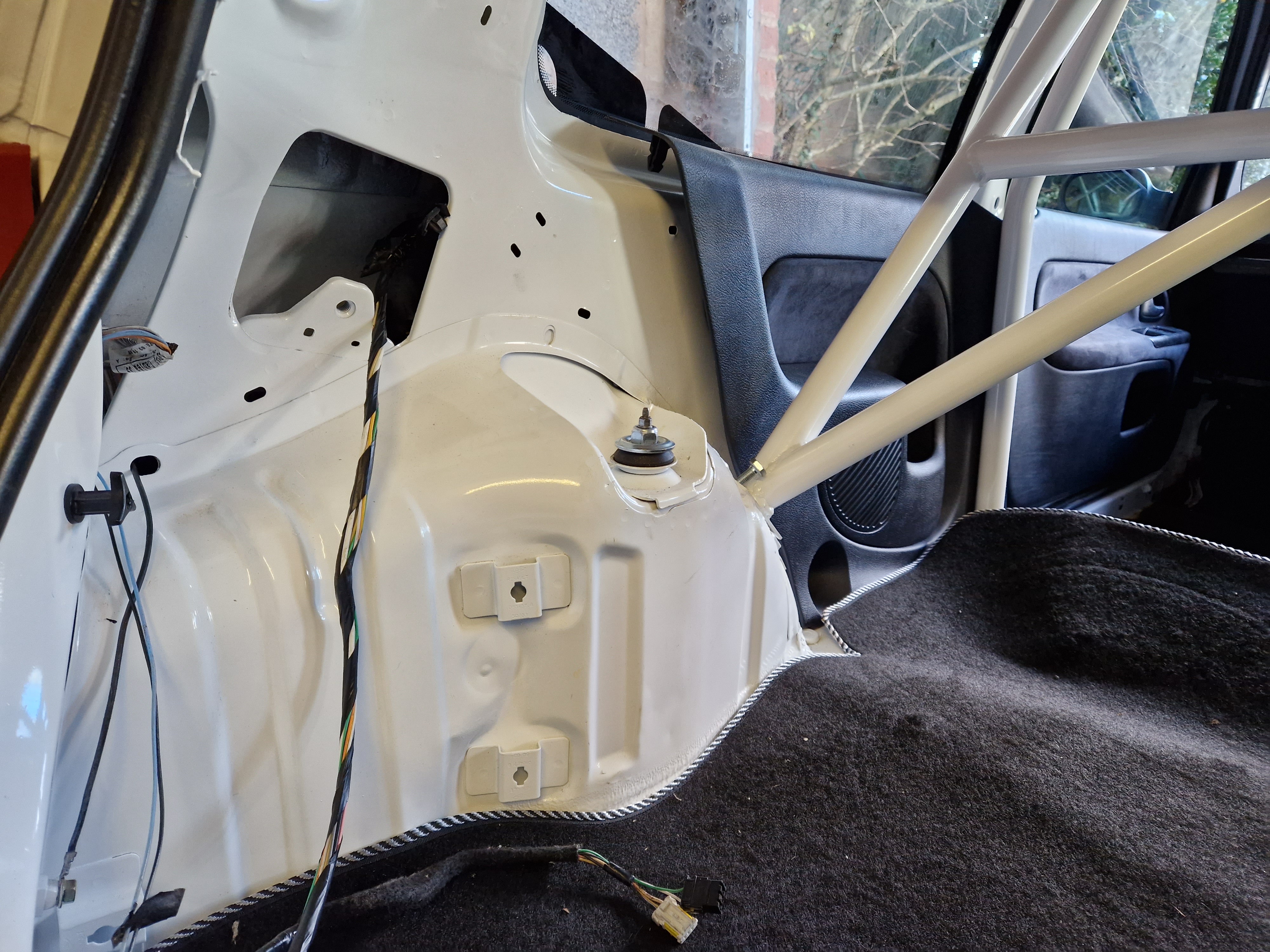

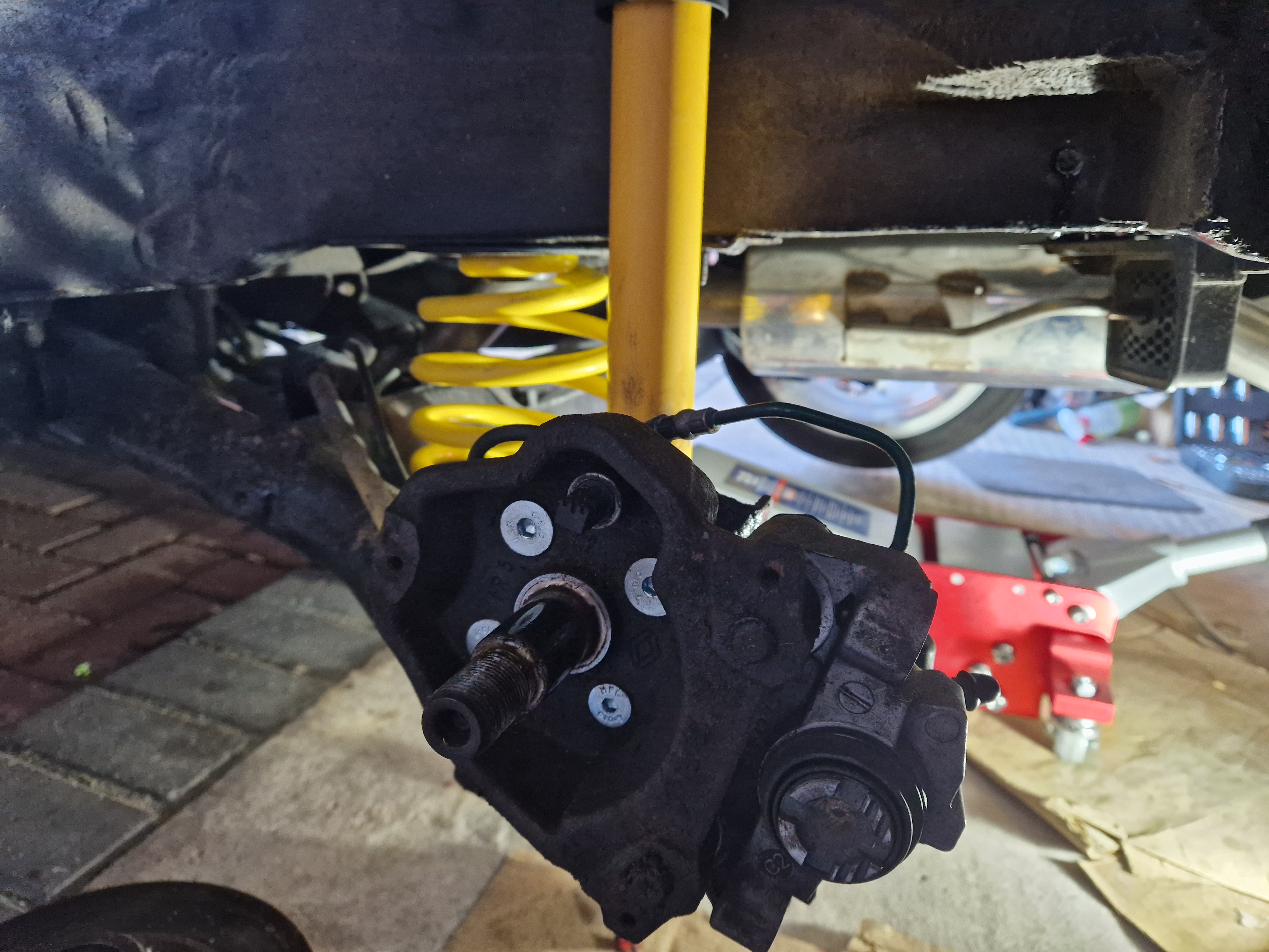

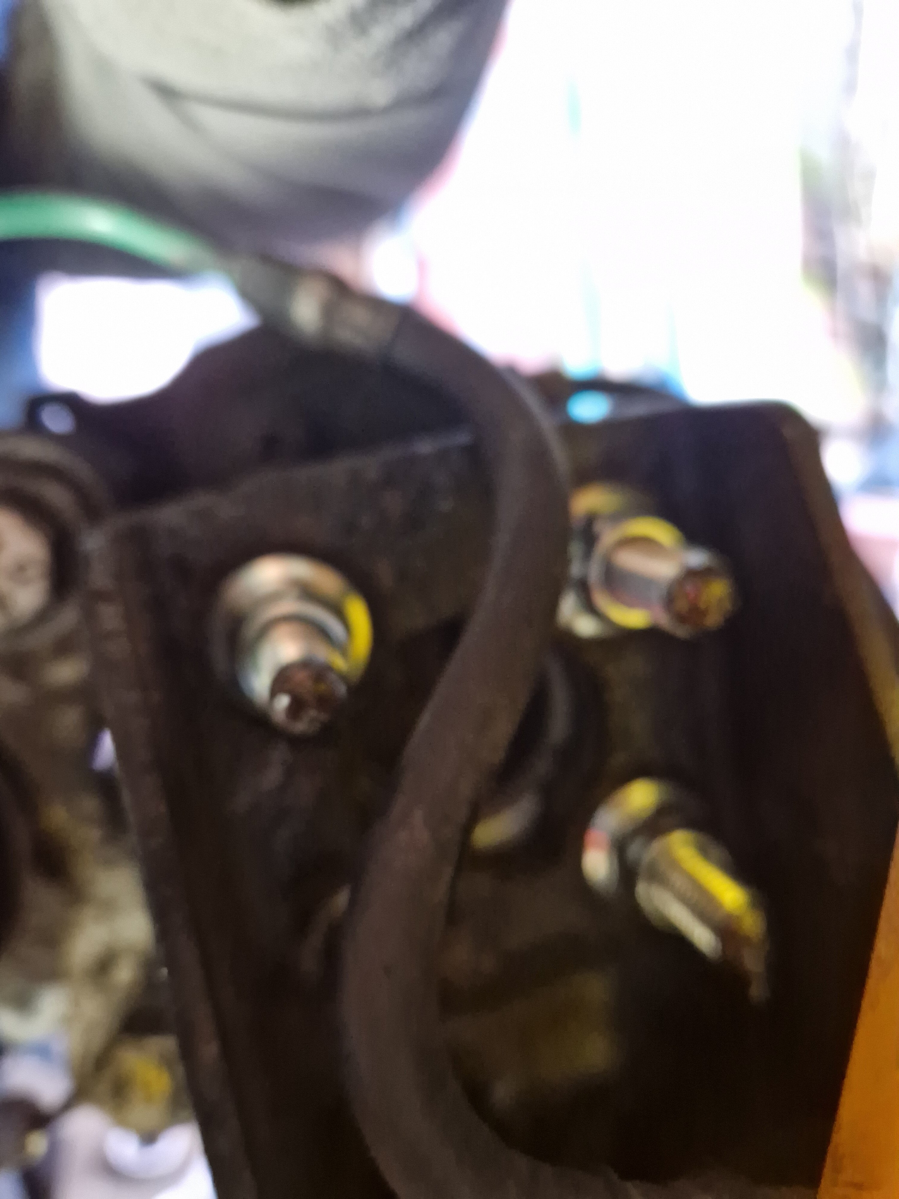

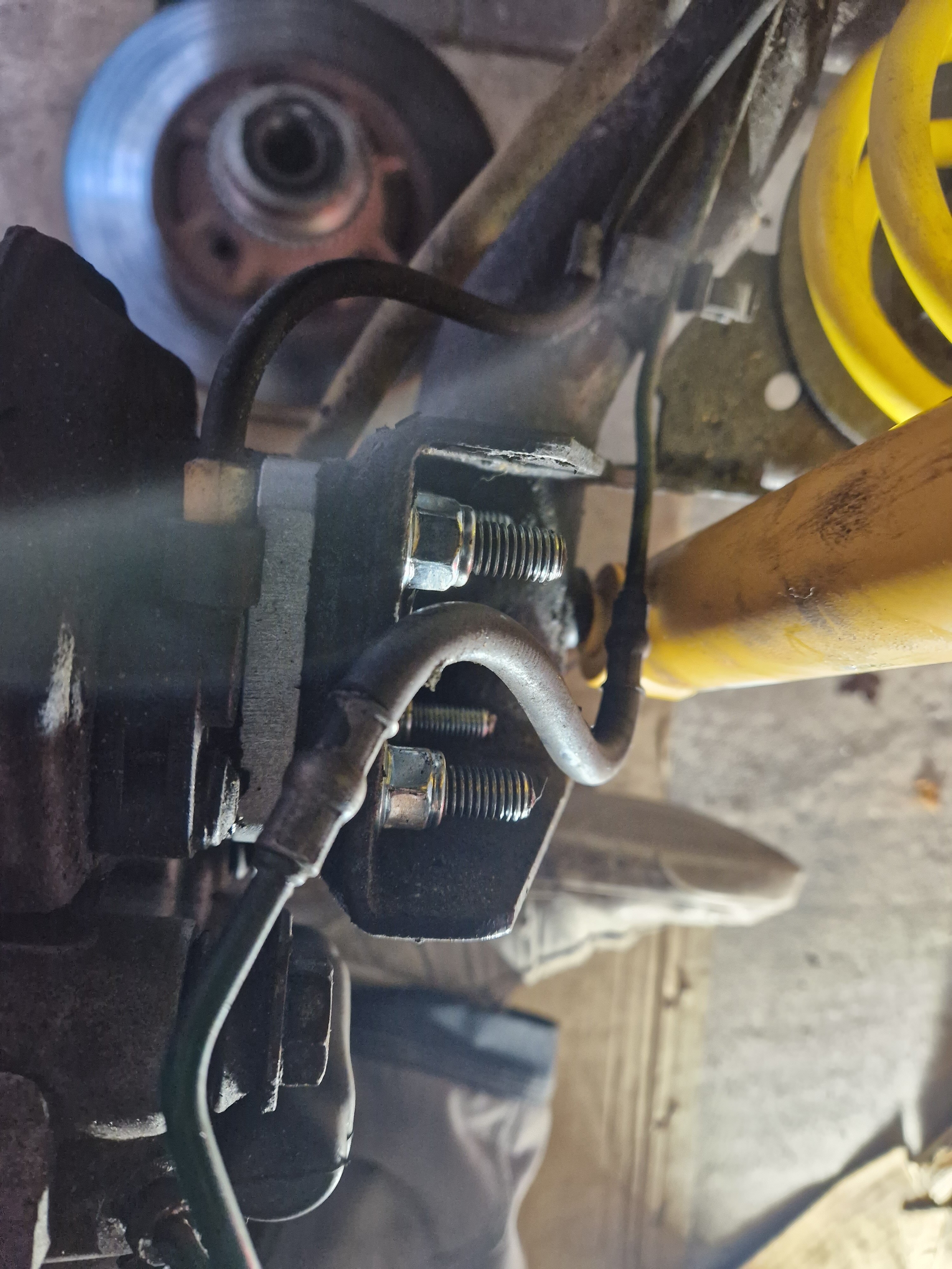

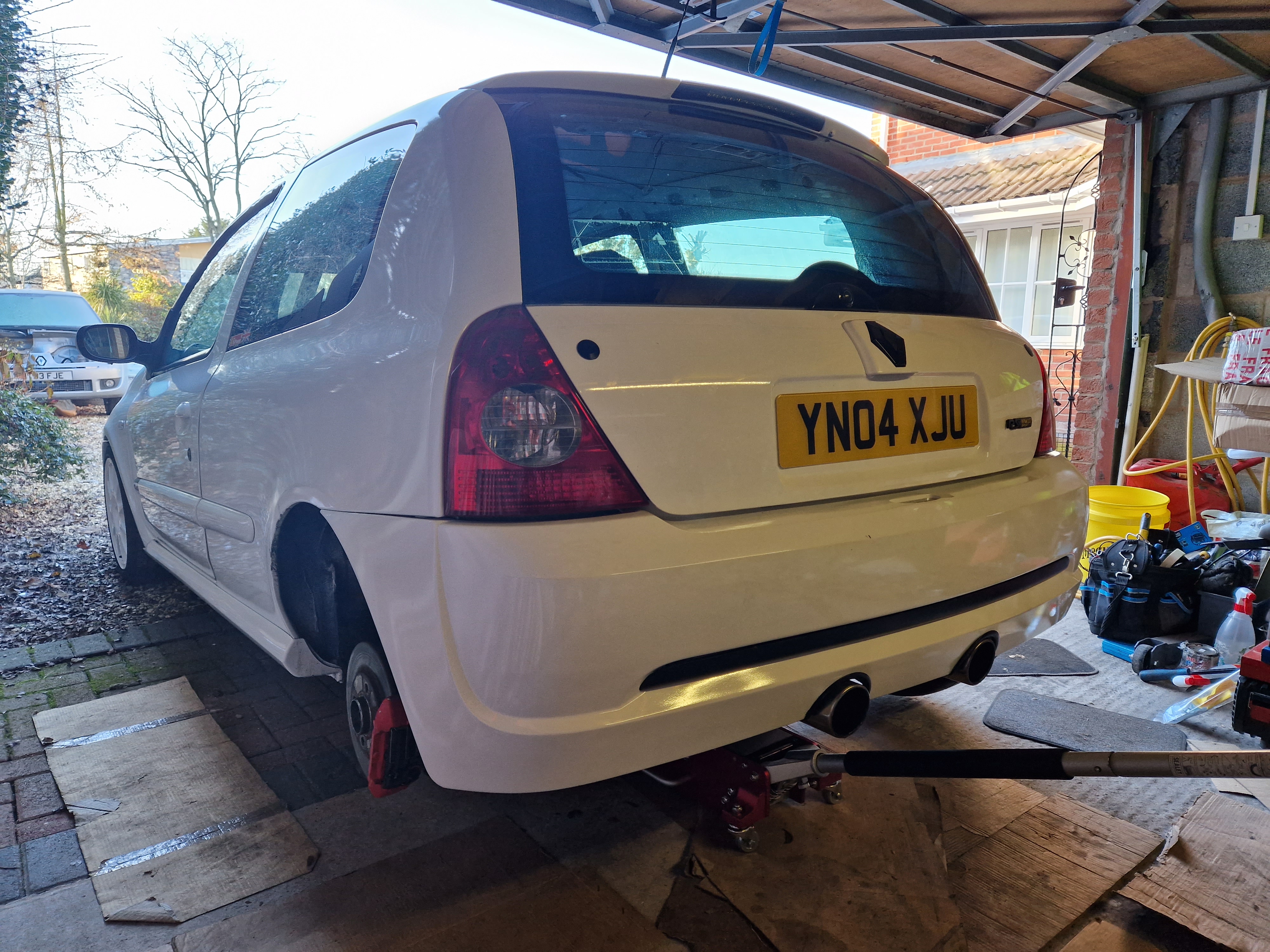

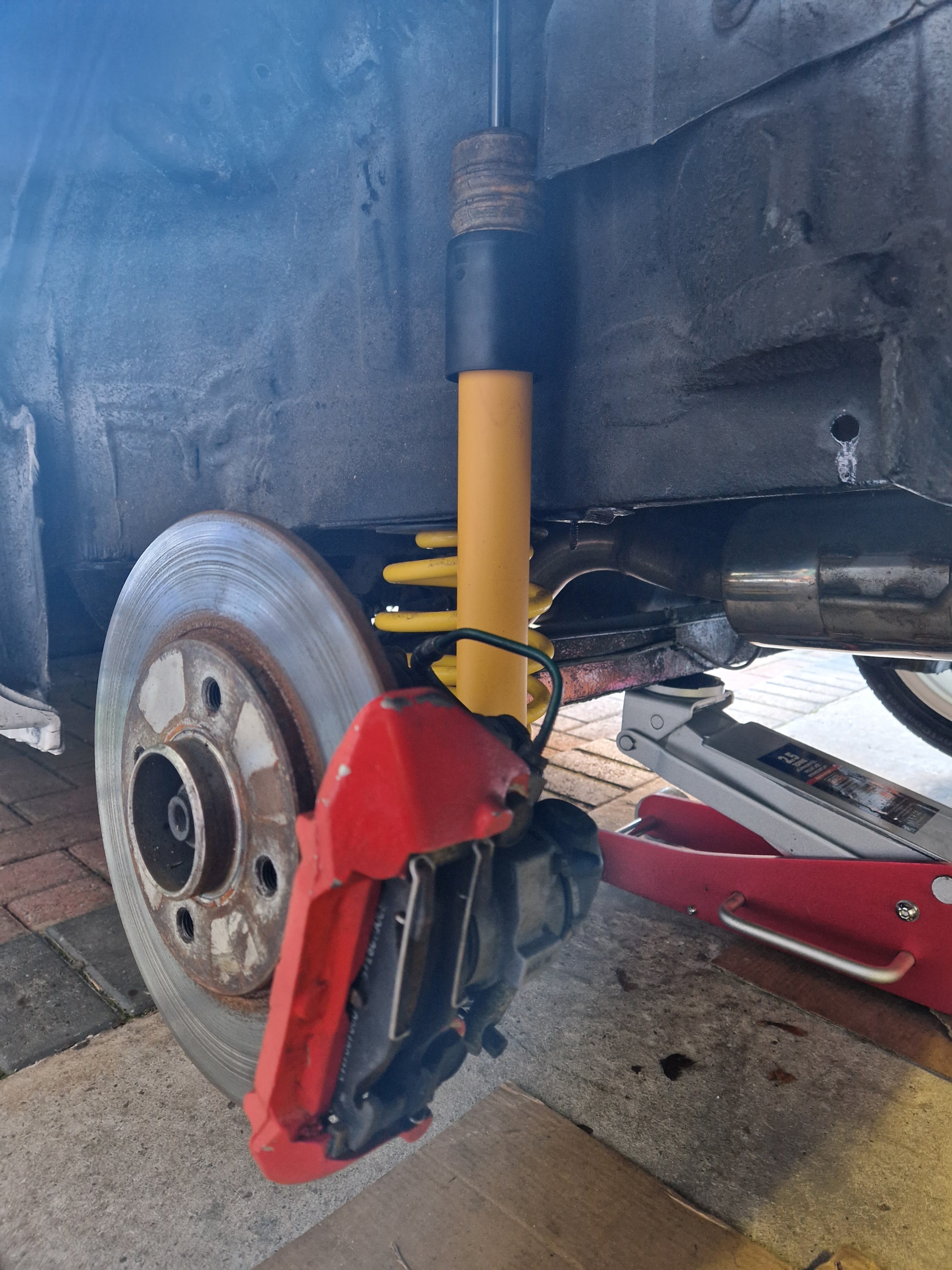

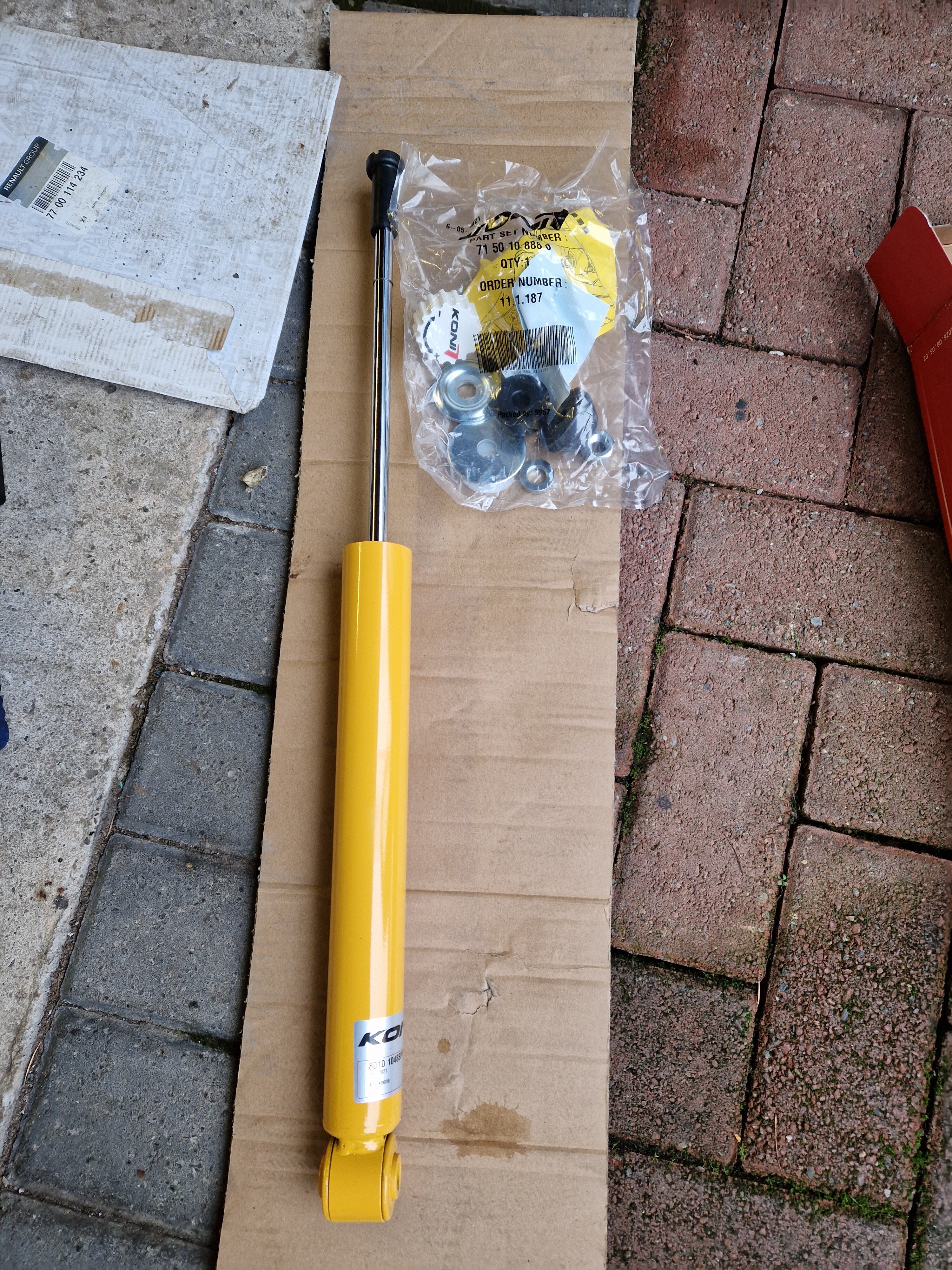

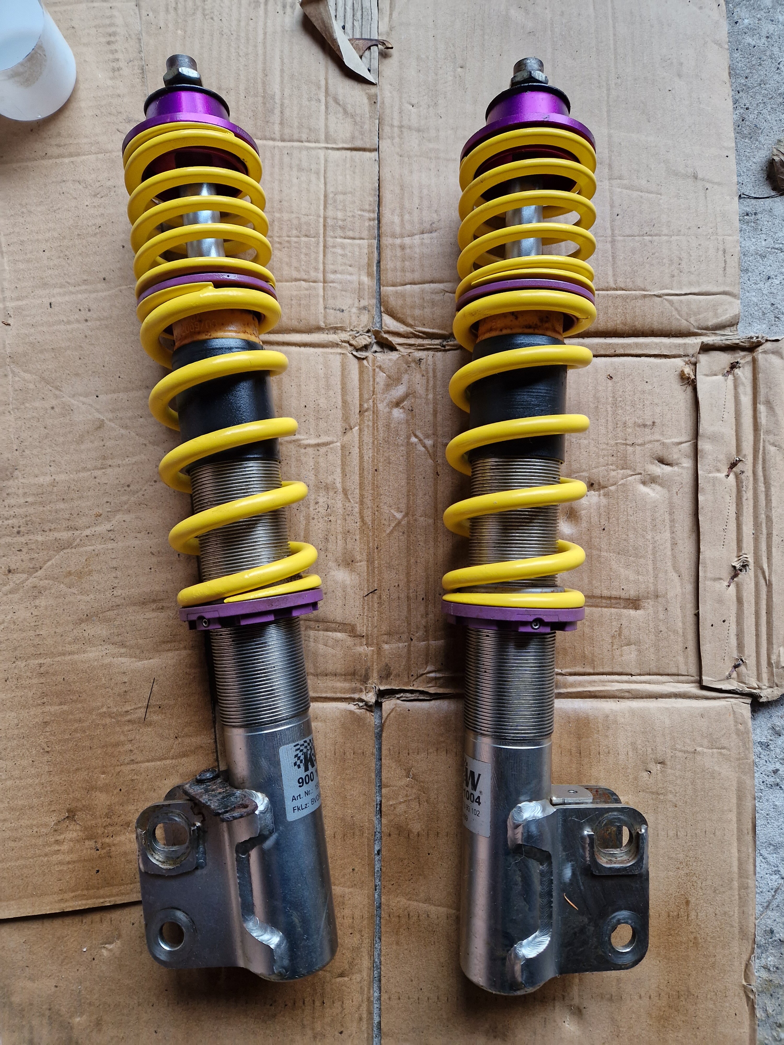

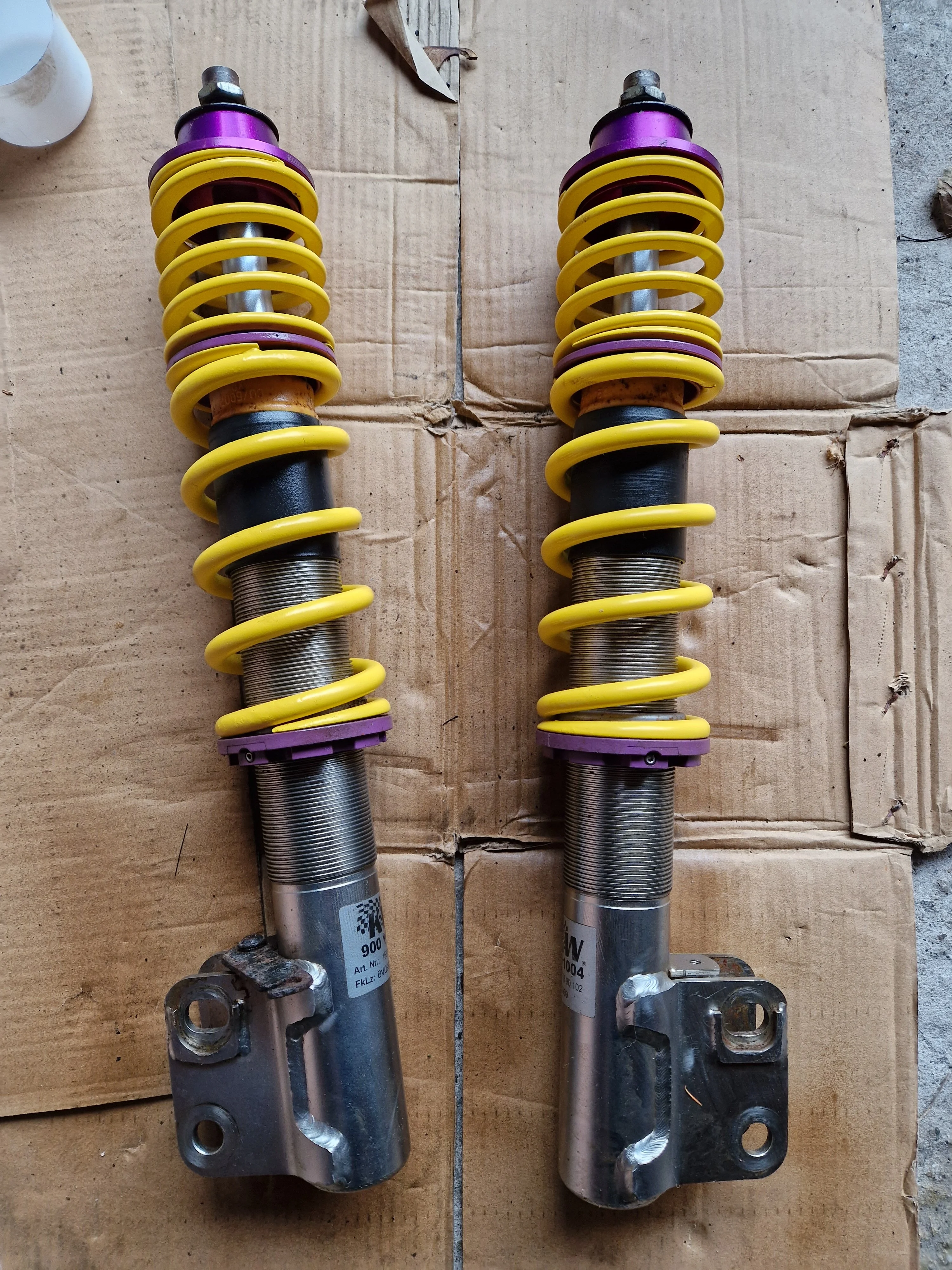

Started on rebuilding my suspension. I have new koni rear as one of my KW rears adjusters had seized.
Struggled with the koni rears fitments and the topmounts. It was dark and couldn't see the thread when the rubbers topmounts are in place. I think it's the lack of weight on the rear end !
The light had gone and so had my head so called it a day. I'm sure tomorrow I will get them nipped up on the rear.

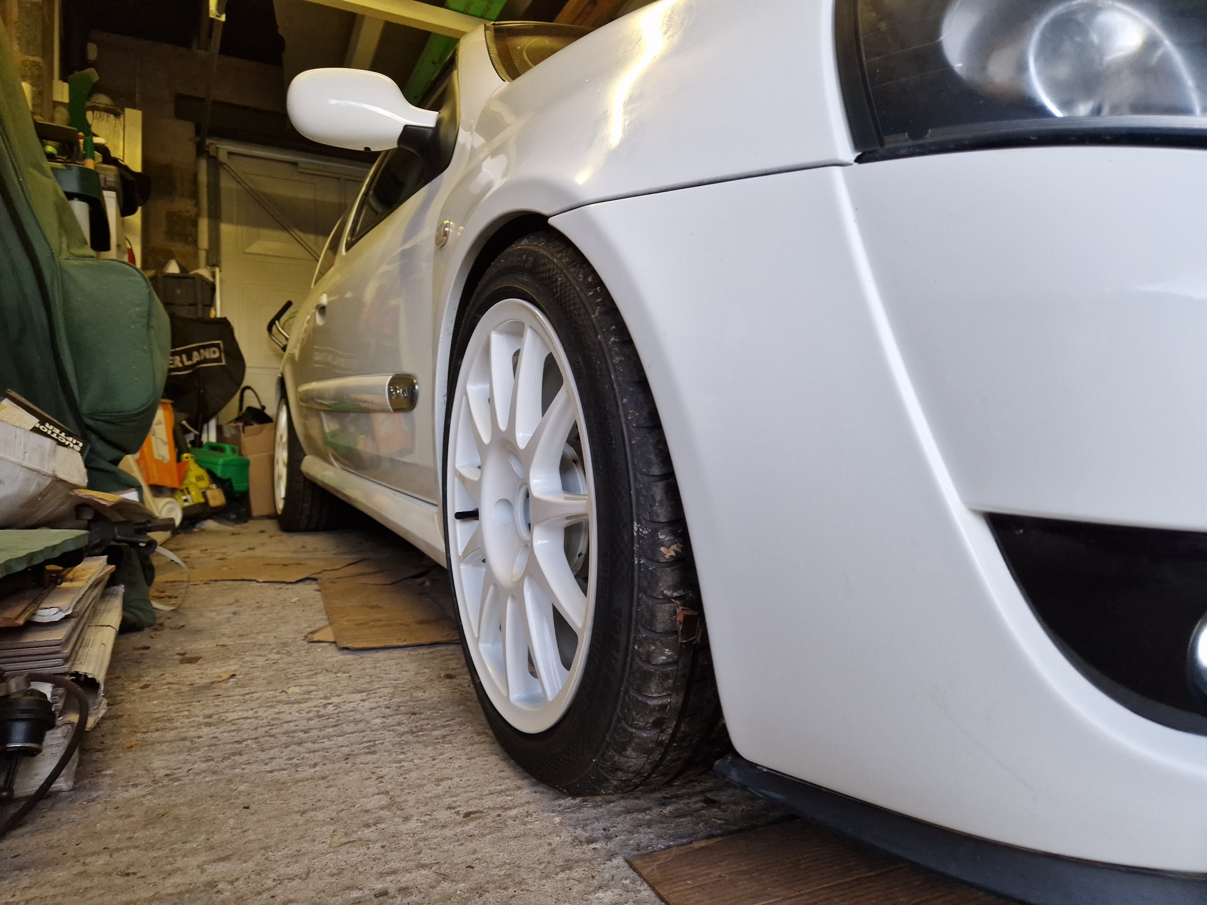

Rear needs to drop abit otherwise thr front needs to come up. Haven't driven it yet so not sure if it will drop much.

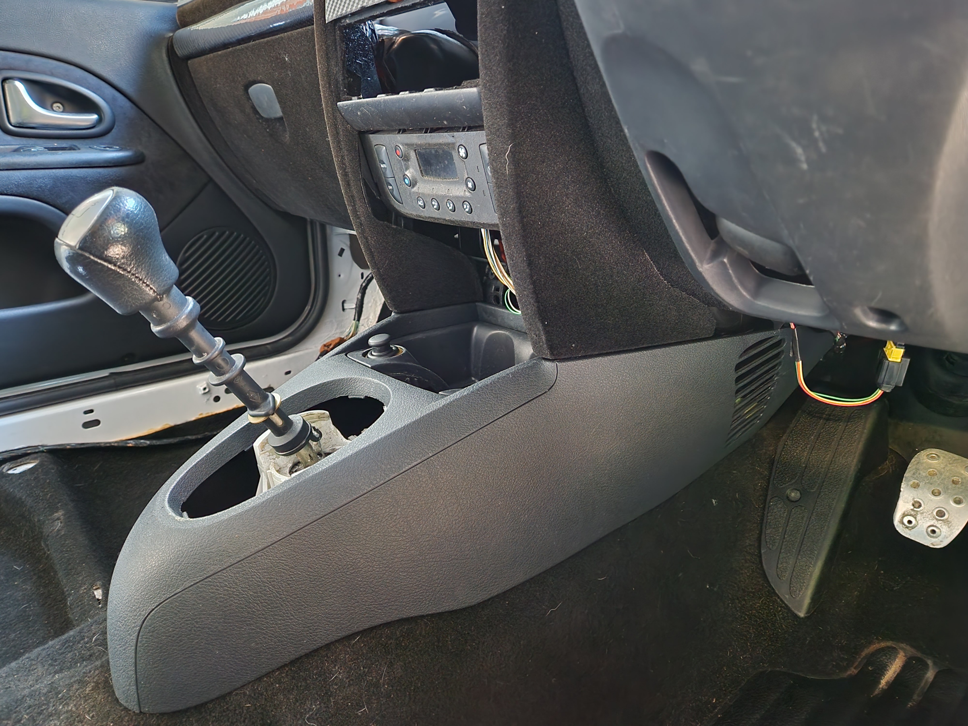

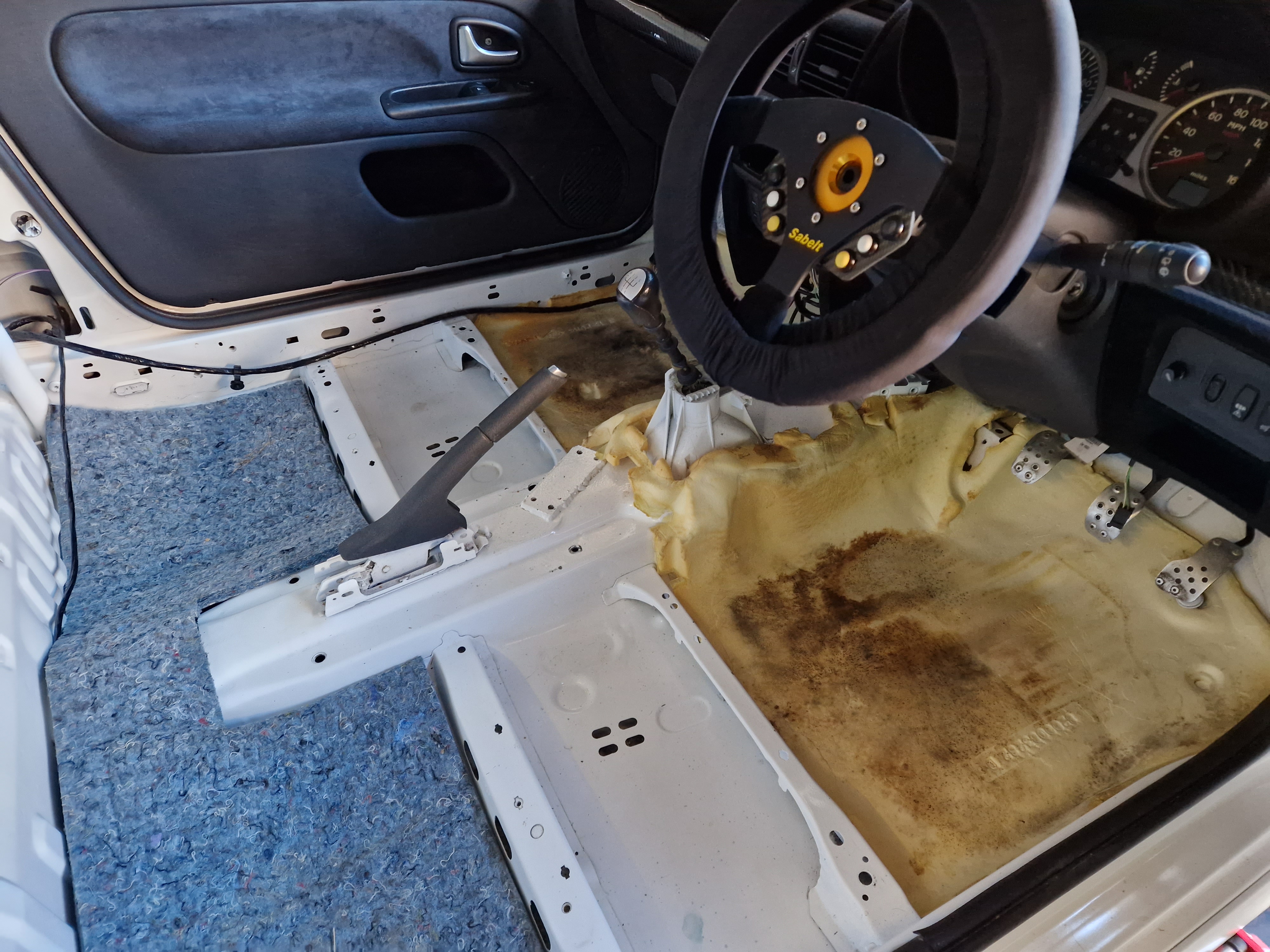

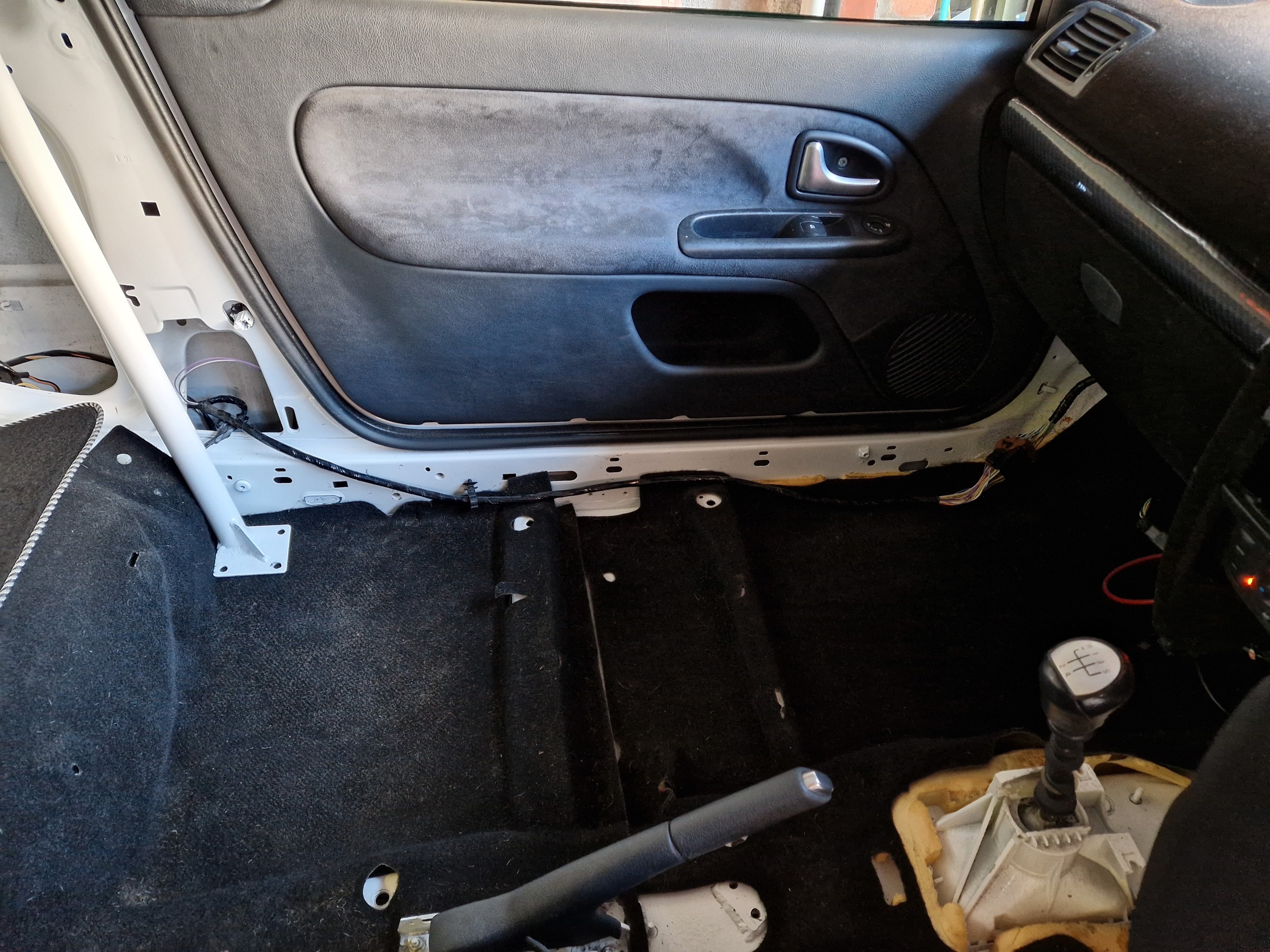

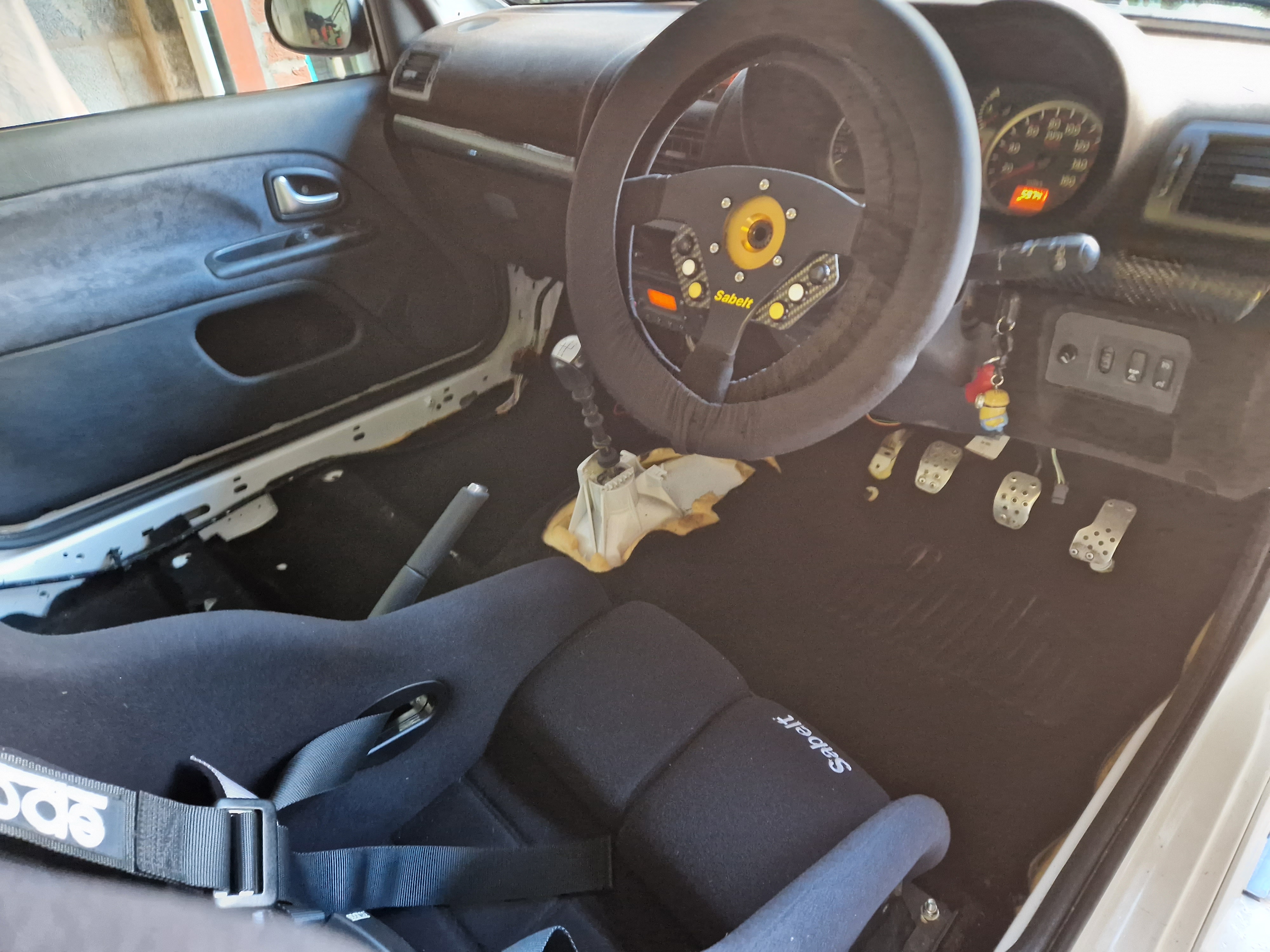

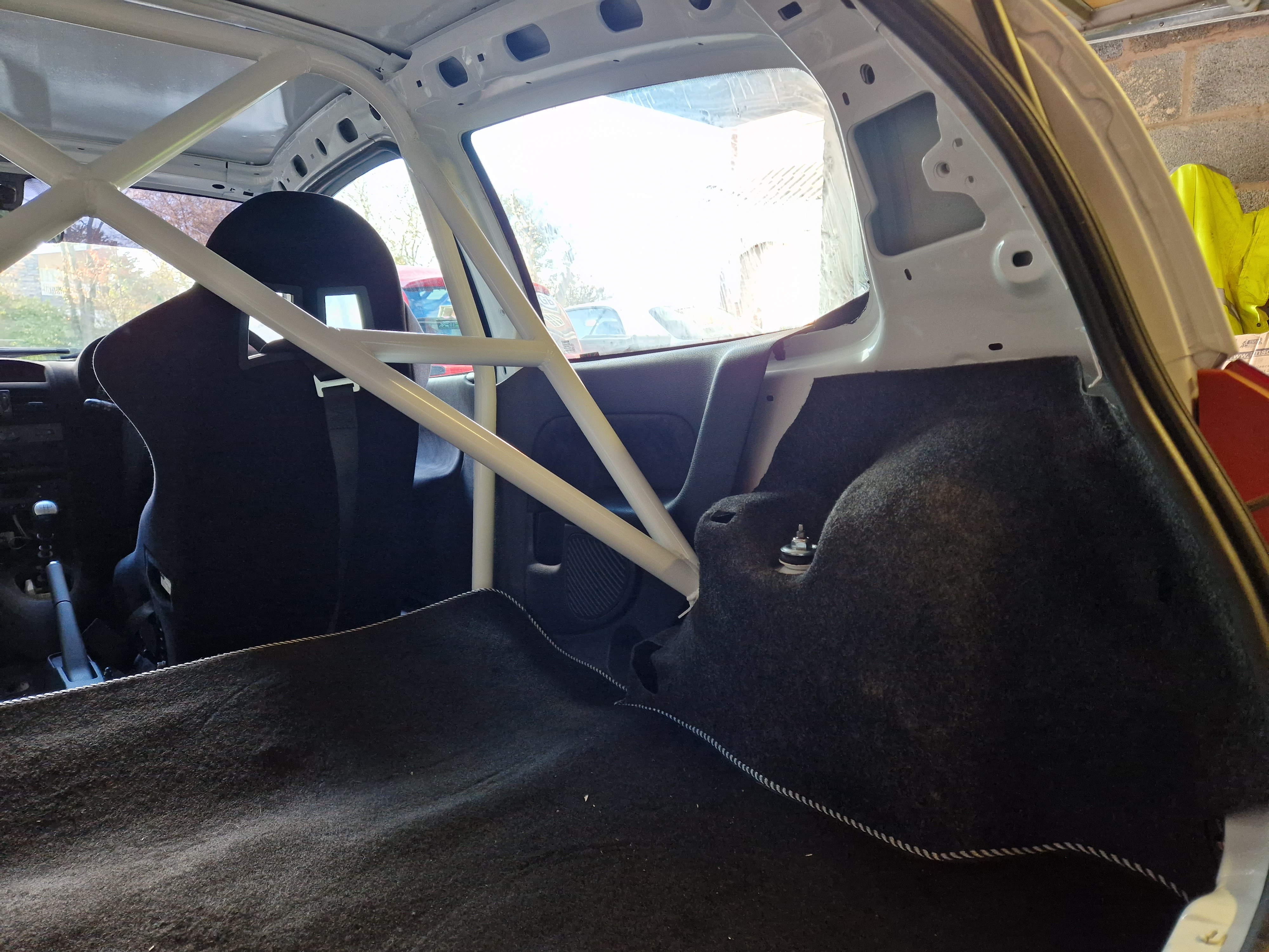

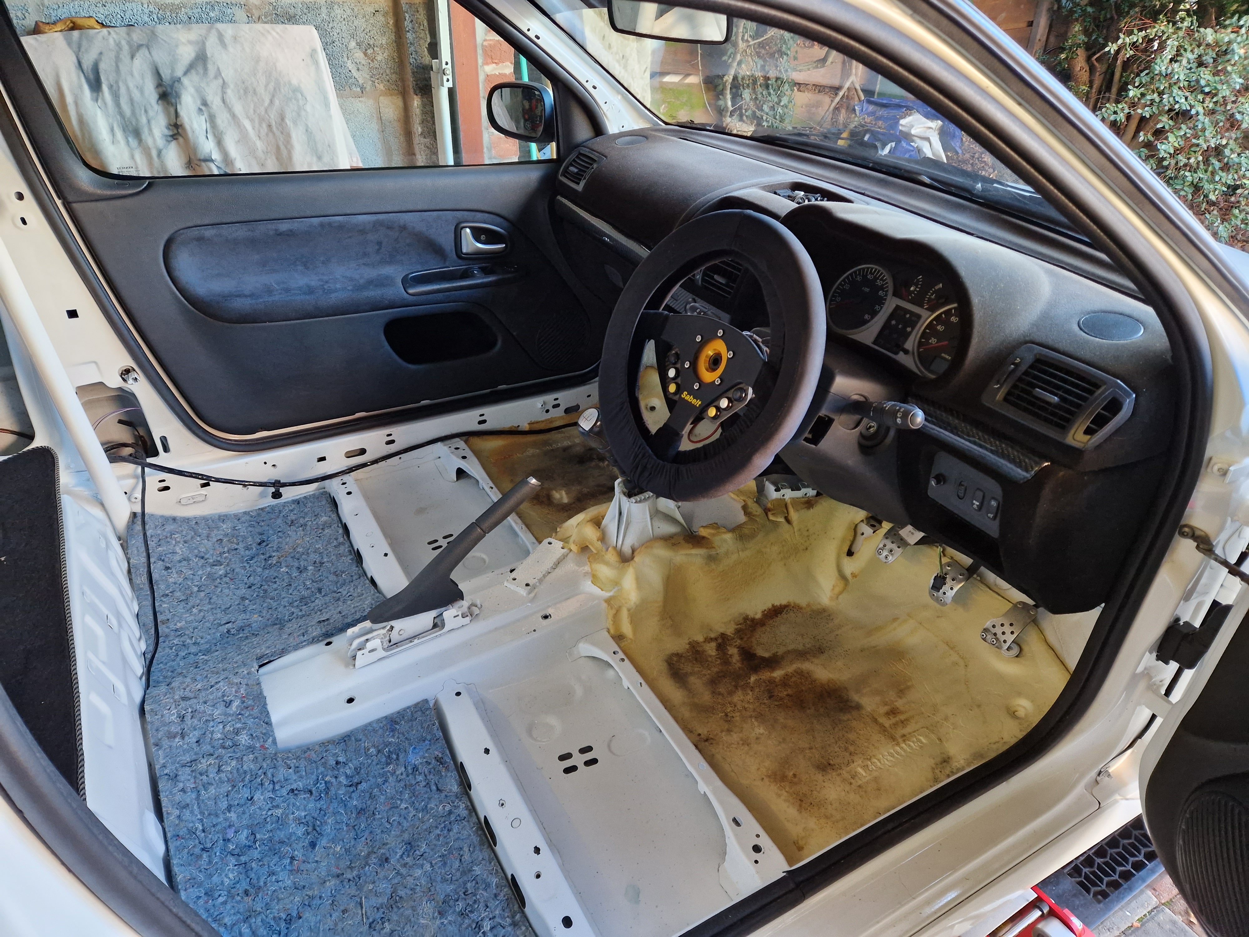

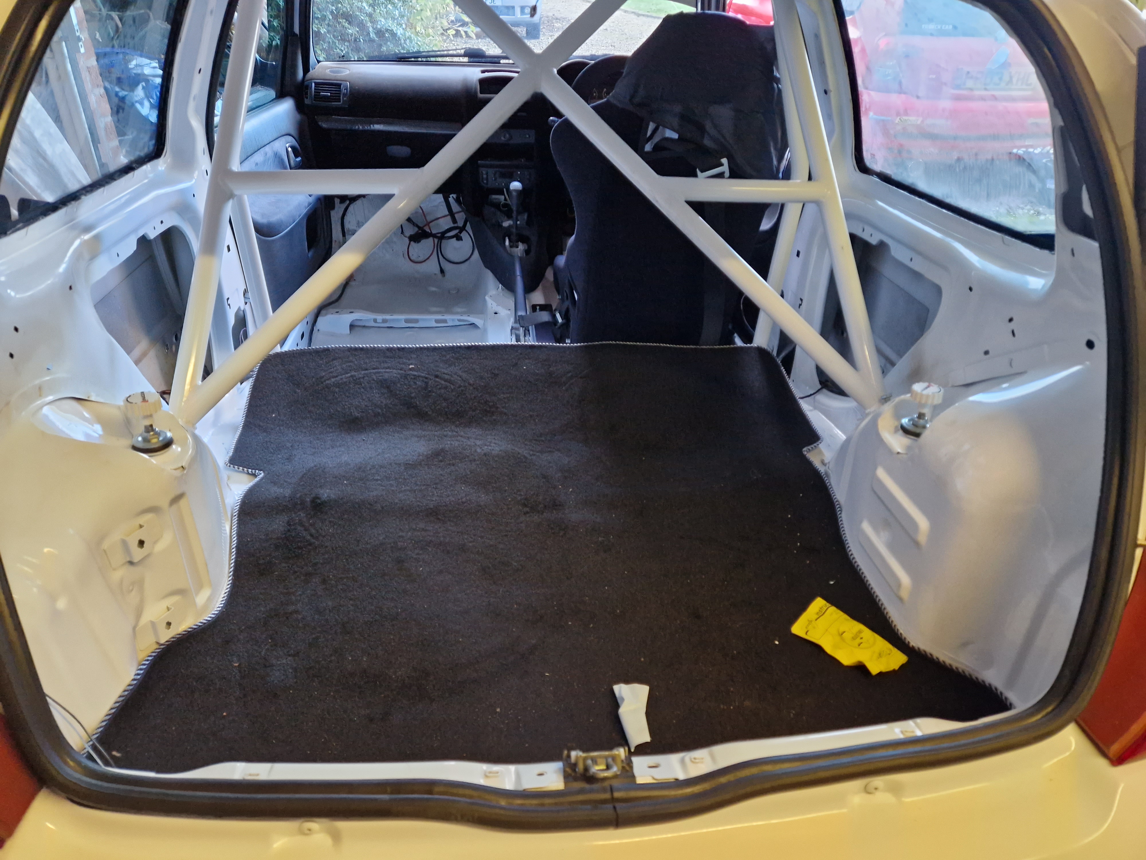

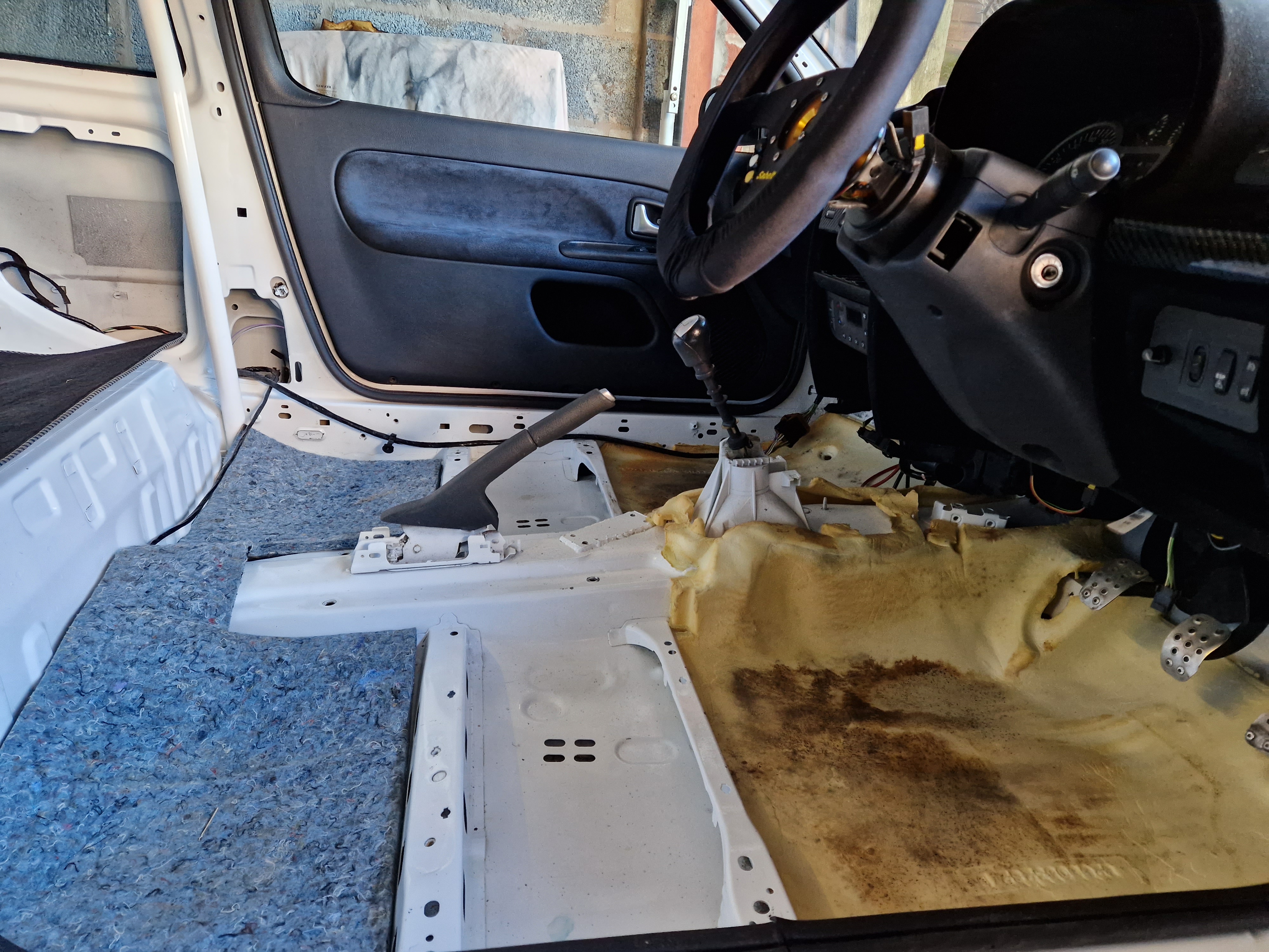

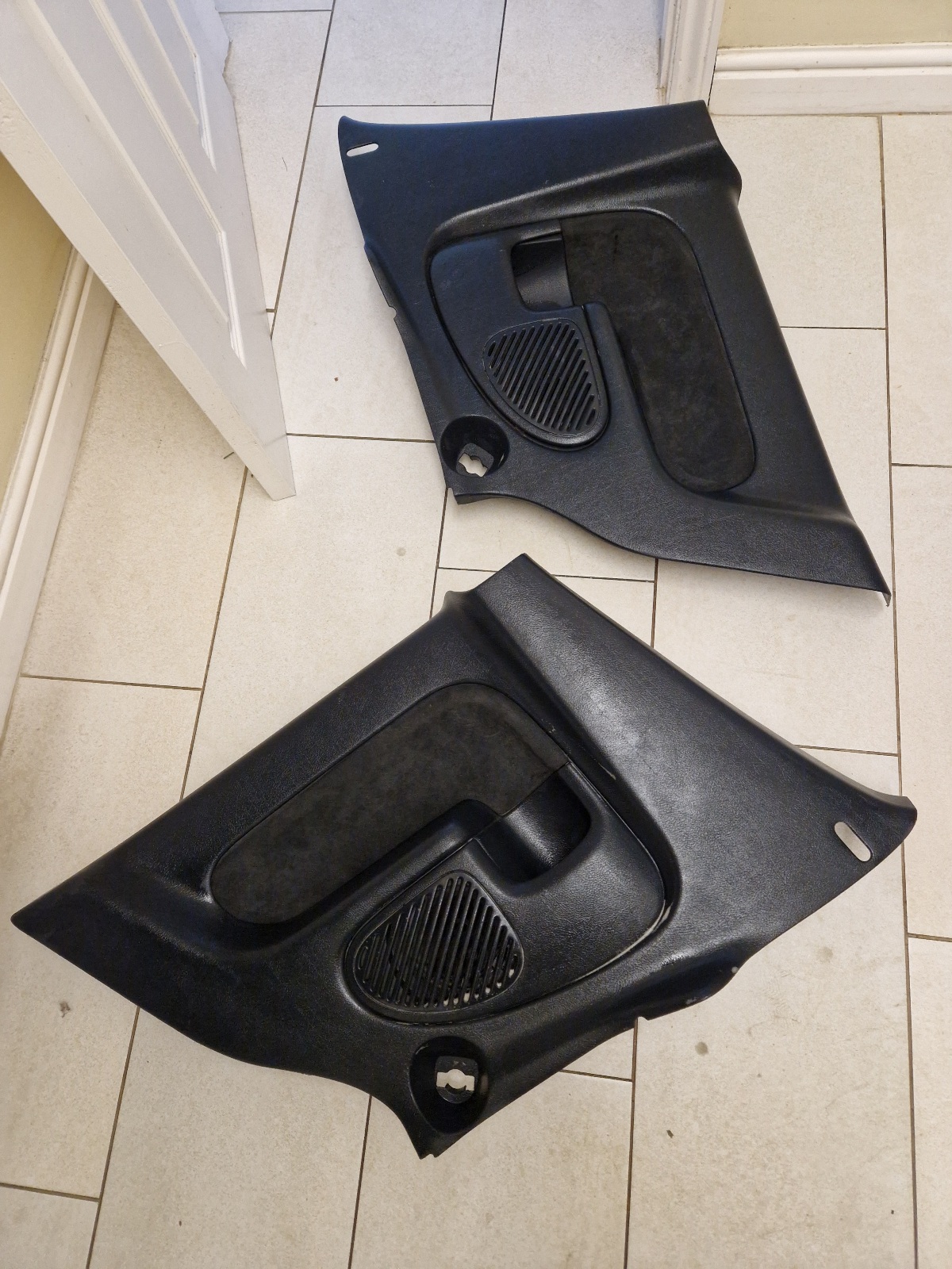

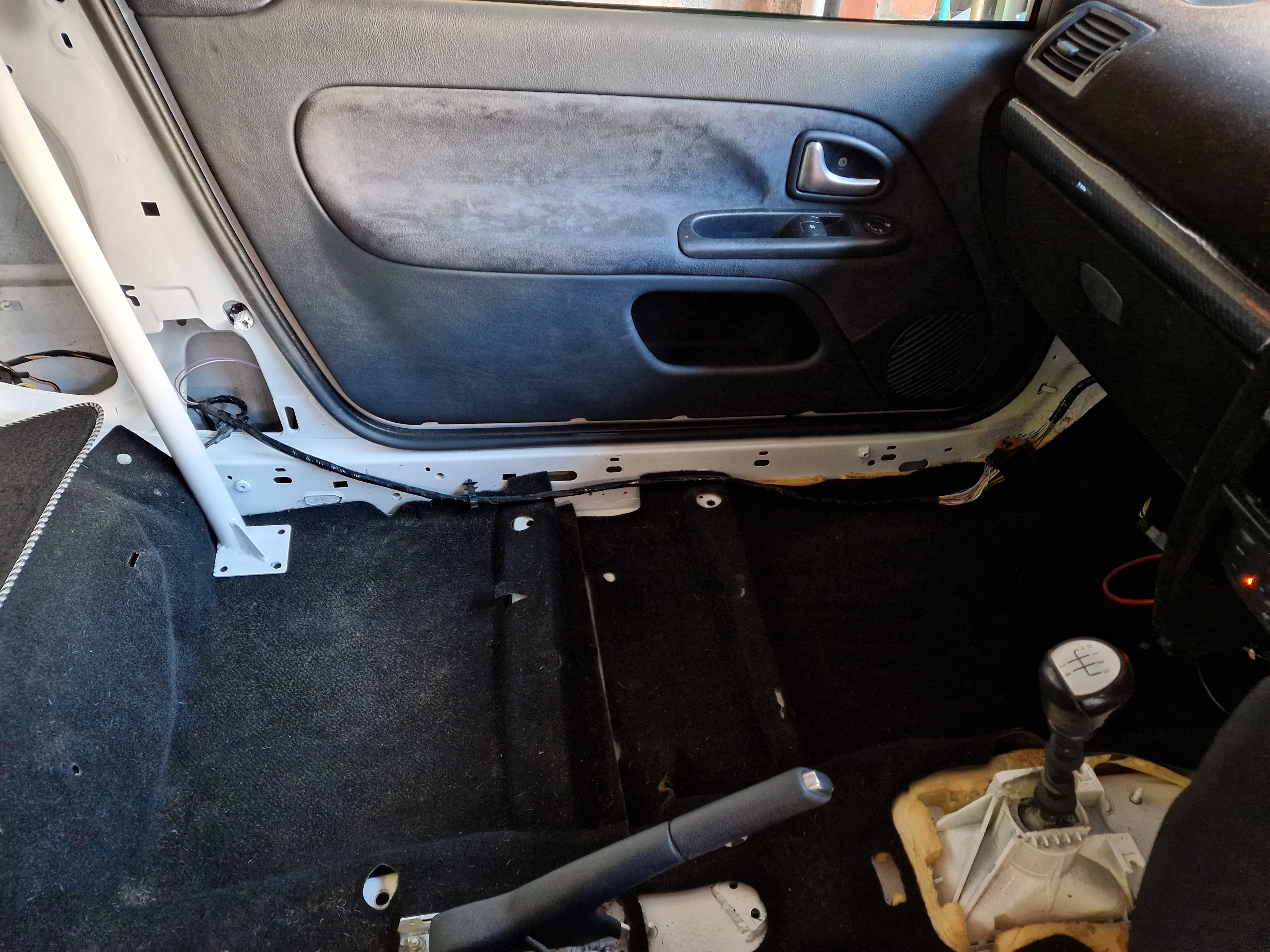

Started putting interior in today ! Needs to be a bit more winter friendly.
Shocks sorted with KW bumpstops of my old rears.

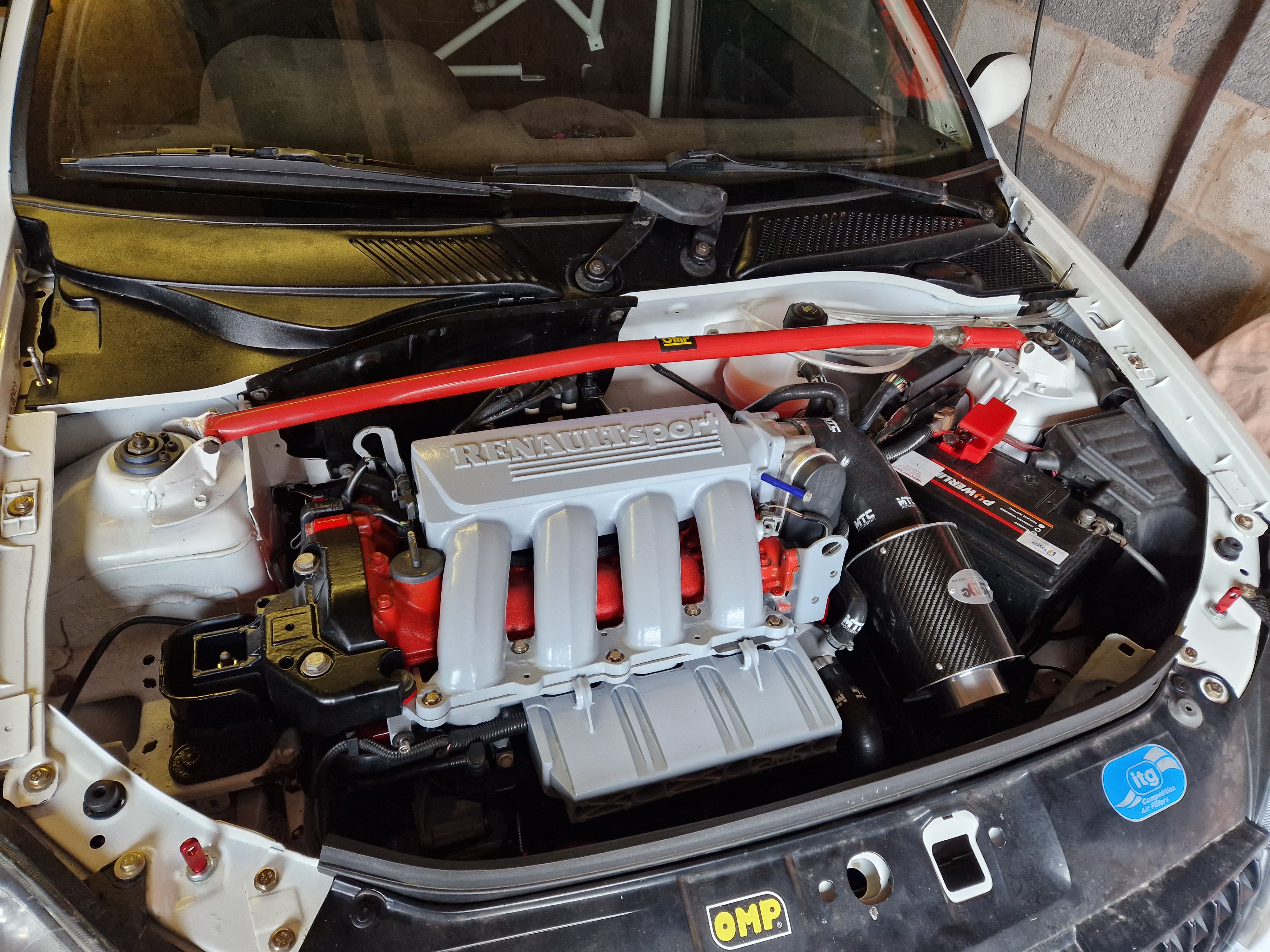

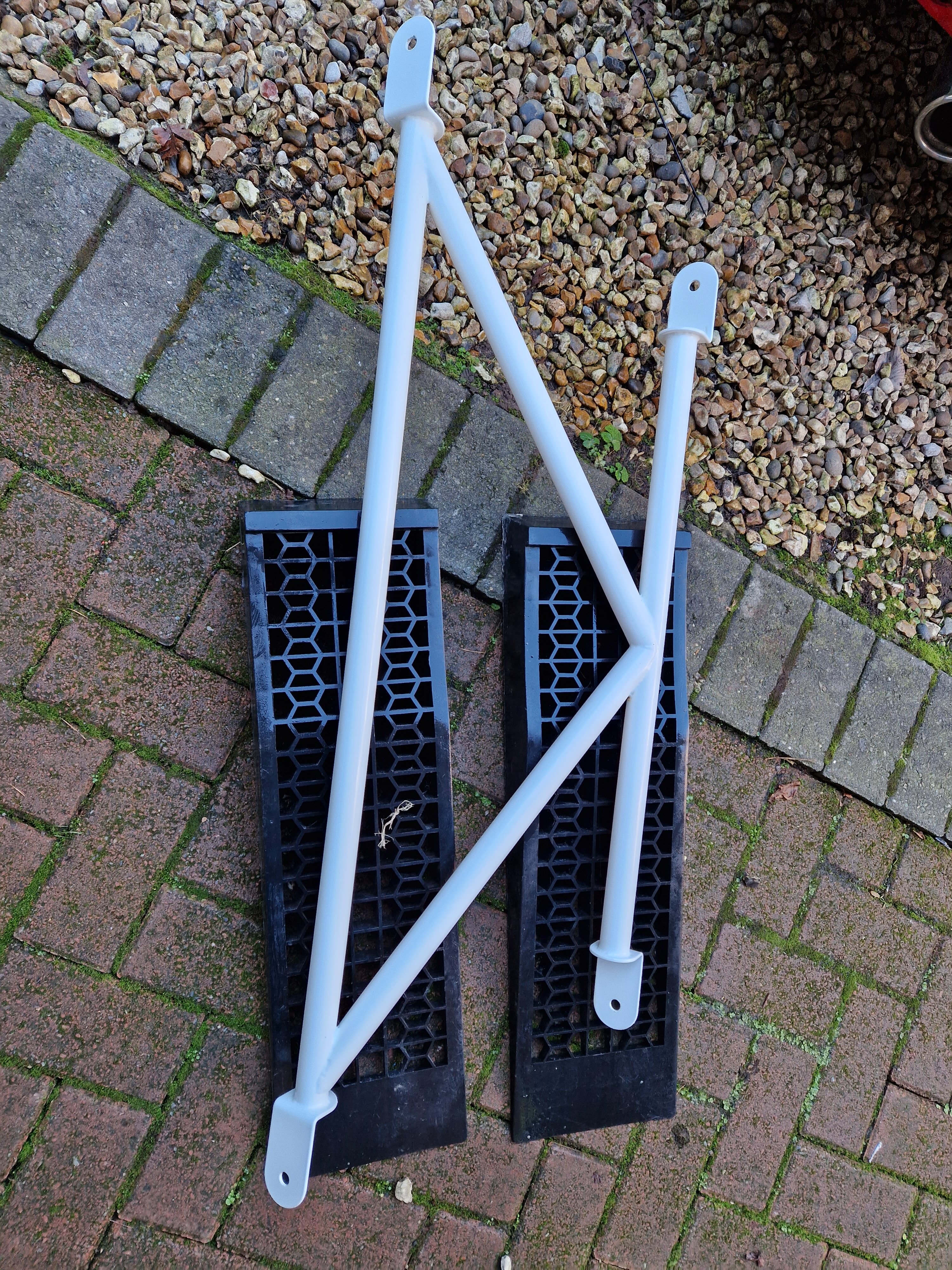

K brace powder coated to match cage.
Test fit , holes need enlarging slightly on k-brace.

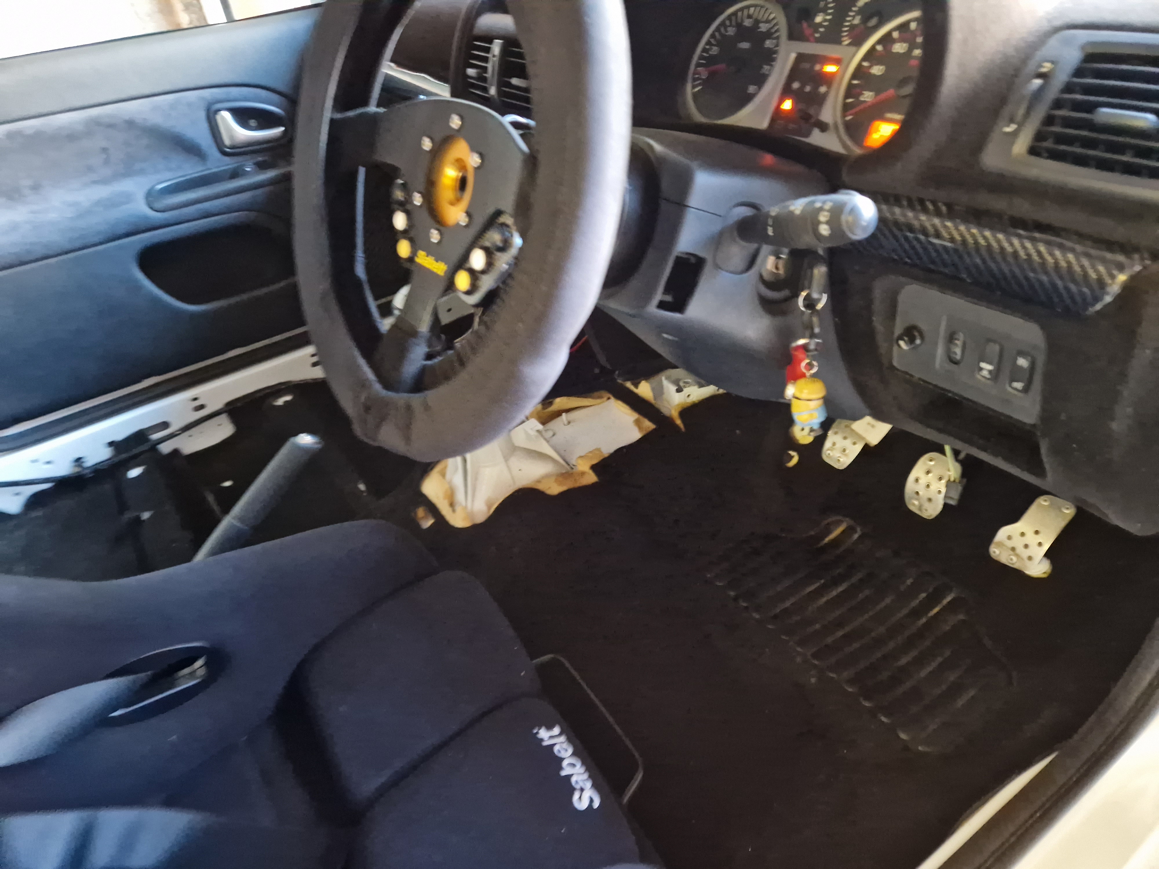

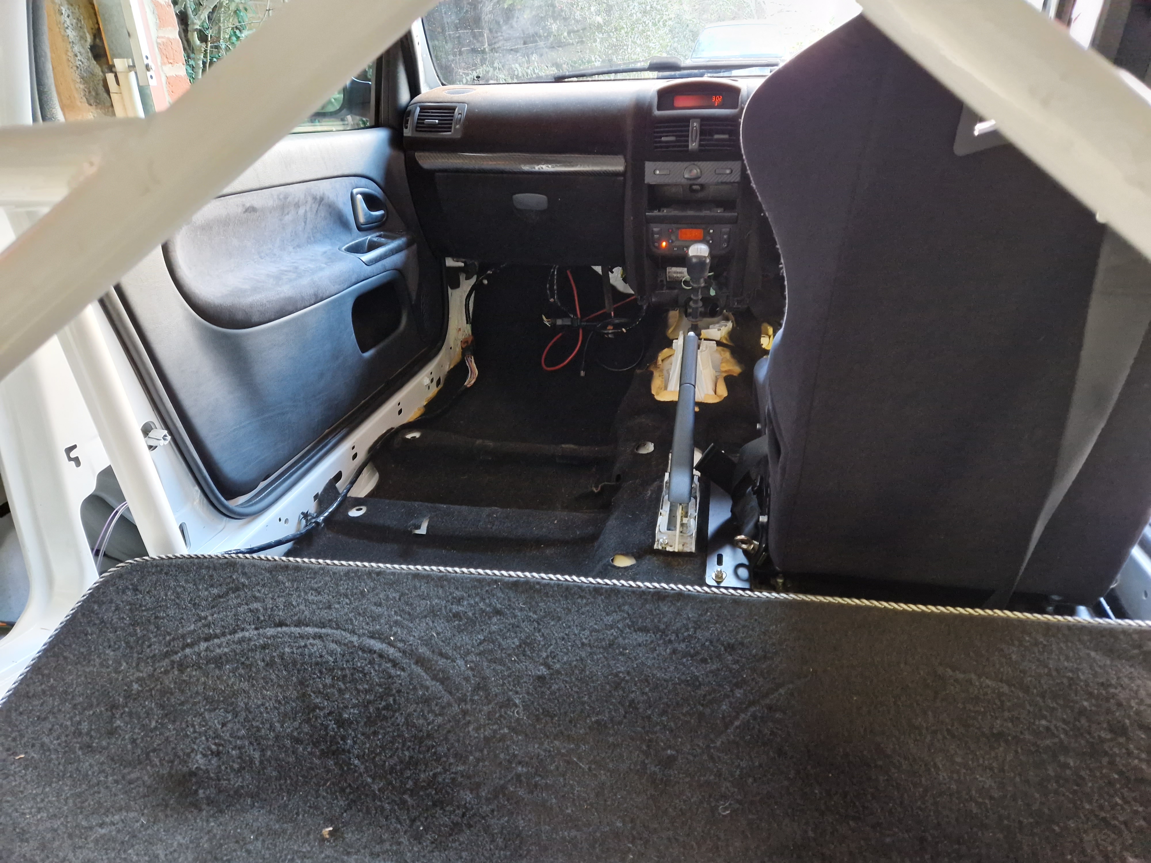

More interior going in, hoping this will make the car more useable over winter and a little warmer.

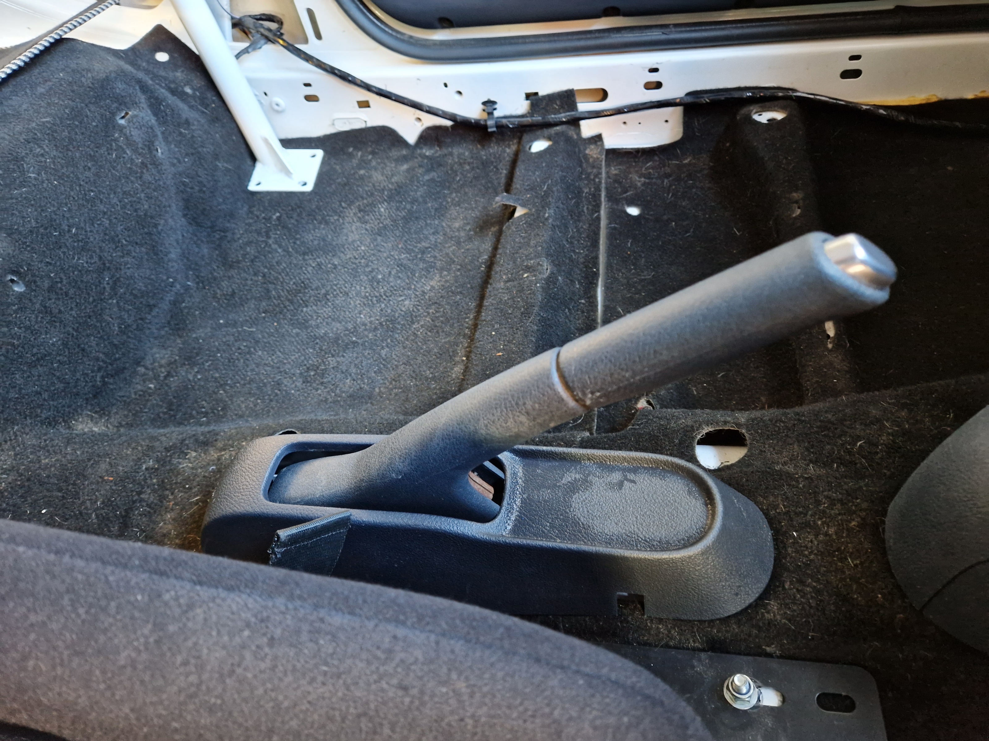

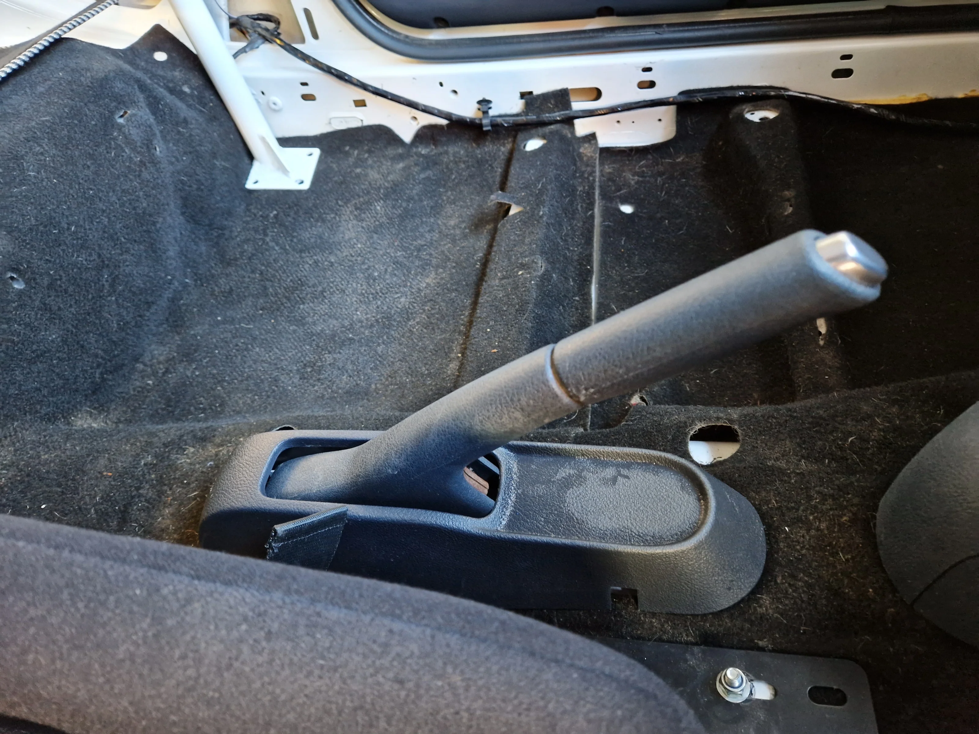

Handbrake coverfitted.
I need to get the foam piece which sits over the gearstick.

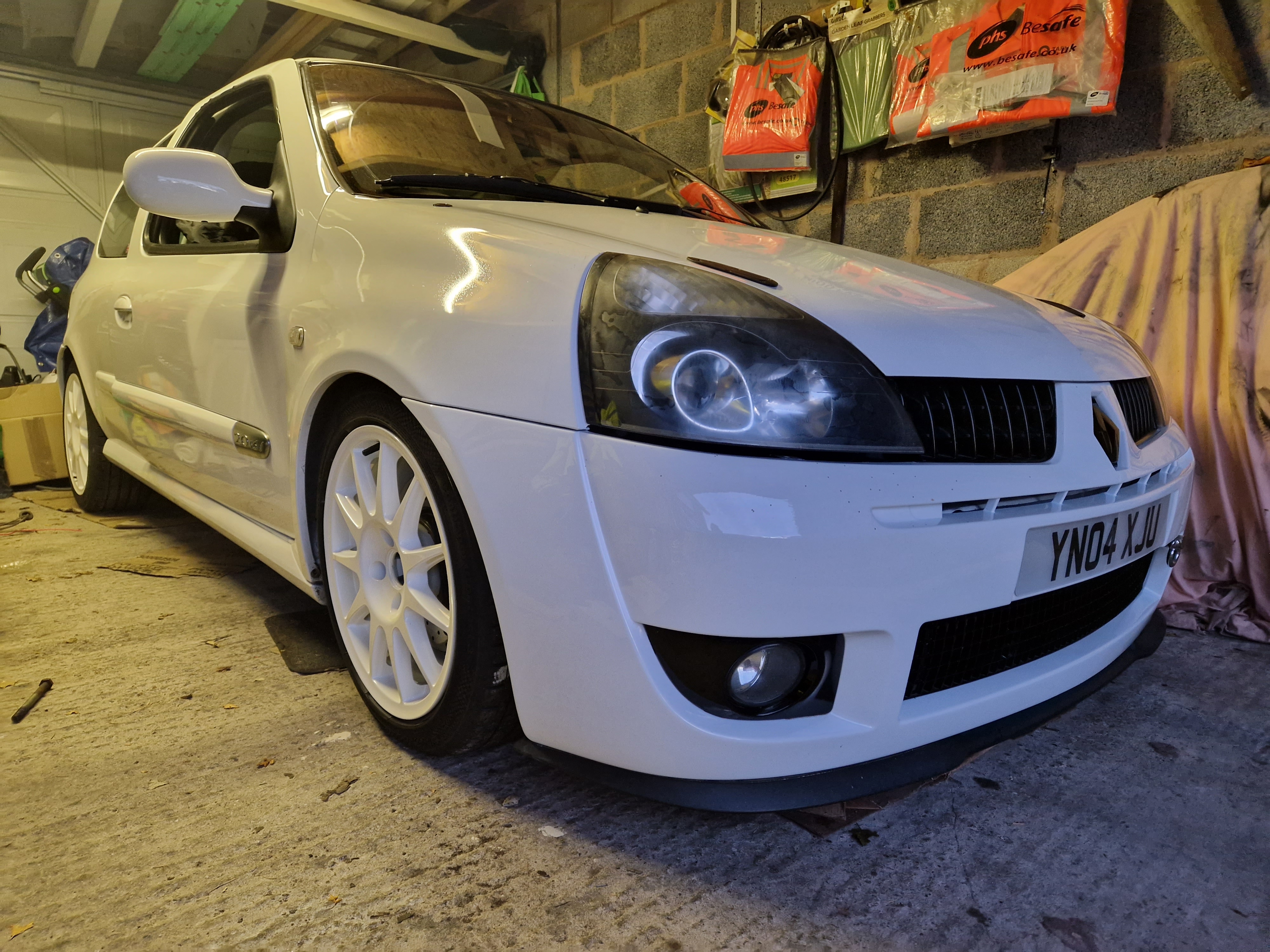

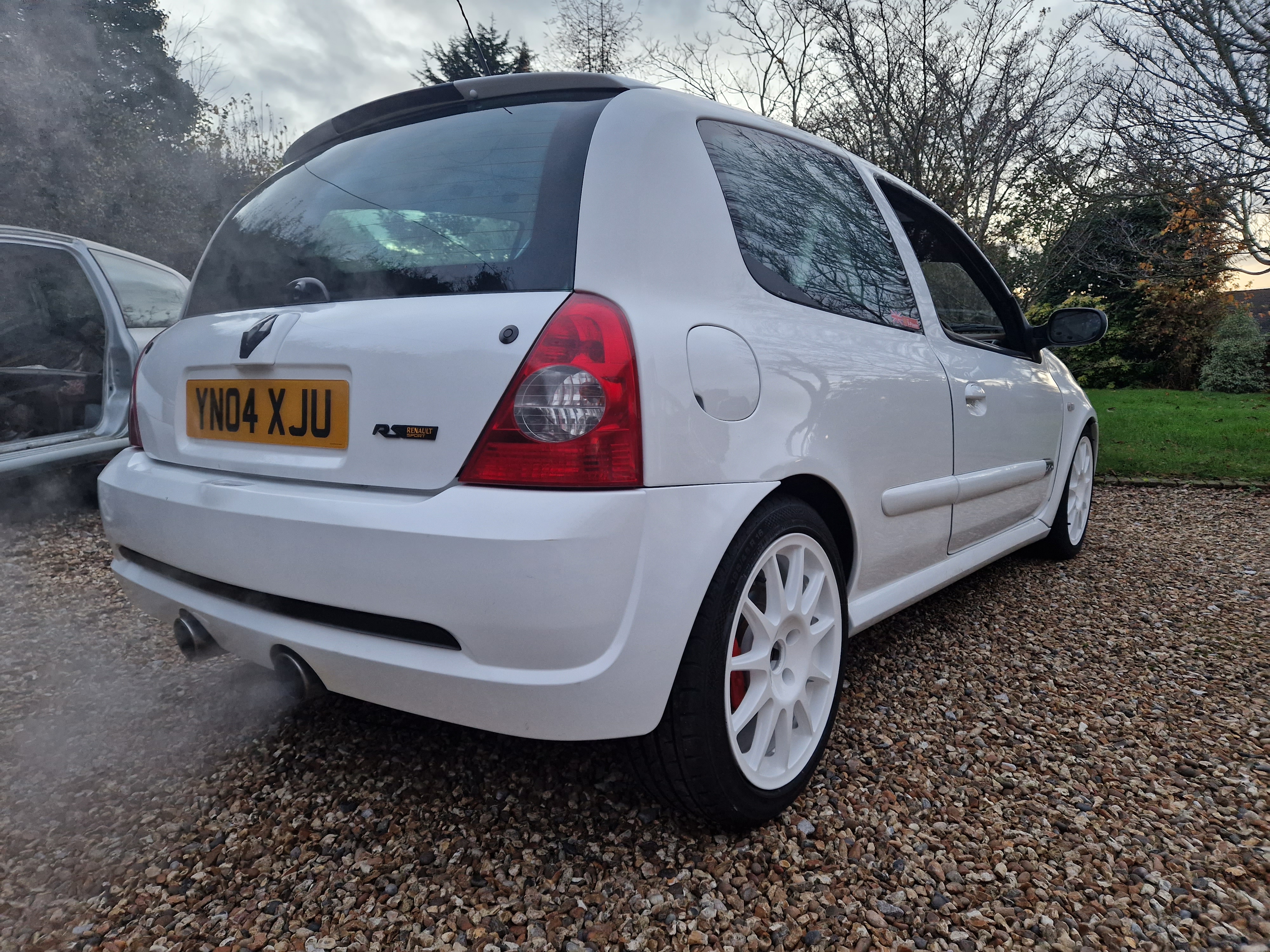

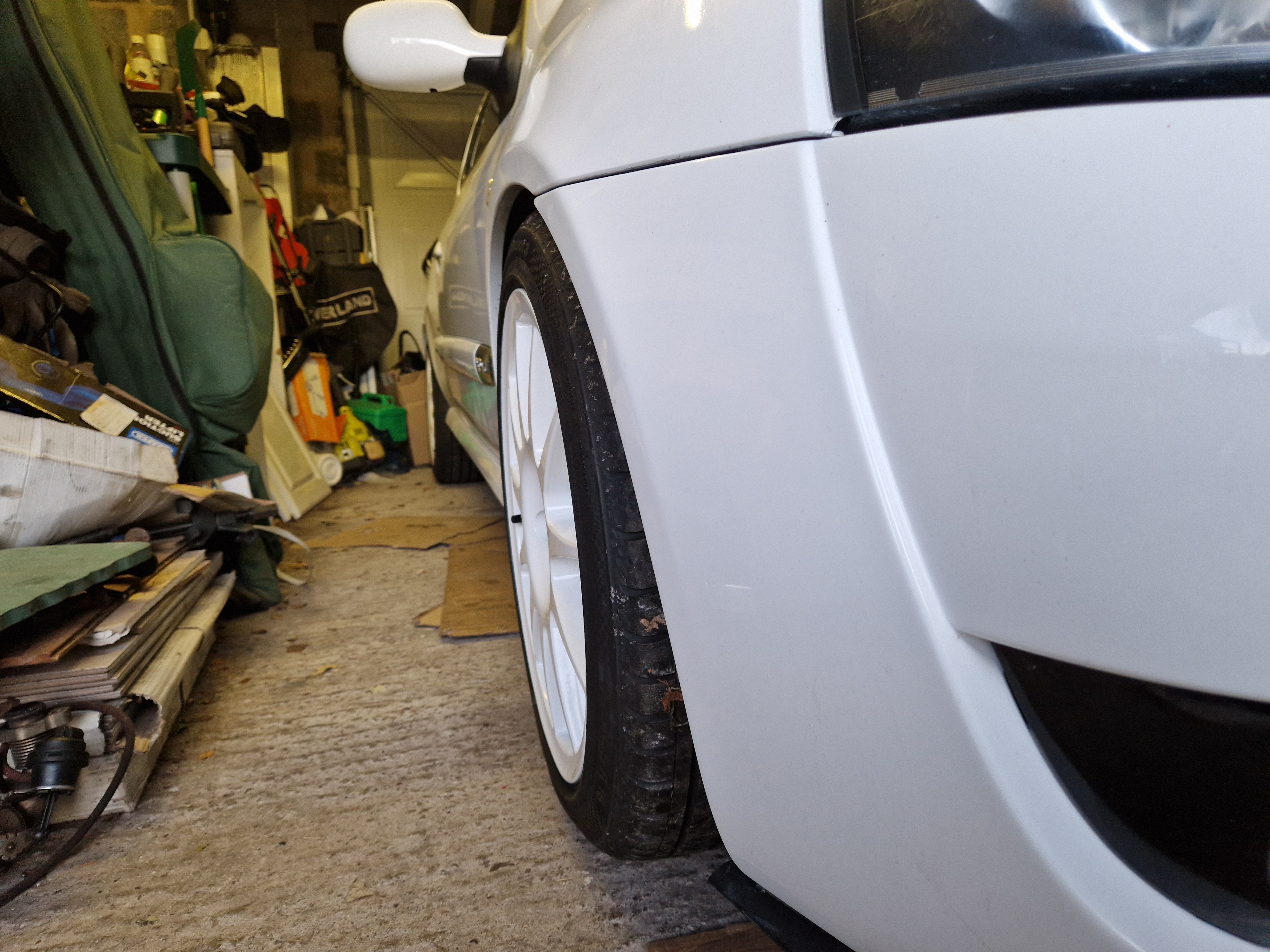

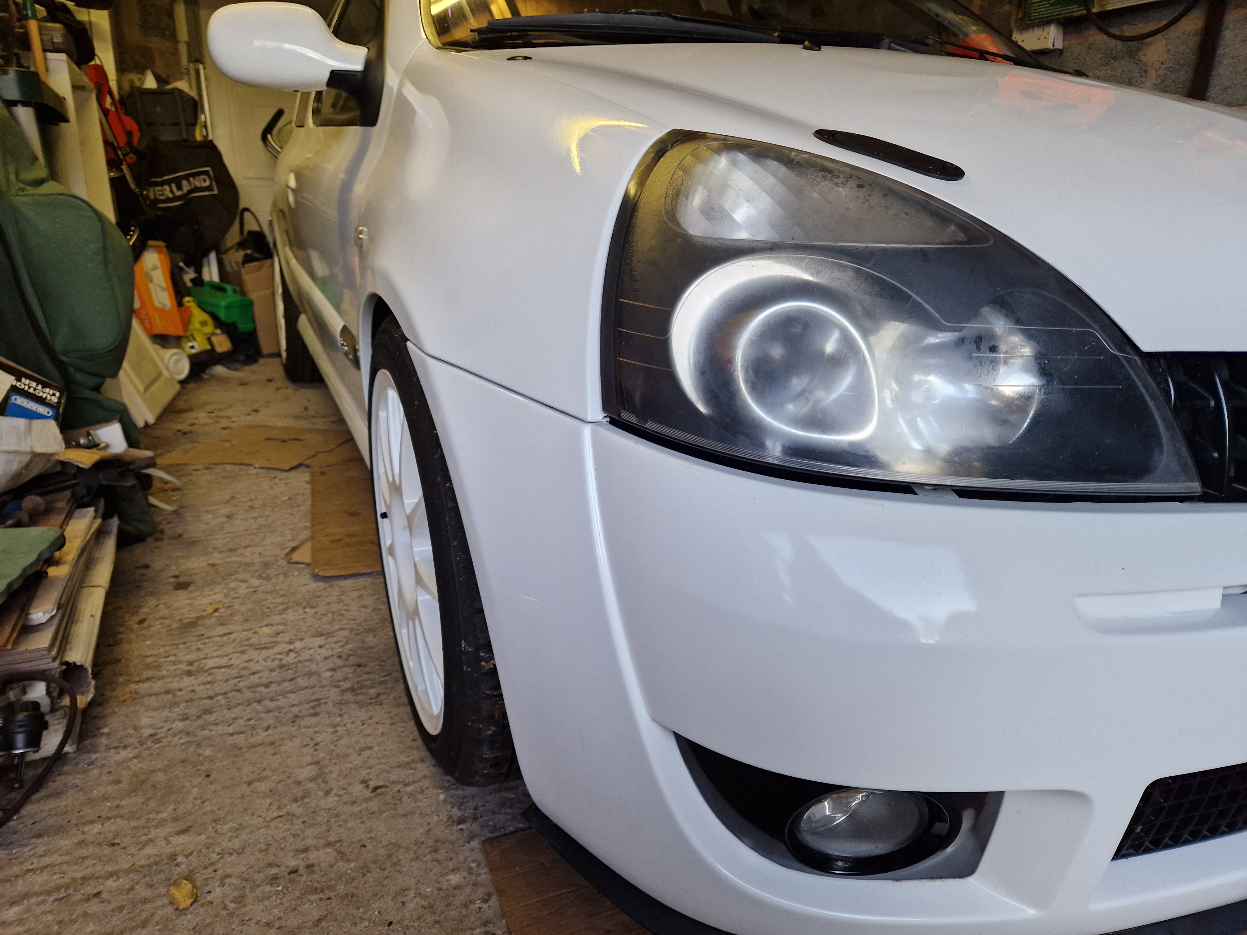

Pure motorsport Spacers fitted front and rear. Could have gone a little more on the rear but happy how it's sitting.

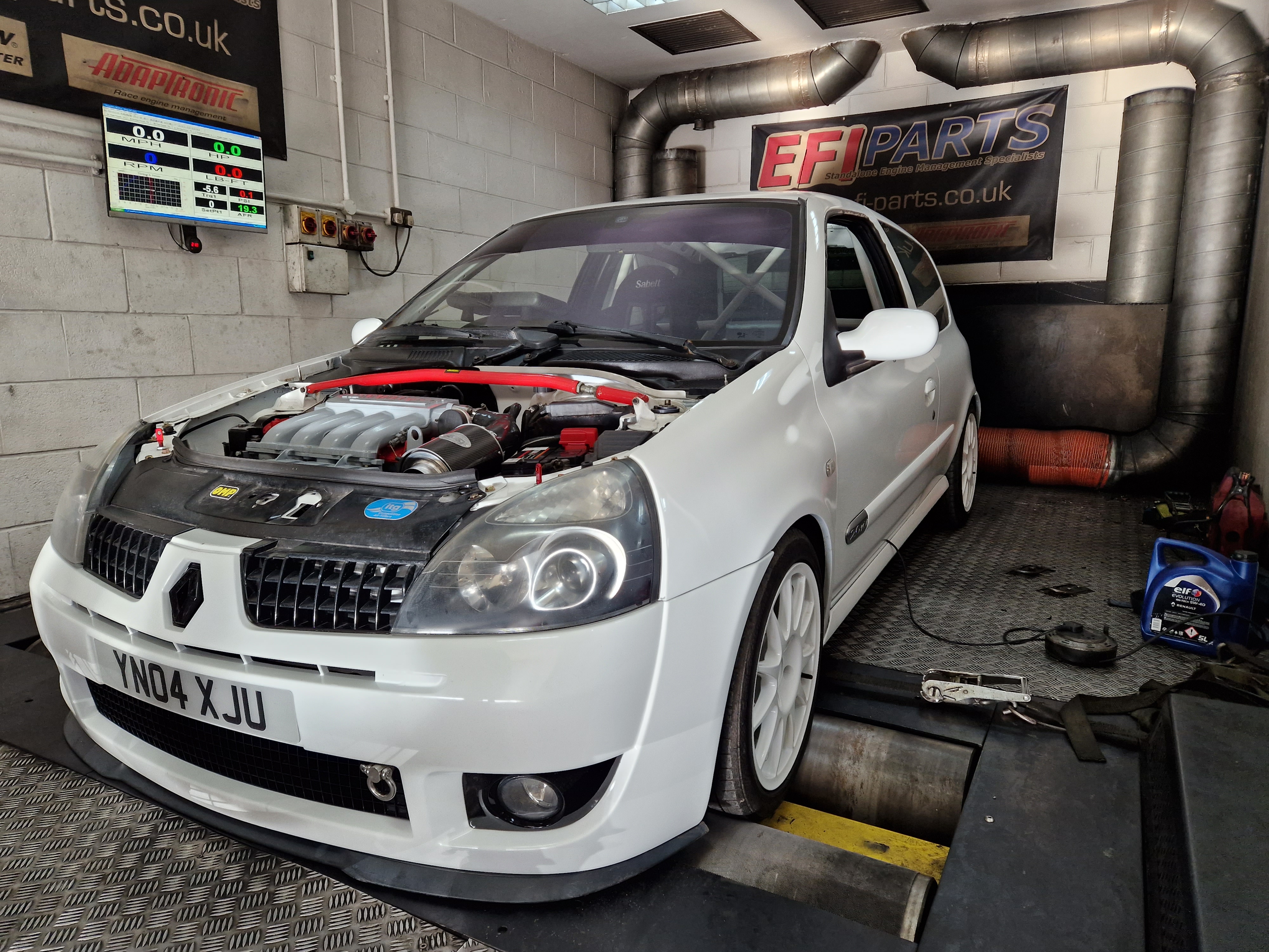

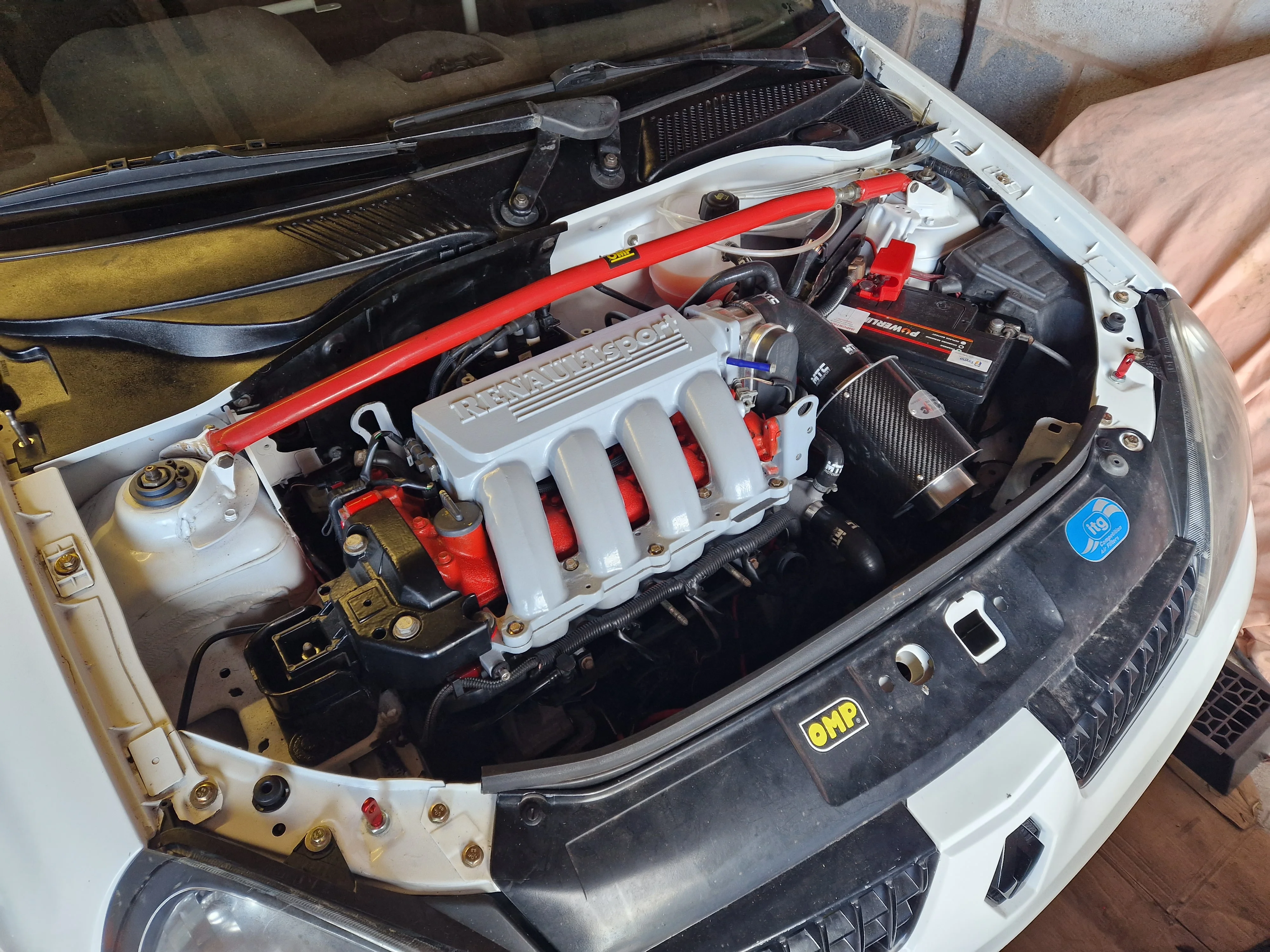

Car went to birchdown on Monday for a fresh cambelt and water pump and keyway Crank pulley fitting ready for mapping.

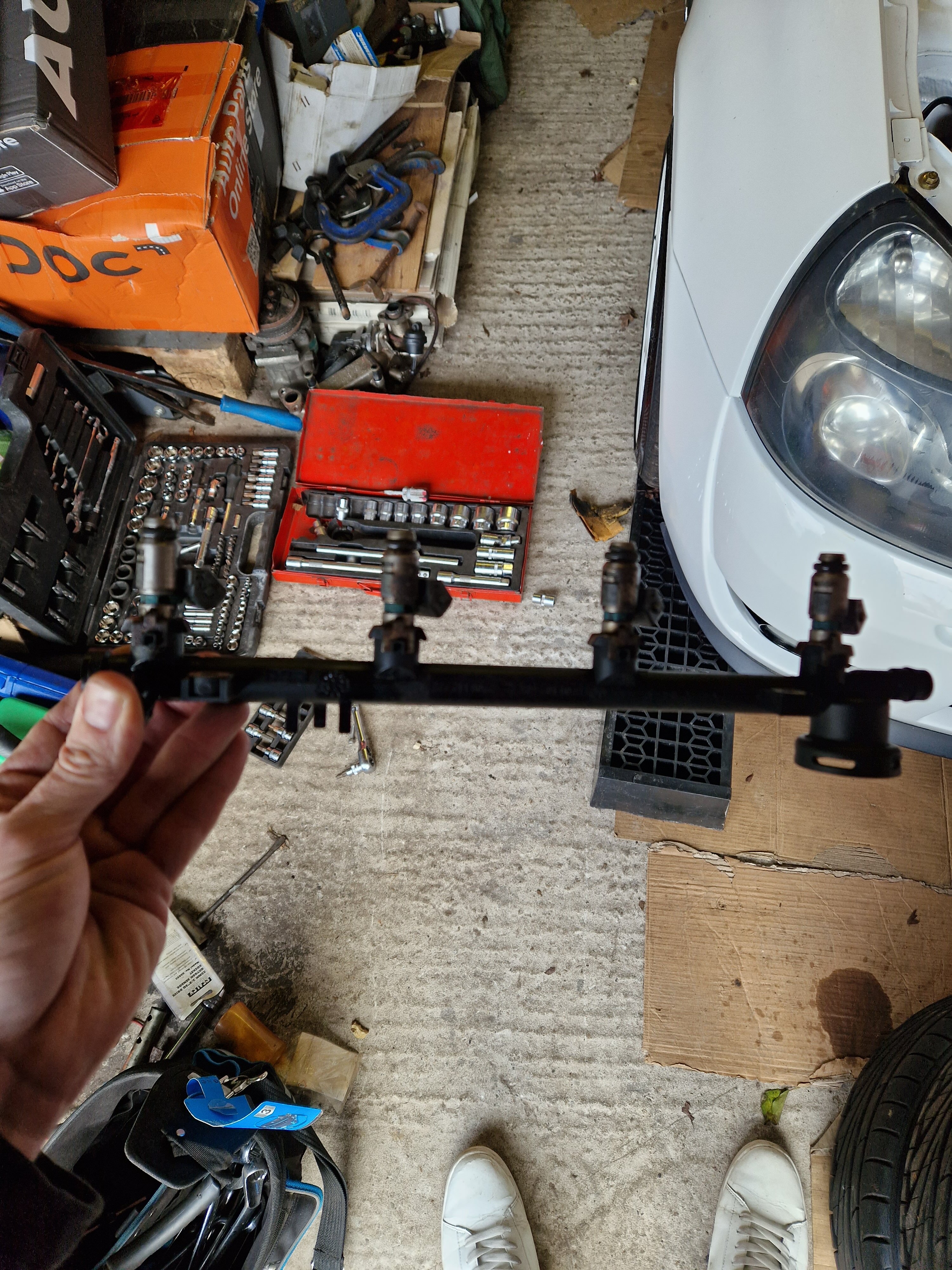

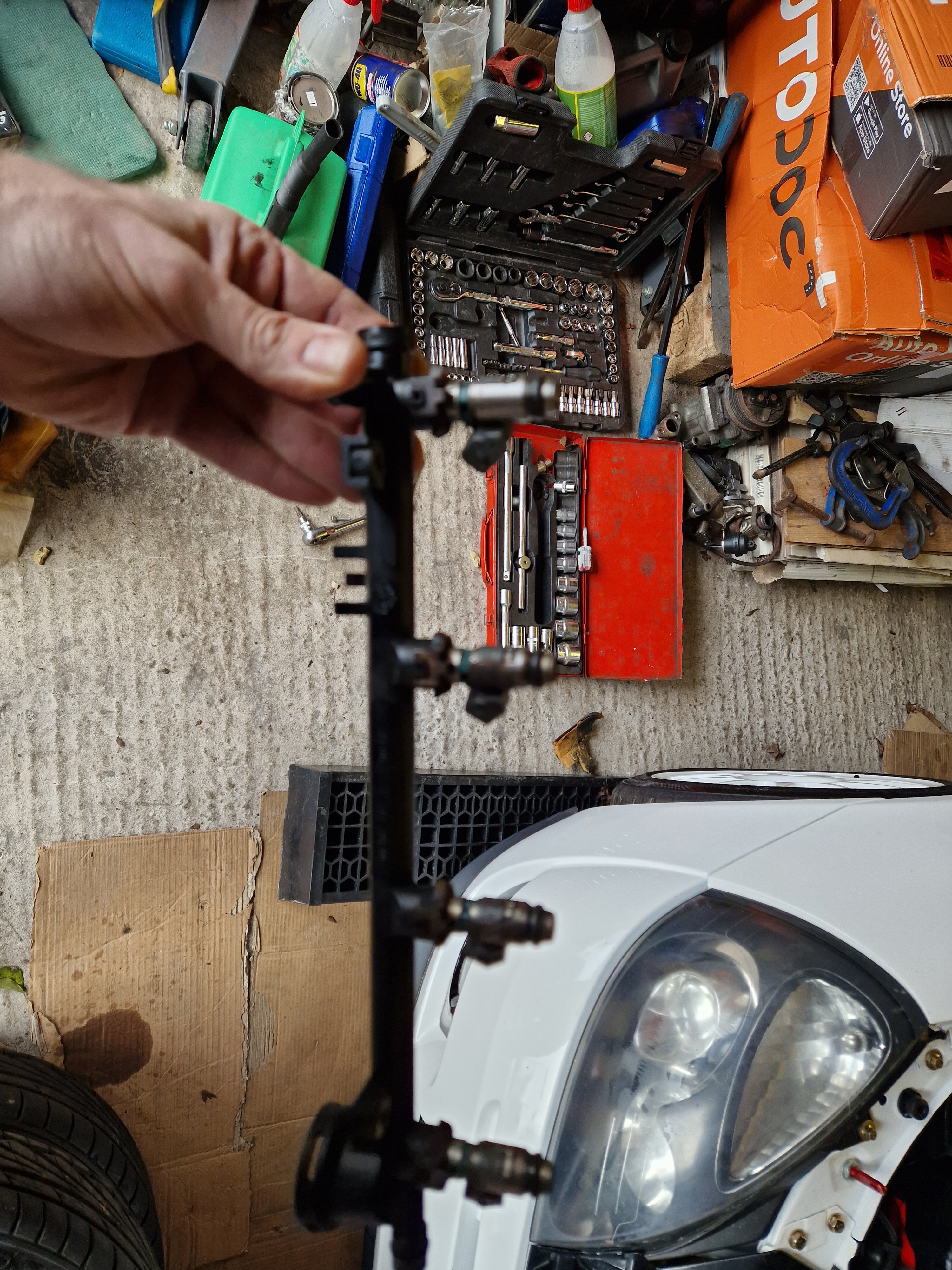

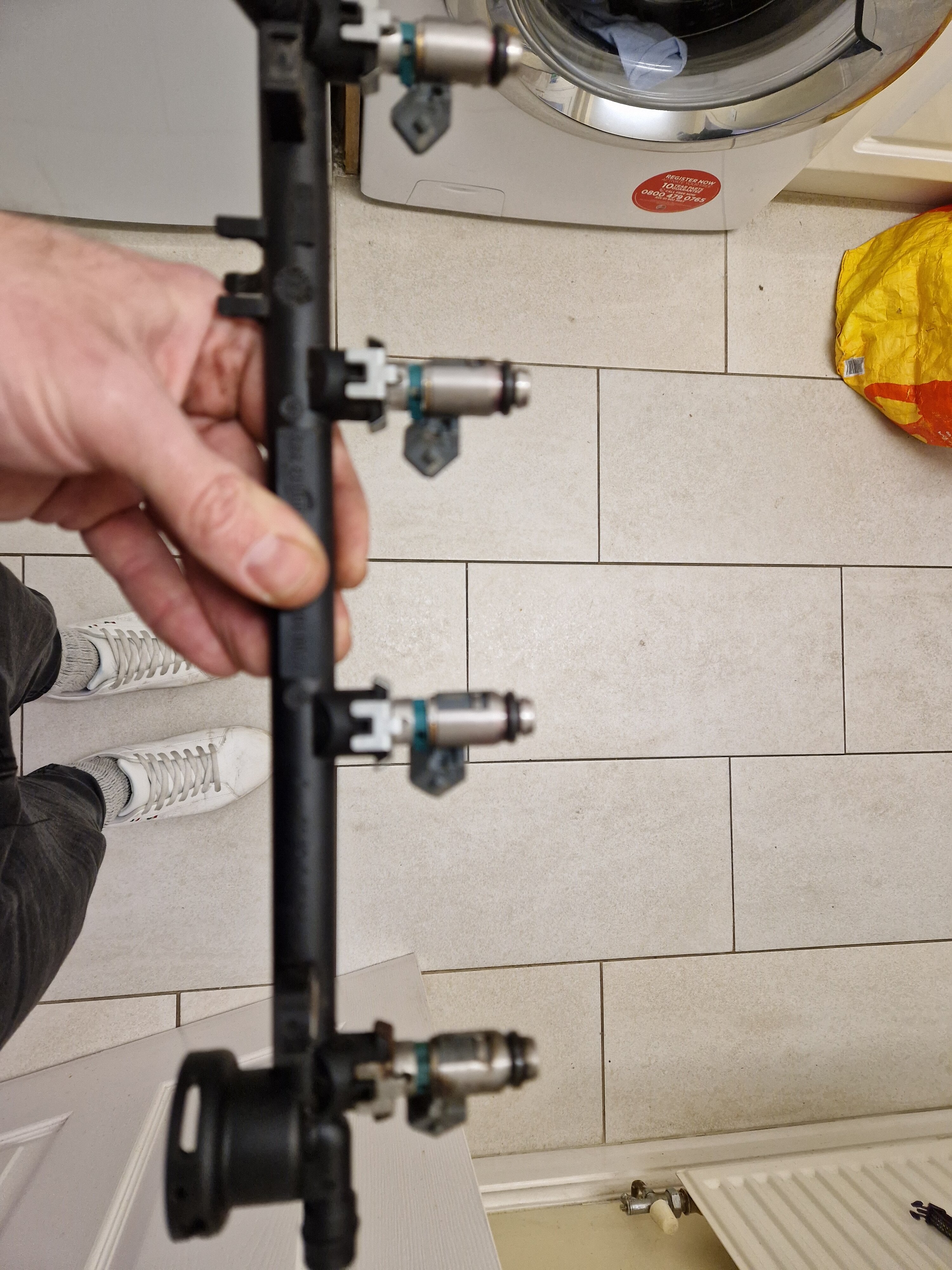

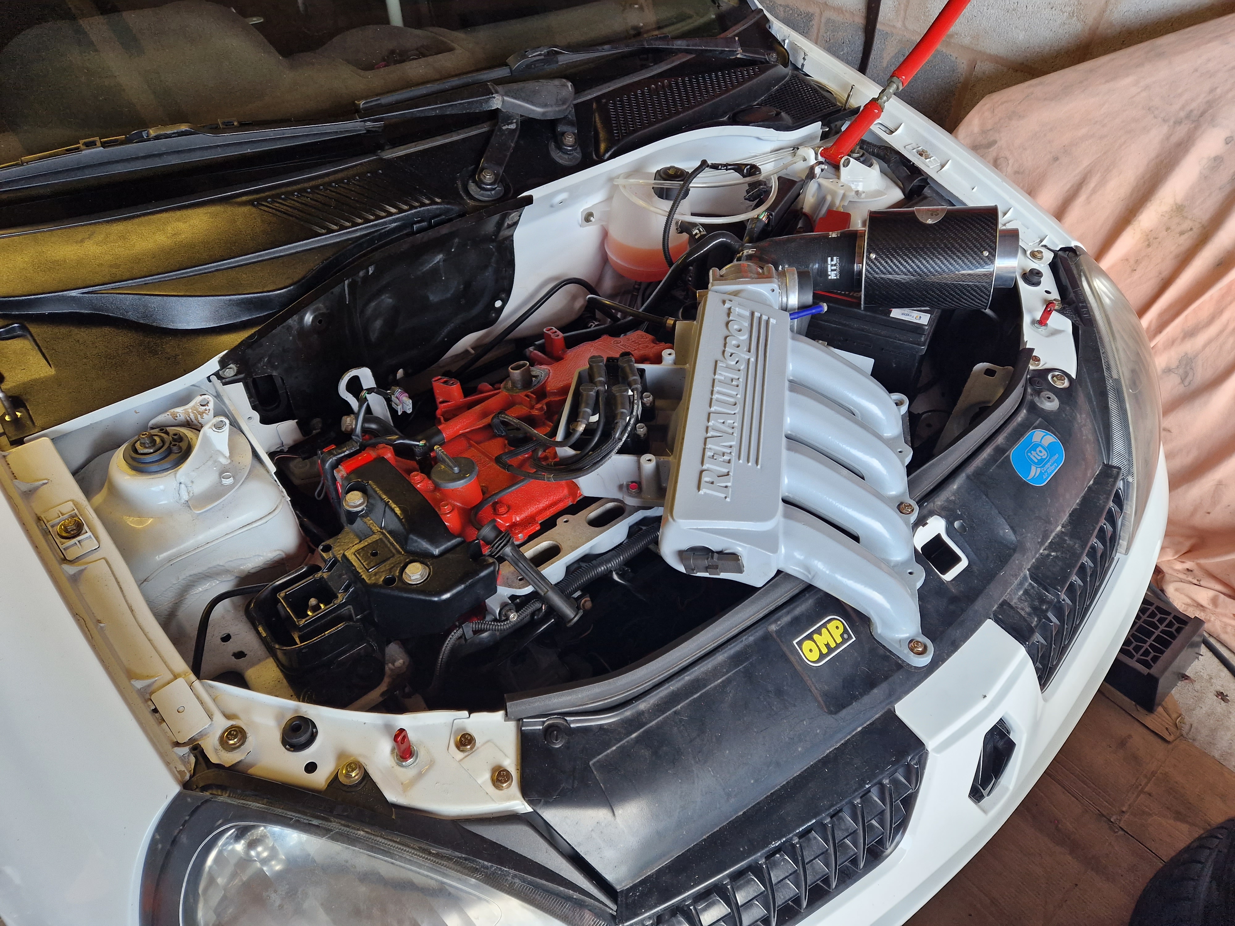

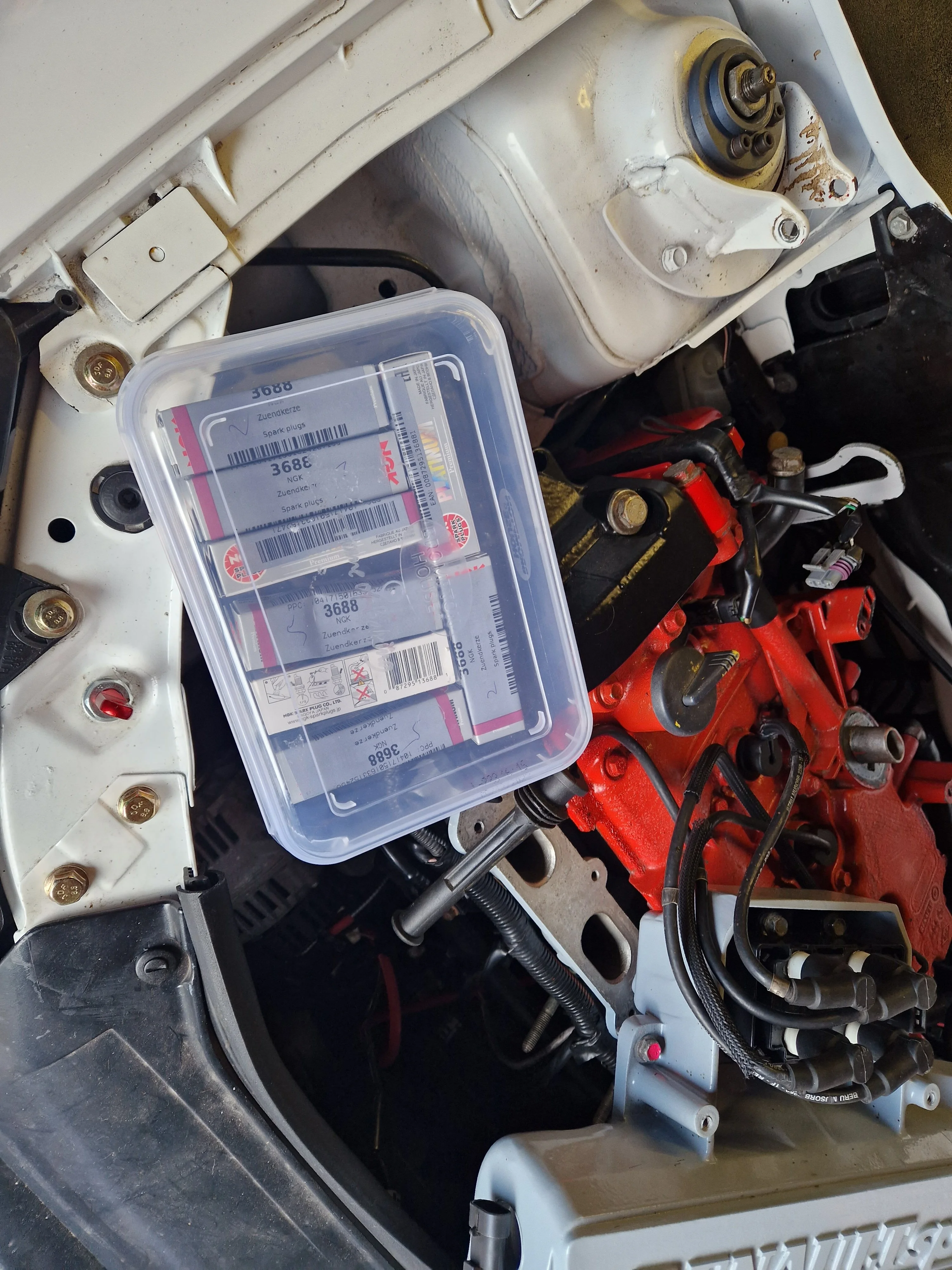

I fitted a fresh set of injectors and spark plugs.
Fresh injectors fitted.
Inlet removed for spark plug replacement.
All done ready for mapping.

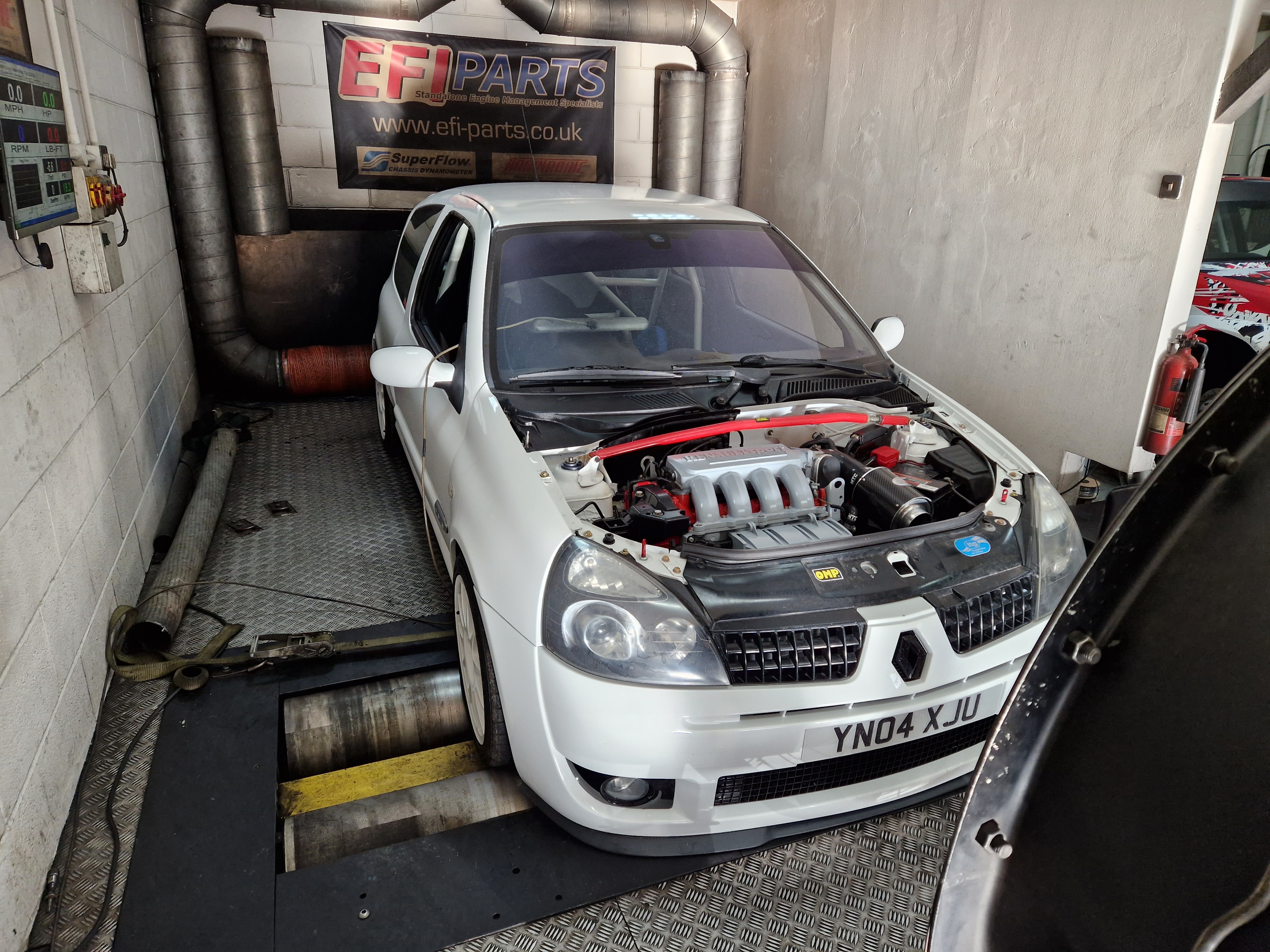

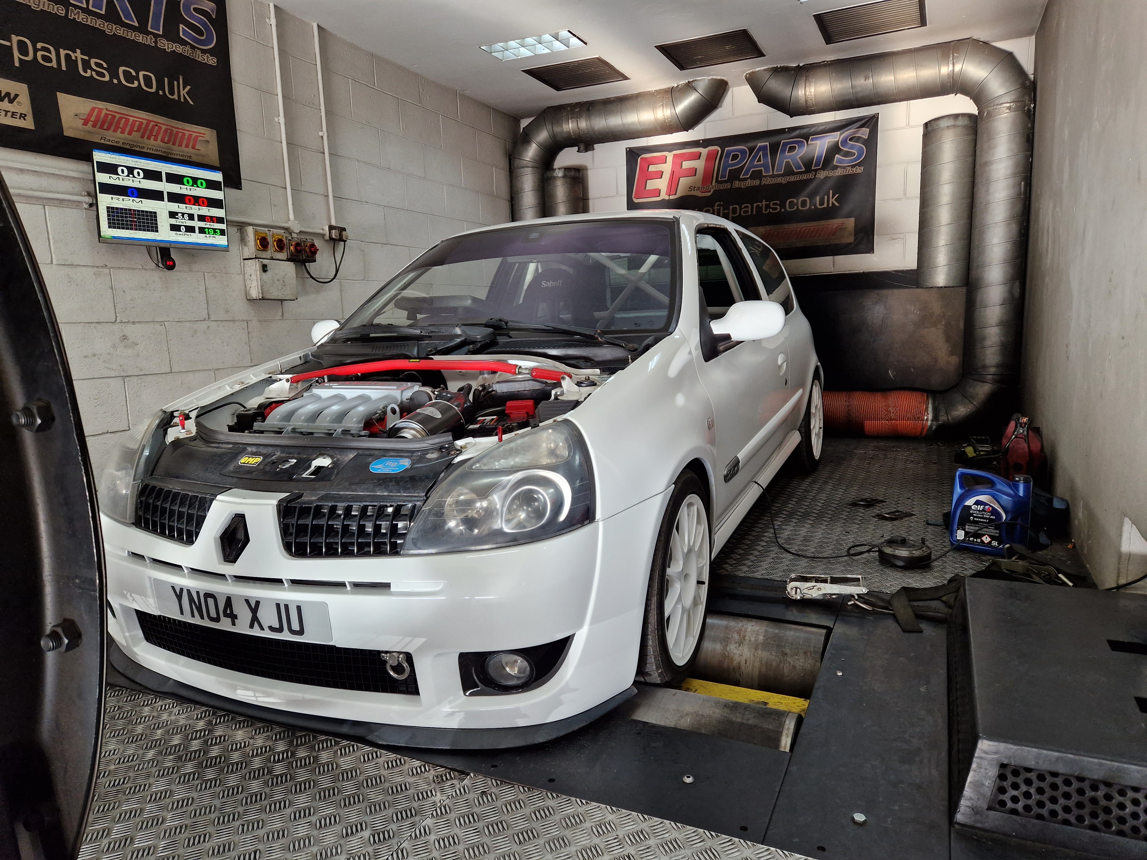

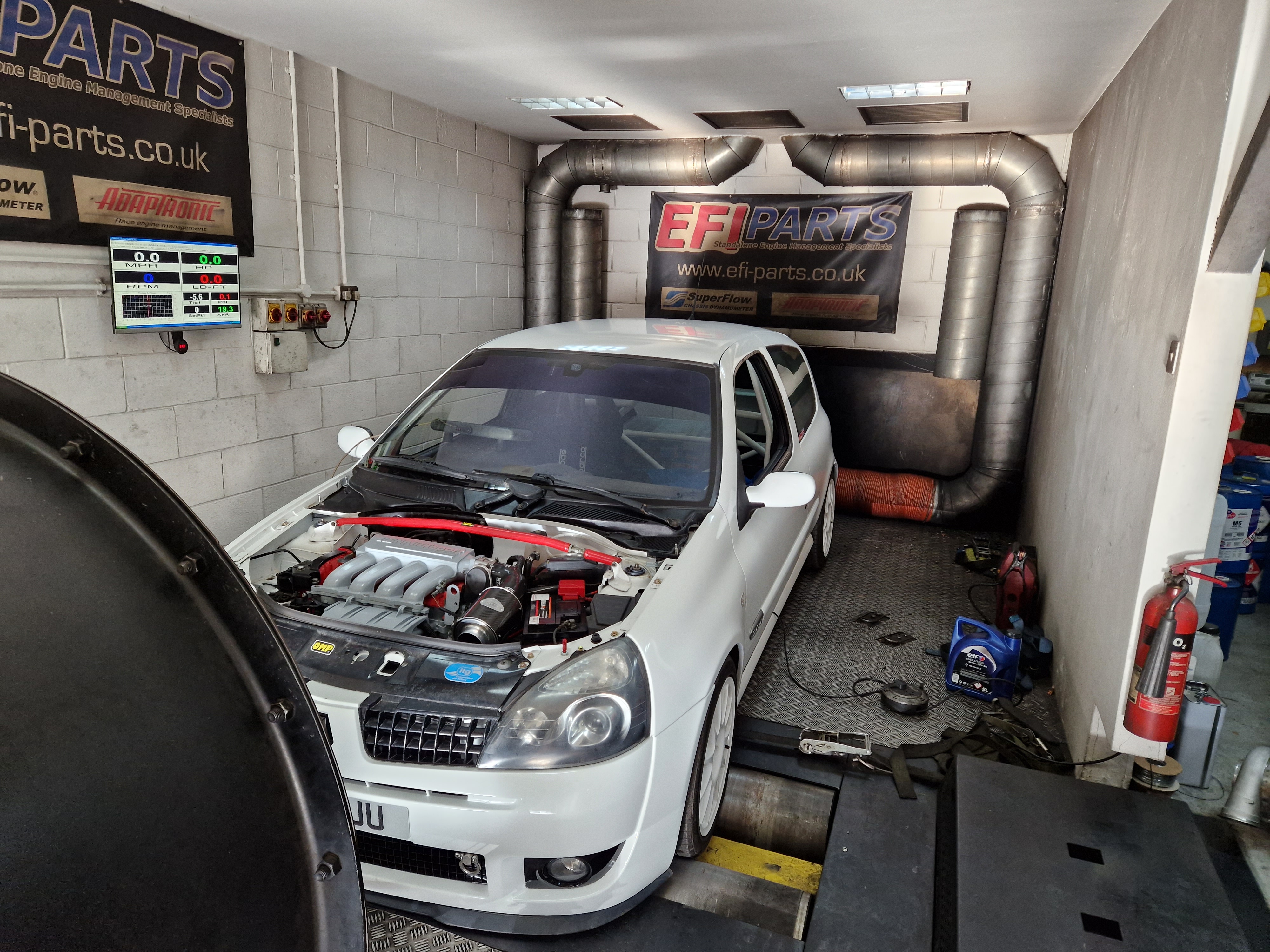

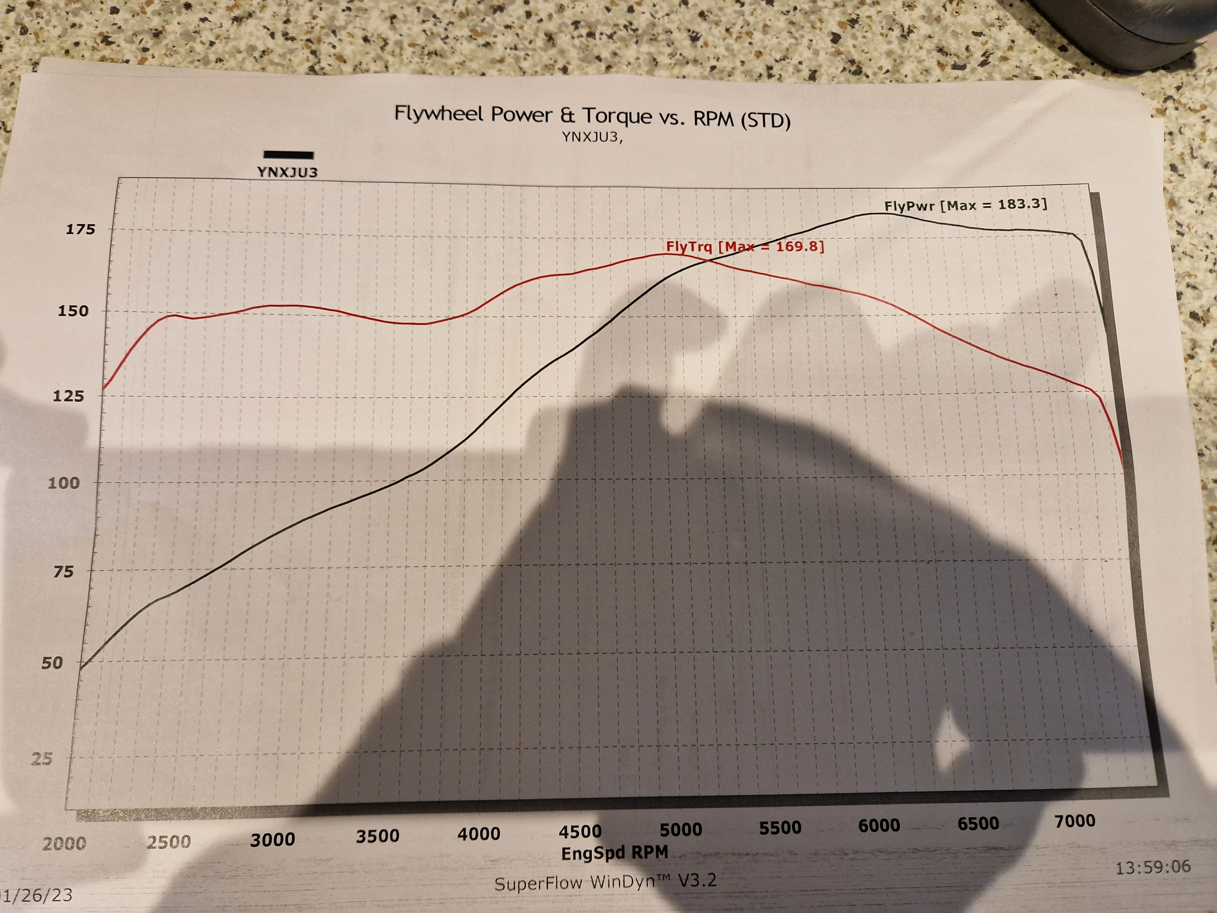

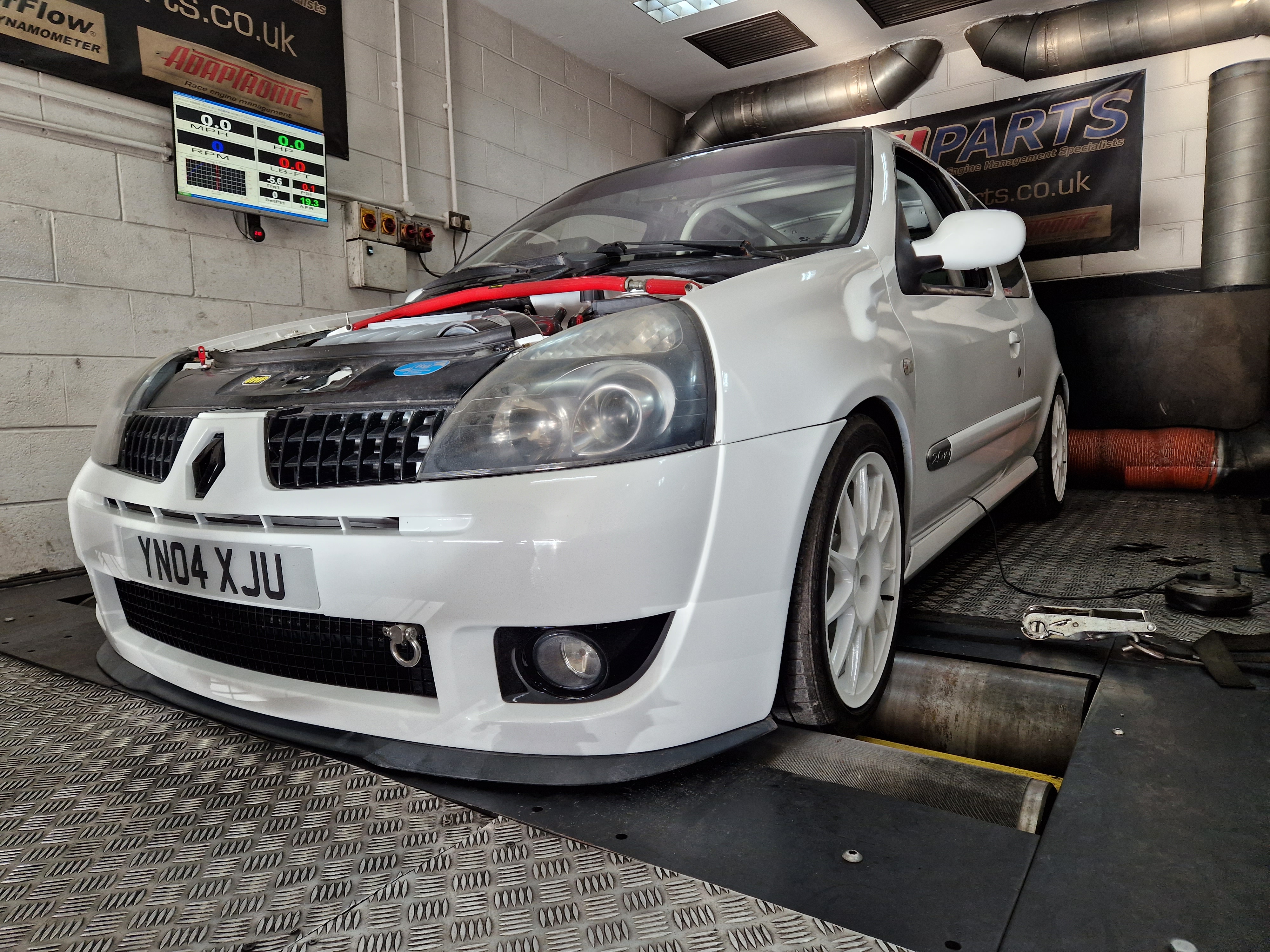

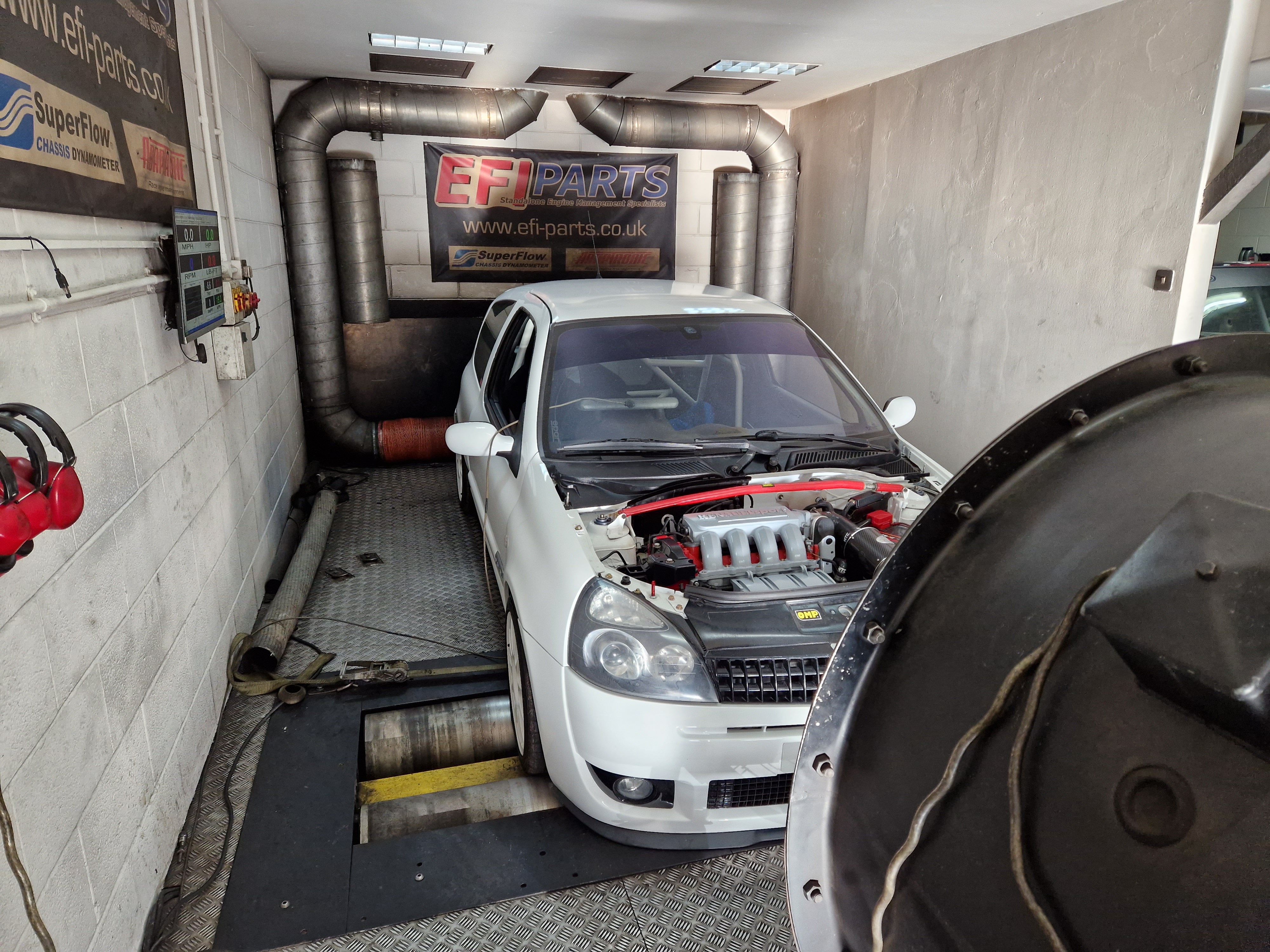

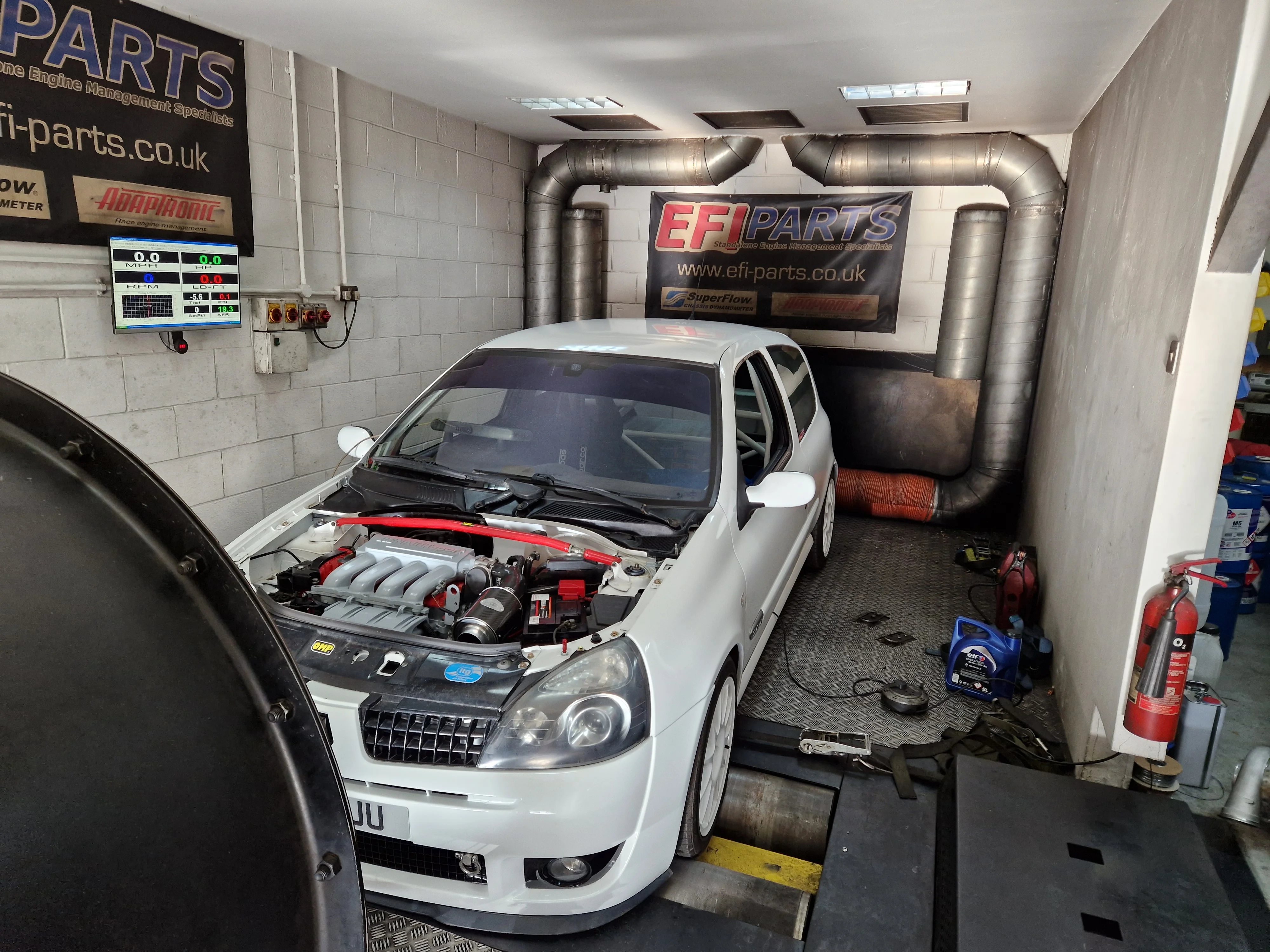

Car went to Efi for mapping after having group N timing set while having a fresh cambelt, water pump, dephaser pulley and keyway Crank sprocket.
