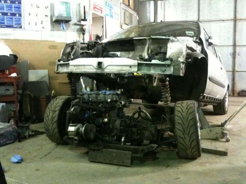

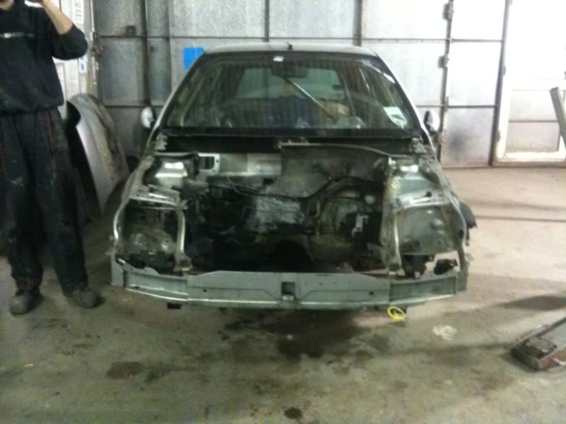

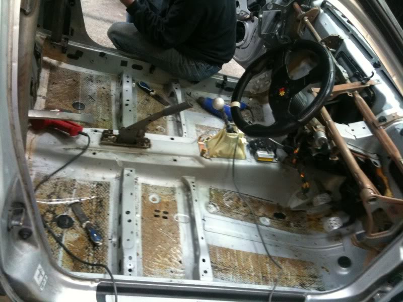

Few up to date pics..

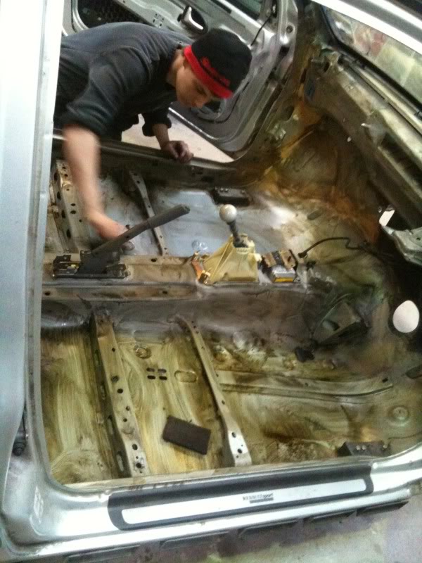

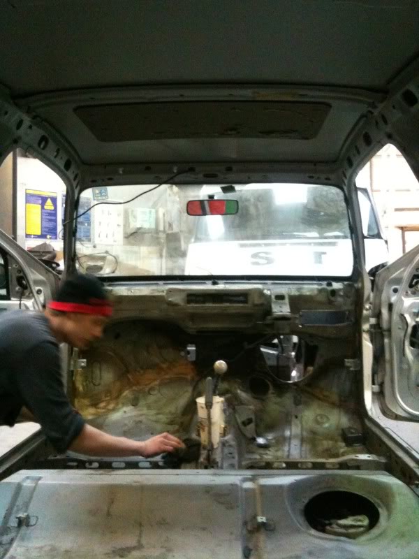

So the weekend involved getting the sound deadening out and general titting around

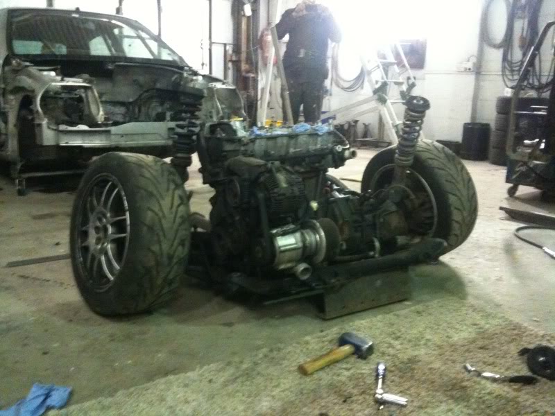

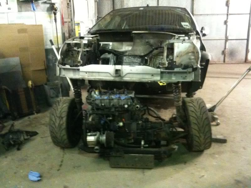

Then last night we dropped the subframe, engine and everything else
Removed the power steering pump (I would never want to do that on an engine in the car!)

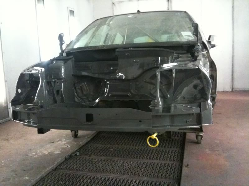

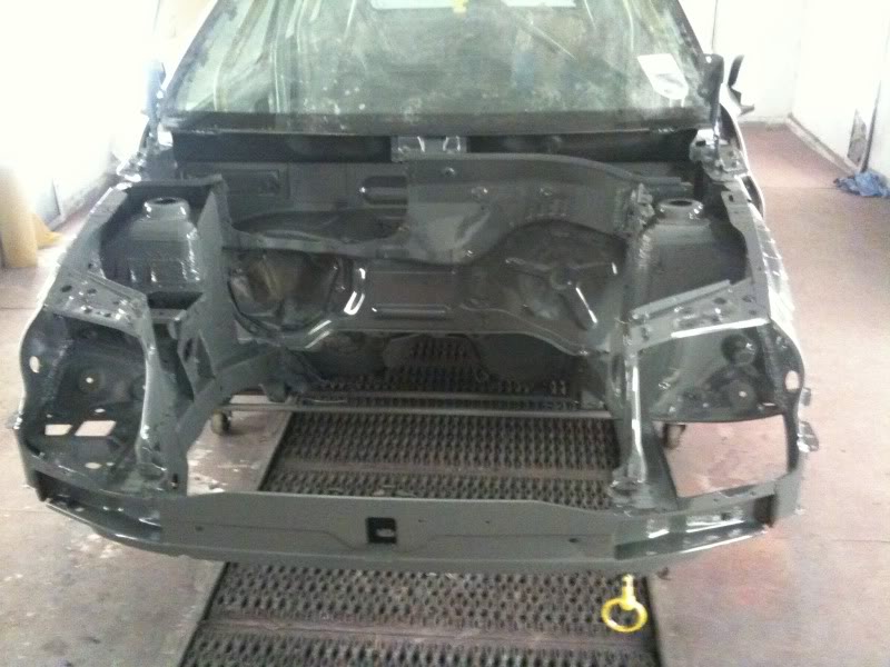

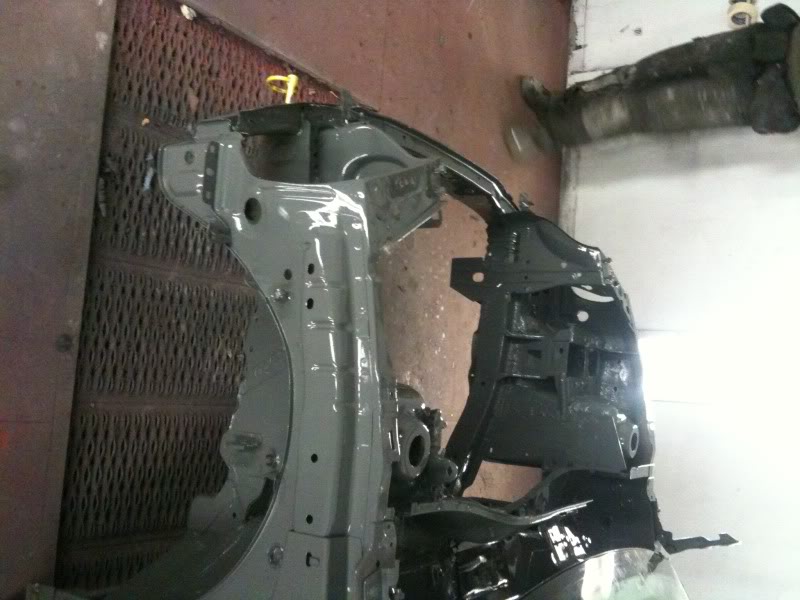

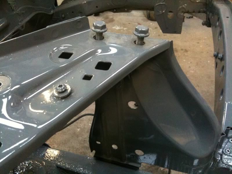

Then today it got rubbed down and engine bay sprayed ;)

Can't believe took this long to talk about colour :p Engine bay and inside is quite Lunar grey but its exactly it without the pearl in it. Outside will be going Lunar Grey yes :)

Got the blue paint today and together they look good!

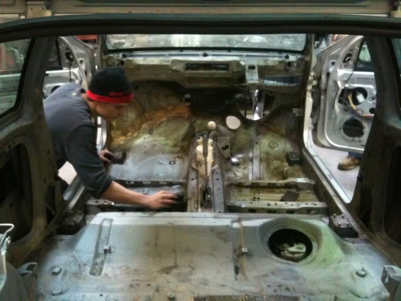

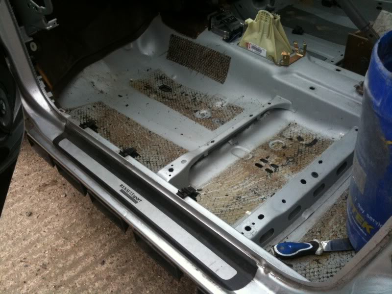

Just got in high as a kite from getting all the sticky s**t off from inside, all over my hands and it STUCK well! Also quick pic of the paint a little dusty and up close.
  M3 Touring
I do not miss removing and washing down all the tar patches with White spirits eurgh :(
you've missed a big one on the roof btw ;)
  182, SQ7, Trafic
The roof lining only came down today as the cage had been in being welded. We didnt fancy getting the heatgun in with the thinner fumes everywhere!

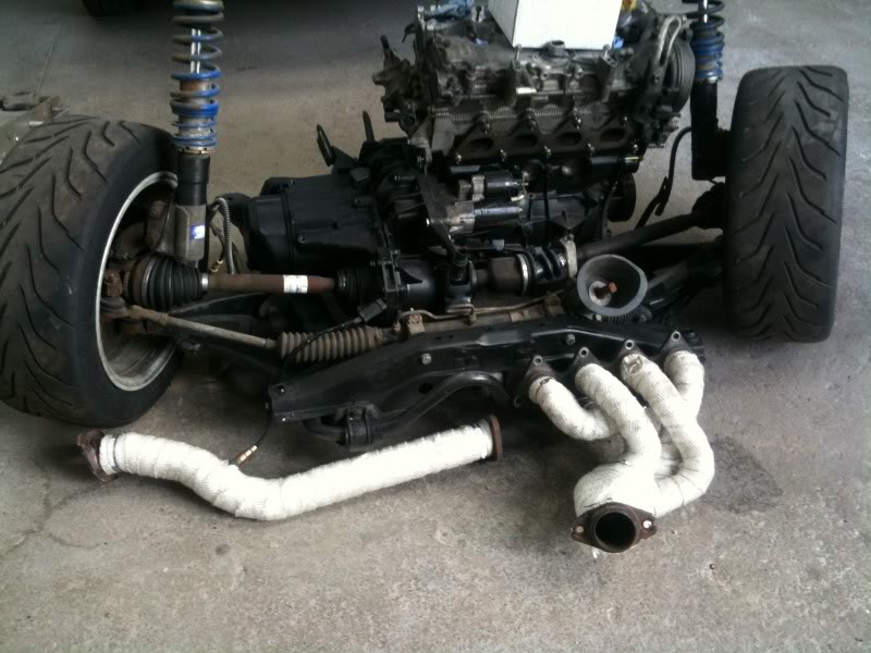

heatwrapped decat and manifold today, mates first go and was very good! And Tims mate ed came and done the cambelt, pulley was a little melted and not round!
Also I unfortunately rippled the roof taking the roof sound deadening off :( Going to have to find a new roof skin to replace it now ;)
