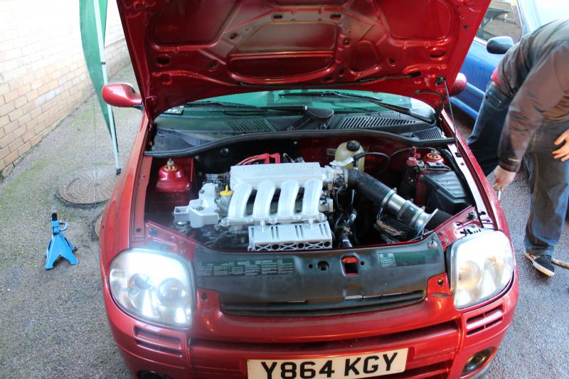

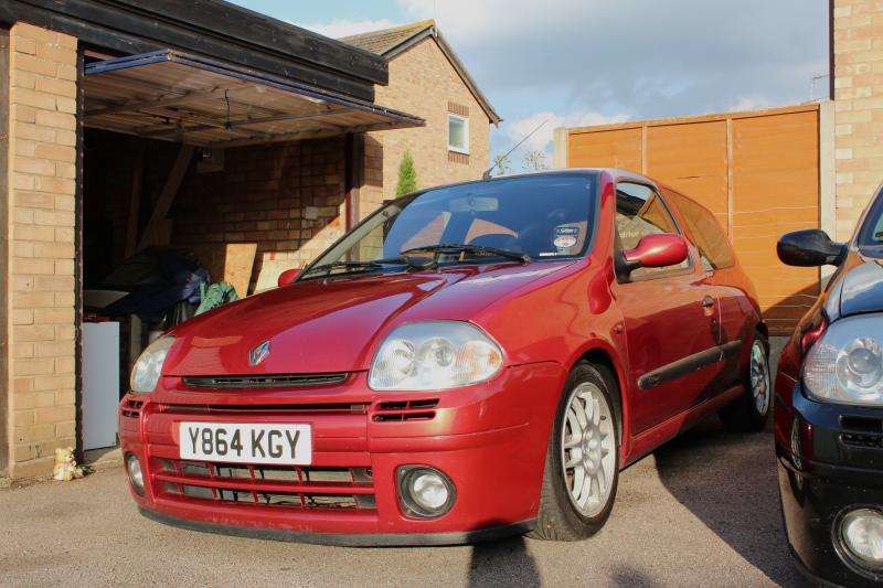

The day I got it. It had some nice bits on it already.

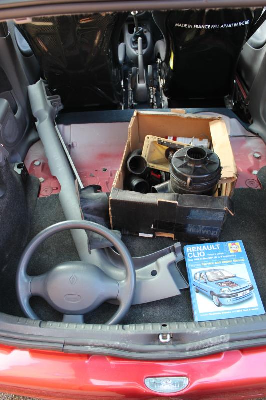

And some spares

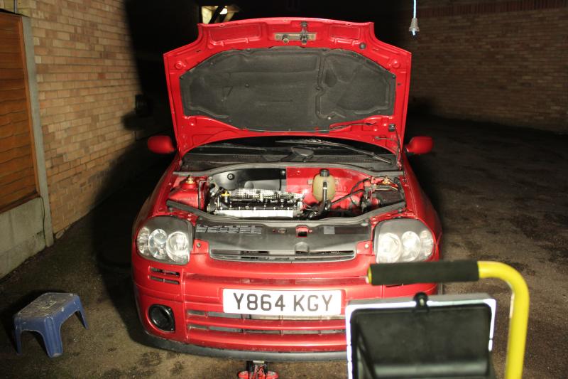

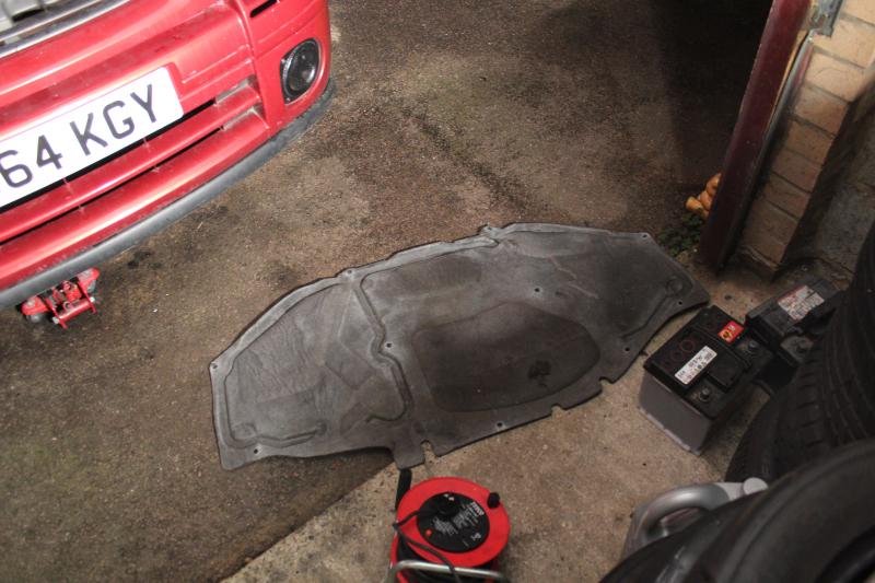

Shed'd abit of weight.

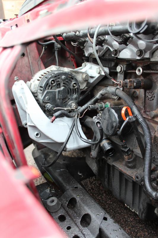

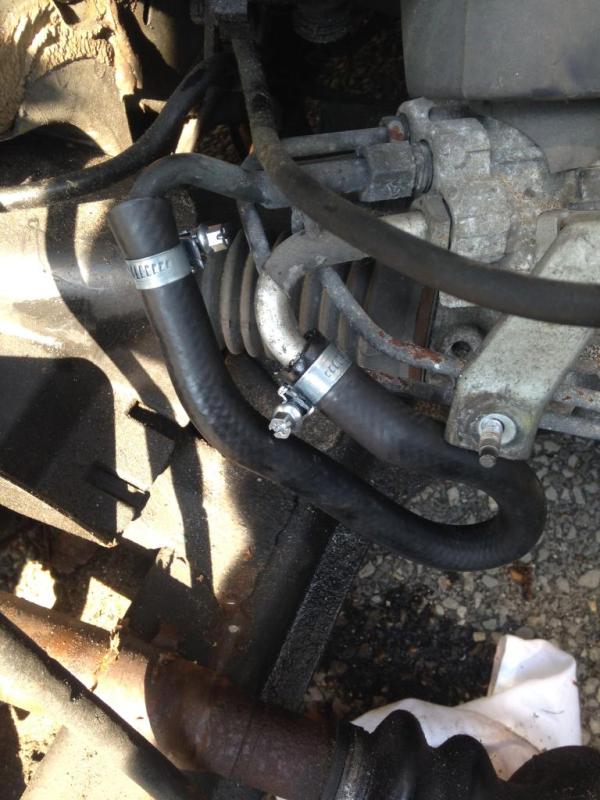

PAS gone.

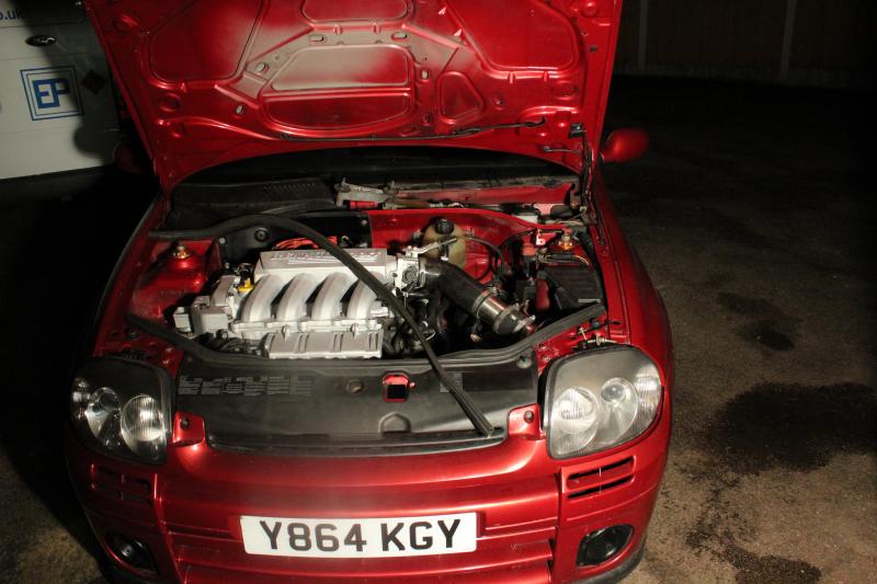

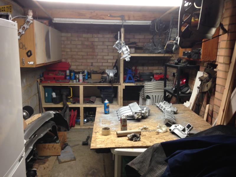

Sprayed up some engine bits.

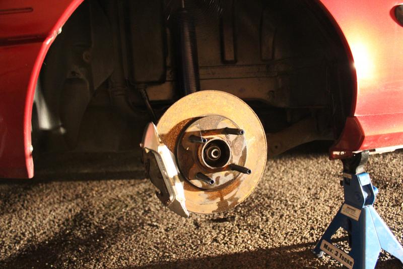

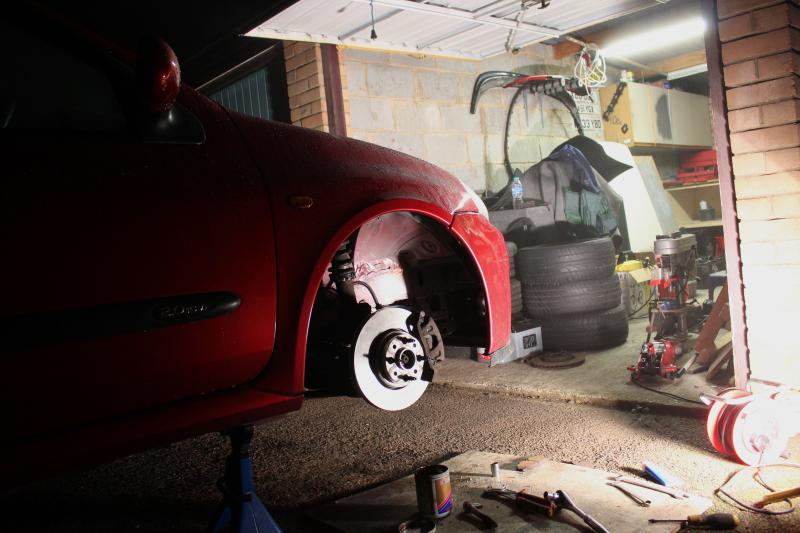

Added studs all round and a set of powder coated carriers also thanks to @Dr Jekyll

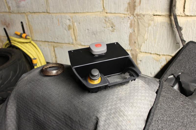

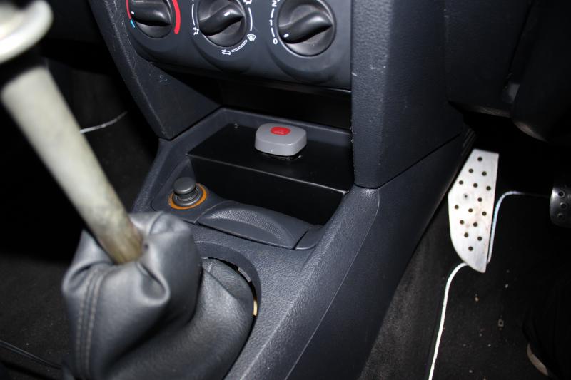

Made a super awesome bespoke hazard pannel ;)

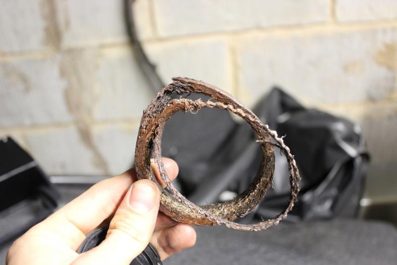

Changed the Cat-Maifold gasket.

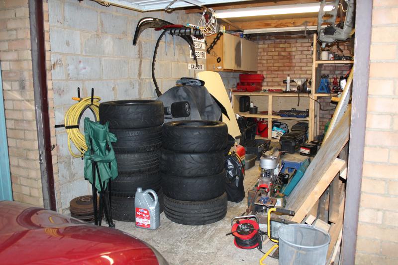

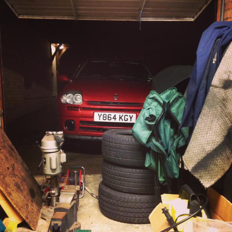

Stock piled tyres for next year, tbh I only want the 888's lol

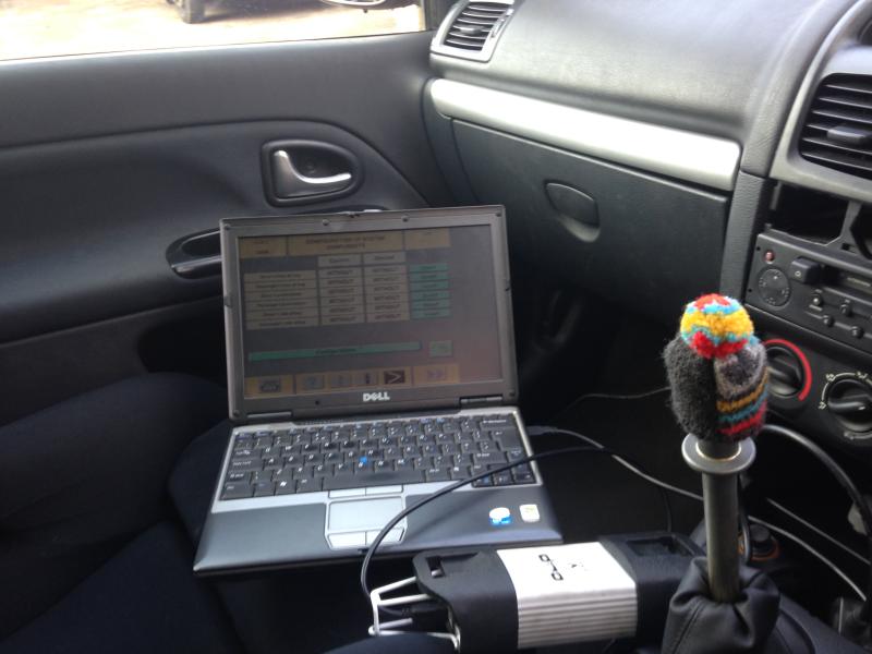

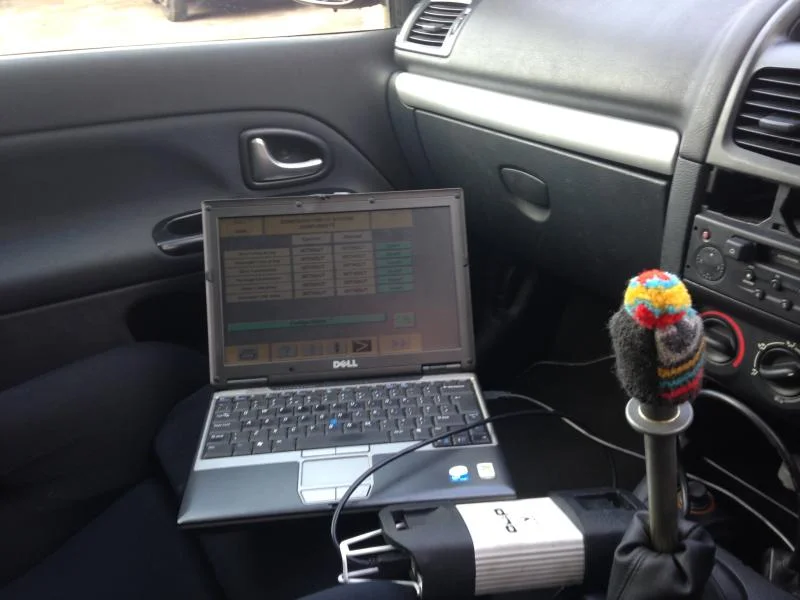

Turned the airbag lights off with my super legit cliP

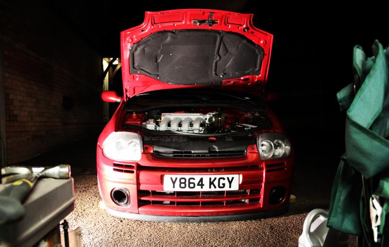

And how it sits today, waiting for an MOT at 8.30 tomorrow and then tracking after (if it passes!)

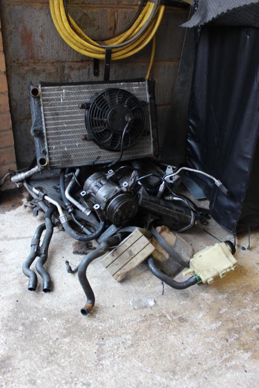

- Air con delete
- PAS delete

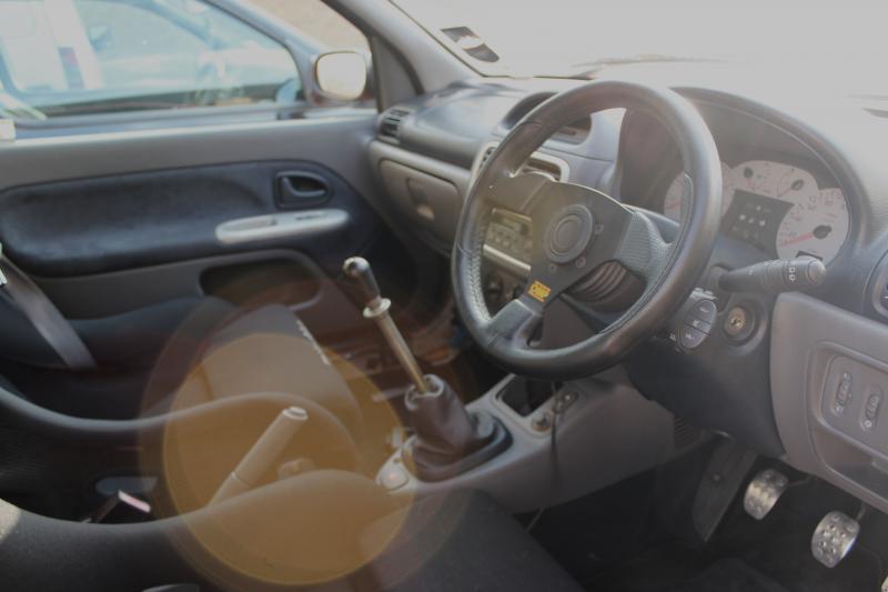

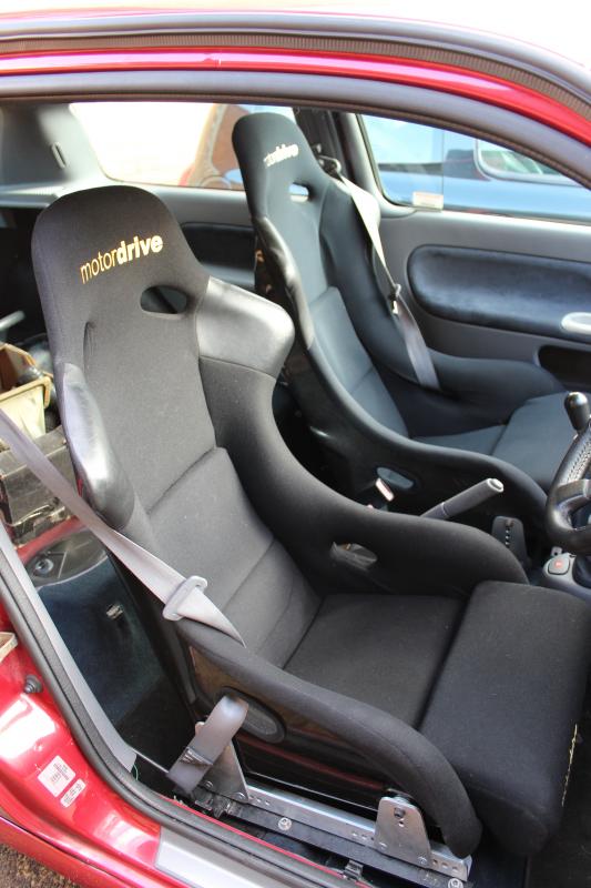

Interior

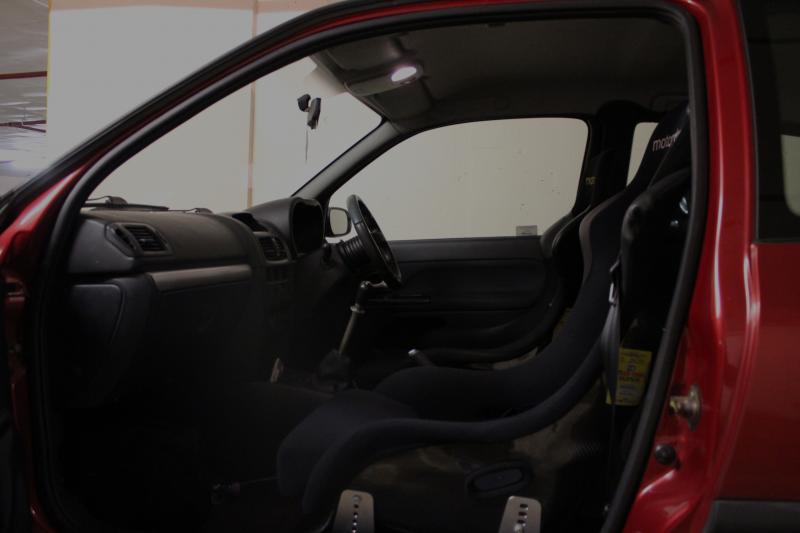

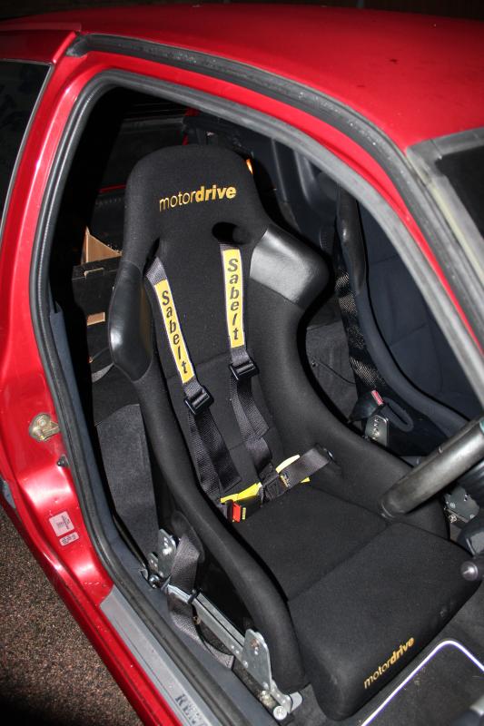

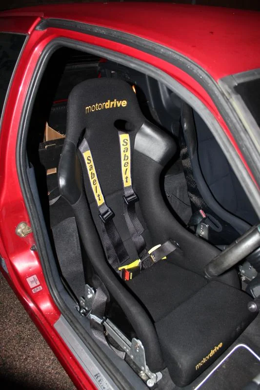

- Motordrive GRP driver seat
- Motordrive Carbon Passenger seat
- Custom x-low copy Subframes
- Sablet drivers harness
- Sabelt RenaultSport wheel which is very dirty.
- OMP boss
- Renaultsport Front Mats
- Full cup interior plastics, dash, carpets and control pannels.

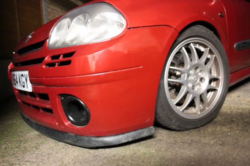

Cup Spoiler in black.
- Megane front splitter

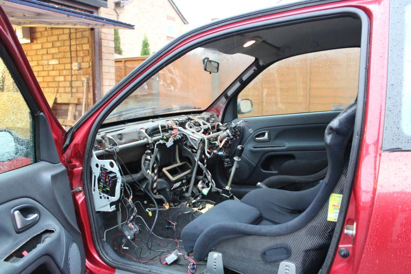

I have missed the dash conversion yes, well I took a picture of it with no dash lol. tbh last sunday I did two dash conversions in the rain so i could sell the black ph1 this week! Pictures werent on my mind lol.

-Fit skoda splitter
-Aero catch front bumper
-Raise front 10mm, literally was just to low to get the gauges in/on.

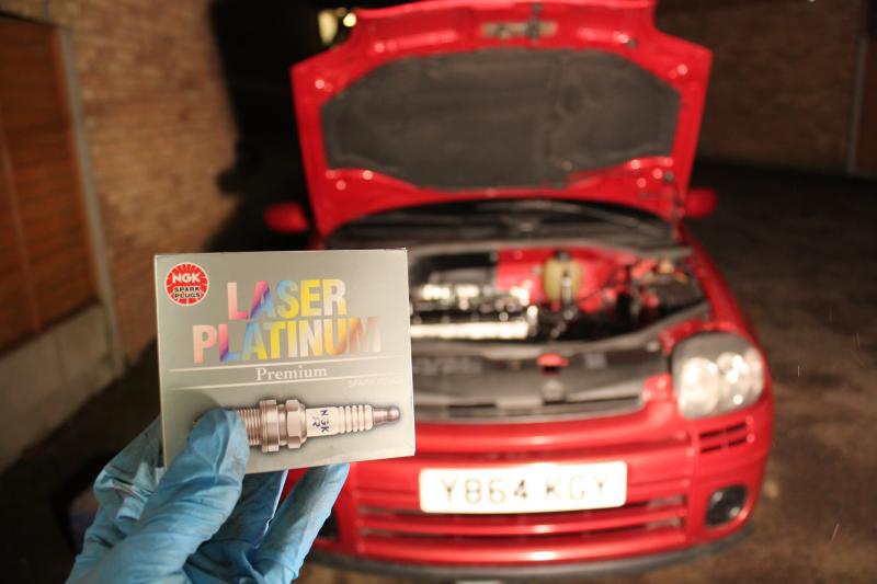

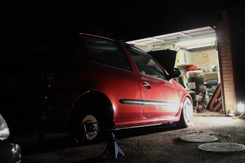

So tonight I started stripping a few bits off the car ready for the cambelt sunday.

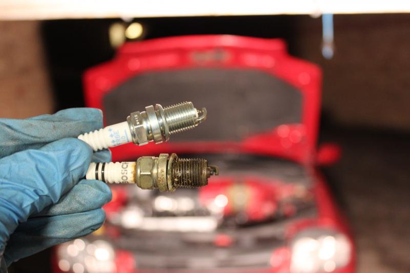

Whilst I was at it I changed the plugs, thanks to @G 172
Old V New/Wrong V Right.

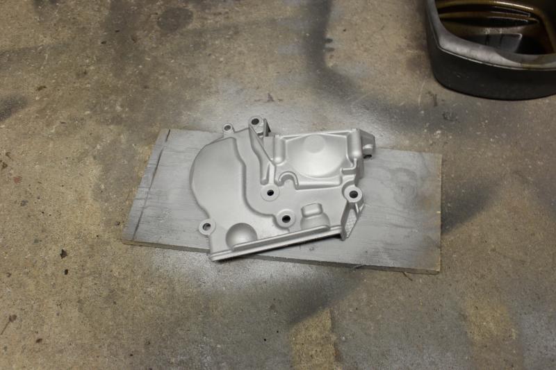

Sprayed the cambelt cover
All Ready for @AlexW to do his thing/teach me sunday.

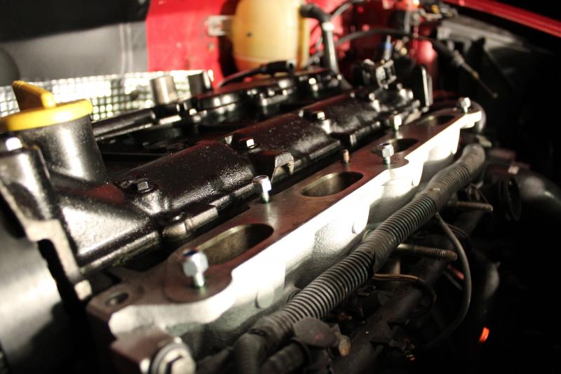

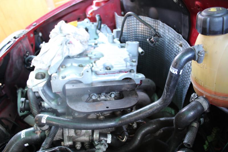

Also did something kinda sad, studded the lower/upper inlet joint.
And then I got bored and removed some more weight.
I also raised the front 10mm, the cars still on axle stands so unsure how much difference its made. Why? As it sits a little too low

I've ripped the pas pump out mine, been wondering what to do with the pipes but your idea has sorted it for me cheers!
Rubicon_
  Defender 110
I'm glad it was of some help! The loop is filled with fluid too.
Are you fitting epas?
Yeah I'll be fitting epas before it's back on the road. Tried removing the pipes at the ends but the nuts wouldn't budge so chopping them there sounds great ha!
Ive been driving mine this week with no PAS, its not to bad but it doesnt make life easy.
I removed them then cut them, they were tight mind!

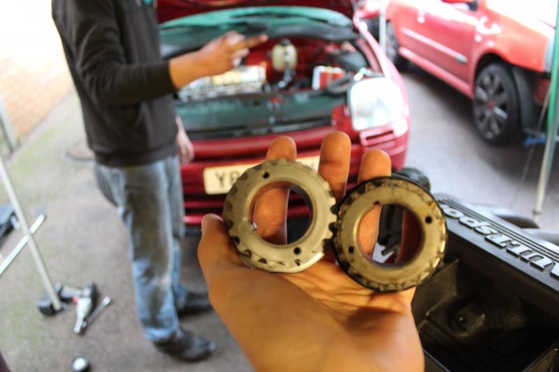

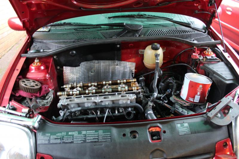

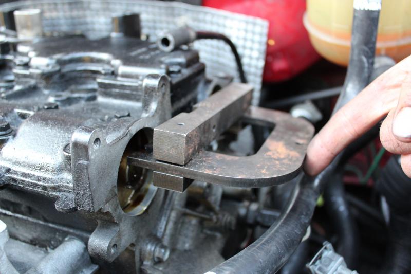

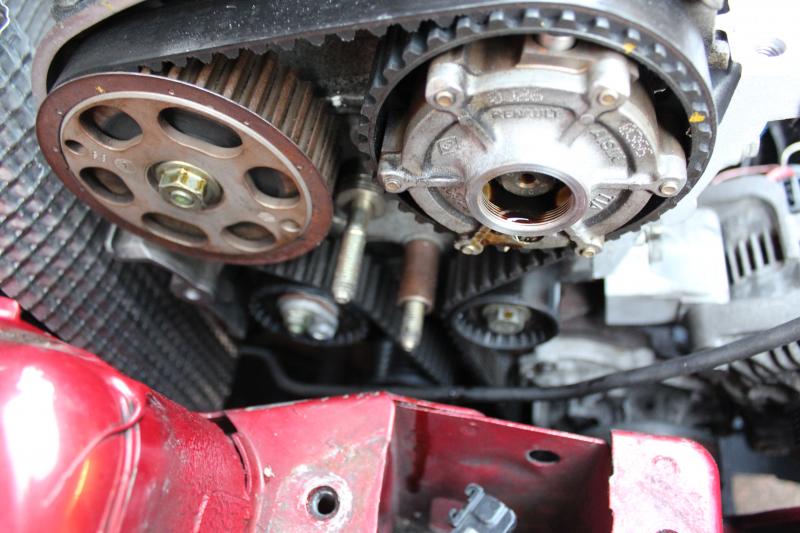

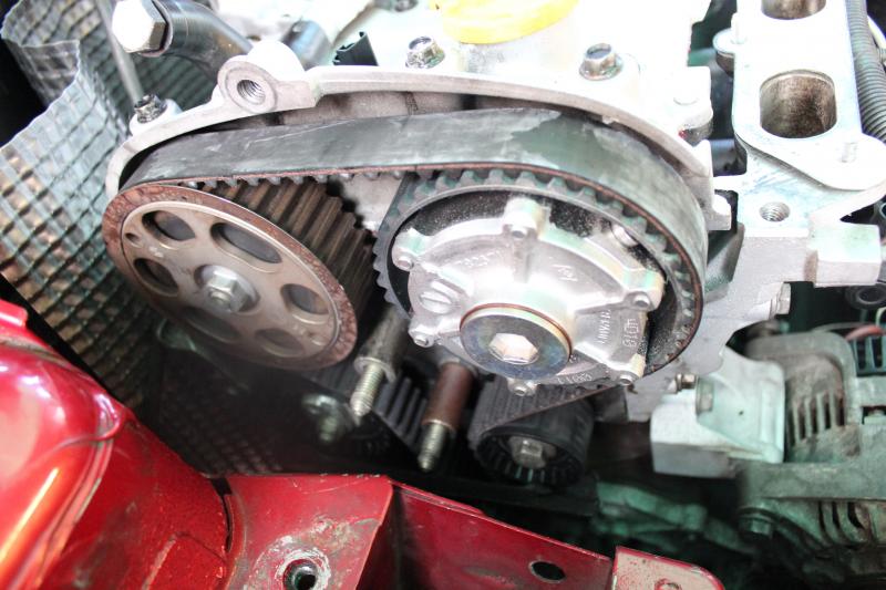

So today @AlexW had kindly offered to help/show me how to do the cambelt, ill be honest he done most of it and I spent most of the time cleaing/painting my rocker cover. I do have some idea of how its done now, which is a start! Oh and my pictures from today are as bad as always.
Old belts/pulleys with yellow marks on for timing.
Timing was out.
Fitted a megane keyed crank pulley, future proofing et all ;)
I also inherited a new catch tank from @Dr Jekyll , in the form of a coffee tin!
This is a picture of correctly timed engine, though its over exposed to s**t and I appear to not have much coolant lol
New belts/dephaser/stuff.
And another over exposed photo of an my car back together.

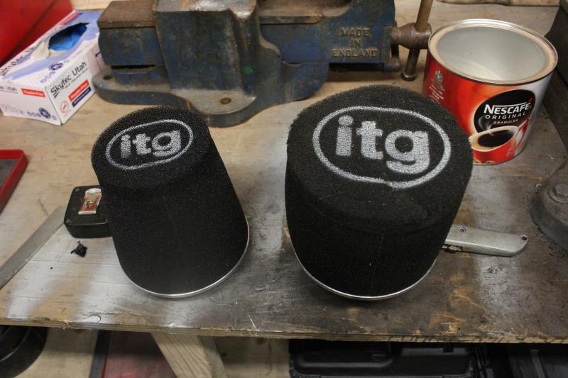

Changed the filter, new one on the left. Same size except it cones in at the top.

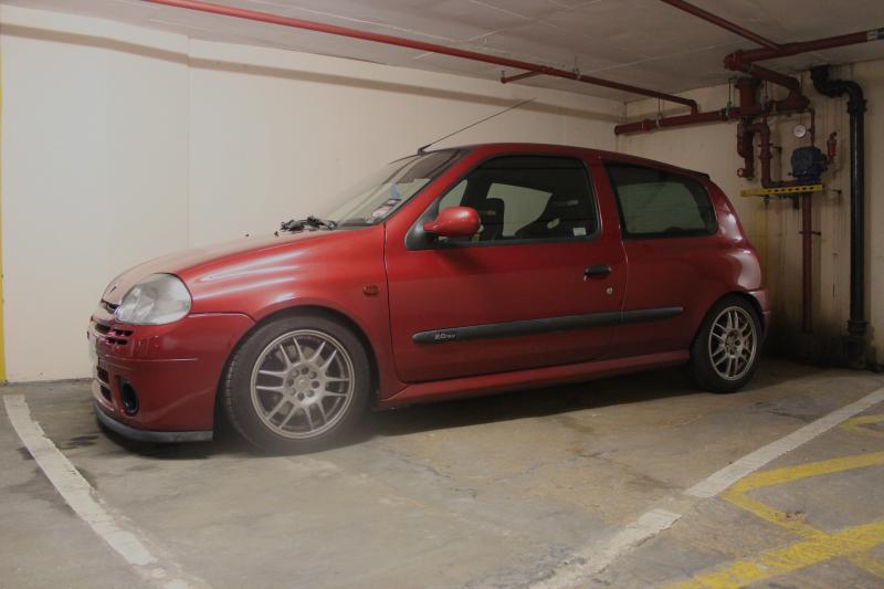

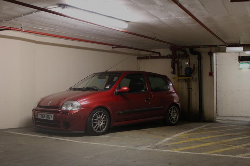

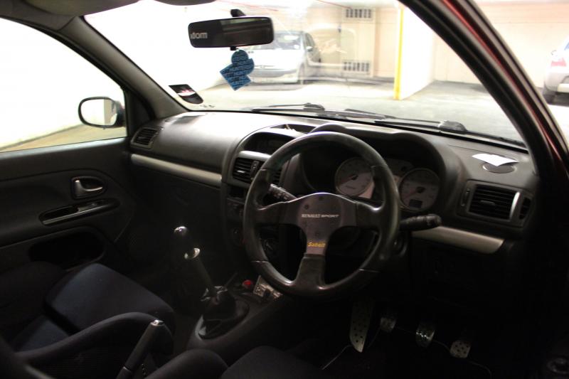

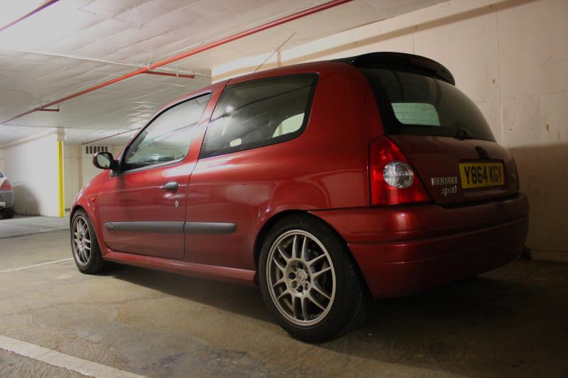

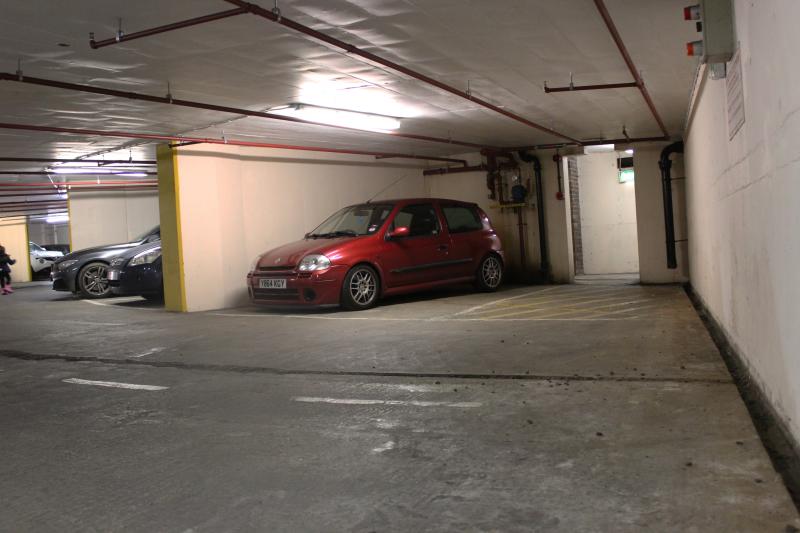

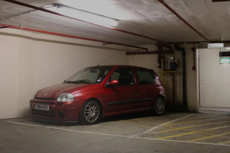

And some random pictures from a dingy multi story.
Hasnt been cleaned since Ive owned it, the car has done just over 500miles since I got it (which I cant remember when as it was a while back) and 150 of them where my friend driving it home.
