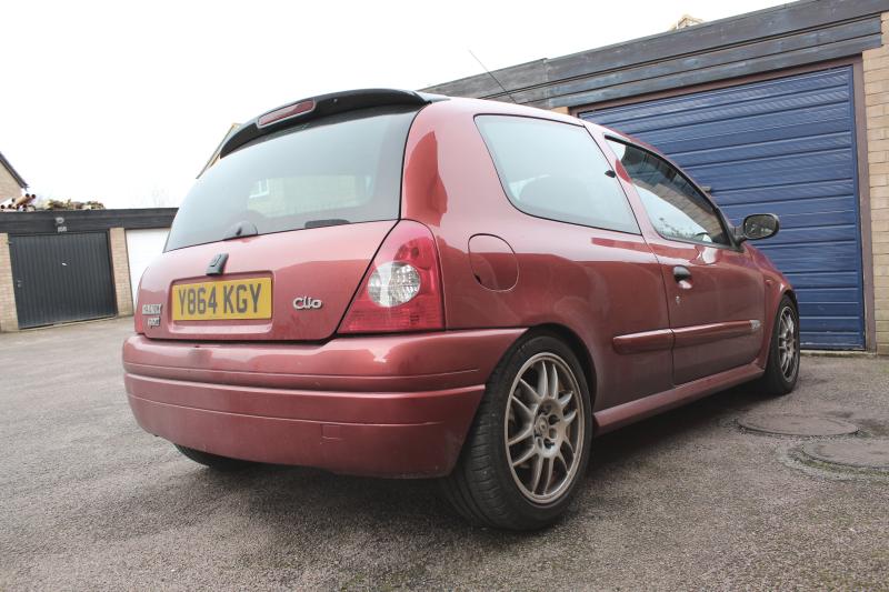

Looked sweet when I was following you home the other day.
Sounds a bit dodgy that, your rear isnt too shabby either ;) Cheers mate! I am 100% happy with the way it looks now, nothing needs changing IMO.

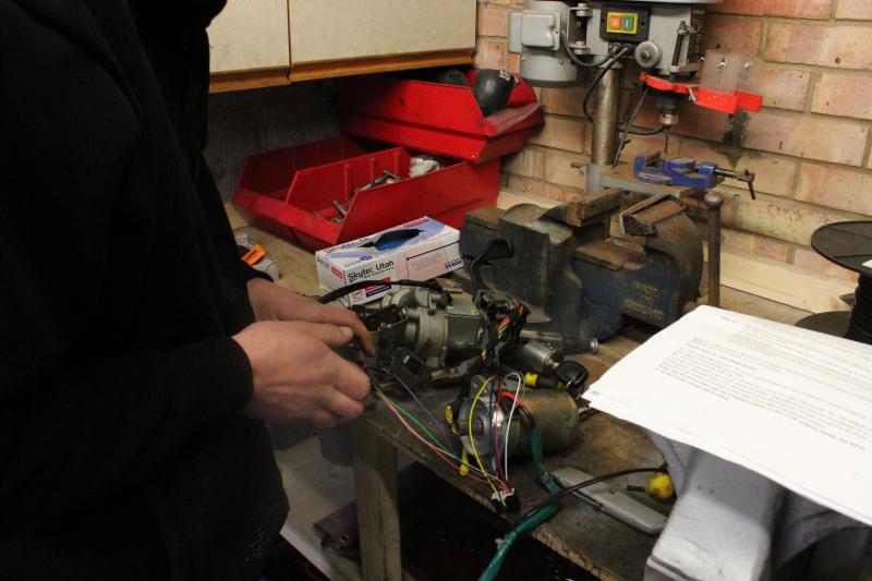

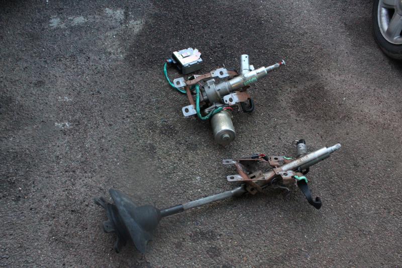

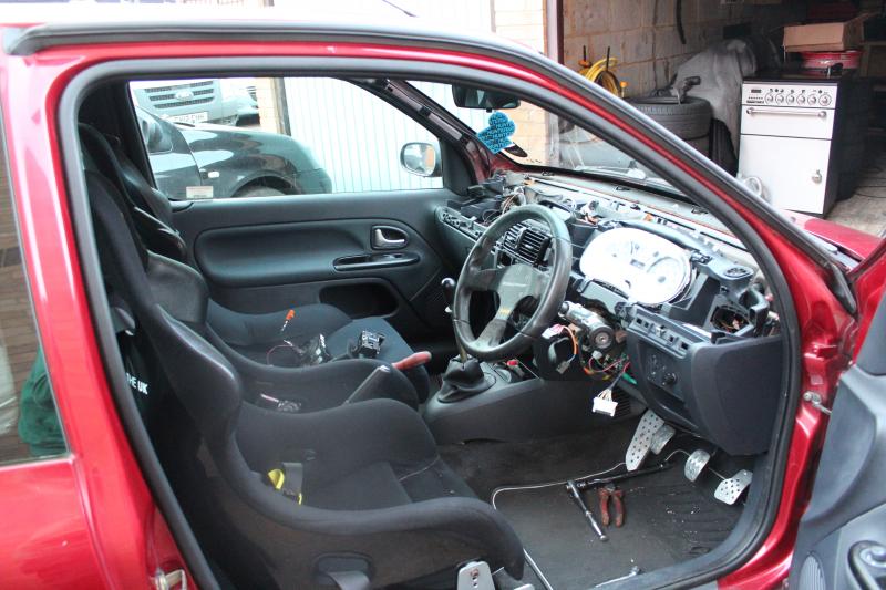

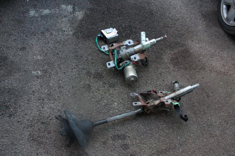

@AlexW came round and we set about fitting the epas, it didnt take long and the car was looking like this.

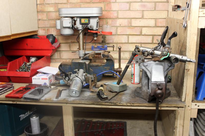

EPAS v Sport Column. And this is where we hit problems, I didnt have the lower part of the EPAS column thinking the sport column would unbolt and fix to it. I was wrong it would seem!
Regardless of this Alex did his thing and fixed wires together. Joining the ebay box of tricks to the loom and so on.

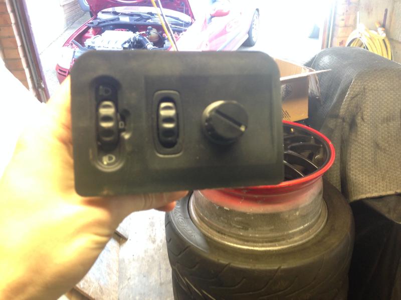

Whilst Alex done that, I fitted the adjuster to the light pannel.
And this is how we left it. All wired in, though we dont know if it works lol. We tried it but the motor didnt seem to do anything, unsure if its because it had no resistance or not but it had power. We also found out the ph1 squib doesnt fit to the EPAS column, Alex has kindly offered to drop one of this week.

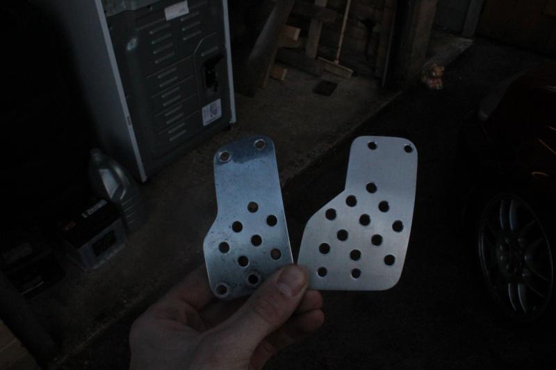

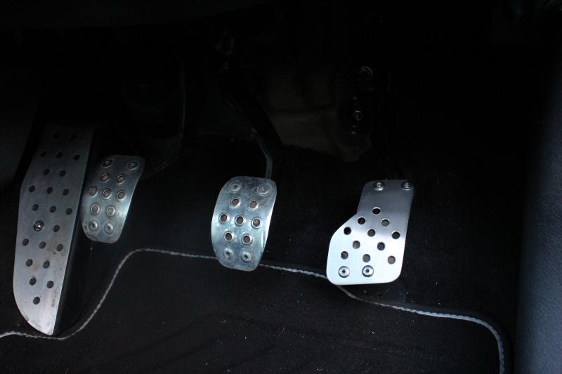

Oh and I fitted the heel and toe pedal.
Need a new cable, pedal sags bad!

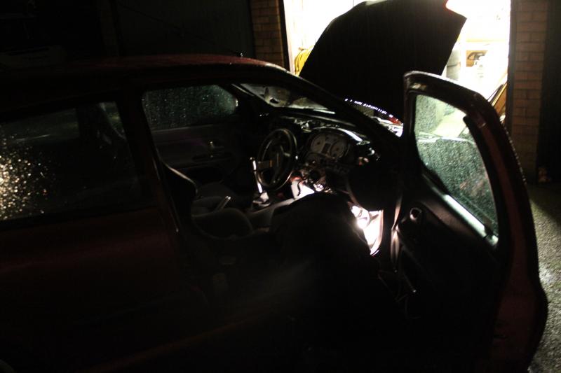

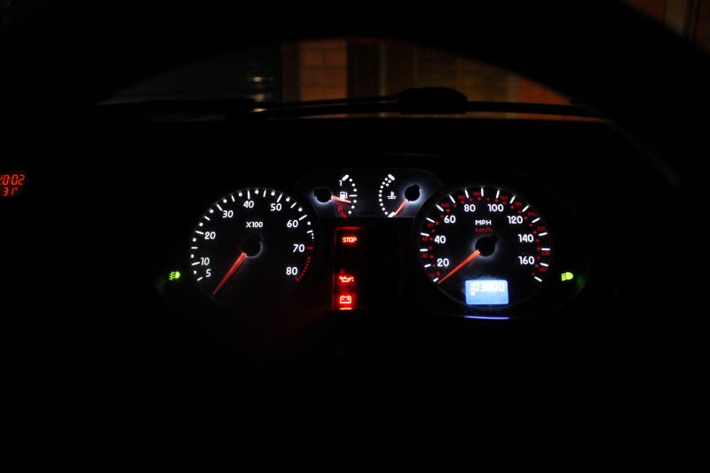

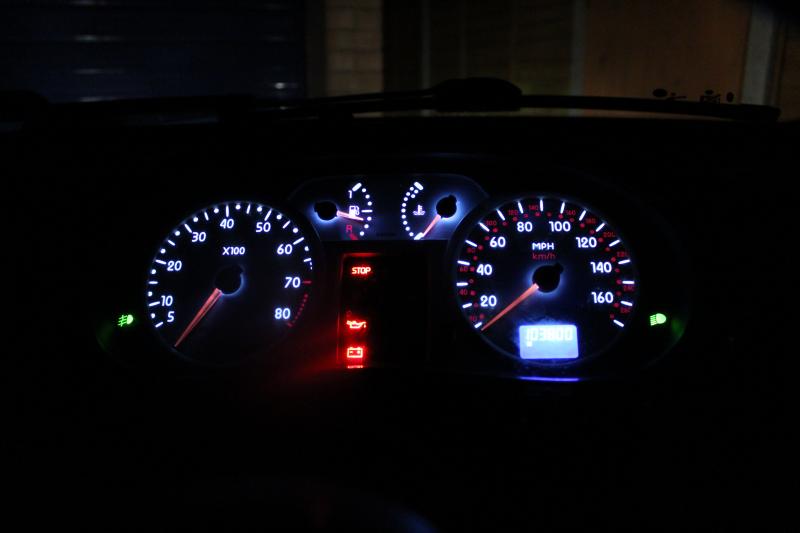

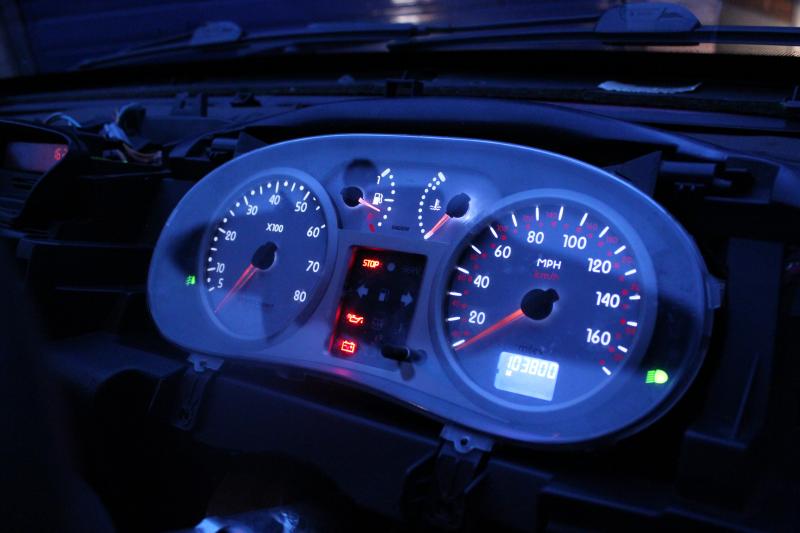

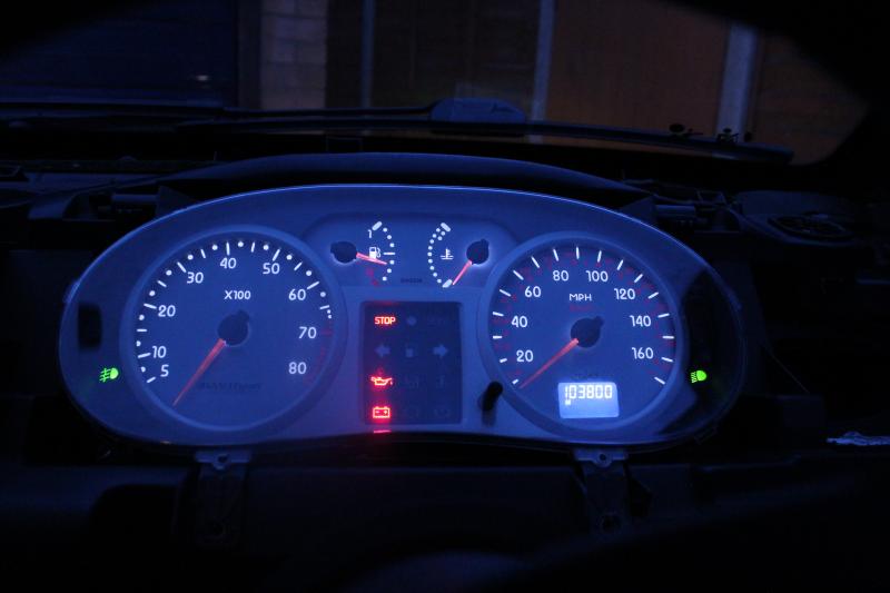

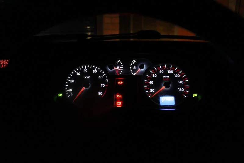

So semi succesful day, Oh and I now my dials converted to LED which look pretty good! Picture to follow when its dark :)
Really hard to take a photo of these! Looks utterly brilliant and will look even better once my dash is back in lol

Window switches Alex has taken home to play with as they are different to the ph2, see if he can change them! Ive gota order the heater control/clock bulbs too finish it off now! Getting the car so it steers comes first though lol

The rev counter was a little teething issue, its fixed now.

With the conversion is there actually that much bleeding from the lights or is it just the pictures. Especially on the LCD. It's the only thing putting me off really
Not at all, they look quite sharp in reality. Im pretty useless at using my camera so those are the best I could get lol
The LCD is crystal clear

Out of interest, why do people do the epas change? I always thought electric steering felt rubbish in comparison but obviously not in this case or people wouldn't do it lol
Car looks awesome.
Simplicity of the engine bay & less pipes to leak, no fluid to boil over on track. I would say reliability too, but I don't know who reliable epas is in the long run.
The beauty is you can adjust it. I liked the car with out pas until you were doing less than 5mph & trying to park.
Fingers crossed I'll have it up and running tonight so I can deliver my thoughts on how it feels!

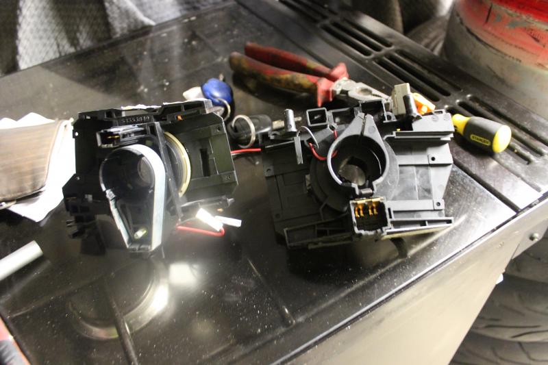

Kirk will i need the lower column and a different squib to fit the Epas to my PH1, you didnt need it for yours did you.
Ended up with getting another column today, I only needed the lower part of the column so I now have a spare/one to sell on in time.
@AlexW then dropped round a ph2 squib.

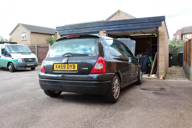

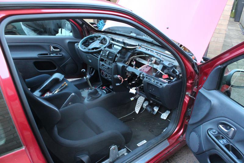

Then like a mad man Alex got stuck in, I was a bit reluctant due to the rain! We also broke all of my portable lights, things were going well!
Rack City. We ended up using part of my pas column, part of the epas column and then the upper column from a DCI that we fitted yesterday.
Ph1 squib on the left, mounting is different to the ph2 squib on the right. Ph2 item fitted, then streamlined slighty (air bag wires removed.)
Alex drove it and was impressed, Im yet to do so.
Few interior pannels to back in, few other bits to fix on too. Need to find a fix for the drivers side heater tubing too.

Dci tube won't fit either, I checked on my DCi at the time. You'd need a non sport heater box too, poss just an issue on a pH1 tbf.

Yeah Ph2 doesn't have any issues with the vent pipe. Just Ph1 :/
I may fit an EPAS column. I'm quite happy without it and I don't use the car much but the adjustability might come in useful. We'll see...
Driven it,
Its very nice to drive and its awesome being able to adjust it, I currently have it set to almost off. Once I get used to it im sure ill stop changing it so much.
At current the indicator doesnt cancel, so I need a ph2 indicator stalk.

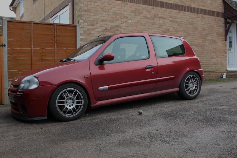

Ph2 boot hatch with Ph1 rear bumper is a good shout though. Looks spot on IMO, but then im bias.

Can't believe how much I've gone off ph2 lights on a flamer, used to love them, now I think they look fussier.
