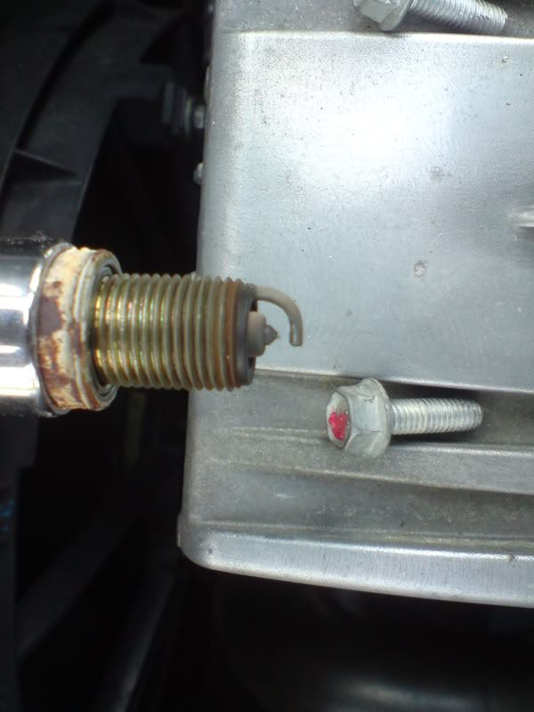

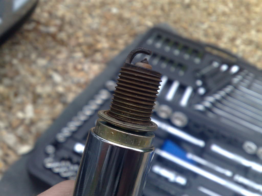

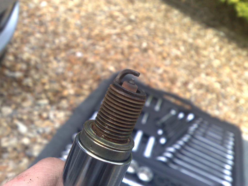

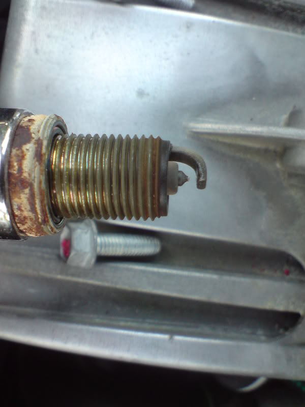

so i have took my spark plugs out this morning and im not sure if i need new ones or not?
the gap between them looks huge!!
this is the first 3 i didnt take one of the 4th cause its just the same

the gap should be 1mm max
that looks too big IMO
NGK PFR6E-10 is what you need
LOL well they deff not 1mm lol. ill go get some then mate cheers :)

The electrodes on those plugs look dead, you can try altering the gap but tbh you're in definite need of new spark plugs asap. You won't be getting a good spark from those even with the right gap.

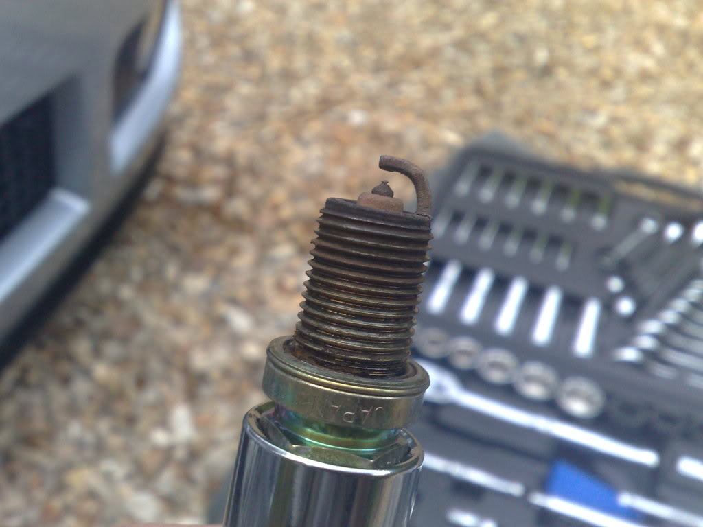

Heres the pics of mine
