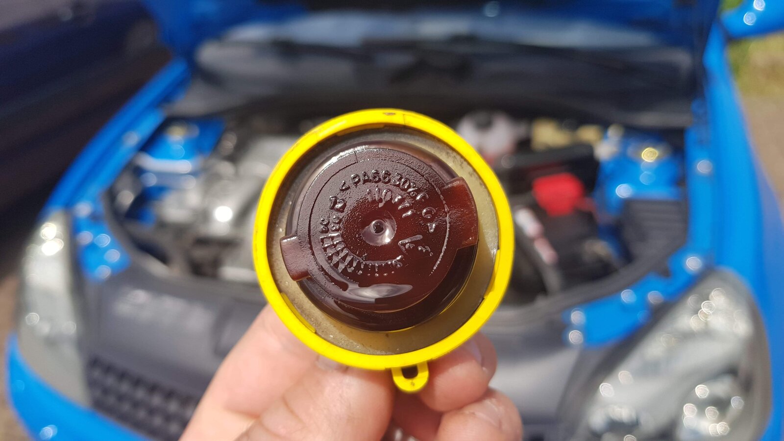

The oil cap on my old 1.4 MK3 was completely different to the cap on my 172 and 182. It had a built in dip stick
Jekyll
For reference, this is a 182 cap.

Rather sure that all the RS oil caps are the same.
172 / 182 / 197 / 200
