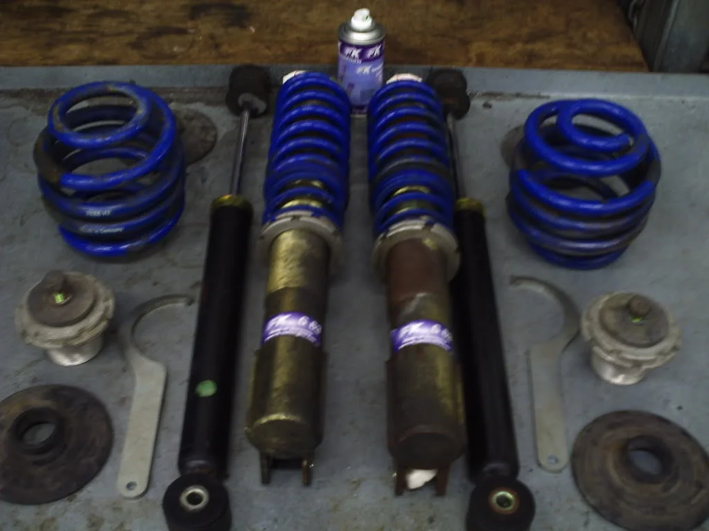

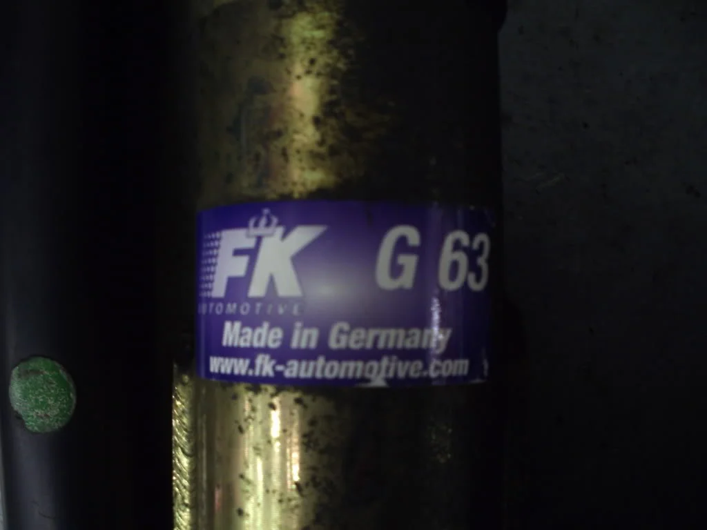

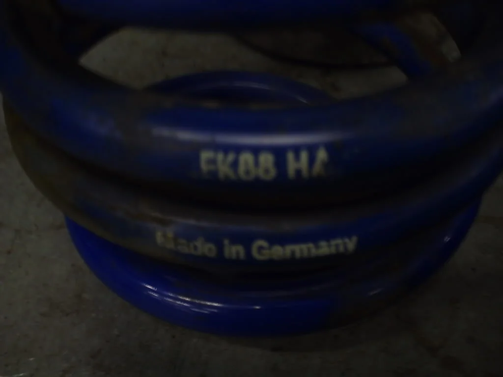

do you know what fk automotive coilovers these are?
Car  Audi A5
as above finding it difficult to find out exactly which model these are. sorry for the picture quality didn't realise how bad they were till i uploaded them.
any help much appreciated

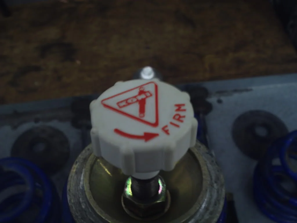

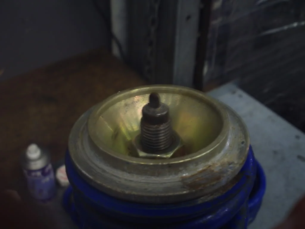

Means these are not stainless steel. Rear adjuster on FKs like to seize but that's easily sorted with tons of WD40 or heat.
yh i had a go at freeing them off earlier they were tight but managed to get them all loose. what do people think of these any good?
thanks for all your info mr pink and 519automotive very much appreciated. might see these in the forsale section soon if anyone interested :)

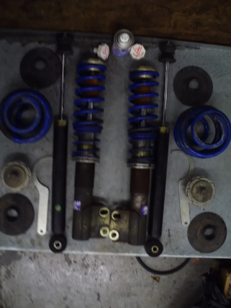

also i was wondering have i got everything i need to fit these straight to the car. im not sure if their is anything needed to bolt to turret i.e are these compatible with oe top mounts. also could you use the original pinch bolts off oe shocks as their is no camber shims present.
you will need original top mounts. The spring cups on the fronts look a little odd, not sure they're the right way up. Looks like eveyrthing's there though
Cheers mate yeah think I got then the up side down lol do you think its ok to use these with oe pinch bolts or would camber shims be a must. I was thinking maybe they would have a set camber that way if you know whY I mean?
Yeah I see what your saying how much camber can you have their dosnt seem like much room for adjustment?
