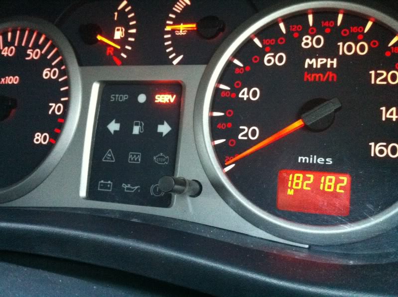

Bought on 170k/5 years old, sold on 187k 2 years later. Sold a 50k mile £7k Trophy to buy it, drove exactly the same.
Was bought solely as a second/track car, so took ALOT of abuse. However, it was maintained impeccably and its only break down was linked to a fault with a new part, not the car (PAS line ruptured after PMS aircon delete fitted). Shouldnt have sold it, but i thought i needed the money. Now replaced with a highly tinkered with MCS, on 100k. It produced a solid 175bhp on 180k, with only an airbox/BTB catback & 90 ron map.
So yeah, my preference is to buy a cheaper car (with higher mileage/in need of work), then pour money into it maintenance wise, then i know parts have been replaced properly, not by some halfwit. Far better idea than buying someone elses "minter" as more often than not, their standards are lower than mine.
