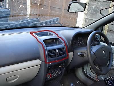

Does this come off?
Car  Clio Dynamique 1.4 16V
Was wonder in this this part came off the dash?
If so where can i get one?
Some people manage to take that bit off once the top dash is off with it.
They kinda separate by "melting" the joints as they are actually separate pieces.
Was tempted to do it at some point to spray it, didnt bother in the end though.
Take the dash top off, cut the tiny plastic tabs.
Piece of piss mate.

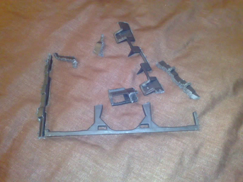

YES! HAd to get rid of all the plastic behind there although I have cut it soo that I can put it back on... it sitting upstairs in a drawer.. if you want il take some pics of what was removed.... brb
Actually didnt remove as much as I thought butit was still quite a bit.. This is not in order I just threw it on the bed to take a photo. Gonna be fun putting it back in! lol

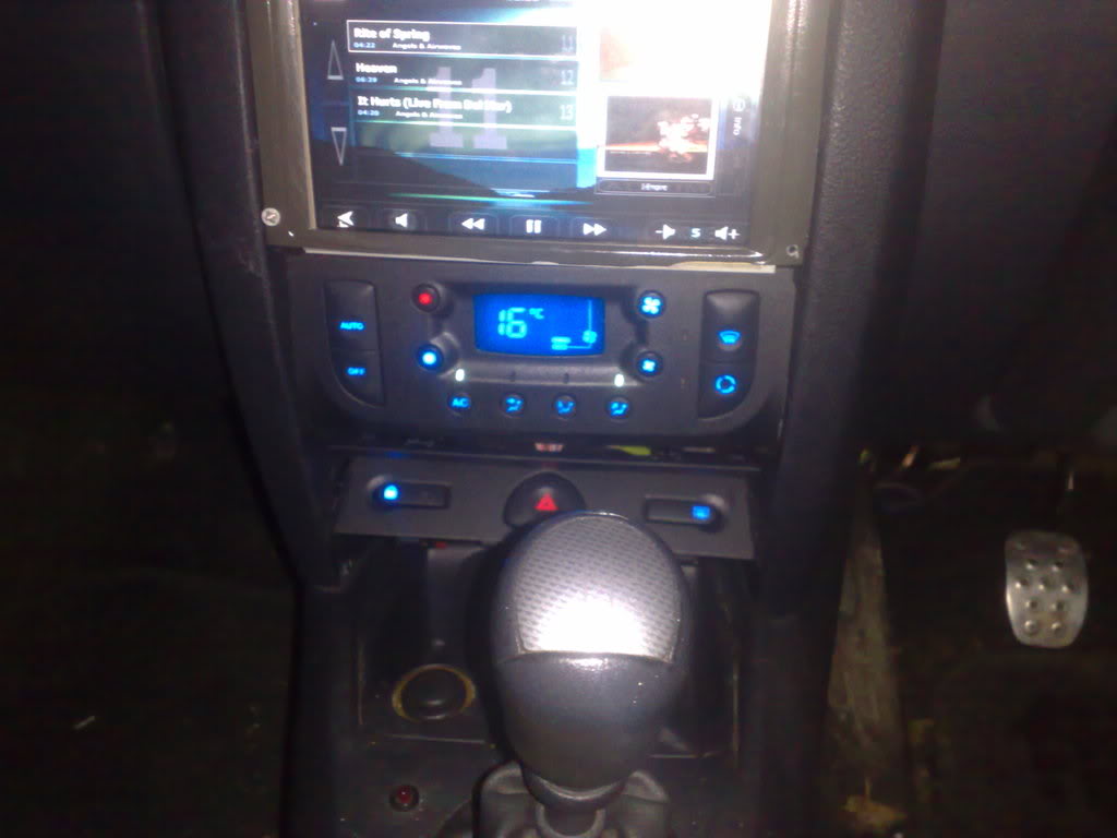

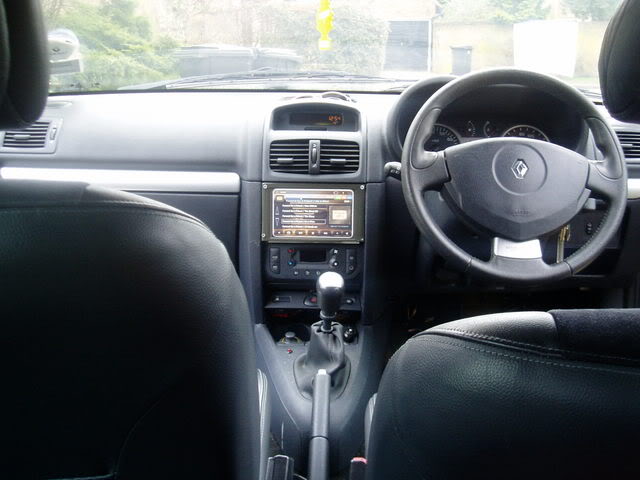

"Just" The monitor I have is a Xenarc 7" touchscreen and it doesnt quite fit in. I wanted to mount it inside something but it just wouldnt fit. I removed the Hazard switches and mounted them here...
As you can see my case is cracked to f**k and its held in by screws :o... it was only ever a temporary thing until I could fabricate it properly but the Renault just isnt easy to do that... now if we had a corsa or a focus thats a whole different story! they are easy!
