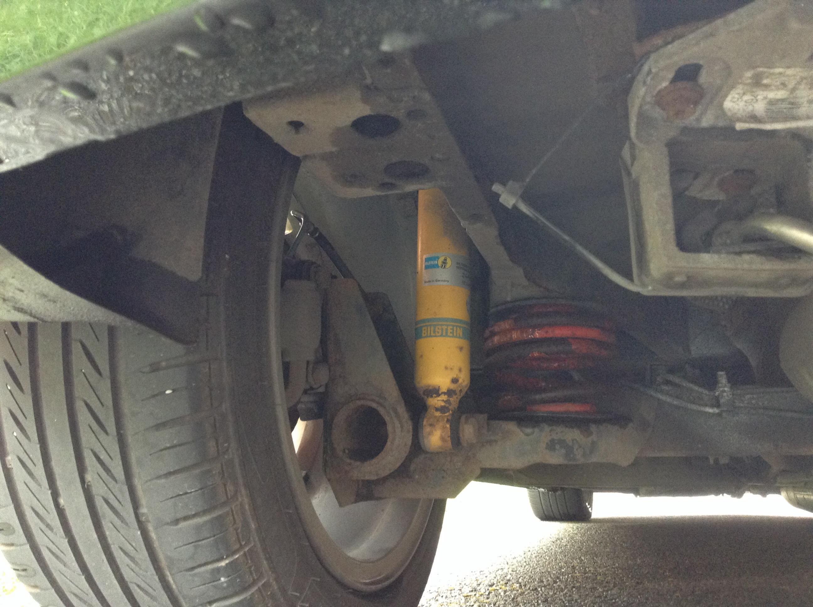

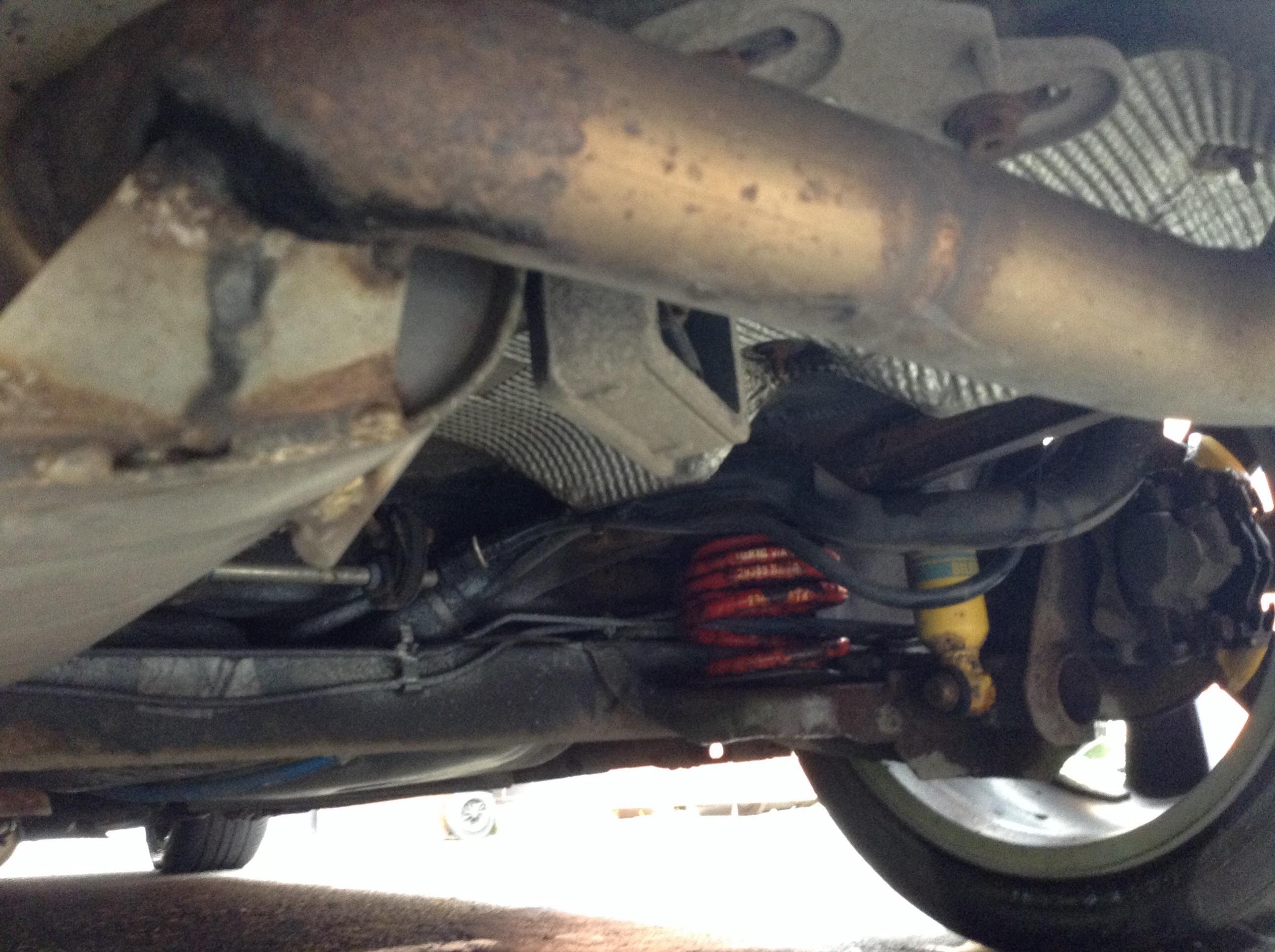

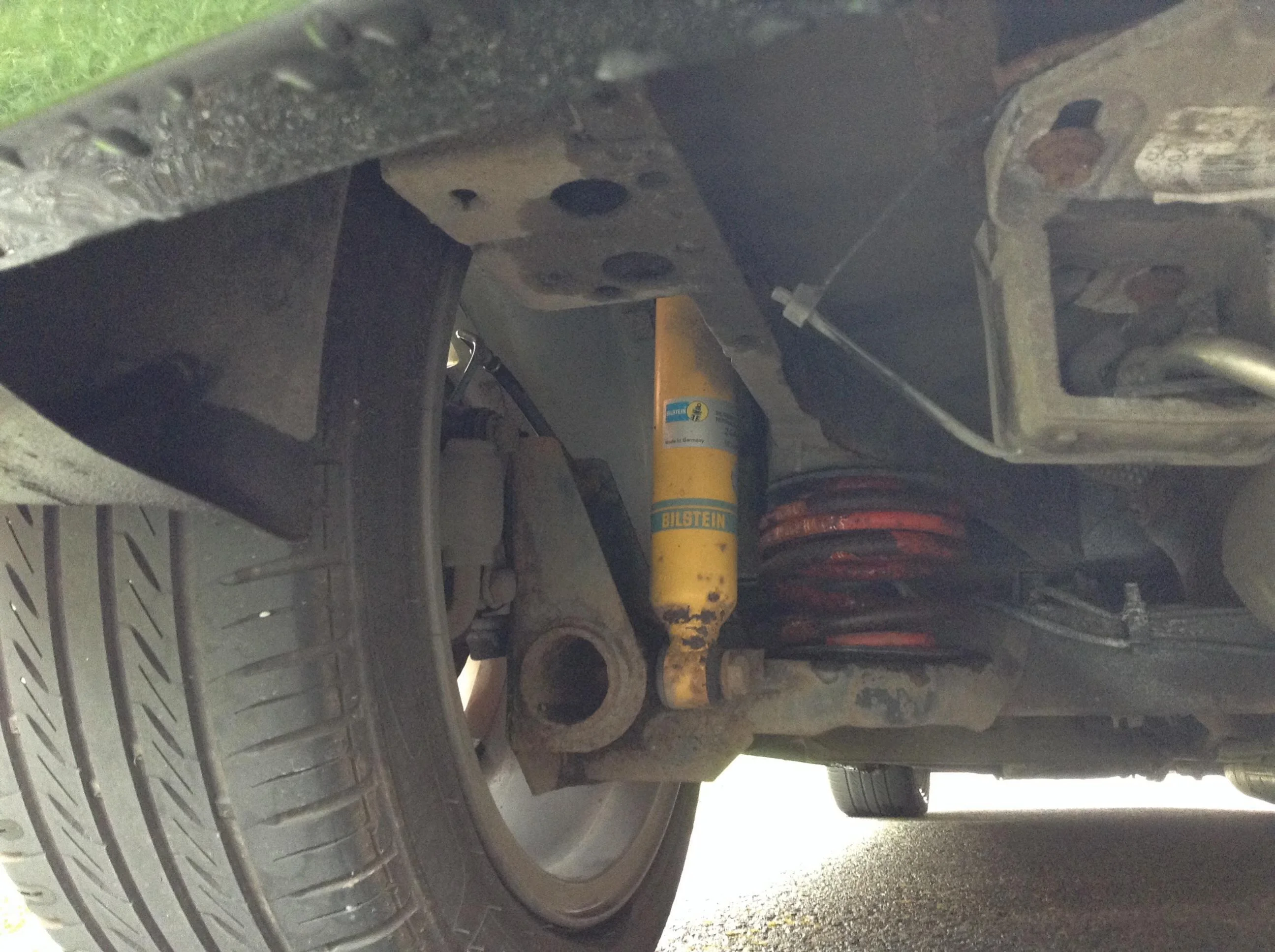

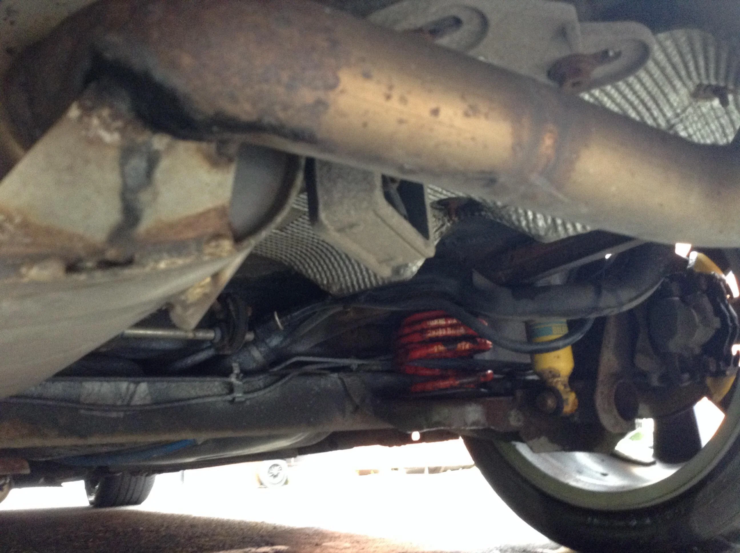

I have bilsteins fitted to my clio approx 5 years old.. Do they look ok? The suspension is good, driving it I wouldn't say the suspension has gone.. Time for a change?

Exhaust is in tomorrow morning for new one :-) feels ok but previous owner ain't kept on top of cleaning it so not sure if it seized :-( I have boon told it is and also told it isn't
It's impossible for anyone on here to tell if something is seized by looking at it. Spring don't seize though, the damper won't and your beam won't have either. These all move when driving so don't get stuck. Just look for leaks on the shocks. You can paint them to stop corrosion.
Car is too low though
Bilsteins kit with eibach springs. looking to buy RB so not changing set up
Height of a car is personal preference. I'm happy with the height and any lower I may struggle with speed bumps. Seen a lot lower
My old Vmaxx springs (both sets) used to coil up like that where the top 3 coils touch when compressed.
I've had 2 sets of Eibach springs and they've never looked like that :S
