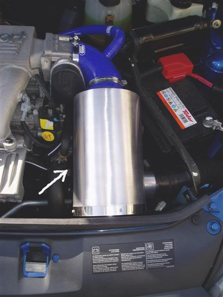

Sounds like the temp sensor to me . It might be knackered or just a loose wire . You could try giving it wriggle , its under the airfilter box .Its roughly where the arrows pointing , but underneath .
Yup, same symptoms I had, I tried the fix as suggested, and tried cable ties around the wire which wirked for a while, but the problem came back. Keep an eye on your mpg too, I was losing about 5mpg on average!
Didn't cost me much to have it fixed at the main dealer. :)
